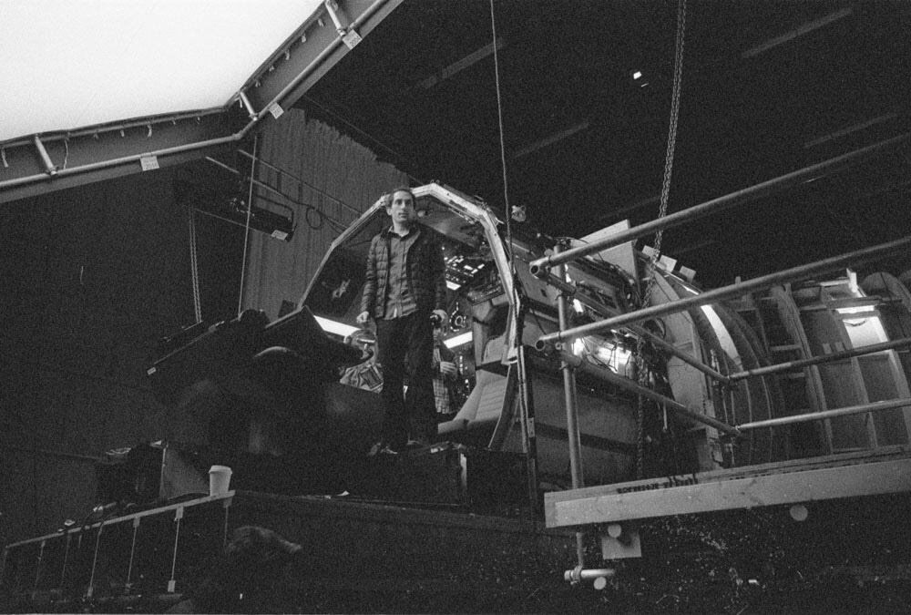

Hey T,
I know. How wonderful is that image. Note the steel frame around the body panels. :)
