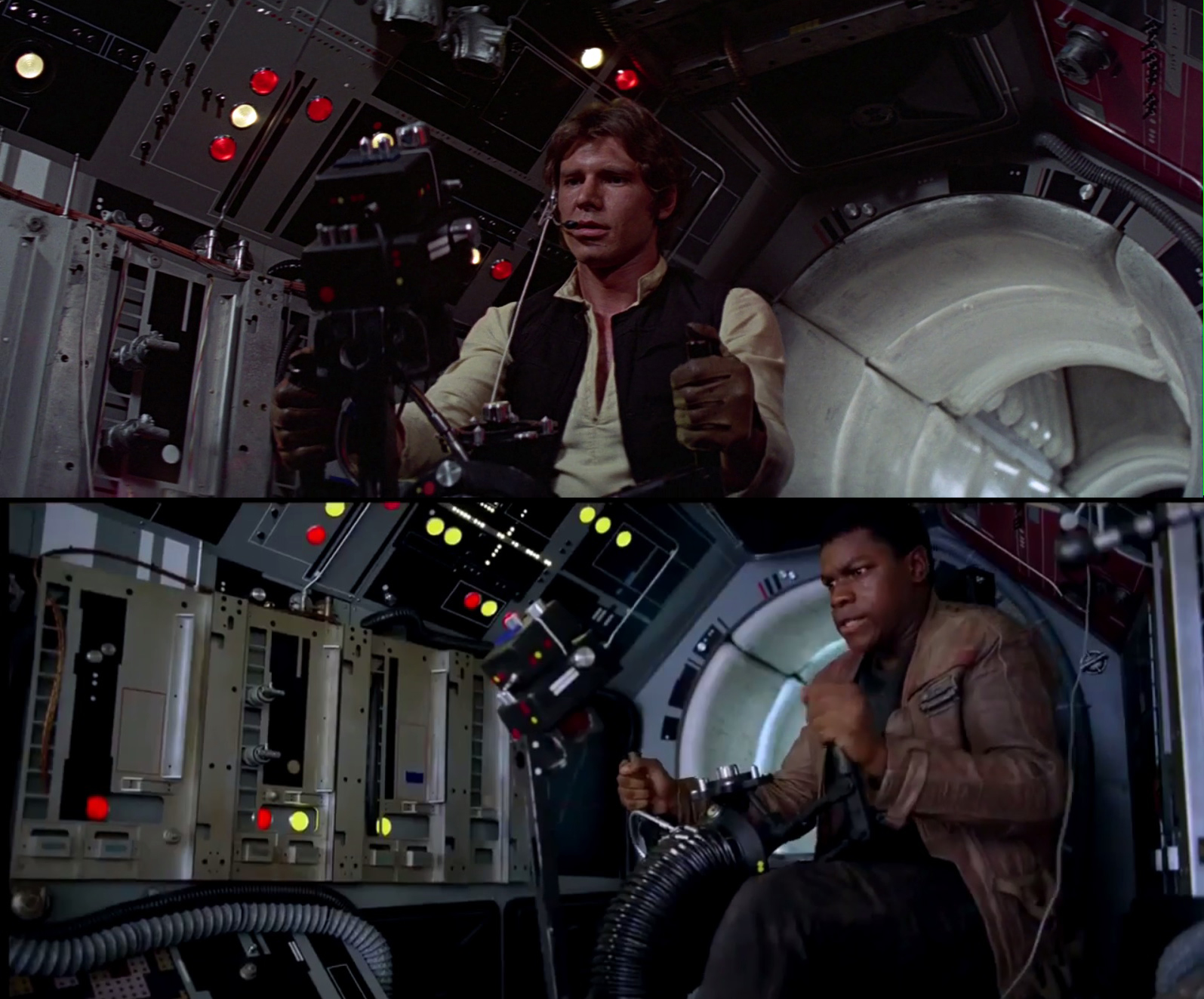

I believe there was a comment re: the EP VII Canister and where it was and what it replaced from the ESB Version. ESB Left - EP VII Right
I have to admit, I had doubts when I first saw this MAJOR change to the cockpit. Now, I LOVE IT! I can't wait to see it lit :)
The nice thing - they are both interchangeable

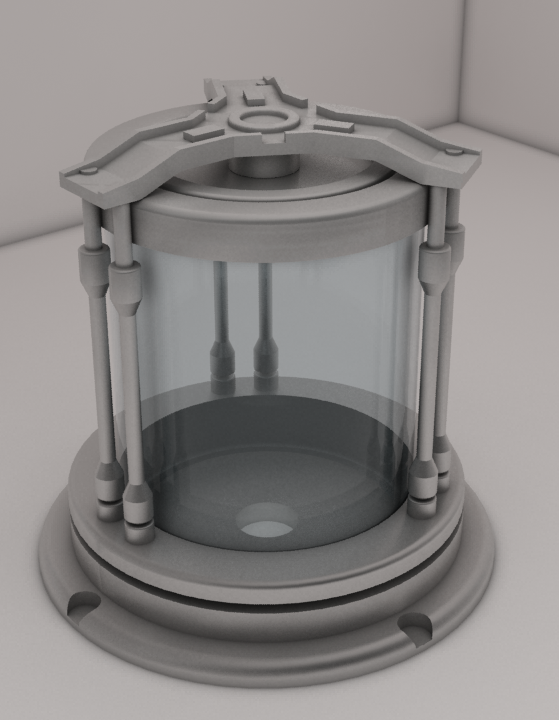

After watching the preview for the disney behind the scene special, I was able to do a quick 3D mockup of the center armrest canister --
I am hoping that this might give you a few ideas for your project and if you want I can send you the 3D file if you think you may need it --
Thanks
Oslm
Hi O,
Thanks for the great 3D image! We've been able to recreate the canister in 3D as well using the few screen shots we have. Once the chaos does down I'm going to recreate the canister with machined parts. We should have more images available the closer we get to the premiere.
Nice! :)

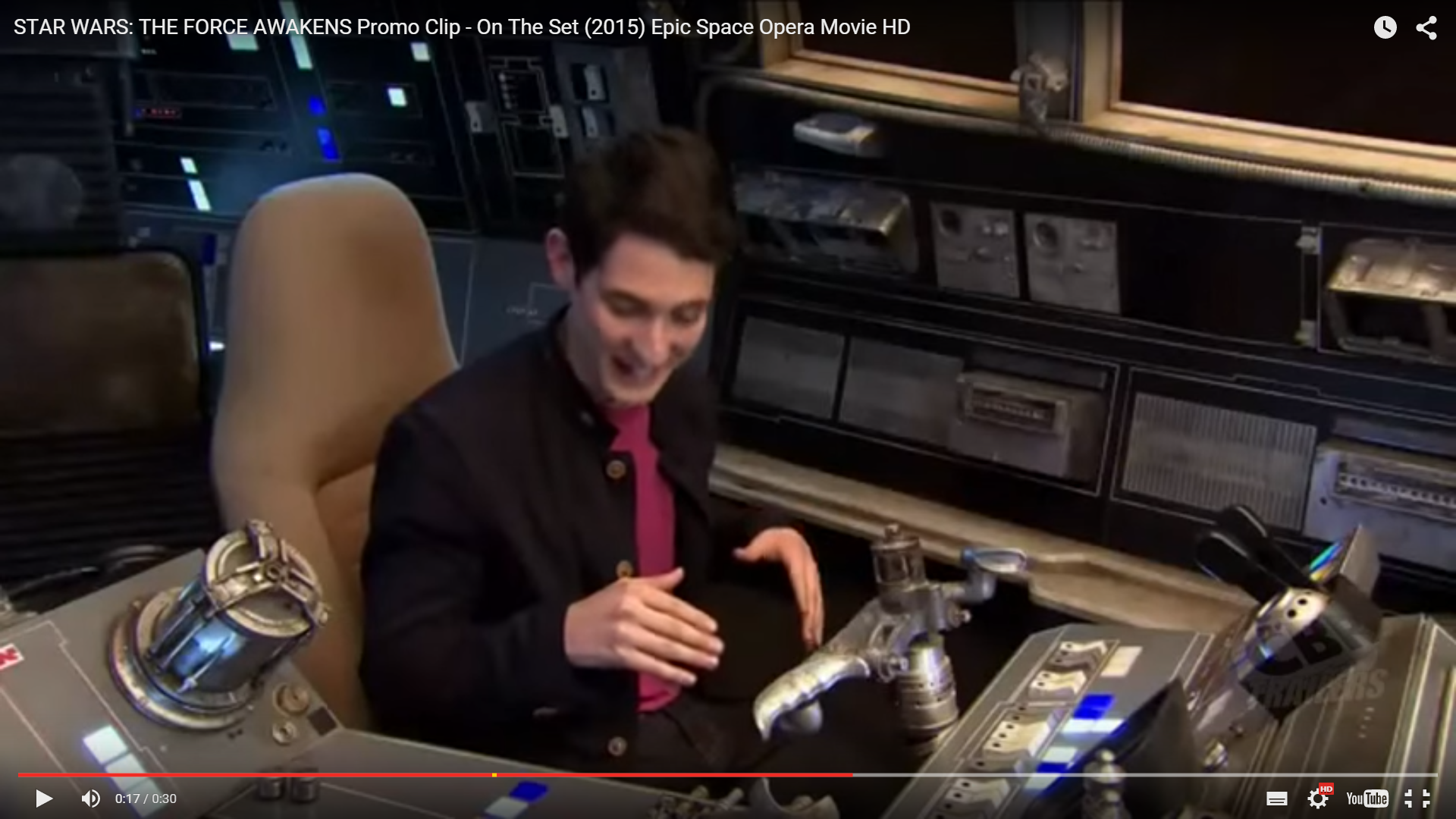

Here, next to the pilot's seat:

Naturally... the moment I'm about to finish the greeblie a clear shot of the dang thing appears. I think they do this to me on purpose! ;)
Great image! Thanks for posting
Hey Greg... is that canister in ESB or is it just an addition that was added for the Ep7 Falcon? If its just the EP7 addition, what does the canister look like in ESB?
Hey Hey
It was an update for EP VII. I love both greeblies. But I think I'm going to leave the EP VII Canister in place for now. :)
