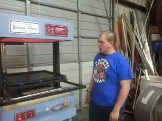

Just got back from the Makers Local where Daniel and I spent a few hours taking the VERY FIRST ABS plastic forms/pulls and created 4 cockpit "access panels" that are mounted to the 15" extension panels. Enjoy!
This is the vacuum forming machine that was built by Daniel and Wayne

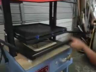

Original MDF buck where the ABS plastic will fit around by vacuum
ABS Plastic is put in place and the heating element is turned on where the ABS is lifted into place
Heating element
When the ABS reaches a certain temp the lever is pulled down where the plastic is laying around the original form. A vacuum is then turned on and the ABS is quickly sucked around the original form.
Daniel explaining the vacuum forming process - the VERY first pull (we had a first vid but it didn't turn out - I'm fixing it)
Another attempt...
4 ABS panels - I LOVE IT!!! Thanks Daniel! You're my hero!
This was out first pull... whoops... left it near the heating element a little too long

I kinda like the first pull... it looks like it got the corners pretty well, and that texture is pretty neat!
Hey Y,
The first pull is interesting... the vacuum was perfect only because the ABS was so hot to the point boiling! It literally just melted into placed. We might try to salvage the pull...
