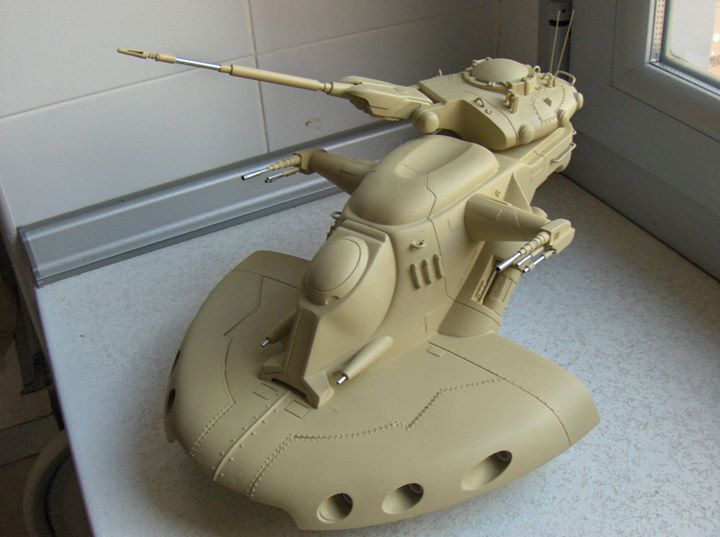

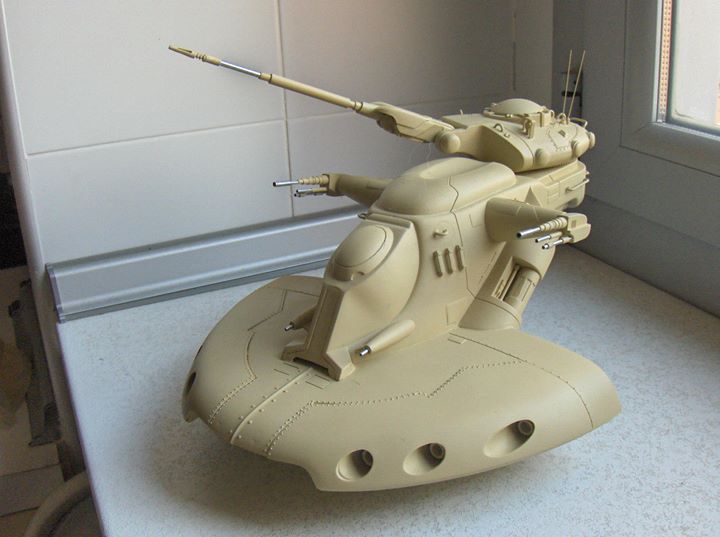

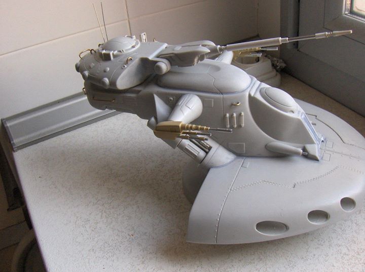

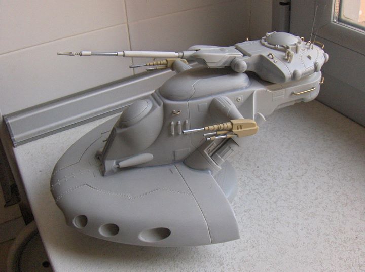

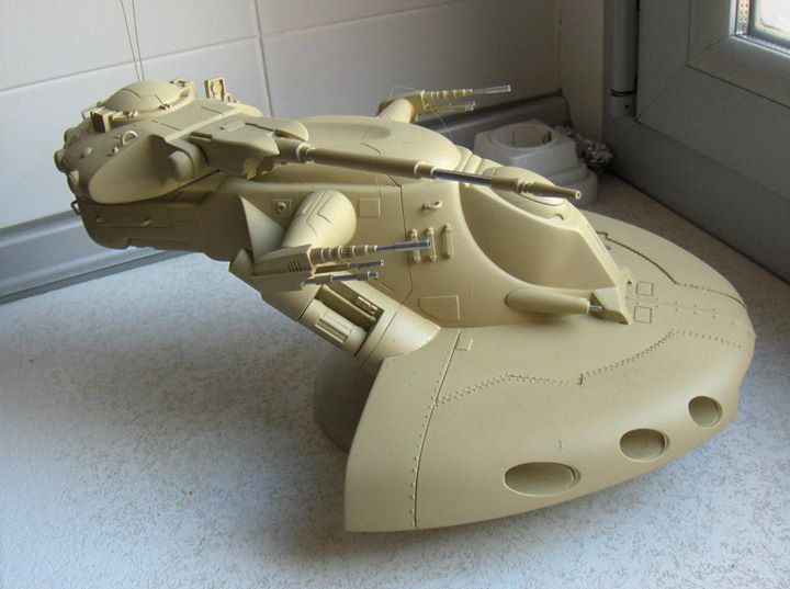

Hi guys, we would like to share with you our last project, a Trade Federation Tank,

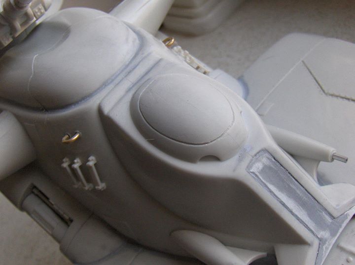

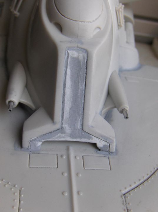

Just mention a little bit of the process. This raw model had just the appropiate size to be painted. We've fixed all the panels with a model cutter just to give the final product a better look.
Once assembled, the turret and cannon's gun should spin around a shaft and the cannons move up and down either. Even though it may seem hard to believe, the main body consists of two joined parts, so the filler was necessary to hide the junctions.

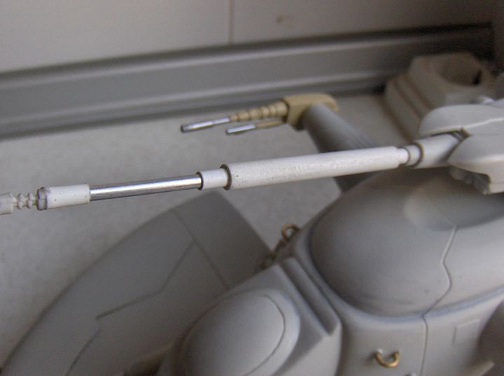

The central cannon was initially pretty nice, but it came in two pieces, then it was better to replace every piece by some plastic and iron tubes. All grips were also replaced by stronger moulded metal tubes.
We used a sand colour as a first paint layer, definitely better for red and ochre tones. Now it seems to be ready to paint!!
We are still on it, so we'd appreciate any contributions

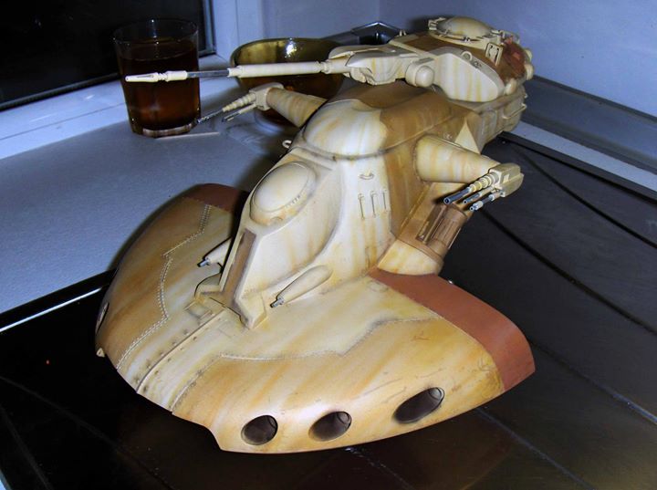

After a long weekend, here we have the model update. Camouflage colours painted and arranged, mixing three tones in very different proportions.
We've used oil painting with oxid-kind traces on it. This is our first time working with oil, but not the last one, cause it allows a great detail control and excellent results. We tried not to abuse oxid and dirt details, giving it a well-adjusted look.
Feel free to give us advice!!!
I love that look. That's how tanks should look. i don't care how fancy the tech is a tank is going to rust, especially on a planet like the one Jarjar is on. Seriously couldn't have the death star blown that up before jarjar could reproduce?
Hahaha, we love your question about JaJar and the capability of the death star to avoid anything about JarJar. ;)
And thank you very much for your kind words, in our next pictures you will see we have reduced the rust level, but we have deployed it all over the model. We will post new pictures ASAP. We have to admit that this is the first time we have used oleos for painting and we will use them again.

FINAL UPDATE
Finally we've finished our ATT!!
It seems that the paintbrush strokes have given excellent results. We've slightly darkened the tones of the fuselage, added subtle rust marks and uneven damage brush strokes.
Adding artificial grass and dirt to its belly proved to be a strenuous job. The AAT is supposed to float but, considering that Jar Jar hung from its turret, it must have touched the ground.
We hope it meets your expectations :) Thanx a lot for your advice!!!
