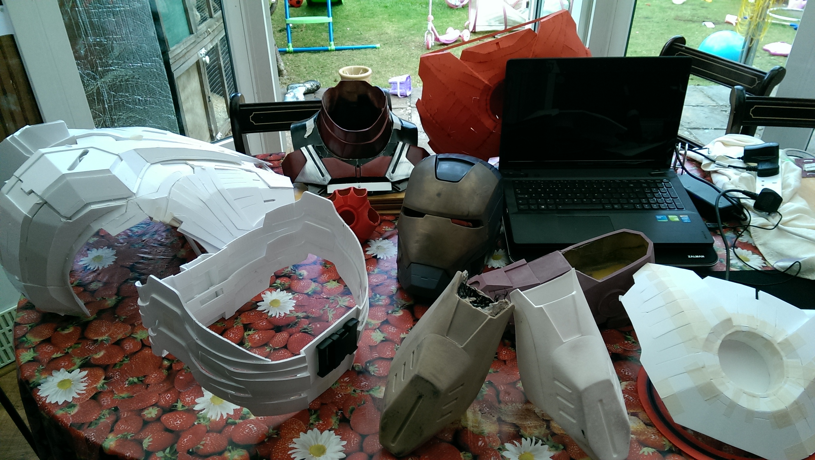

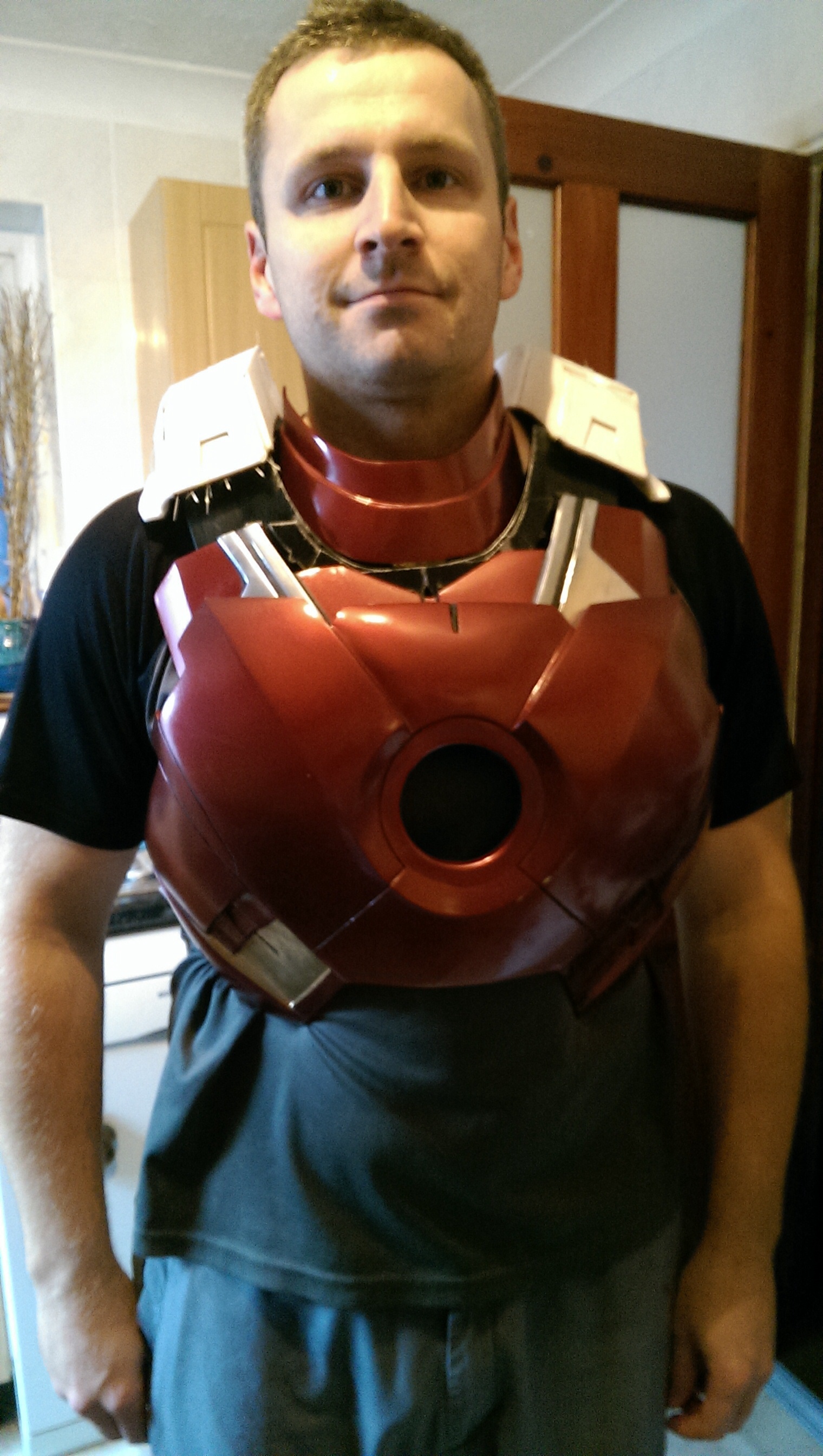

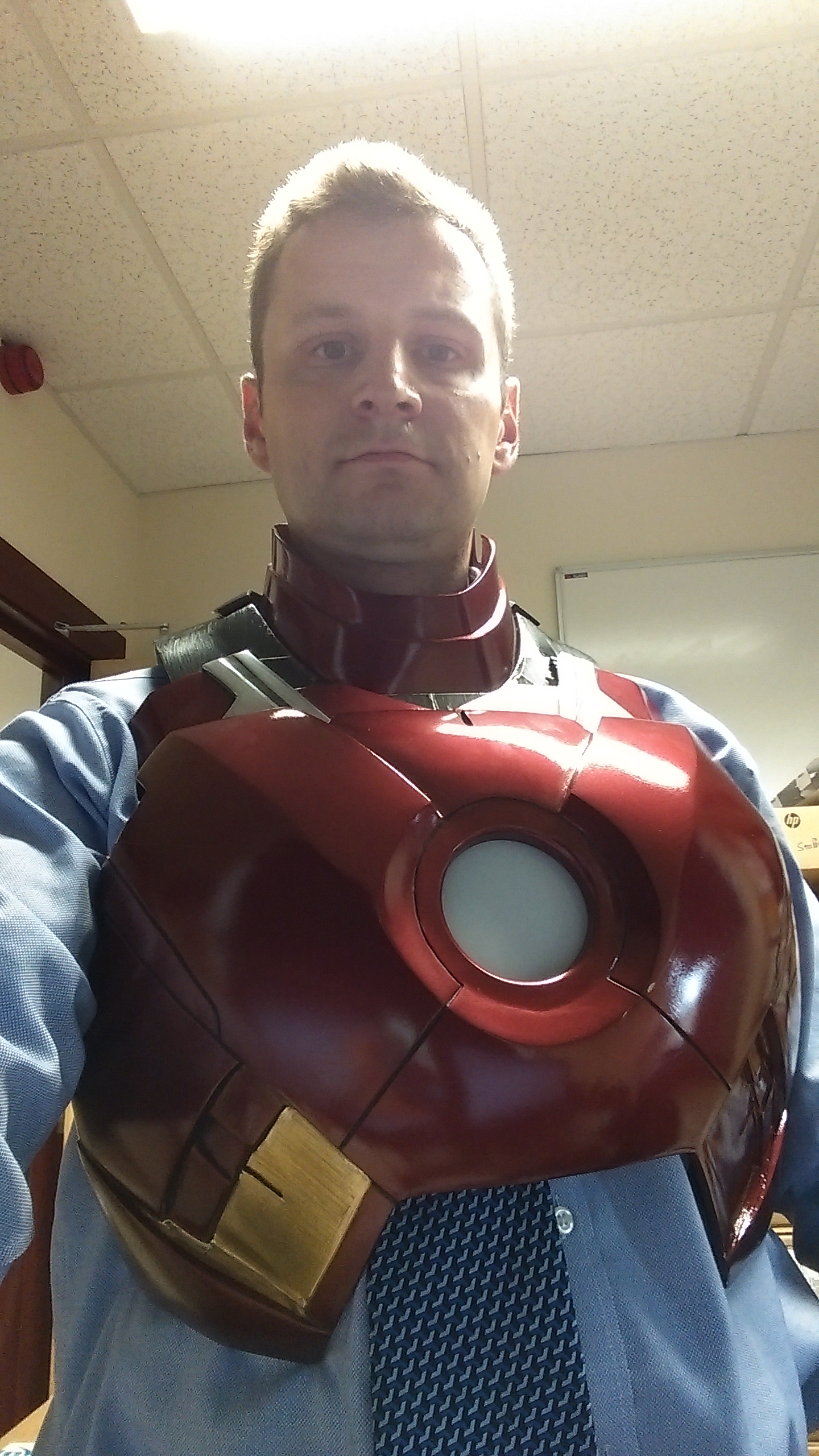

I was lucky enough to get JayCVenlo's awesome neck and chest pieces. That should save me about six months of build time!

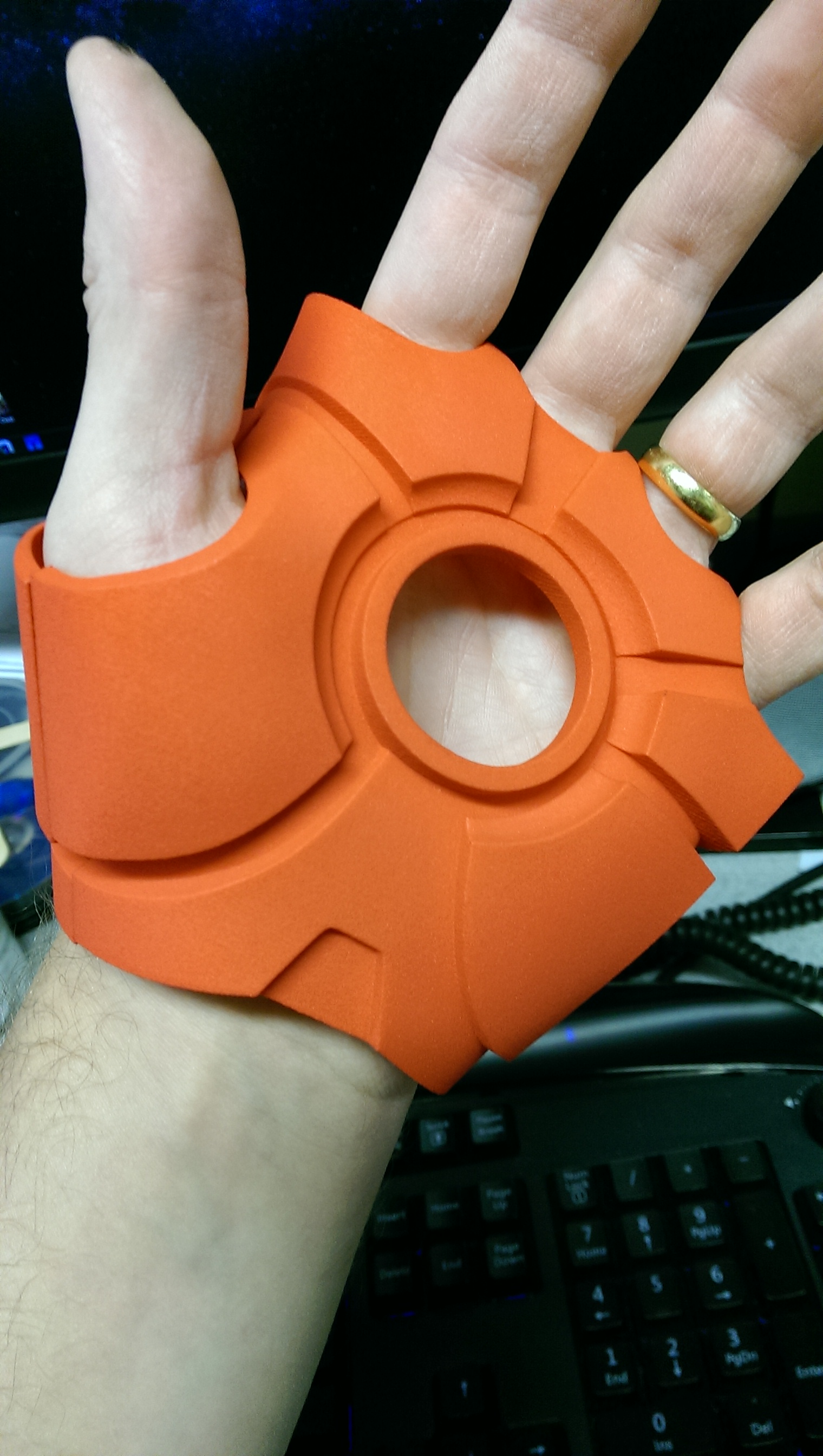

Finally got my left hand from Shapeways (They originally sent me two rights).

So with the recent arrival of my 3D printed boot, I've got a weekend of fibreglass reinforcement ahead of me :)

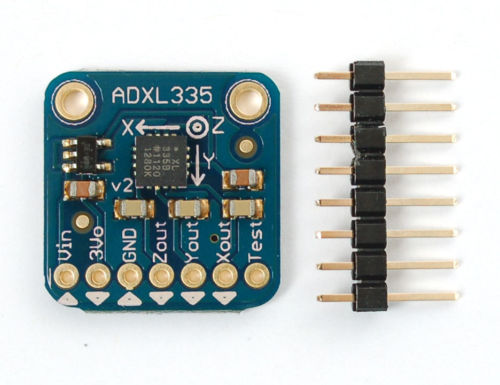

Have had a last minute change of plans, so now have to get all the key electronics together in a hurry.
I've just ordered a few bits;
I'll hopefully get the Adafruit Triple 3-Axis Accelerometer ADXL335 talking to the Arduino Pro Mini to control both the HS-125MG servo (which fits in TheRealTonyStark's Shapeways servo mechanism) and the eye LEDs. If I can also rig it to power down my Vuzix Wrap 920 video goggles and connected camera when not needed, that would also be nice.

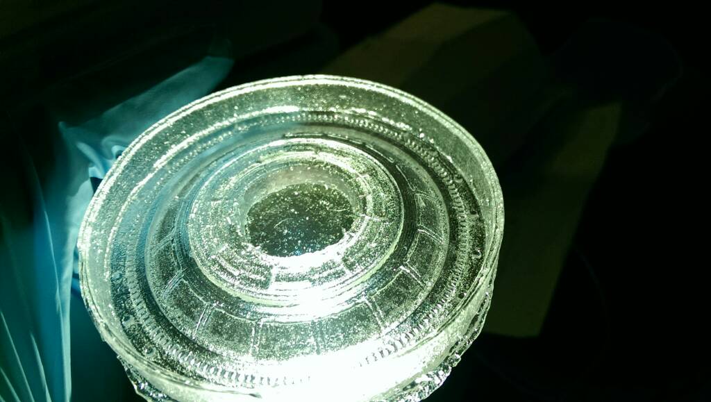

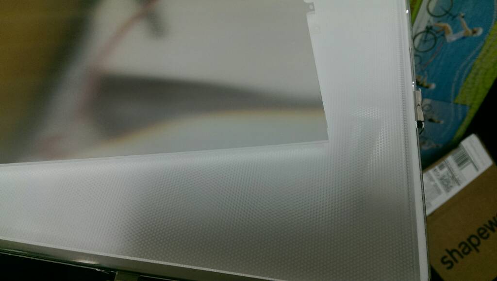

My diffusers just arrived. They measure 64*24mm so should fill the eye holes quite easily. I plan to soften them in hot water and shape them by hand.

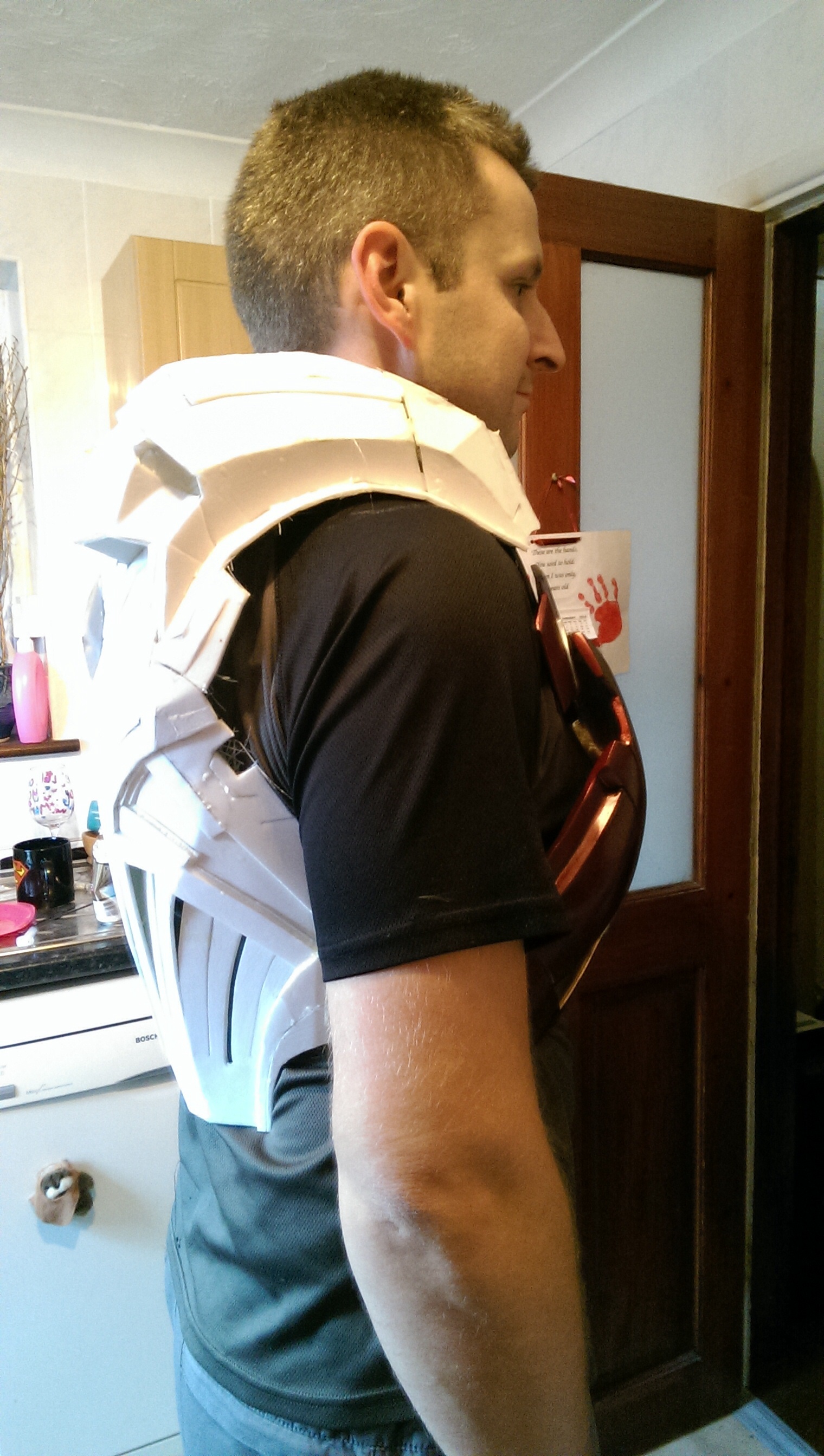

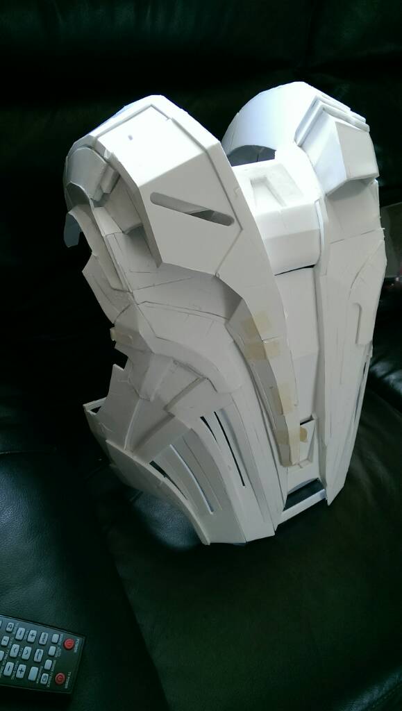

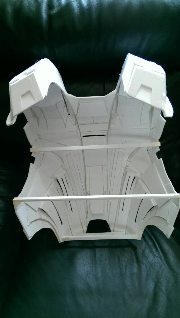

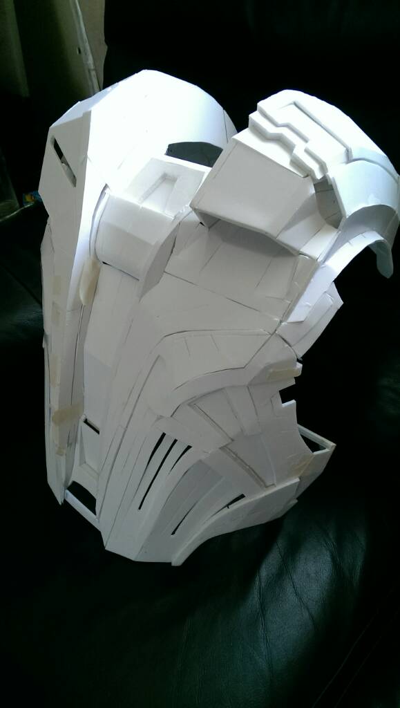

Back is pepped. Just need to fit the flaps, then get a wiggle on with the rest of the suit.
uploadfromtaptalk1402158408676.jpguploadfromtaptalk1402158408676.jpguploadfromtaptalk1402158408676.jpg

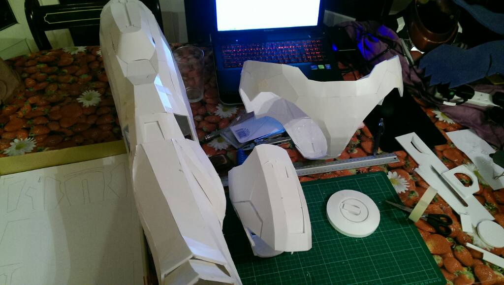

Started working on the abs yesterday. They're a really tight fit, so I'd best avoid food for the next month if I want to be comfy in the suit. Once they're done, then it's on to the thighs, as I'm pretty worried about how they'll fit.

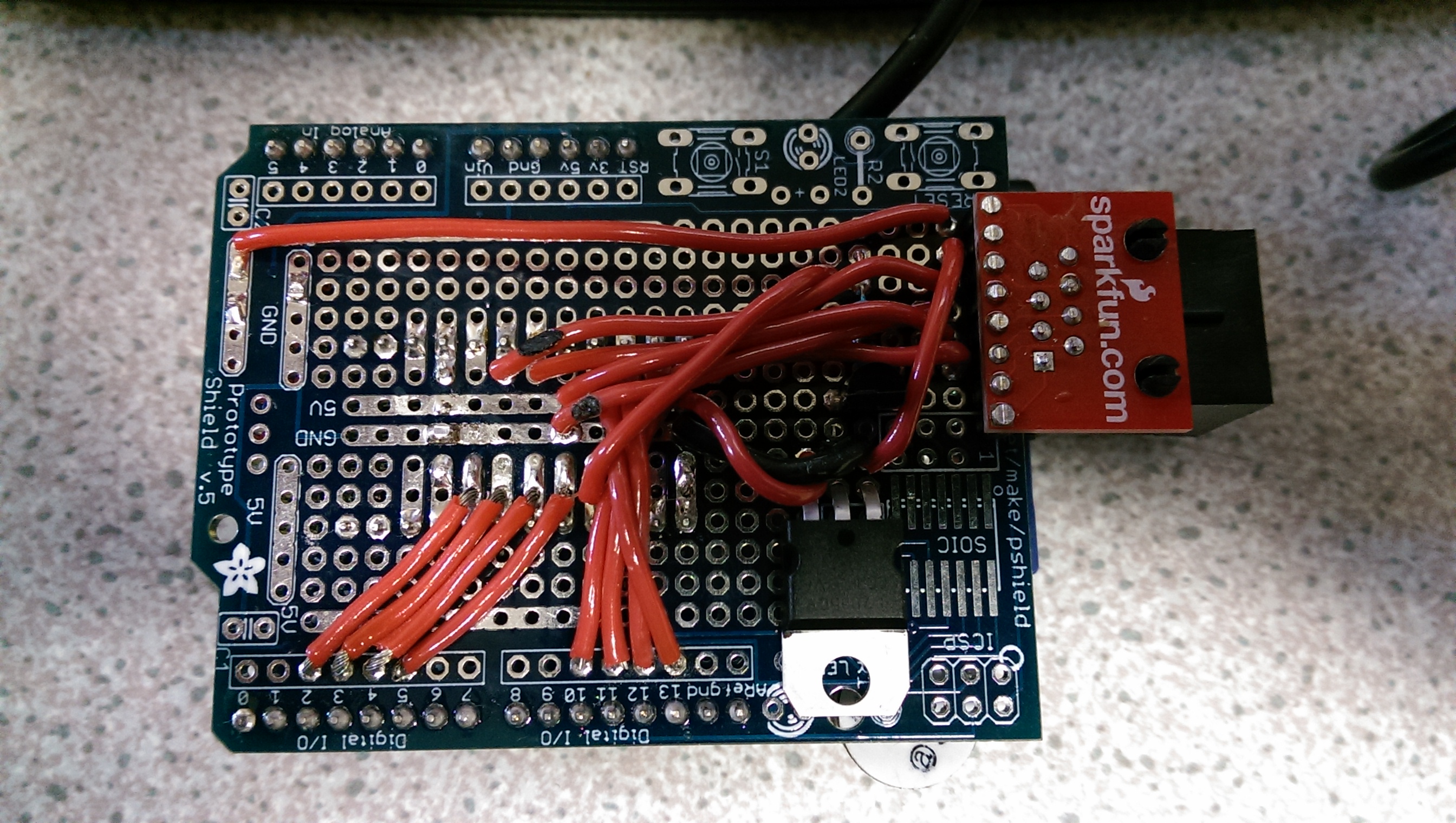

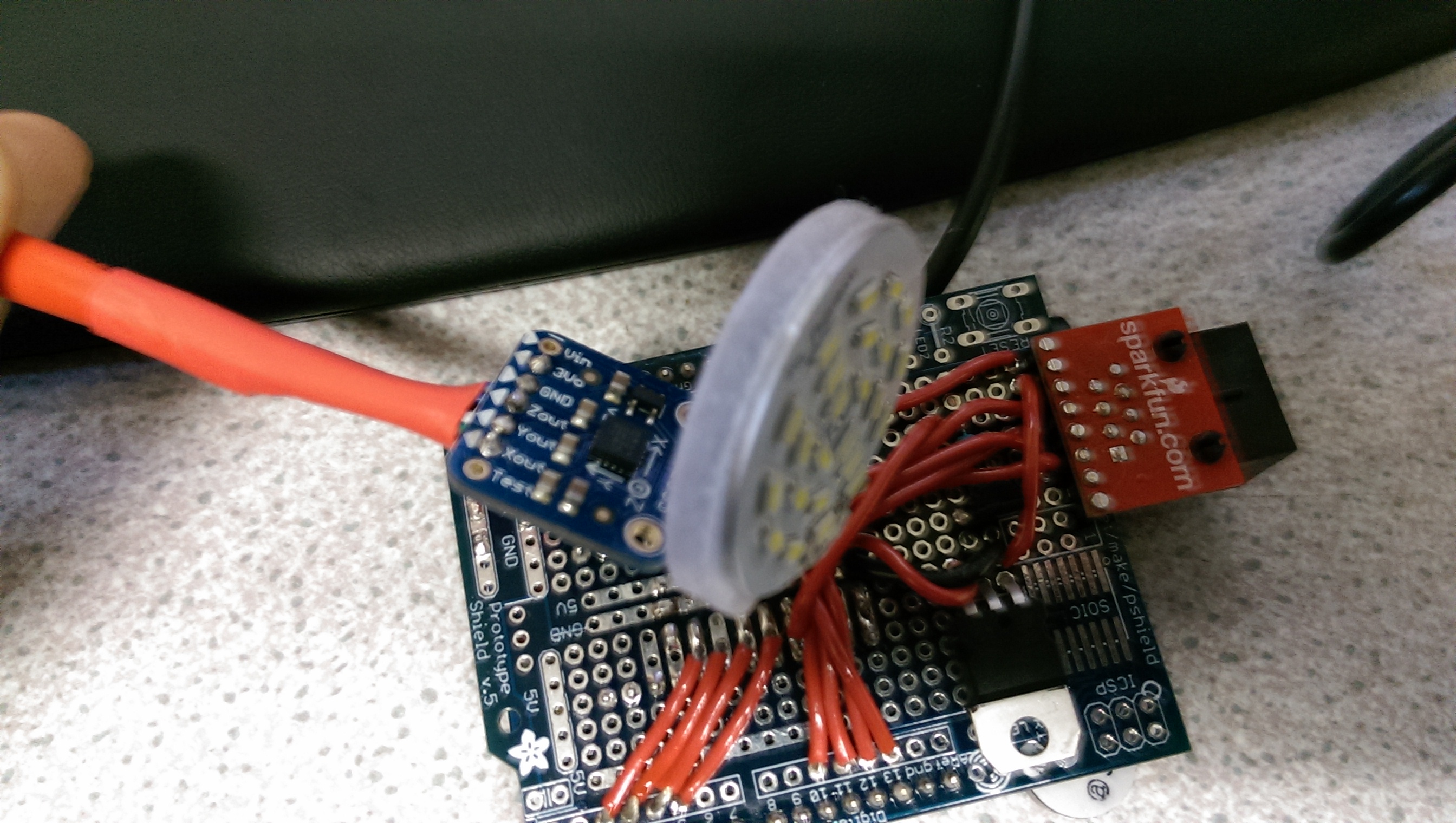

My first repulsor is done;
Here's a video of it in action; https://www.youtube.com/watch?v=0JBd5OvG8uA
And in case it's of any use to anyone, here's the code;

Re: Roomiest Iron Man
Finally making progress with the build. One leg is complete, the Cod is done, one bicep is mostly done (awaiting elbow) and I just did a hip pod, which I'm quite pleased with.
Am definitely getting faster with the foamboard, but with three weeks left, I'm getting pretty worried.
Also, although the Cod fits, I can't pull it over my bottom. If I cut one side, I can get in it , and feel quite comfy, but I have no idea how to accomplish that once it's fibreglassed and ridgid. Has anyone experienced similar problems with the Cod and found a solution?
Sent from my HTC One using Tapatalk
Stripped down an old tft to nab the diffuser.
Initial testing is pretty good. Will post pics once I''ve figured it out.
