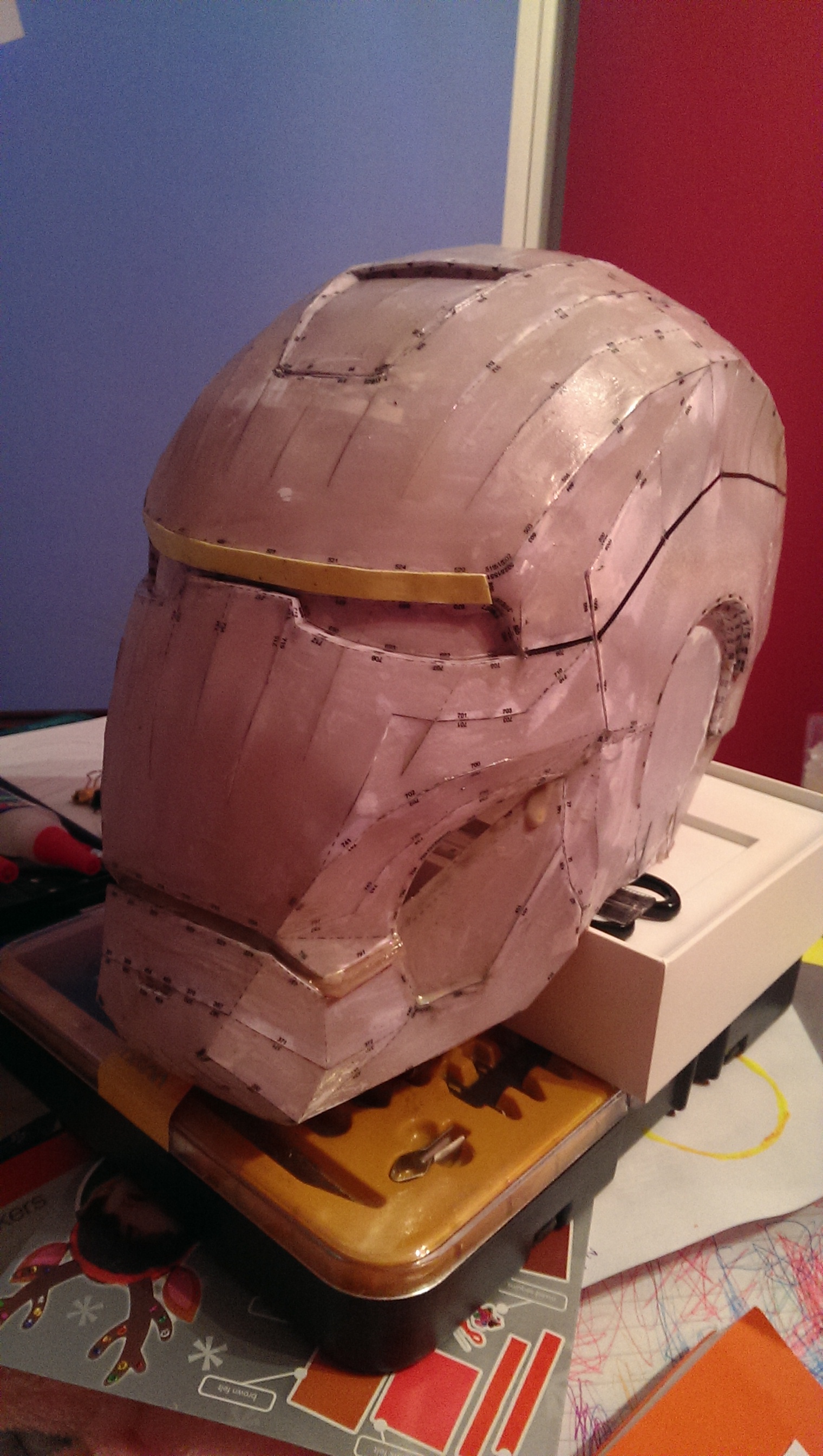

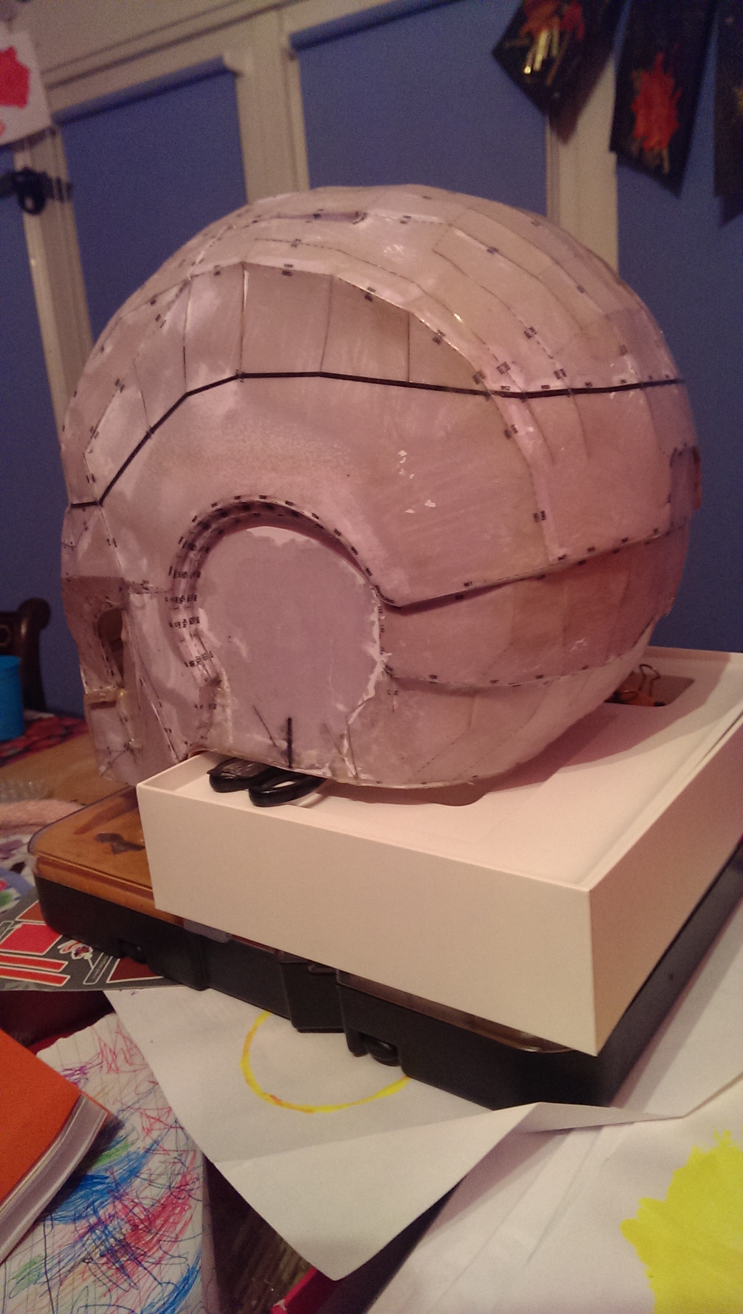

I made up some plates in the shape of the ear sections, and sandwiched a couple of layers of fibre glass between these. Once they were set, I clamped the helmet down on a flat surface, glues on some bamboo skewers, and pulled the helmet into the right shape. One I was happy, I did the outer resin coat, and a quick rondo inner slush, and voila;
It's still not 100% square, but it's as close as I can get. Most importantly, the internal measurements all look good, so this should fit. I'll reinforce it with fibre glass and some carbon fibre over the next couple of days, and then crack on with smoothing the thing out. I'm eager to try it on, but don't want to crack the thing open before bondo.

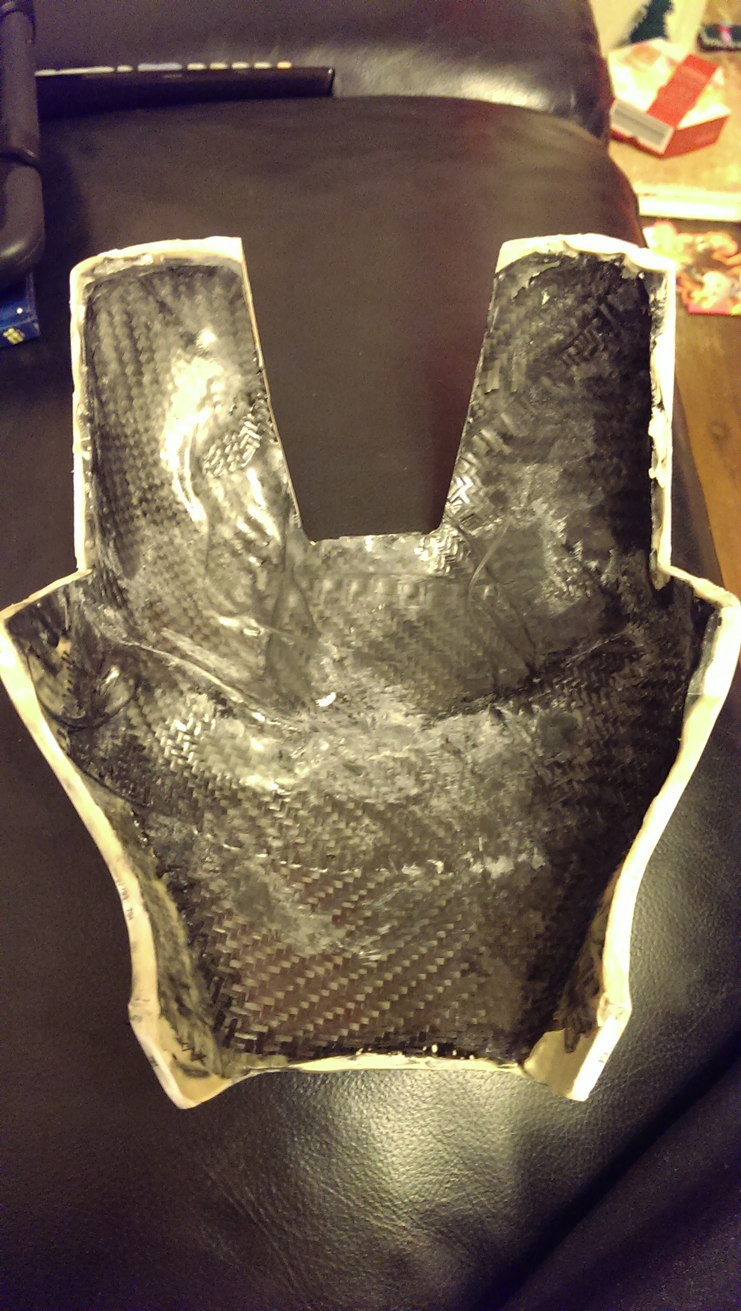

Started strengthening the helmet this evening. It's not pretty, but I plan to add a neater layer once it's cut into pieces:
Hopefully I can start applying bondo over this weekend.

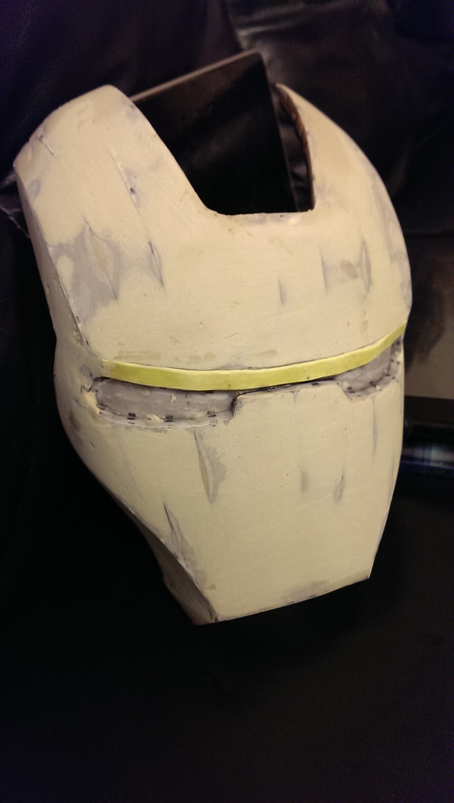

Cut the faceplate out, and applied the first Bondo layer - I can't believe the difference it made :)
I'll tidy up the inside, before applying one more layer of carbon.

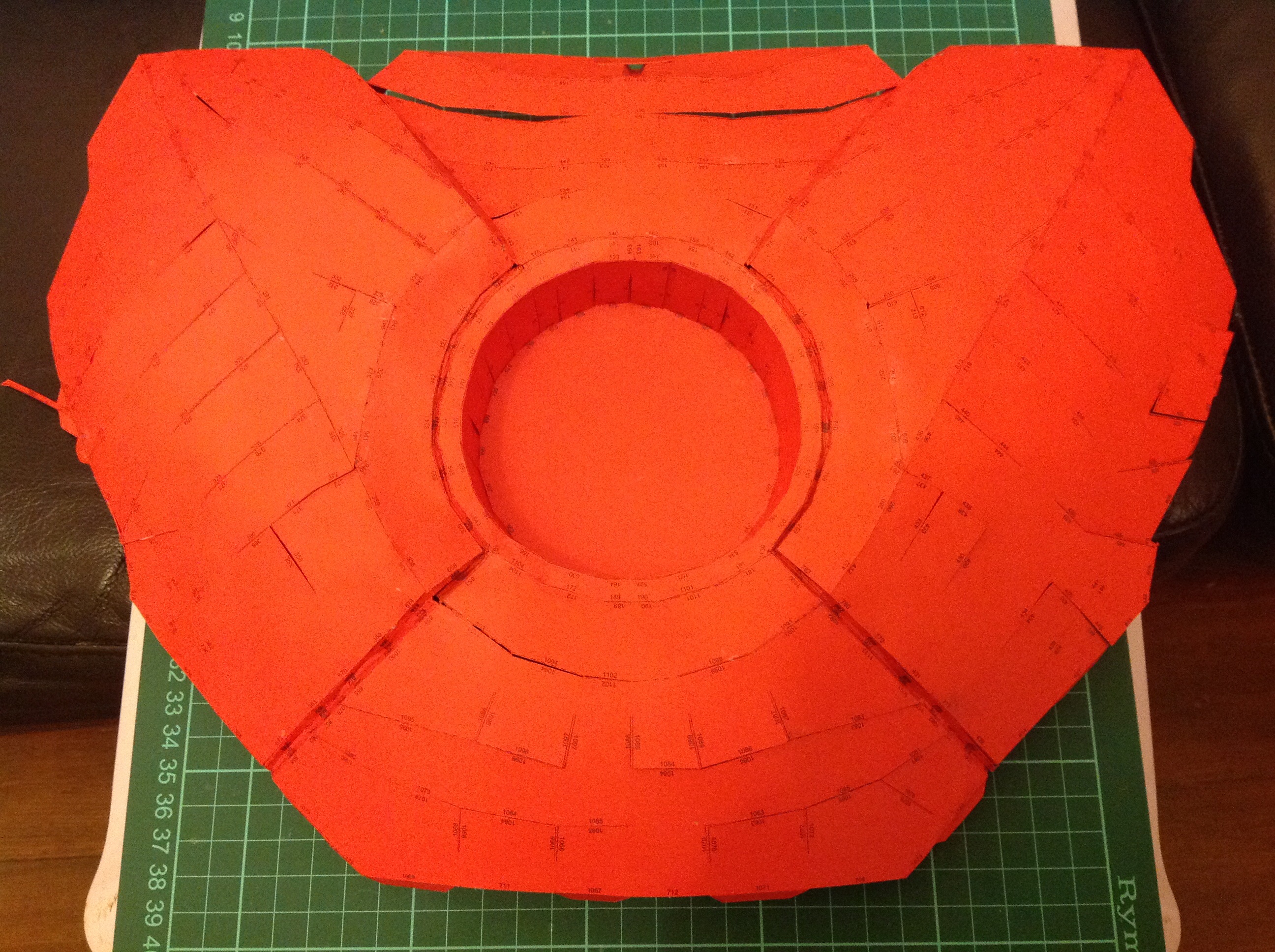

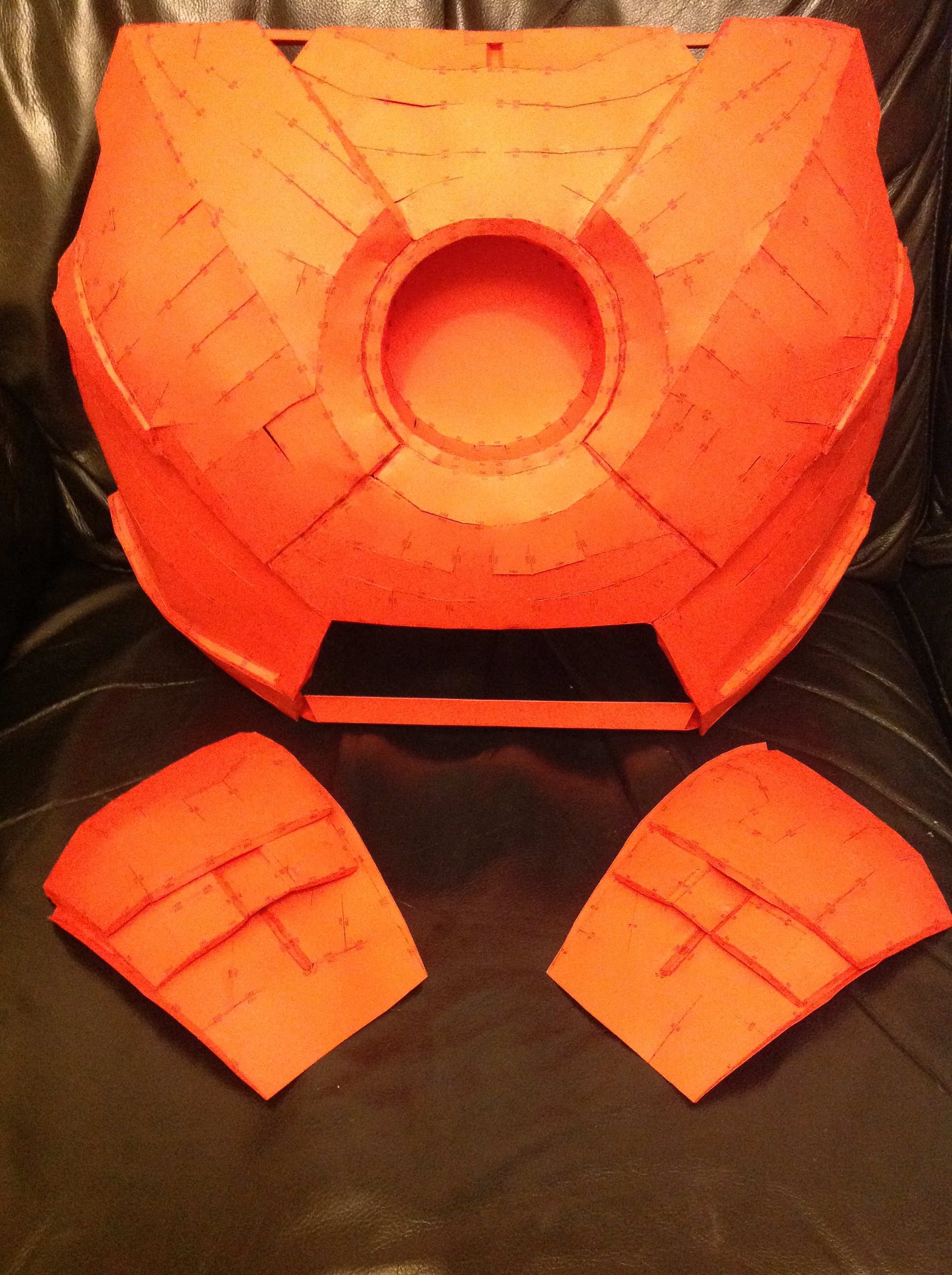

Well the chest is coming along slowly, and the back is printed and cut (thank the lords of Kobol for my Cameo).

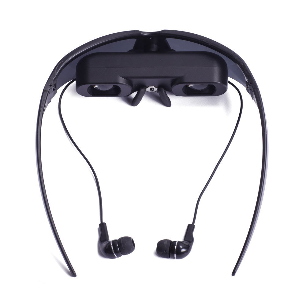

I've ordered a cheap set of video glasses and a car reversing camera to solve the visibility issues of the helmet (Even with empty eye sockets, I can only see directly in front of me, and am likely to step on children). If this method works ok, whilst still allowing the faceplate to lift, I'll look into upgrading to a higher resolution setup.

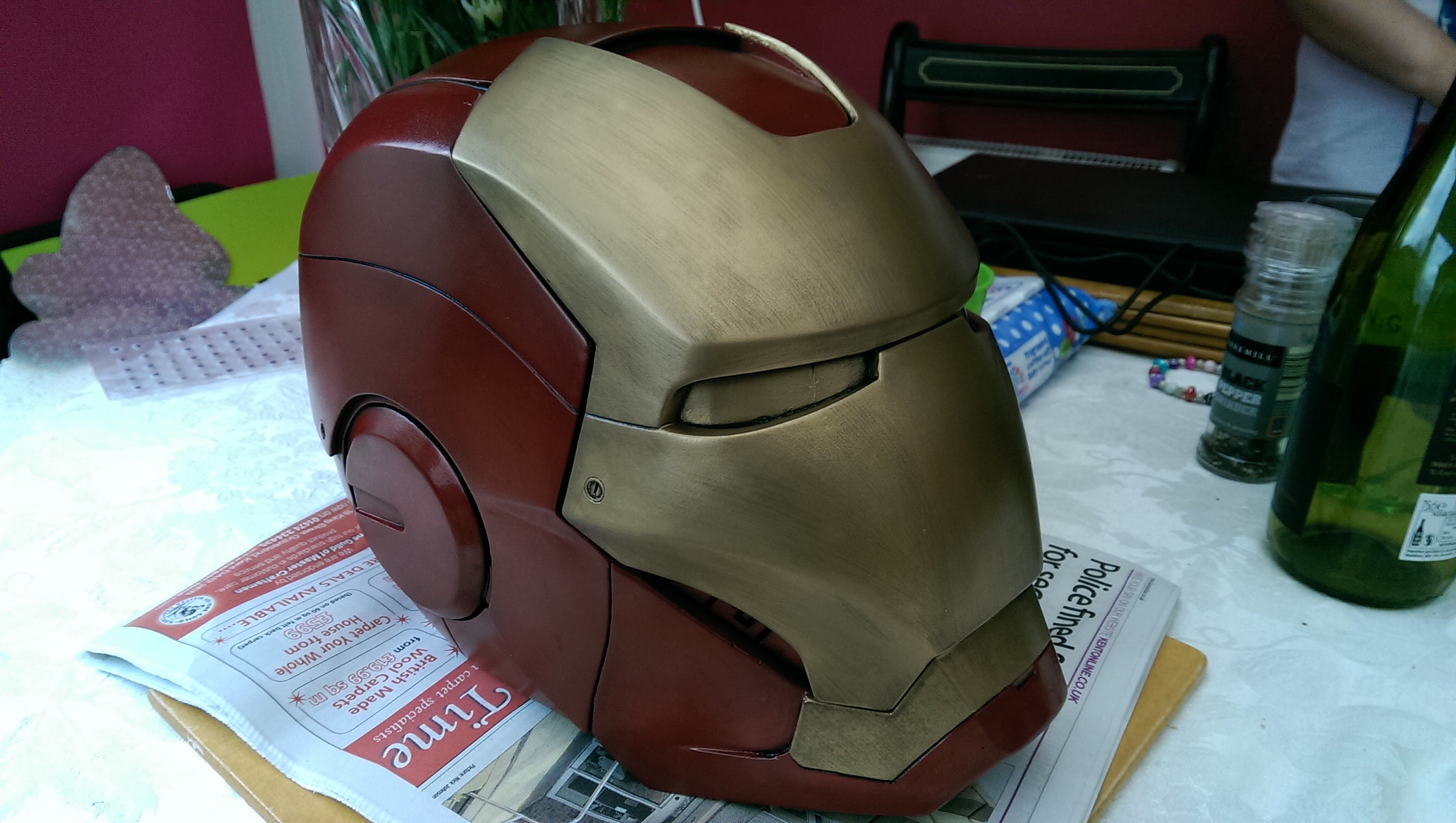

Did a test paint and weather. Quite happy with the red (Fiat Racing Red), and the gold isn't terrible. Will try a few more gold paints.
