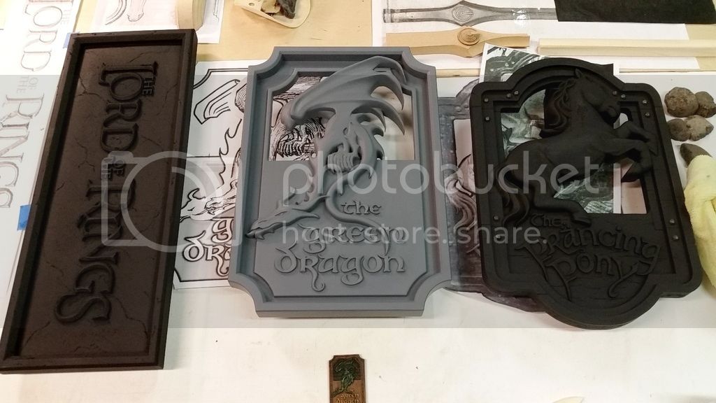

This is beautiful. I love hand-carved signs. Very nice work so far, is there a build thread??
Thank you! Thread is here http://www.therpf.com/showthread.php?t=268468 Here is what I've completed so far. They are just the masters and still need to be molded and cast.

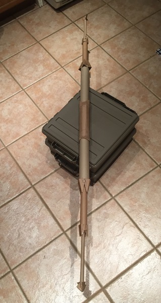

So I guess someone has to be mickey mouse in comparison. Might as well step up. The latest step with the Predator spear.

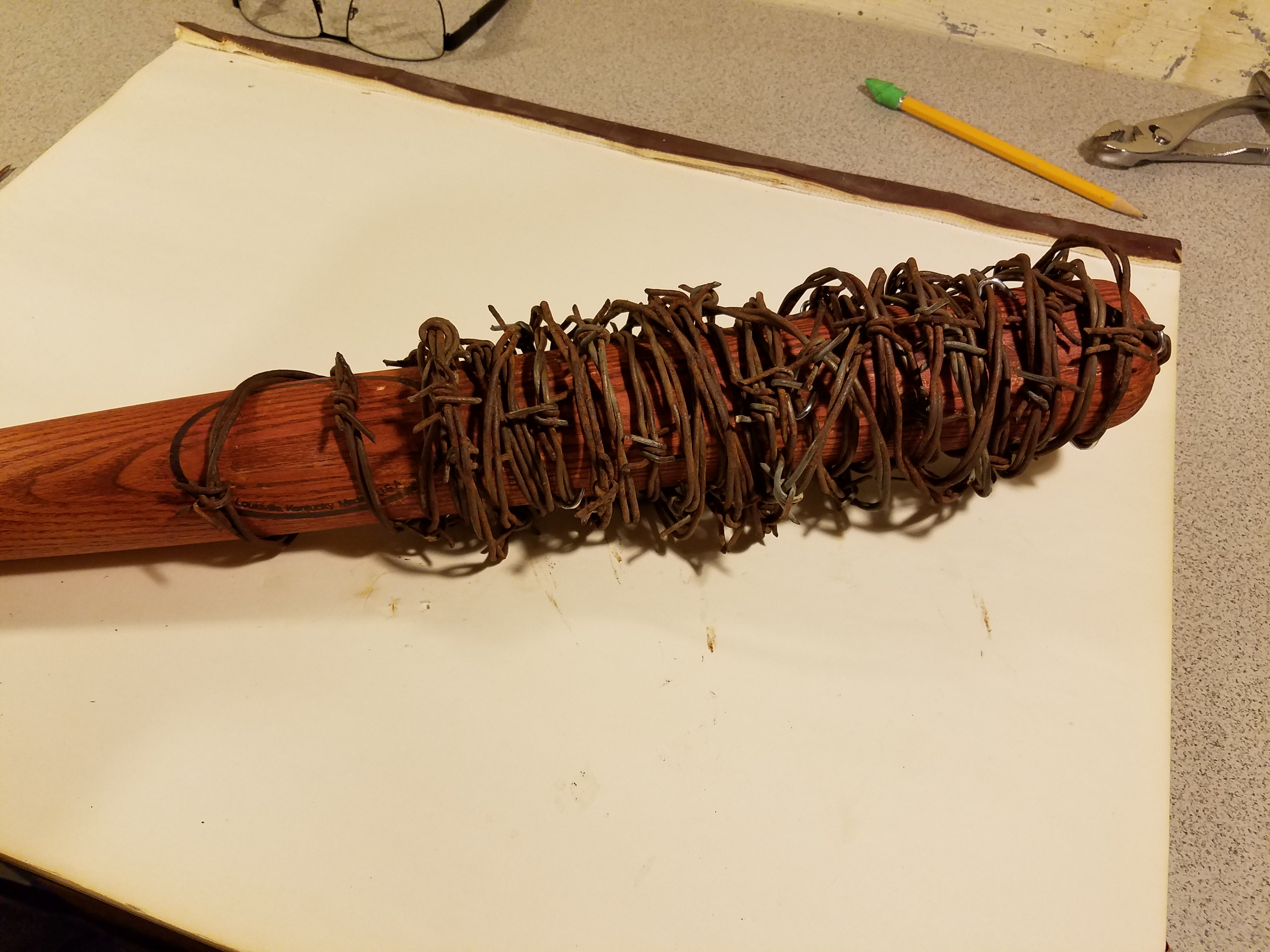

Finished just in time for Sunday night premier. Real Louisville slugger with 25 feet of real barb wire wrapping.

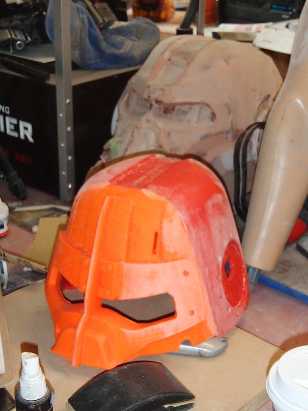

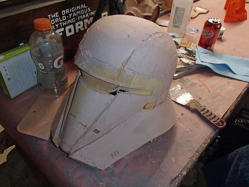

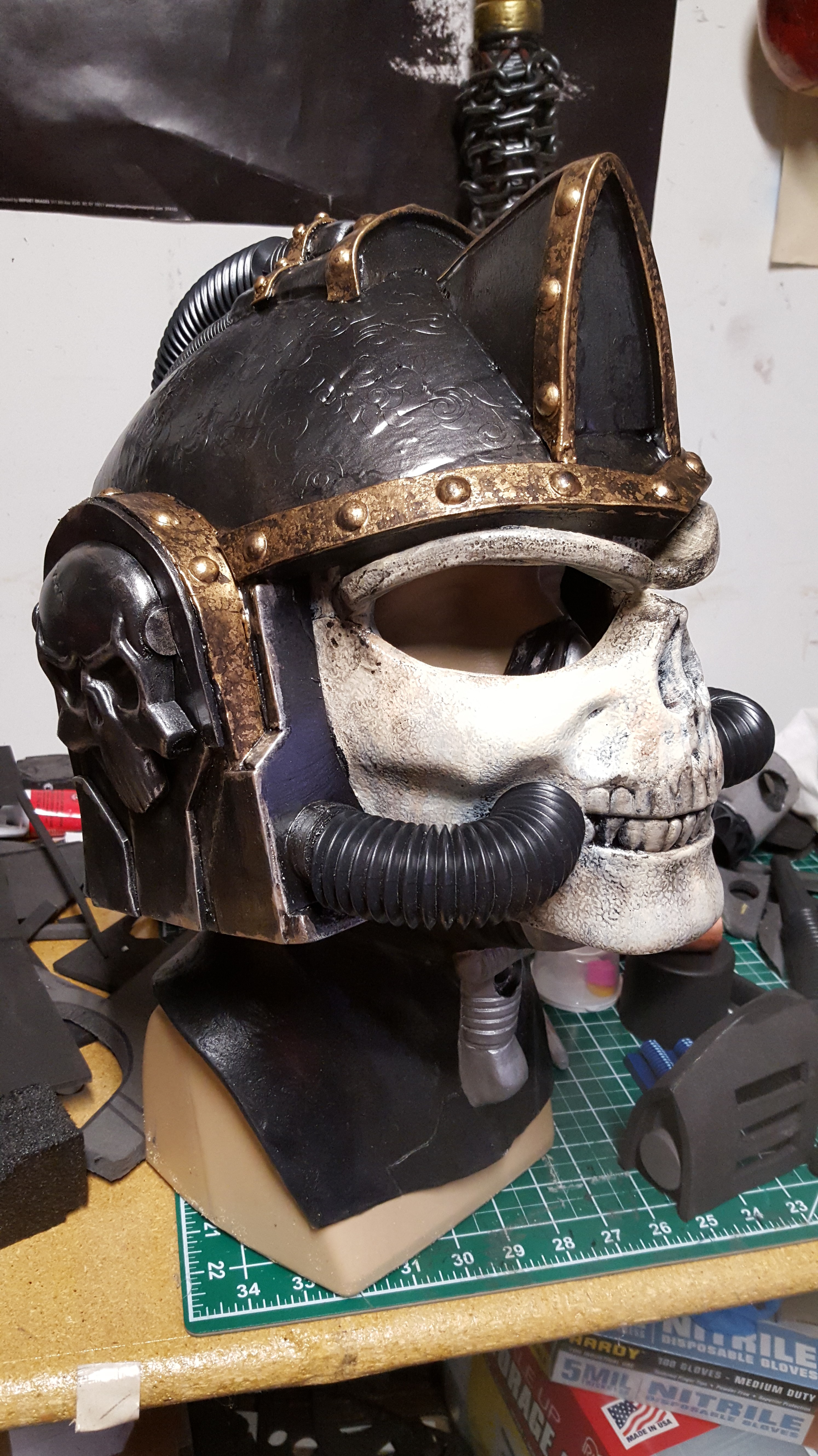

Just some finishing touches on my Star Lord helmet until it's complete. Unfortunately it seems it is a bit too small for my head! (I think I'm a 23)

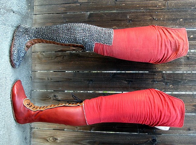

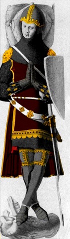

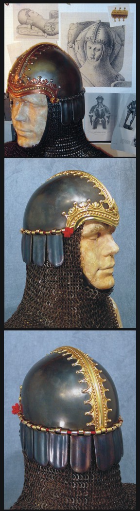

This is a little off topic for the RPF, but given I have made (and worn) armour for films, perhaps not so much. This is one of my current projects.
A recreation of a 1330's European armour, based on reference from brass monuments & effigies of the period.
All elements are "real", as in; spring steel, leather, linen... Note: about this time in history armourers where producing hardened steel armour. By the 1350's, virtually all quality armour was hardened steel and against popular myth, under normal circumstances, arrows and crossbows could not penetrate it.
Composite effigy
Helmets: (left) The under- "helmet", and (right) the Over- "helm" (known as a sugarloaf)
Legs- (left) Under structure- tailored mail, leather boot, linen upper (cuisse) all hand sewn, & (right) finished legs. (Gold trim is leather)

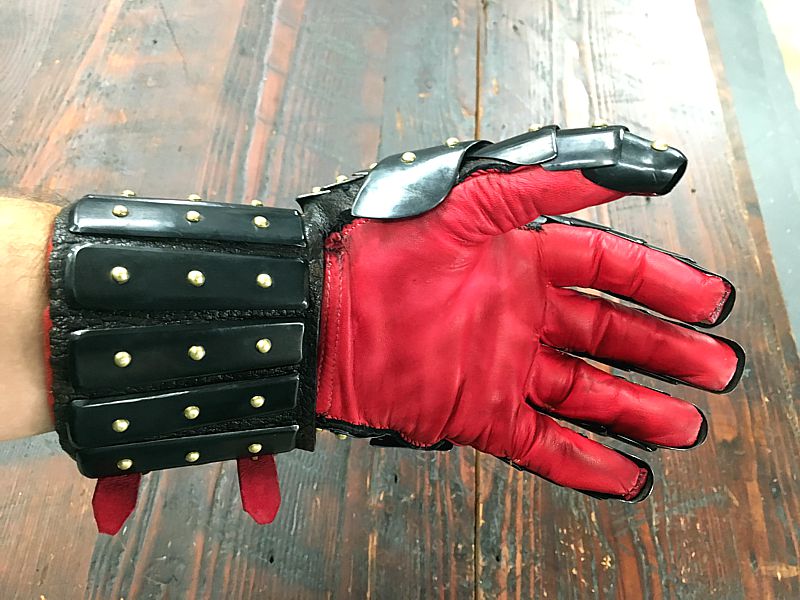

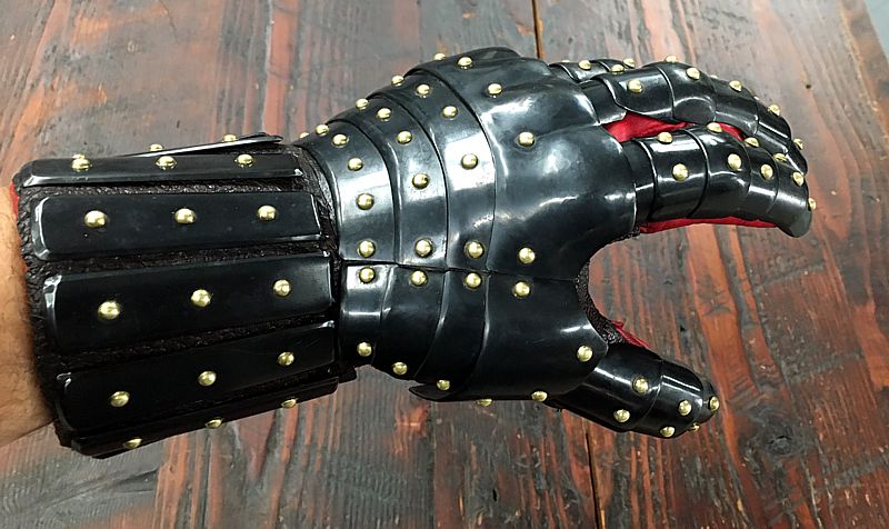

Gauntlets- Heat treated medium carbon steel. Again, against popular myth, gauntlets were not held on by a series of leather loops over the fingers. They had a leather for fabric glove sewn into them and functioned as a complete unit.

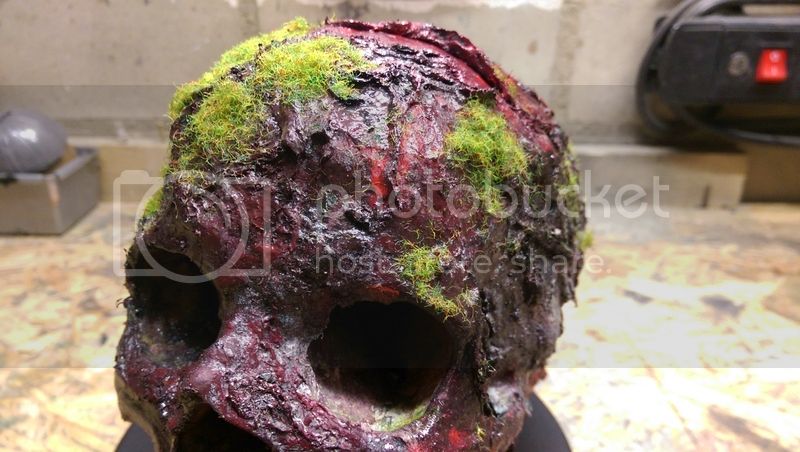

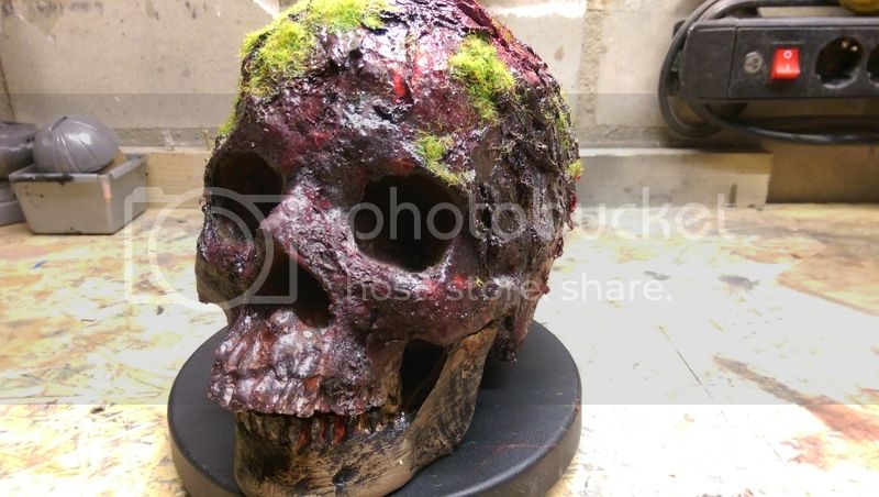

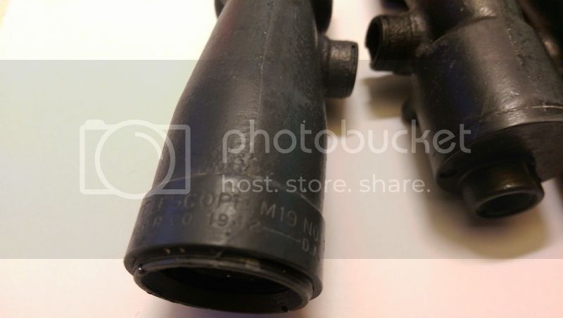

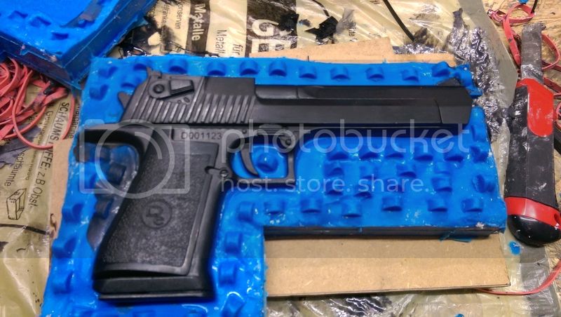

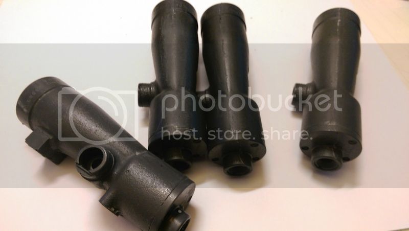

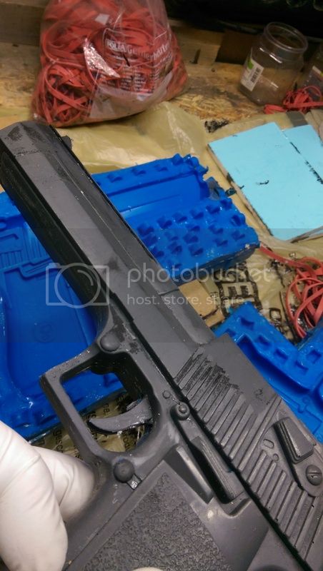

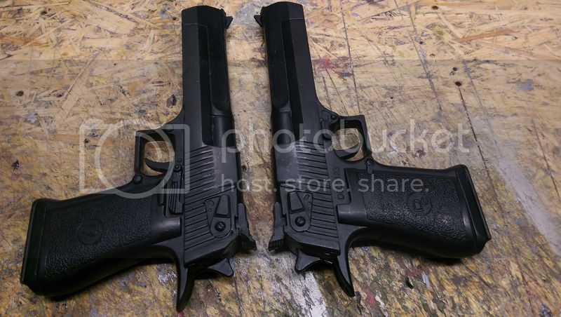

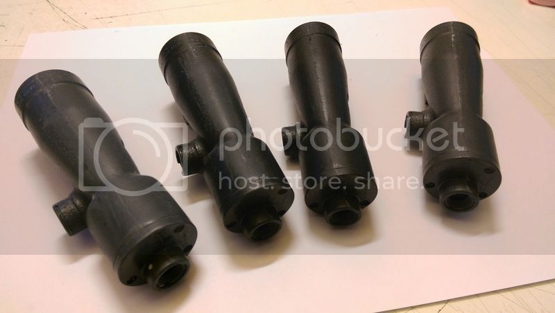

here are my new Props
Skulls , Rubber Desert Eagle and Rubber M19 Skopes :D
Skulls ... check my Threat !

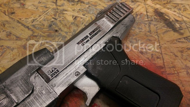

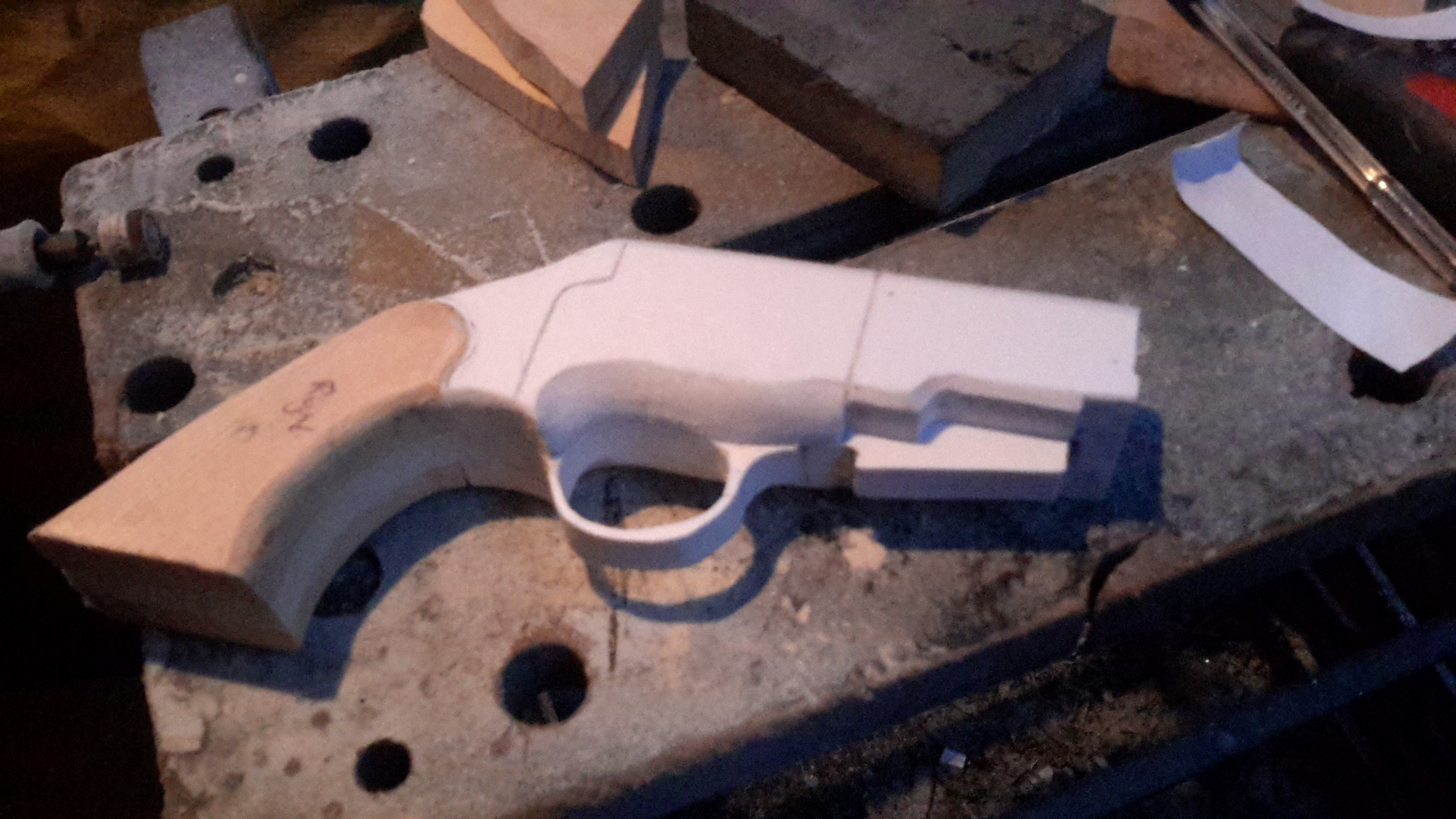

Currently working on this Firefly pistol following the video tutorial by Punished Props and chance to havework featured in a video. Hopefully I'll get it finished in time :D Making it from PVC foam, styrene, wood and 3D printed parts.
