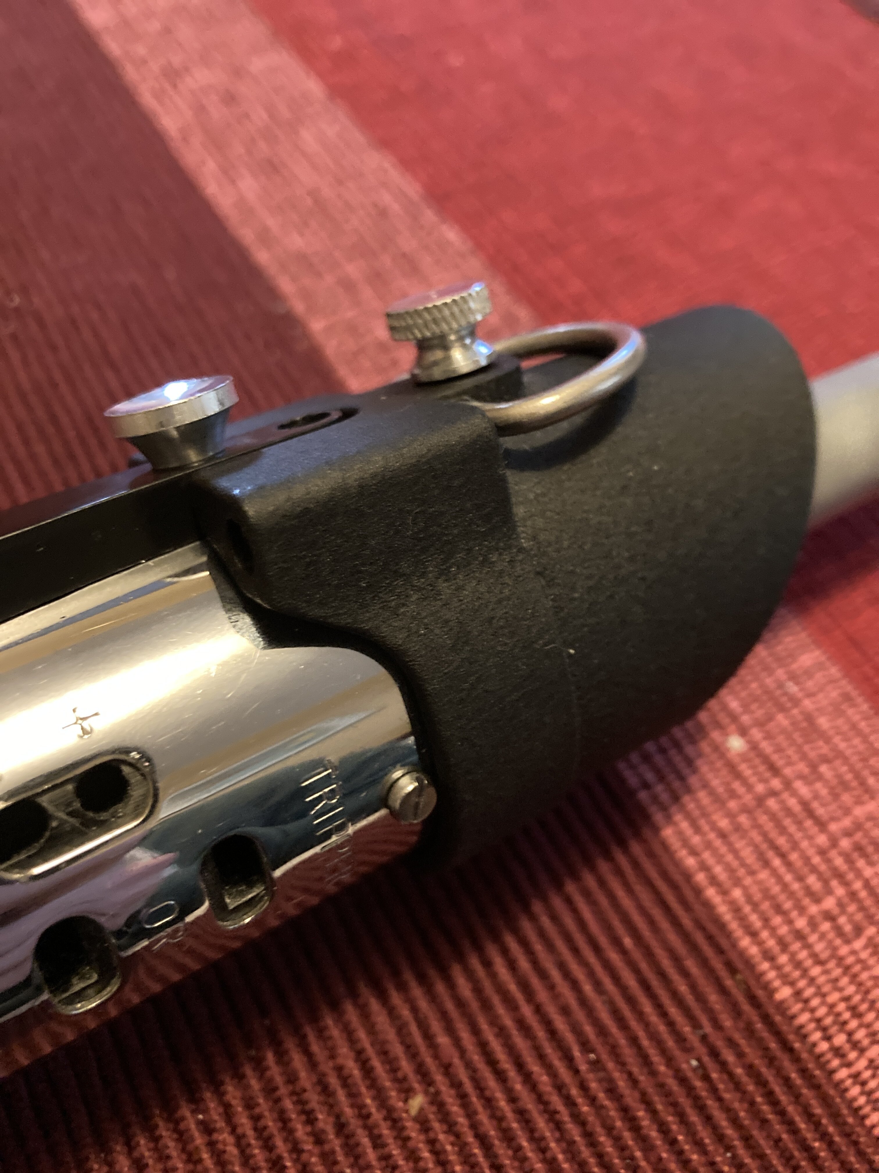

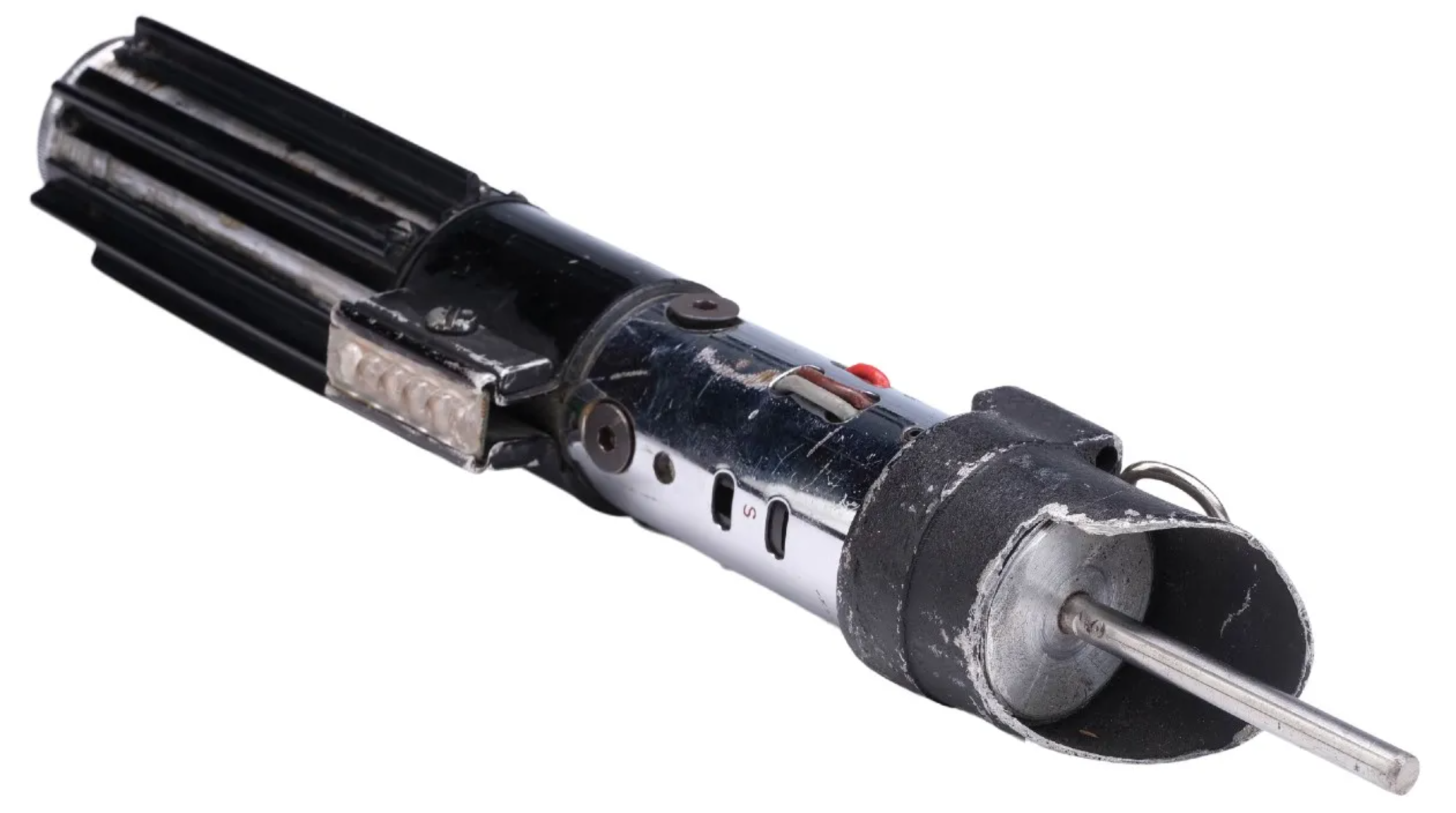

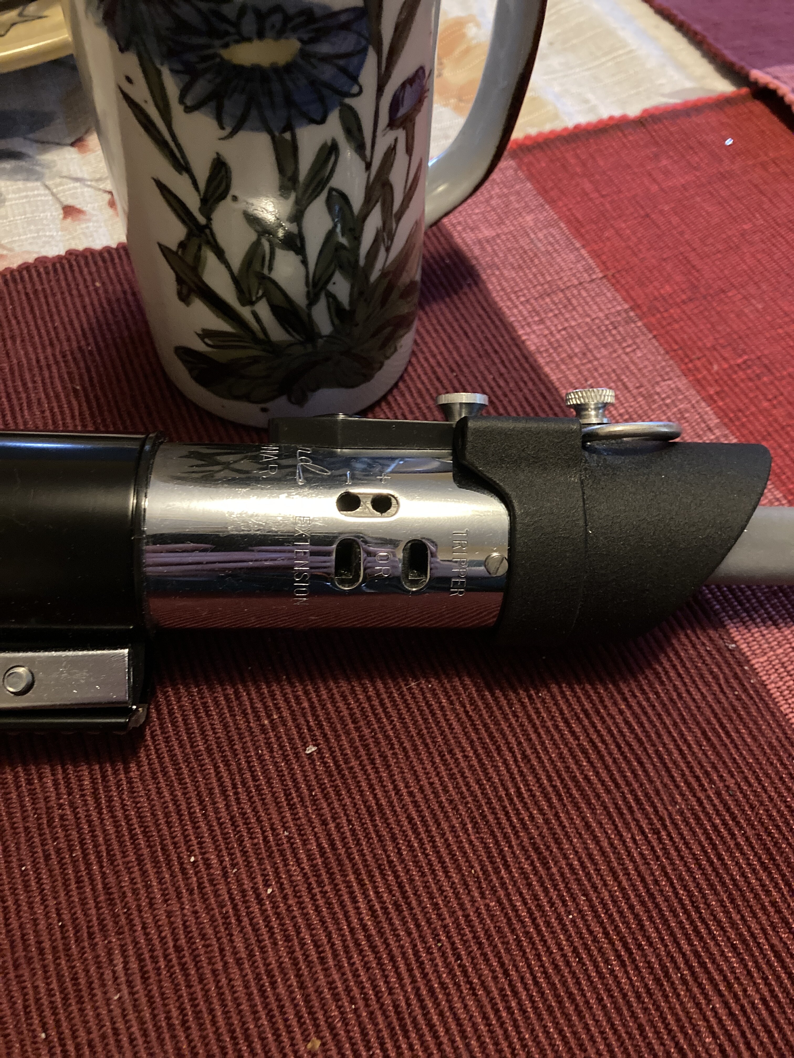

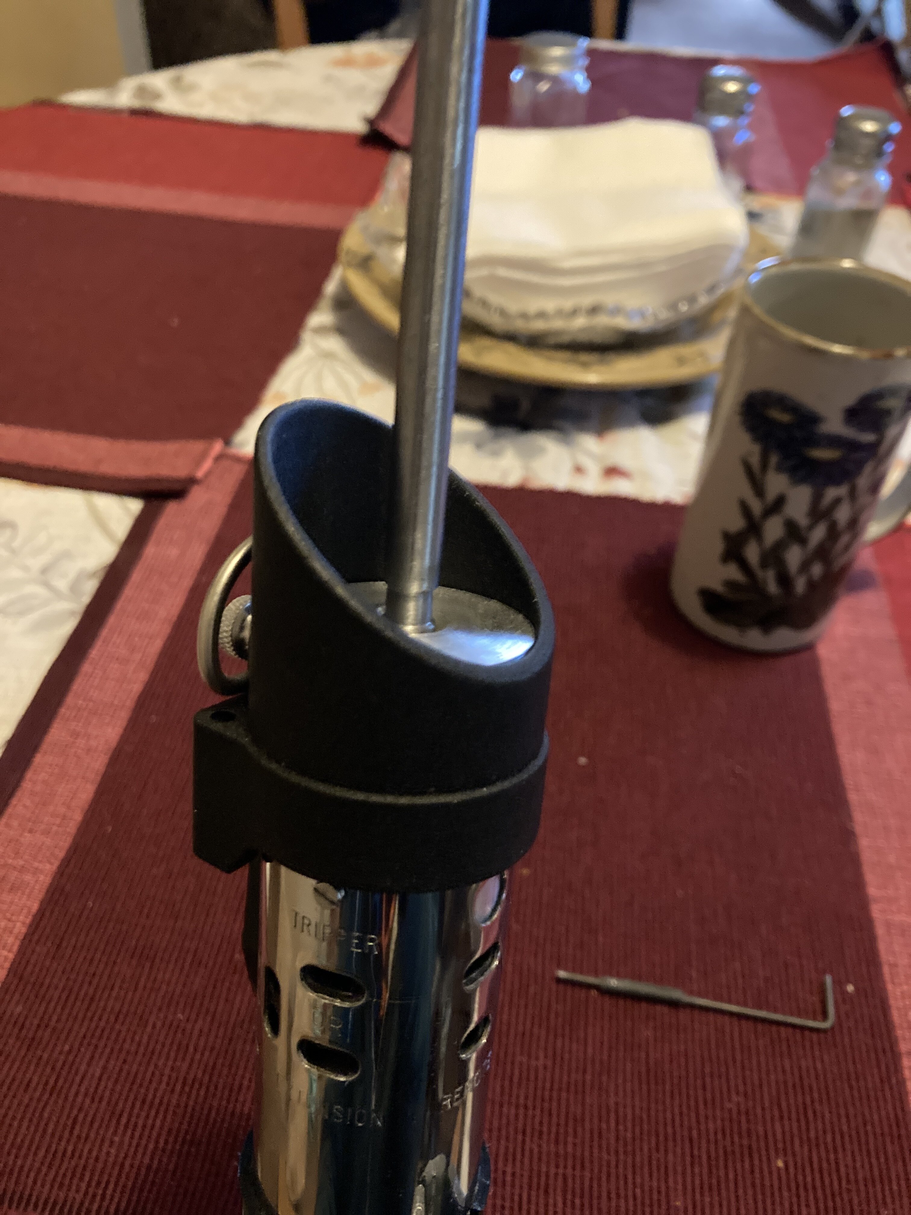

It’s a core raised all the way up to the rim of the shroud. HA! Anyways, in the Dagobah shots I see wires… so this again proved my double core theory. I also see a slotted screw, just like the MPP flash. So… those are tapped into the core. On the Heiland this doesn’t exist, so I bought the right items and tapped M2.5 screws where they go. Looks quite nice
Now this means I have the replica MPP bulb release and these two screws. That’s 4 little screws, so technically the core isn’t going anywhere
I also added one M5 grub screw per core, affixing the tang in place. If they did this, they would have had to remove the core stack to make it a belt hanger. I guess that’s not hard to do.
With the Graflex, obviously making it a belt hanger after filming was tough because they cut the tang.. so for that I’m assuming the screw is inside. (And the possible pop rivets….)
Anyway, I did have to sand off a little bit of plastic under the Roman bulb release. That little piece is genius and the tab holds it in the bulb release area of the socket on a Romans and possibly a real MPP. Thankfully on a Heiland the spring for the button lands beneath the open switch hole. So the surface of the tube is used.
