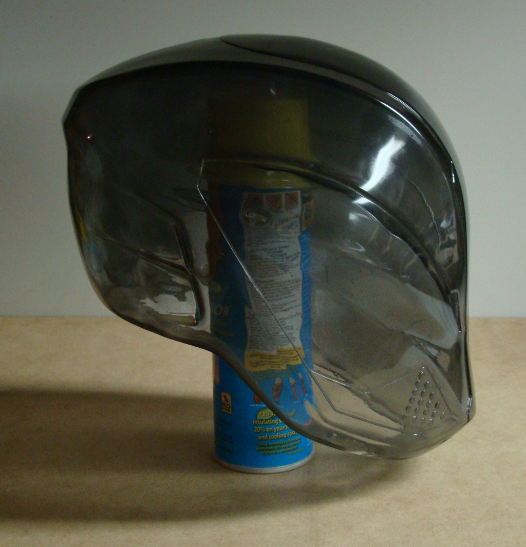

This latest attempt was waaaay better than my previous ones, and I think I'm sticking with it. Still some bubbles, but very small, and really not noticeable when your a couple feet away. They should fade away even more when the interior is painted black.
So, here's a pic of a failed previous attempt, and here's a pic of the first good raw cast. It has some tinting already, which I will tweak a little darker for future casts, but it really doesn't matter much, since the finished helmets will be sprayed flat black on the interior, and the viewing areas will be sprayed VHT on the interior till it's dark enough.

Visibility is good. I'll try to take a good picture of it. But here's how I'd describe it:
Peripheral vision: 90% (you can see in almost every direction you normally can.)
Focus: 80% (what you see is clear and in focus, not foggy or hazy)
Optical Clarity: 60-70% (ripples distort vision due to the variable casting thicknesses)
For me the clarity is a little wierd at first, but as I move, my brain is able to interpret things just fine.
I'm going to attempt to make a contoured block that I can press against the inside of the casting when it's semi-cured. This should hopefully flatten out the variation in thicknesses, and create optically clear areas similar to vacuum-forming.
