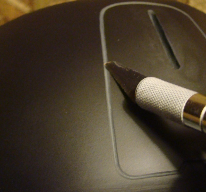

Nick, thanks, and they aren't too difficult to do. Forgive me if I'm too wordy.
- Draw the line onto the sculpt in pencil (so that you can erase your mistakes)
- Trace over the line(s) you like with a sharpie.
- With an exacto knife, follow the right side of the sharpie line pulling the knife towards yourself, holding the knife at an angle, and only using the tip. Basically, you're cutting a V-groove.
- Flip the sculpt around and cut the other side of the line.
- First pass is a very shallow cut and nice and slow. Should only take 2-3 passes till the cuts meet each other at the V and the material just falls out.
- Sometimes I'll need to straighten out a wobbly cut - lay the full length of the knife edge flat into the groove and use it's straightness to help you make a straight cut.
- Fold 220 sandpaper in half and use the V of the paper to clean up the groove.
- Spraying it a few times with filler primer also helps knock the crispness of the knife cut down a little.
For the mini-update:
All of the light grooves are cut in except for the two small chin features. After these are in, I think it's just a matter of getting the sculpt glossy and ready for silicon! I feel like I'm forgetting something...
