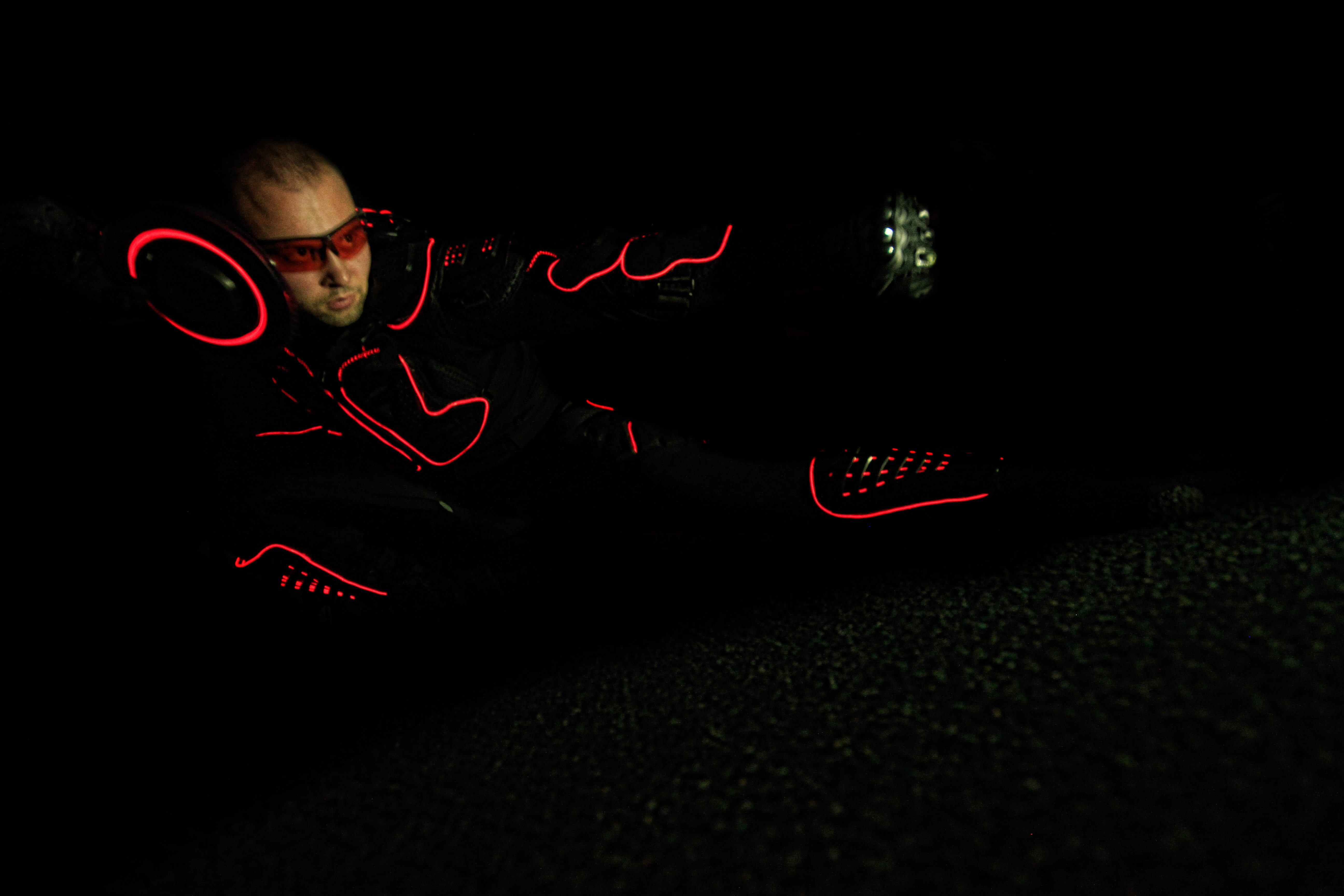

Heres my version of a suit. Had to go economical tho so no el tape :p. (I also put in some reflective tape so for photos with flash you can get a little bit better of a effect, but not shown in this photo :p )

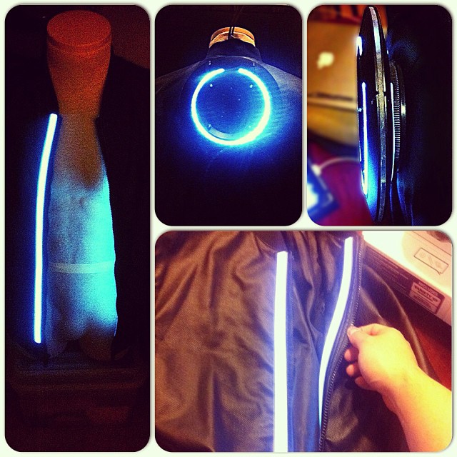

I wonder if anyone can help me on this. So I used Luminous Film's split electrode light tape. I used their eyelets as well but I did not have an "official" eyelet closer so I would basically crush both sides. The suit does light but it flickers A LOT. I'm sure its a connection issue. Is there a better way to connect the wire to these light strips? Thank you in advance.
