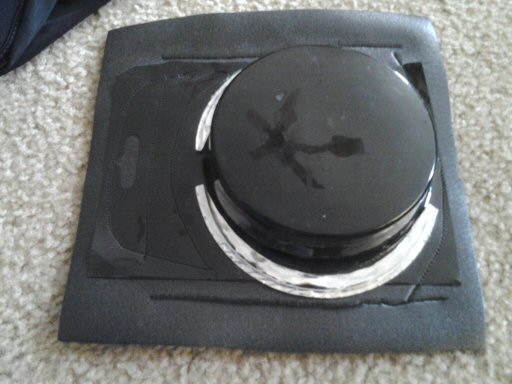

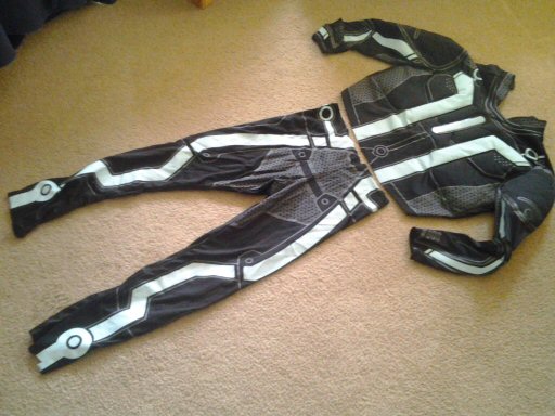

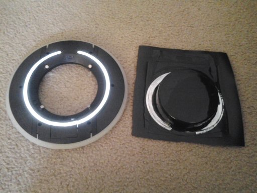

Hey Rook so I FINALLY took some pics of my Disney Costume and what it took to make it better though not the best by any means since I still don't have lights. Also please remember the Disney costume is a one peice but they sewed a top and bottom together. I used a seam ripper and then added some elastic to the bottoms as this helps but they are to low waisted but work. My Wife's Quorra Disney costume updates are similar as far as the disc holder is concerned. The gloves came from Lowes as they already had the hexagon shape in rubber and so with some triming and sewing they worked ok. The modified disc was from FATAL 5150 on here as I purchased 2 - one for each of us. Discs work great as the inner ring and outer ring have their own power switch. The disc holder was also from Lowes as some package of some plumbing rubber disc. The package was used and the cost of the product was around $2.00. I then painted the INSIDE of the package black and then used the expandable foam to make the packaging more durable. Since my discs also have the rare earth magnets I then needed some metal somehow. So back to Lowes and the plumbing aisle. I found the adjustable pipe collars that are chrome. With tin snips and tools I then made the chrom half moons. I will paint them gloss black later to match but for now this will have to do. I attached the chrome peices to the package using GorillaSuper Glue - works great once it sets. The disc holds and fits perfect! The disc holder is attached to a foam sheet like what you would use for tools in a tool chest. I sewed the plastic and foam together and to hold this to the under armor padded shirt, I sewed matching velcro on each so the under armor could be washed. The under armor pants help to provide some form to the Disney pants once seperated from the top and also offer some coverage as the Disney costume for BOTH men and women fit odd and would show some skin if nothing underneath. I didn't take pics of the motorcycle boots but they are black as well and work but are bulkier then in the movie. The suspenders are there not because I have belly :) but because it helps to keep the under armor up as you move around so it doesn't sag. If there are any questions please let me know I don't want to waste everyone's time. :) All creations look great!!!
