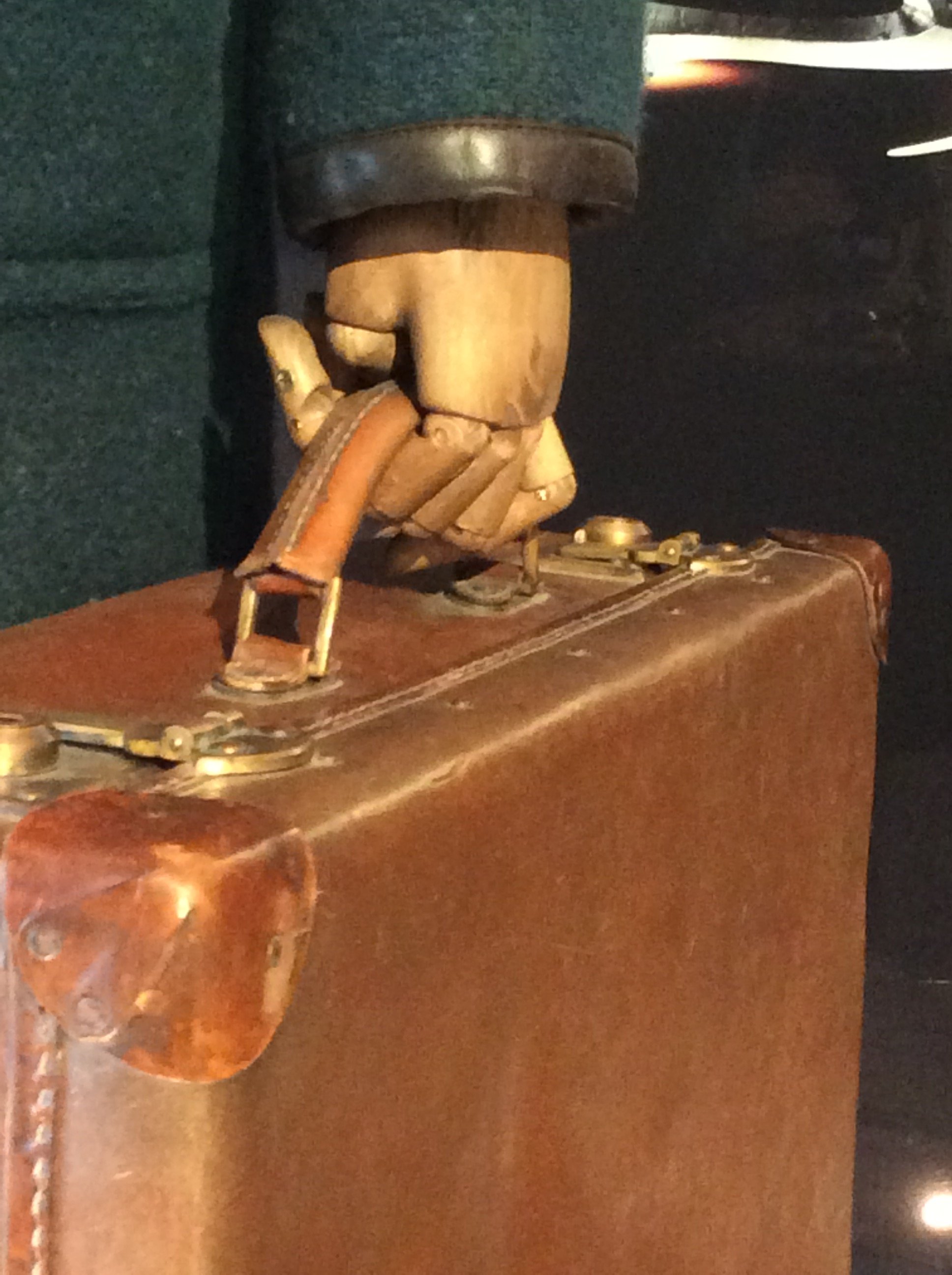

The suitcase from Fantastic Beasts and how to recognize it
This thread/build is one of the best/most informative I've ever seen! Alt Kenobi has done a wonderful job! I'm still undecided about what colour to use...

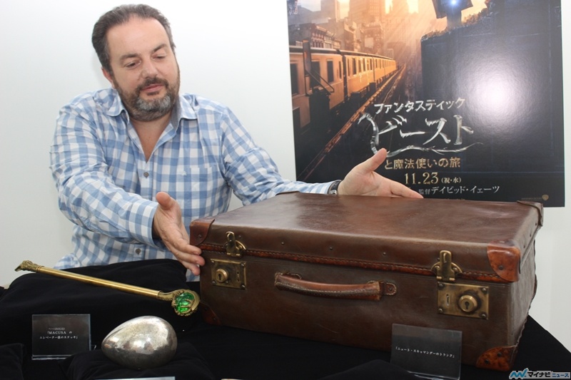

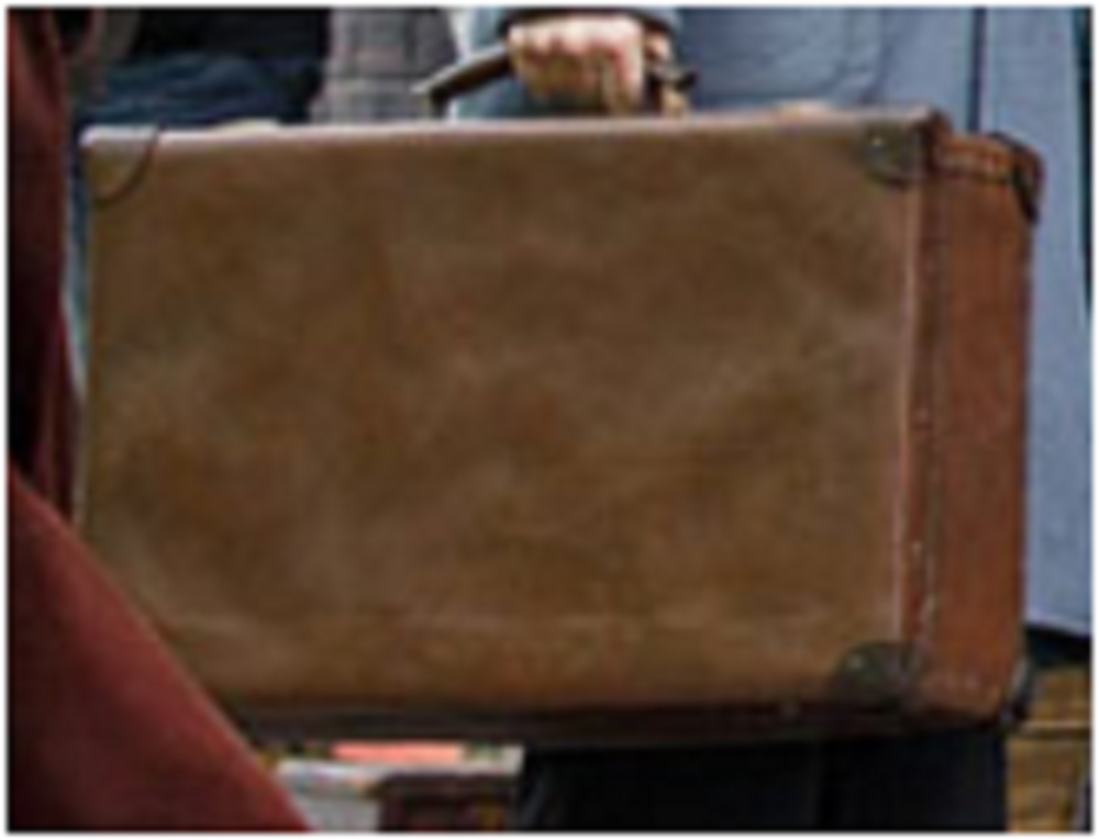

The nature of the dark film lighting vs the pictures of the real case reproductions found at displays, then the ones of Pierre showing off some of his harry potter props including the case, all show different shades of the one colour (I assume). I saw on a close up of Alt Kenobi's pics that he used Fiebings oil dye in saddle tan, and then treated it to a darker shade.
I'd like to hear any thoughts on this. Do you go the shade it looks in the movie? Do you dye it closer to the real display cases? Sometimes it looks like a medium brown, sometimes it looks like walnut, or russet, or english tan!

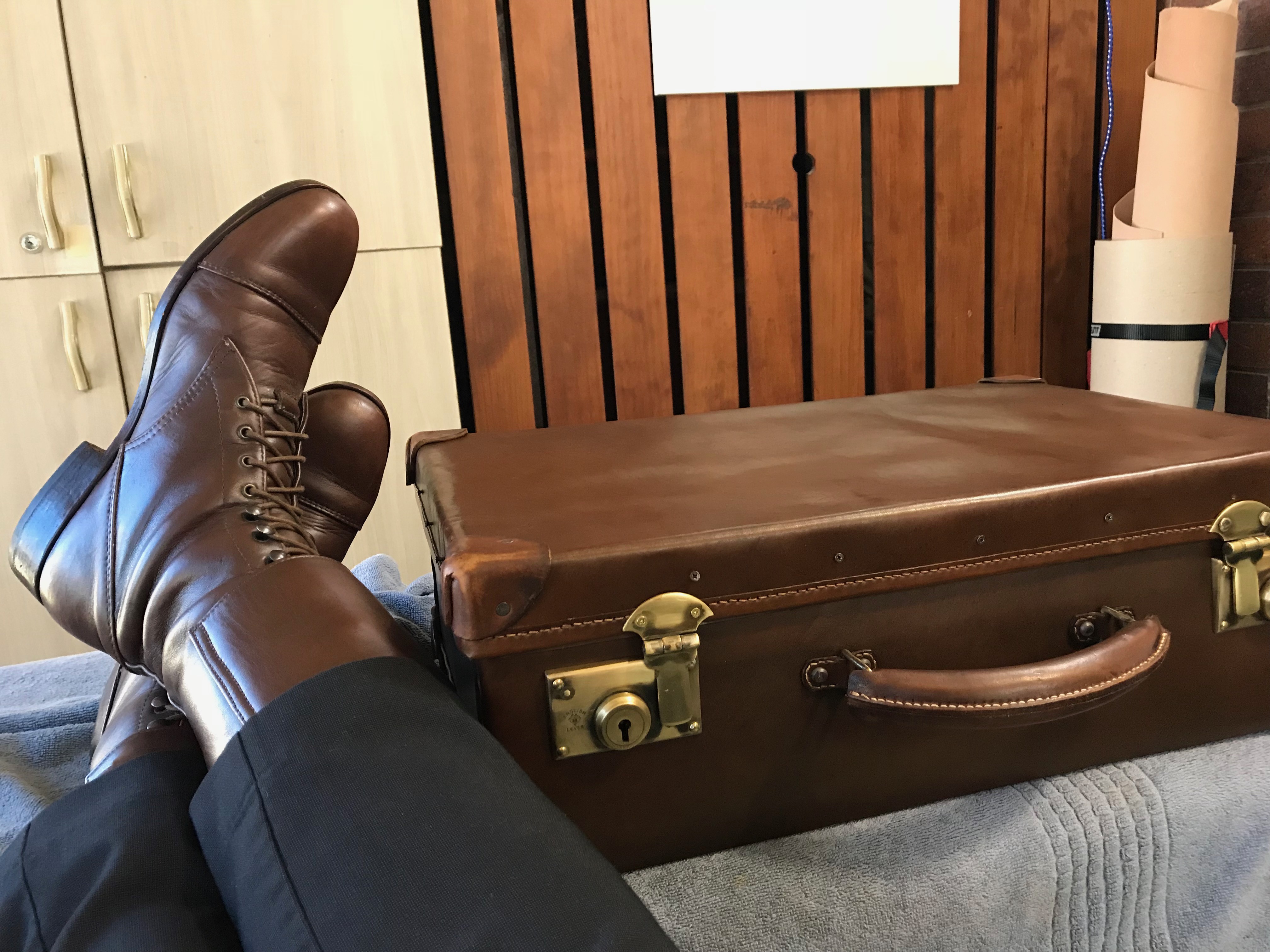

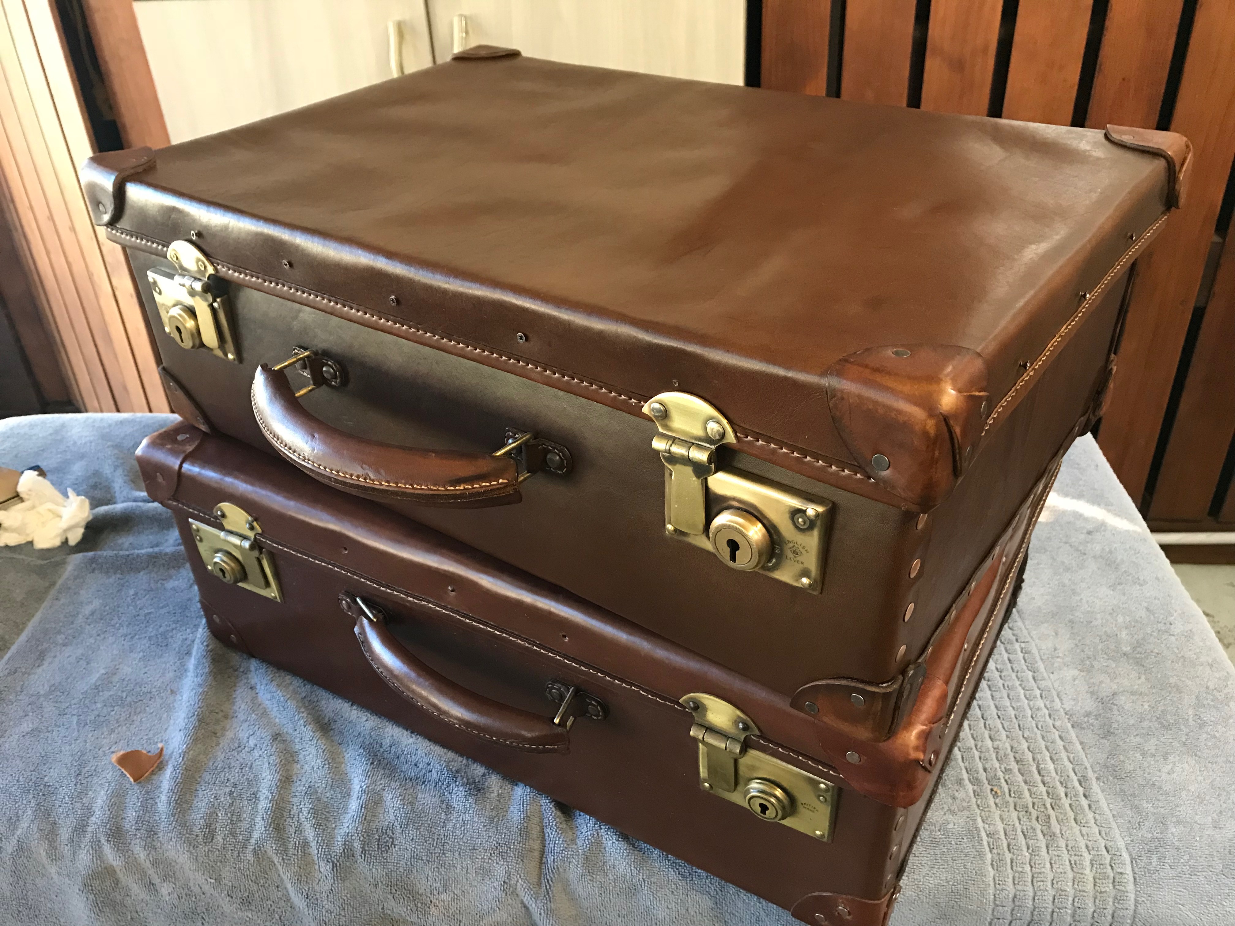

I prefer the warmer tone of the bottom one, however color matching is definitely not my strong suit. I am amazed by your dedication, especially when looking under the table. I am keen to see which one you end up going with.

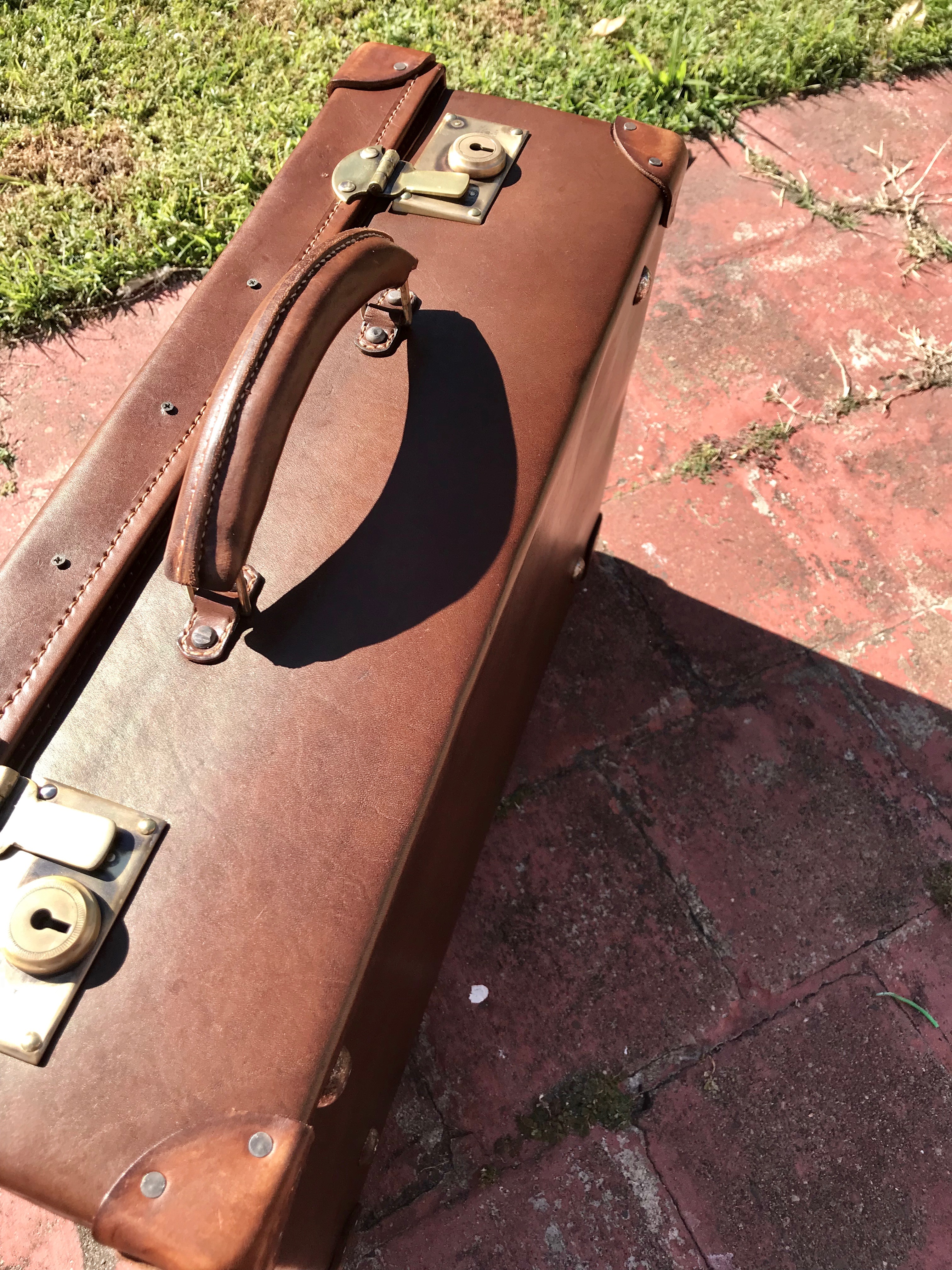

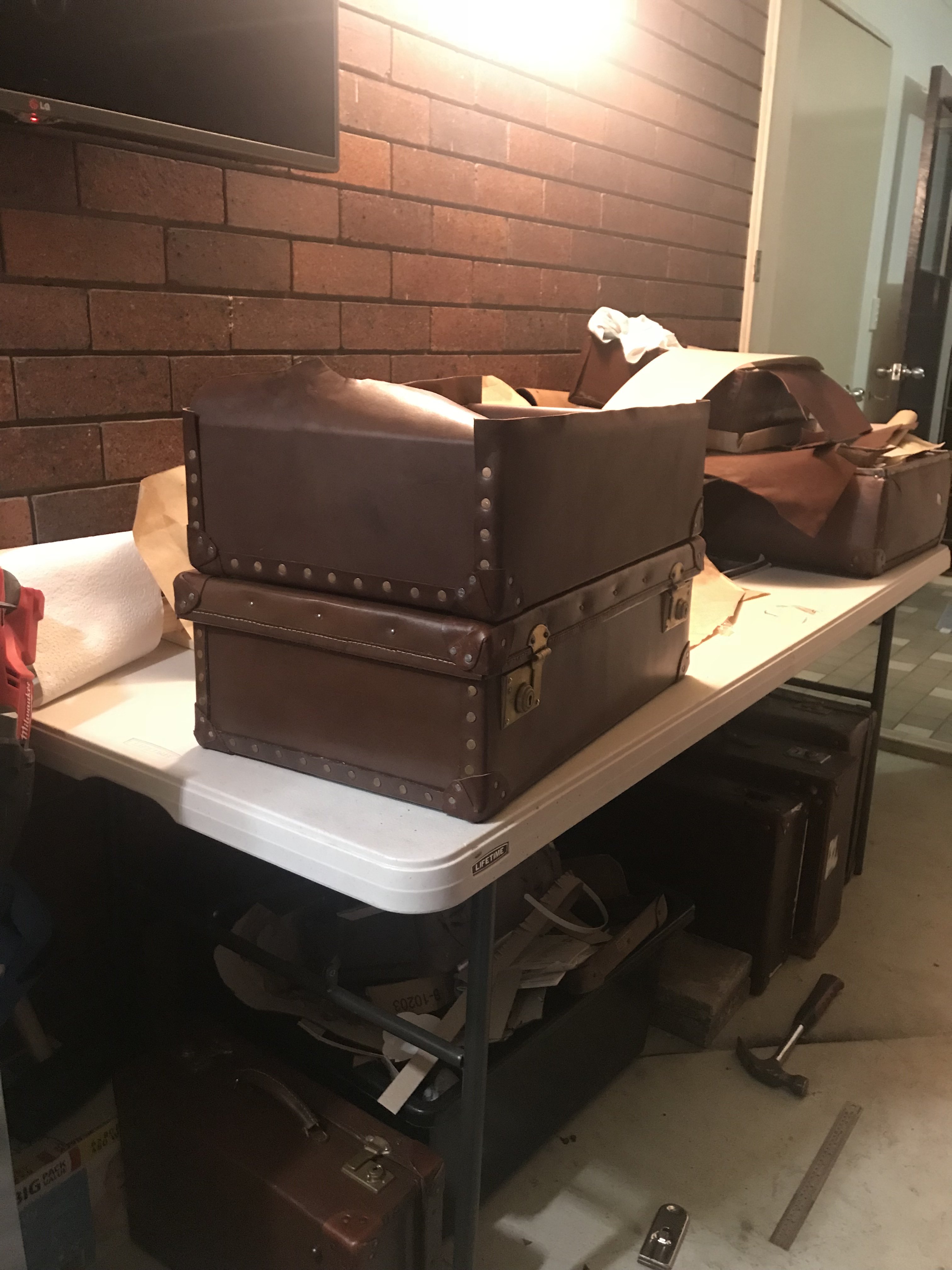

The ones under the table are antique/vintage cases that I’ve sourced over the last little while either due to the fact they looked similar to newts case (like most here I’m sure sourcing a vintage case is where we look first) actually they represent a fraction of the cases I’ve gone through for parts (locks, hinges, proper strong steel bag feet, rim corner stabilisers etc...) I originally thought I would use the antique leather as well but it was a bust. By the time you take it off it becomes clear it cracks too much to re-use. Like the case of the handle I’ve learnt a lot from taking apart old cases. I’m always on the look out for the proper solid brass locks as well. All the English lever stuff will last another 100 years+ with a good clean or sand back and some mechanical type lubricant. You can always tell proper antique brass as it takes on a black/greenish hue regardless of wether it has been zinc plated to look like silver. The upper hasp will also be flatter than the ‘Chaney style’ brass plated locks that are (imho) the next best thing:)
Using solid brass antique locks would make it more difficult to create a ‘muggle worthy’ mechanism though... hats off to alt kenobi for doing that!
