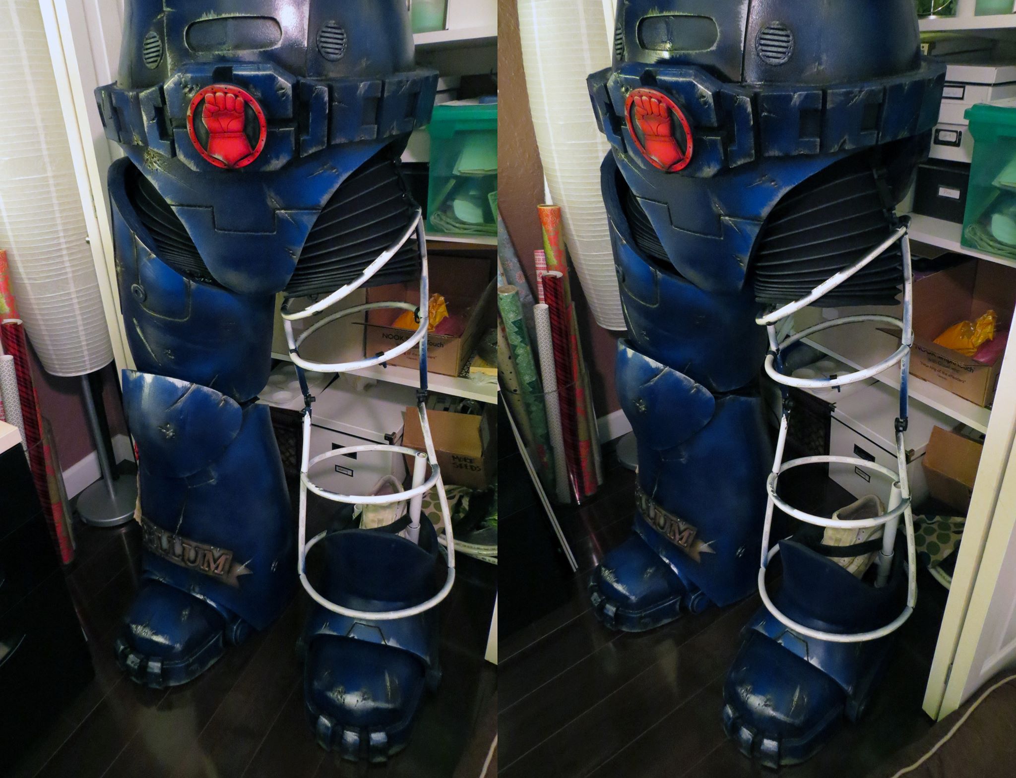

Also, this is worth a share. Thanks to the stairs on the convention stage, my knees were damaged needed service. the good news is I got to take these pics of a cool feature of my armor that no one ever gets to see. Inside all of the major armor pieces is an internal structure built of PEX tubing. It acts as a skeleton of sorts. The skeleton keeps the armor pieces in shape and provides me with rigid mounting points to attach all the pieces together.
