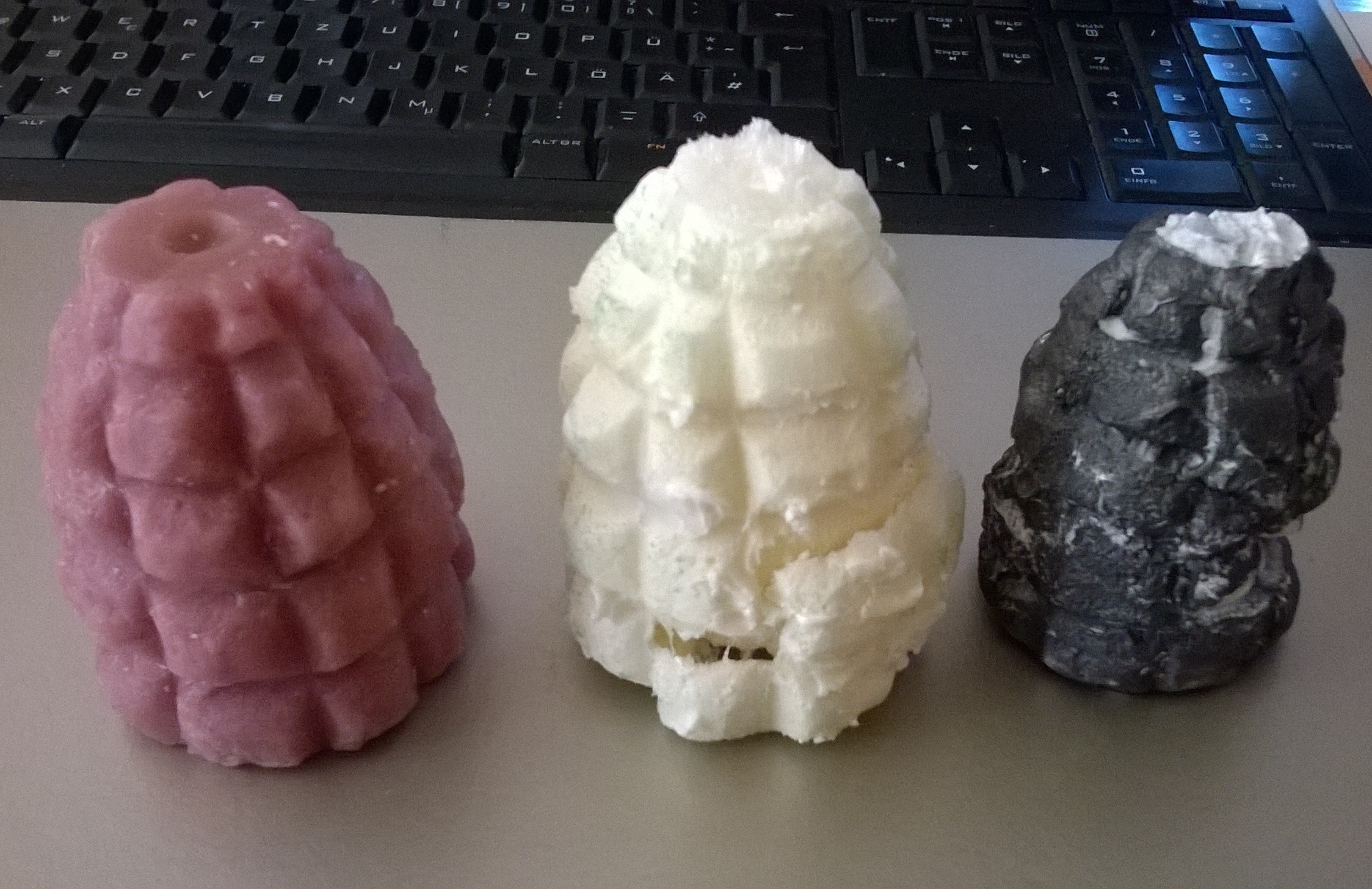

I made this wax-grenade with a caulk silicone mold (actually not following this tutorial here, but just smearing the silicone onto the master). After I pulled some wax-copies, I tried some other materials, including caulk silicone and expanding foam. The foam copy came out without any kind of mold release, and, keeping in mind that the mold was only held together with some tape, was in pretty darn good shape (unfortunately, I demolded it too early, so the copy wasn't perfect).
The silicone copy on the other hand was more or less a proof of concept. As silicone wants to stick to silicone AND is not easy to paint, I tried to kill two birds with one stone and brushed some graphite powder into the mold to release it from the mold and prime it for further painting.
While priming and releasing worked out great, the copy itself didn't turn out that good, as my method wasn't the best. I just pushed the silicone into the mold using the...I actually have absolutely no idea how that thing is called in English, cartridge gun? You know, that thing you use to push the silicone out of the cartridge. This trapped some air in the mold (see first picture) and didn't get every single detail (second picture). But with some pratice, another type of mold and/or "brushing" the silicone into the mold using popsicle sticks or something like that, it should work just fine.
It should be noted though that the silicone seems to shrink over time; you can clearly see the silicone copy is smaller than both the wax- and the expanding foam copy.
Oh, and btw, caulk silicone molds (at least the silicone I was using) can also handle higher temperatures, for a short time. I was able to pull some keyrings in such a mold, using molten pewter.
