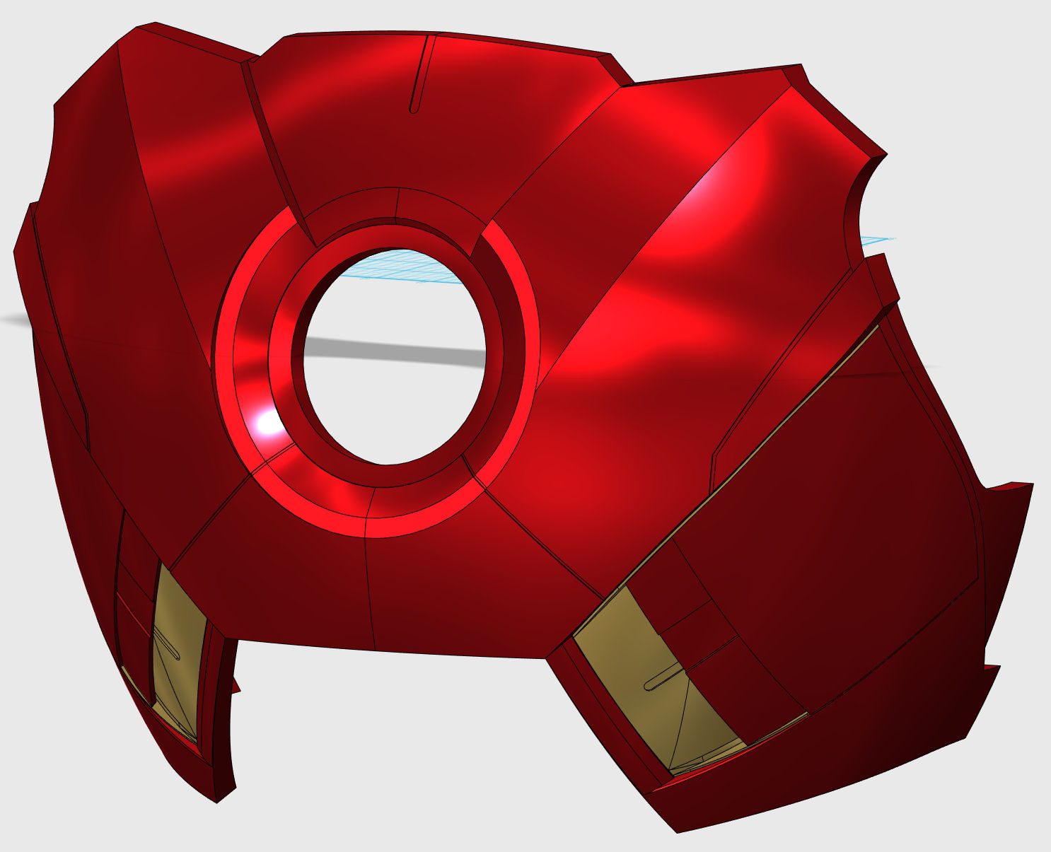

Added some detail bits.

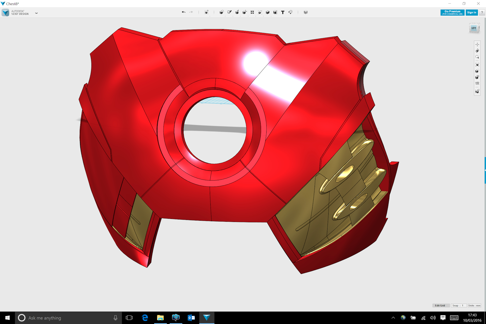

Well I'm done with the side panels!
I could spend far too much time on this, so I'm moving on before I get too carried away. I'll pull the part back into the chest tomorrow, add the final couple of small details to the neck area, and then get this ready to print!

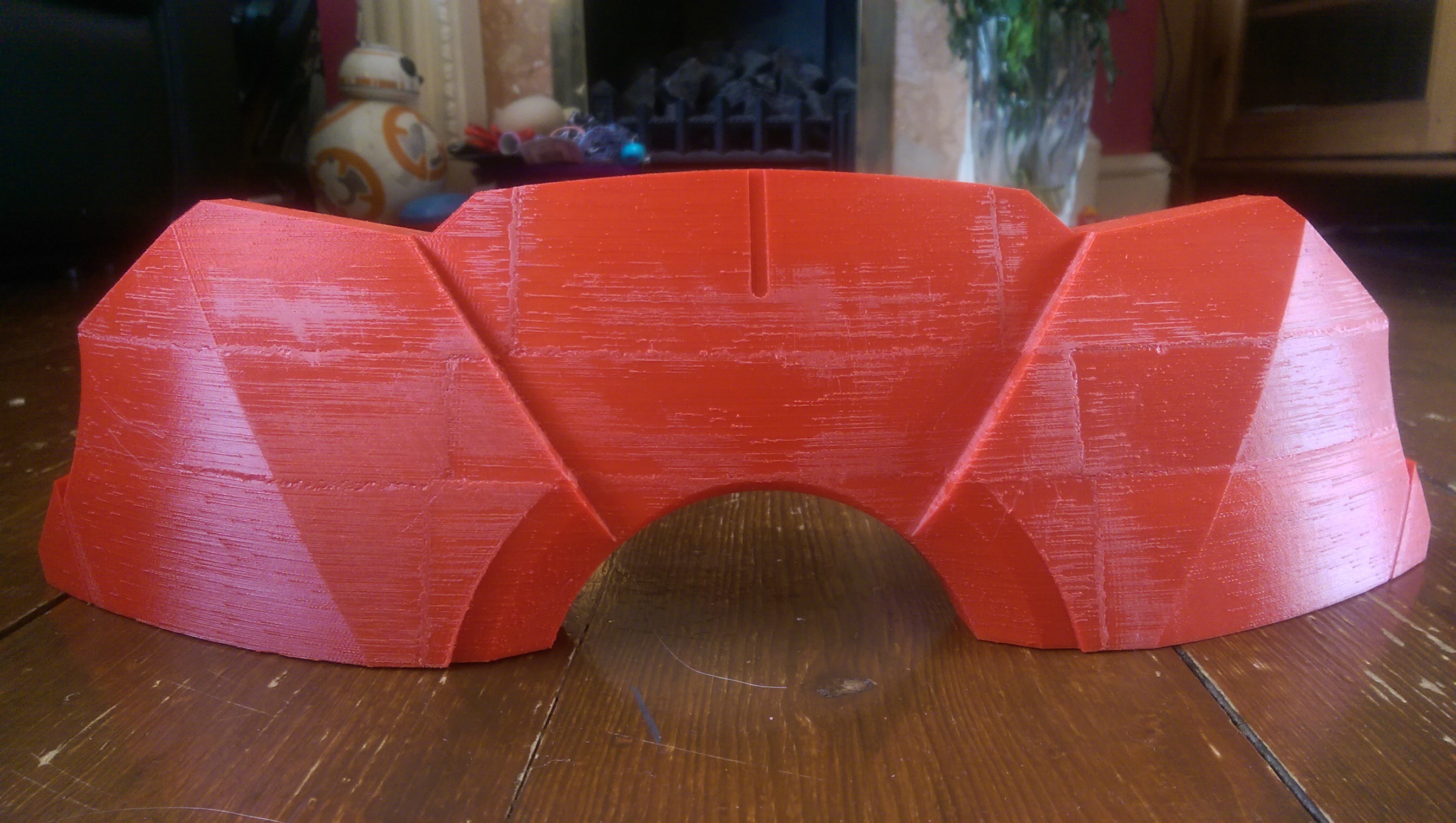

Well it took a bit longer than planned, as I've been ill, but the first part is printed!
Needs a bit of sanding but I'm pretty happy with it.

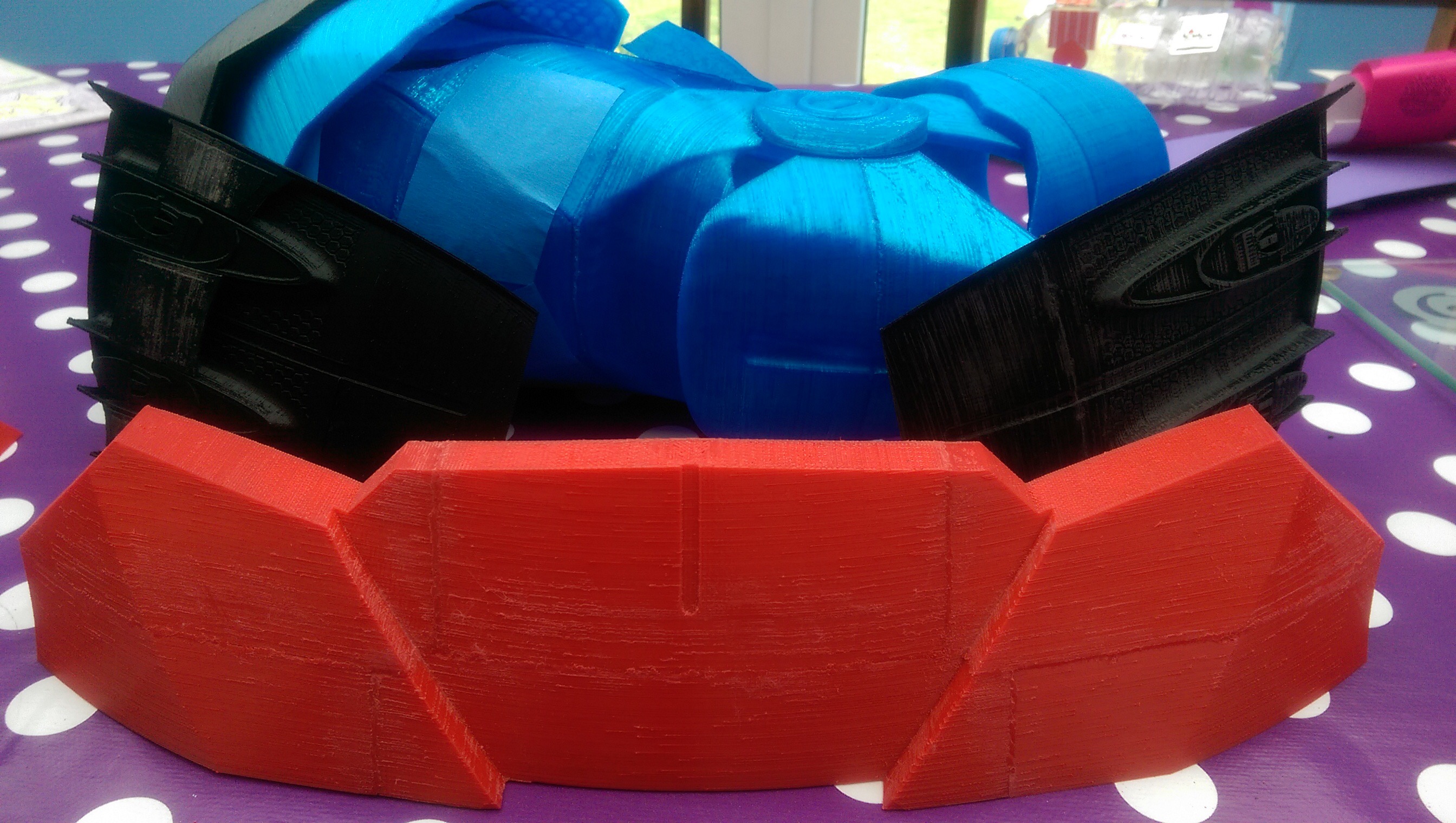

Another three parts of the chest printed. Decided to start welding the pieces together.
Alignment is ok so far. There are a few small issues, but nothing a little filler won't hide..........
