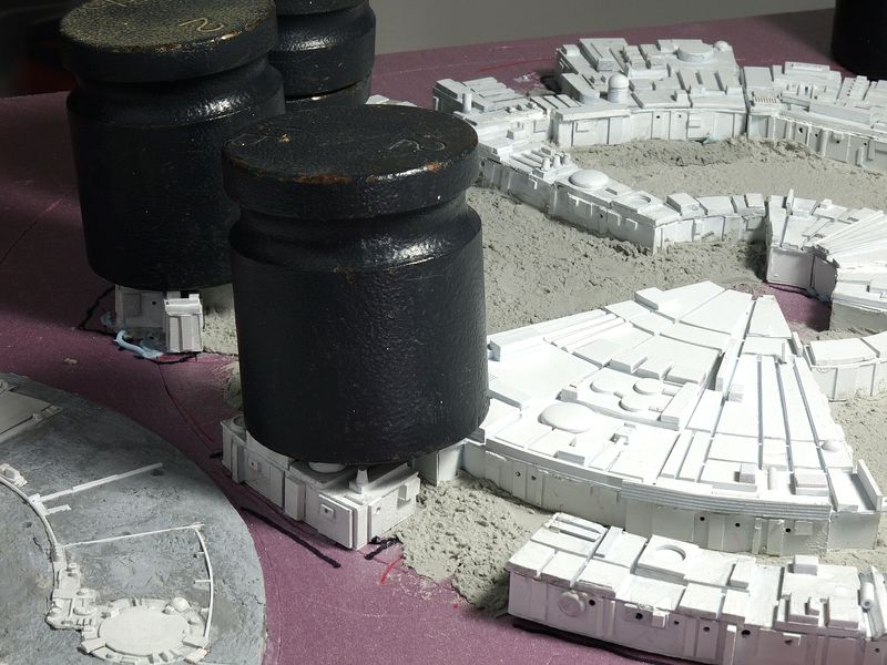

The final smaller sections of the Clavius model were glued and weighted down... waiting overnight to dry.

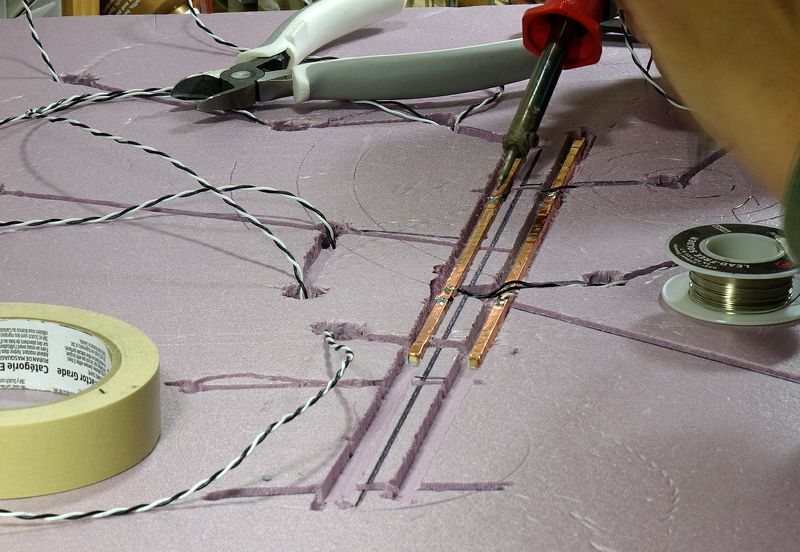

I flipped the base over and soldered all the separate lighting circuits to the power busses. Always test lighting at every step...

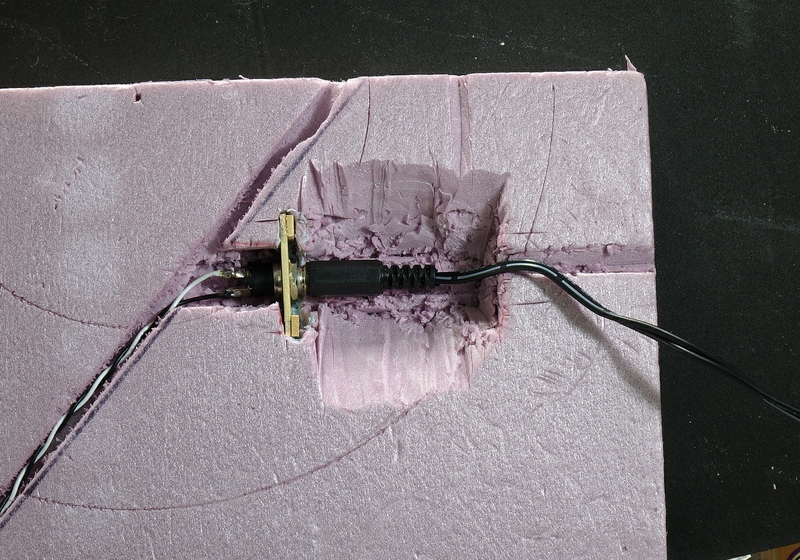

A DC input jack was mounted just underneath a bottom corner. Much foam was removed to allow human fingers to plug/unplug.

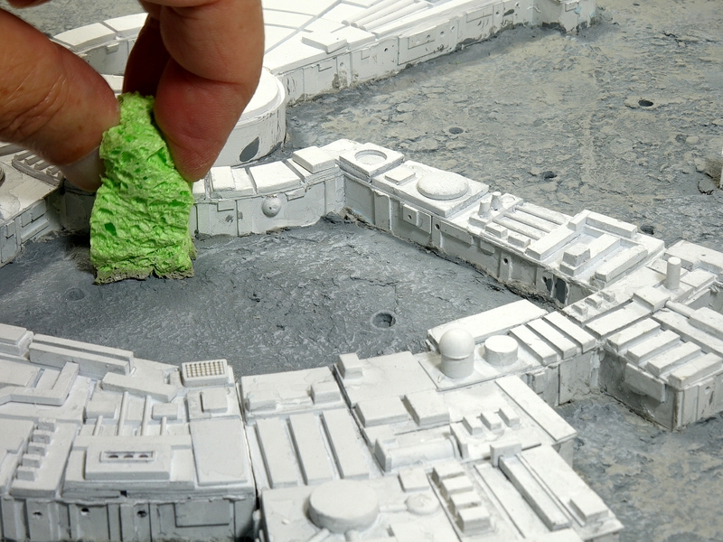

I painted several more layers of different grays onto the surface... using the same type sponge as before.
Many clean-ups/fixes required.

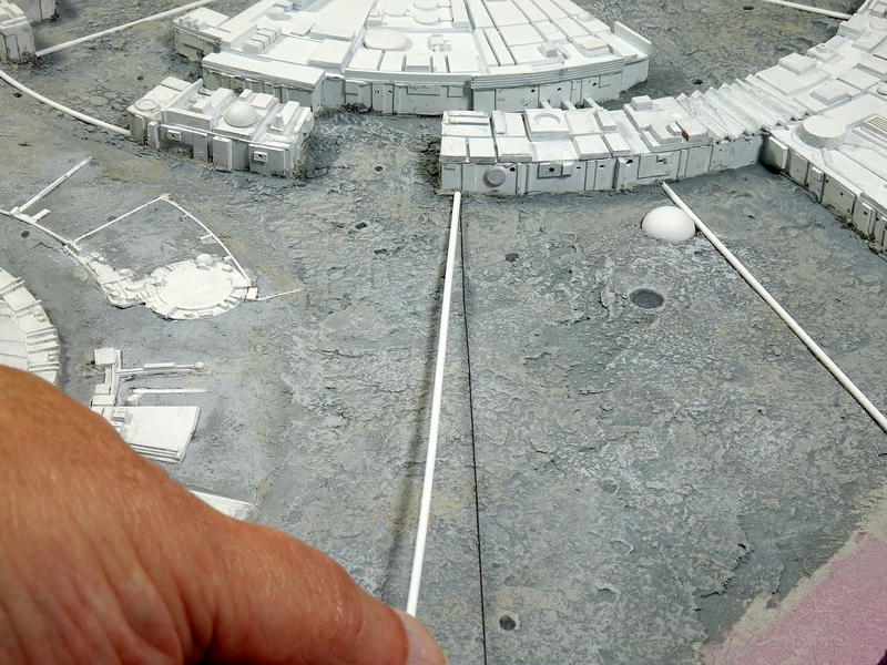

People mover tubes, or liquid distribution pipes (whichever you prefer), were installed per the original plan. I cut a small slot into the surface and forced them a bit below the grade. These are .030" Evergreen styrene rod.

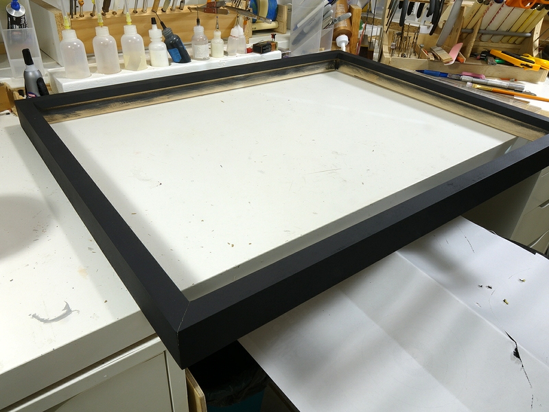

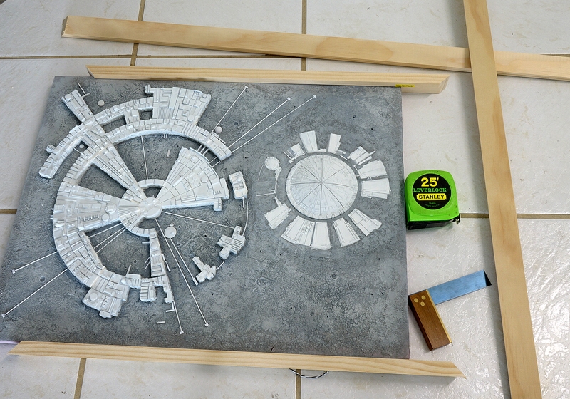

Finally building a "picture frame" from 1 x 2 select pine for the model, which will be hung on a wall.
Frame ready and painted flat black.
Base is mounted with standard offset clips and wire hanger hardware. Of course, this is NOT the lighting this was meant to be seen in.....final shots next time.

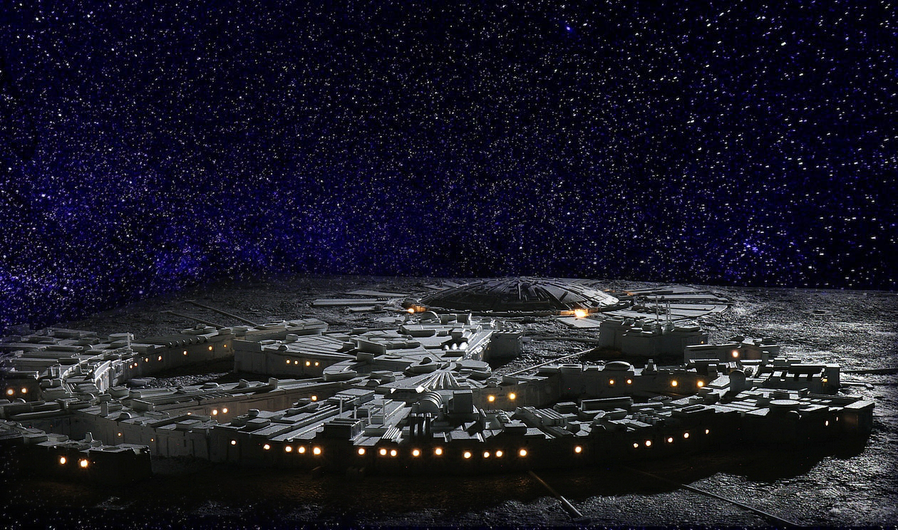

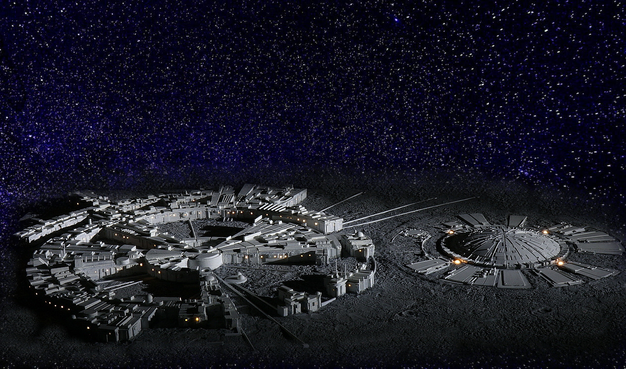

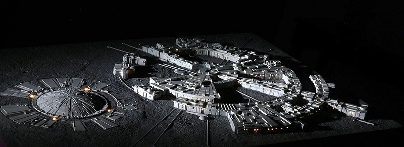

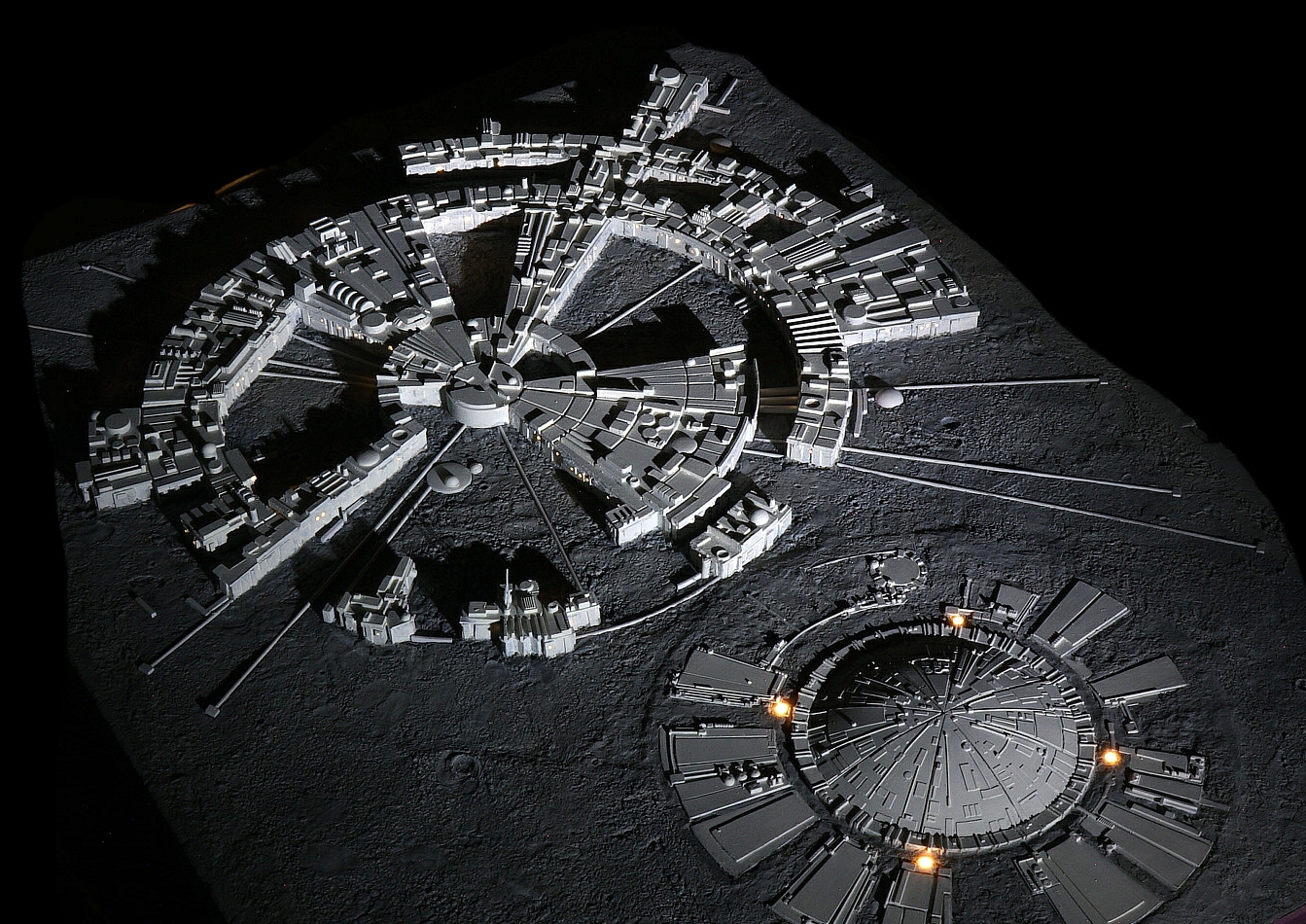

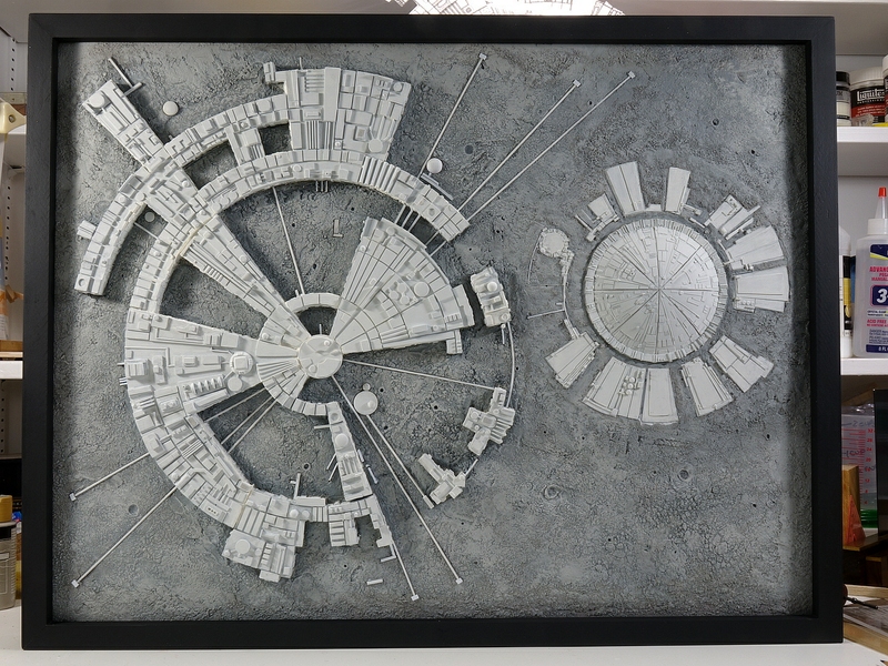

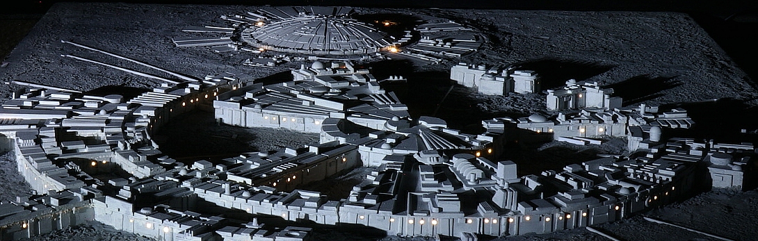

Thanks to everyone who read and commented on this thread. I appreciate the encouragement and support of RPF members. Many challenges were here. I learned some new things-& tried a few techniques I'd never done before, which is the best way to improve. There were many sessions of head scratching, and trashed "first attempts".
I followed some of the techniques offered by the excellent scratch builders on this forum.
And the research, calculations and problem solving involved may keep the old bean from becoming atrophied.

Really nice photographs and of course the model itself. I especially like the first more overhead image, it really reminds me of scenes from the film (my favorite film of all time).
The Moon base and its rock/ground formations are looking great :cool: :cool: (y) (y) Glad that you've tackled a Sci-Fi project such as this iconic base!!
Hi Carl. Just catching up again with your project, and you've already finished.
As always, you have done a superb job, and certainly a different topic to the normal train threads. But it seems you can turn your hand to any type of modelling.
Lighting looks excellent as I would expect from you, and excellent work of embedding the structures into the moon surface.
The method you used in replicating the dome was genius. Something I need to try.
Hope you paste a few pics over on the RRL thread, as many would like to see them.
Take care mate.
