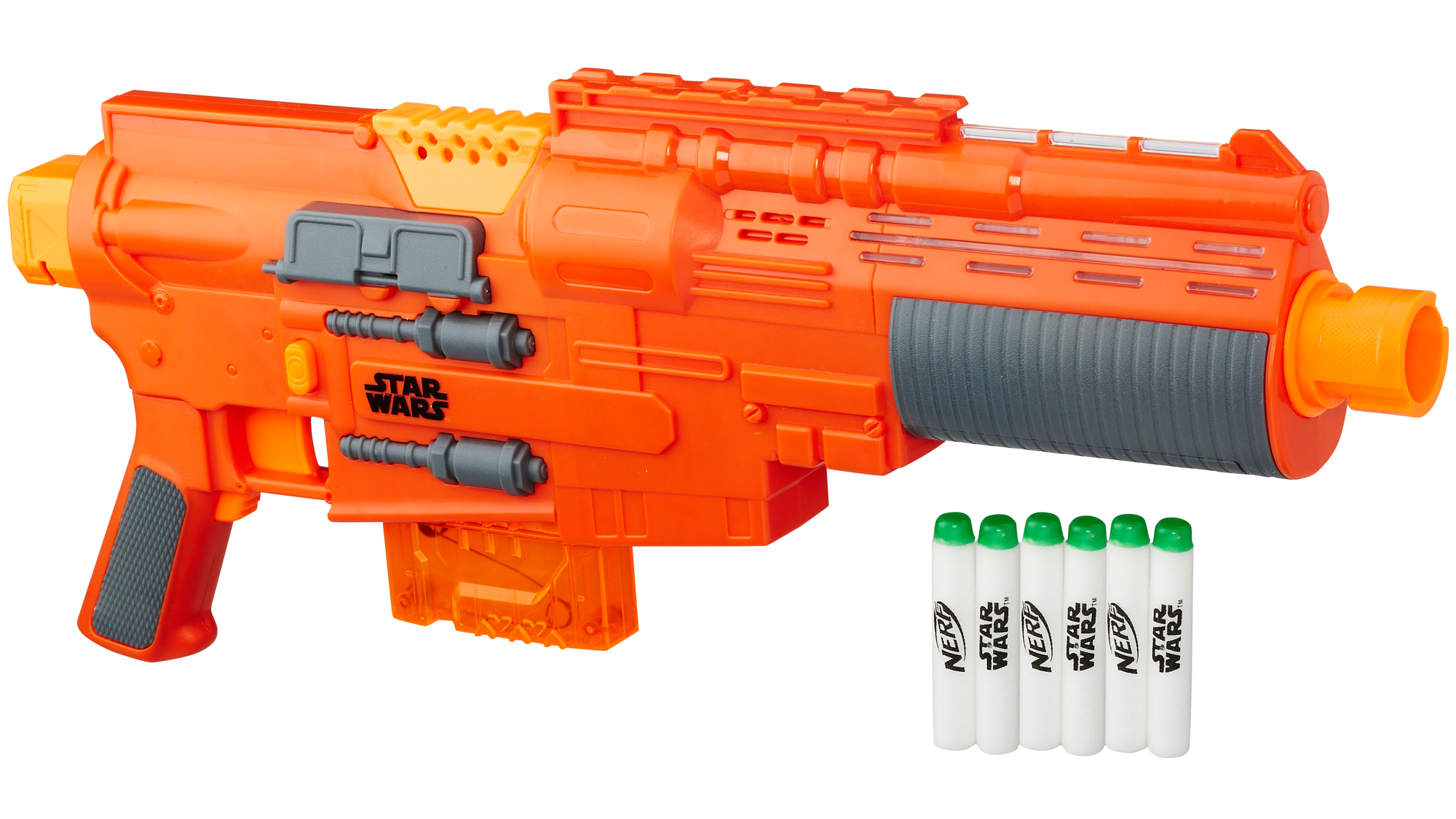

Nerf's also releasing this $50 blaster that's supposed to be Erso's, but it's more similar to Cassian Andor's:

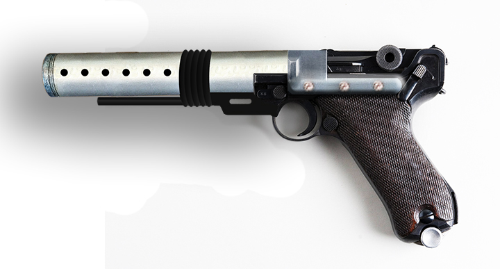

Ok, So before I jump in to my 3D design for Jyn's blaster I thought I would do a quick photoshop sketch to see if I am on the right track. Let me know what's "off" so I can make changes and carry on. Once I finish the 3D .stl I'll post them for anyone to use.JBW.jpg
Re: Rogue One Felicity Jones gun - ideas
Imagehunter I think your sketch looks great. I post the following comments not as "facts" but in the hope others will chime in to support or challenge these observations as they are based on fuzzy photos.
I do not believe the black ring on the shroud is ribbed.
I do believe there are very shallow grooves on the section of the shroud behind the black ring on the toggle side.
I believe the front face of the black extension under the shroud is angled much like you have angled the section in front of the trigger guard.
I believe on the left side there are only two machine screws holding the side bracket, but there are three screws on the right side.
Not a part of the print but the safety should be removed.
One question on your design. Do you have the right side and left side bracket as one piece wrapping over the top of the barrel? I have considered that possibility but so far have not found any evidence to accept or reject that idea. I have also thought there might be some connection between the bracket and the shroud. I would be interested in your thought as you have obviously spend some time analyzing the design.
