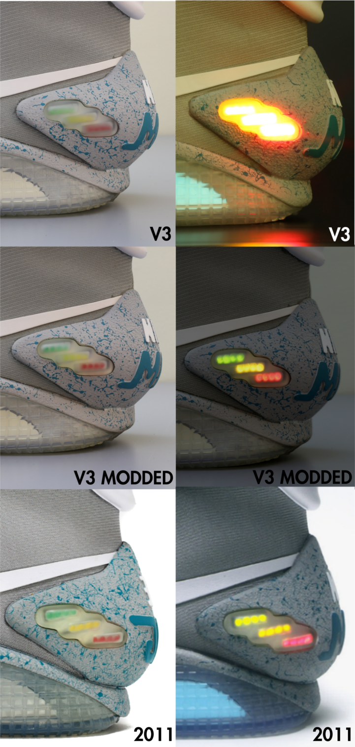

Yes, but I can do better pricing here then on eBay. I also have a few other parts I don't have listed. Like LED boards ect, I did a little comparison photo of them below...and right now they seem to actually double the battery life. Pretty close to the 2011 version, especially when LEDs are on.

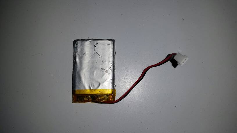

And this was interesting.
Notice the battery I have marked as OK actually has 3.7V 1000mah text. The other does not. So the unmarked really is a piece of Chinese crap and the other might be half decent. Hopefully I can get two new batteries soon.

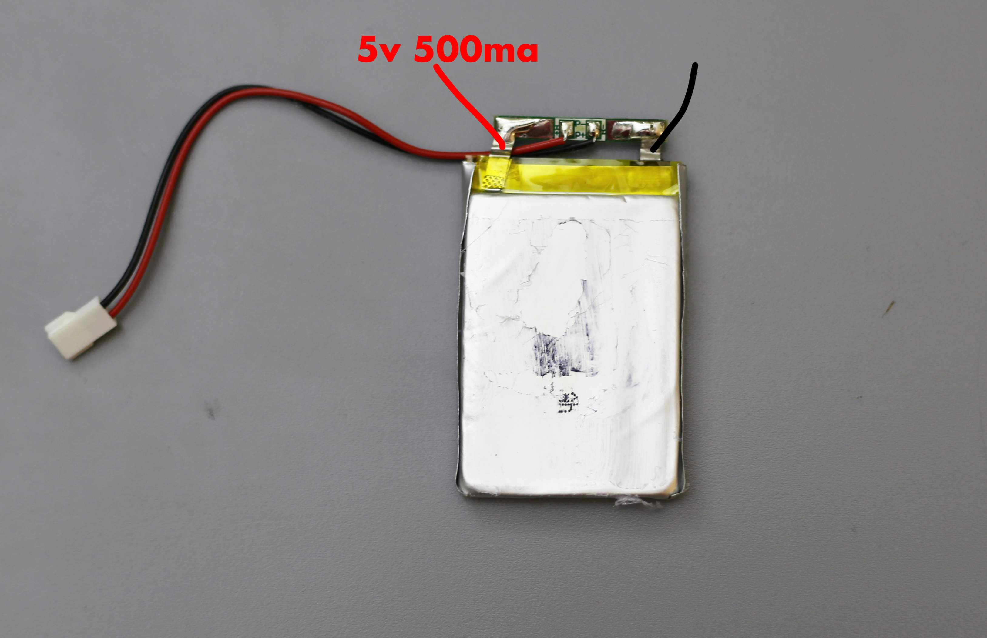

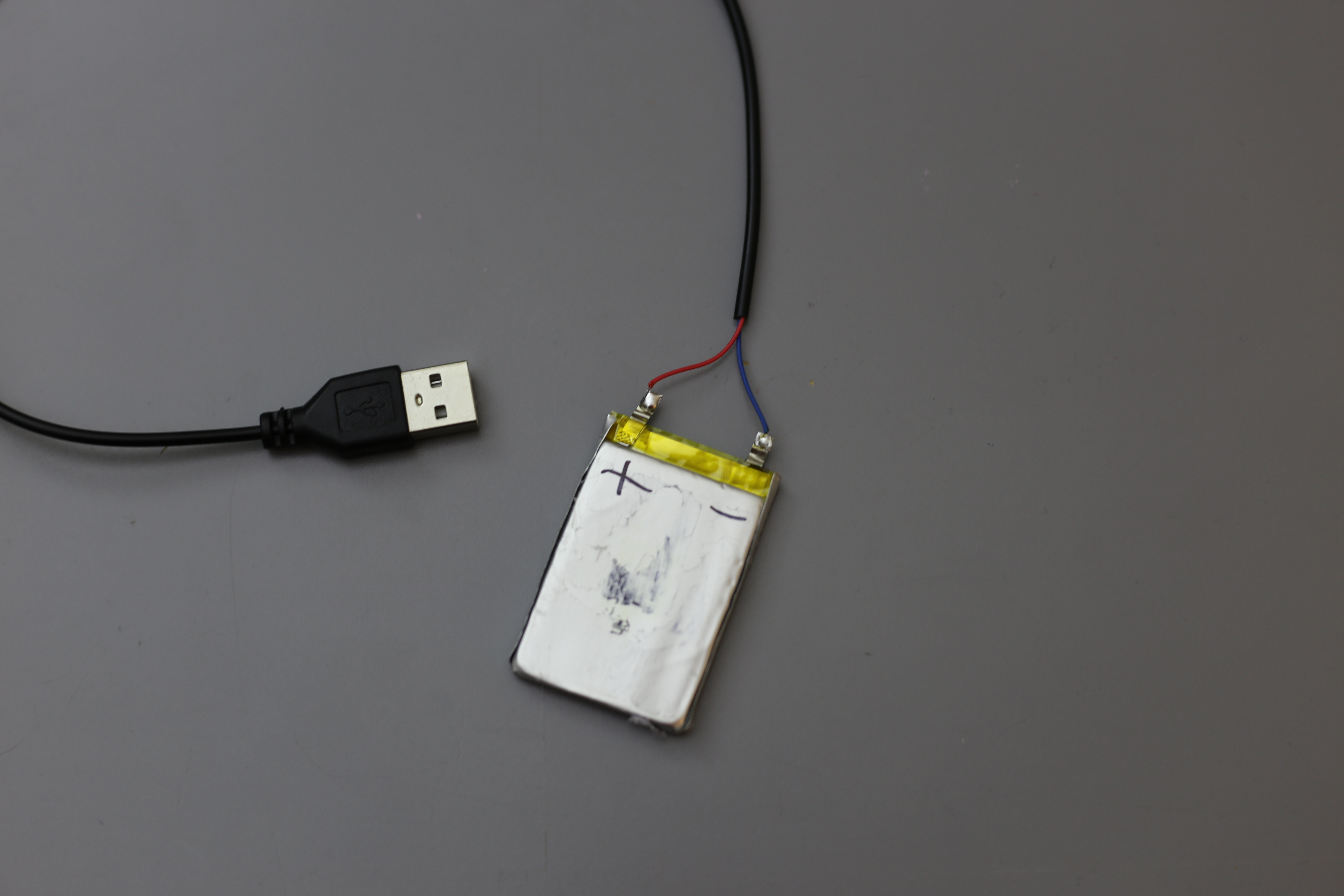

To further what cavx said...when your batteries "die" they aren't actually dead. The board on the top of the cell is a protection circuit, designed to cut power to the cell with over charge/discharge. You can pretty easily bring the cell back to life so it will work again, without actually buying a new battery. The circuit cuts off the battery at the 3-3.2v range. Doing this once will not hurt, but its not something you want to do constantly to a battery. (Picture it like jump starting a car battery)
Undo the yellow thermal tape expose the flat wires going to the board, connect them to a 5v 500-1000ma power supply (normal USB port will do) for about 15-30 minutes and your battery will charge enough to enable the circuit board again. You can now fully charge it with the actual shoe charger, and use it again like normal. (Its very important you get the polarity correct when charging them manually, and to not over charge) Only 15-30minutes to get the battery back up over the 3.2v DO NOT LEAVE UNATTENDED OR OVER CHARGE. And charge your shoes every 3-4 weeks even if you don't wear them.
