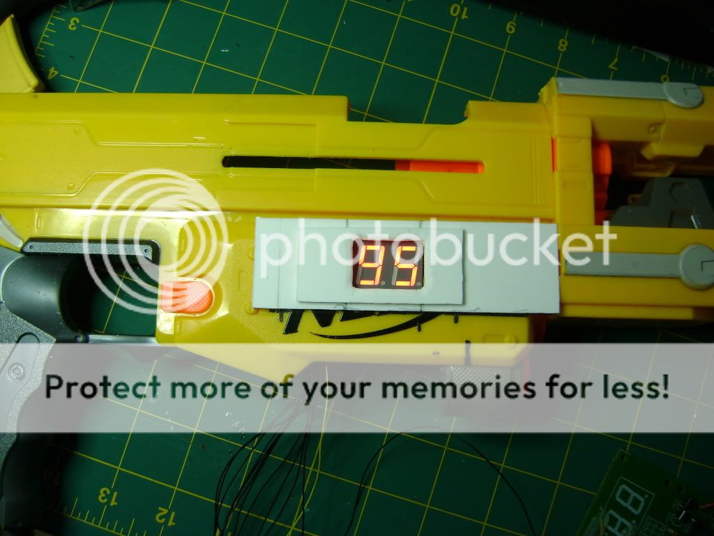

After a couple of days tinkering with the totally new world of electronics I have this baby up and running.
I have it counting down but need to tinker some more to patch it in with the trigger.
I'm just waiting for delivery of the LED's for the barrel & grenade launcher flash and then I have the fun of getting the Blaster Core up and running, I feel I may be seeking help in the near future.

Oh wow! That round counter looks amazing!!!
