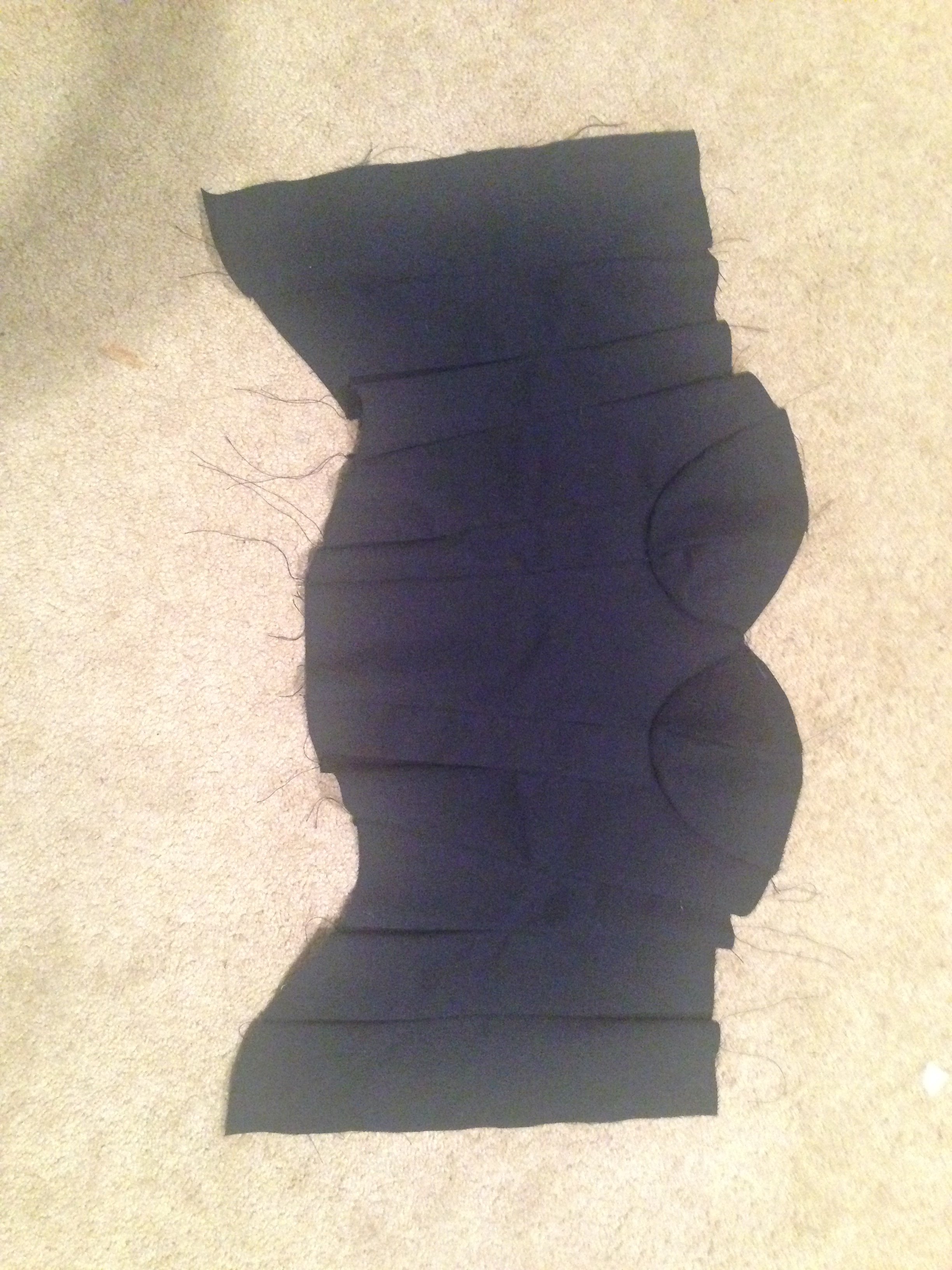

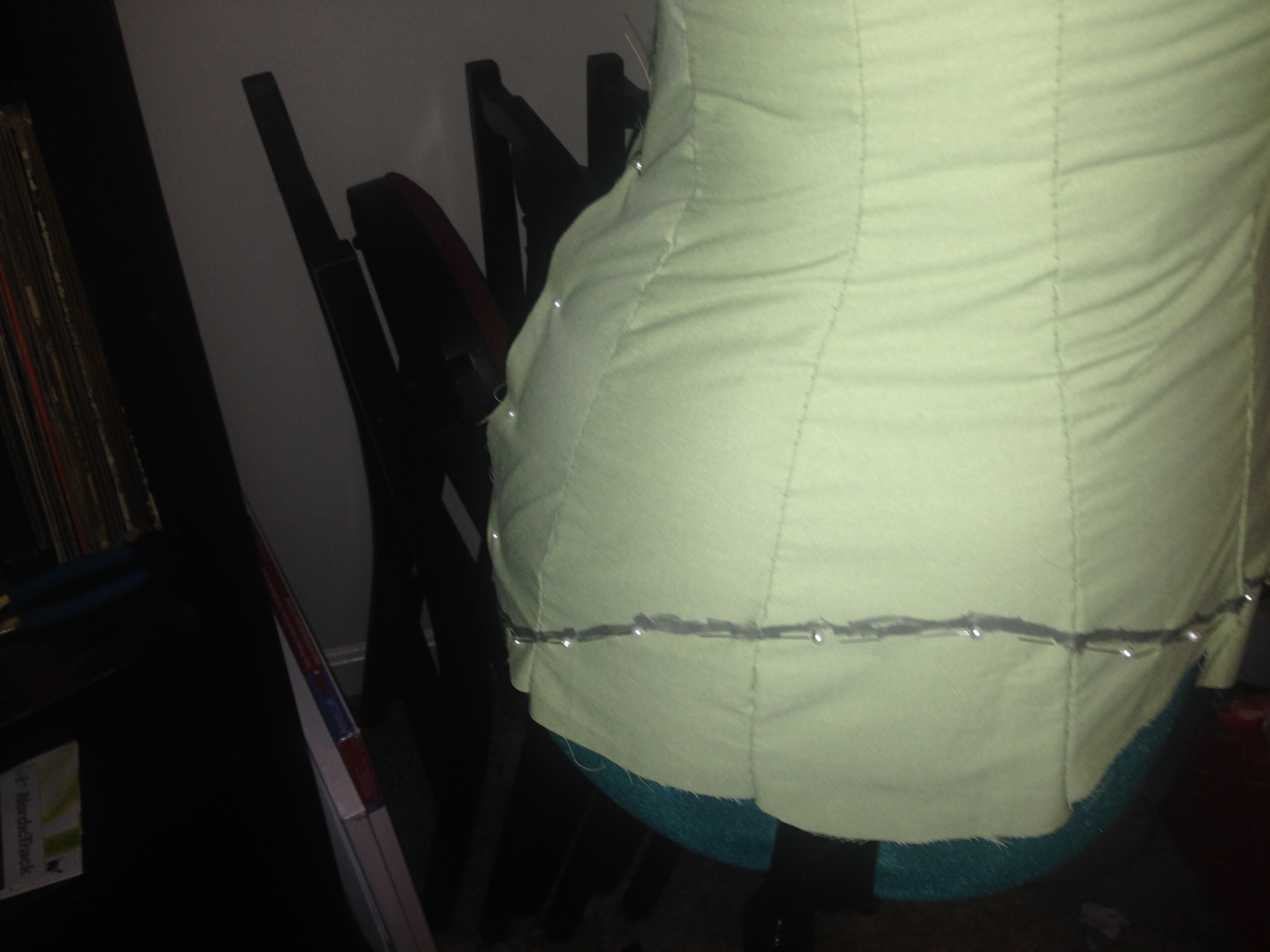

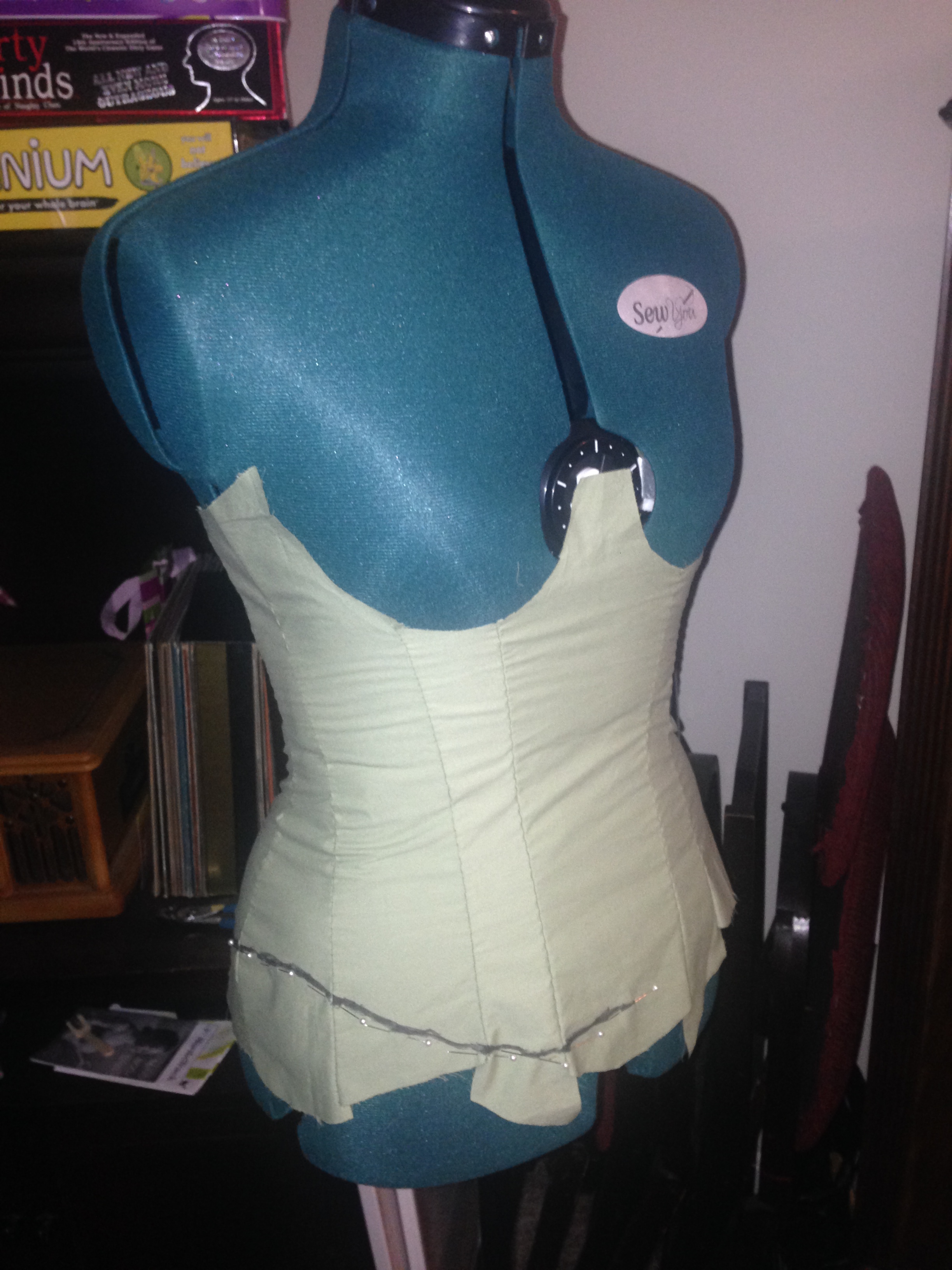

Okay so a lot of work has been going on this past week and weekend. I made a mock of the corset to design the bottom of it to work with the skirt

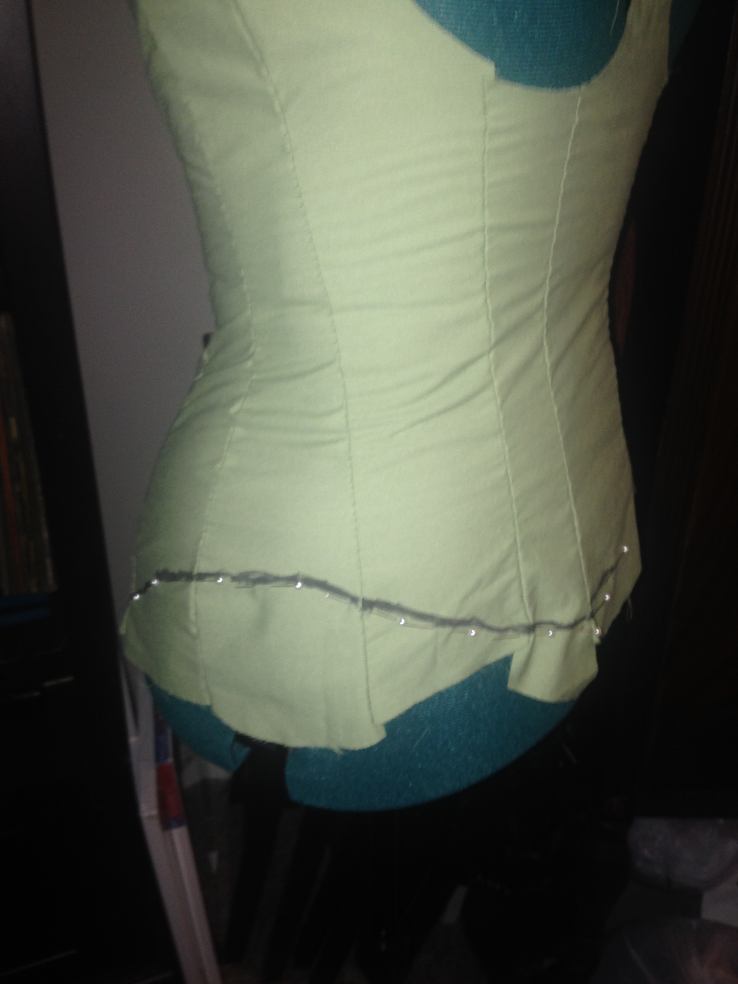

Once that was done and figured out I created the lining of the corset to make sure everything worked and would fit. Luckily it did and came out just perfect.

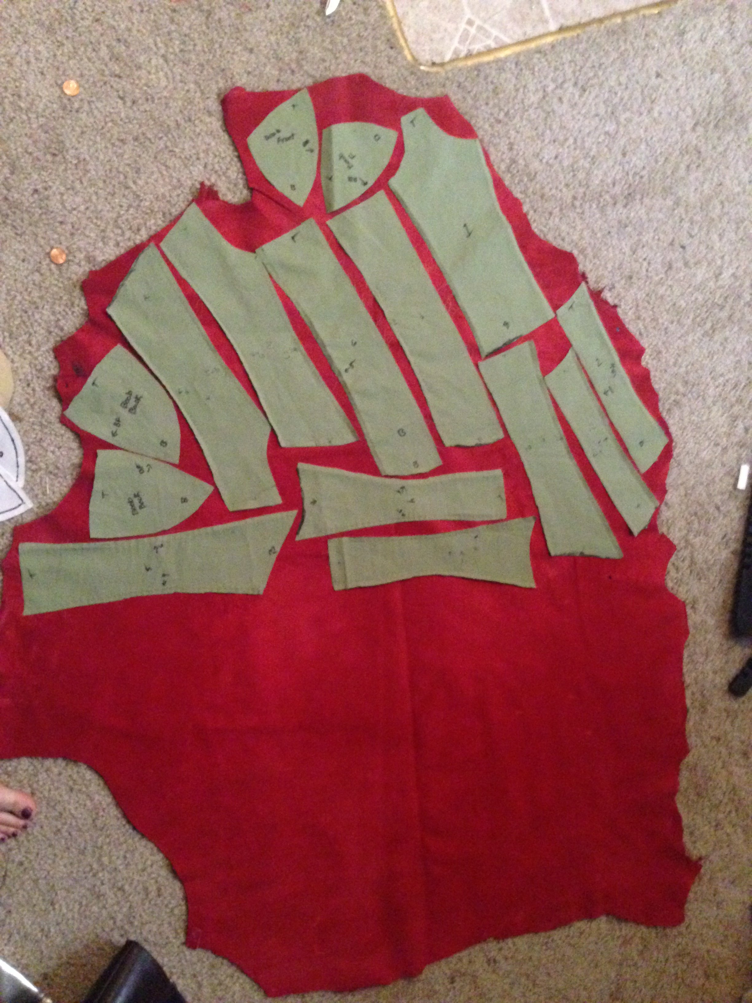

Tonight and the rest of the week is dedicated to the scary task of cutting and sewing the leather :unsure

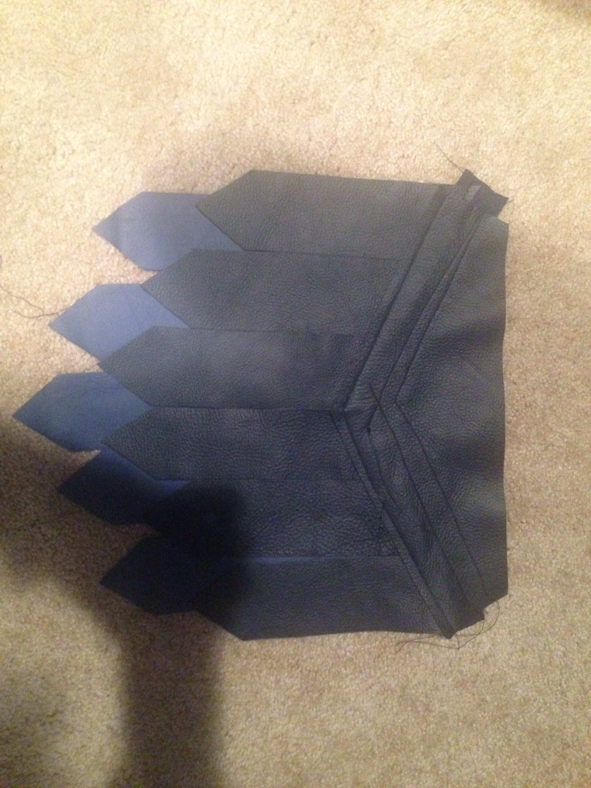

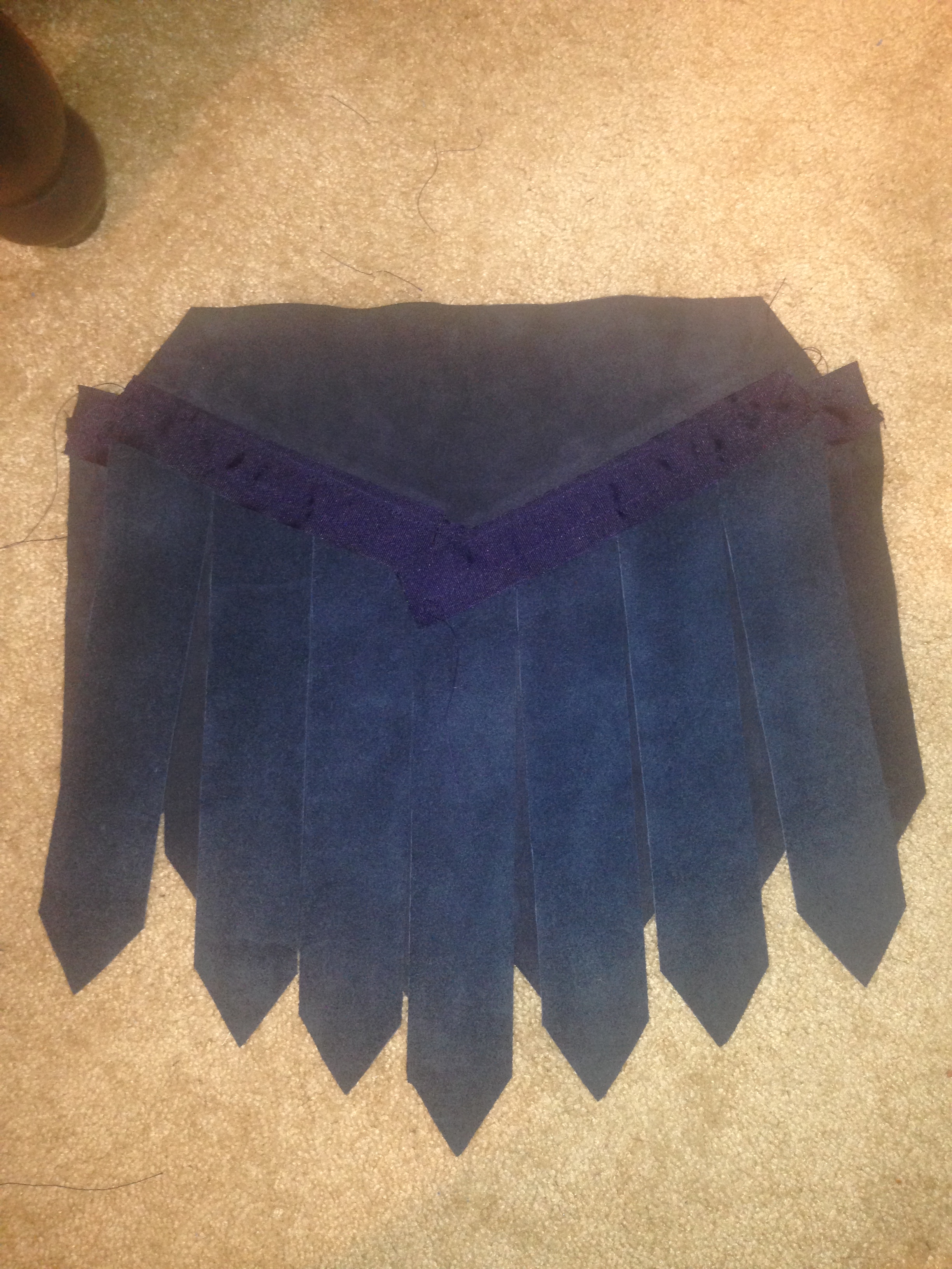

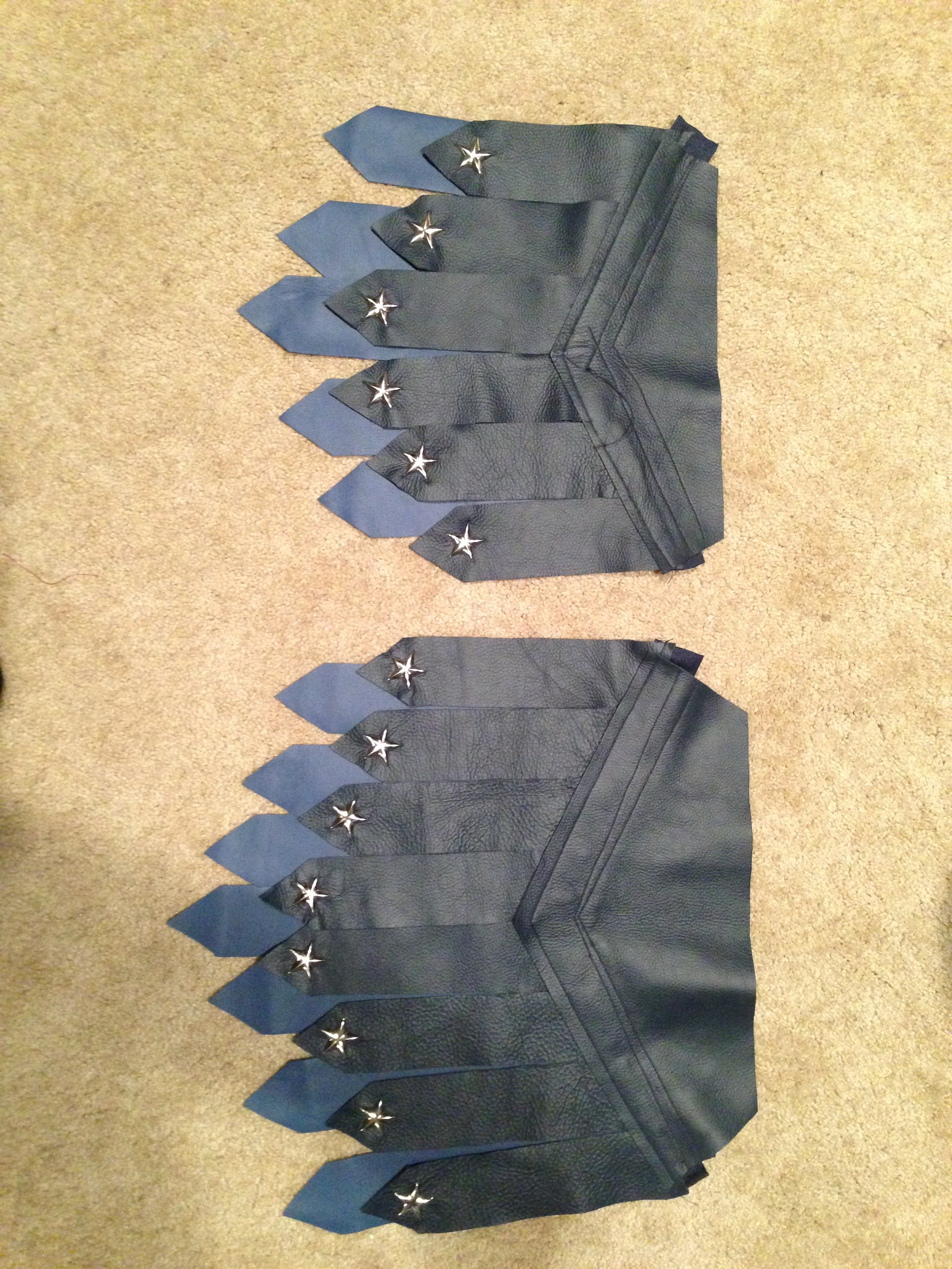

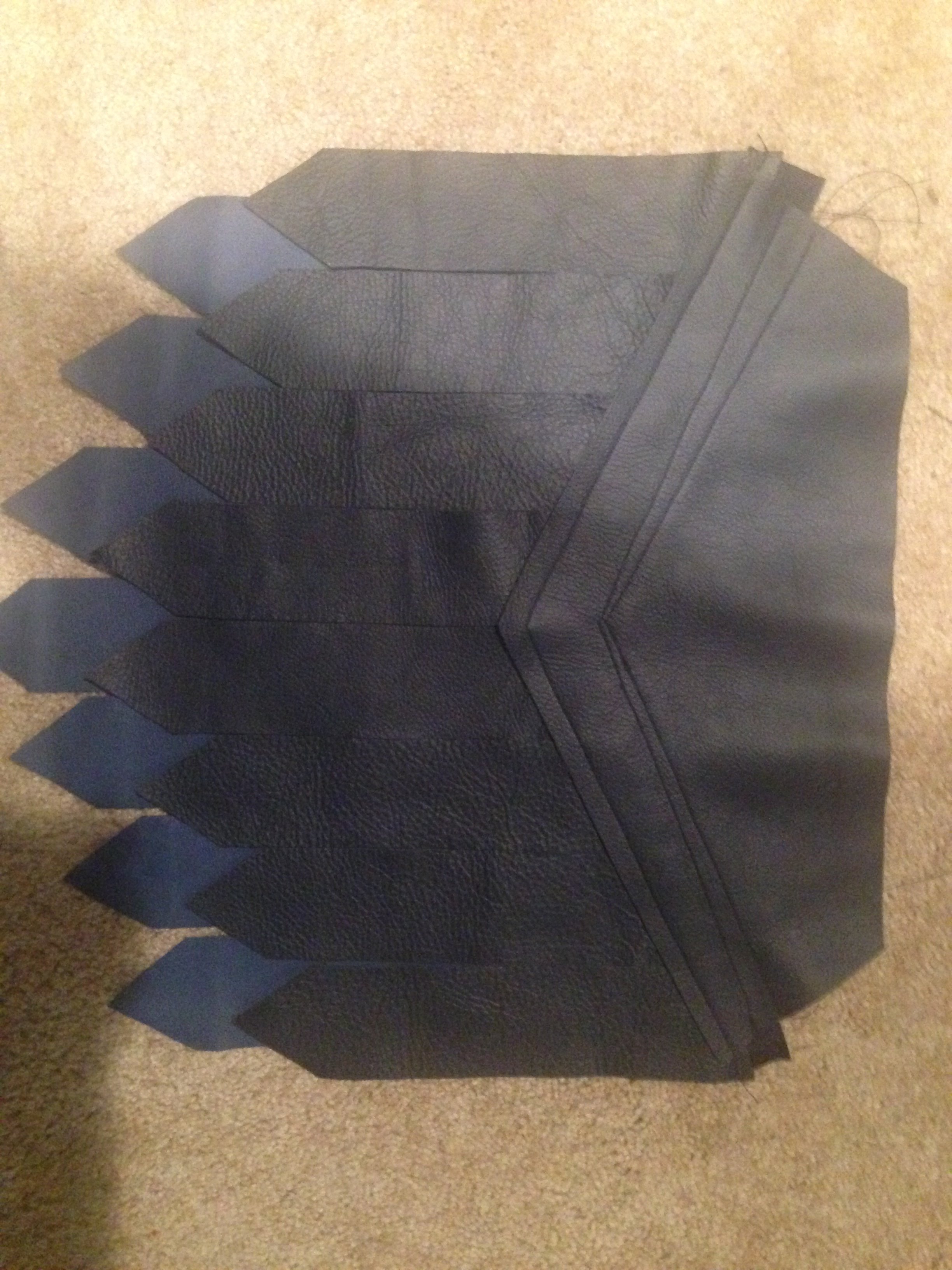

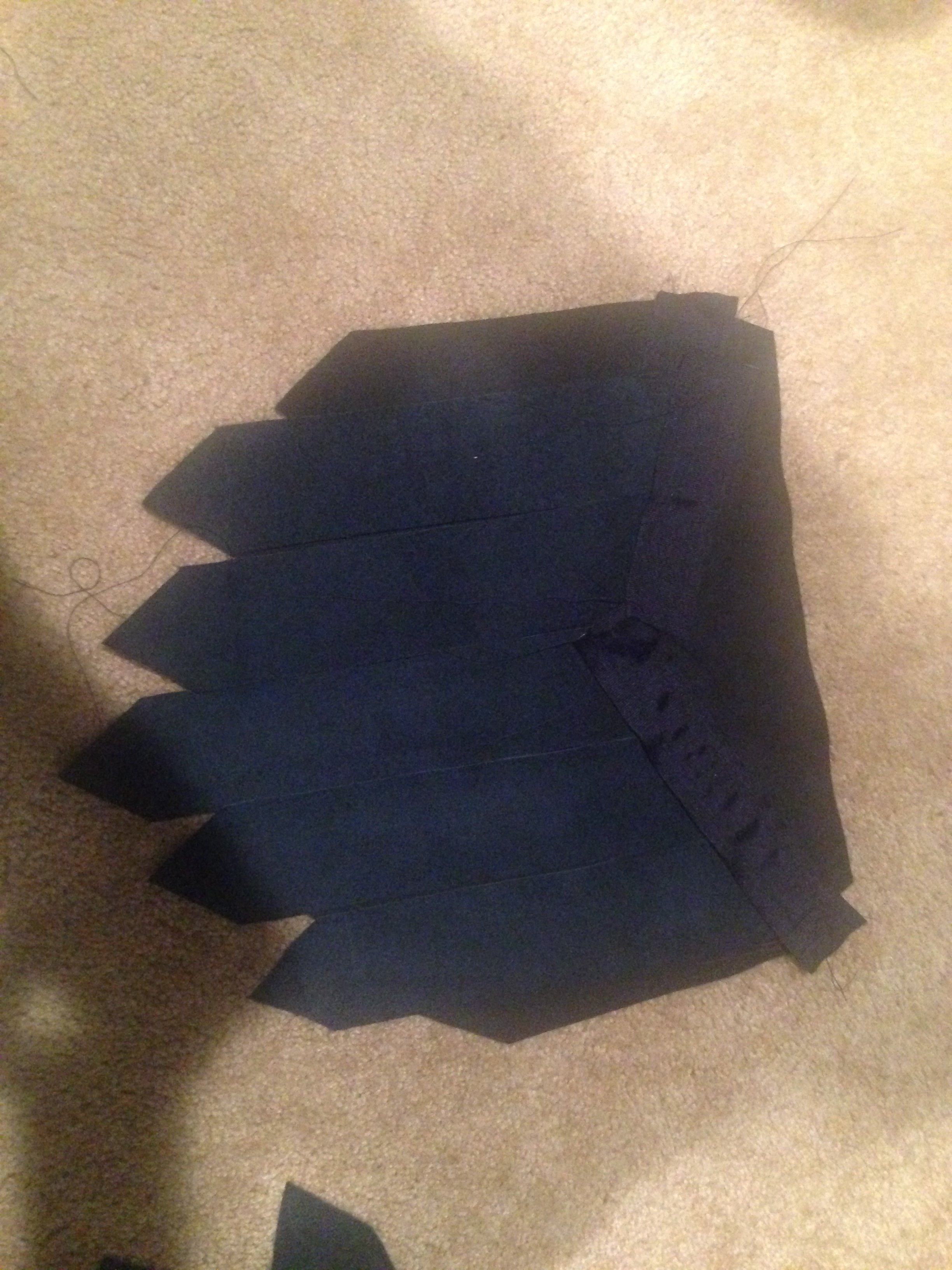

As promised there has been a lot of work in just the pass few day on building the leather pieces for Wonder Woman. Had some issues with the sewing machine not working, but got it fixed to a point that it sewed pretty well. So last night I finished sewing the skirt. All I have left on it is some hand sewing and adding the hard wear (grommets and stars)
front and back skirt.JPGfront leather skirt.JPGback leather skirt.JPGunderside front.JPGunderside back.JPG
love how the stitching turned out on the back, wish it would of done the same on the front piece but that's the piece I discovered I was having a few issues with my sewing machine.

OK so almost had the red leather of the corset finished but accidently flipped sides of two on the pieces so spent half the night ripping out seams and re-cutting a few pieces. But I also go a bit of the hardware done on the skirt.

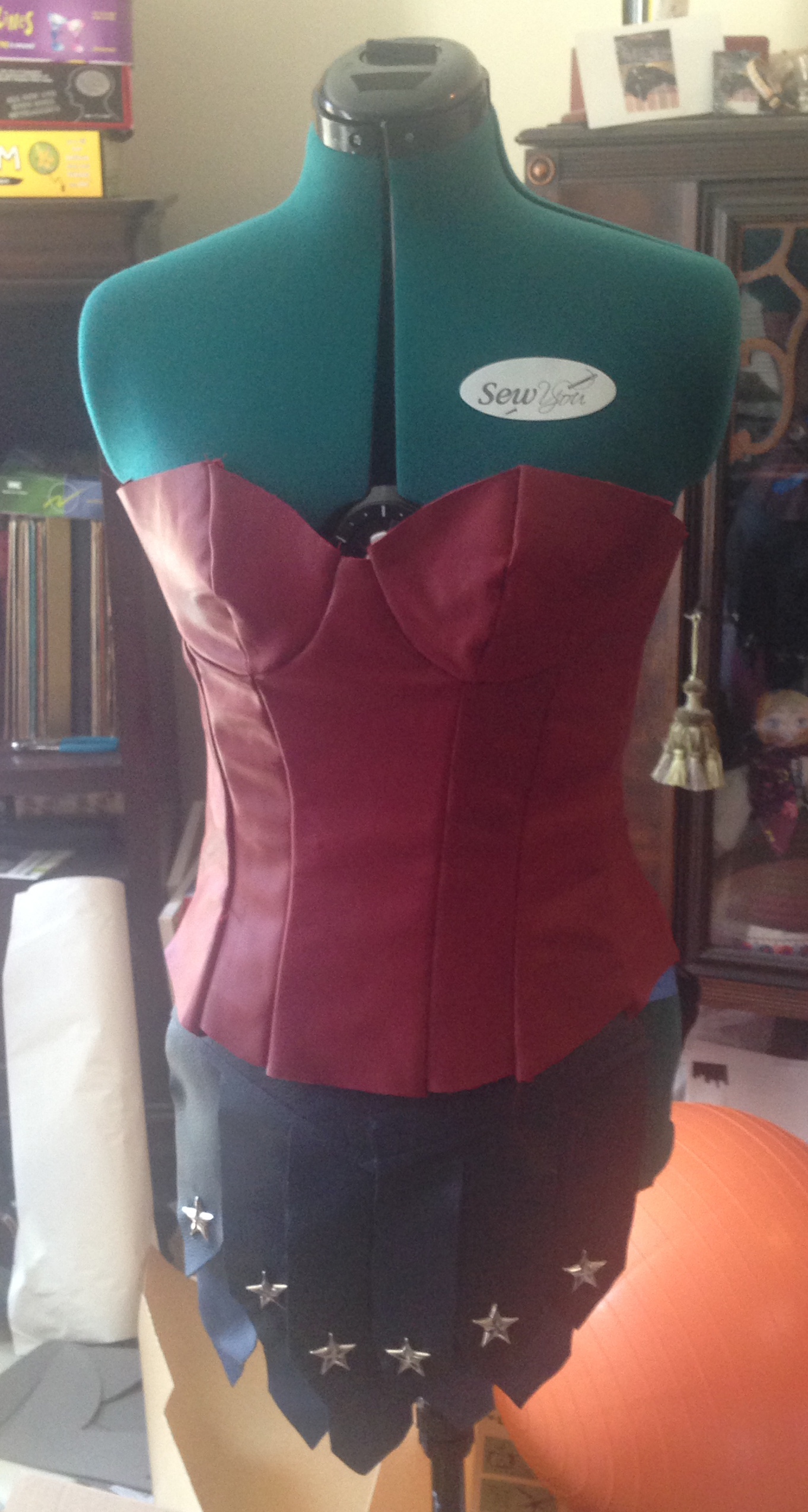

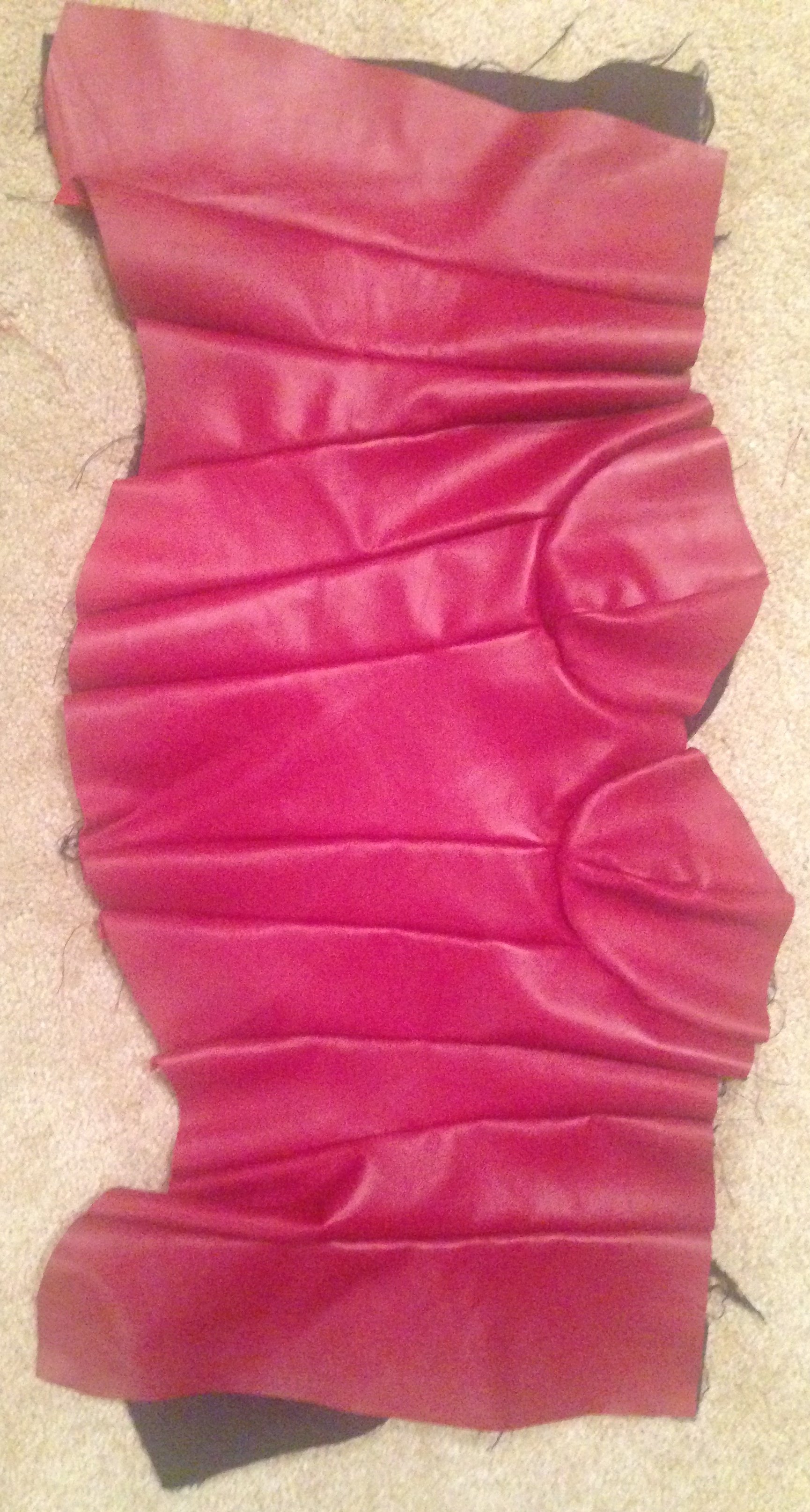

Been a busy bee this week with the sewing. Finished putting the red leather together for the corset, all I have to do now is sew the lining to the leather make the channels for the steel boning and put it all together. I am also looking to maybe have all the key pieces done for Awesome Con cosplay competition here in DC in 15 days, wish me luck :)

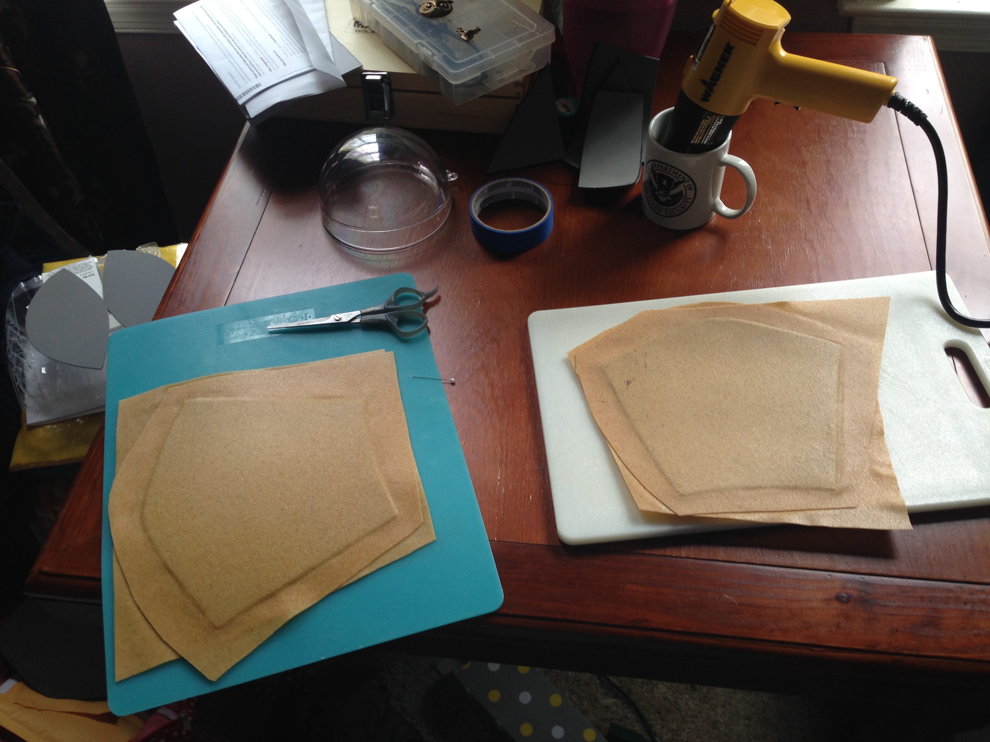

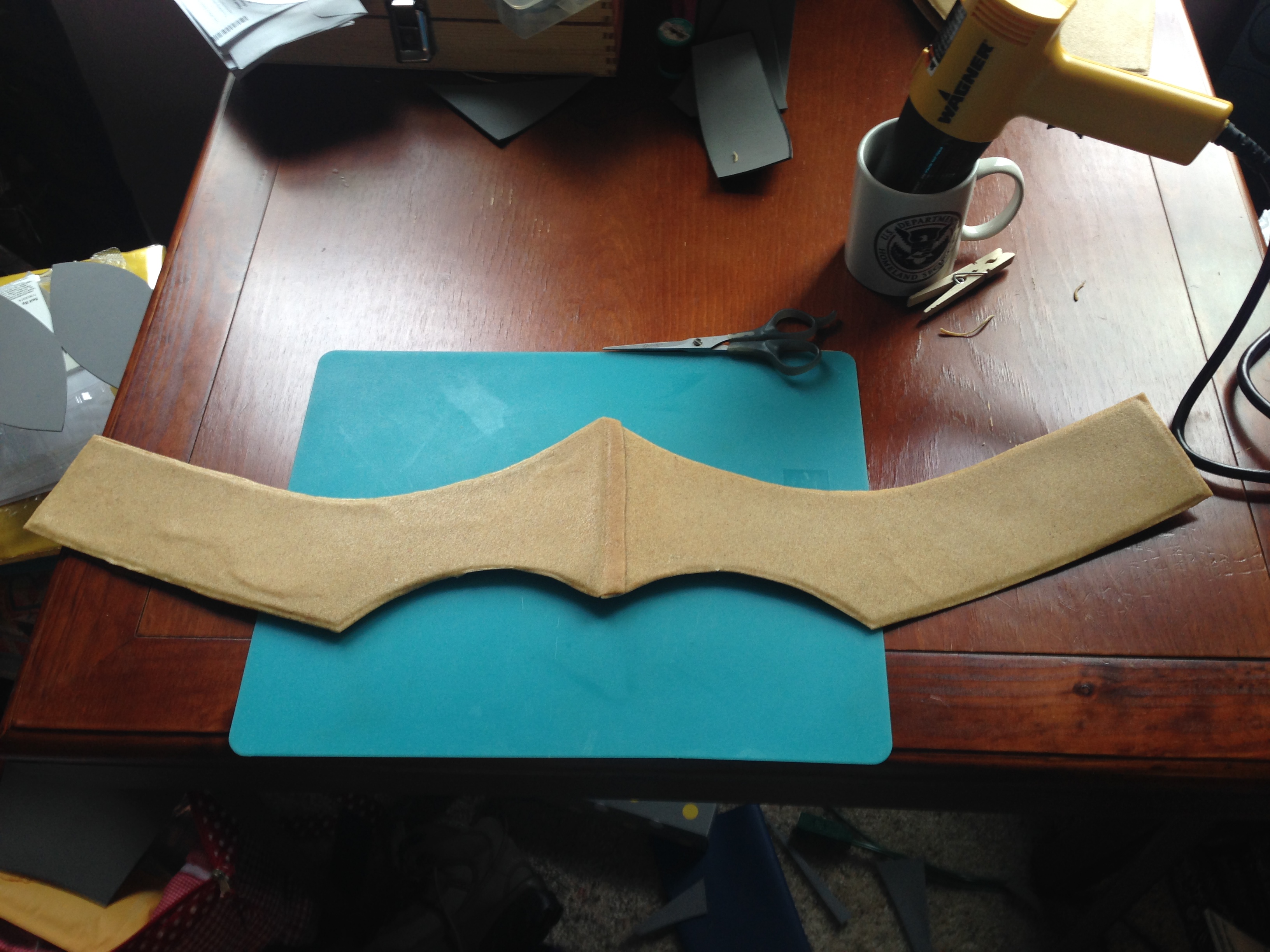

This weekend I spent building the armor out of Worbla.

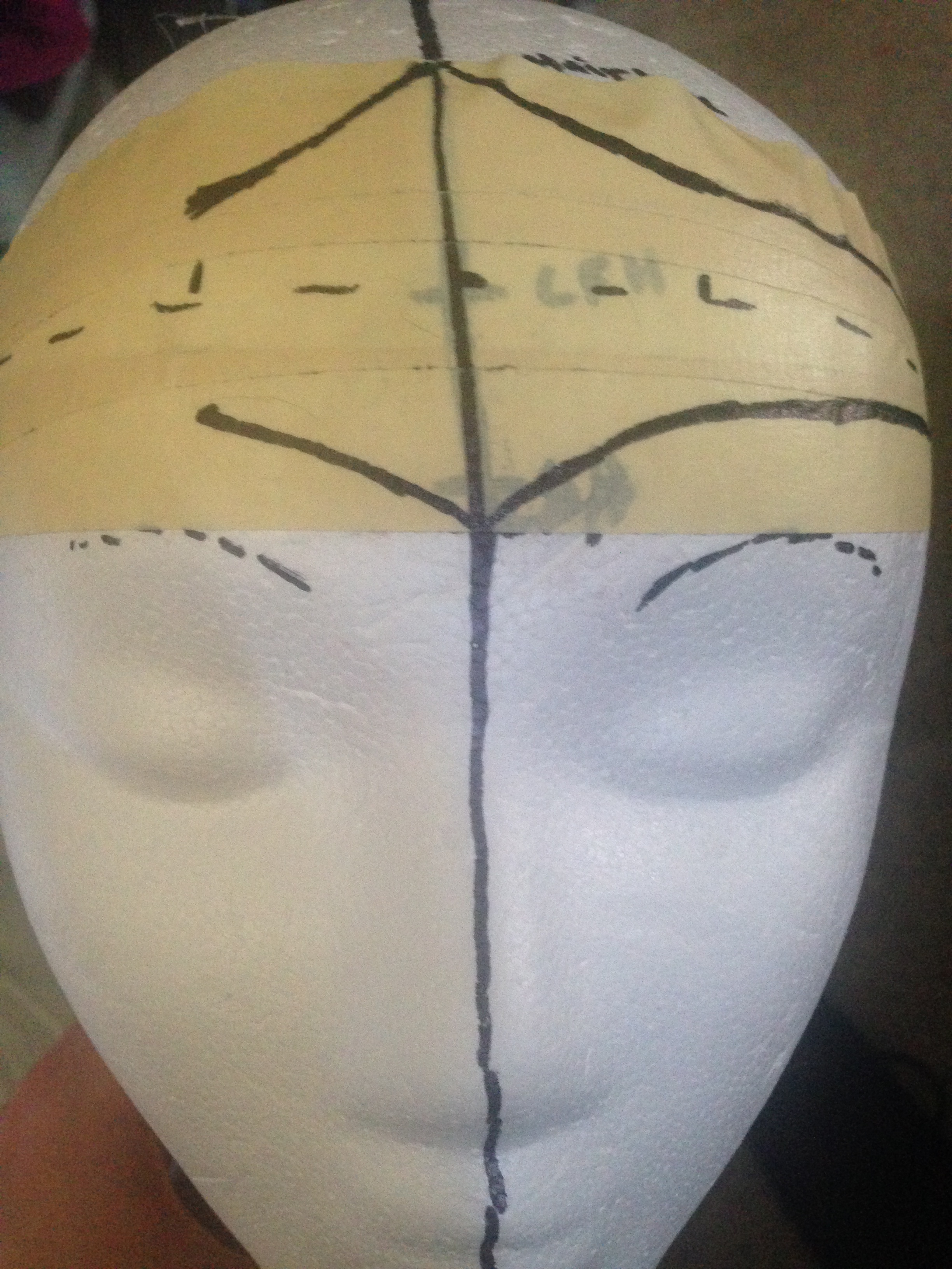

Step 1: Make patterns for all the armor pieces

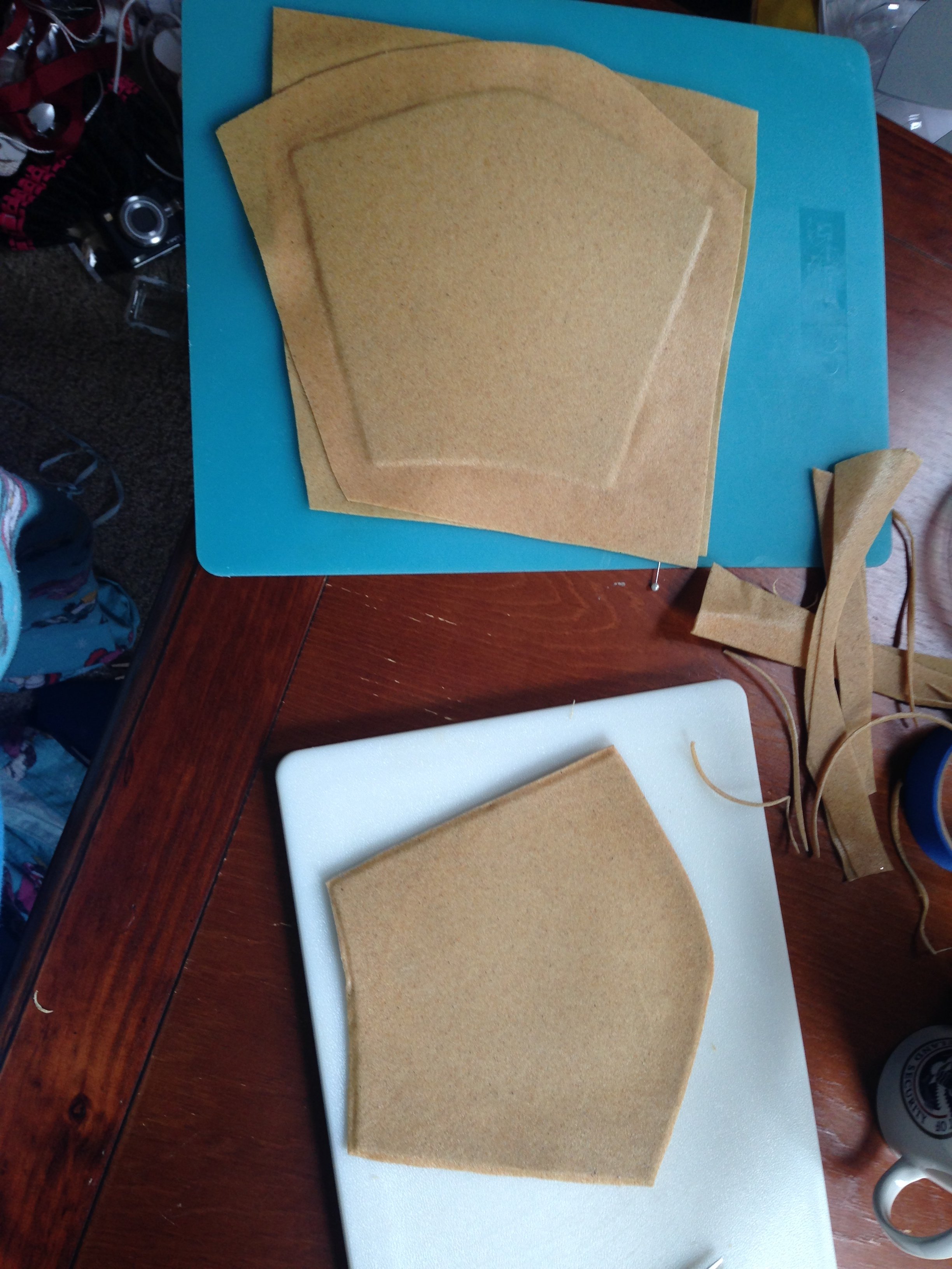

Step 2: I cut the actual sizes of the armor pieces out of craft foam to be sandwiched between two pieces of Worbla a little larger then the craft foam
Step 3: I heated the Worbla with my heat gun to get it movable and sticky and the sandwiched the craft foam between the two layers

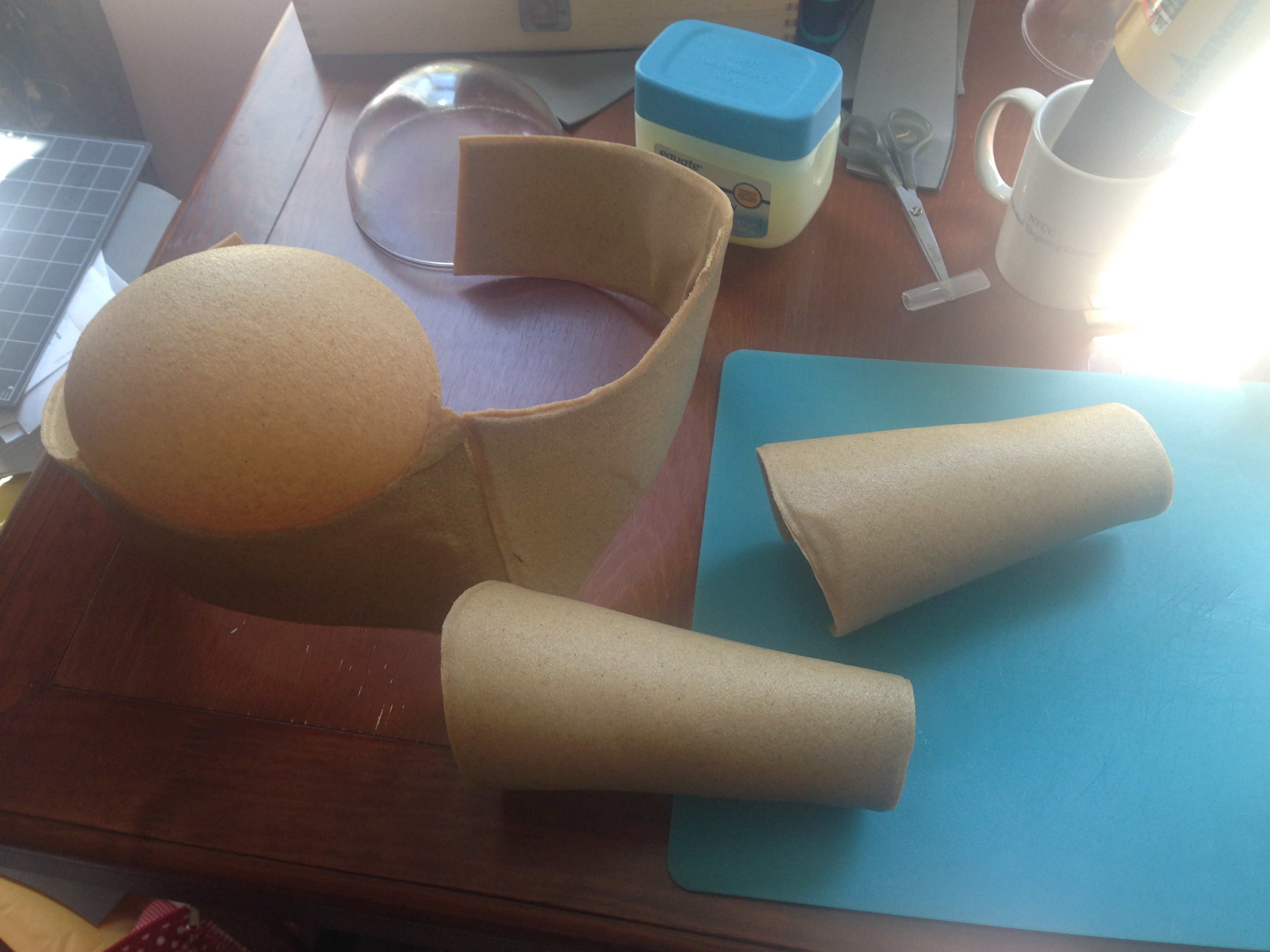

Step 4: I then trimmed the extra away

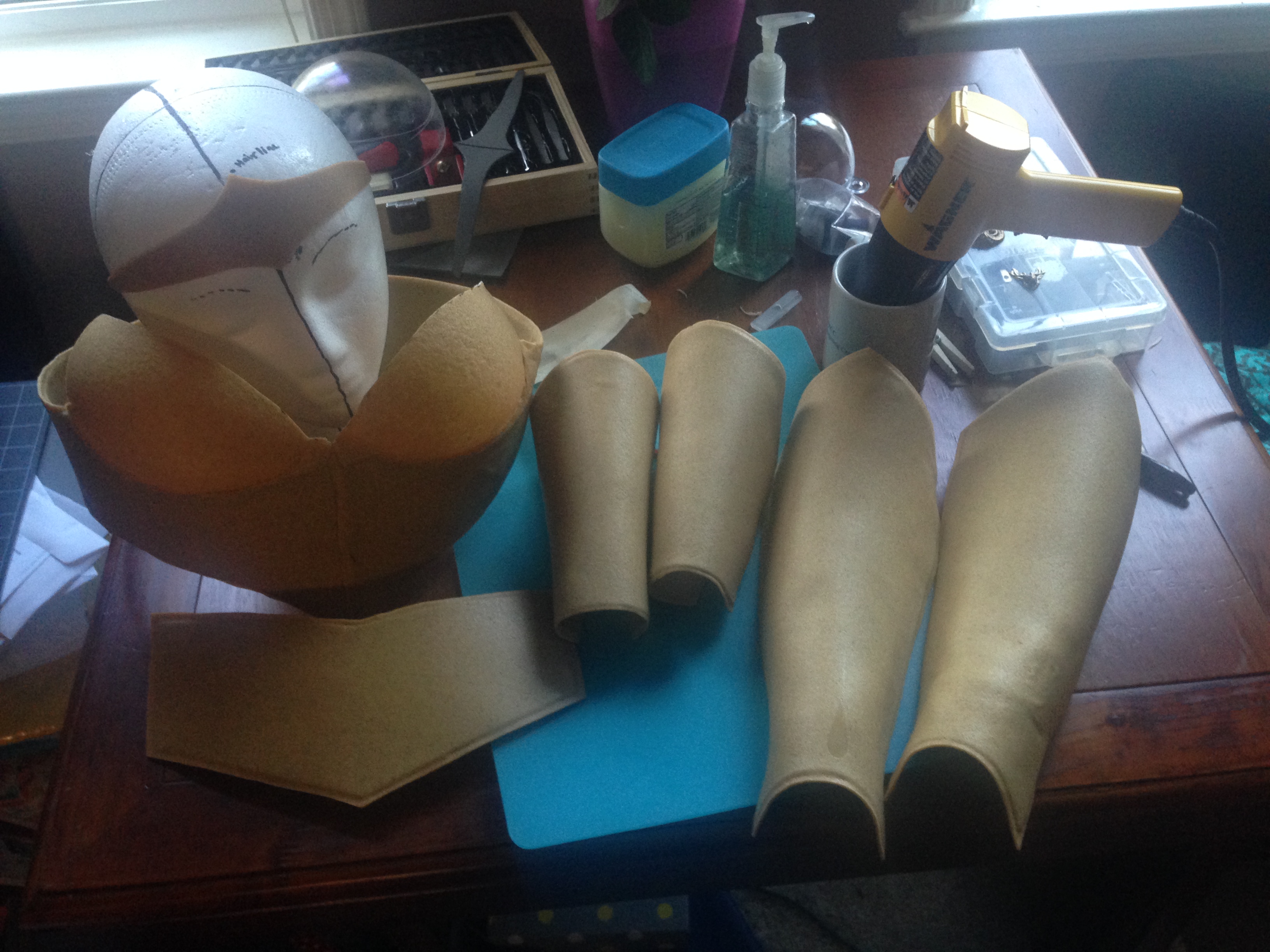

Step 5: I reheated the pieces and molded them to me to get a good fit. Warning; the Worbla gets very hot so to mold it to your body you need to had running cold water the run the pieces while wearing them under as soon as you get them molded to you. This keeps you from burning yourself and makes the plastic set up faster.
I now have all my pieces done and just need to do the detail work and paint.

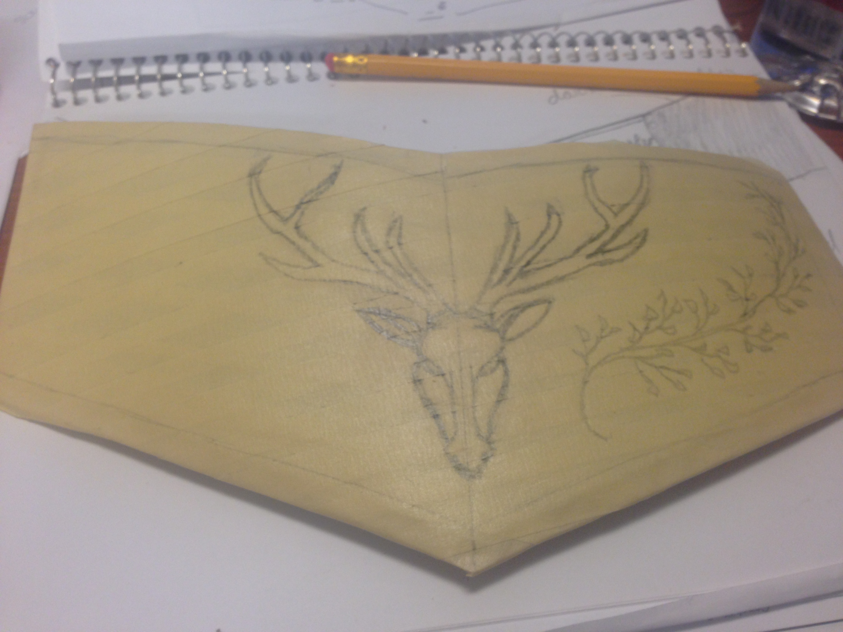

So it has been awhile since I have given and update. I have been crazy busy lately so haven't been able to spend much time working on WW. With that being said I have started adding detail to the armor; mainly just trimming the edges right now so they look nice. I have also started sketching out the very detail work on the belt and the bracers to be transferred onto the actual armor using transfer wax paper.
Here is design for the belt to be sculpted out of "friendly plastic"
