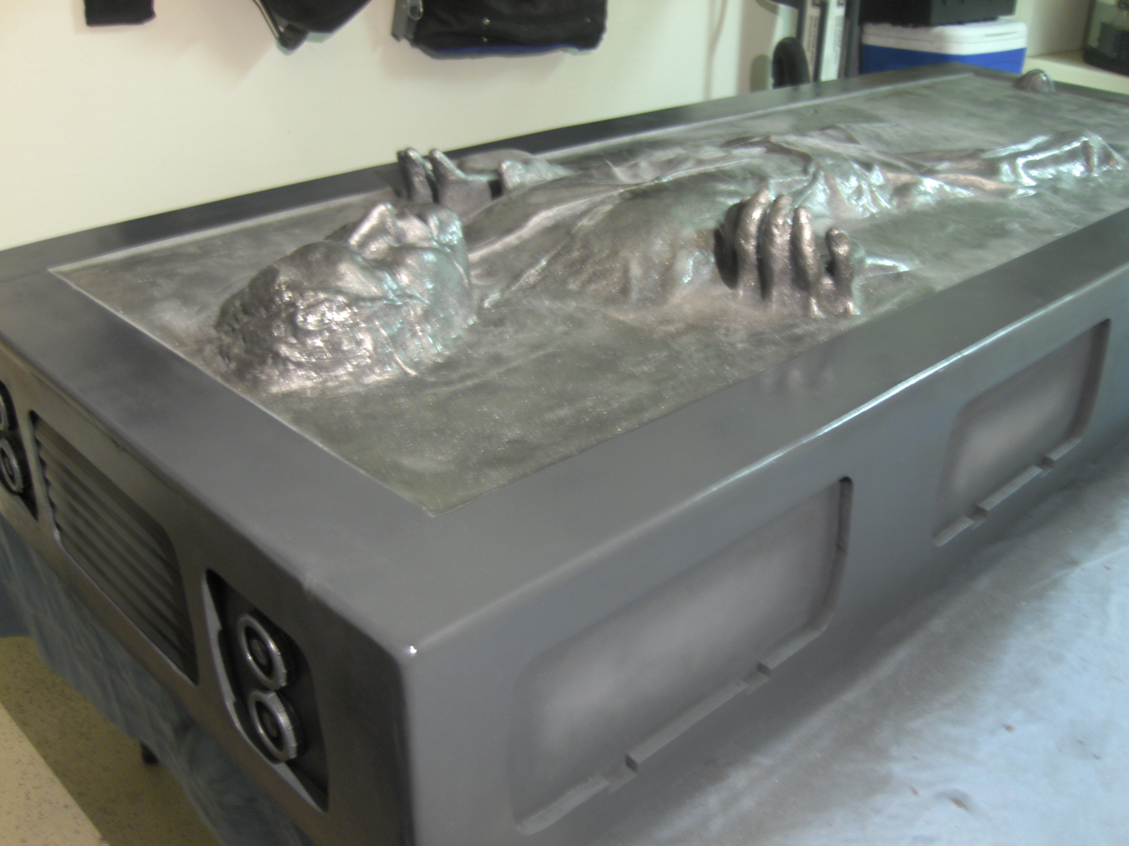

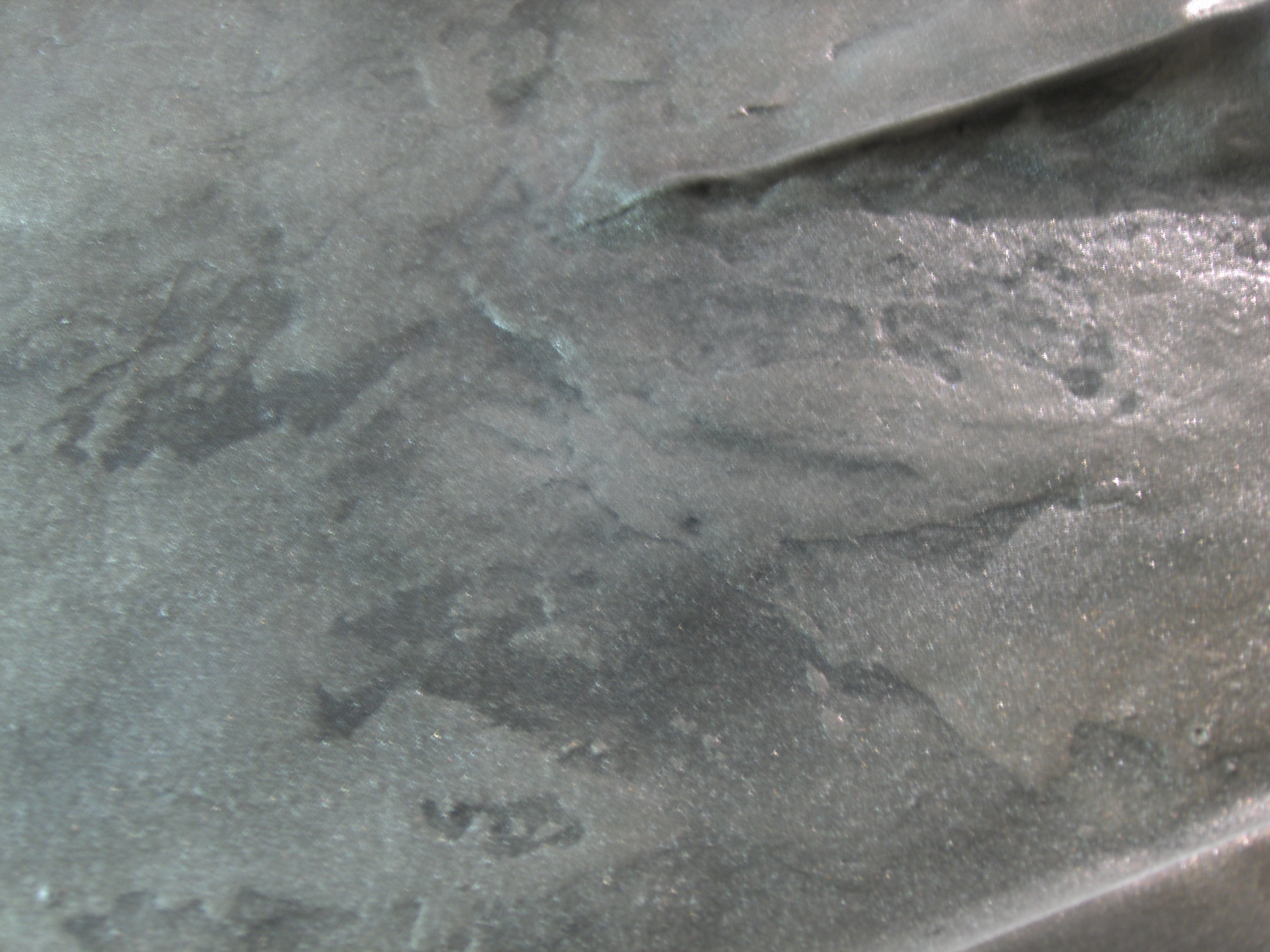

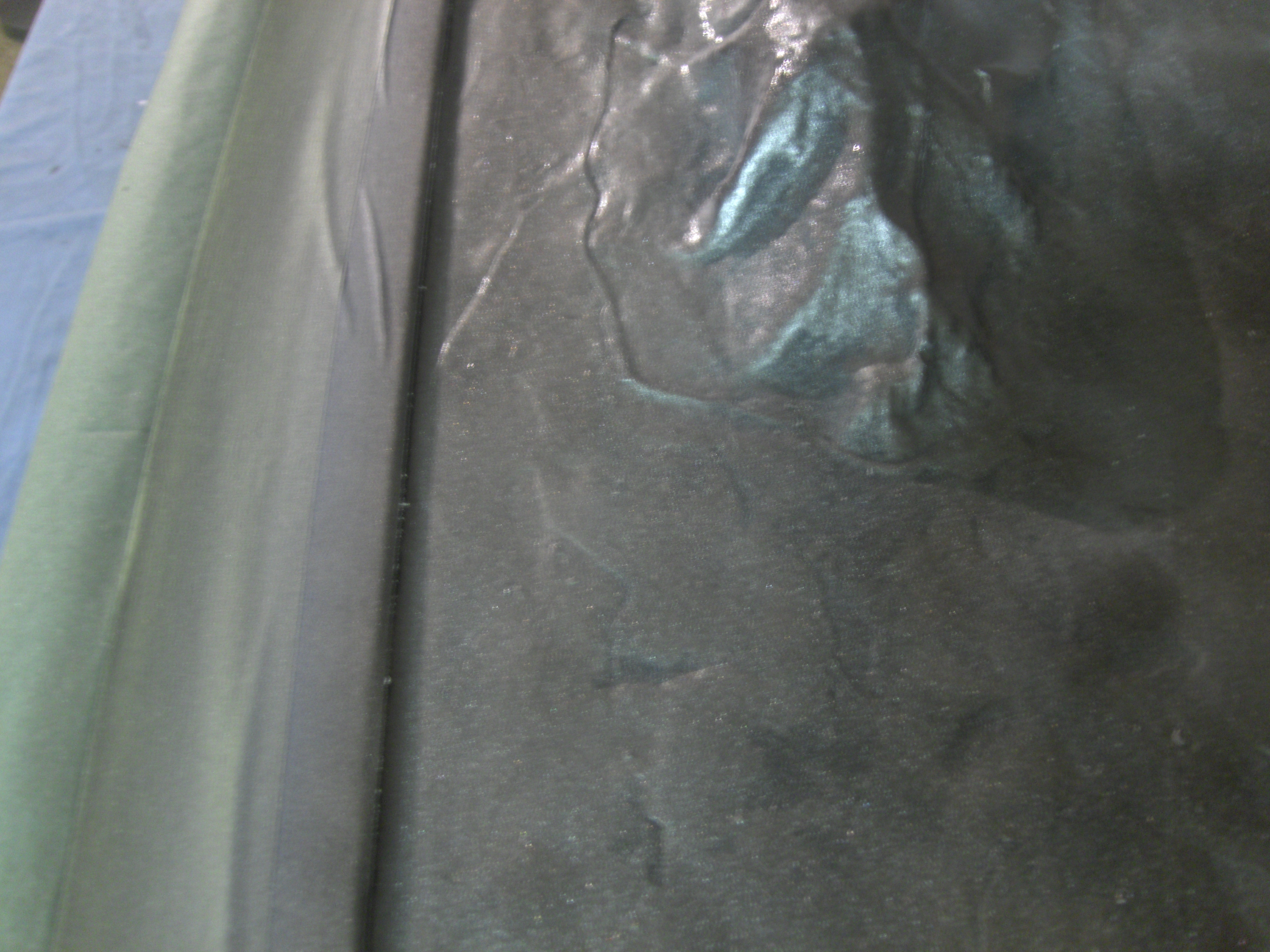

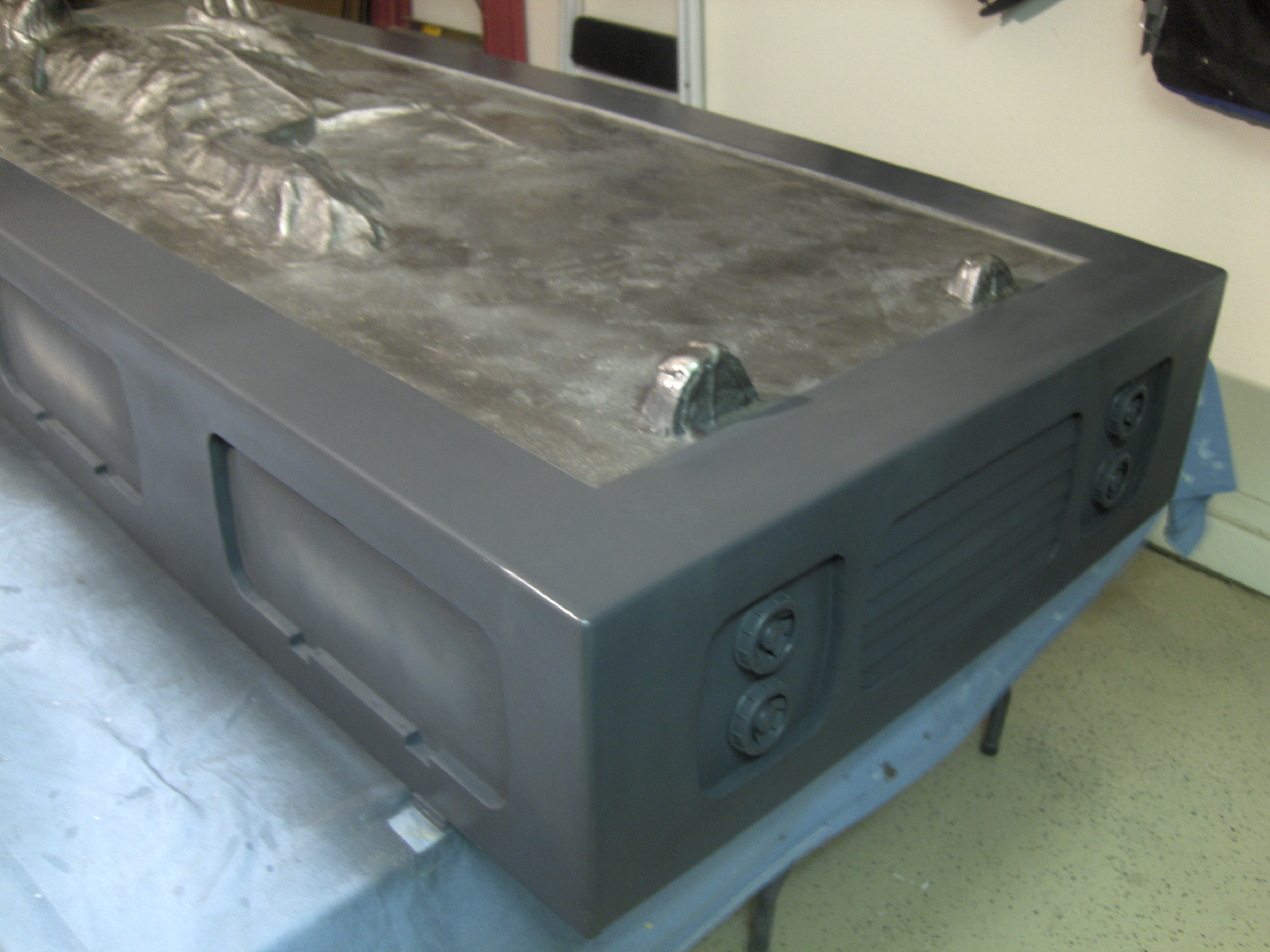

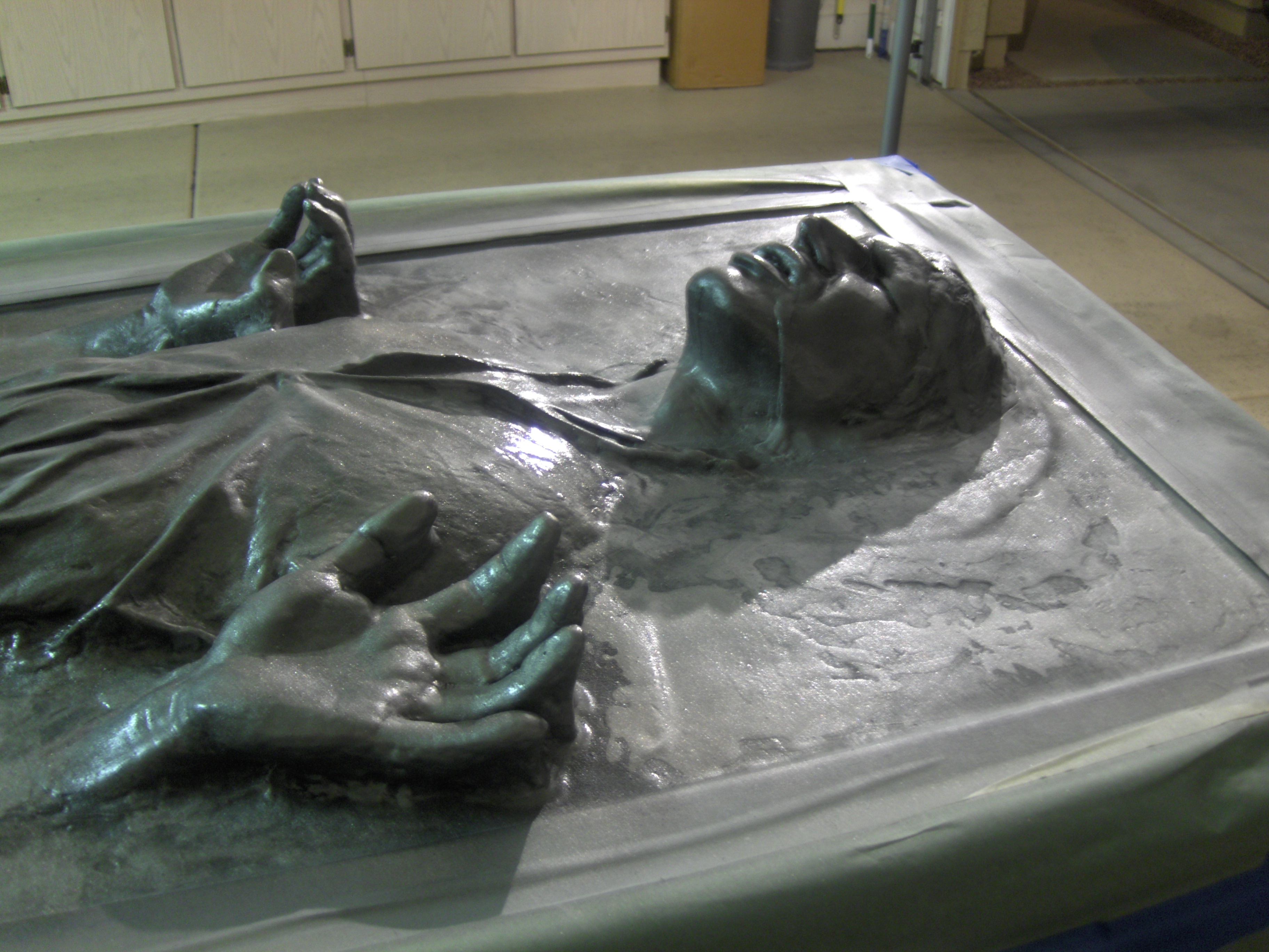

I did my light acrylic wash in black and a coat of clear gloss. I tried to take some close-up photos, they suck, but you get the idea.
I'll put another coat of gloss on then start mounting the panels.

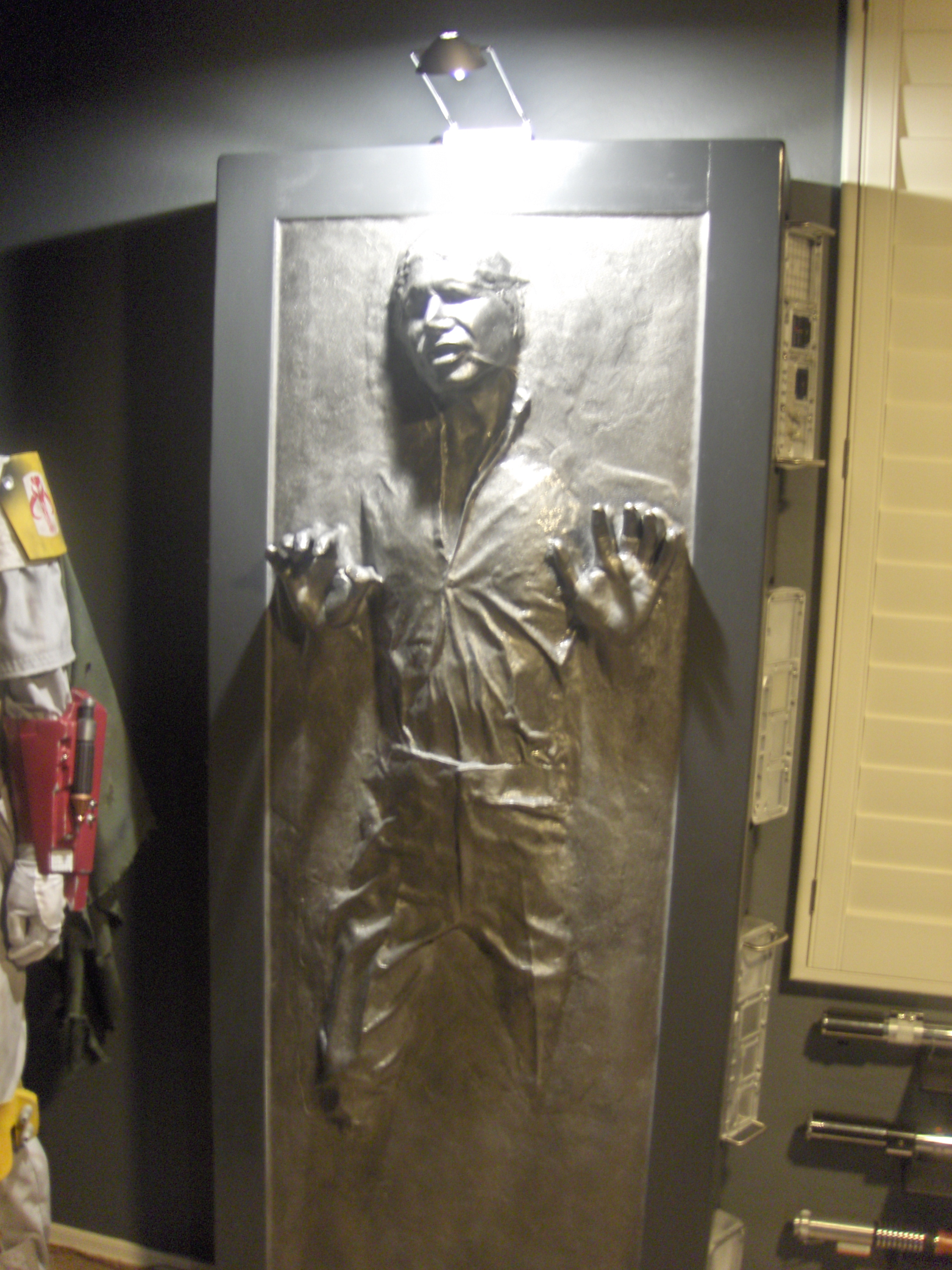

I finally finished the front panel. Put a triple coat of gloss on top and called it done. It was a painstaking process of trying to find the right colors to get the contrast I was looking for, but I have to say I couldn't be happier with how it turned out. I beat myself up over the colors, back and forth, but this is pretty much exactly what I hoped for.
The high gloss gray looks good on the cabinet. Pictures really don't do it justice, other than a few blemishes, it looks terrific in person.

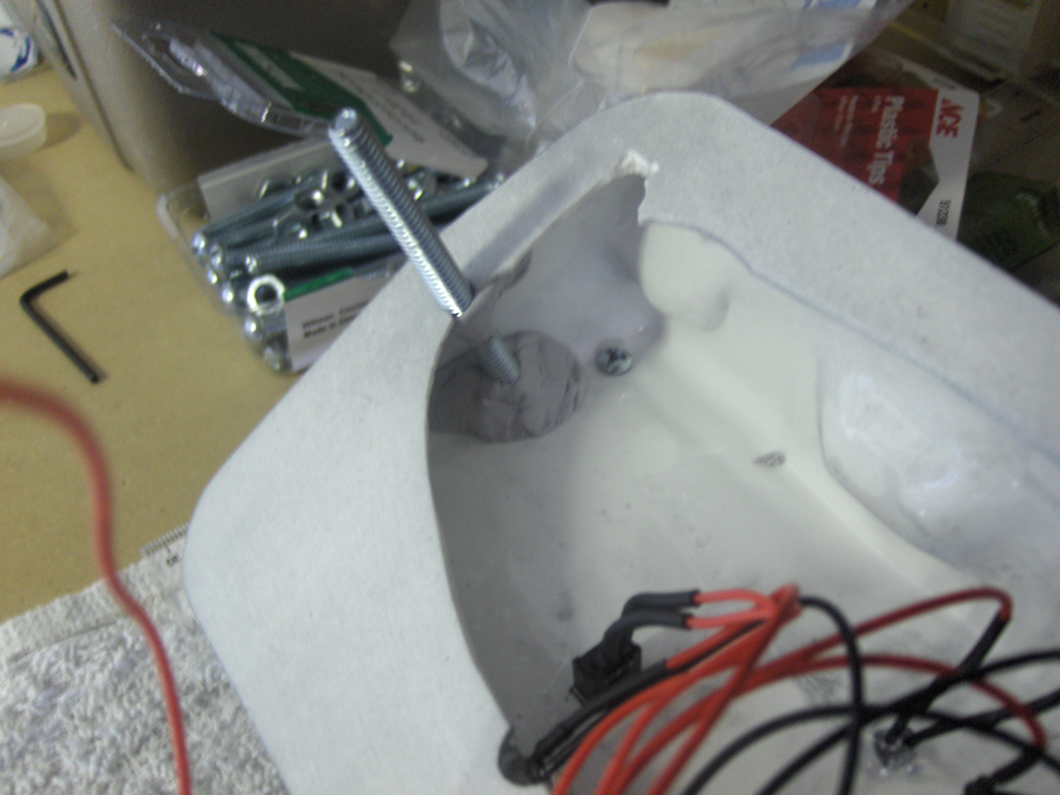

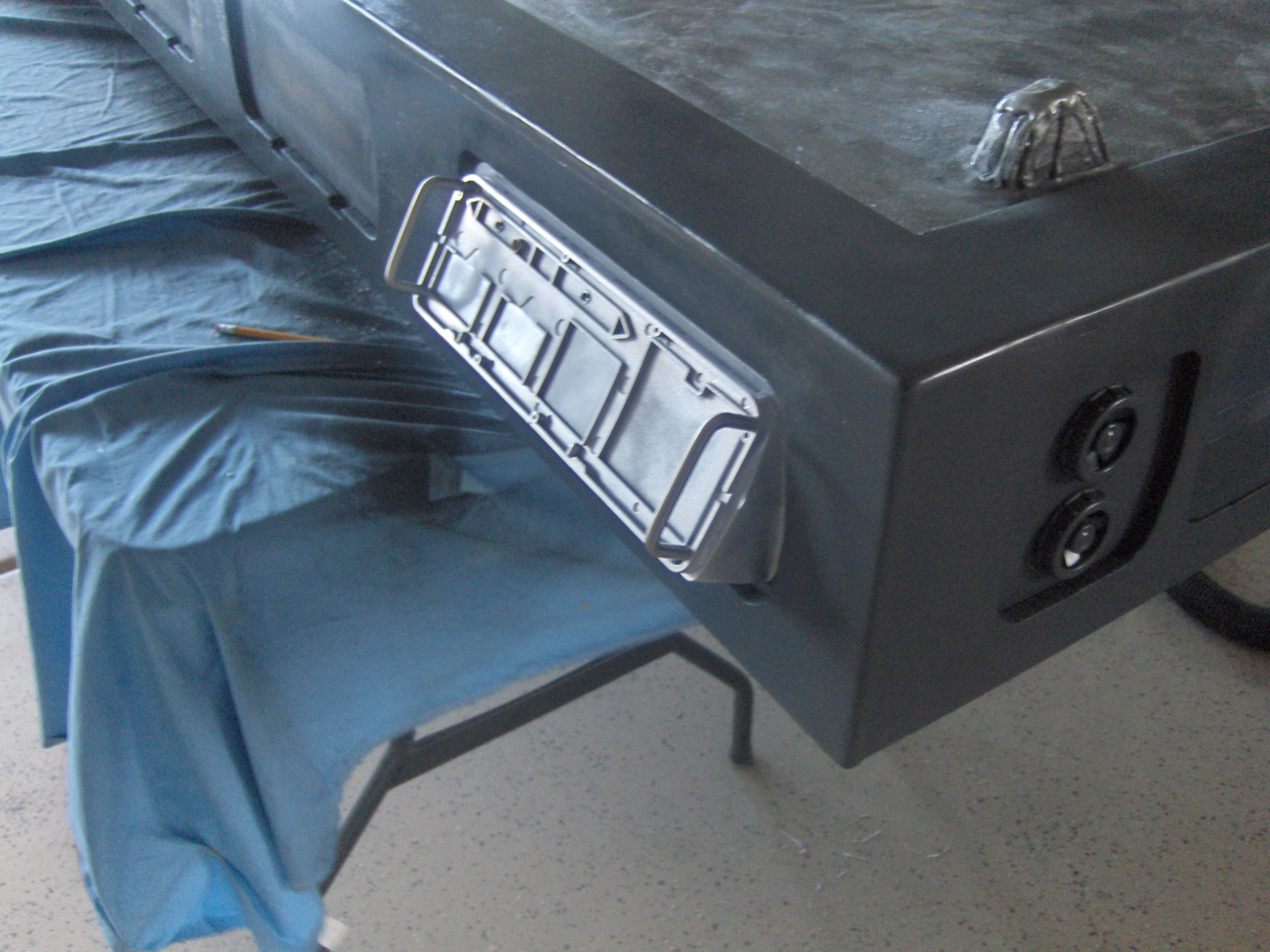

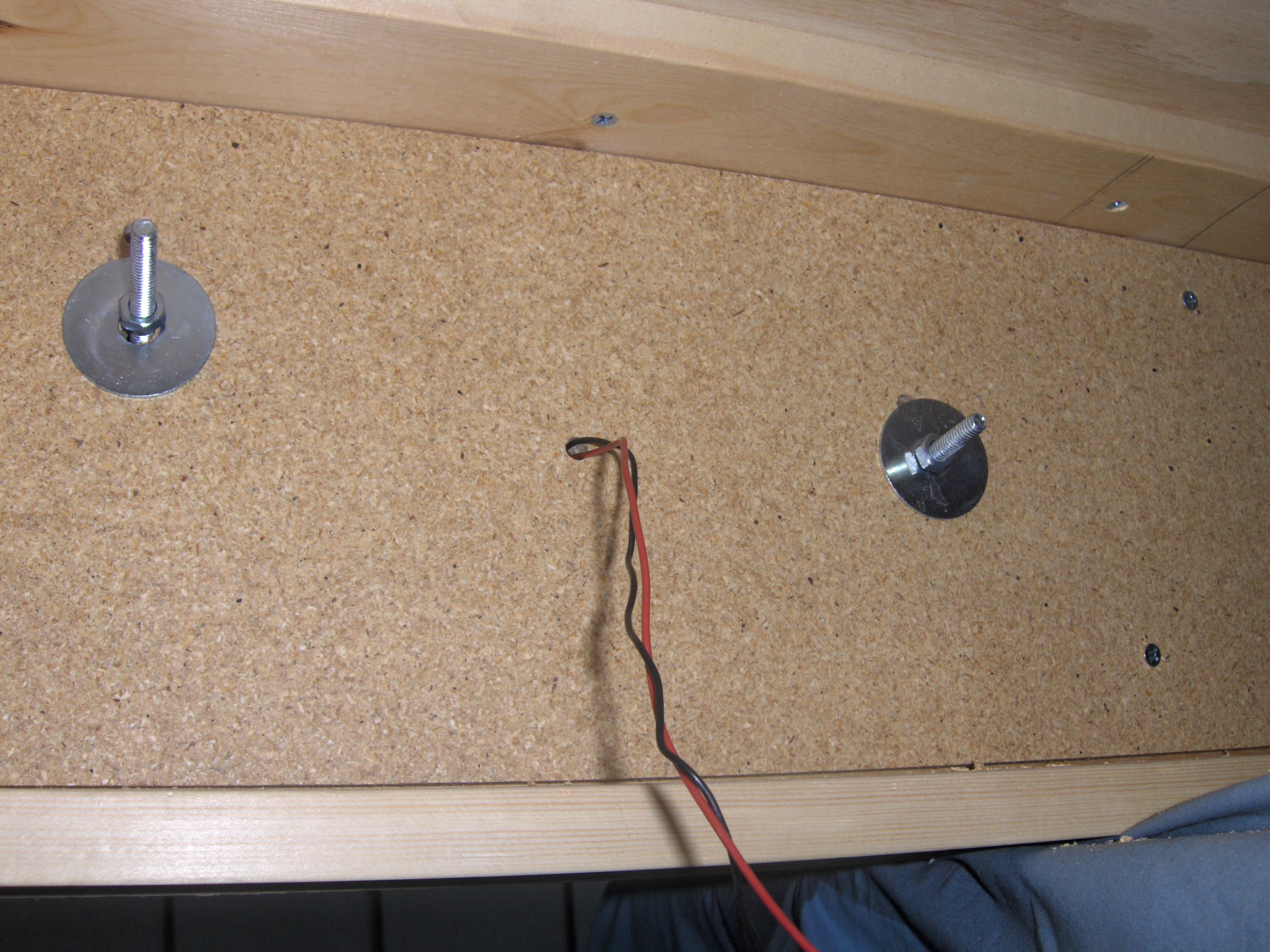

I started mounting the panels today. I wanted a way to mount these that wasn't permanent, that way I can take them off if I decide to move it or sell it. I used 1/2" x 3" bolts secured to the back of the panels with 5 minute epoxy putty, stuff is great, hard as a rock. I drilled holes for the bolts into the cabinet and secured them with a fender washer and nut. I also drilled a small hole to feed the wires through.
I added video of the main panel as well so you can see how it looks on the cabinet. I am very pleased with the contrast between the cabinet, side panels, and HIC front panel.

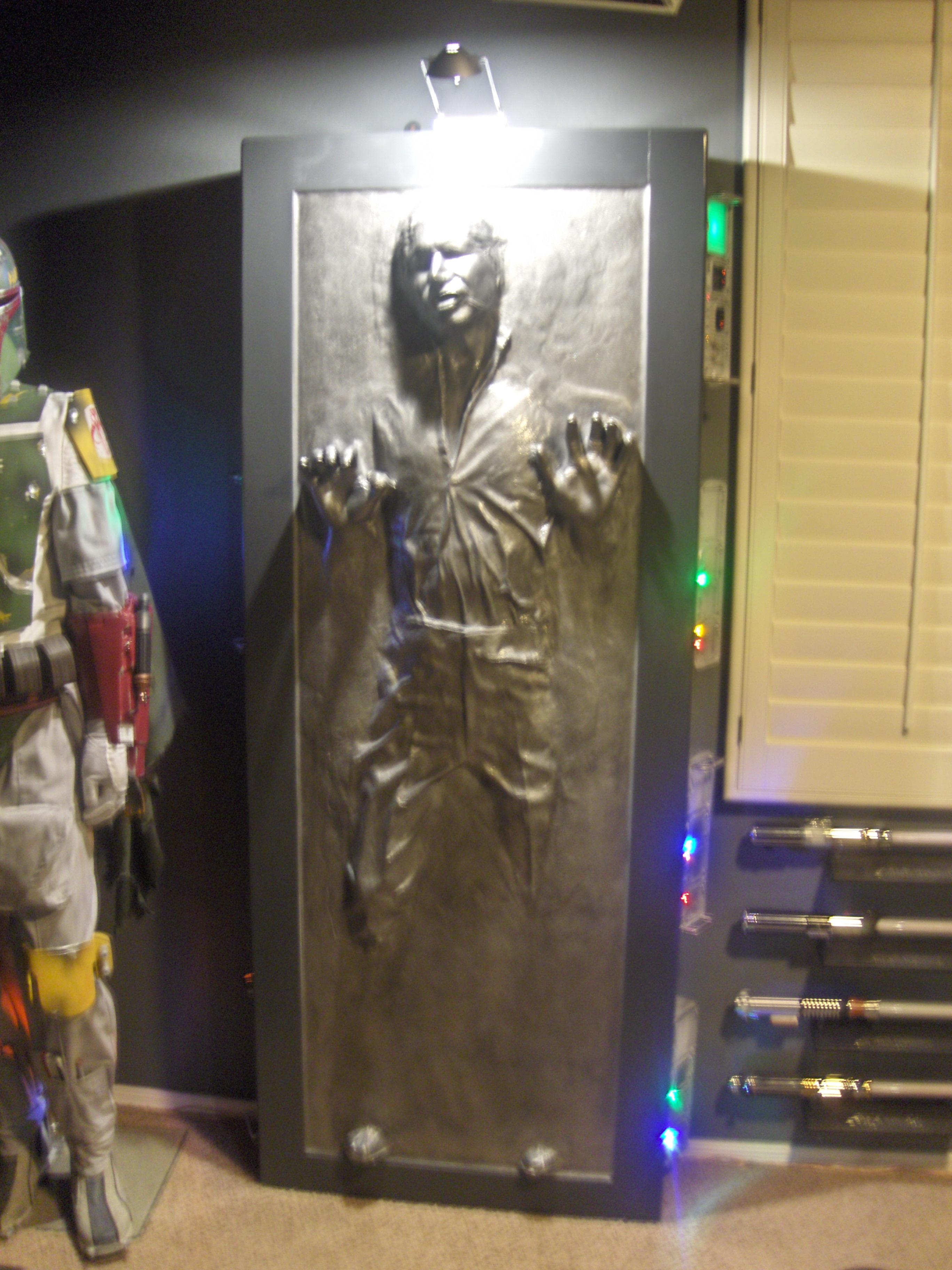

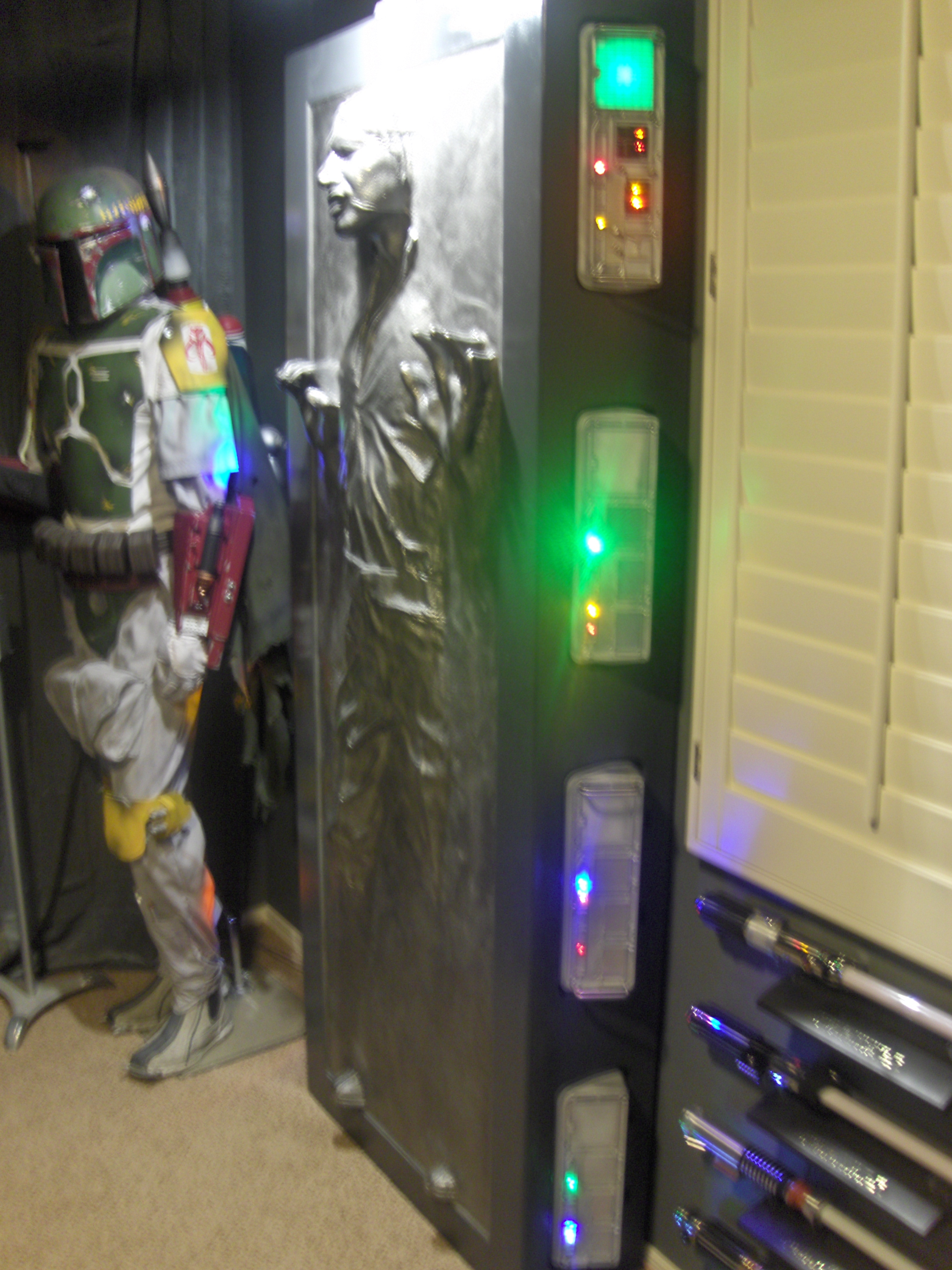

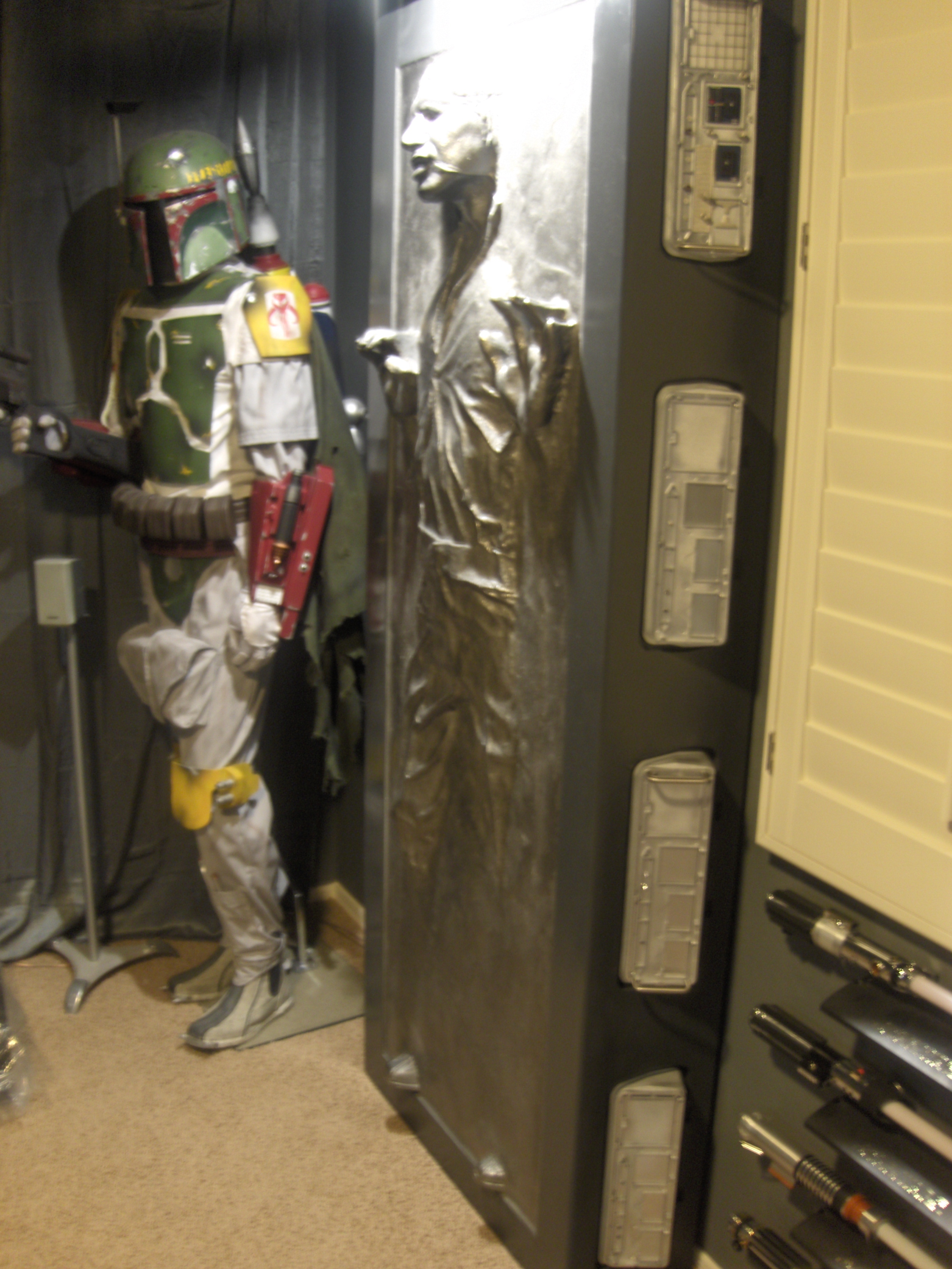

I was able to mount all the panels and wire all the LEDs, looks sort of like Christmas, but all those lights give the illusion something is working in there. One of these days I want to mount this to the wall.
I just need to give this a good wipe down, then add the panel greeblies and I'm done. I brought it inside the house where it is a little cooler.
Here are a few pics and the video. Sorry about the video quality, still trying to work this thing.

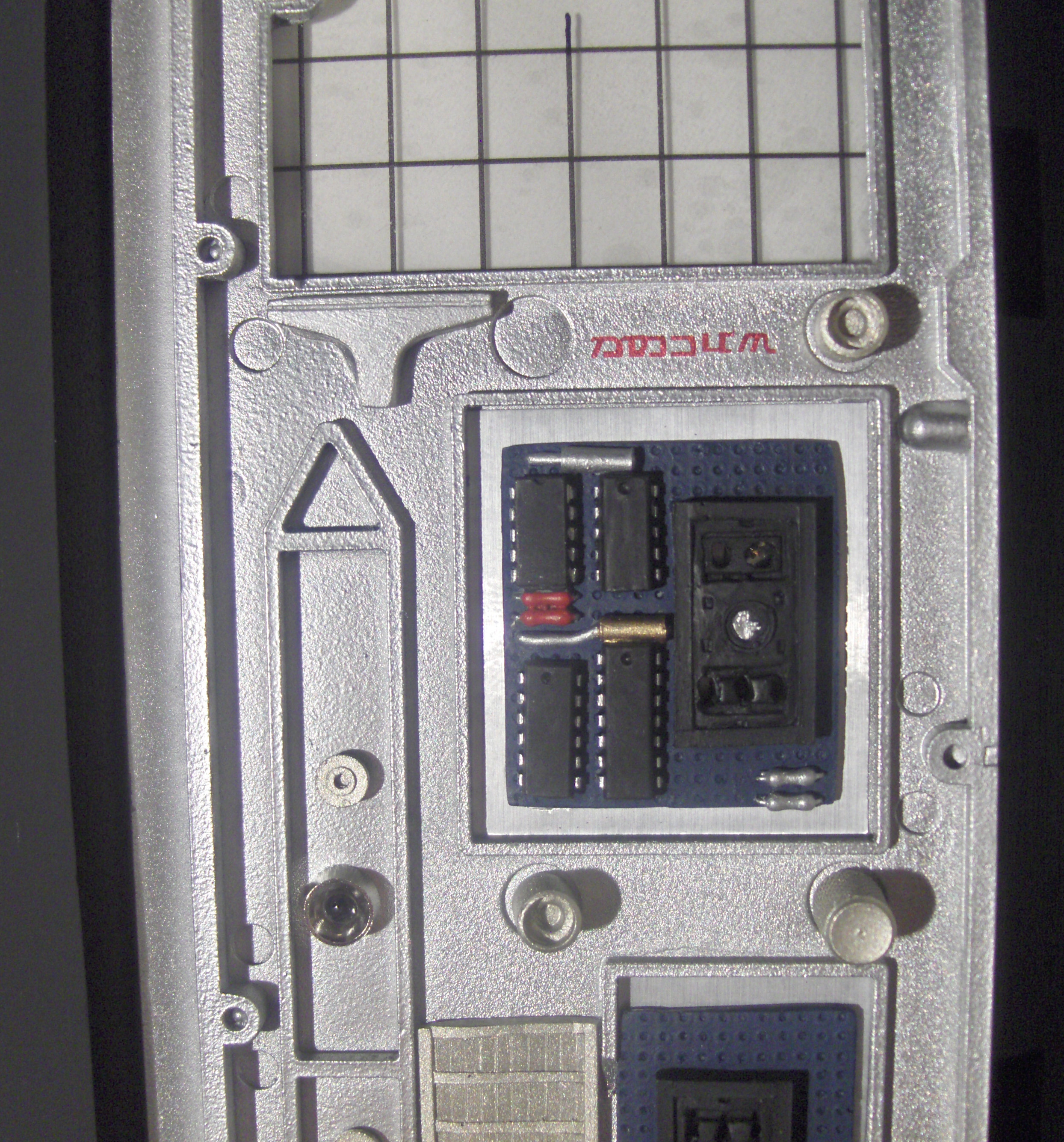

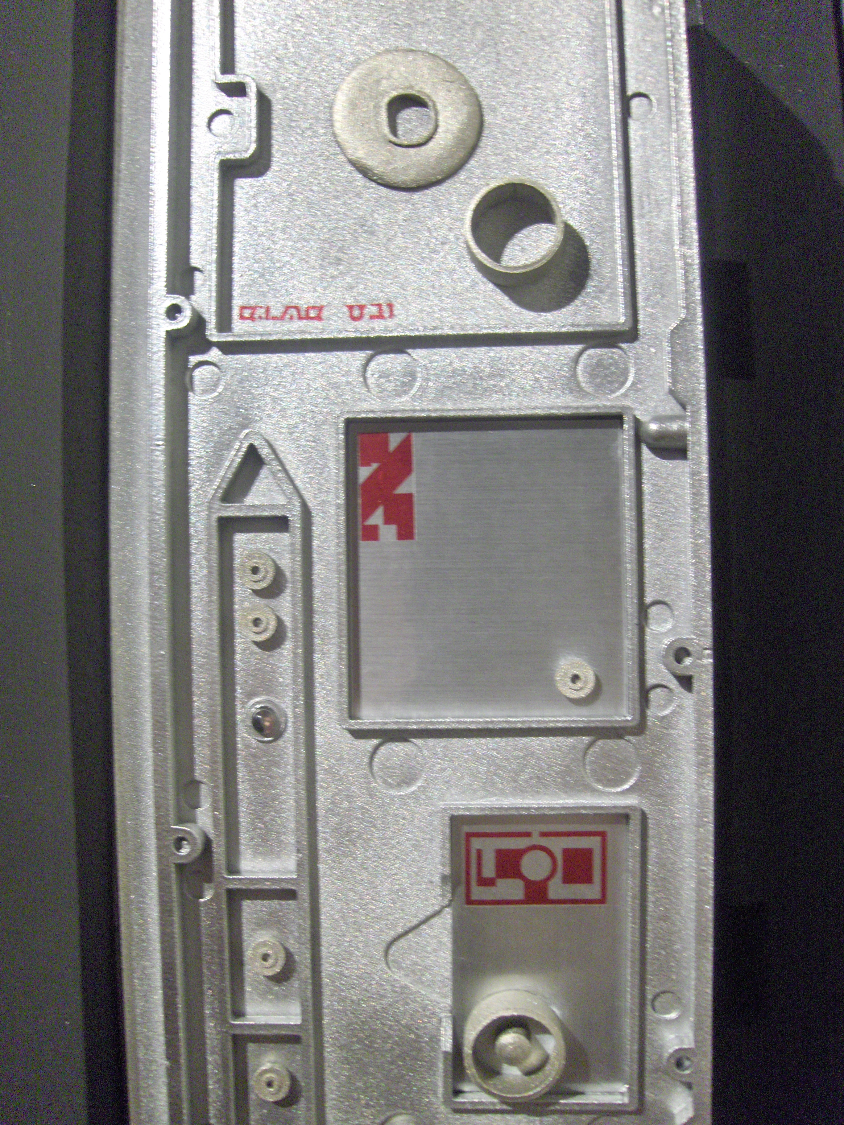

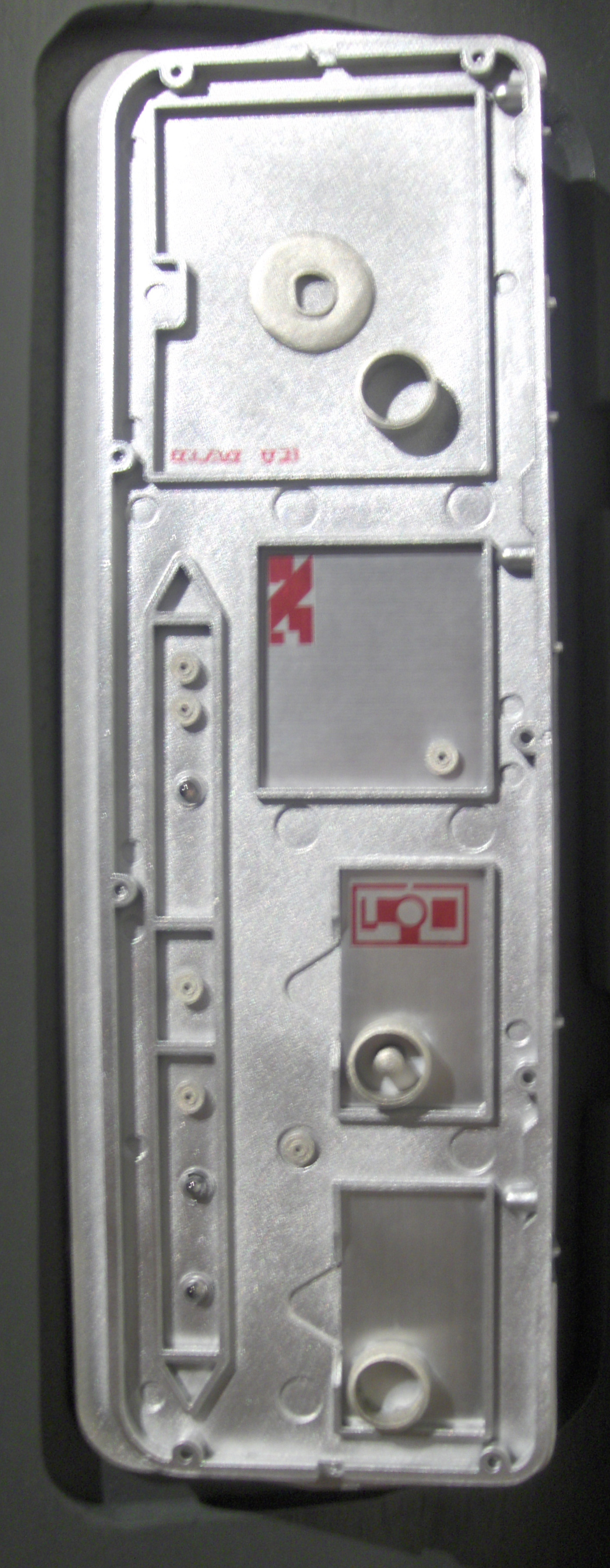

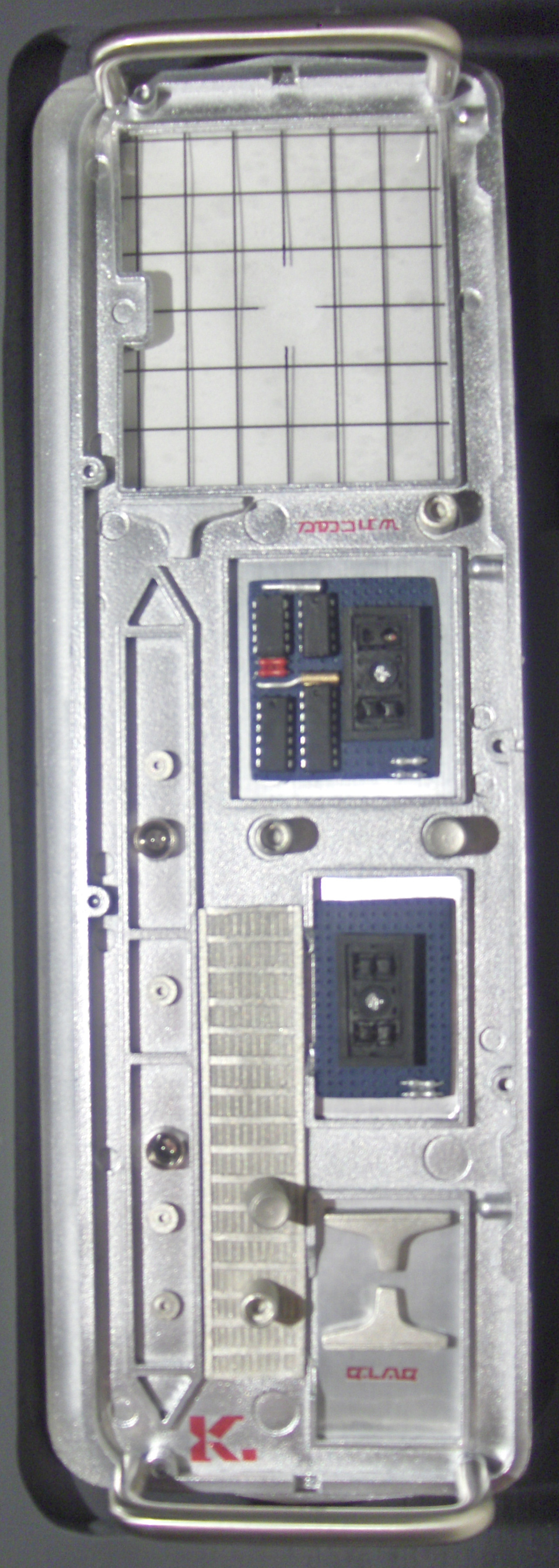

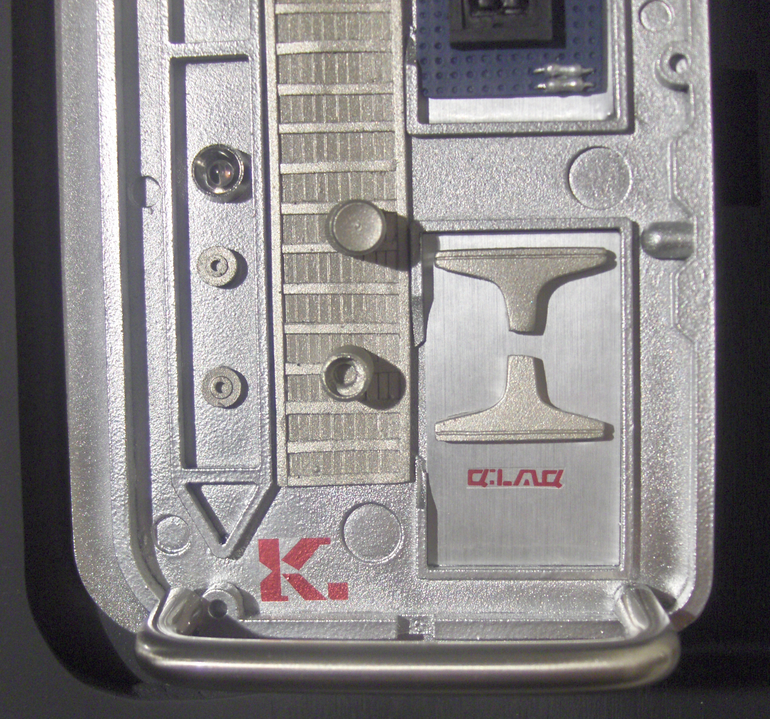

Trying to finish up the details for the panels. Today I added more of the greeblies and made some water slide decals of the alien symbols. I deviated quite a bit from what's screen accurate, I just eyeballed it and went with what I liked.
I still have a bit of fine tuning to do, a few extra decals and greeblies to add.
