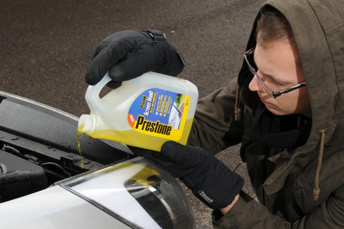

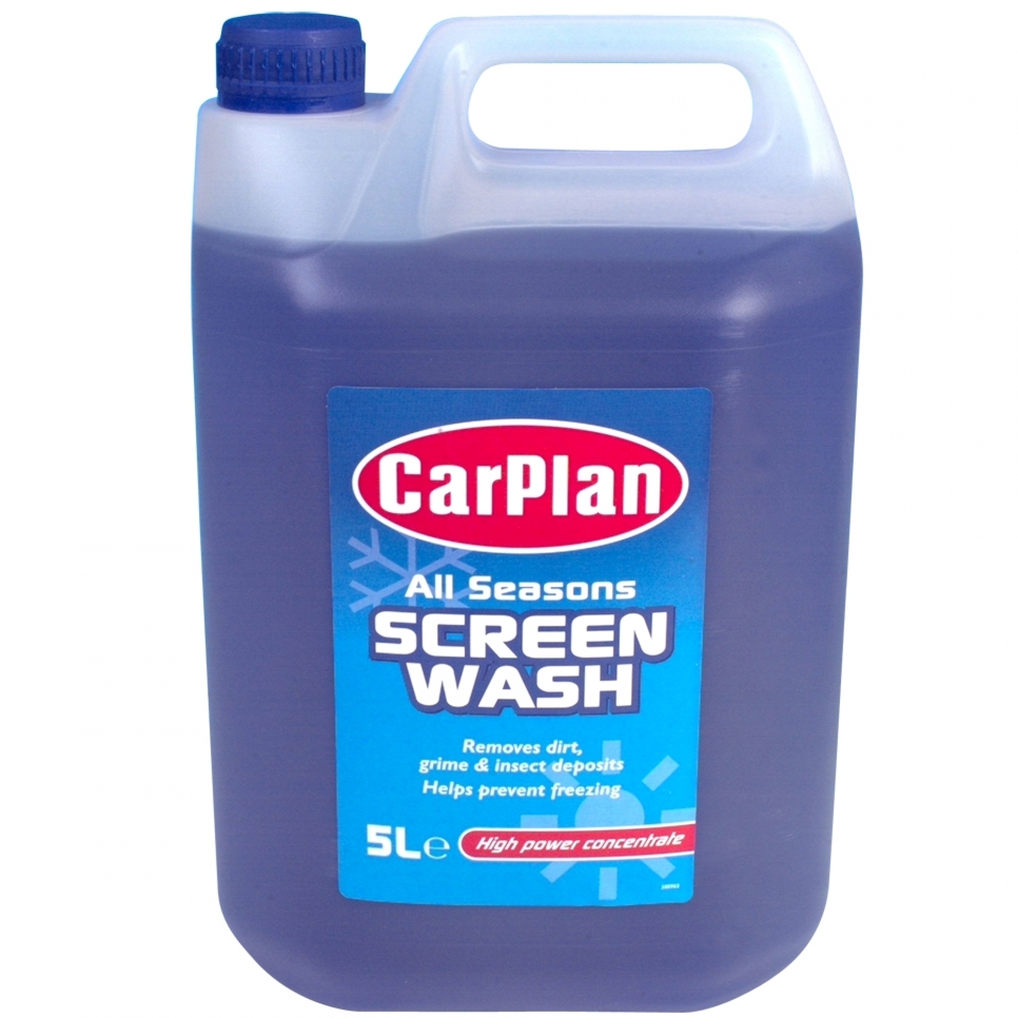

Looking good. i like the Skin, you could try a thin wash of green acrylic on a small patch.
Water down the acrylic with car screen wash.
good luck
cheers
re: Jurassic Park Velociraptor Build Thread; Target Date --> Halloween 2013
good luck
cheers
"car screen wash" ?? Hmmm.... quick googling on my part suggests that may be what it's called in the UK, but not in the USA ? I've never heard of this stuff before.
I wonder if there's something else I could substitute?
Thanks for the tip! I'll certainly make a note to give this a try on my next day off.
-= Dave =-
Its the liquid for windscreen of your car.
Normally comes premixed in litres or five litre containers
hope that helps
cheers
