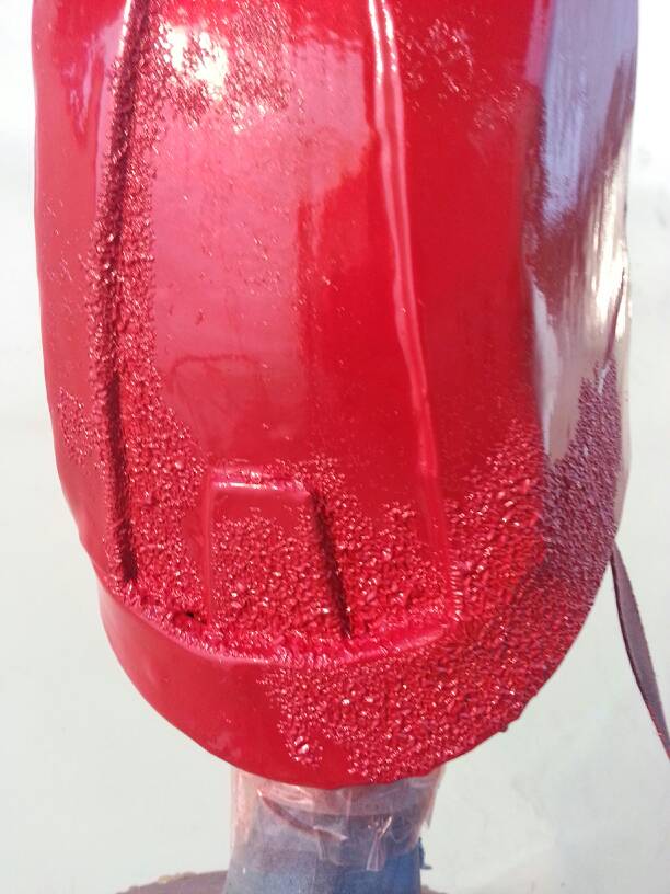

Why the paint got this reaction? I painted many things before and this never happened uploadfromtaptalk1400058264462.jpguploadfromtaptalk1400058278449.jpg

i had that once when the primer was a different brand than the color.
could also be that the primer wasnt fully dried yet, paint has a tendancy to eat into it then.
Ive been told the same about the primer but it wasnt paint it over primer the pcs were already painted with rostoleum red enamel the I heard about duplicolor toreador red and I just painted it ontop idk if that was the problem

Depending on the temp they formed at, sometimes blobs and runs of hot-glue will just peel off if you gently lift one end. If the glue was really hot, it tends to stick hard and may need cut or ground off.
BORN1977 - I have had that happen and just recently. That typically happens to me when I have oversprayed an area. Make sure and keep the spray paint about 12" away and do several light coats instead of complete coverage all at once. That was a hard habit for me to learn. I wanted to see complete coverage ASAP.
@BORN1977 - I have had that happen and just recently. That typically happens to me when I have oversprayed an area. Make sure and keep the spray paint about 12" away and do several light coats instead of complete coverage all at once. That was a hard habit for me to learn. I wanted to see complete coverage ASAP.
While thinking everything I did before painting I remember that I wiped the pieces with a wet towel, so a friend of mine told me that maybe the pieces was still humid when I painted it, what u think?

That's a good possibility to. Spray paint is great, but it's so touchy. It may have reacted to any moisture that was on the piece. I don't know how you coated your pieces, but if you're careful, you should be able to sand those areas down with a higher sand paper (400+) and reapply the paint.

The towel might also have had some soap or softner residue which reacted with the paint preventing the paint to adhere to the surface
Enamel paint takes many days to off gas (all the solvents have evaporated). If you spray acrylic paint over the enamel, the acrylic lifts and does all those weird things.The only option I know of is to remove the bad paint and start painting again.

Some of the Rustoleum paints are EXTREMELY hot chemically, they'll eat your next coat chemically if they haven't had time to cure properly... Their Painter's Touch line is a good example of that; They say you can recoat after 24 hours, but that paint will usually bubble and crack whatever you put down over it if you don't wait closer to 48 hours, even if you are using a perfectly compatible Rustoleum color over the top. It sucks to fix. Besides this, lots of brands (and of course paint types) will react with each other anyways. It's a PITA to do, but test-spraying sample pieces can save you a lot of work fixing.
