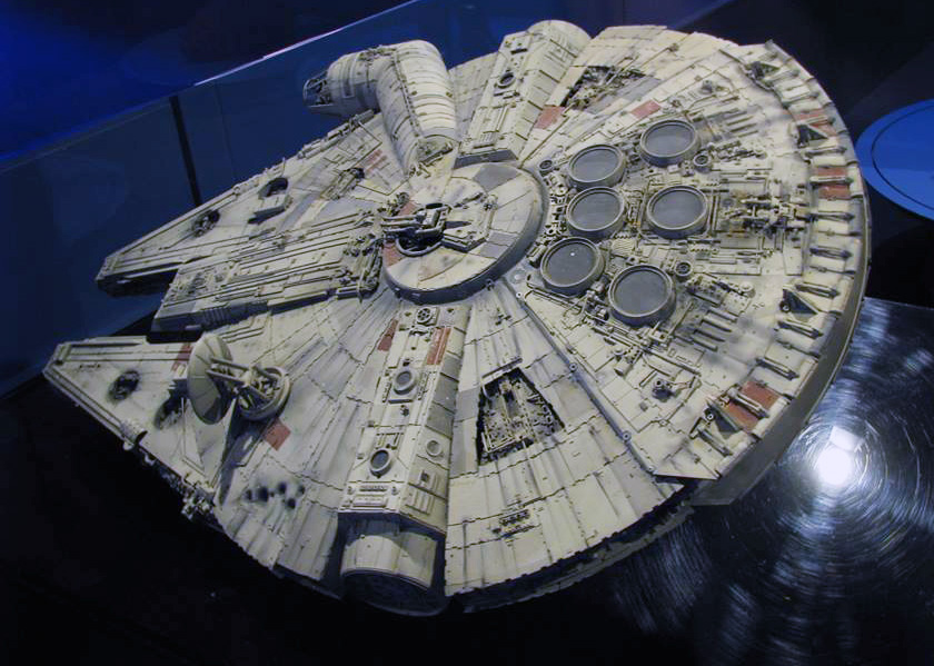

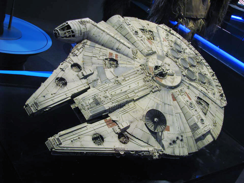

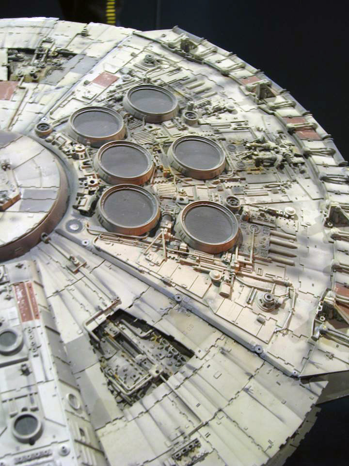

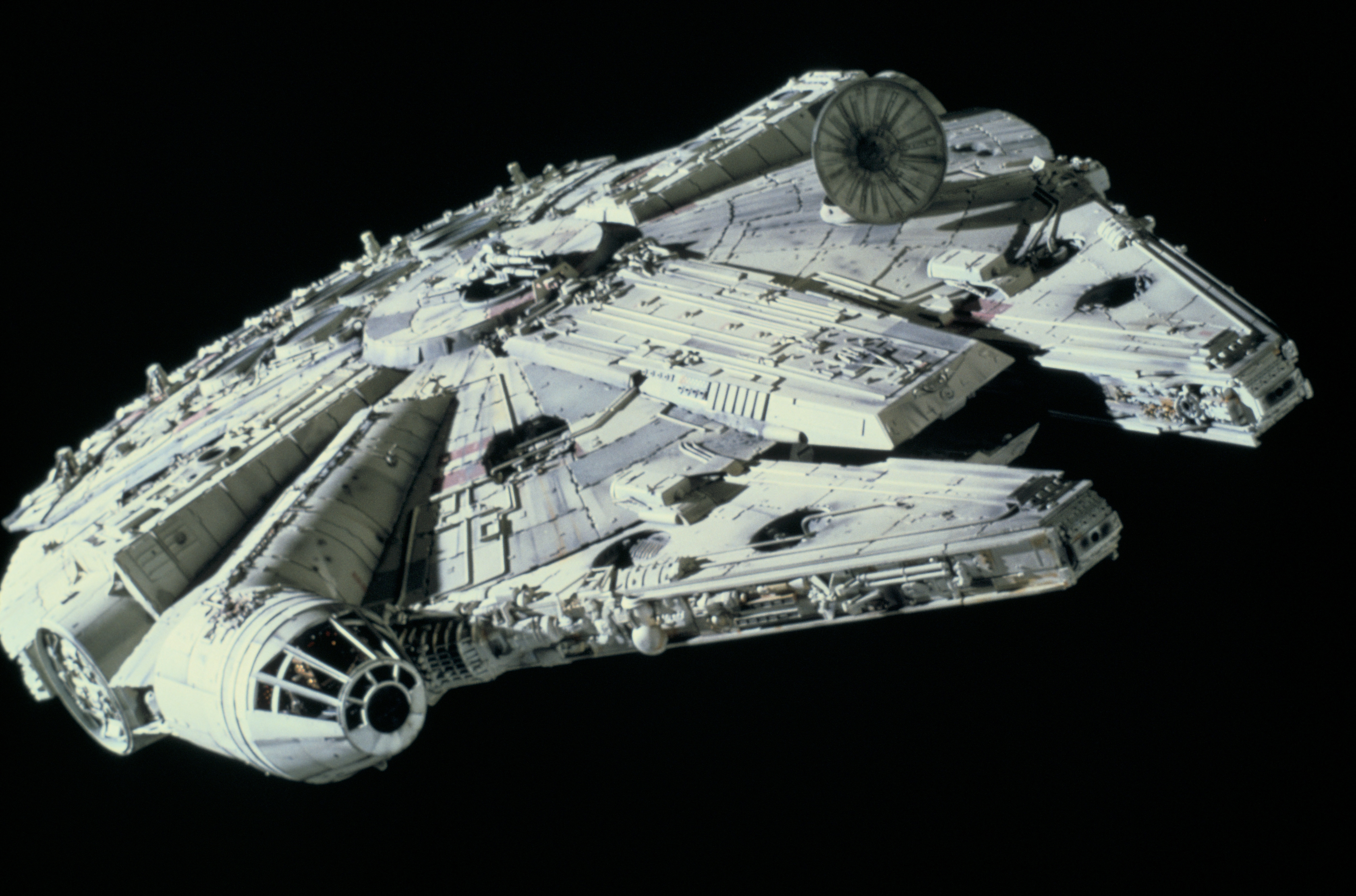

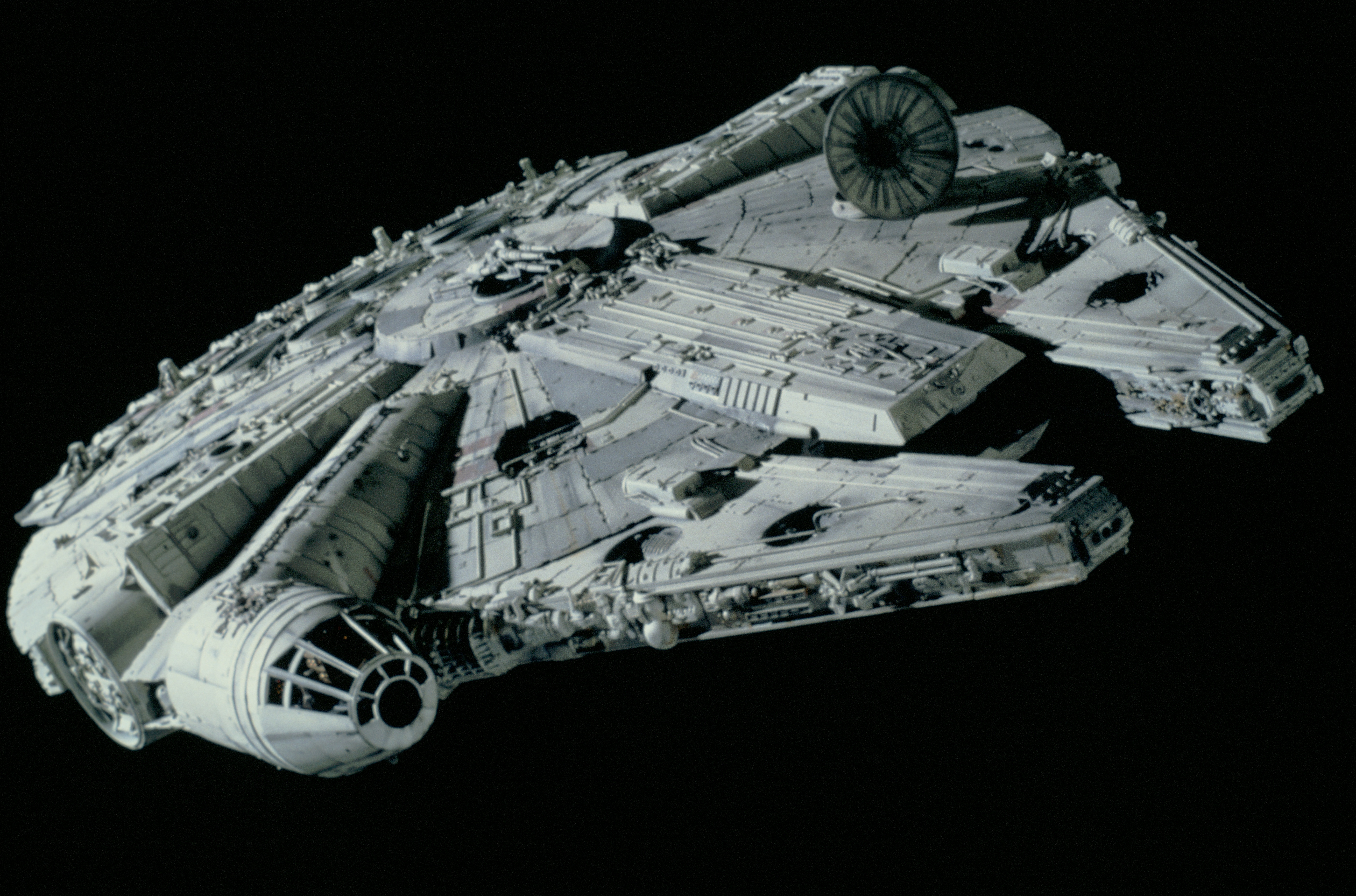

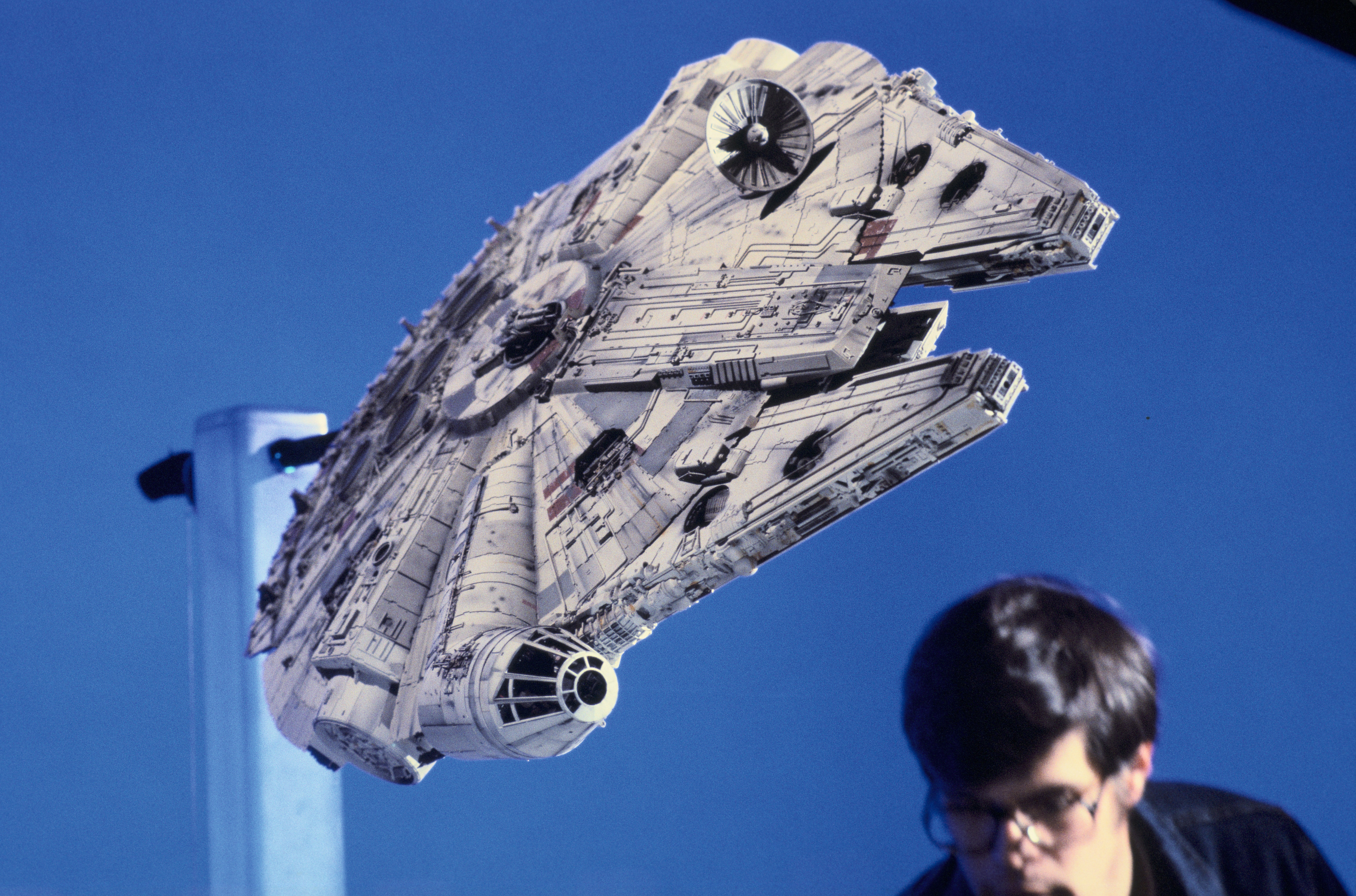

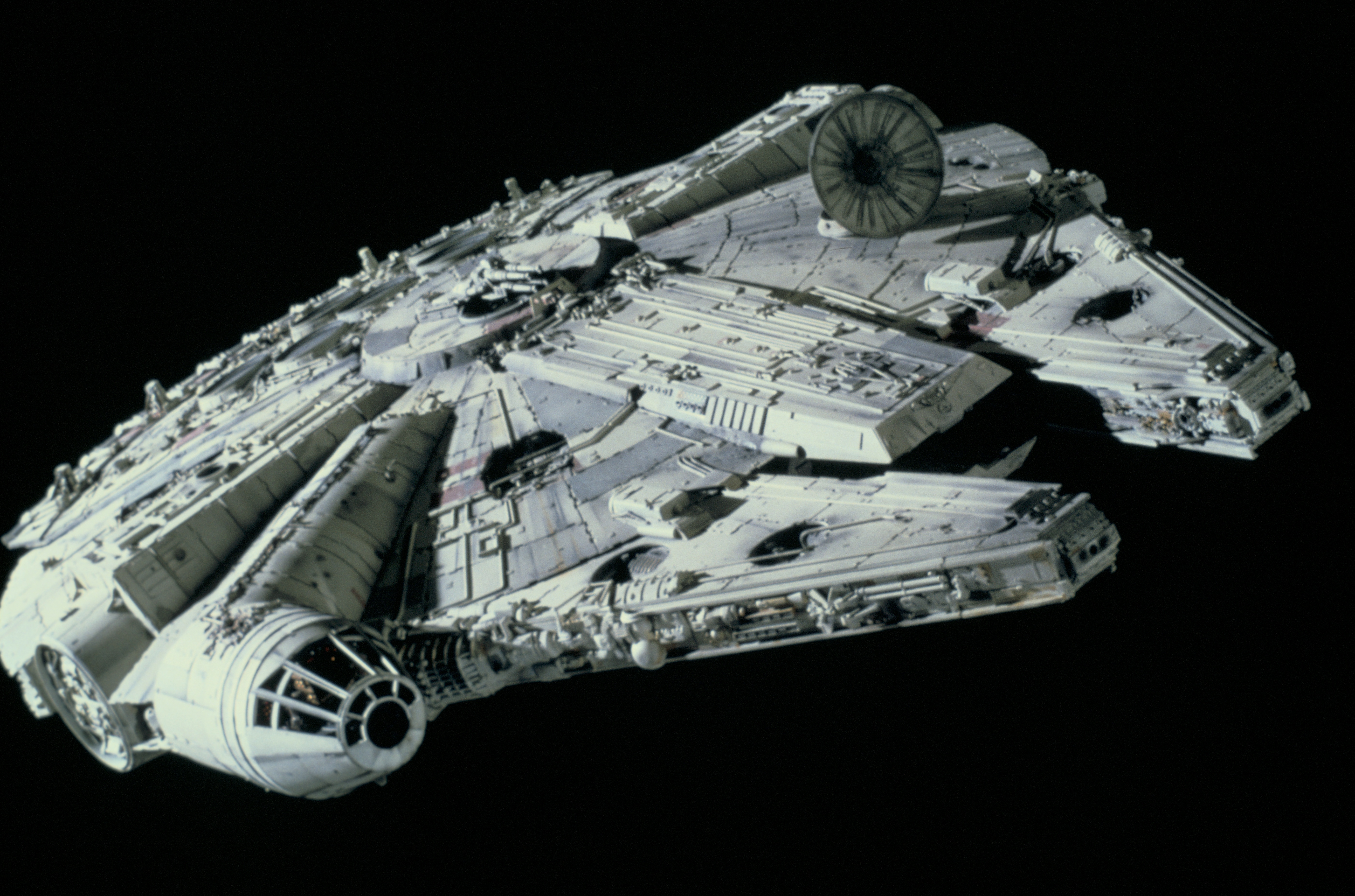

I don't know if these will help ... behind the scenes and some with different lighting ... and then after colour correcting ... the final image as we remember the falscon as seen on screen.

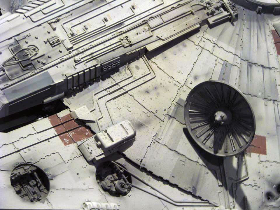

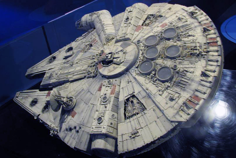

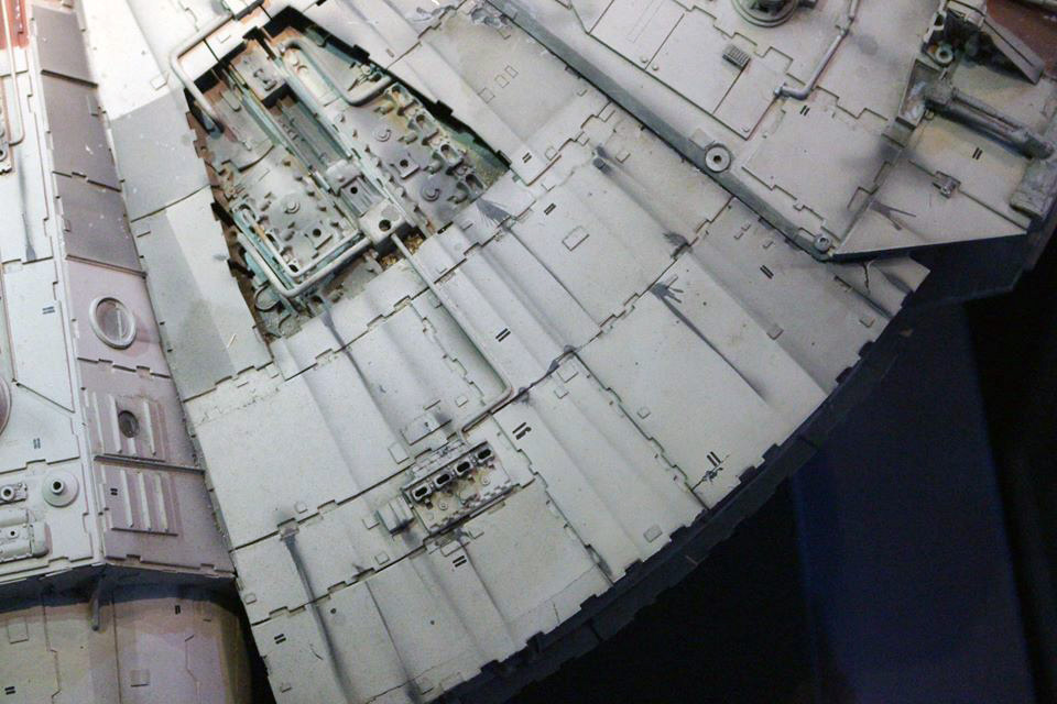

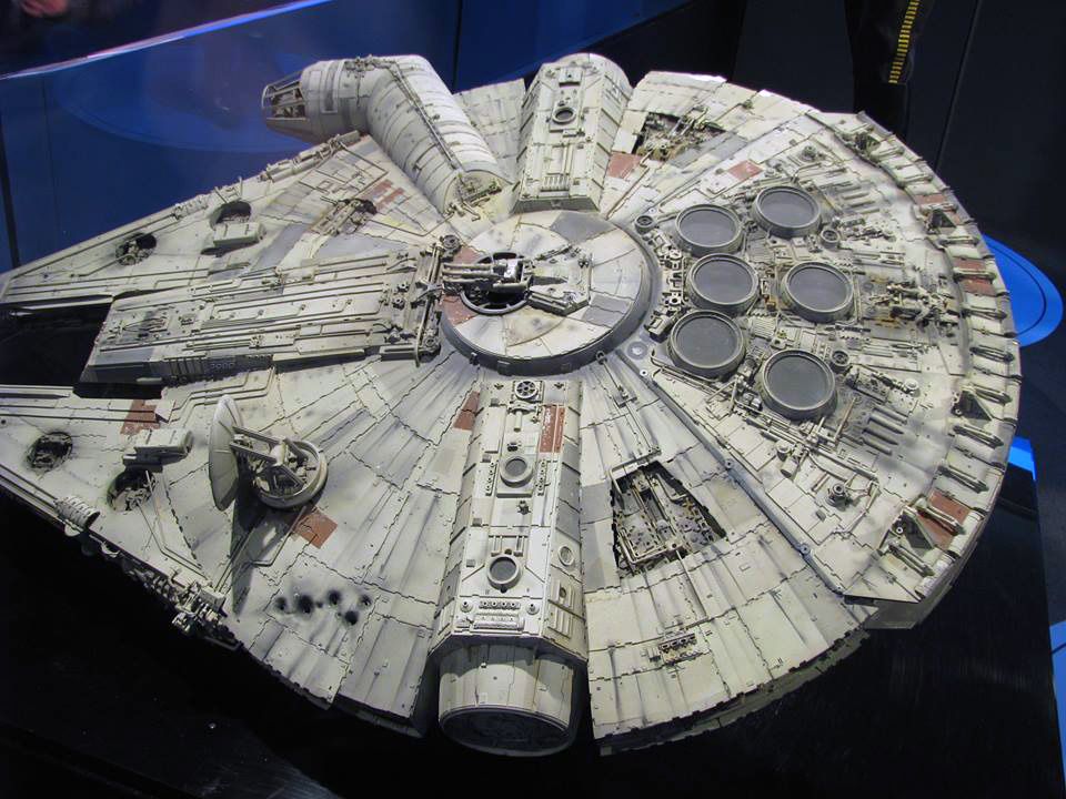

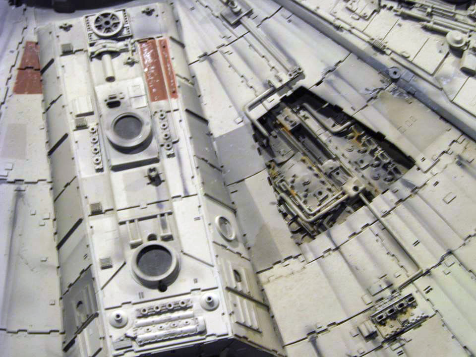

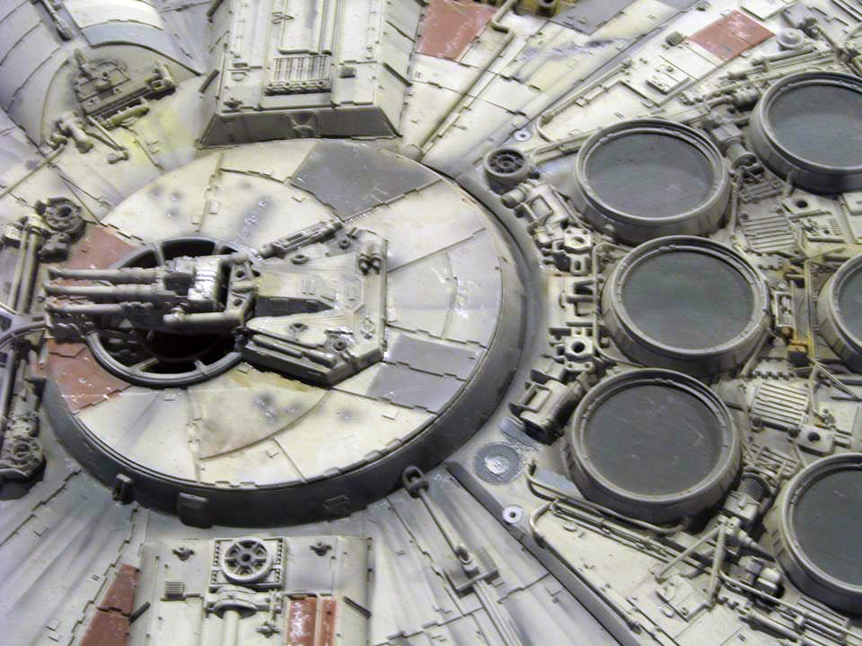

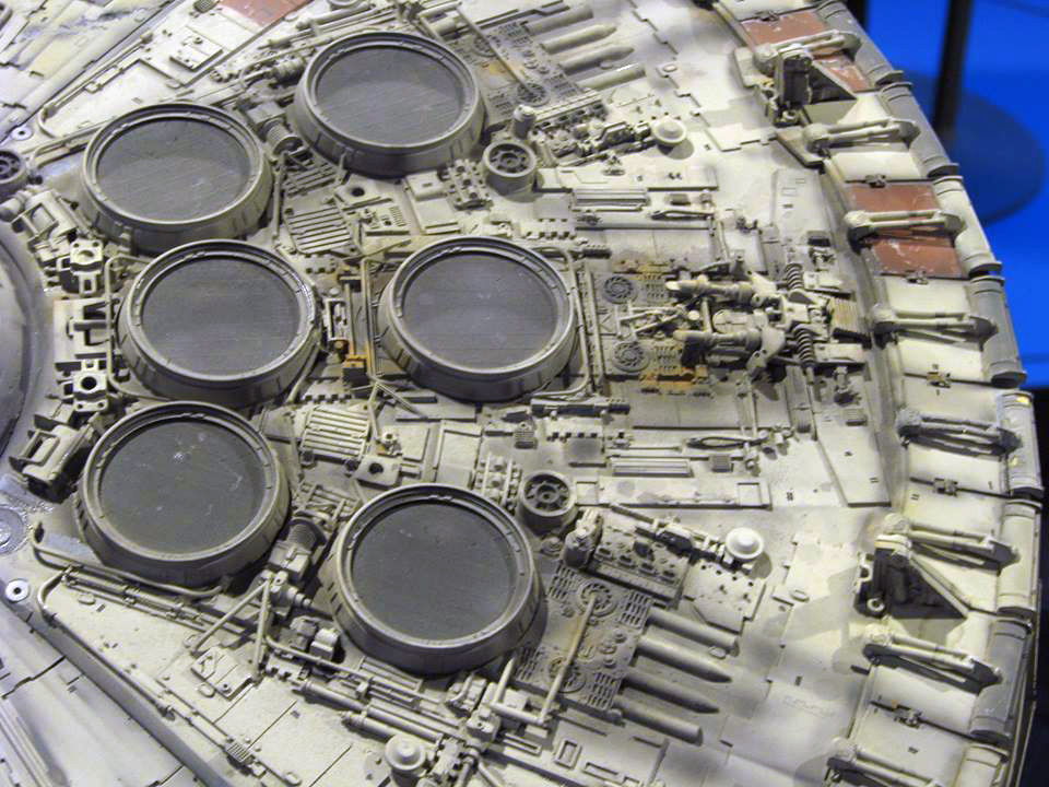

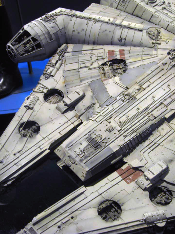

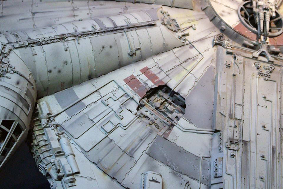

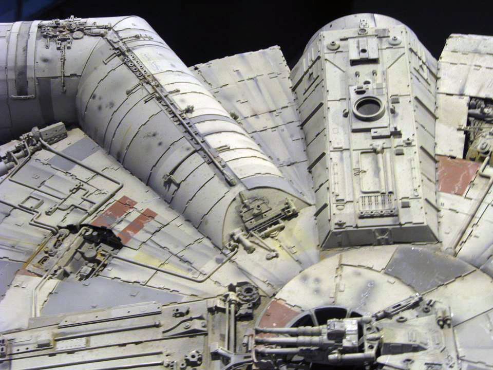

Loving these HD behind the scenes photos. They're not really good for reference use however.
A lot of the images out there are brightened or taken with a flash, but these show the Falcon with the right amount of 'darkness' of the base coat, so should be a good indicator of the other shades for the panneling

Beautiful work, J! These are definitely useful for reference use. Thanks!

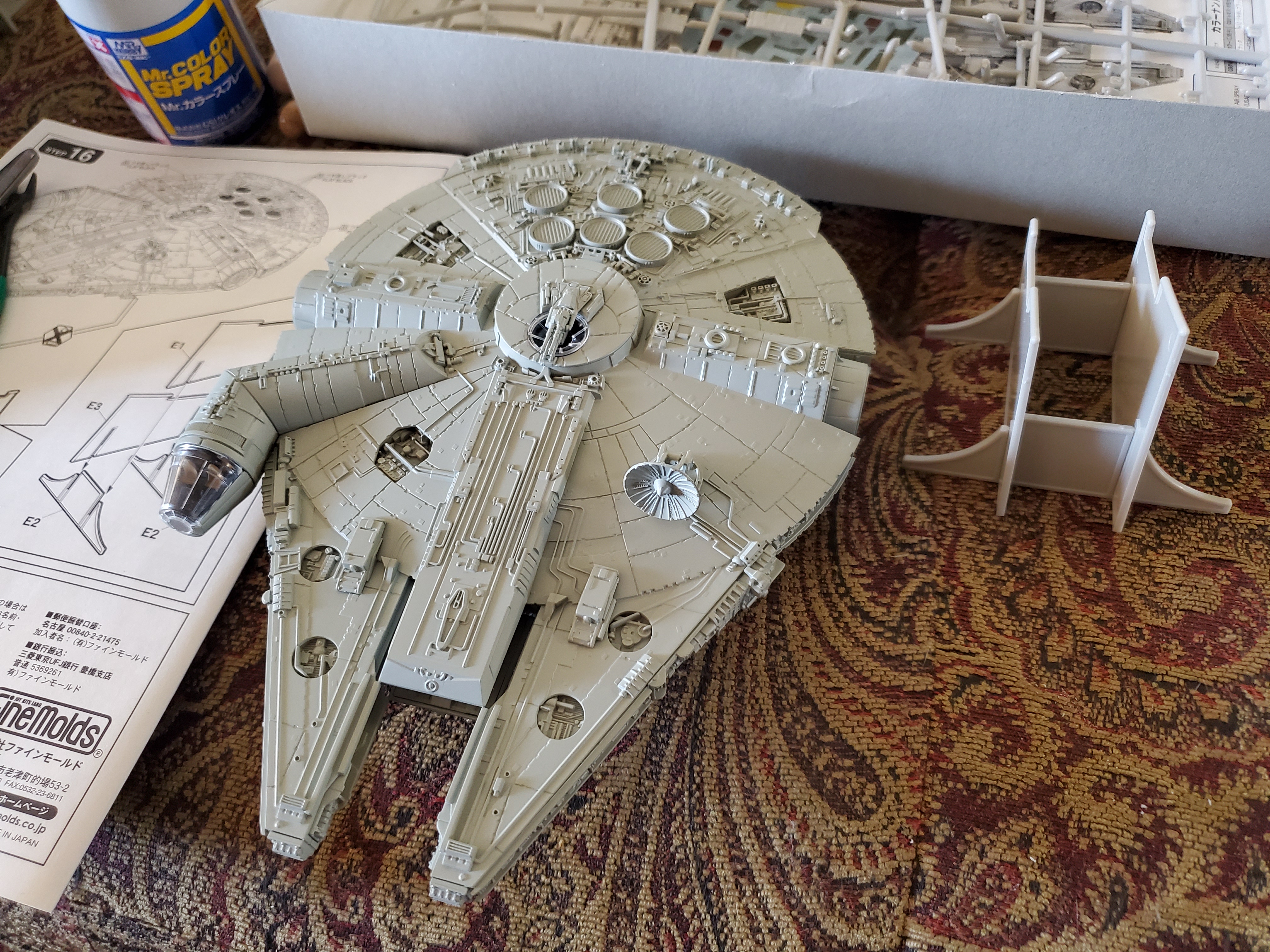

Guess what just arrived at the front door! This will be my project for the next few days or weeks, or so. After I finish the build, I will likely sell it here or on Ebay as a pro-built model. Will be posting updates on this thread.

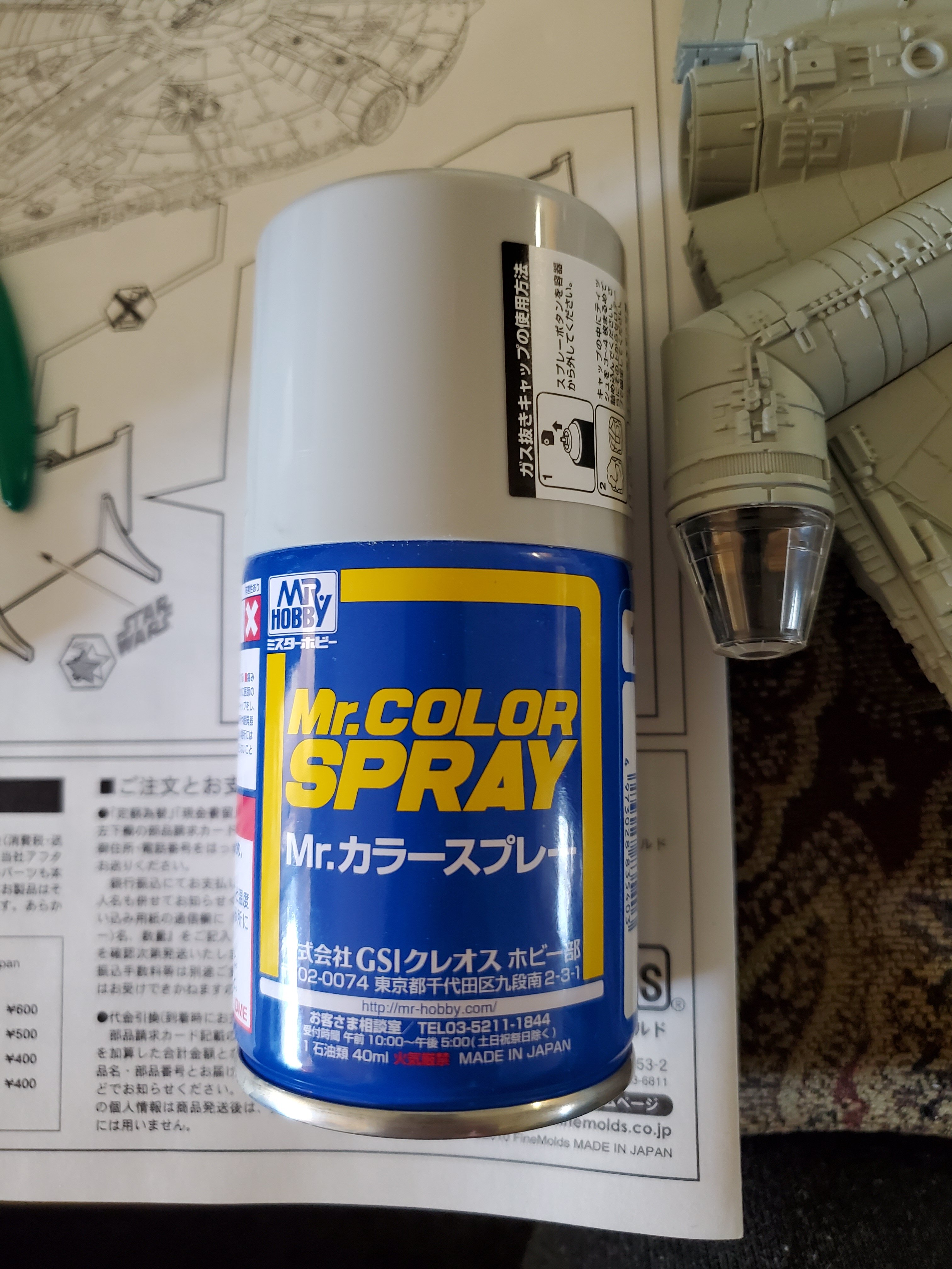

Base coat done, no primer however. This is how I did it on my original FM Falcon. Mr. Color Light Gull Gray was used for the base color, which is close to AX-004, but perhaps just a tad lighter. Next up, decals and panels, and then the canopy and windows.

lighter actually woks out better considering the scaling factor for color
Looks like a great choice
