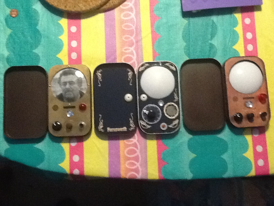

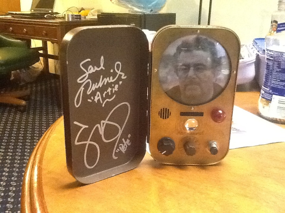

image.jpg Farrnsworths getting prepped for Shore Leave 35 with Saul and Eddie. One stunt farnsworth, one Claudia's, and one made with RPF recommended parts. Comments please. Thanks for the help RPF!

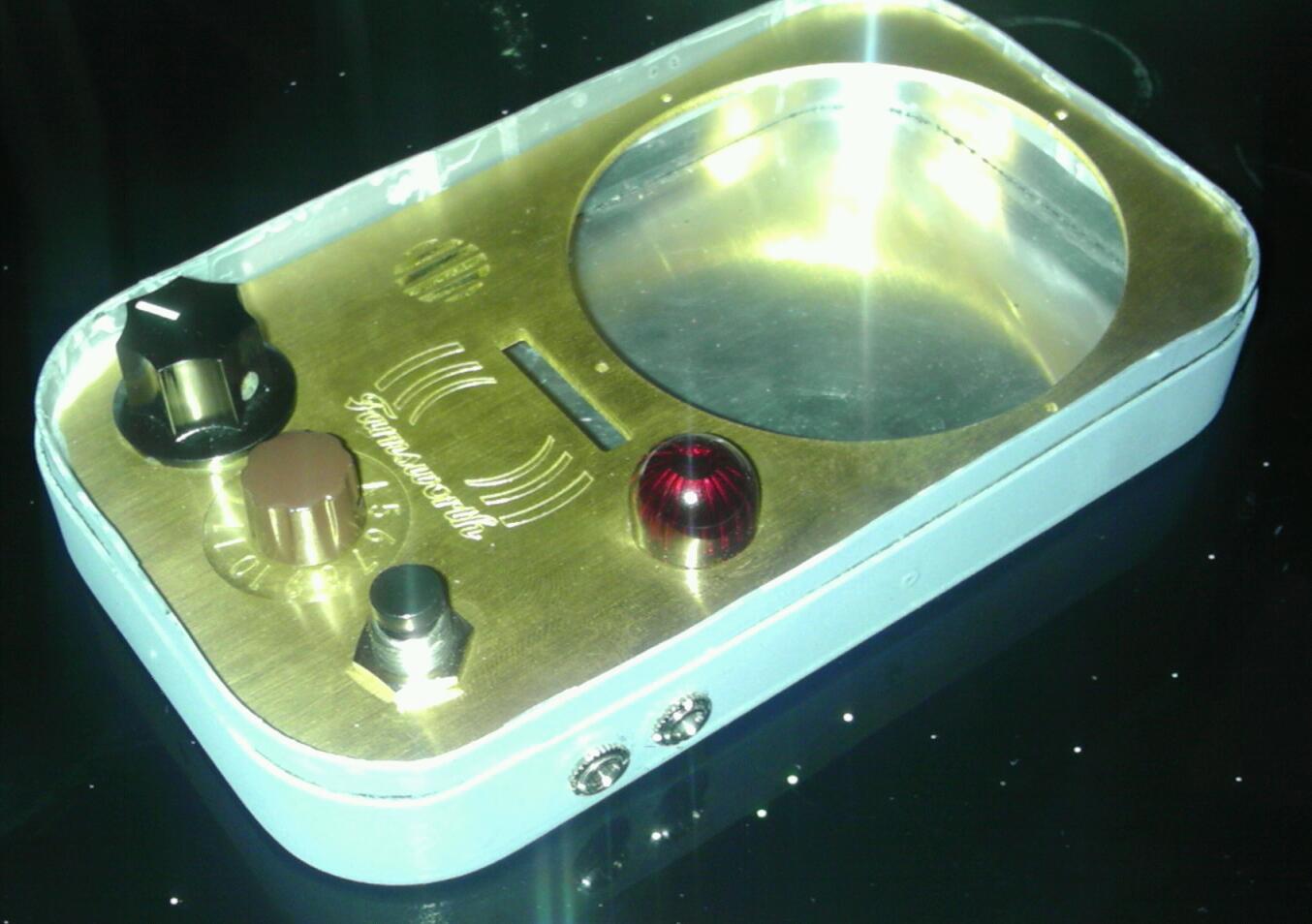

Has anybody figured out the placement of the side jacks yet? I've read most of this thread and I'm almost done assembling mine, but I've been holding off drilling the holes until the last minute because I'd just be eyeing it. If anyone has actual measurements, I'd be much more confident.
I don't think there have been accurate measurements of where they go that have been taken. I just put all my stuff together and eye balled the spacing.
In all honesty, I've never seen any measurements for jack placement.
On the ones that I built, my criteria for placement boiled down to making sure that they wouldn't interfere with either the button or led! :p
My method? Place a dual banana plug with the middle equidistant between the red dome and the pushbutton. Then, the two prongs will mark where your holes should go.
I went out and got one, but it ended up looking too far apart based on some of the pics in this thread. So I just eyeballed it. I think it came out pretty good, and this is just my test box anyway, while I wait for the gold one to come.

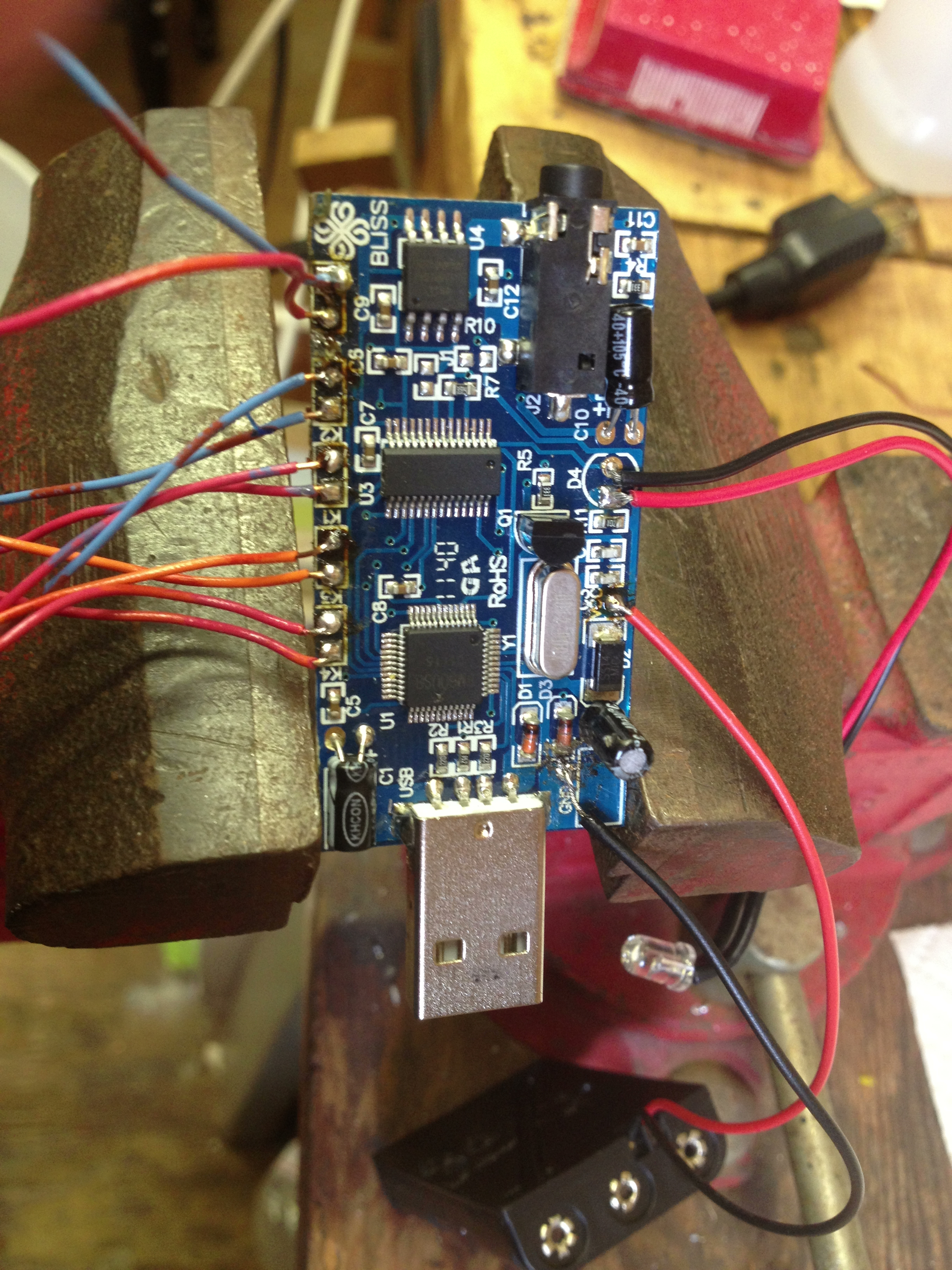

ok I have an electronics question, needless to say I have been frustrated a little with this since it's my first time soldering and just dealing with electronics myself overall.
I'm using the soundkit from the first post, and I replaced the speaker it came with for one of these: ADS02908MR-R PUI Audio | Mouser
I've been talking with shawn (jedibugs), and he helped me out with the electronics thus far in terms of wiring it for a rotary switch and some painting tips and such.

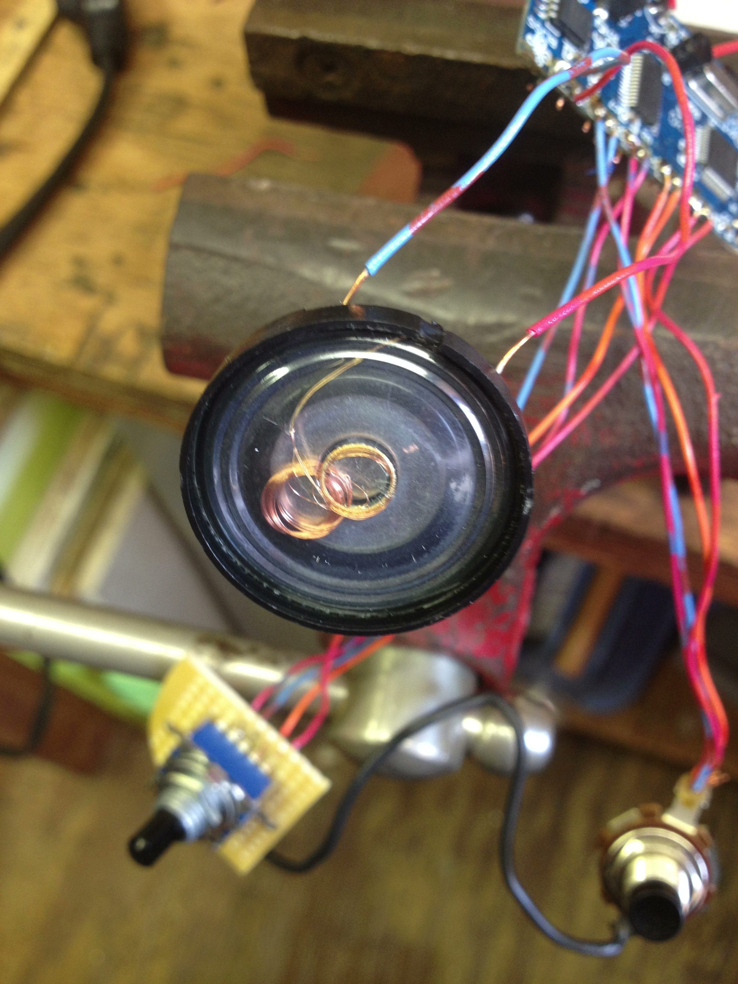

anyway the problem I'm having now is with the speaker, the first one I bought worked great for a little bit but the copper wiring thats spindled in the center, came loose from the center, now it sounds good for the first ring but then the volume trails off with each subsequent ring. thinking it was the speaker I ordered 2 more. fast forward to this morning I put the new speaker on boom works great, one of the battery wires has come loose so I went to put it back on, afterwards I try it to make sure it works the the new speaker is doing the same thing.
I think I might know whats going one but I need help to know if it's correct. after I put the speaker on the first time I changed out most of the wires to more "ridged ones" since some of the lines would keep breaking on me and I got tired of having to redo them all the time. After that is generally when the speaker problem started to happen, so I'm guessing it's the wire's that I switched to that are the problem on why the speaker keeps getting blown out per say.
please let me know. (See attached images of the speaker and the sound board in it's present state)
I can see from the pics that you've used fairly thich solid wire to connect to the speaker. Just how hot was the soldering iron and how long did you hold it on the speaker terminals when soldering? It's one of those jobs that needs to be done as quickly as possible. It looks like you might have heated up the voice coil to point where the adhesive has let go. You've also got a lot of bare wire exposed on those speaker leads.
Pare only as much insulation as you need to connect it. First tin both the speaker terminals and the bared copper wire ends with a little solder. Then place the two tinned surfaces together and apply heat long enough to get the solder to flow. Remember that thick wires and different metals will act more as a heatsink than others and need more heat. It really pays to practice on something a bit to get used to how hot the iron needs to be for the components and the type of solder and how long you need to apply the heat for. If you can adjust the temperature of your iron even better. It needs to be just hot enough to melt the solder quickly. If you ever decide to try soldering transistors or ICs remember heat can be a killer.
So try the extra speaker if you have one left following those tips and see if it helps. Maybe practice on a bit of the perfboard I saw in the photo and try to solder some wires to it quickly.
ps. I can see from the photos that you've applied a lot of heat when soldering wires to the circuit board. Be really careful as you can lift the copper pads (connection areas) off the board with too much heat.

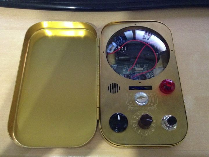

All finished! As a replica prop, I don't think it's going to win any prizes, but I feel I should get bonus points for having made the faceplate from scratch. The faceplate is pitted slightly where the printer ink mask started to break down (*cough* "weathering"). The 300 second sound card works well, although I was almost crying when I shorted it out last night. Fortunately it does have a fuse of sorts on there, which saved the day. All in all, I'm pretty happy with the result.
Good job. It looks great and it's not a bought one. That's the great thing about fan made stuff. We can buy all the same parts but everyone's prop will be slightly different.
I've include a shot of the really nasty looking insides just in-case this is helpful to somebody.
I doubt there is a really neat way to do it without custom electronics like the QMx one.
The faceplate is held on by an arrangement of magnets. You are going to laugh, but I was actually surprised to find brass is not magnetic! Epoxy resin soon resolved that issue.
OK then * chuckle chuckle *.
