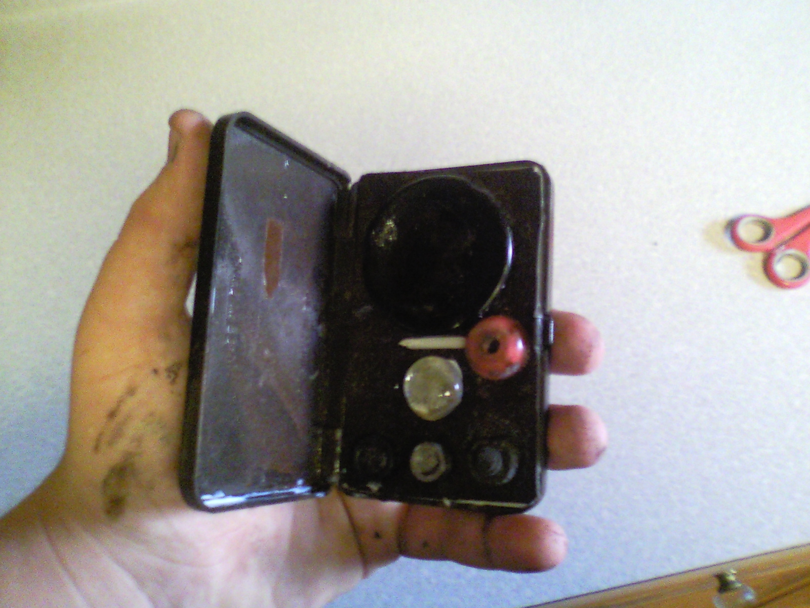

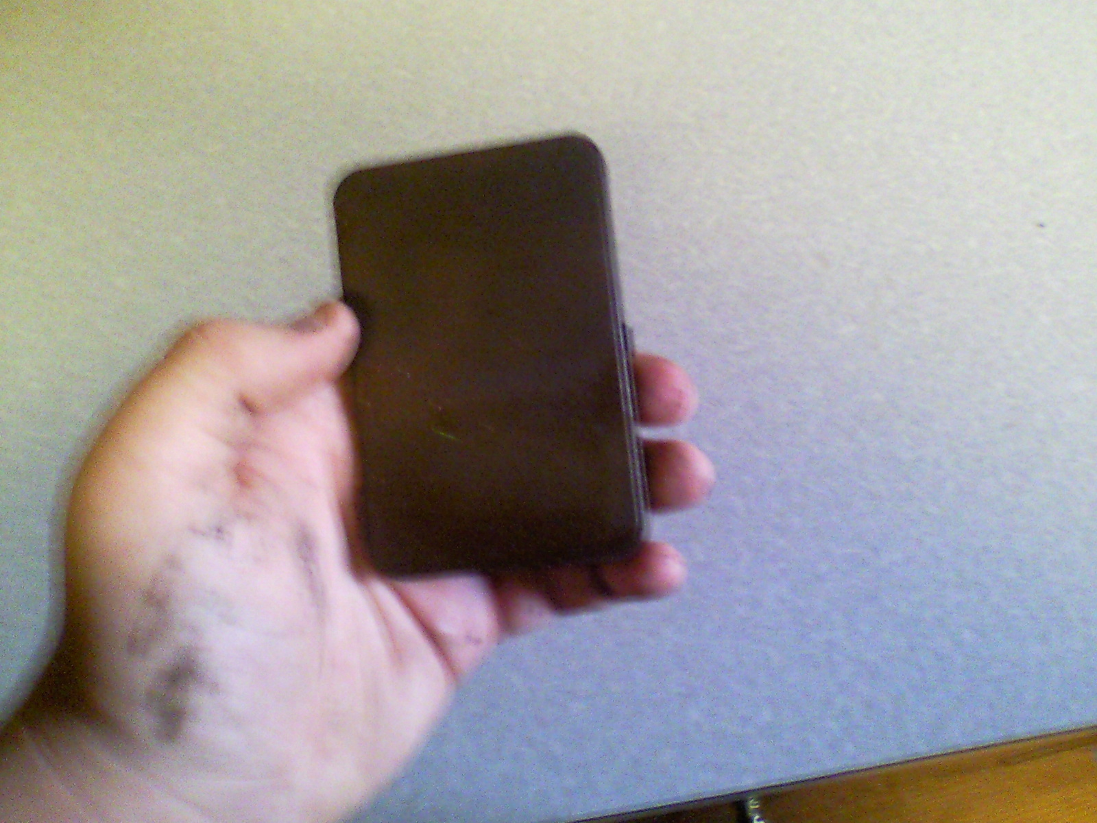

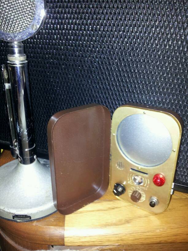

Here's my first attempt!
It's far from perfect, but I was in a bit of a rush to have it ready in time for the missus' birthday tomorrow.

Looks great! I'm sure she's going to love it.

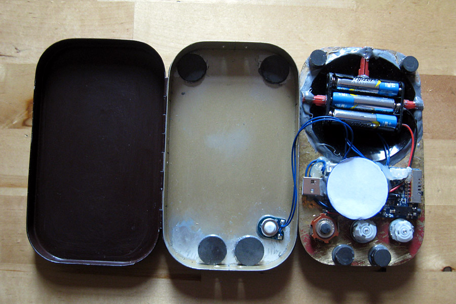

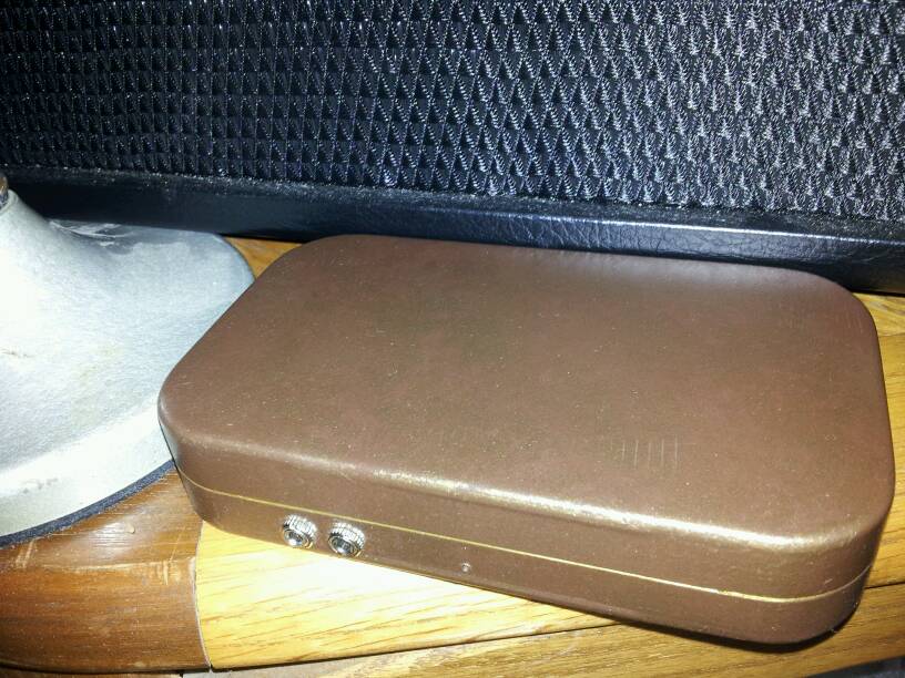

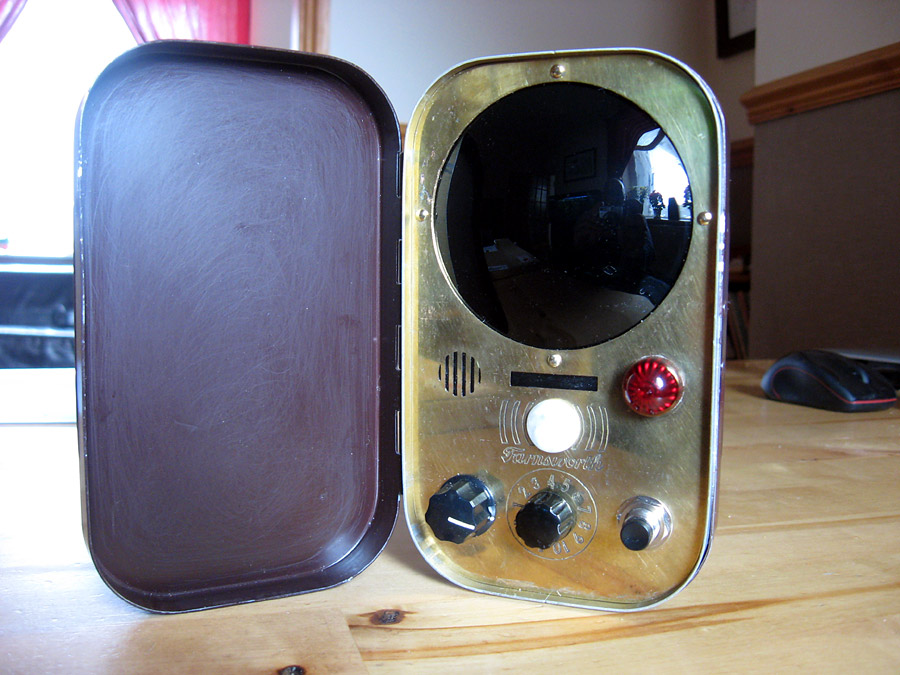

All finished! As a replica prop, I don't think it's going to win any prizes, but I feel I should get bonus points for having made the faceplate from scratch. The faceplate is pitted slightly where the printer ink mask started to break down (*cough* "weathering"). The 300 second sound card works well, although I was almost crying when I shorted it out last night. Fortunately it does have a fuse of sorts on there, which saved the day. All in all, I'm pretty happy with the result.
I've include a shot of the really nasty looking insides just in-case this is helpful to somebody. The faceplate is held on by an arrangement of magnets. You are going to laugh, but I was actually surprised to find brass is not magnetic! Epoxy resin soon resolved that issue.
Very nicely done. I don't know if you are interested, but if you bought the 300 second USB recording module, you can adjust the blink rate of the LED. The default blink rate is quite fast compared to the one in the show. In the PM66 Write software, it's the last column call "flash" that sets the rate. Nice case paint job by the way.
