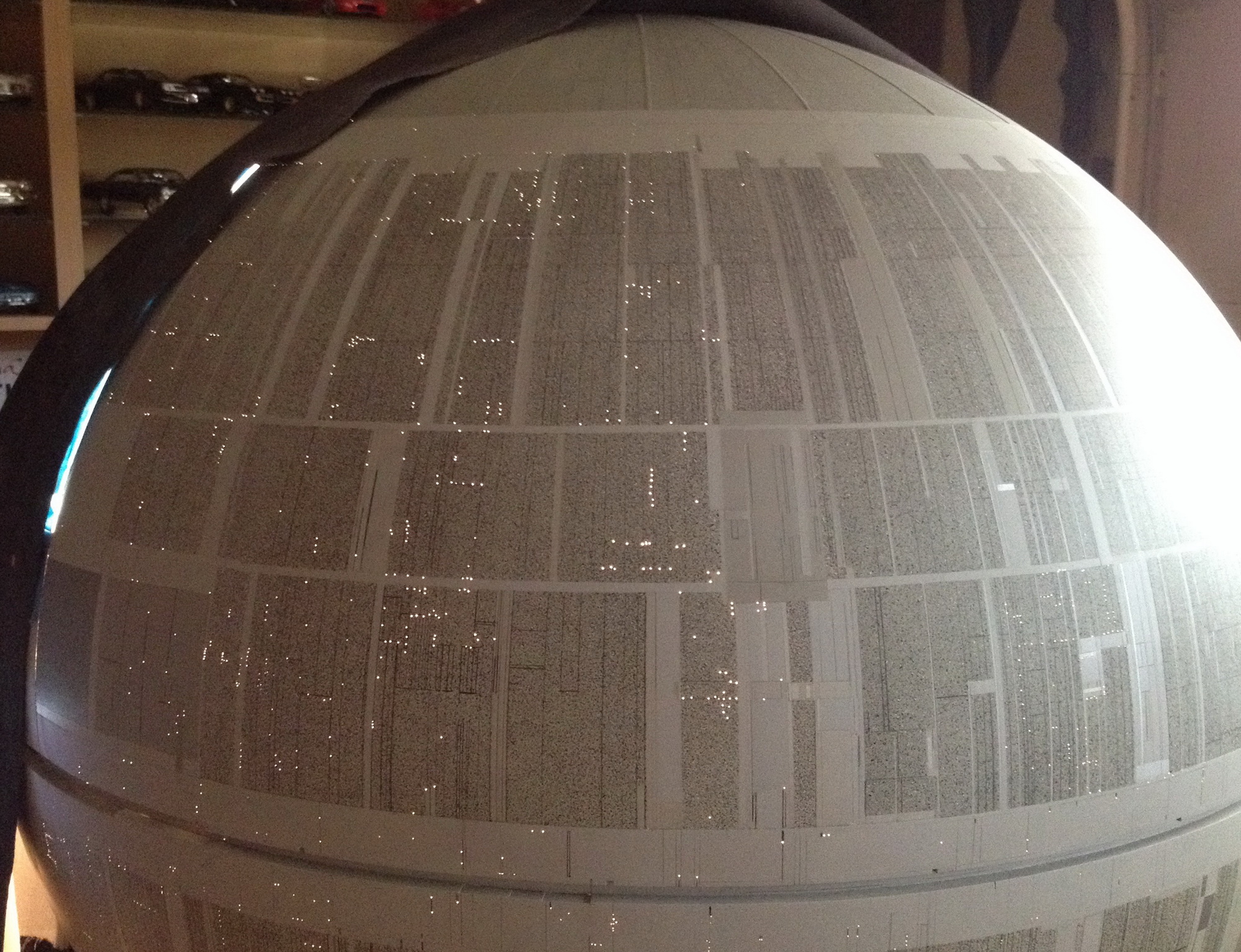

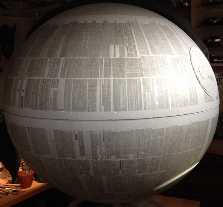

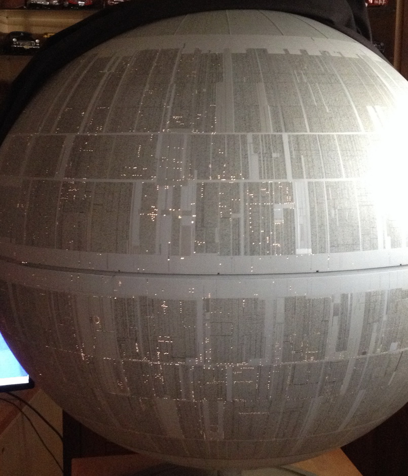

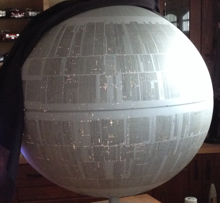

Heres where I'm at with the lights on the upper dome...
So, not sure if I'm mentioned before (probabaly have), but the process for the lights is pretty straight forward...
Through various sources I (as you know) have a fairly extensive collection of images of the original - shots I've taken, published images, etcetera.
I have a PC set up in the shop, and am simply finding the most revealing image I have of the area I'm working on, and duplicate the lights, hole by hole. Once I've exhausted all the clearly discernible lights shown in the image, I'll move to the next image; wash, rinse, repeat. There is notable content overlap between images, so I am able to "cross-reference" all the lights in each city block across multiple images to help insure I have got them all accounted for, and drilled into my model.
Couple hundred more lights tonight...
By the way, as a reminder, I left a trapezoid of crystal clear (not even hazed) acrylic in the back of the upper dome (access hole for lights is in the back of the lower dome). left the open window as an homage to the fact that the original is clear acrylic on the entire rear 40% of the sphere.
But...
I am 95% sure I'm going to paint over this, and close it up (primer >>> silver >>> base grey), and maybe even do city blocks and lights. But rest easy; if I go the full route (city blocks and lights), it will be after ALL else is done.
