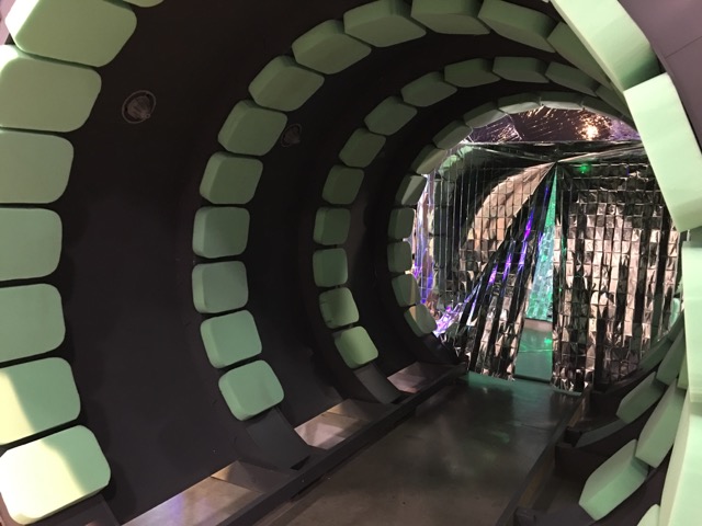

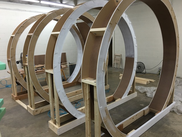

To my taste I would love that you have decided to go higher with those corridors walls... and having two of those green wall lights would,ve been exciting... Now it's like a welcome matte and not as exciting as if it was a full complete entrance to the cockpit. It could dramatically improve the emotionnal impact of the visitor when he open the door and see that amazing cockpit... but hey it's just me!!

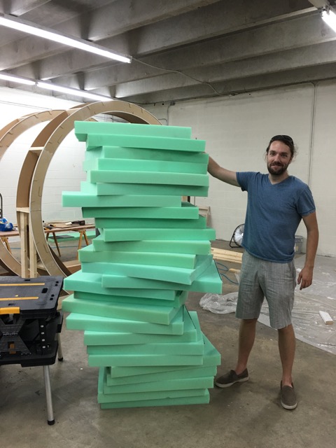

Amazing work as usual.... did they sell 18litres bucket of wood filler? I guess you would have saved some money there!! LOL

Hey SK, I love the idea of exposed cabling and wiring.
That said, the corridor is going to be subject to a lot of foot traffic when on display and may be less visible to you than the cockpit (you can only be on one side of the display at a time). So, unfortunately, you'll need to worry about visitors either breaking or stealing exposed pieces -I think anything inside those panels might be tempting to fans with no scruples.
Sorry to get all "real" on you, hopefully you've already considered this in your design and assembly.
Hey SB,
I've given the foot traffic an incredible amount of thought. And you are correct, there is the potential of "anything" happening with over anxious fans (it's happened before with the throttles and switches). In most cases, we "have" to think real world situations and consider the "what ifs". Any show/convention we attend there will ALWAYS be someone standing at the ready to ensure how and where people should walk.
The design of the removed panels wont be exactly screen accurate as there is a cross beam dead center of the corridor panel but I think I split the area in two. One section for pipes and wires and the other for the occasional pipe and circuit boards - still thinking it through. :)
I think that would be really cool, but it's important not to overdo it. One or two pads removed would in my opinion be more than enough.
Hey FF<
Agreed! The corridor would have only 4 large pads (8 total when I do the entire corridor ring). I think removing just one panel would be enough to give the impression of the "used" universe we all know and love. But I have to find that delicate balance between pipes, wires and insulation.

Thanks so much! It's funny, several people at the local home improvement store know me by name and the project I'm working on. They always ask if I'm getting more 1x4s, wood filler or paint. ;)

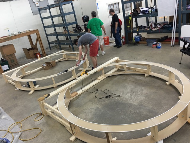

My thoughts exactly! And entire corridor ring showcasing not only the exposed wiring but the familiar corridor lights would be AMAZING and just give it that finished look! We'll get there eventually. I want to finish these half corridor panels first and see how they turn out.
I think the real thrill would be including the bend in the corridor that we see when the cockpit door is open. Unfortunately, I don't think I have enough room at the warehouse to include it. But I check again!

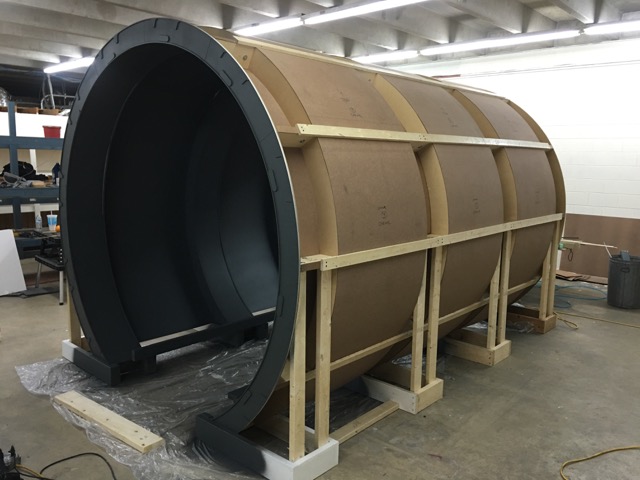

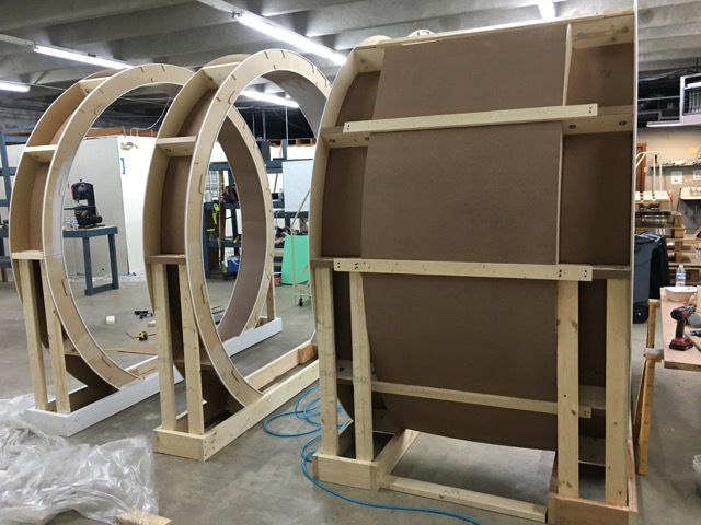

We have a 13' section of hallway well underway up here in Nashville.

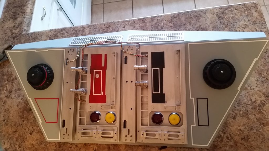

Hi Gang,

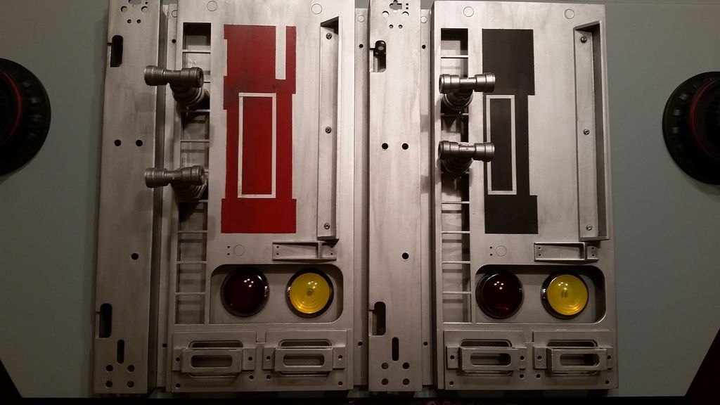

This weekend wasn't as productive as it should have been! Rogue One was awesome but then bad weather hit and kinda put a damper on any real forward progress. BUT...

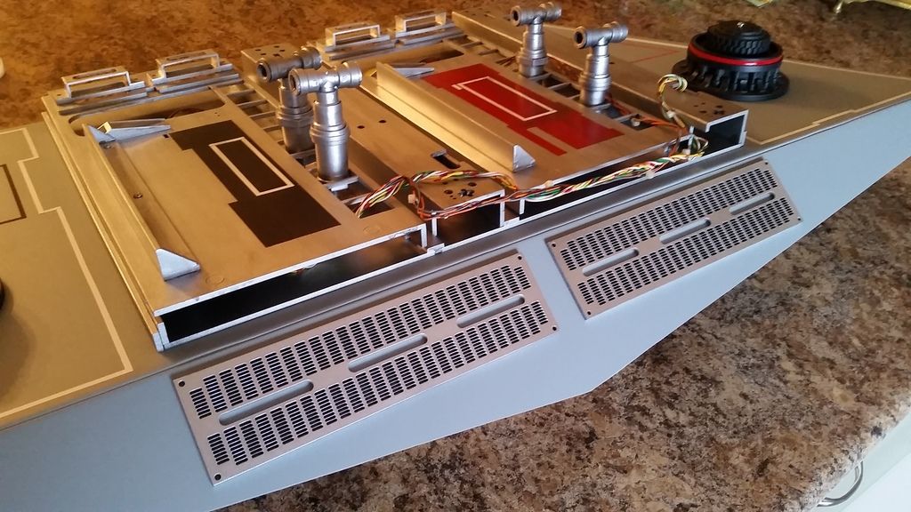

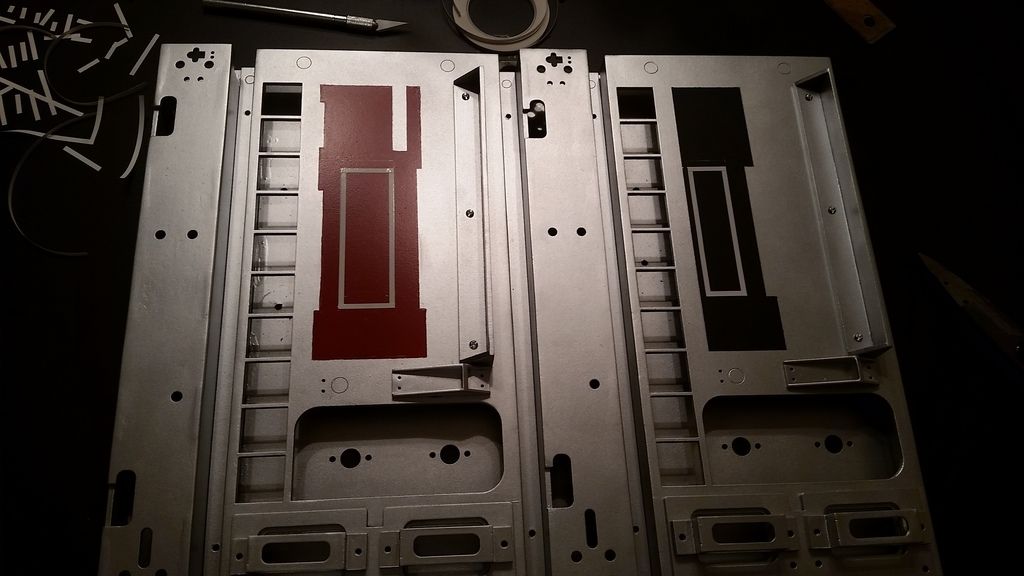

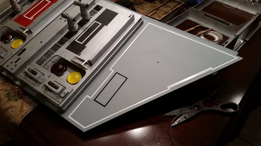

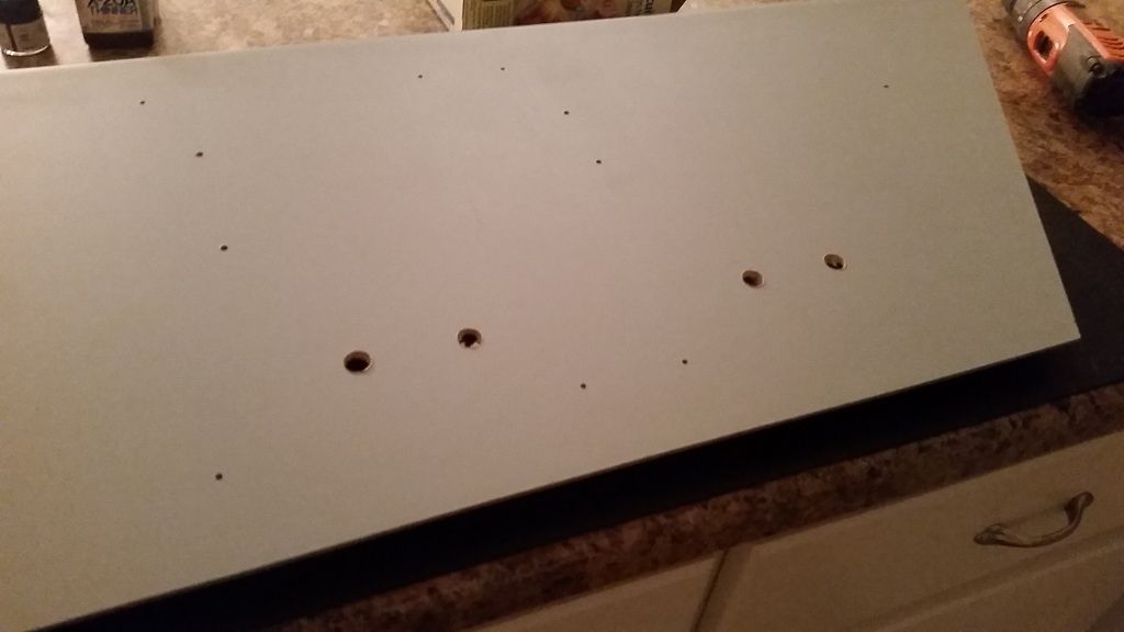

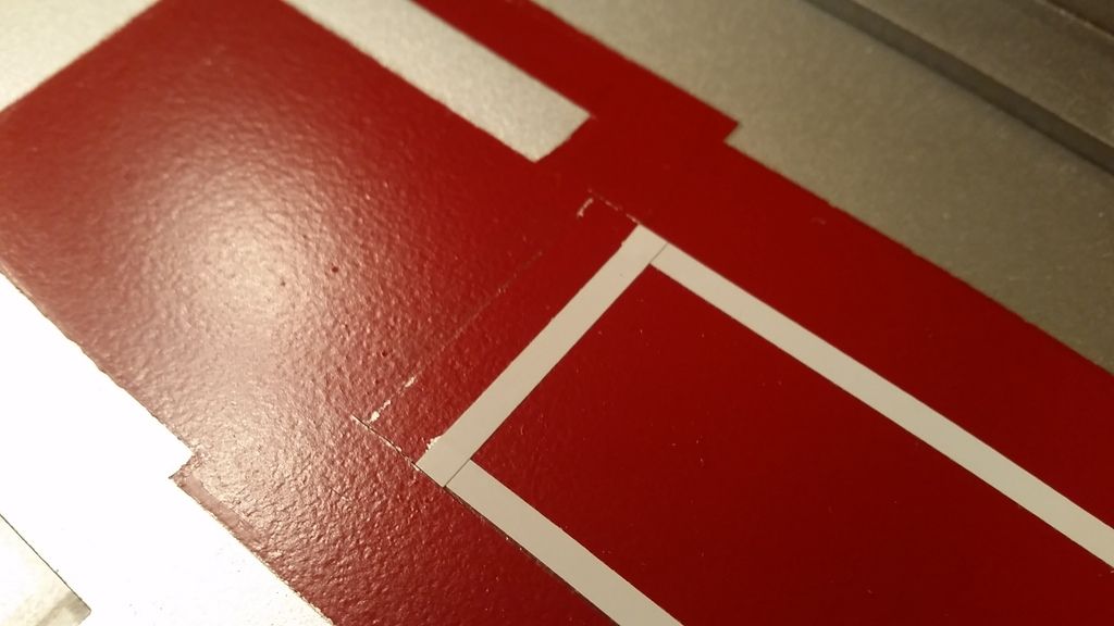

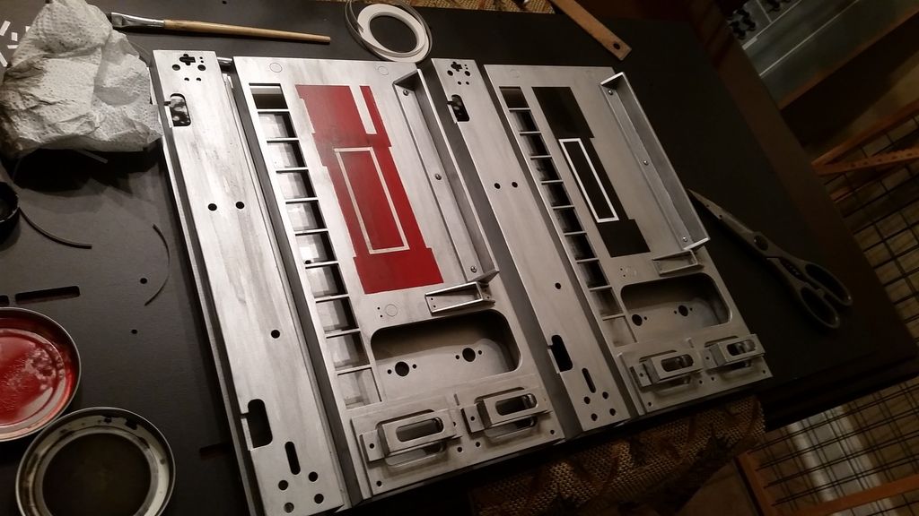

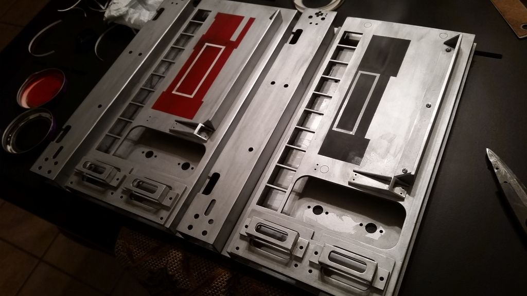

I finally drilled these holes

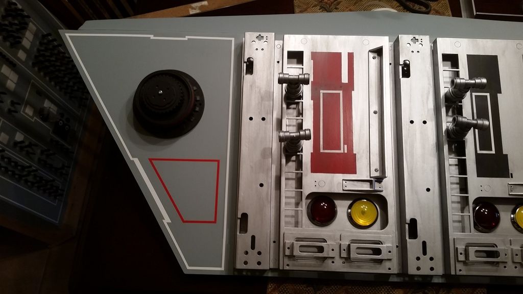

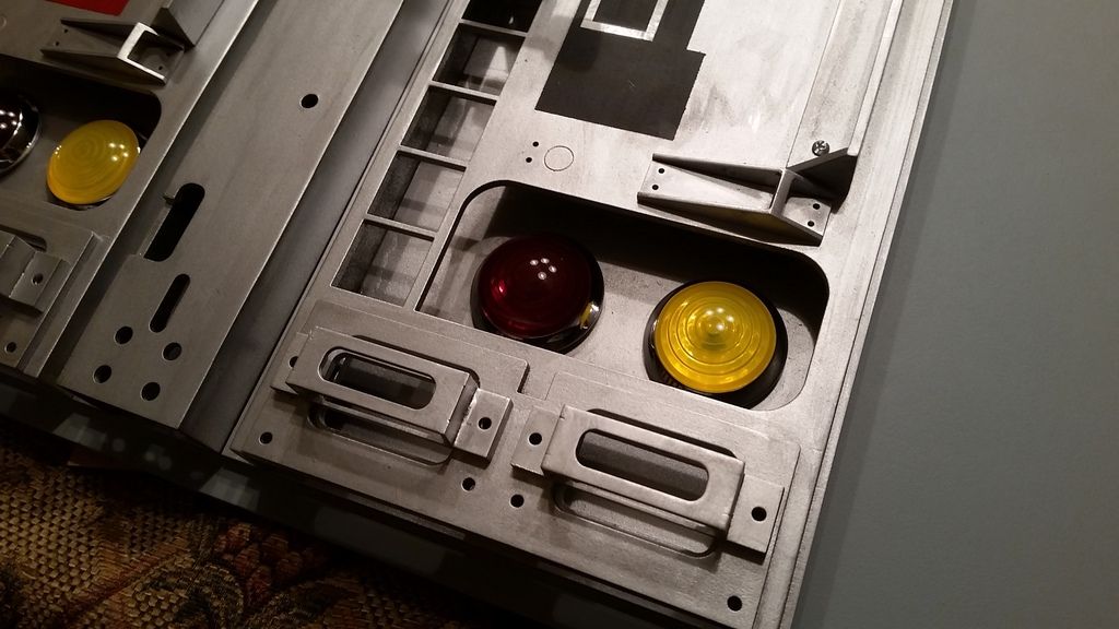

I finally added pinstripes to the foot well panels!
Whoops...

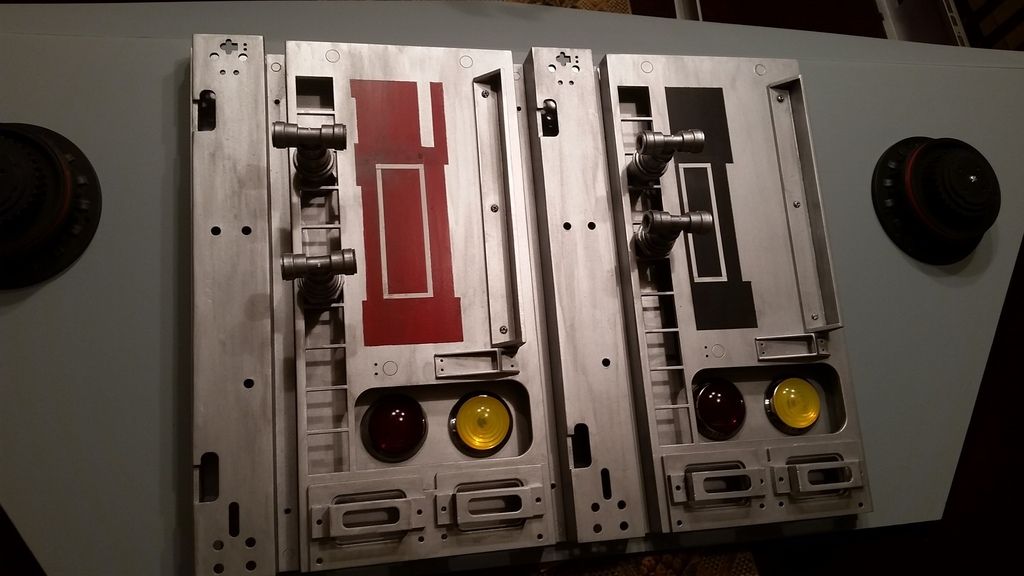

Add some weathering! FINALLY!
Close Up of the Panel Lights

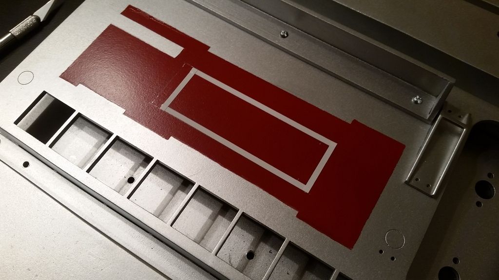

Something is missing...
PINSTRIPES!

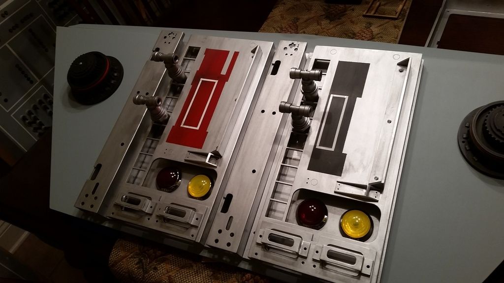

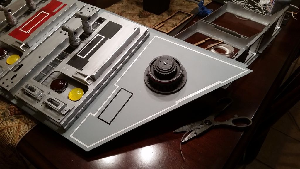

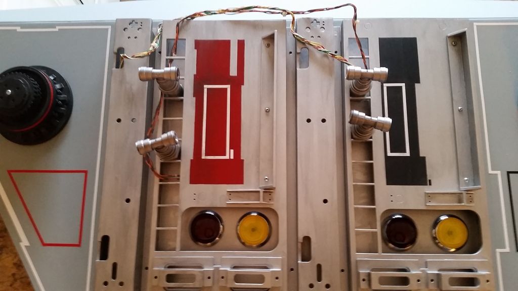

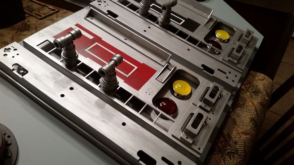

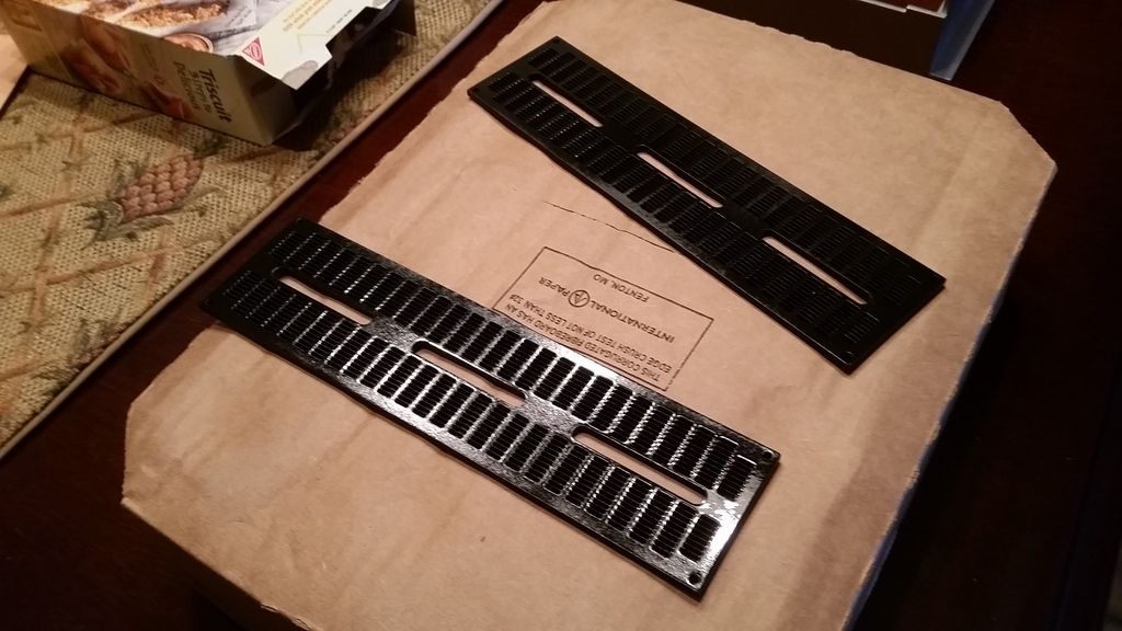

I decided to paint the new screens silver

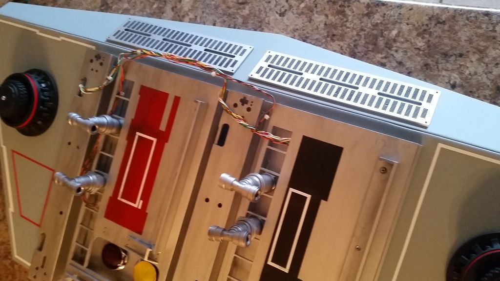

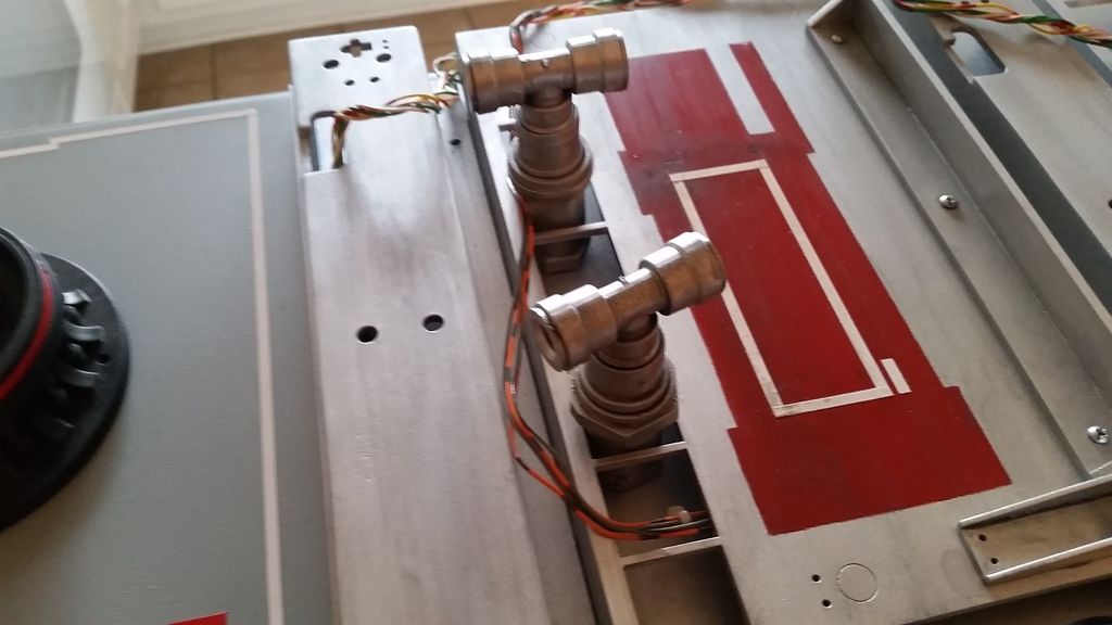

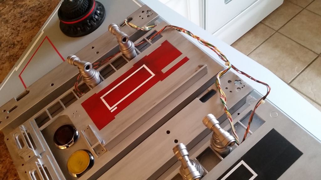

I then added some wiring
The greeblies sticking out of the panel are not bolted in place thats why they are not aligned...
Silver Screens - not yet bolted in place

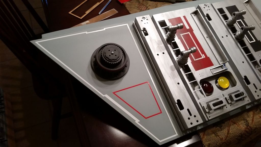

A few more greeblies to add and I think we can call this near finished!
More to Follow!
