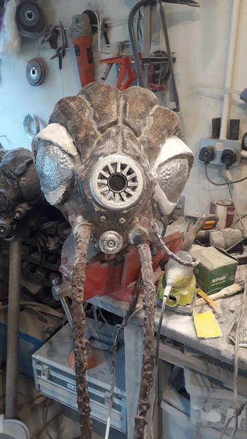

So, as you've guessed, I'm exploring the less famous bounty hunters. I'm well underway with 4-Lom and am working on Dengar too, but for now it's time for Zuckuss

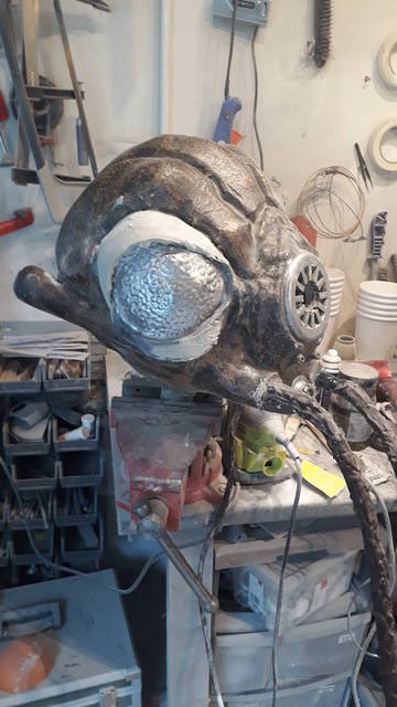

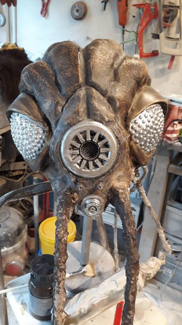

Modelled the head in Zbrush...not too dissimilar to 4-Lom but actually different enough to need a new sculpt.
Used Easylam resin sprayed on and then stippled as it cured with the compressor to get the mottled skin texture. Added the hoses and coated them with hot glue and latex. Just need to add the breather bottle.
I know the eyes are wrong...I'm working on them, I just modelled them like that to get a rough idea.

For the eyes, the actual suit used bubble wrap. You can just leave the eyes like you have them and glue bubble wrap (small bubbles, not tiny) to the eyes.

Actual bubblewrap? Hmm interesting
Quick update...got the eyes done. Yeah I read they used bubble wrap for the original eyes but it didn't look great for me so I stole an idea from another RPF member 'Skaught', who used drawer soft close pads...cheers dude.

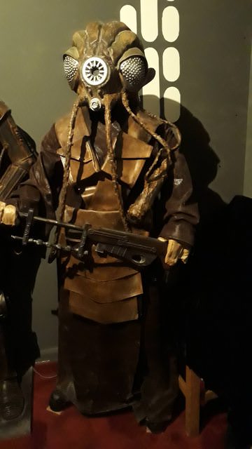

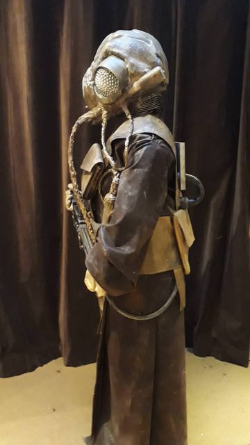

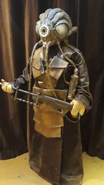

What the Zuck!...he's finished. I became very fond of dear old Zuckuss over the course of the build. I know he's a bounty hunting male Gand and all that but I think I see something a bit friendly about him compared to the other guys. Probably a bit of an underdog in the race to catch Solo and also a bit of a softee methinks
Anywho...here he is done
After the head was done I modelled and printed a bespoke mannequin which I fibre glassed and filled with PU foam. They don't really sell short, chubby mannequins

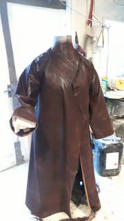

The biggest hurdle really was the Kimono coat. not many reference pix of the real costume and a lot of variations with the 1/6 scale figures. In the end I went for a faux snakeskin leather painted with red/brown fabric paint. Pretty pleased with the result. Had to make up the pattern to sew it all together and put a zip in the back
The rest of the costume is a tan pleather with heavy grain which was all sewn and weathered.

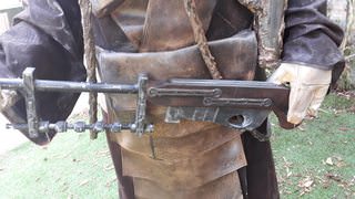

The 'Snare' gun was scratch built with a bit of 3d printing. The gloves are leather rigging gloves re-sewn for 2 fingers

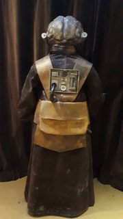

Back panel 3d printed with a few greeblies...and here he is
