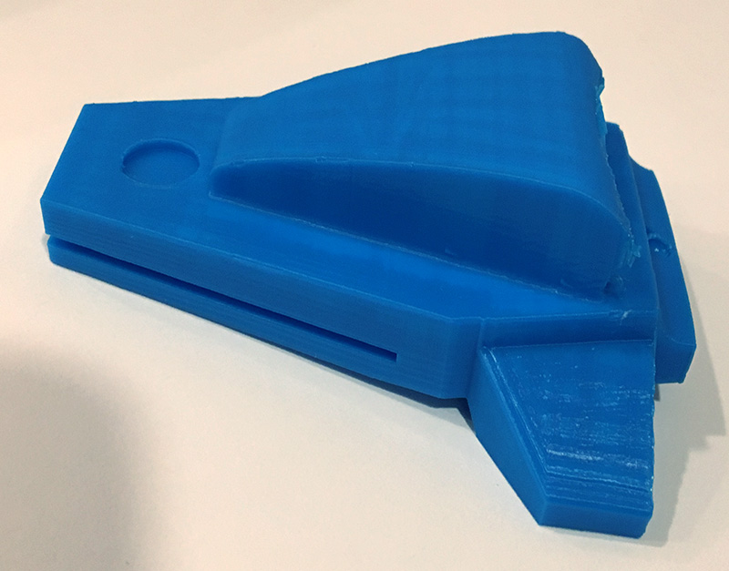

Prototype hot off the PLA printer. I pulled the supports off, but this is pretty much no finishing whatsoever. Surprised at how clean it is.

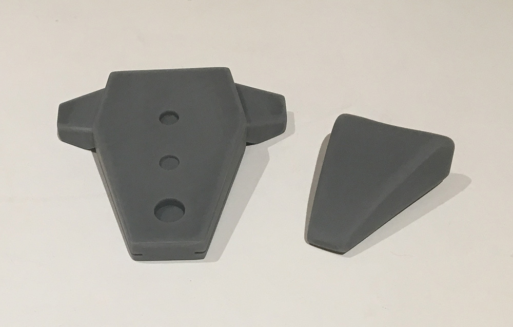

OK, after inspecting the prototype, I've made some changes. Added some softer radiusing on the red button thingy and changed the shape of it a little bit so that it's a closer match to the screen prop. The agonizer will be produced in two parts. The main body and the top red button thingy. That will make finishing and painting a lot easier. 3D models done. I'm producing the next prototype in resin. Will update as soon as I have a print in hand, hopefully in the next couple of days.

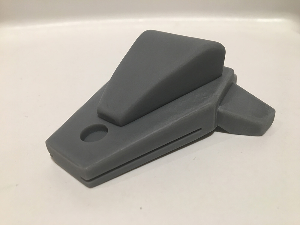

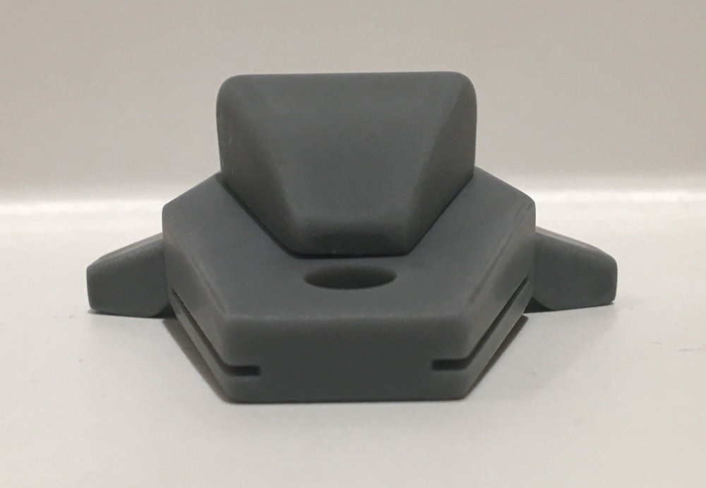

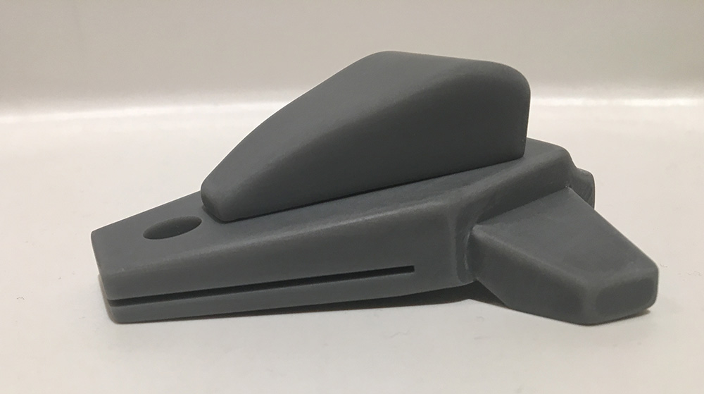

Final resin prop just off the SLA printer! This will take very little clean-up to finish.
tJ

I’ll be finish sanding this tonight and will post more pics.

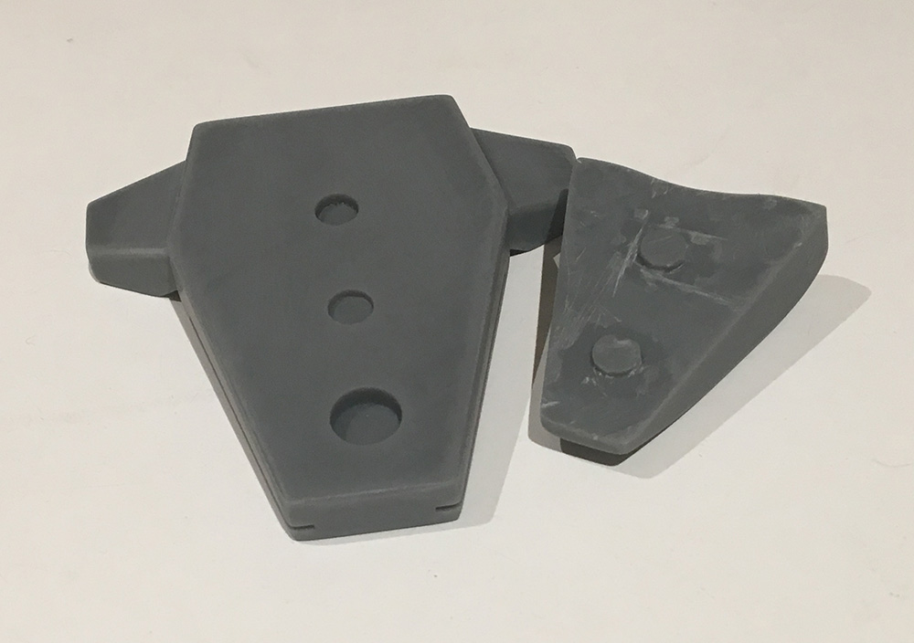

After 10 minutes of sanding with 220, 400, 800, 1000 sandpaper. I'm priming and painting this tonight. Will post more pics of the painted prop tomorrow. Still am working out what to do for the buttons. I can 3D print those as well, but I'd like to find metal ones. Will keep you updated.

agonizer-sanded8.jpgagonizer-sanded6.jpgagonizer-sanded4.jpgagonizer-sanded5.jpgagonizer-sanded7.jpgagonizer-sanded2.jpgagonizer-sanded3.jpgagonizer-sanded1.jpg

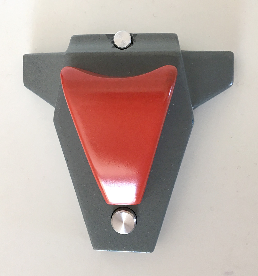

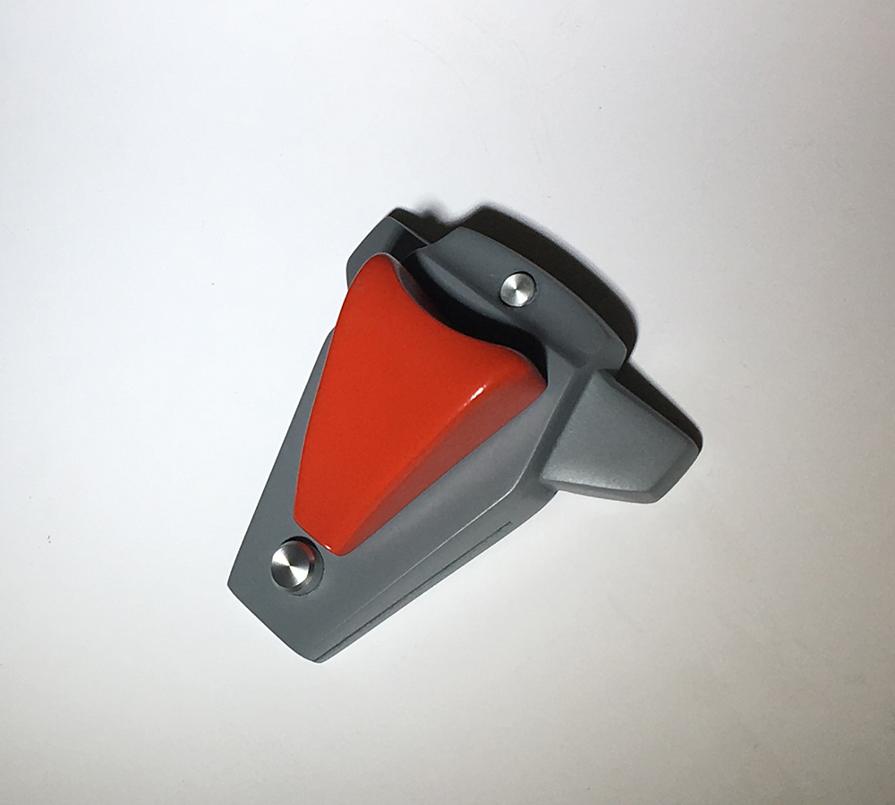

OK, painted prop done. I have sourced what I think are going to be the perfect buttons, which I'll install as soon as I get them in the mail. In the meantime, check these pics out!
It took less than 1/2 hour from the time I picked the agonizer off the print bed to getting it to this point.
tJ

Beautiful work! To me, the grey looks a little too dark, but I'll be honest, I think in my minds eye it should be "phaser grey" so it matches the rest of the equipment. I'm not going to challenge the color you chose, though as you clearly did your homework on the piece. :thumbsup

Yeah, the lighting in the pics make it look darker than it actually is. I'd like to say I know exactly what shade of grey it is, but the truth is, I eyeballed it. Paint can always be redone if necessary.
The buttons came in and I can see I will have to make a slight change to the rear button recess as mine is a bit too small to accommodate the button. I drilled out the hole (and chipped the back in the process), but I was able to fit it. I'll make the change to the model and the next one will accommodate the button perfectly. Here is the finished agonizer:
tJ
