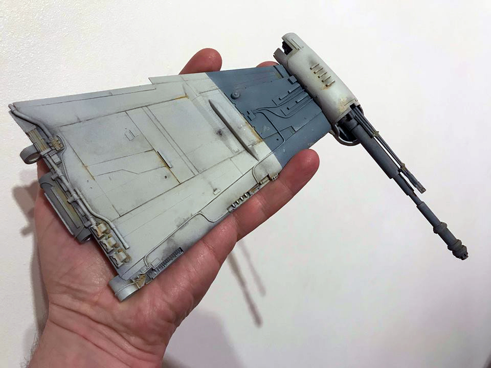

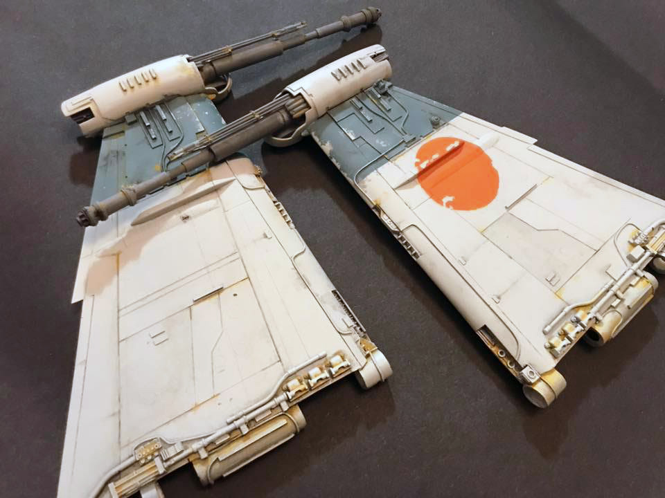

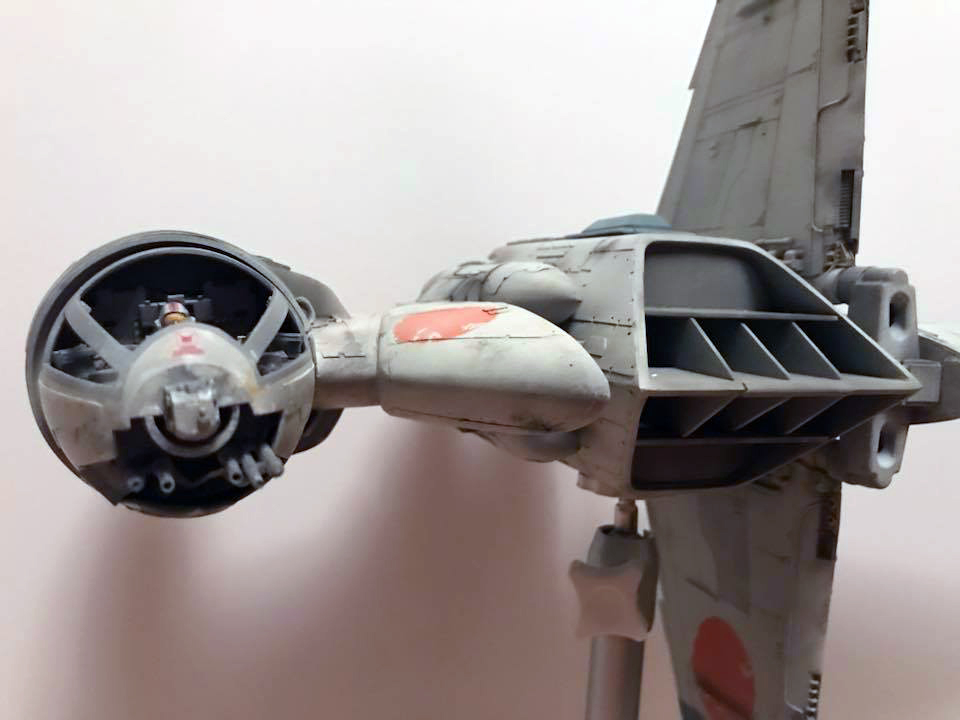

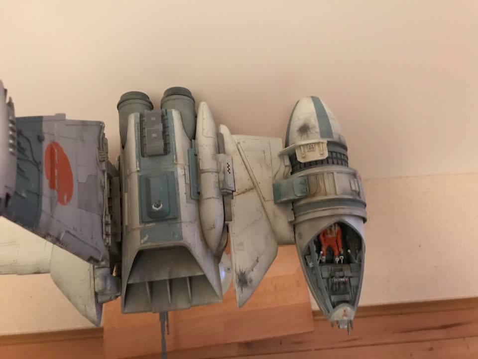

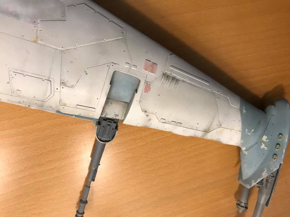

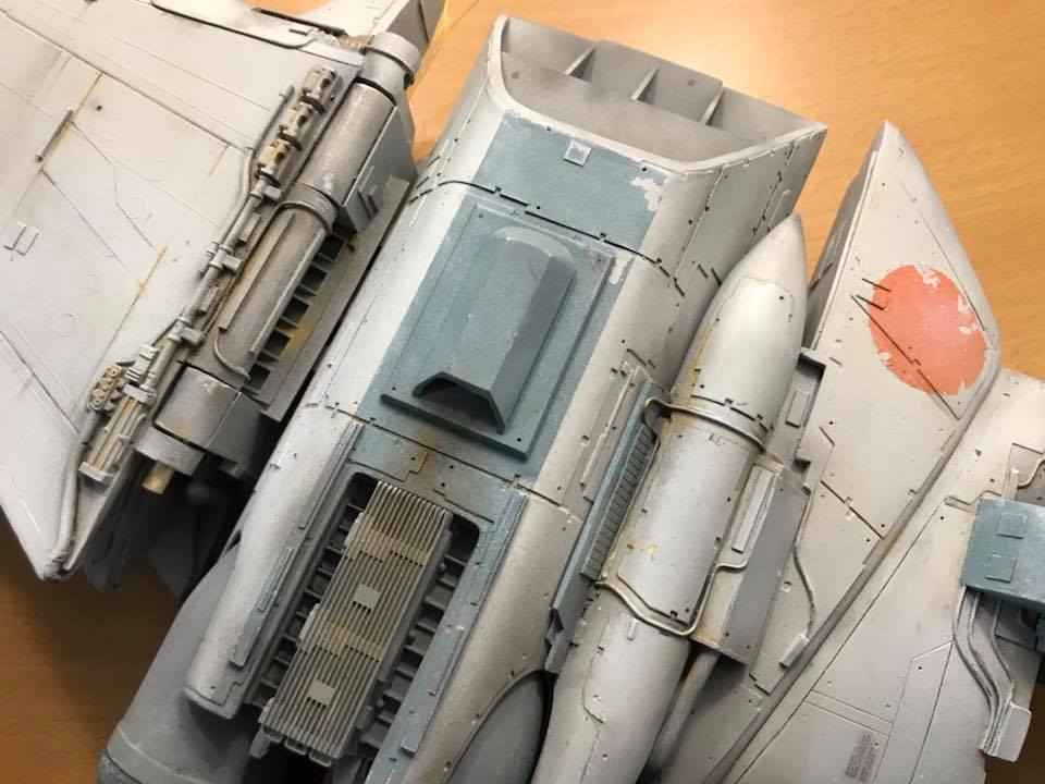

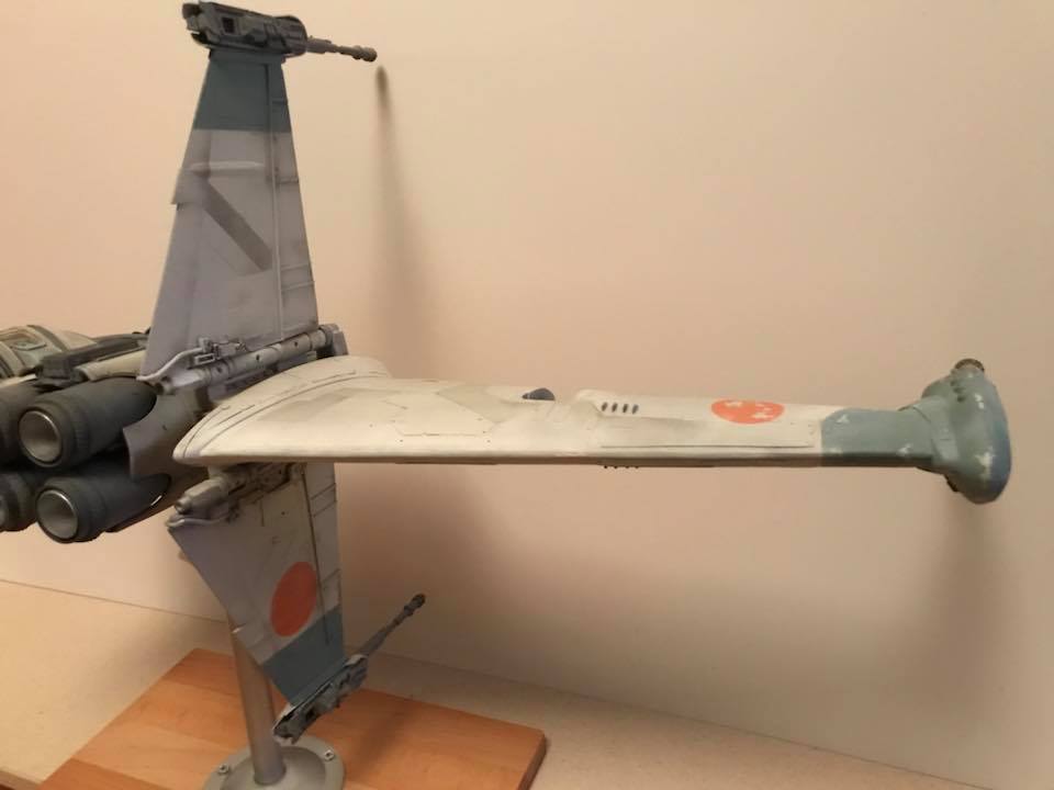

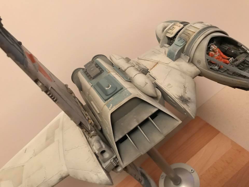

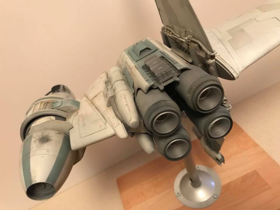

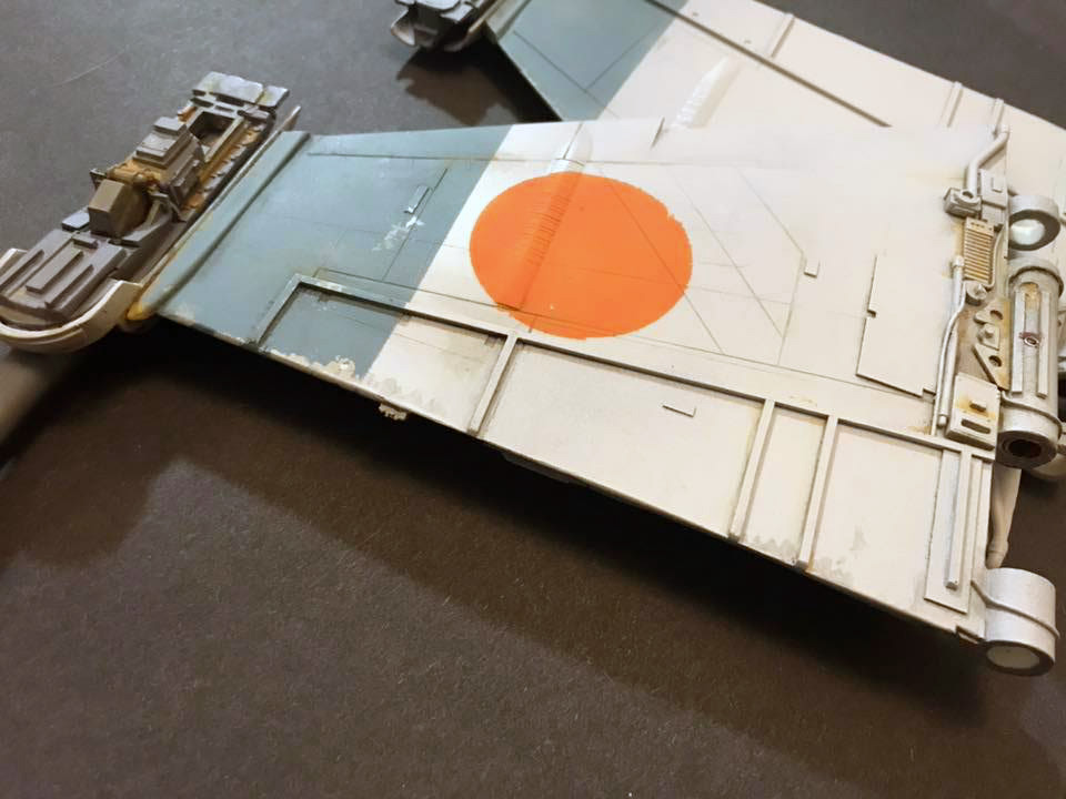

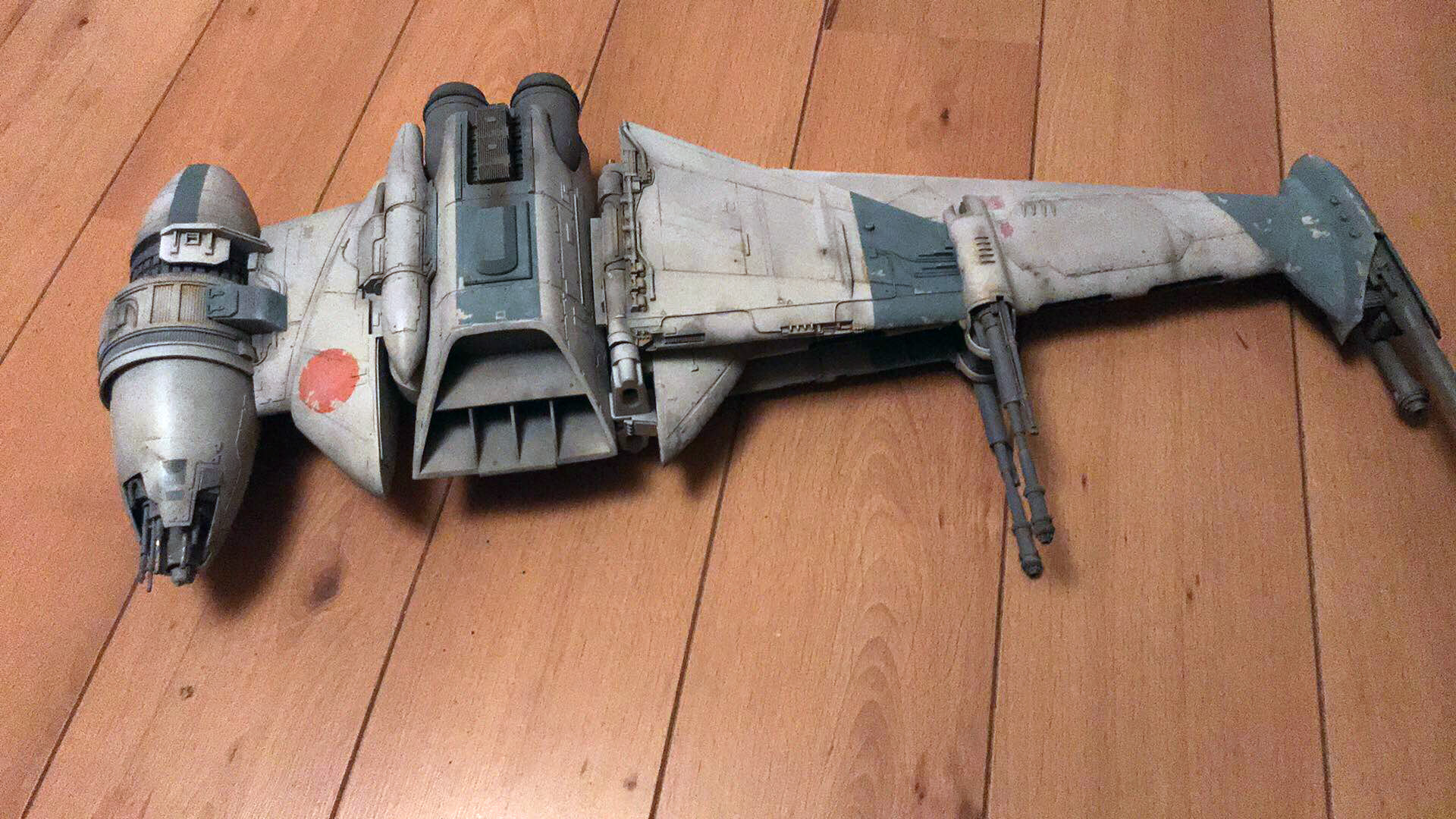

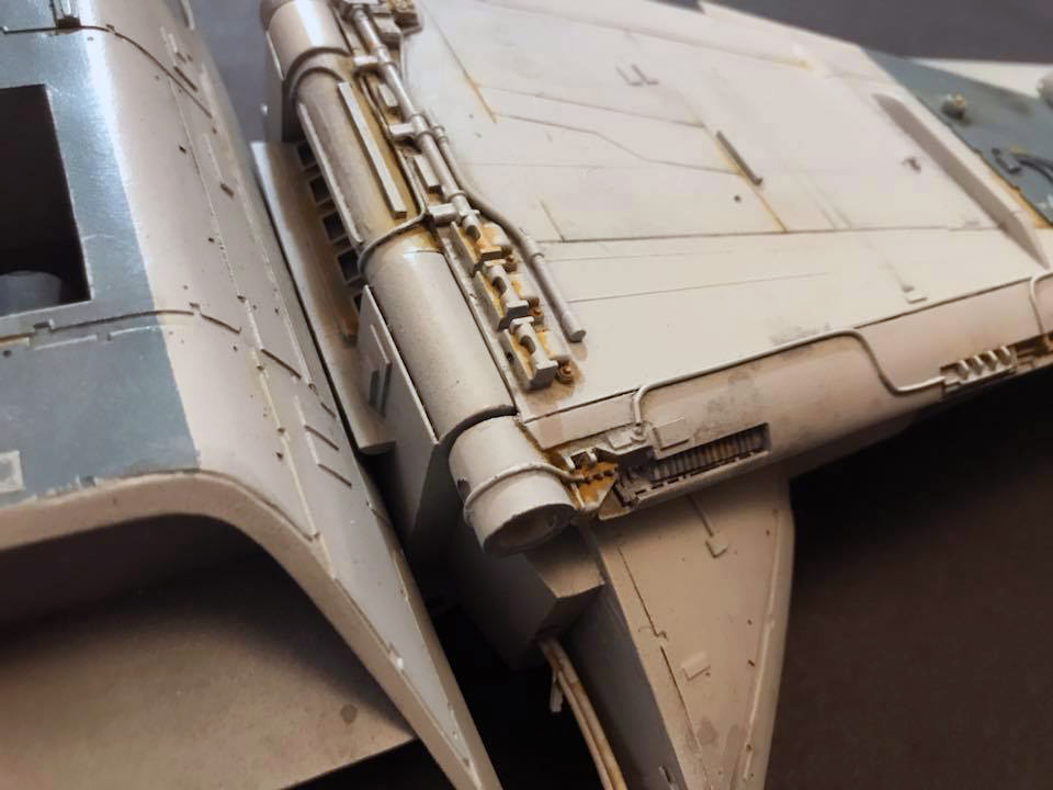

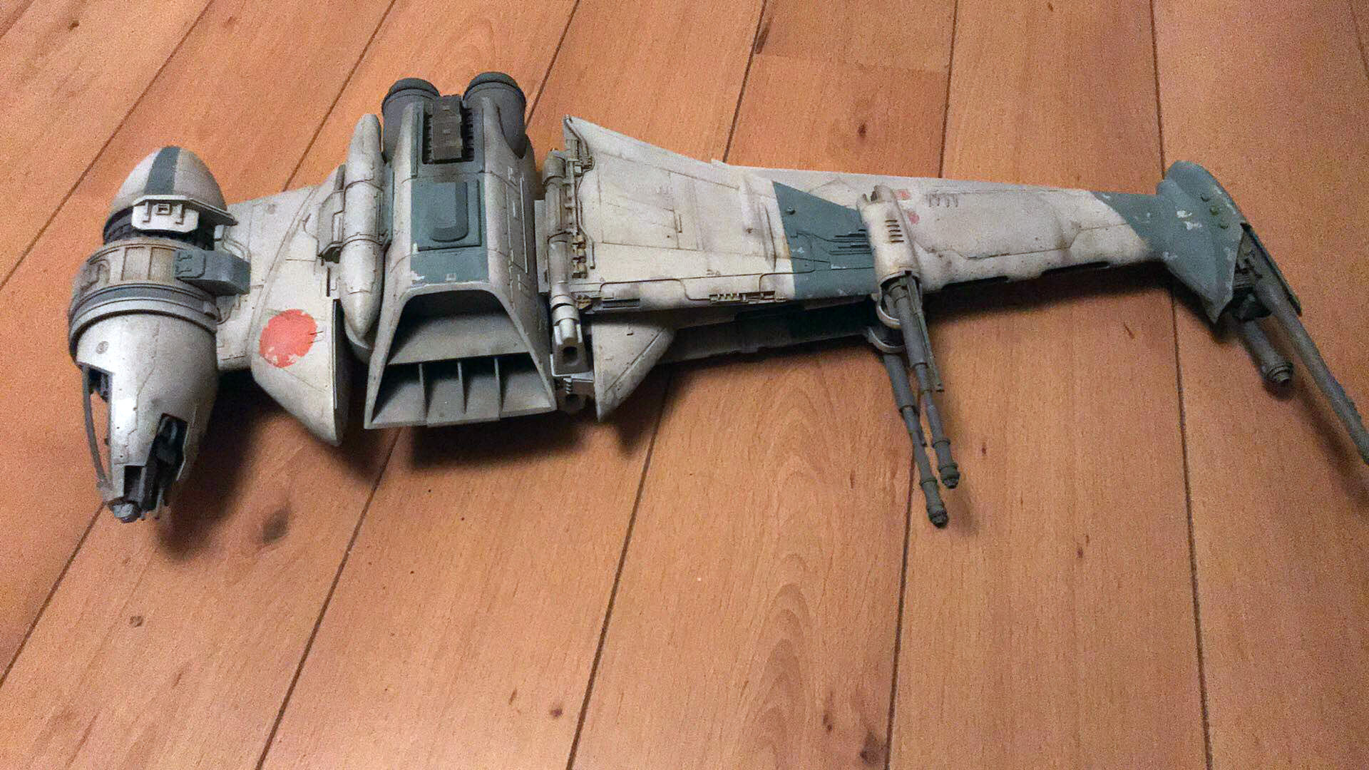

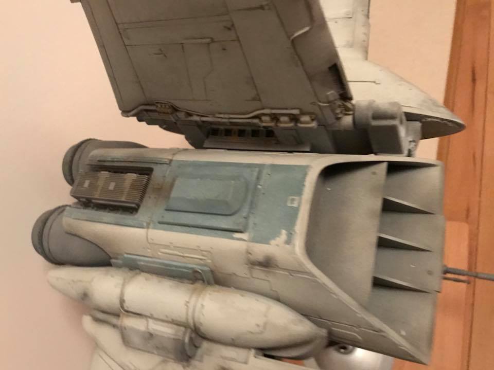

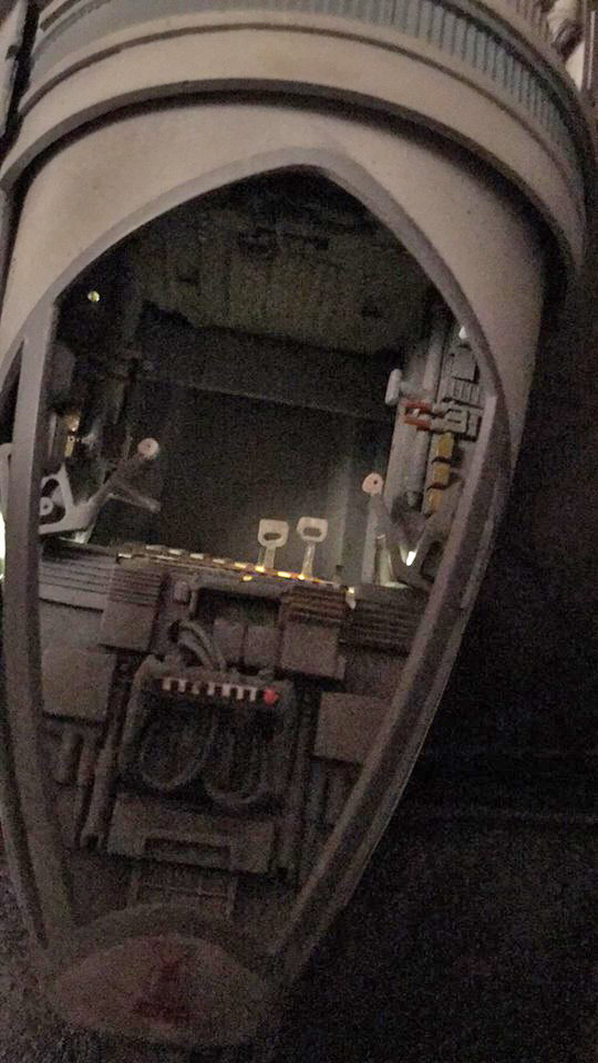

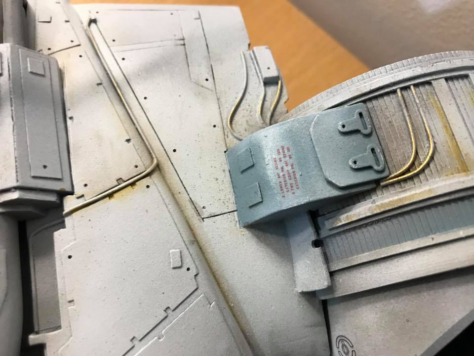

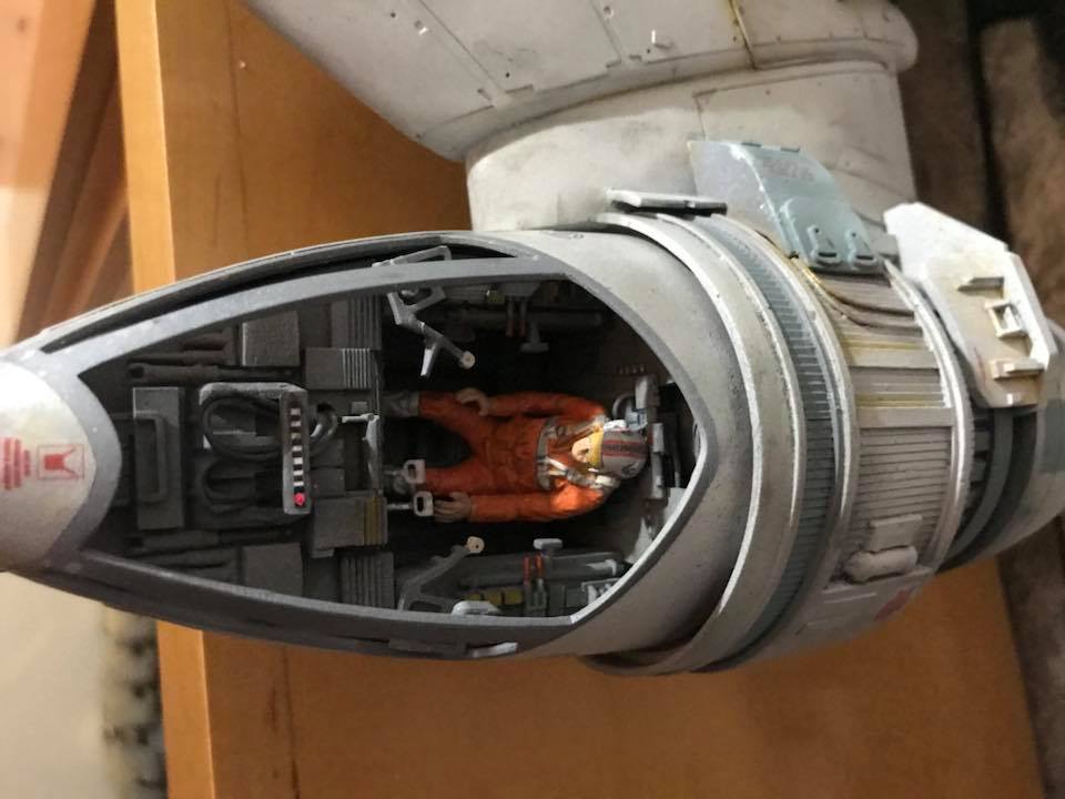

Hey just showing my progress on the fantastic B-Wing kit by Steve Neisen,....I'm very nearly finished, so I'll show pics of where I am now & then go back & show older images of construction
28308900_2044655965756427_646872761_n.jpg28236534_2044655982423092_743129008_n.jpg28236678_2044655972423093_1867644219_n.jpg
attachment.php
attachment.php
Thanks for looking

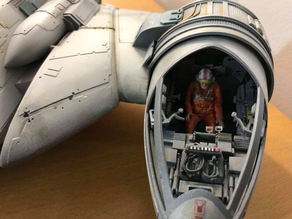

Simply fantastic! I've never been a huge b-wing fan until I saw these images. You nailed it! All Archive-X?

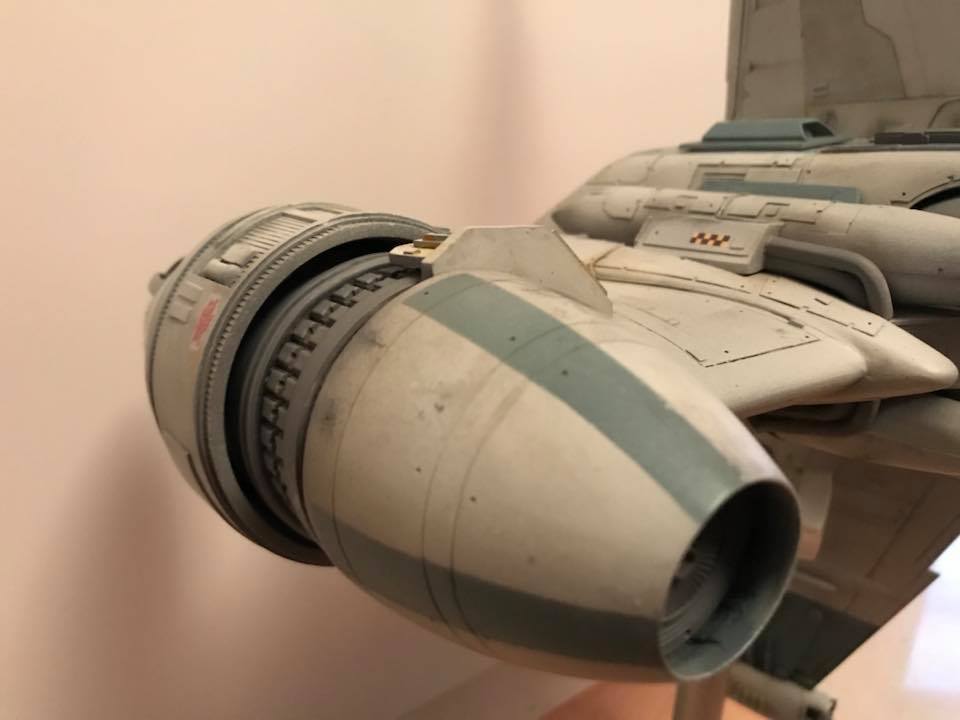

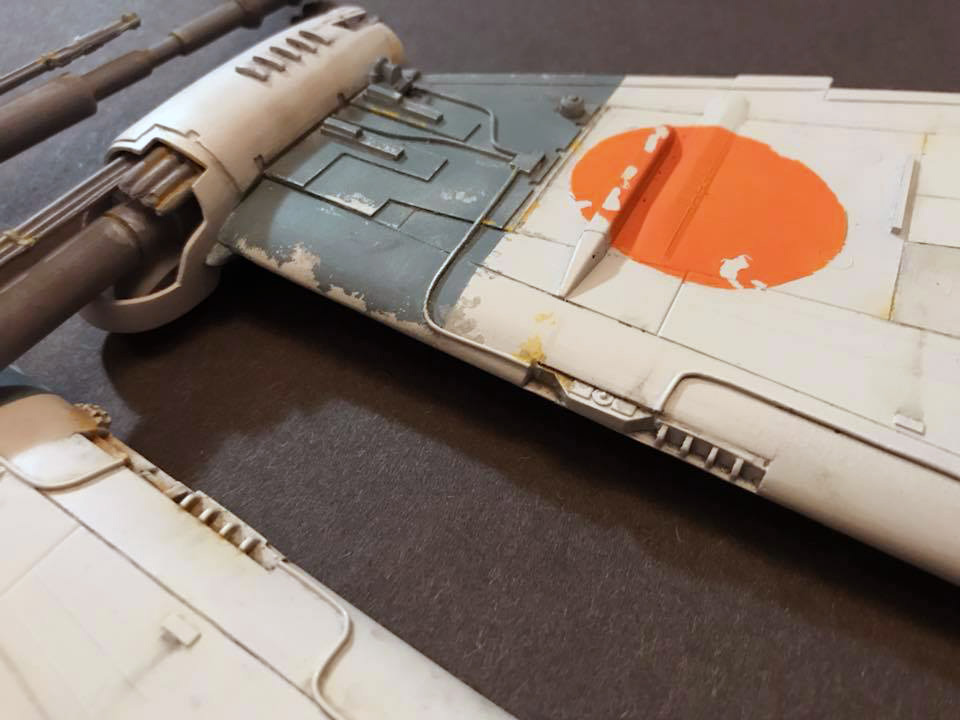

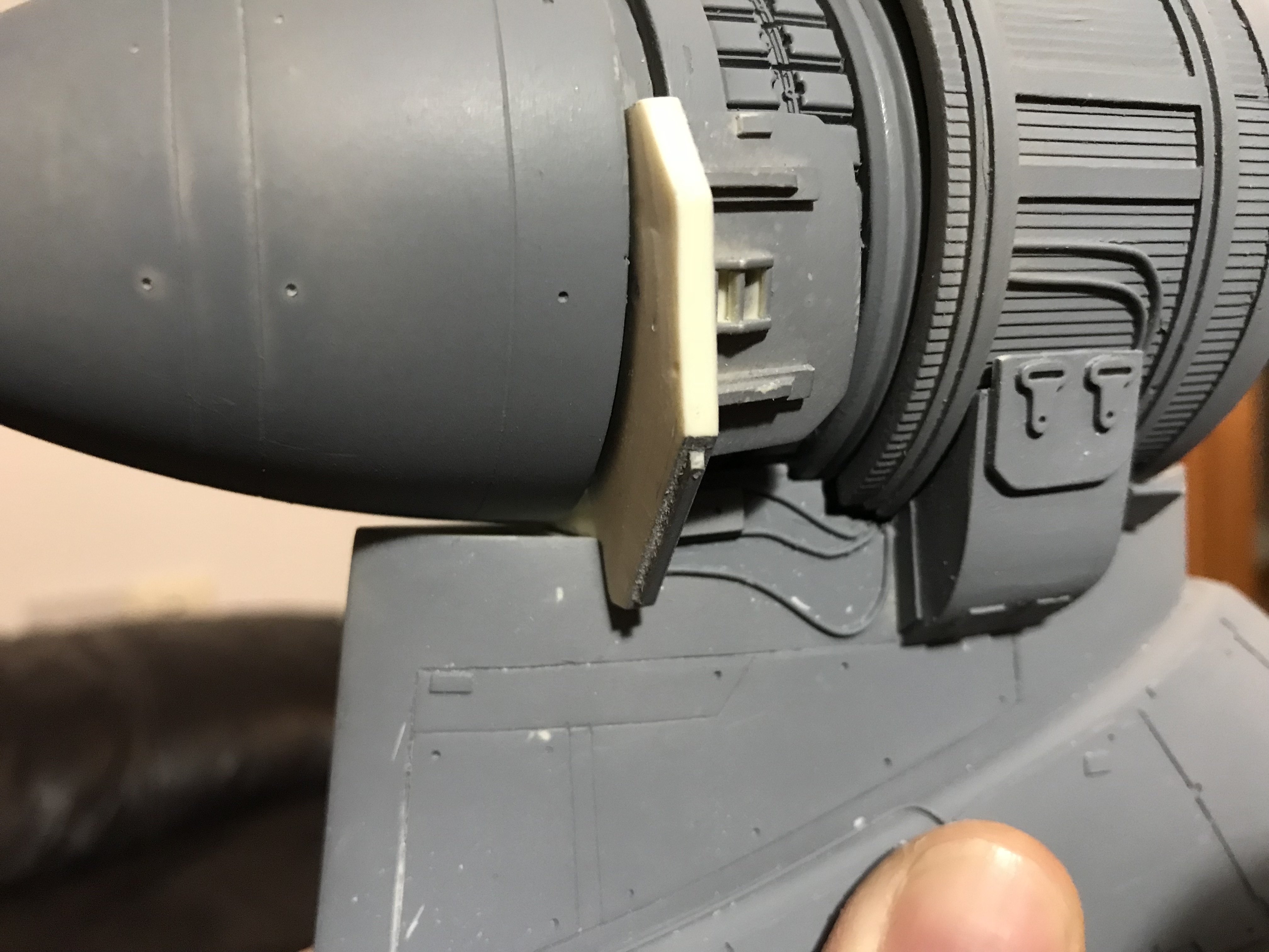

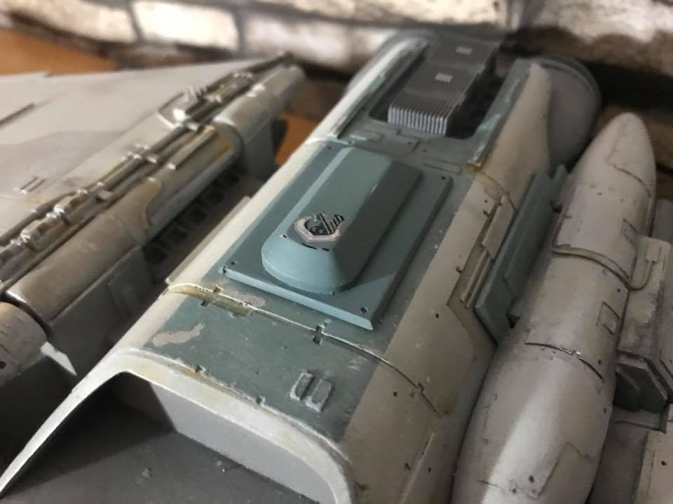

Well, when it came to starting the painting, Guy was away in Japan or somewhere,....I couldn't wait till he came back, so I ordered Tamiya AS20,....I'd used Archive X on a DeAgo Falcon & it was beautifully smooth & a dream to airbrush,....so using the AS20 rattle can was a horrible experience,...splattery, thick & very slow to dry.....I then mixed my own colour for the blue/grey areas with Vallejo acrylics.....still couldn't get it right,...too dark,....but pretty quickly I got the proper stuff from Guy......then things began to get better for me

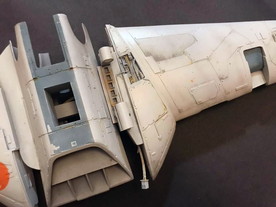

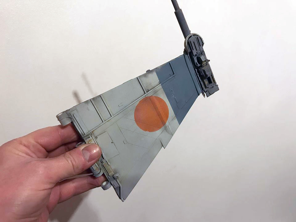

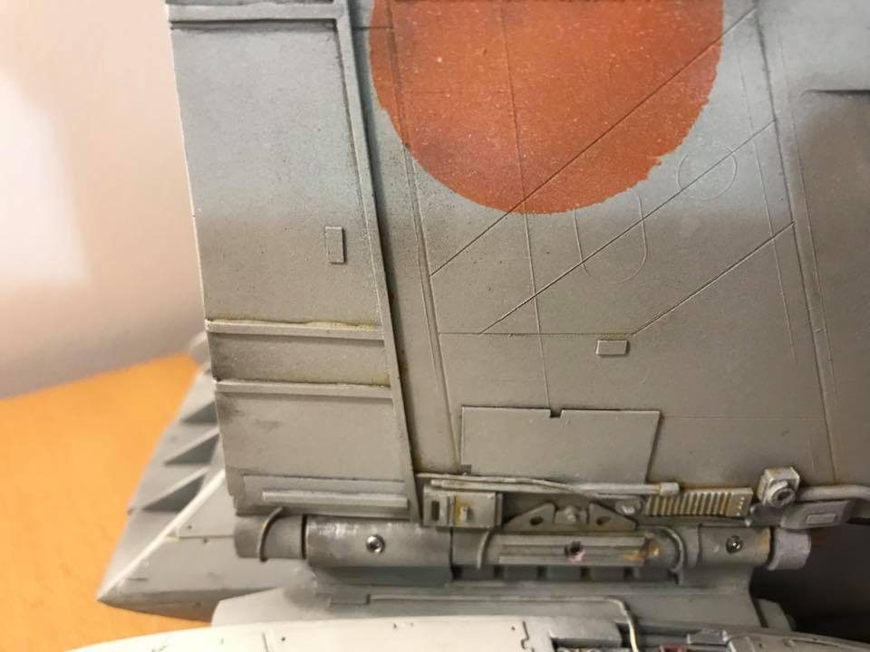

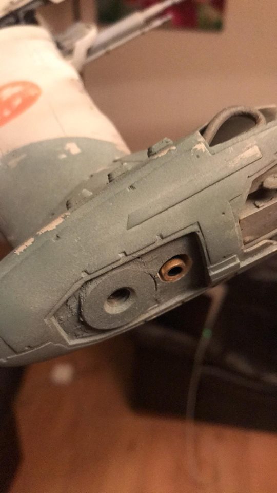

I see you've drilled out the wing joints - what are you going to use for the hinge mechanism to maintain the friction for the wing positions?

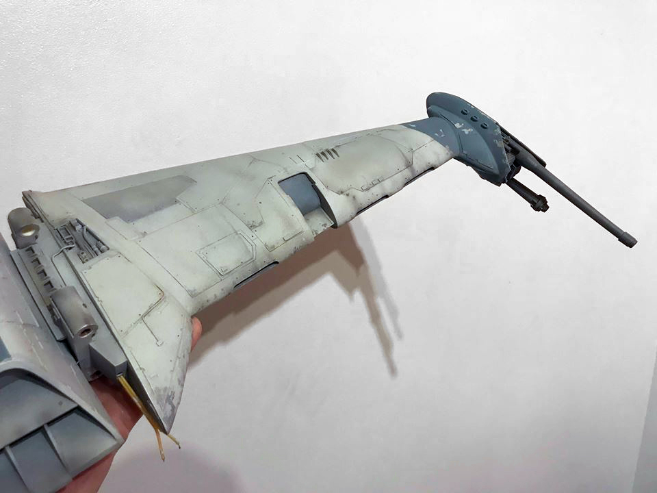

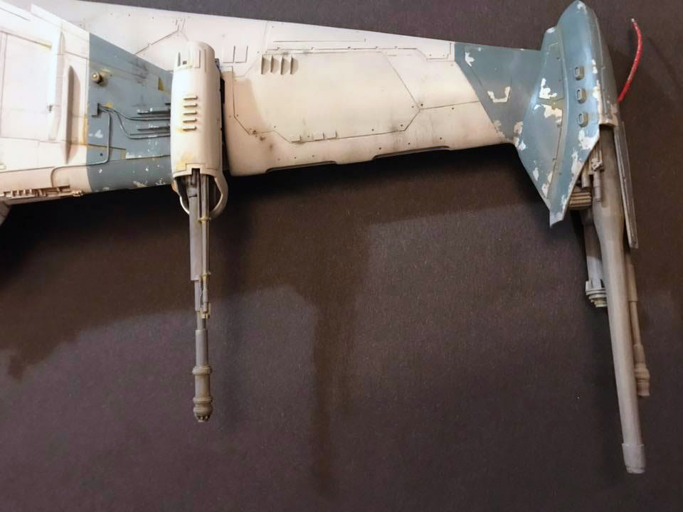

G

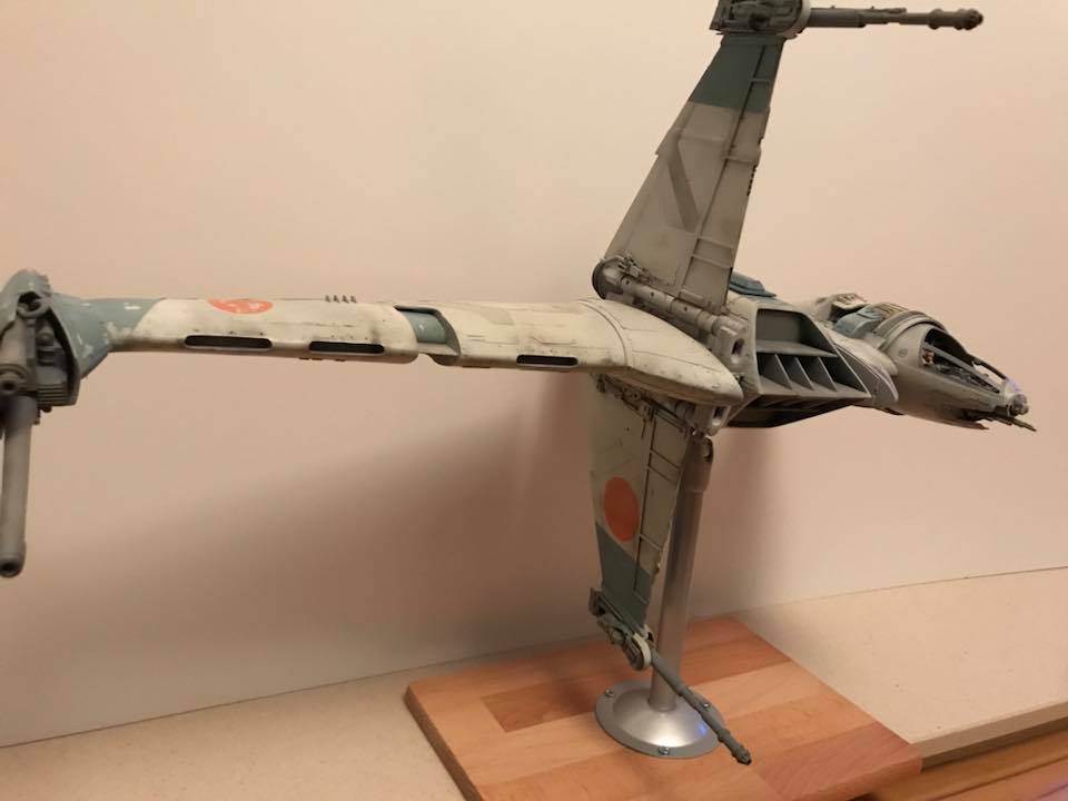

Yes Graham,...I drilled out the joints using a 6mm drill,....pretty scary,....but luckily no fractures,....I bought some 6mm copper tube & a 4mm brass rod that fits inside the tube....to tighten, I bought 3mm allen grub screws, to go through the copper & grab the brass
So 3 grub screws on each wing.....I'll take some more pics soon

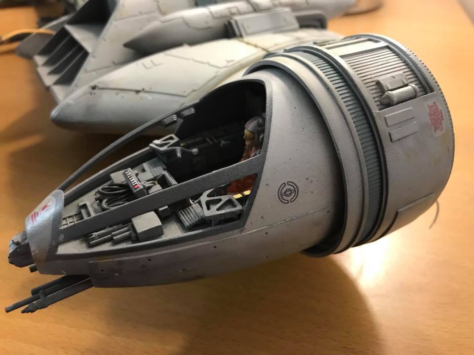

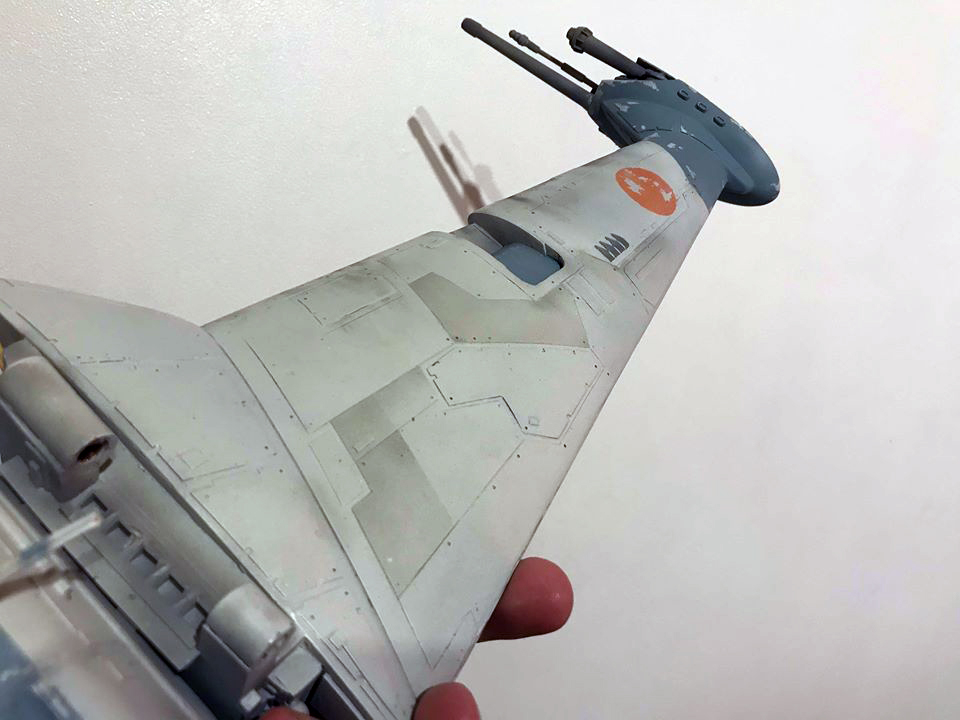

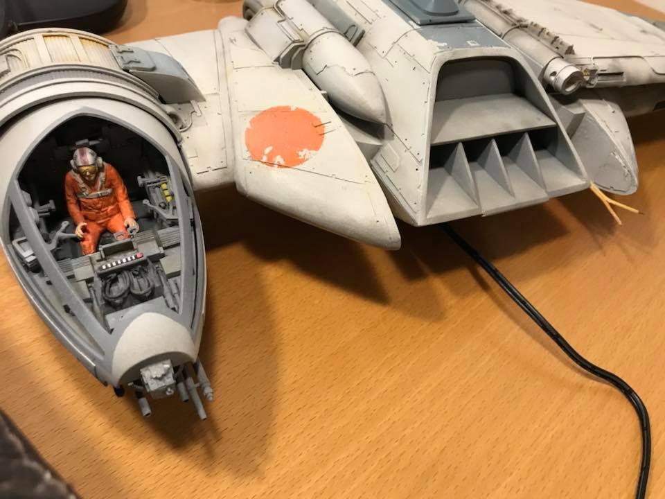

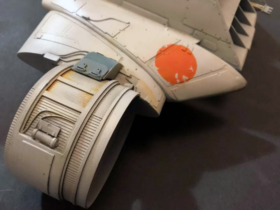

I've done some more on the B-Wing.....Decals etc
28468557_2049176358637721_2997506028173035068_n.jpg28276506_2049176355304388_8887829993767964146_n.jpg28168340_2049176331971057_2615333643657119371_n.jpg
attachment.php
28167870_2049176265304397_5245075512241760104_n.jpg28167955_2049176261971064_1273602013654914460_n.jpg28379114_2049176255304398_161102510286565856_n.jpg28378553_2049176258637731_3377921013480446955_n.jpg28377973_2049176515304372_4309800990554729040_n.jpg
28276474_2049176415304382_8300792080133813476_n.jpg28378637_2049176421971048_3686643343298776488_n.jpg28379067_2049176518637705_6723986665635785745_n.jpg
attachment.php
attachment.php
More decals,....then lights
Thanks for looking

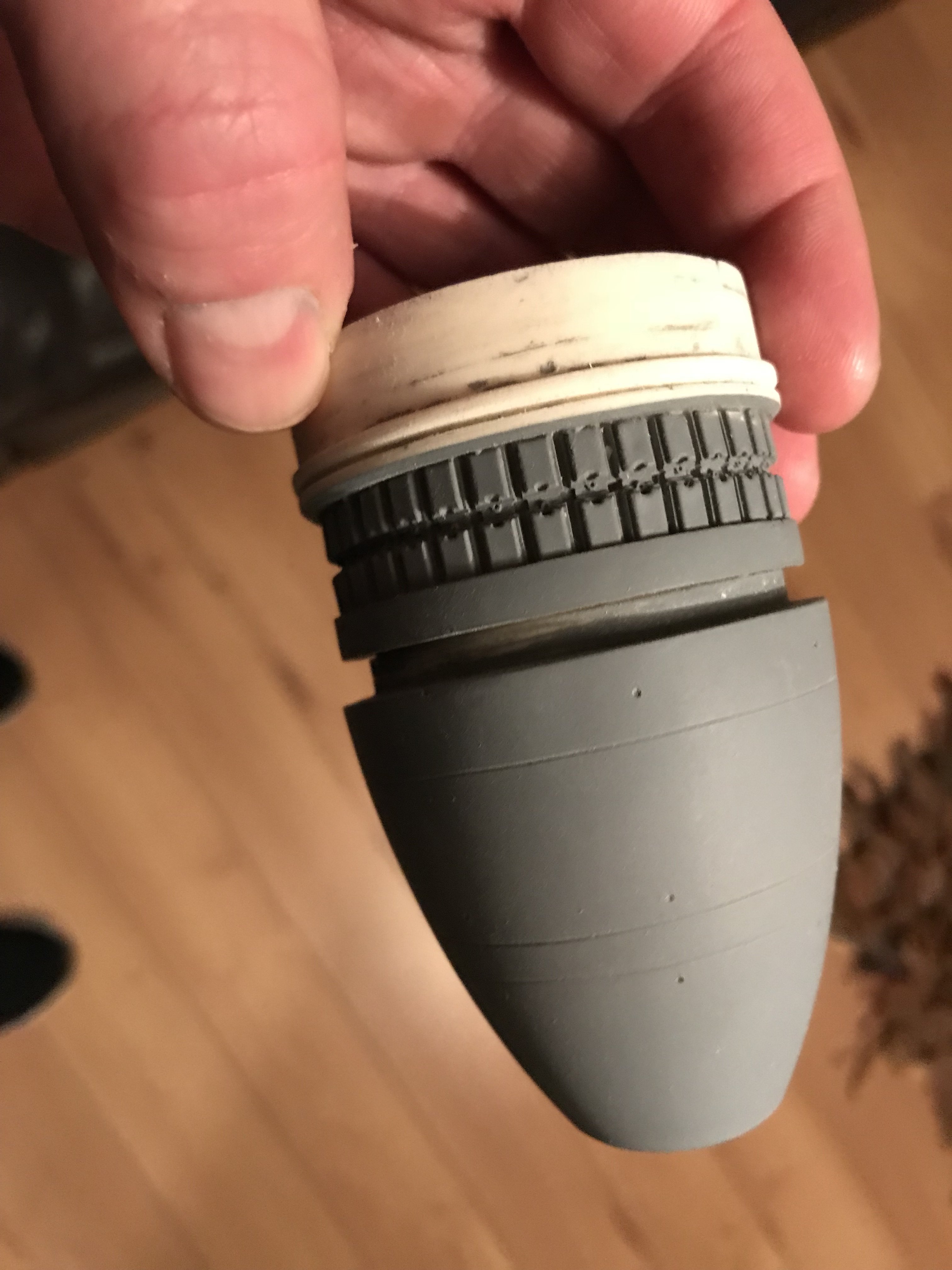

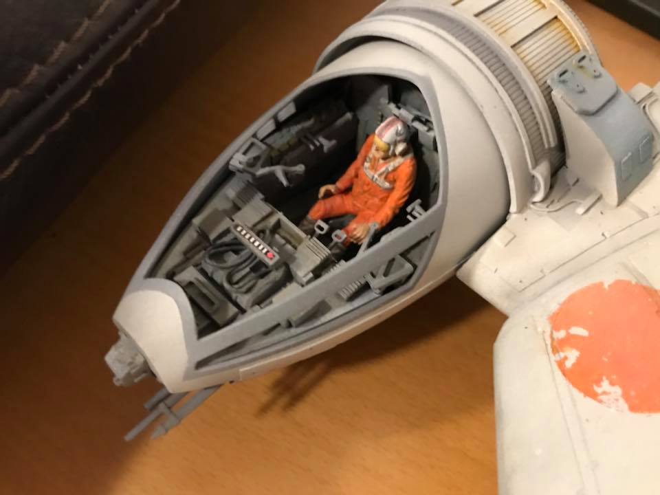

Just so you know... it's fixed wing, and also fixed cockpit. Jaitea above was very brave to add hinges to the wings. I plan to make my cockpit rotate, and to do that I need to scratch build the flat part of the Flakpanzer Gepard tank track ring.

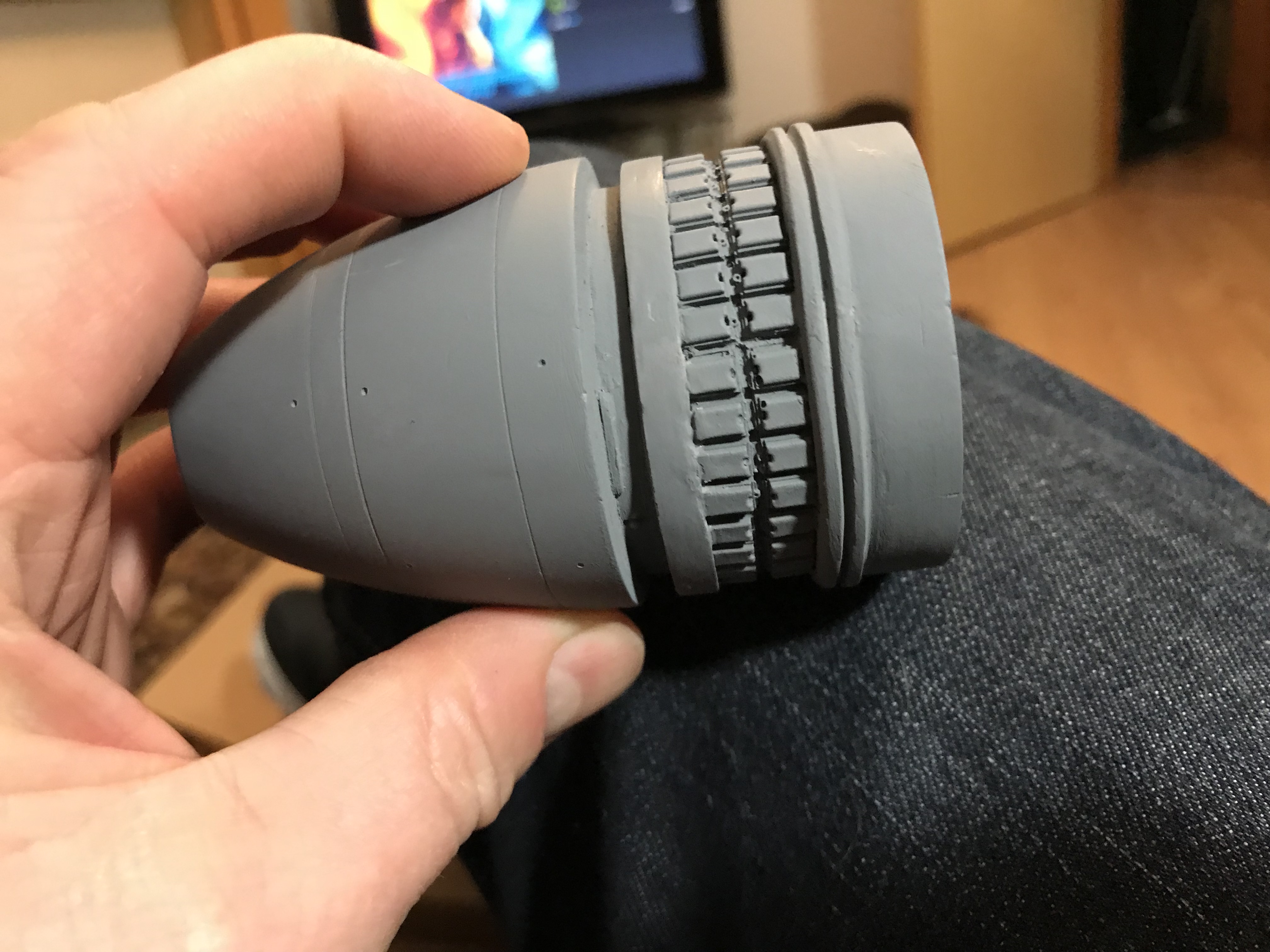

Yes indeed,....I made a cast of the pattern, then cut out a section to continue he pattern

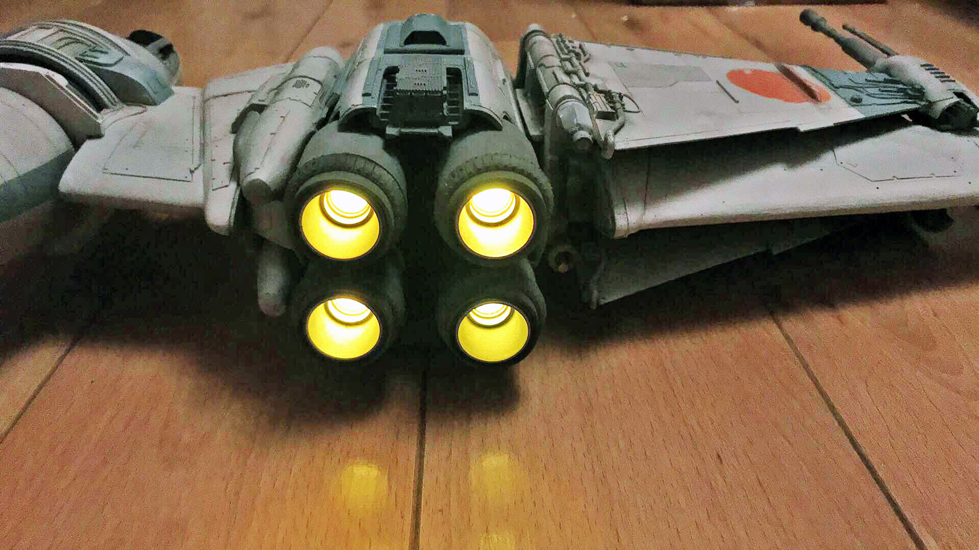

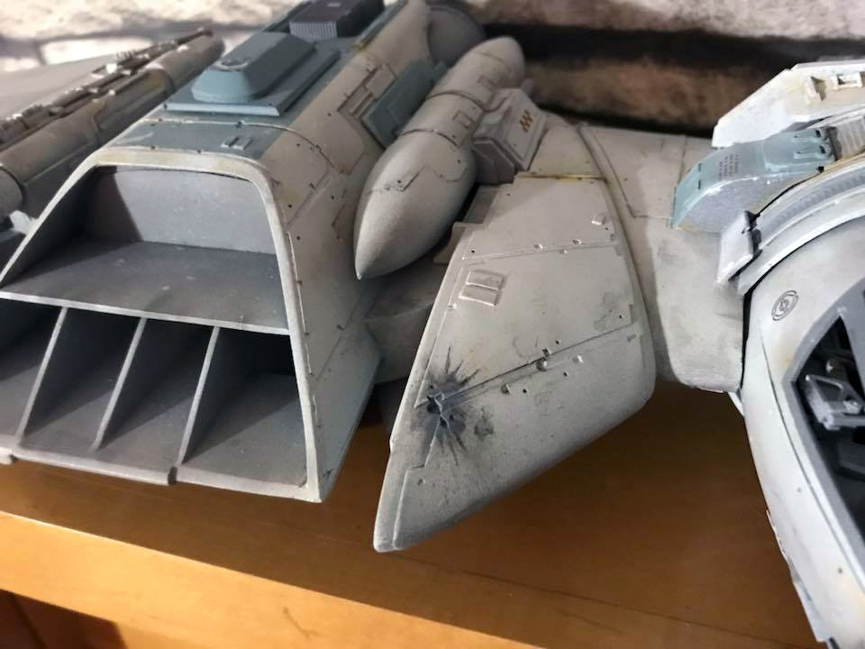

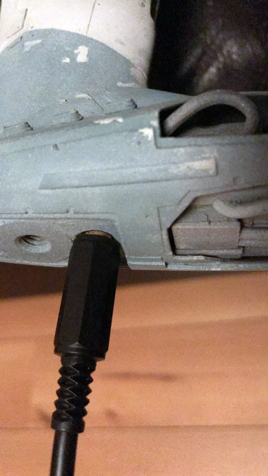

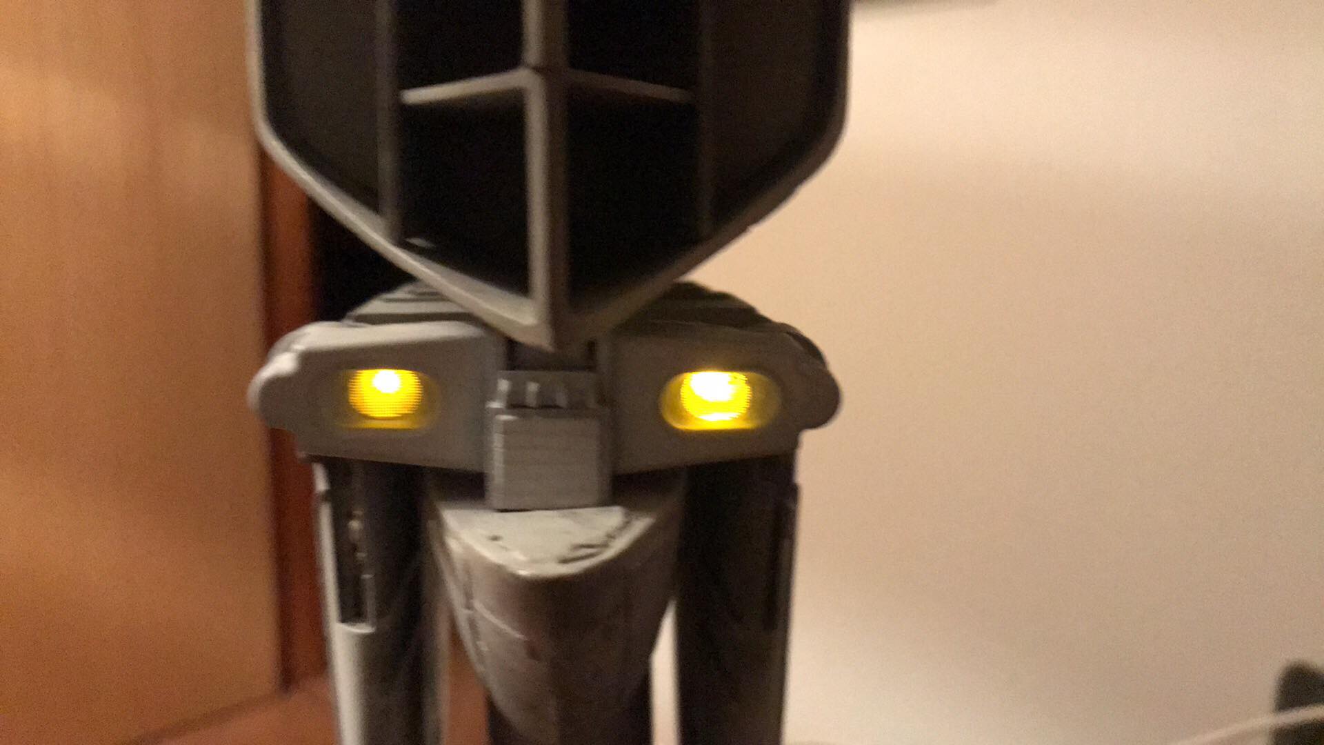

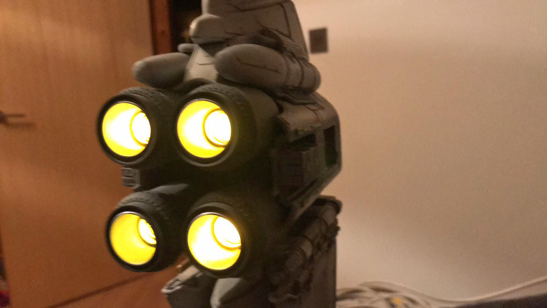

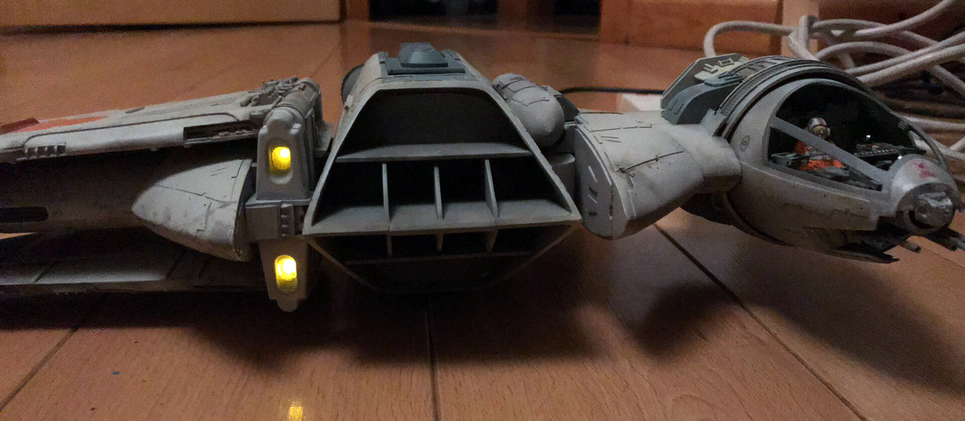

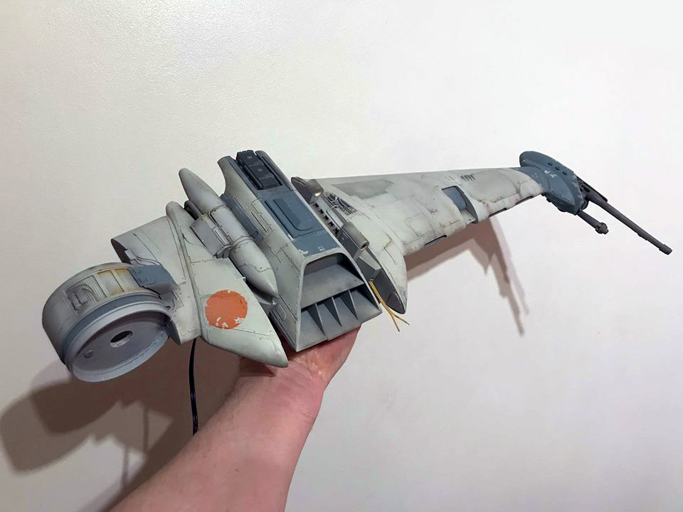

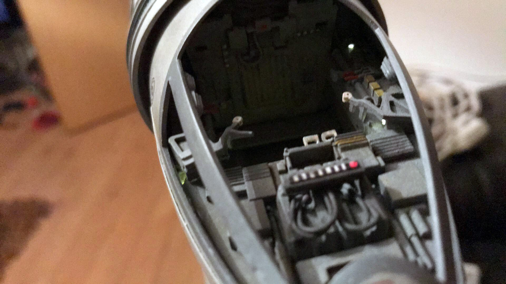

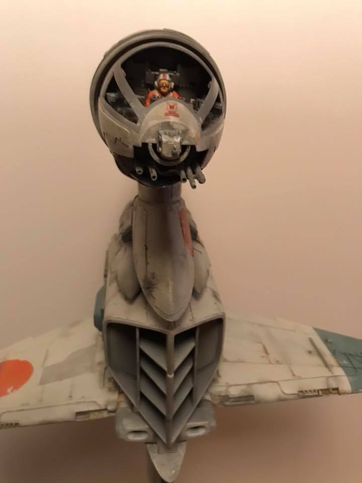

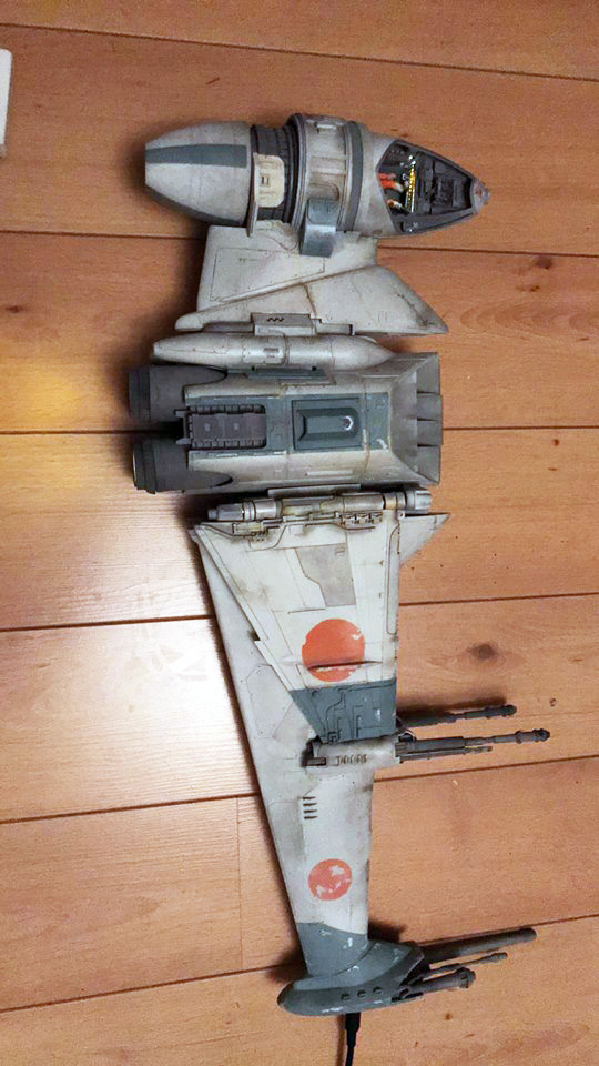

I'm very nearly done on this one.....not a lot more to do....attach a couple of parts,....resin in the mount screws.....a bit more weathering....lastly attach a few decals.....then she will be flying across the Atlantic....LED's powered by USB charger
29178996_2059863287569028_651000429416546304_o.jpg29134093_2059863454235678_8698662067055362048_o.jpg29178802_2059863507569006_1667019297412612096_o.jpg29178487_2059863687568988_2921664117422948352_o.jpg29177937_2059863784235645_5041339540103495680_o.jpg29133499_2059863864235637_549766667270356992_n.jpg29186207_2059863580902332_2487828478716542976_o.jpg29133695_2059861744235849_4173992133289574400_o.jpg29196511_2059861564235867_3347007377424515072_n.jpg
29178187_2059863107569046_3998195011580592128_o.jpg29176713_2059862634235760_8267381371249360896_n.jpg29176793_2059862504235773_1142654522724712448_n.jpg29177196_2059862367569120_269079920137732096_n.jpg29214766_2059862120902478_1313724246945431552_o.jpg29178648_2059861840902506_5626005462353707008_o.jpg29196636_2059861360902554_2254306532692852736_n.jpg29136027_2059863260902364_7355002769935171584_o.jpg
Thanks for looking,...next time I'll take better photos

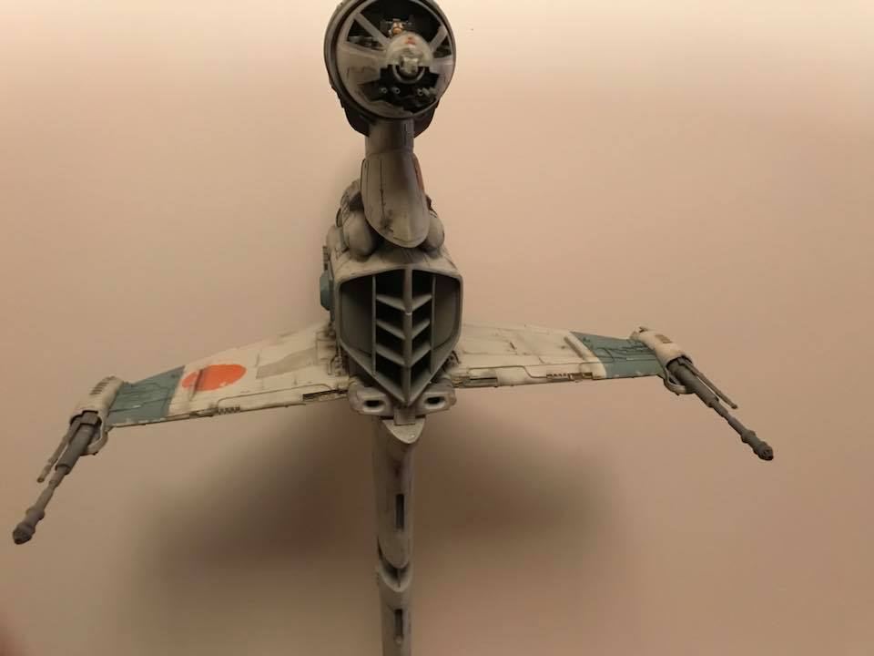

I'm almost finished,....just a few decals & touch ups......got the mounts finished
29432868_2064714203750603_8678386286660157440_n.jpg29432996_2064714120417278_2456633826303016960_n.jpg29389388_2064713823750641_3611649836136267776_n.jpg29425084_2064713613750662_3882515539251167232_n.jpg29425151_2064714123750611_5216660083651379200_n.jpg29425250_2064713600417330_6326744400491708416_n.jpg29425691_2064714213750602_3927322106961854464_n.jpg29426078_2064713607083996_1050492715055185920_n.jpg29432536_2064714020417288_35496938333798400_n.jpg29472242_2064714110417279_2203979085170868224_n.jpg

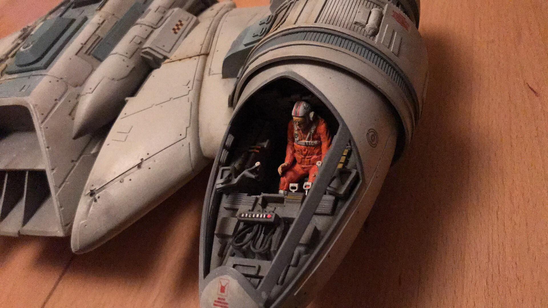

Wing hinges were terrifying to drill - your grub screw idea is great! I 3d printed a cockpit mechanism that Docmani designed... it's a challenge to put lights in to the cockpit, and to get it to rotate!
Thanks Jason,....yep terrifying.....scared that something would snap....but I did it slowly by hand,....I wouldn't trust a powered drill
