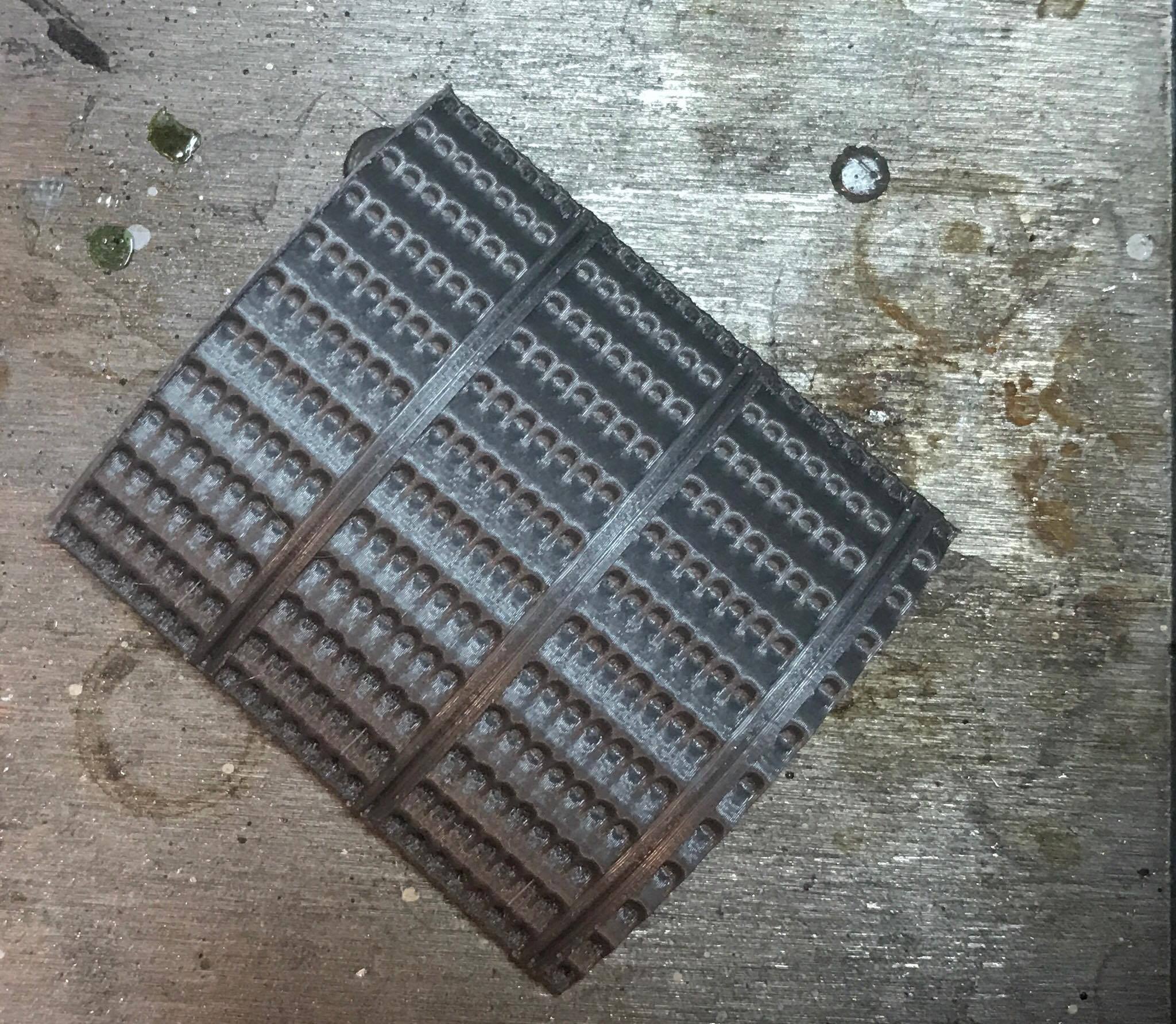

First I had to see if my printer could even replicate the tiny details of the barrel sides. (The originals were printed on pretty high-end machines after all.) So I did a quick test:
Note: The grille "mesh holes" in the above test aren't completely accurate. They are close, but I need to go back and add some things later. Also, the grille sections will be printed separately in the final version, just like they were in the real one. I did the test with a couple different nozzle sizes and they were similar enough that I can use the larger one, making them print faster.

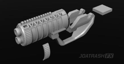

Here is the current work-in-progress status of the 3d model (updated March 26, click to enlarge):
Since I'm generally a total novice when it comes to electronics, I first thought I'd make the functionality mechanical. One criteria would be that it had to be fairly easy to assemble since I was planning to offer it as a kit. But as time went on, I started realizing that making it mechanical would make it harder to build and put a lot of demands on the durability and tolerances of the parts. It also wouldn't be exactly how they did it in the movie. So I did a 180 and started looking into using an electromagnet (solenoid).
The plan was to use a capacitor to store a temp charge, like I was planning for my Glie 44 blaster from Star Wars (to make leds inside flash and fade), but as I would learn, solenoids are a bit more demanding in their power requirements. Again, I had to keep it SIMPLE so that anyone with the most basic knowledge of soldering could put it together. Finding a suitable magnet hasn't been easy- most of them need too much power or too have small movement. After a week of reading up and asking for help on various forums, I even ended up looking at timer circuitry... the hole was getting deeper. So I decided to go back to the basic setup and start experimenting.

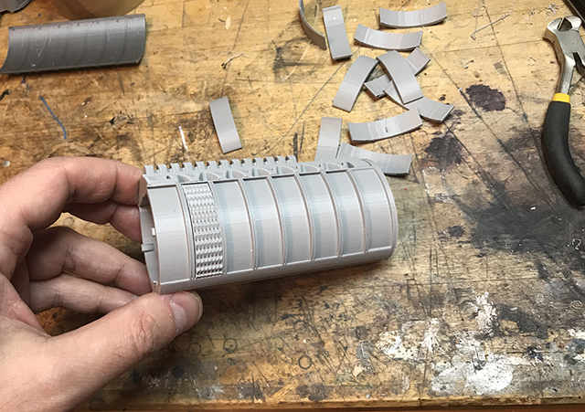

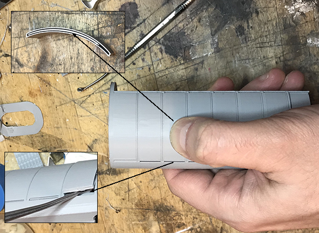

I've done various recent tests on how to print the hollow barrel. The ridges create 90 degree undercuts that are very difficult to get around with a FDM (filament) printer, so I had to experiment with creating different types of support. After failing a few times, printing in halves and whatnot, I finally settled on settings that gave three "layers" (see the insert) that when pressed, "snap" the supports from the barrel, making them easy to pry off cleanly with a flat sculpting tool or screwdriver. (I admit to being a bit proud of that one.)
Test print of the top rail.
Test-fitting a grille plate and the rail. Looking good so far.

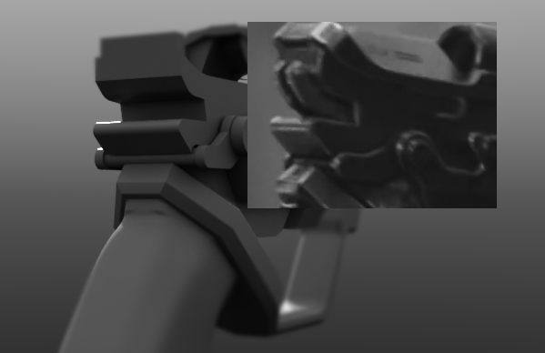

Trying to get the area above the grip right before I start smoothing out and adding details. Note the horizontal rod...
Also on my third test print of the grip. Looks like it was held in place on the screen pistol with a hex screw or grub-screw so that's what I'm going to do as well, to make the battery easily replaced. Almost there... just a couple small tweaks on that, then I can finish the slide, add the barrel-receiver connector and move on to modeling the interior to hold the solenoid and other components.

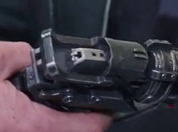

Thanks. That's very similar to the larger of the two models I have, so i can discount the smaller one as an outlier. I think you are right about the real prop having the power source in the grip, as you can see a small button-head hex screw in the back of the trigger guard in the working prop Mr. Savage handled in the Tested video:
(it also shows th small details around the back of the hammer).
I think the trigger guard is screwed onto the grip from the top, and then the grip and trigger guard are removable from the receiver and barrel shroud to replace or recharge the battery by removing that screw. Presumably there is a hollow tube that runs down from the receiver into the grip/trigger guard assembly that carries the wiring and has a threaded hole that he screw locks into. It also looks like the on/off switch is in or behind the centre of one of the 'screws' on the left side of the receiver, as Mr. Harlocker inserts a jeweller's screwdriver into one of those to turn it on and off.
