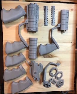

Some of the test parts I've been doing. Final version is on the top right. There's quite a bit of difference in grip sizes- a couple of them are just HUGE.

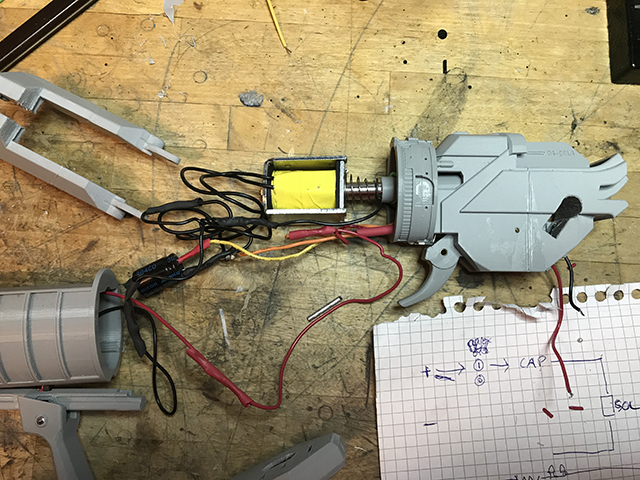

YEAH! WOHOO. The damn thing WORKS! Four freakin' months of "I'm almost certain this is gonna do what it's supposed to do when it all comes together..." and here it is:
DISCLAIMER: The whole thing is just TAPED together, so things are kinda crooked, haha. (And I didn't tape on all the outer parts.) I also didn't add the hidden on/off switch for this test because it wasn't needed for the test (I've tested that separately). But even so... functionality is smooth, even without any final trimming or fitting. The solenoid plunger only grips the slide/hammer with a piece of loose wire inside.. so the final assembly will be even more stable.
A couple things I might tweak before shipping out kits are testing a slightly smaller capacitor. The current one is nice, but I would like it to run out of power and release the slide a tad sooner. I will also probably include a higher rated resistor for the leds, because I kinda think they are too bright right now. (A bonus I didn't really count on was, the way I set up the wiring, you get the LED fade just like on Deckards PKD when you switch it off!)

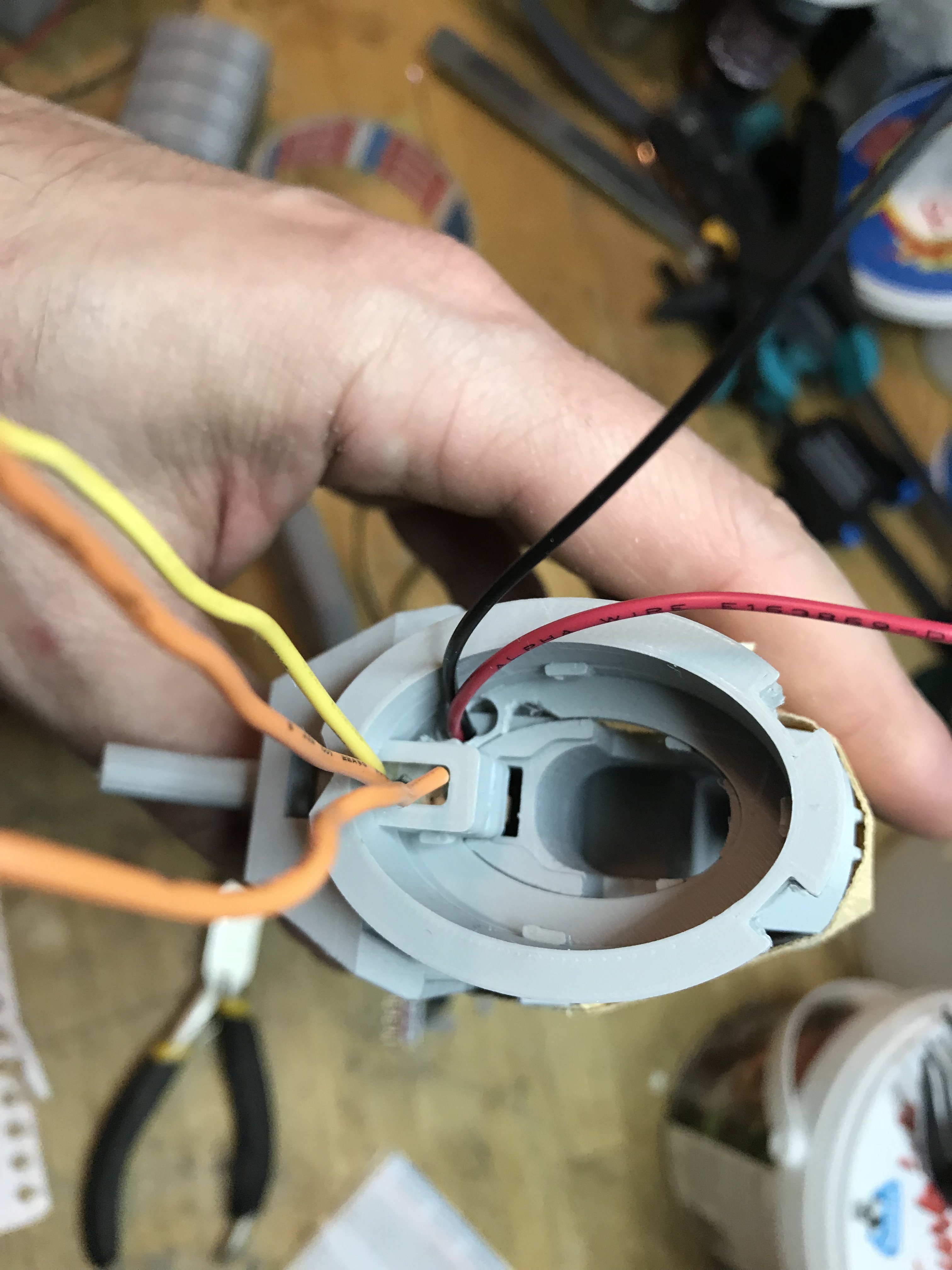

Showing some of the interior channels for the wiring to pass through. (My final copy will have thinner gauge wires.)

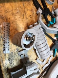

The jumble of wires, pulled right out of the barrel. I didn't bother to tuck them in neatly for this test, and the gauge is much too thick.
