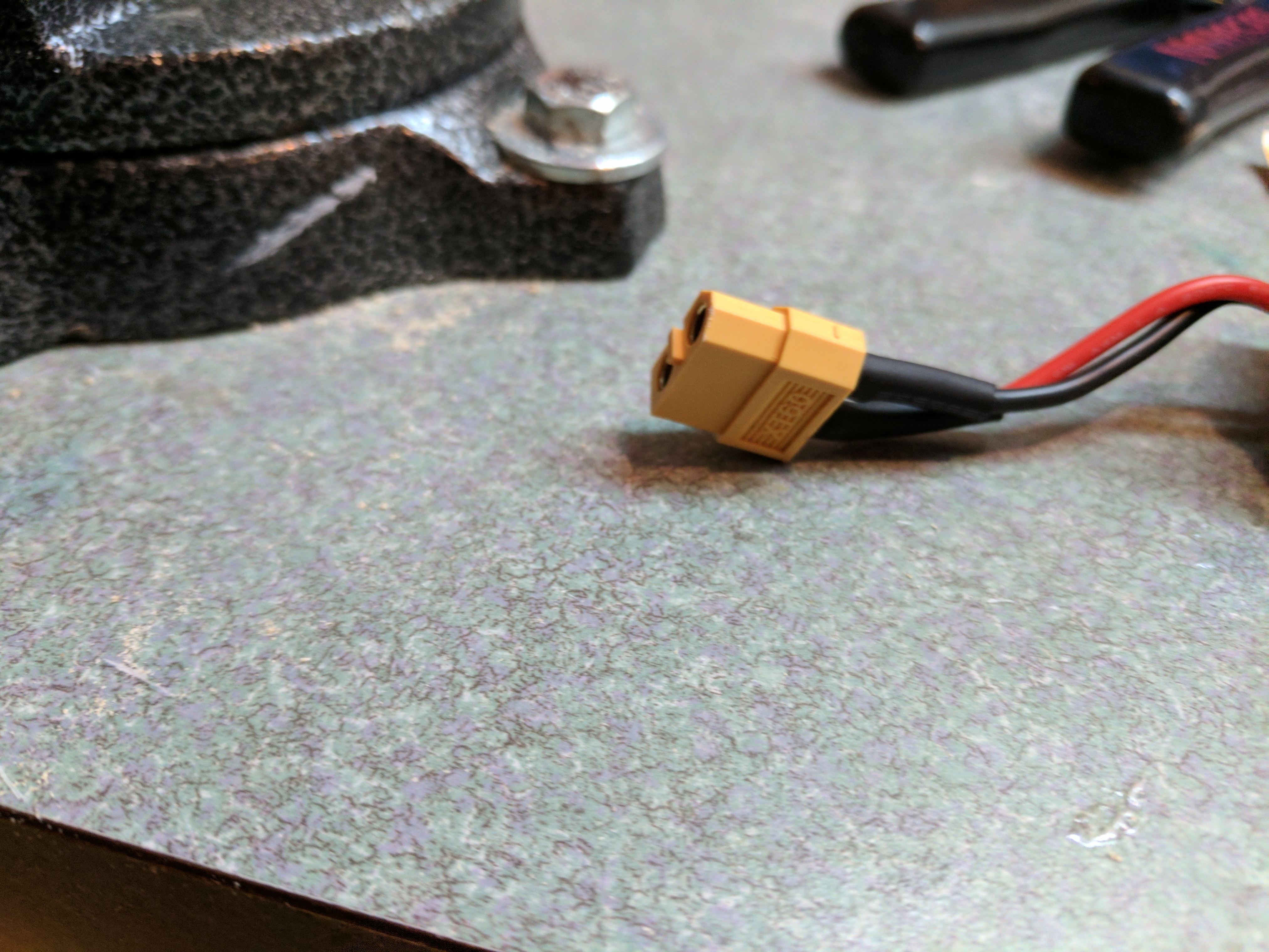

The battery came with bare leads. The charger had large battery clips for connectors. I replaced those with XT60s. I chose the XT60 for their ease of soldering, low profile, amp rating and secure physical connection.
Also, the hobby shop was out of everything else.

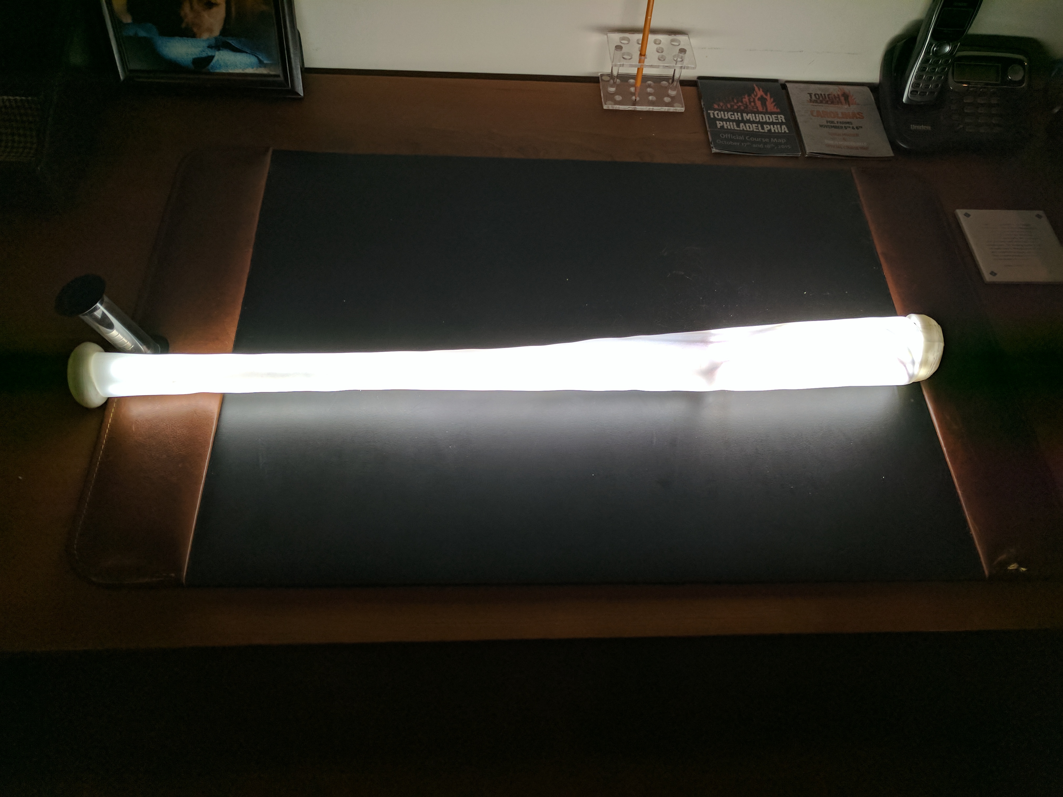

With the Mark I, I had a problem with the LEDs showing up as hot spots. It looked great in pictures because the camera's CCD saturates. That makes everything looks brilliant white. IRL, the hot spots were very noticeable.
For the Mark II I salvaged the diffuser sheets out of a couple of broken laptops. They helped a lot.
I'm still getting some hot spots in the barrel, along with some shadows from the wiring. You can see those in the picture above. I have some ideas for a neater mounting system which should take care of those.

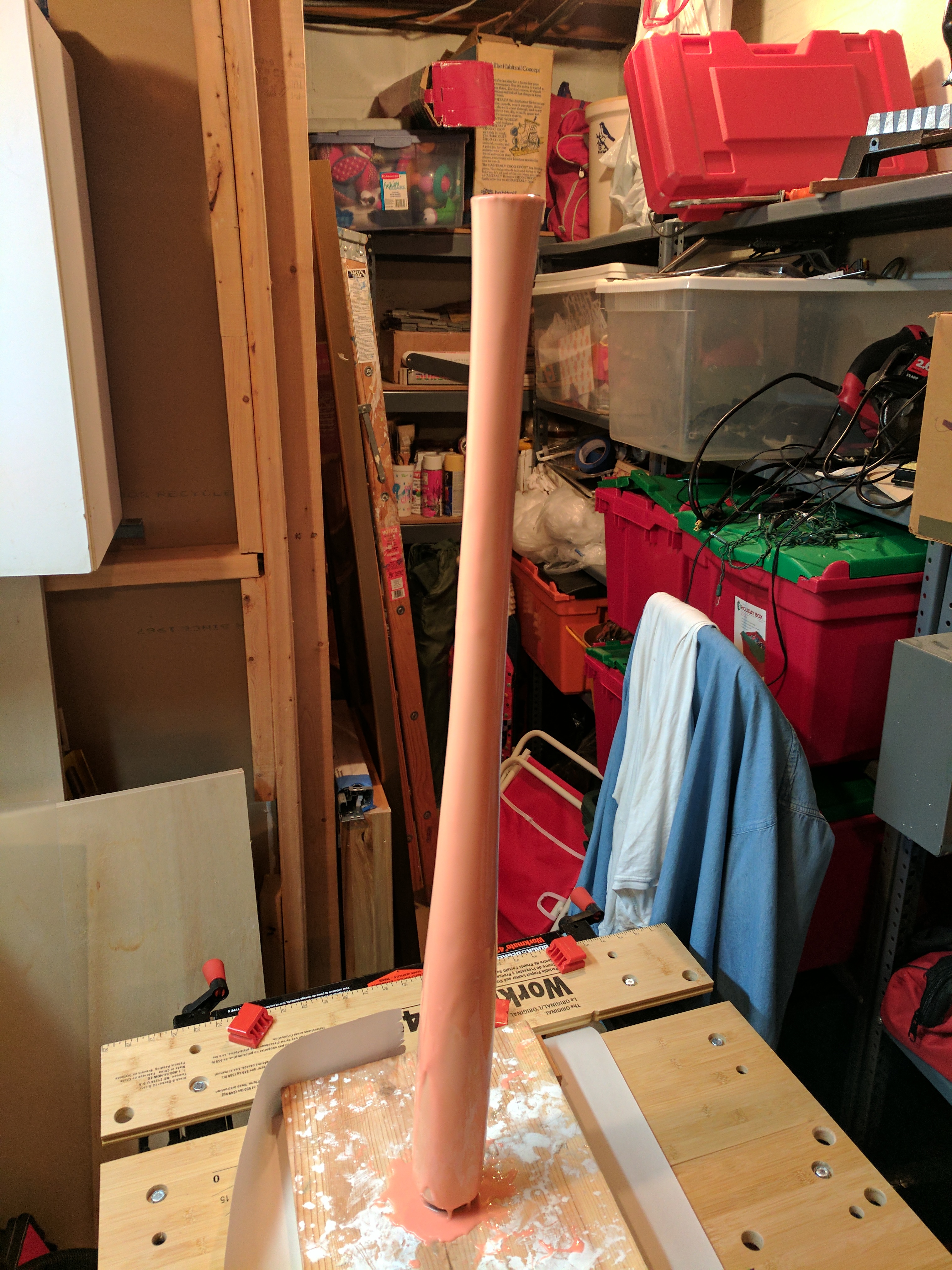

For the Mark I, I made the glove mold with the handle of the bat as the open end. In that configuration, I couldn't stretch the silicone over the barrel to get the bat out of the mold. I had to cut a slit in it. That left a wonky seam in the casting and made it hard to get the silicone mold locked into the mother mold.
In the Mark II, I made the barrel the open end. After all the work I'd put into making the wood bat positive, it killed me to cut it up like that. But we all have to make sacrifices. I was able to get the mold off the bat without cutting it this time.

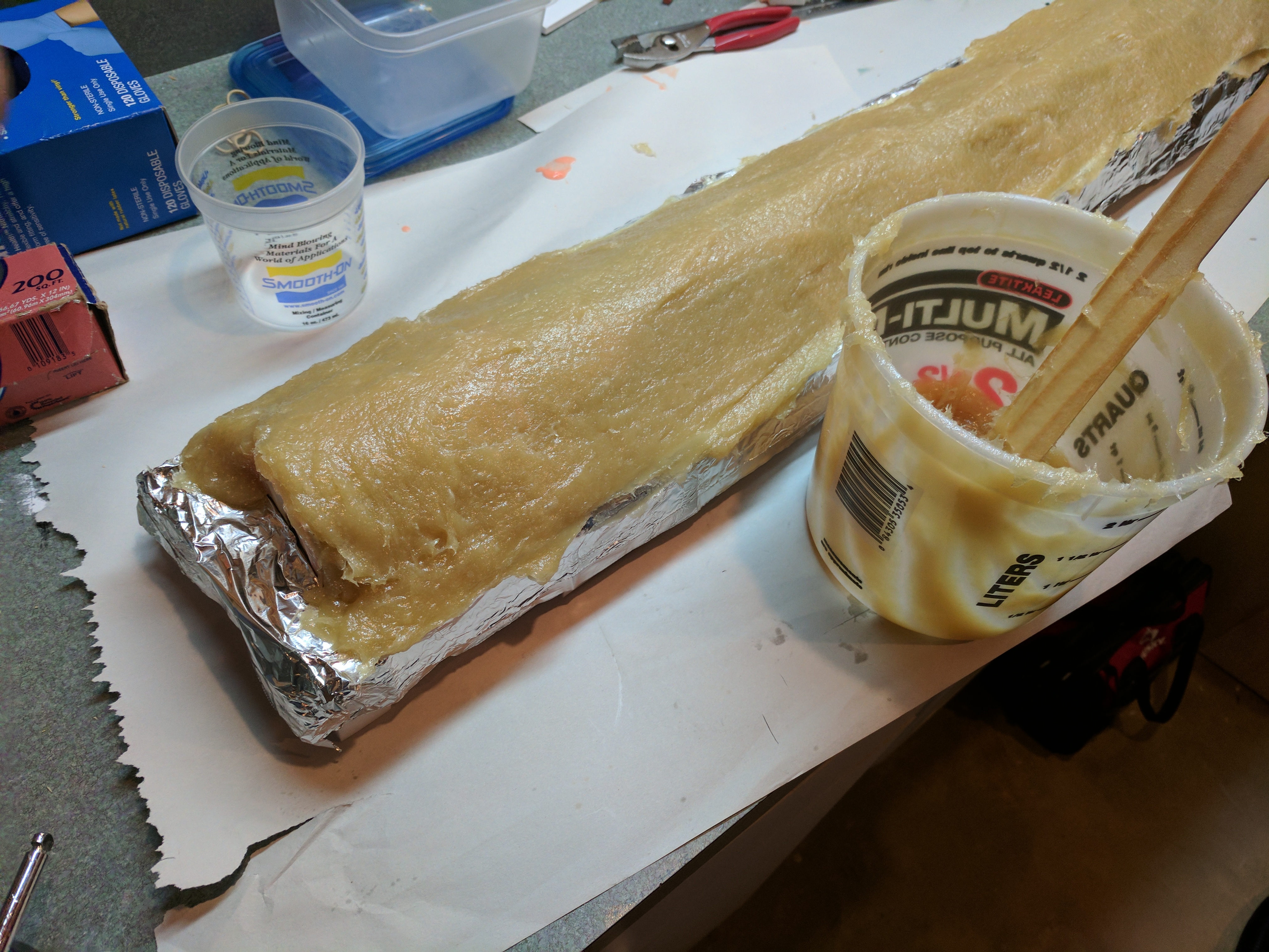

The first time, I used plaster bandages for the mother mold. They fell apart during the slush casting process. This time I made a much sturdier mother mold out of Plasti-Paste. In hind-sight, that was over kill. I could have made a lighter mother that was much cheaper and just as solid out of fiberglass and resin.

The only thing left was figuring out how to mount the battery pack, LED strips and on-off switch. I recycled the 3D printed caps for the handle and barrel from the Mark I. I also reused the MOSFET power control circuit. It uses a magnetic reed switch to control the MOSFET so there's no external push button. I think it's pretty cool.
I used a dowel rod for the strips in the handle. I hot glued three strips to the dowel. I also hot glued 12 strips around the sleeve for the battery pack.
