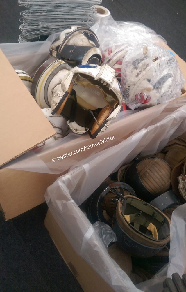

We found this picture from Rogue One and it was very telling about the methodology in making their helmets.

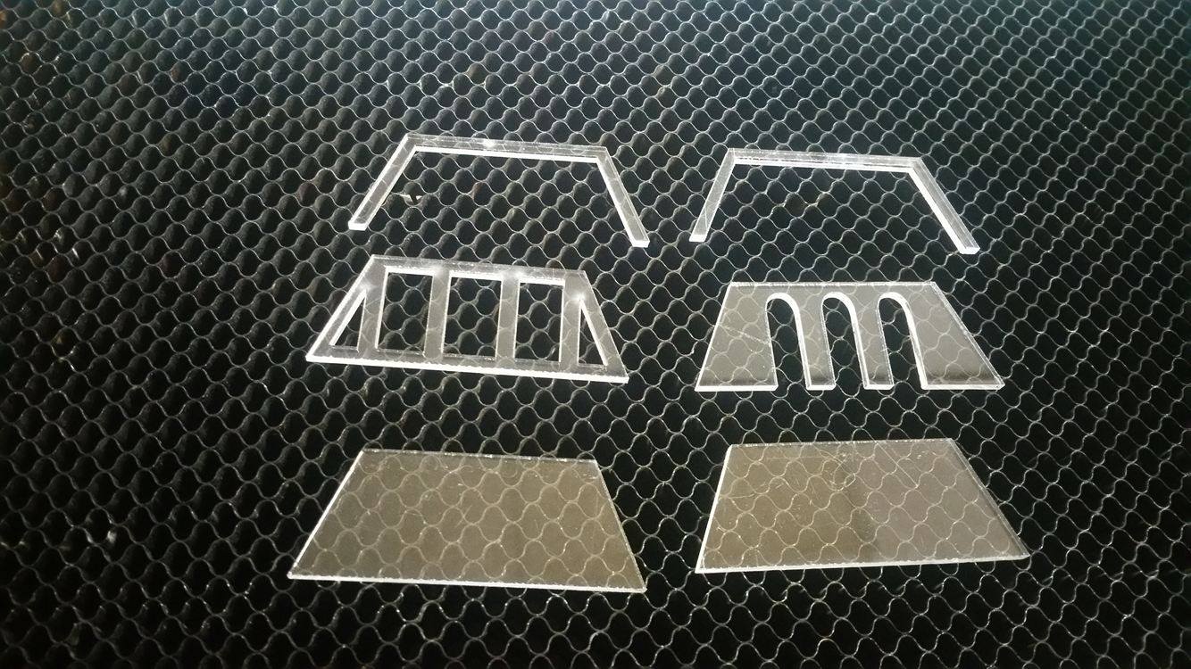

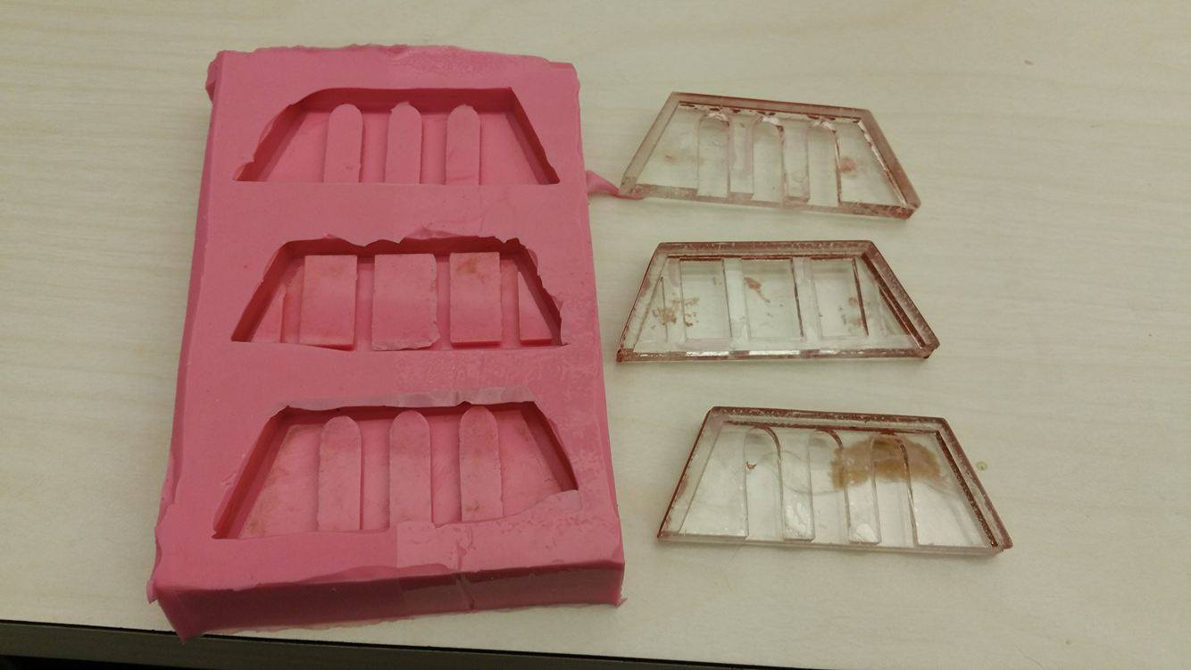

We also determined the best route for the mohawk caps was to laser cut a master.
Nice project Walter.
From the picture you posted, it seems like the helmets in R1 are also made of styrene.
What material do you have in mind to make your helmets ?

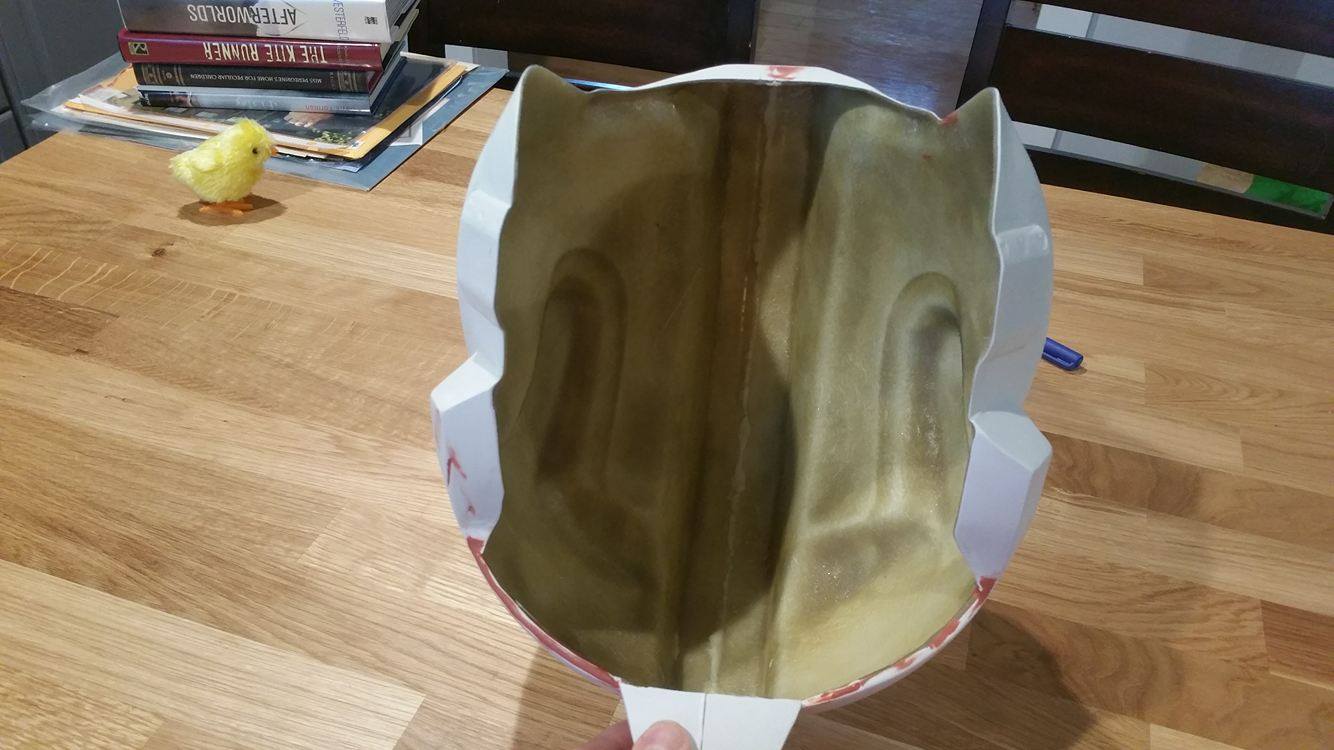

The other challenge we had with the styrene helmets was the assembly, it is not fun. So far, I have been talking about the challenges with the helmets because I want you to see where we were coming from when we started to pull this all together. We worked with our team of fiberglass experts to challenge them if they could make a decent fiberglass helmet, not too thick, but retain the resiliency of the material.

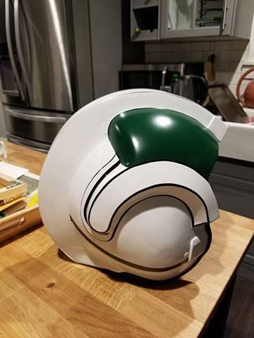

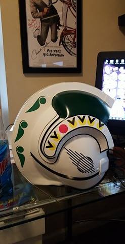

Here is Droidboy's helmet, all primed and ready to go.
We also printed out the buck for the visor which you can see in the photo and a trimmed chin cup.
Is the mohawk cap a detail in the fibreglass shell and some laser-cut parts or is that a separate piece that goes over front end of the mohawk?

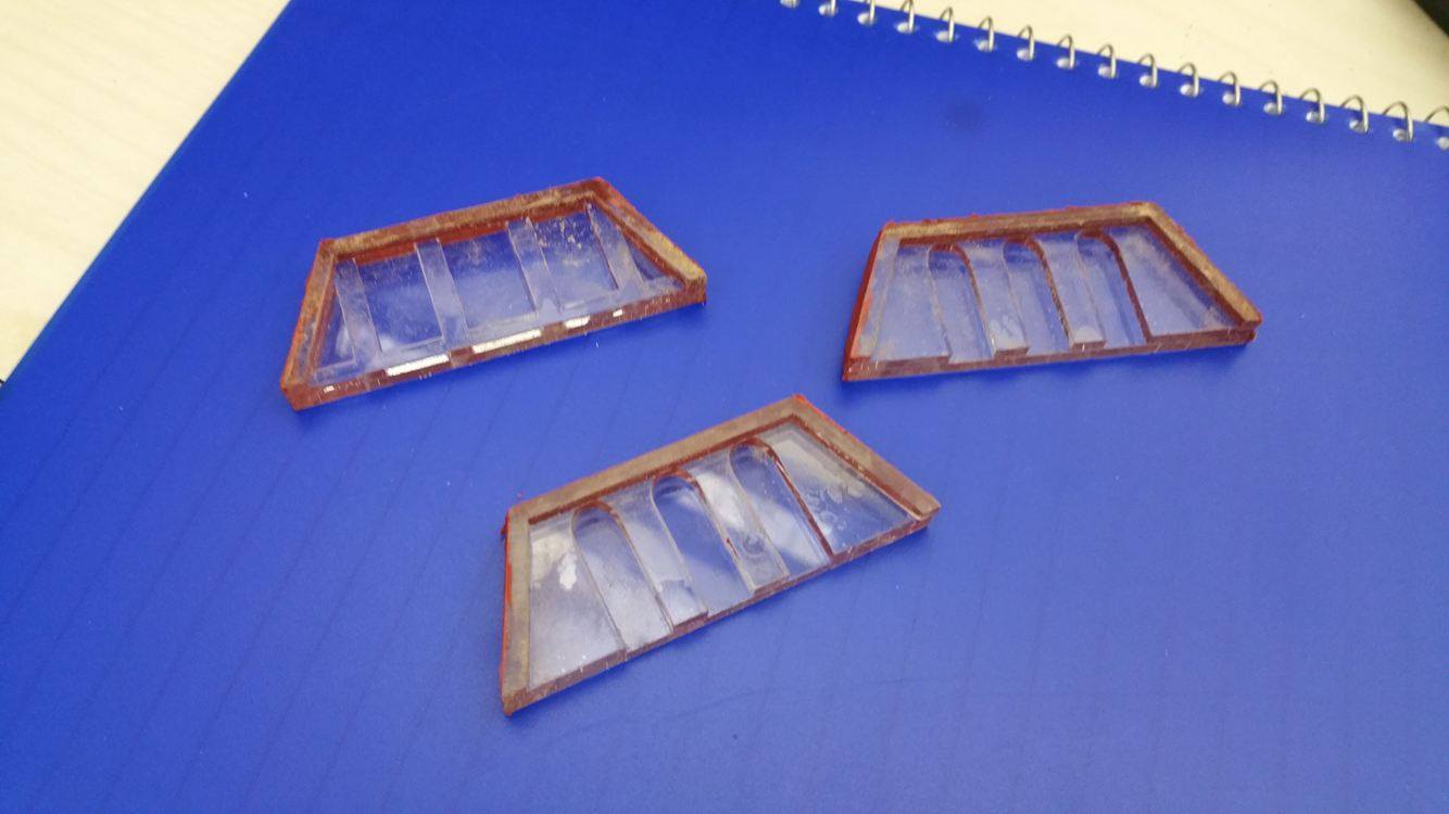

Great question. The masters are laser cut, but...
We we cast the masters so we could have options.
But the remainder of the mohawk cap is moulded in the fibreglass shell, right and not a separate piece like on the original helmet?
Correct.
On on the originals in the OT, the cap is a finishing detail but it hides the join of the two halves.
For ours we we didn't need to hide the join really (easily sanded) but wanted the front to be crisp (and have options), so that is how we landed on just having the front part cast. On the Wedge helmet Droidboy did use an extra master, but I will use one of the cast pieces.

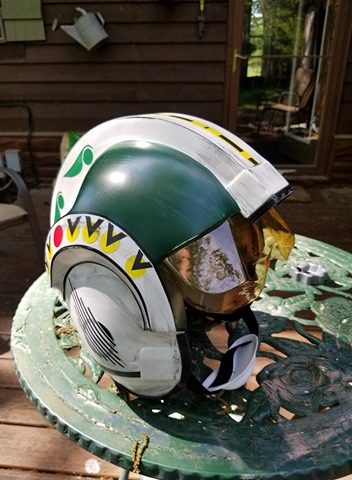

Aaaaaannnnndddd... finished (mostly). A lot of people over the years have taken red fabric dye to tint the lens, we did something a little different. Droidboy applied Krylon stained glass spray paint that you can pick up at hobby lobby or online and sprayed the back of the lens. It looks splotchy at first but evens out as it dries and looks great.
