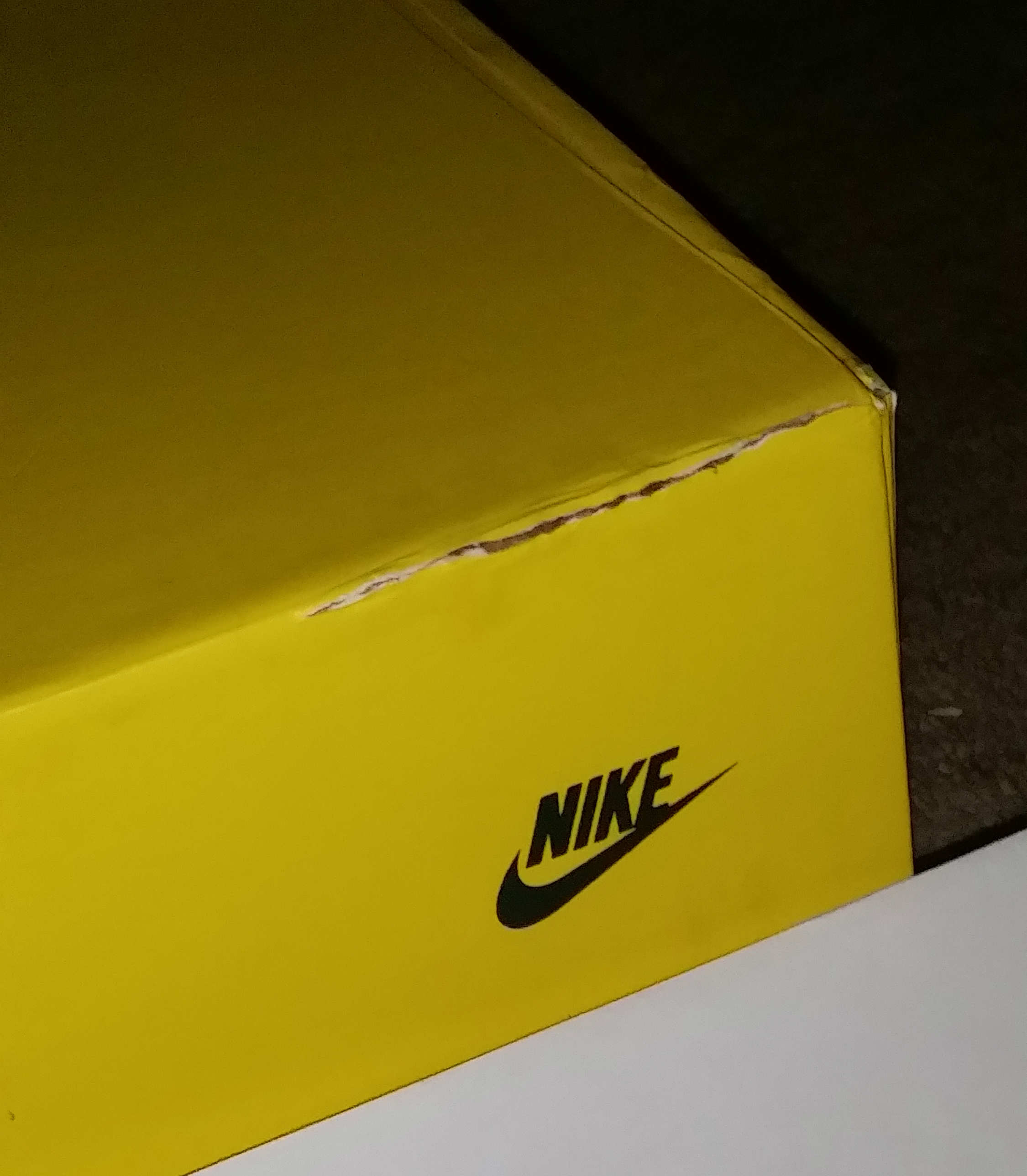

another major problem concerning v3s
how to fix ripped boxes
most boxes rip in front where the lid opens
i tried super glue and it made a difference but the rip is still noticeable,
anybody tried tackling this already?

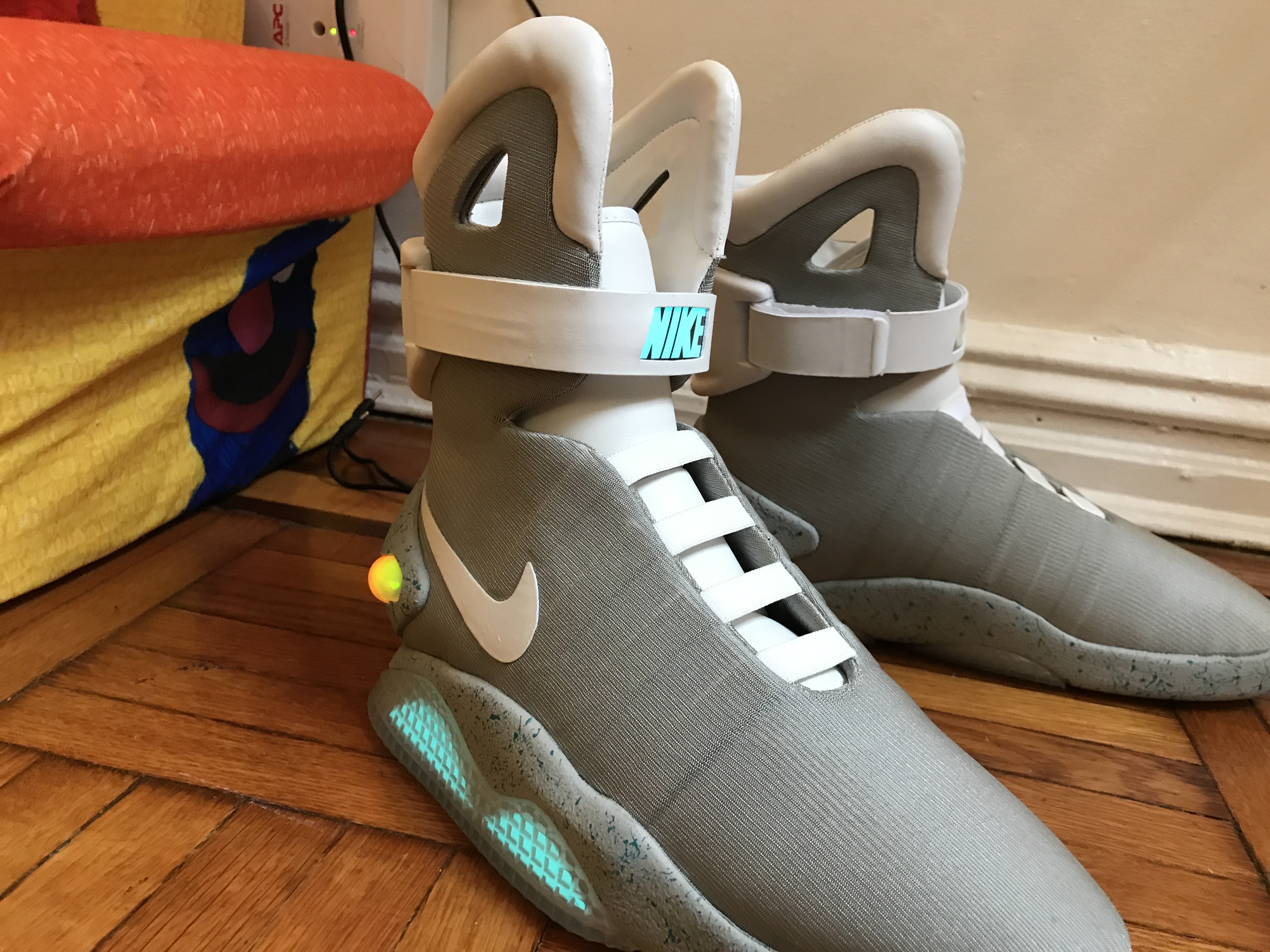

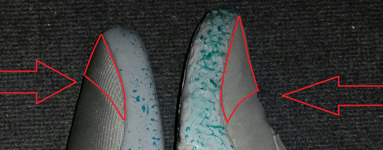

What I saying is that the toe cap on the V3 is smaller than the V2 or other normal boot toe shoe profiles.
When I sock toed by V2s (RHS) I used the origina glue line as my reference to glue them back down. The toe cap was quite big covering over 50% of the toe box. It does not seem to be the case with the V3s.
That left shoe of the F&F pair kind of what I have now.
so
Not sure about a post delivery fix for this, but this is exactly what I was emailing them about and I am glad they sent my pair double boxed with no tears.
The angle on the F&F pair is much flatter than that of your V3. I can't find a clear side profile shot but the material basically meets the sole at a right angle. If the rigid toe-cap foam was removed from the V3 & the material glued back in it's original position, it would be pretty much spot on to this as it would allow the 90 degree angle between the sole edge & upper material & very much highlight the point at which the support in the upper stops.

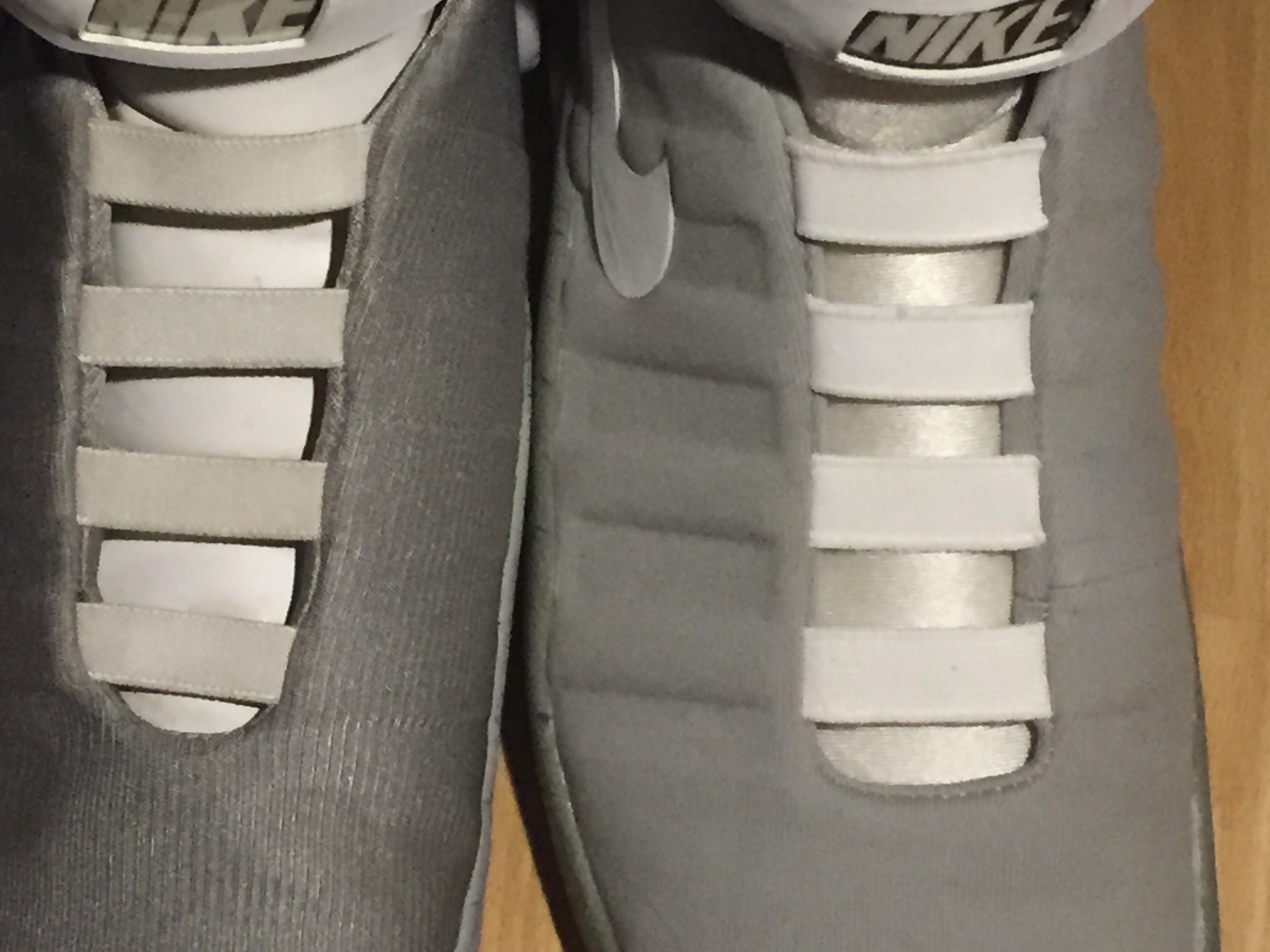

I ordered 4 ounces of sea glow as well as the blue dye so hopefully that will work better than the salon care creme to lighten the soles. I also have noticed the laces on my V3s are no longer a crisp white. I have tried soap and water,sneaker cleaner and stain remover but they still look dirty. I uploaded a picture of the laces compared to my v2s which are clean. Any ideas on how to whiten them?View attachment 720654
Which type of sneaker cleaner did you use? I find the best to clean up these parts on sneakers is the gel type. My jordan concord XIs has bad yellowing on some of the lace eyelets and the gel worked really well. Just be careful not to get it on the rest of the shoe or you will need to clean it all
Out of interest, did you originally steam slim your V2 before opening them up?
You can see on the F&F left shoe that is a ridge where the foam ends.

Yeah, that's what I was saying about the line caused by the foam support ending in the upper of the shoe. As far as I know it's a rigid foam throughout the shoe. If this section could be removed precisely between the inner & outer layer of material, then it would have pretty much the exact same profile as the F&F pair.
Also, as you did the steam method on your V2s which is what I did on mine also, it dramatically reduces the amount of available spare material due to shrinkage. If this wasn't done prior to your 'sock toe' modification, the upper over the toe would be too baggy if reglued using the original line. More so than the F&F pair.
Not quite correct. One pair went from "boot toe" to "sock toe" with out ironing it first. Without ironing, it kept the boot toe on the toe cap, but would slump behind that pre-molded shape as there was no reinforcement left in the toe box. I gave it quick hit with an iron (through the wet towel) just to flatten the pre-molded shape.
