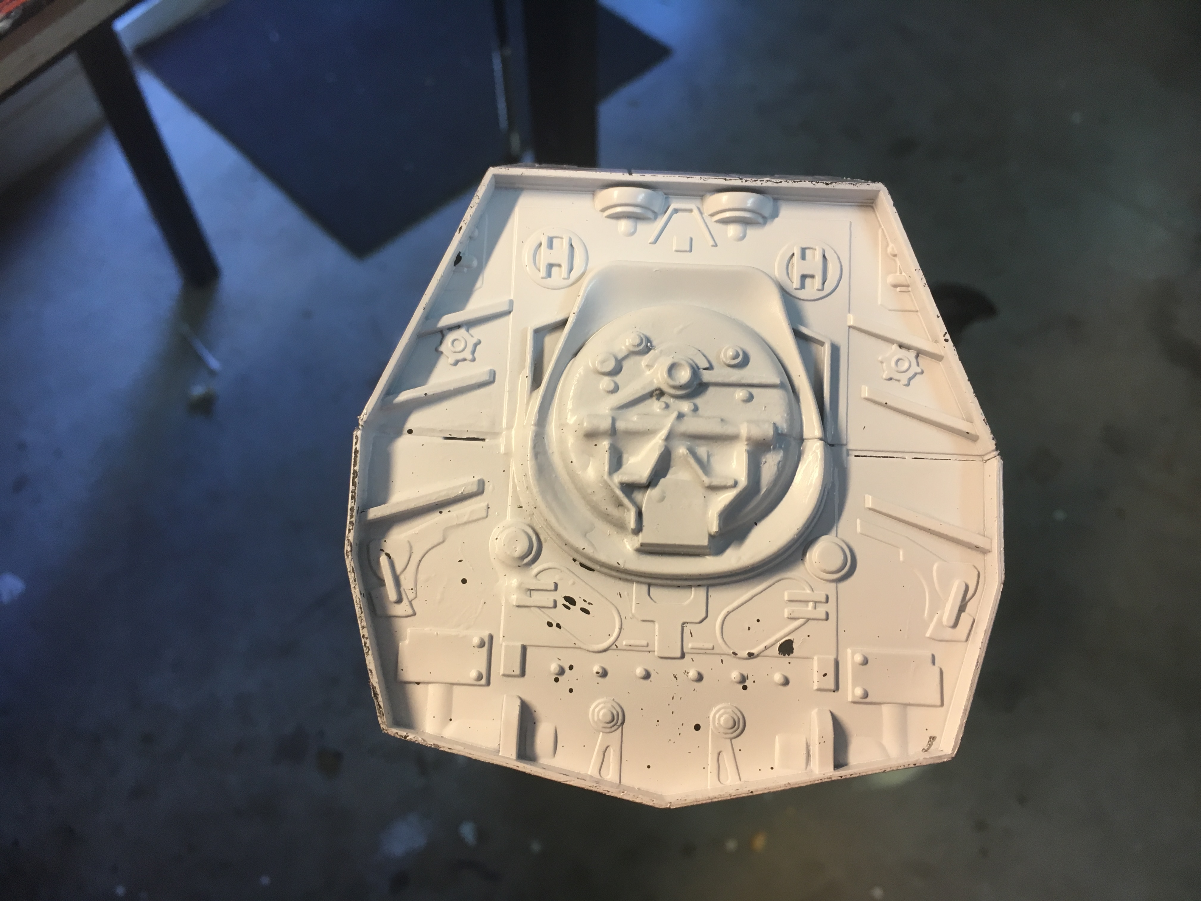

Hi, after lurking here drooling over your Bandai Falcon threads, I decided to do my own.
I'm up to the wash stage, but it's looking dreadful!
I coated it with Matt Tamiya XF-86 after scratching up the decals.
Then I started to apply a wash of XF-1 acrylic and thinners. It seems to just stay put and I can't wipe it off! :behave
What am I doing wrong? Should I have oil based wash, or coat it with a gloss (I have humbrol gloss).
Thanks for your help!

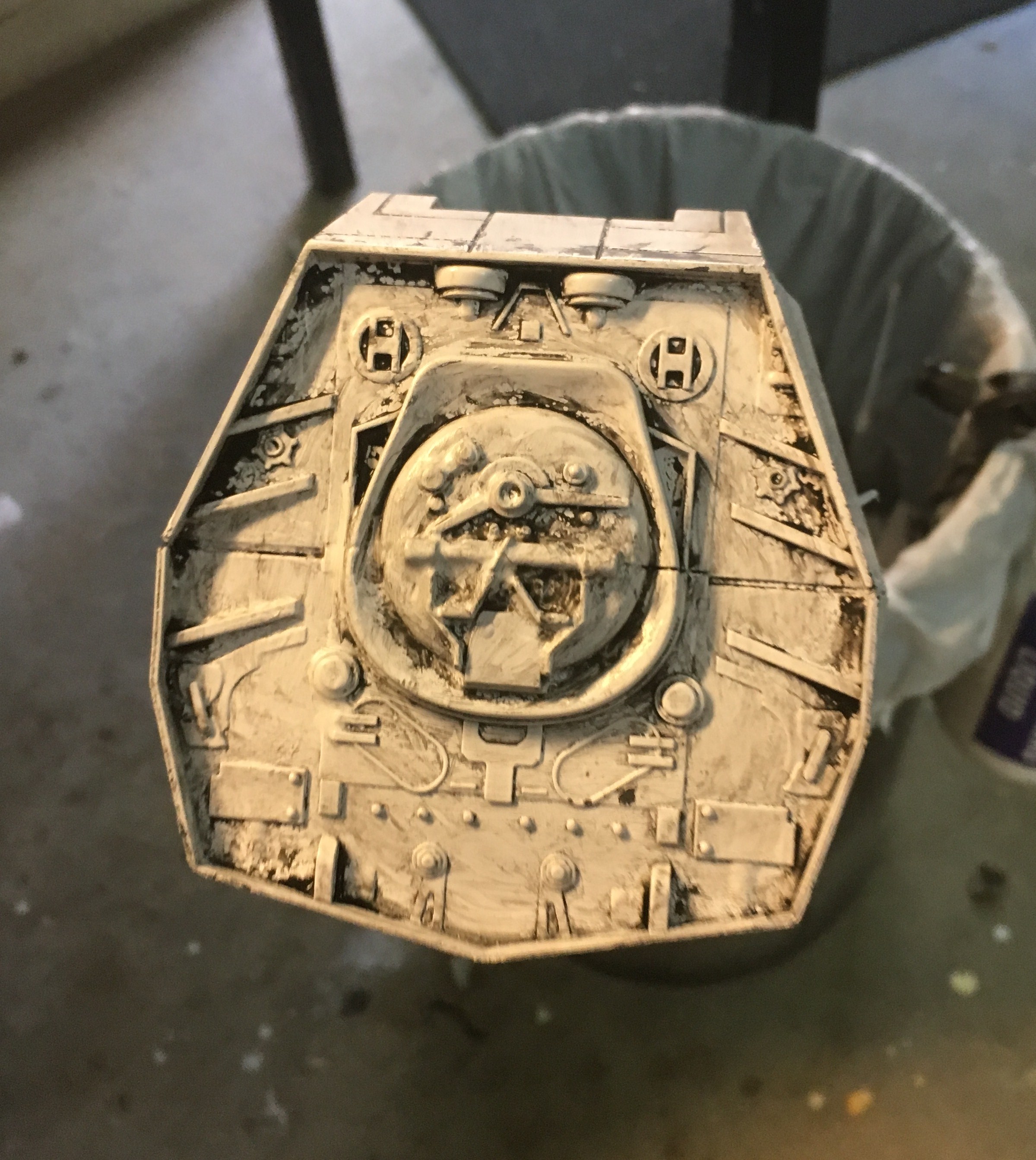

I'm no expert and never washed before (that's why I smell:lol) so I YT'd a few videos and went with an acrylic water based wash. My primer and top coat is acrylic lacquer which is a solid base for anything water based like straight acrylic water based paint because I can tone it back without affecting the base coat. For weathering I think it's the best mix of base coat and wash to use, because they can't and don't interact with each other and it's fixable if you hit it too hard.
I haven't finished yet, I'm going to go back with a rust wash and then airbrush some wear and tear. It may look a little heavy at the moment, but that's the look I'm going for.

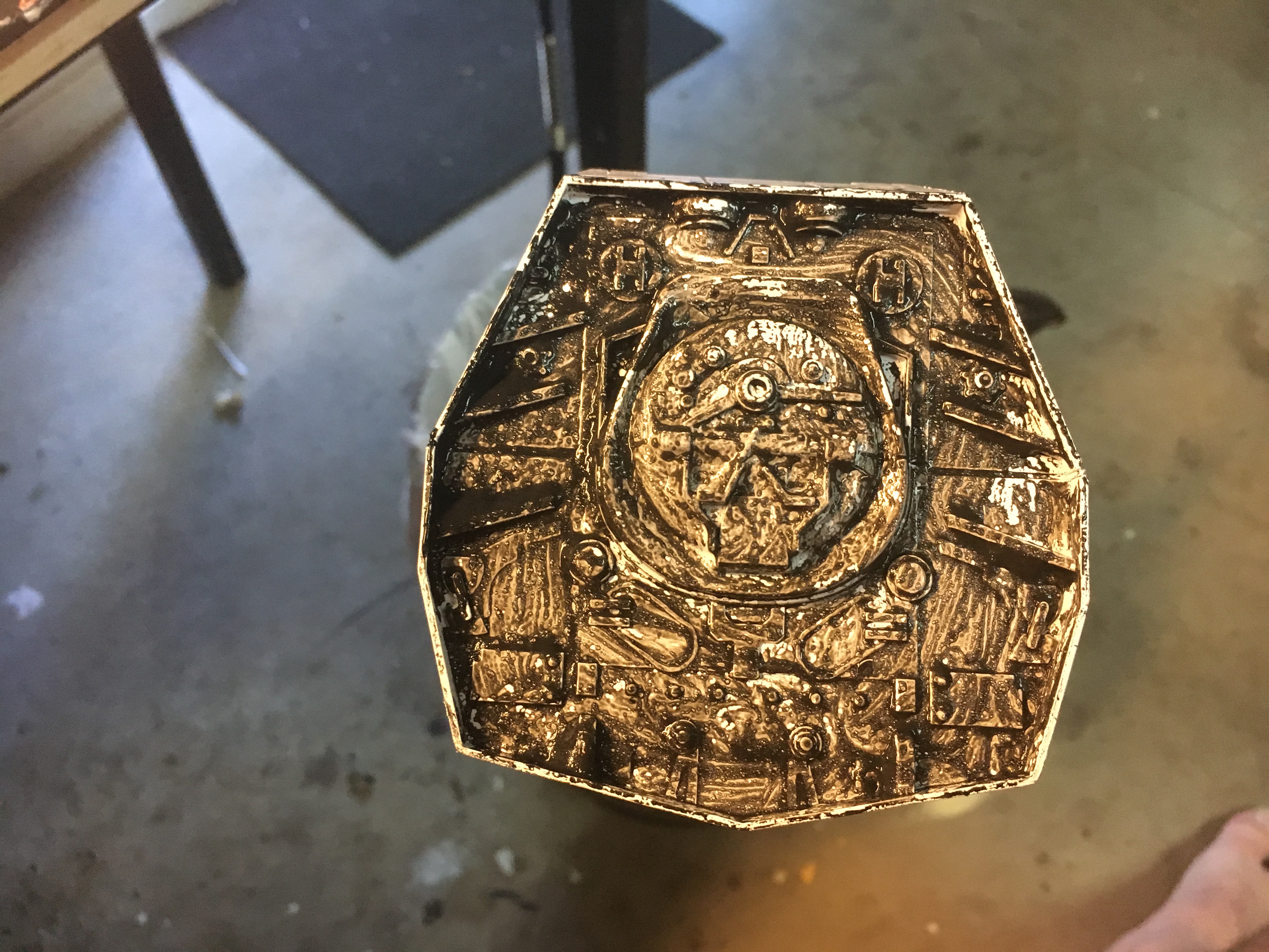

Thanks team, I think I need to get an oil -based wash. I just tried an acrylic wash over a coat of Humbrol clear, but it still turned out ****.
