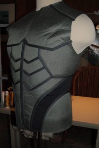

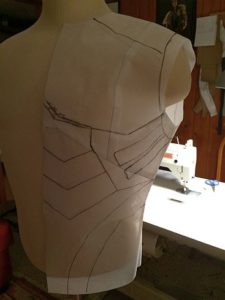

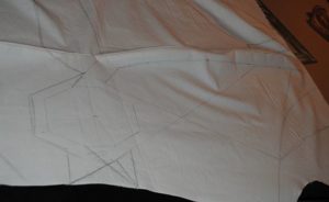

I began with the pattern for the torso. This was made by using a block that matched the client's measurements. I made a mock up in Swedish tracing paper and sketched on the details.

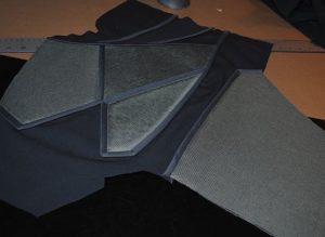

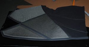

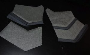

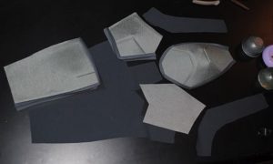

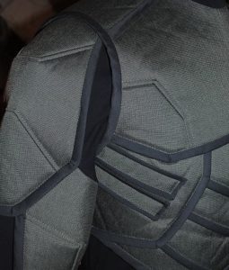

I then began building the torso. The suit is made of Cordura backed with headliner, dark grey sport-tek stretch and bias tape. The pieces are cut from the headliner first. The seam allowance is trimmed away and the headliner pieces are tacked to the back of the Cordura with a light spray of Super 77. The Cordura pieces are then cut with the seam allowance added back in and sewn together.

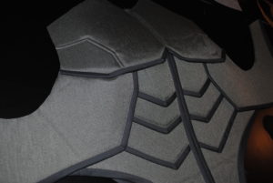

The abs were made in the same fashion. In order to created the look of segmented armor, all of the pieces were cut individually and then edged with a darker grey bias tape. The pieces were then stitched together 'in the ditch' of the bias edging to make a single piece that appears to be segmented.

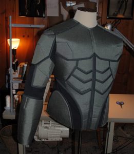

Once the two halves of the ab section were complete, the front edges were bound and the they were stitched down to a center front base piece. It was then time to add in the 'rib' and upper back section.

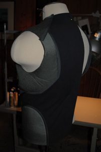

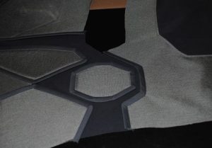

To add some flexibility and movement, an inset of dark grey stretch was added that extends under the ribs to the sides of the abs and also makes up most of the back. The back is almost entirely stretch so that the client will have range of motion across the shoulders and middle back and, since it's completely covered by the cape, will not be seen.

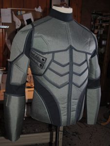

The tops of the shoulders were added to complete the neckline and upper torso. Lower side pieces, made the same way as the rest of the torso pieces, were also added to create stability and maintain the shape under the rib cage and over the hips.
The next steps on the torso are the rib details, back zipper and fishing the edges at the neck and arms. In the meantime, I moved on to creating the undershirt. I began with the sleeves.

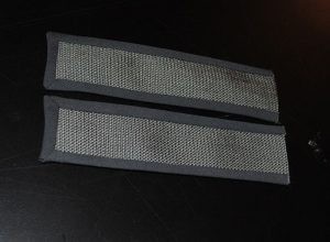

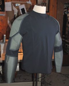

The sleeves were created just like the torso - headliner foam backing the cordura pieces and then set onto a stretch piece that will allow for movement. I created all the foam/cordura pieces first and then assembled all the pieces from the wrist up.
Here are all the pieces laid out and a finished sleeve pinned under the torso in its current state.
The next steps are to finish the base of the shirt and the rest of the details on the torso - then onto the pants and cape.

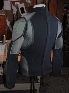

The rest of the undershirt is all stretch to allow for maximum movement and fit under the torso and has a zipper that extends from the neckline 12" down the center back. The body was assembled, the sleeves attached and the shirt was finished by binding the neckline.

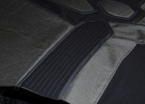

The next step on the torso was to create the small strap details on the ribs. I made these by halving the bias tape used to edge all the other pieces and edging 1.5" strips of cordura. These were then stitched down to the rib sections and the arm holes were finished.
Next, the collar was added to the torso, the zipper set into the back and the grommet details added to the rib sections. These images show how the two completed pieces fit together - the only things left on the upper section of the costume are to attach the symbol, hem the sleeves and bind the bottom edge.

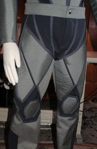

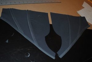

I then began constructing the thighs. The upper parts of the thighs were made of the same padded cordura and bias trim as the vest. The area that extends around the knee I made of the stretch material to provide movement. These images are of the upper thighs and the stretch section with the back of the thigh attached.
Continuing down the leg, I attached the shin/calf (which has stretch in the back) and the front and back of the knee. The knee pad is padded cordura trimmed and sewn down to the middle section. To create the back of the knee, I backed the stretch fabric with headliner and then stitched down the ribbing lines.
Once both halves of the pants were complete, they were assembled and the waistband added. Here they are complete.

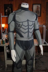

And, here are all 3 pieces of the suit together.

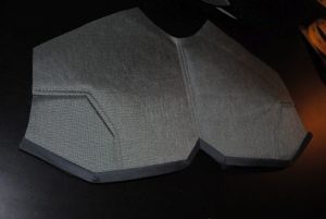

With the patterns set, I began building the cape from top to bottom. The yoke is made in six segments, each backed with headliner foam to give them some heft and support for the weight of the body of the cape.
The body of the cape was constructed back-to-front in seven sections. Each section contained two of the panels and completed one of the points of the jags. These hem edges of each section was bound and then all the sections were joined together and attached to the yoke lining.
The collar was added to the yoke shell and it was added to the lining. I basted the shell down onto the lining wrong-sides-together and then bound the front and top edges. The bound edges around the shoulders were pinned down to match the lining and stitched in place. A small zipper was then added to the front of the yoke to complete the cape.
