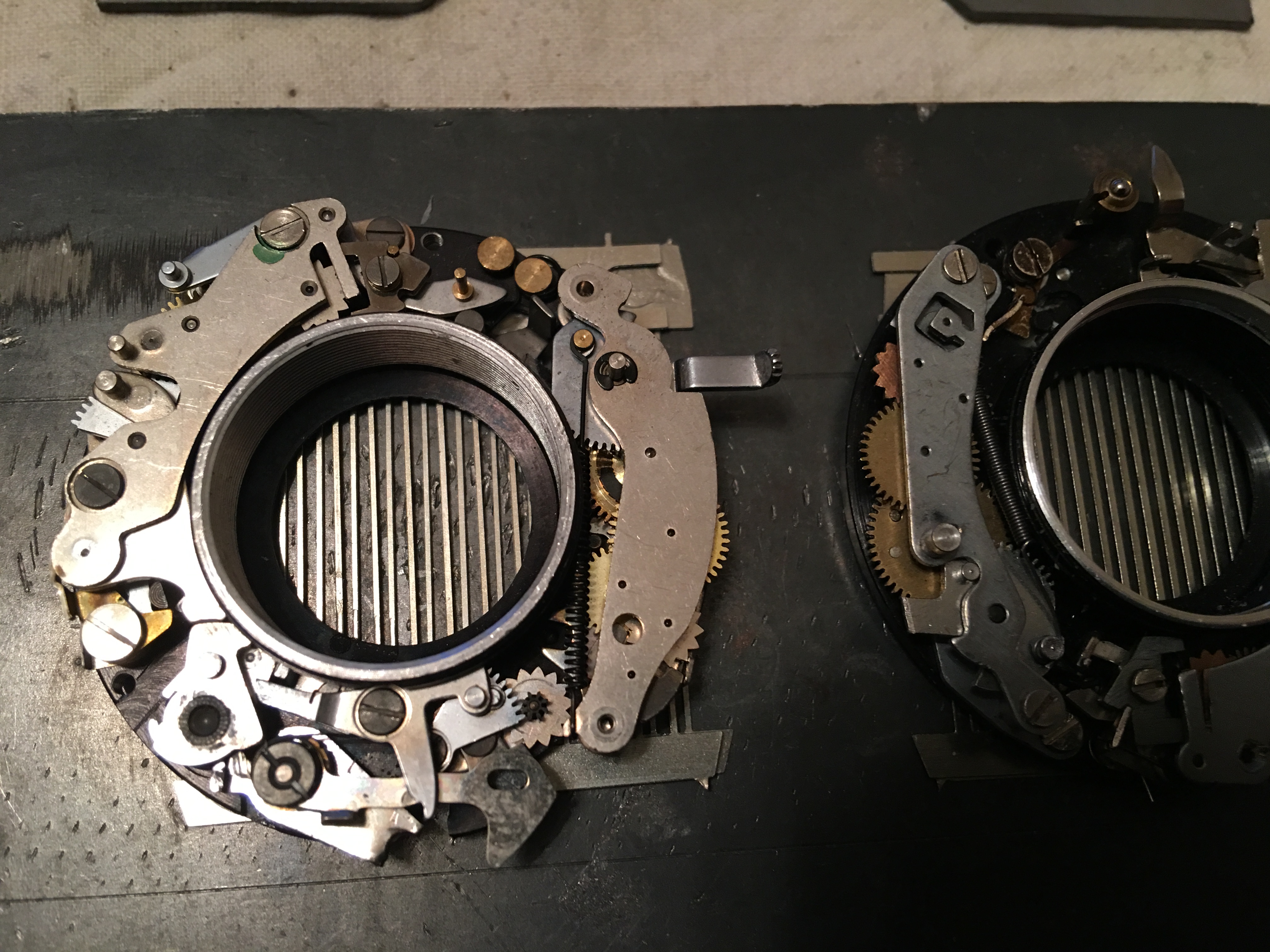

Considering the fact that propguys were always on a tight schedule ... it's most likely they used the same part over and over wherever they could ... so how many vocoder grills would one need now for one Vader ROTJ Reveal build?
Chaïm
6 needed
i used my first attempted cut of the vocoder grill that wasn't screen accurate due to the fact that the little blobs are to far away from the end, and as you dont see the blobs these can now be used for behind the shutters

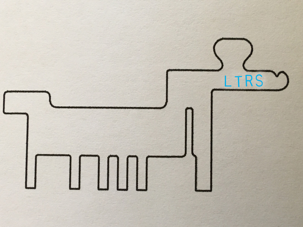

As to your etching dilemma, I think you just need to decrease the width of the laser-etched line quite a bit, your artwork looks nice but the final lines cut are too wide making the characters too fat.

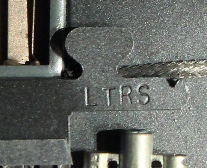

I make the 'LTRS' and the '1-4' characters about 0.25mm wide. I haven't found a perfect font to replicate either of these details, so I did what I think has also been suggested here, and drew them as curved and straight lines in Illustrator (as stick characters) then worked out how thick the lines should be.
Here's a snap I took with my camera looking as straight down onto that area as I could get it. The best I could get, not easy to photograph through glass in dim lighting with reflections everywhere!

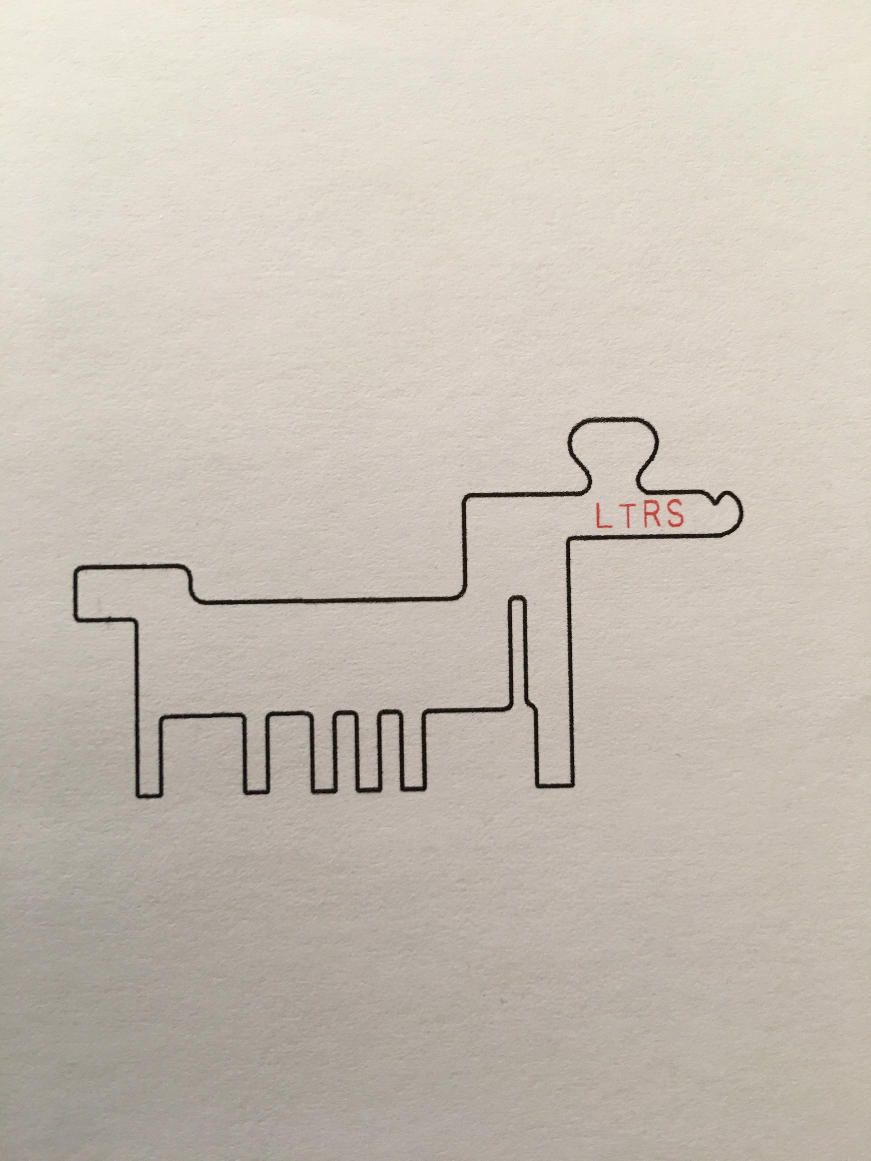

Hi Jeremy nice to hear from you, that's a nice top shot of the lettering and will help with the stretching and squeezing to make them fit, I'm going to do a slight alteration of the piece first as after I did a little mock up I noticed something that just didn't sit right, when I've altered it I will then try again with the lettering with the kind help of Chaim

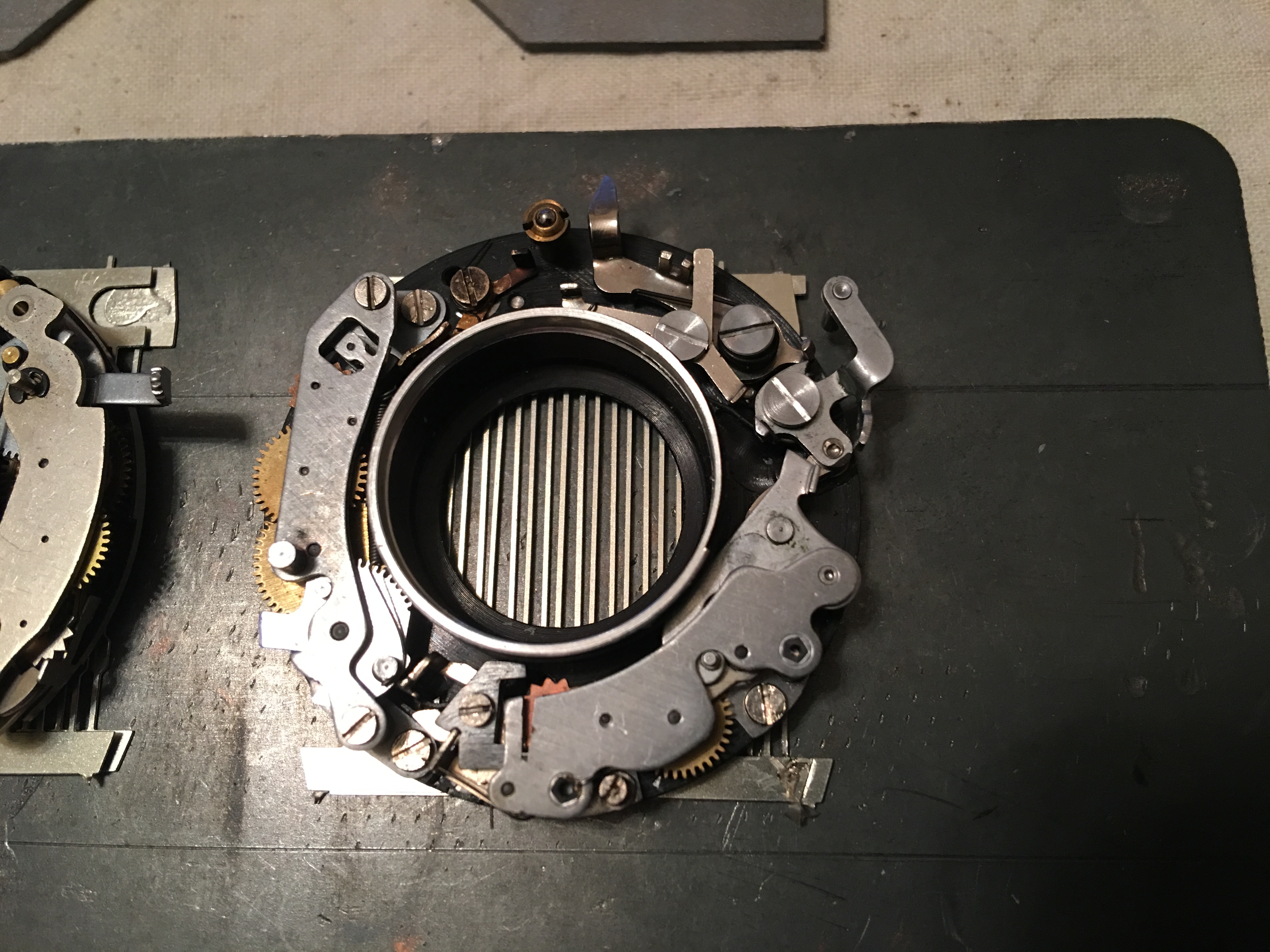

Had a quick hour tonight and I've redone my shutters using the new found way of doing the thin grills behind the shutters by using the vocoder grills
did a quick mock up with the back plate
The edges of the vocoder grills need cutting back, so much better than my first attempt with staples ( it was a bit of a fumble)
Going to to work more on the brow linkage (LTRS) this week been to busy this week end with work
Chaim my friend you are a star I just wish I could learn faster with this computer what you have done would have taken me days
what you have done I can work with, let me see what I can come up with this week as I've got a busy busy week

Excellent find about the vocoder parts being used on the shutters.

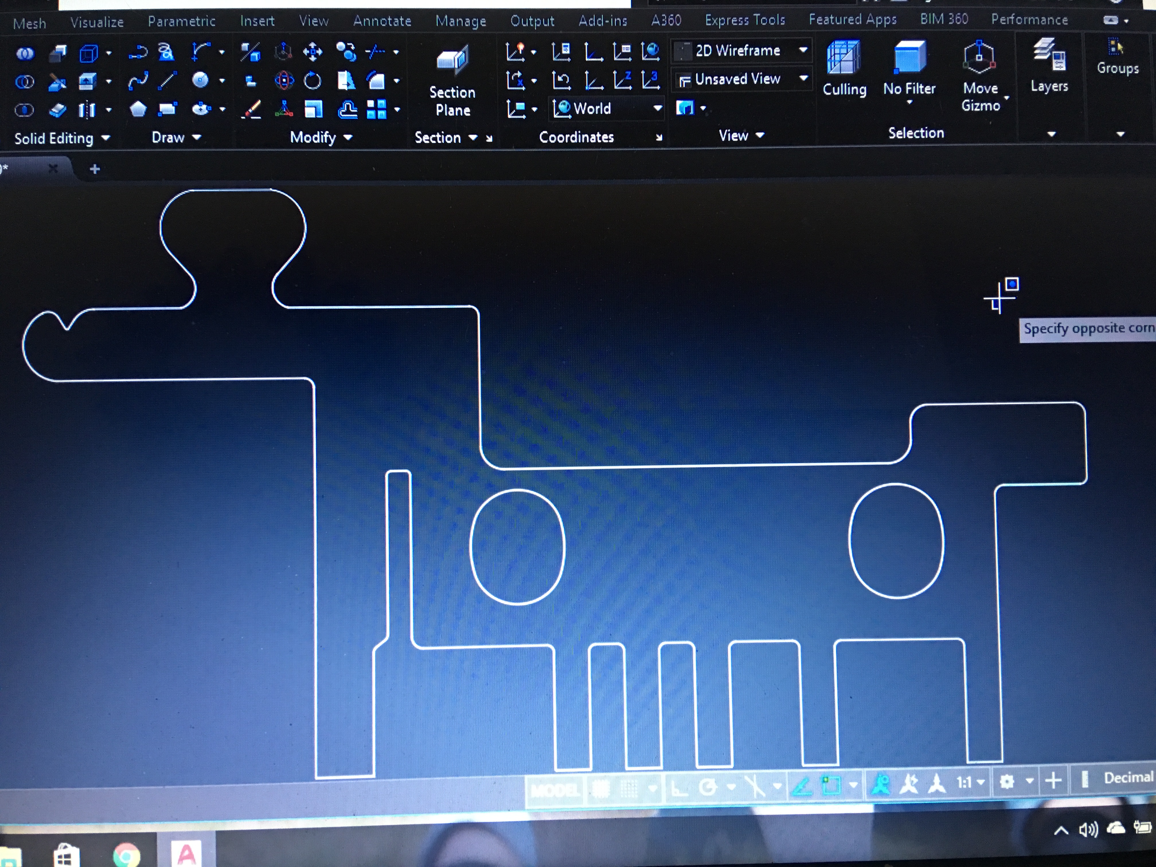

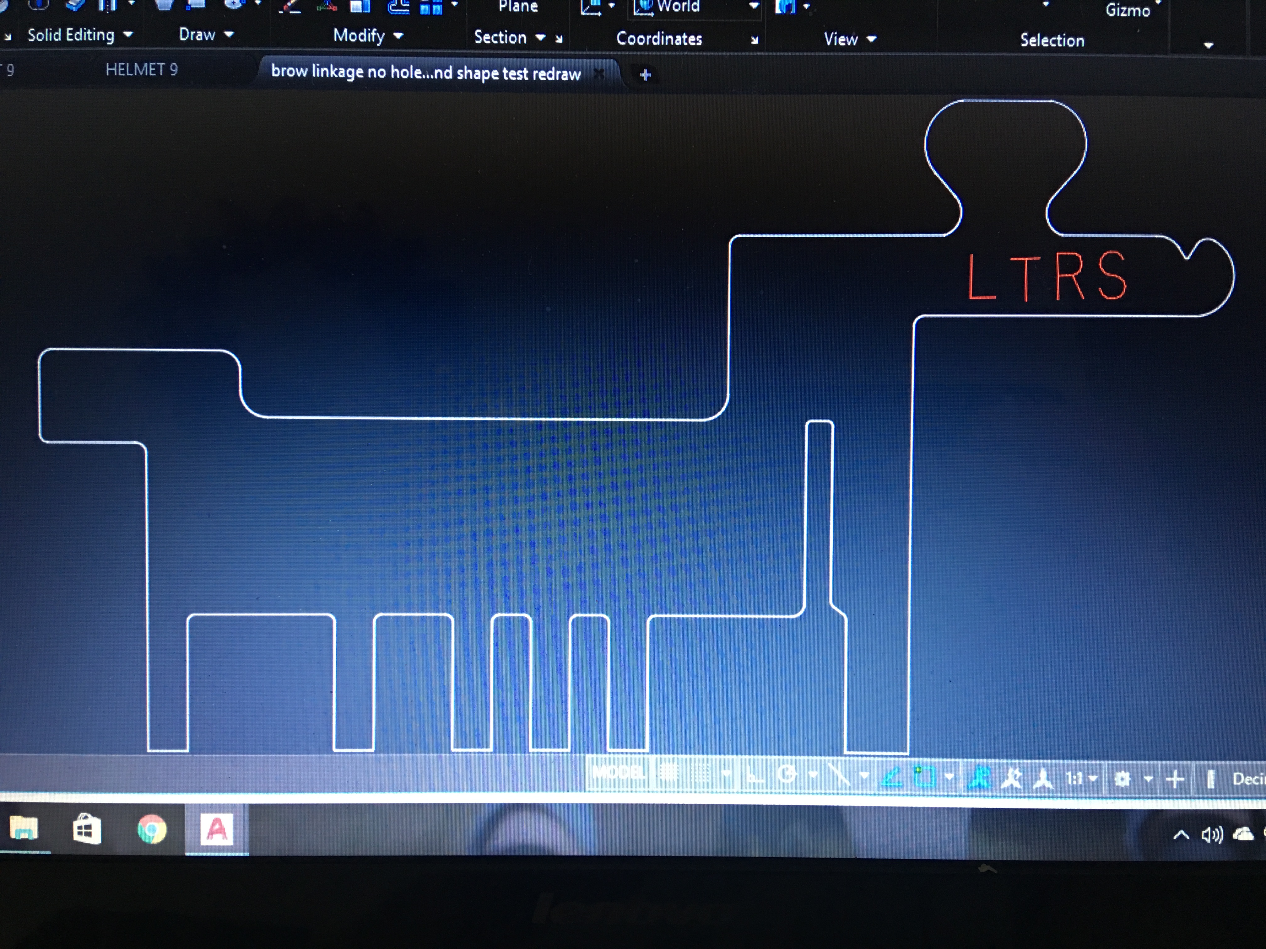

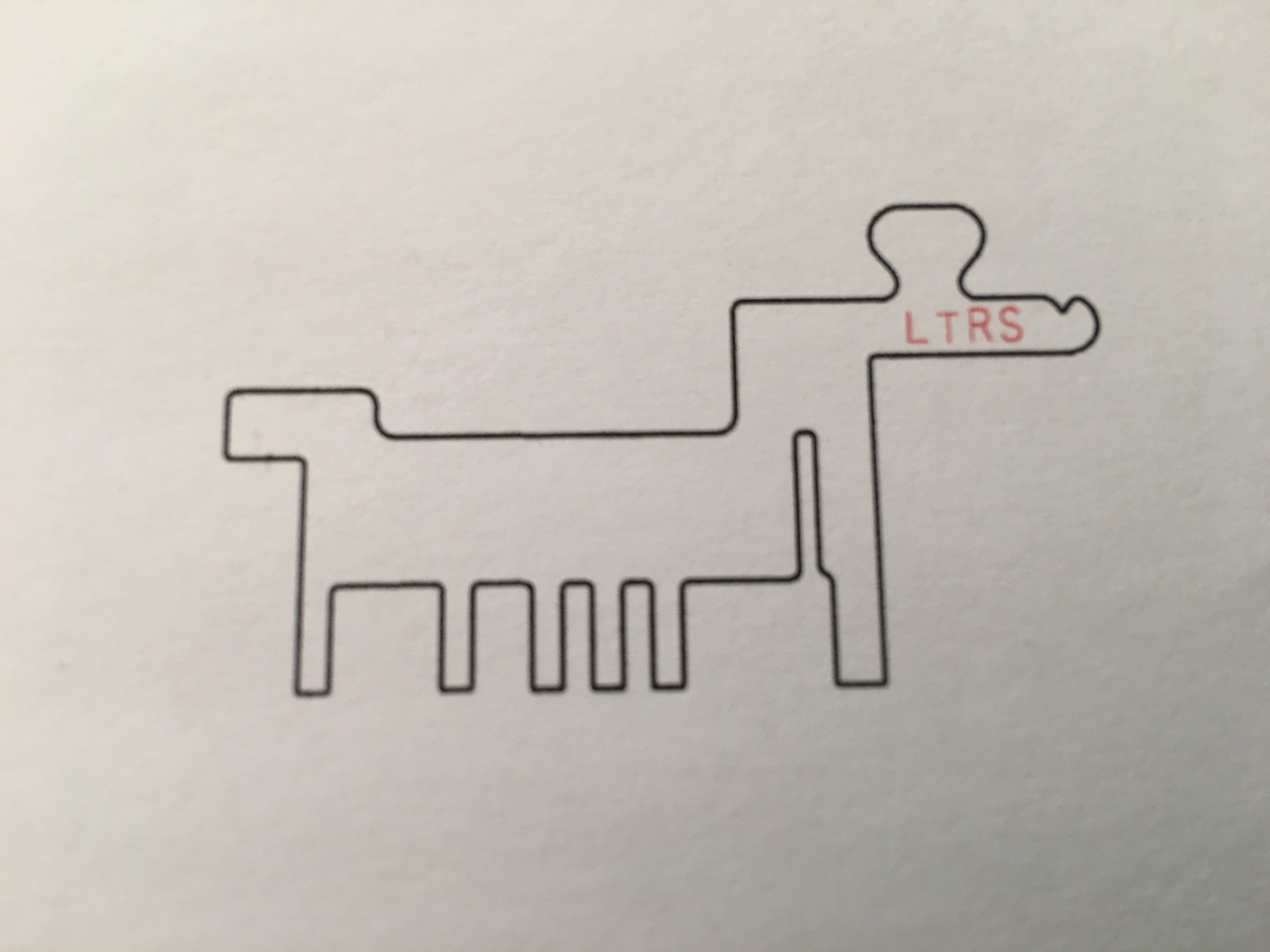

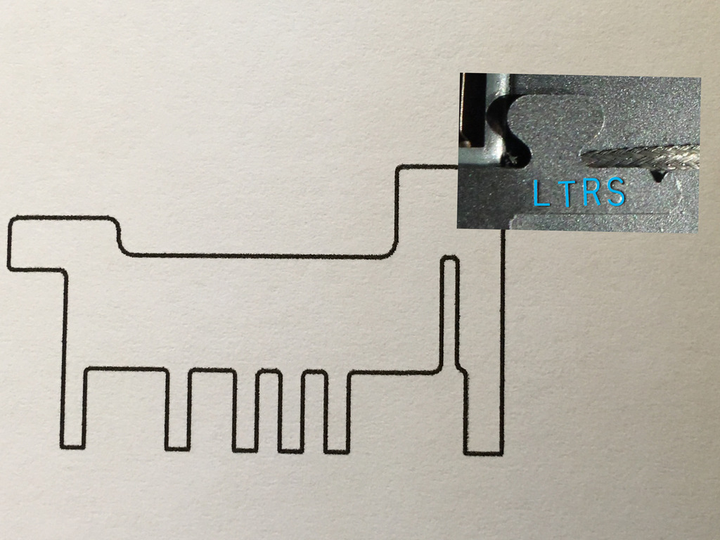

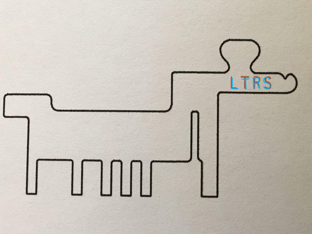

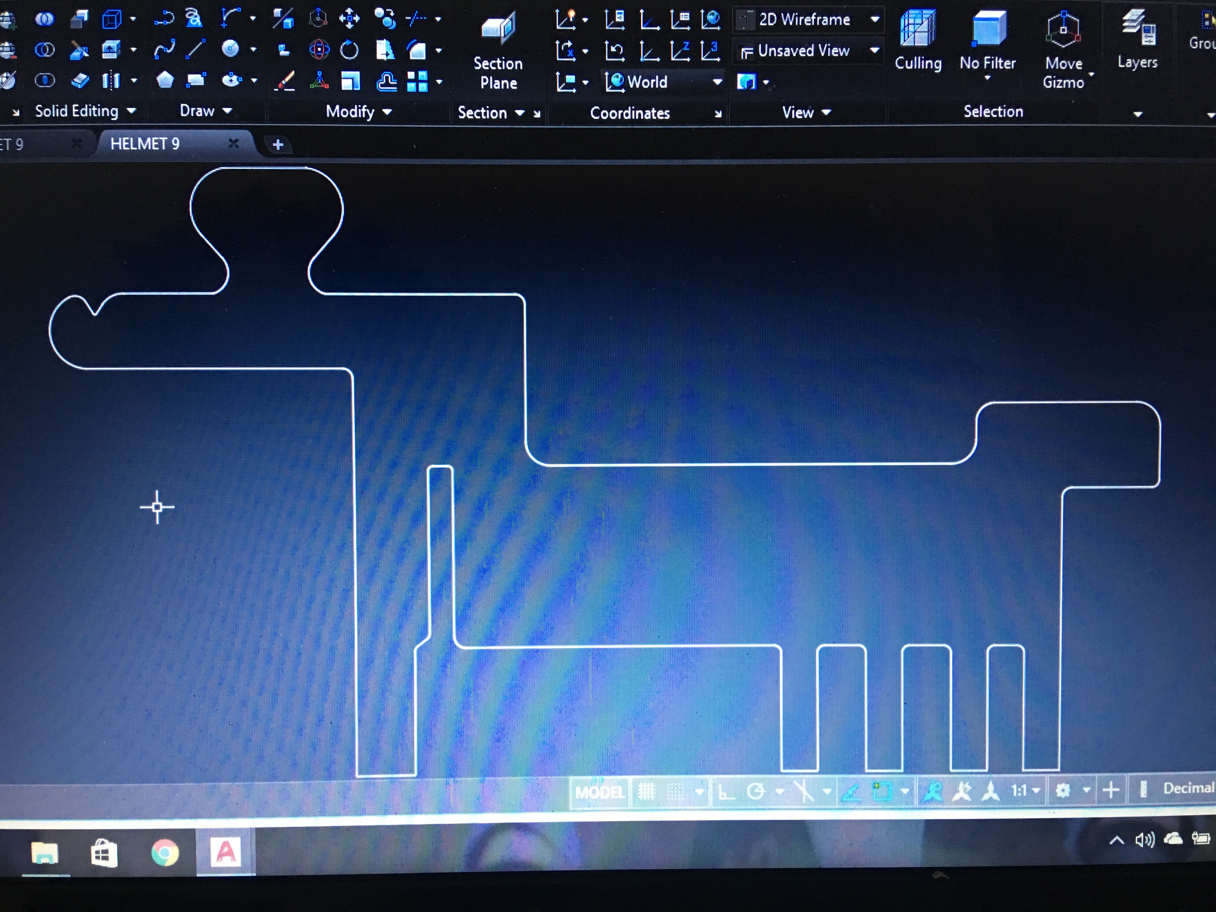

ive done an ever so slight alteration to the piece and I've altered the LTRS, I've imported 2 images to cad, Original and @Sym-Cha drawing. I've traced over both images stretching and skewing pushing and pulling and ended up with this little puppy :wacko:confused what do people think @Sym-Cha i would like your opinion and eye on this buddy

Going to get a sample cut of both brow linkage and crown linkages first for the slight resize I've done and check them out on a mock up
