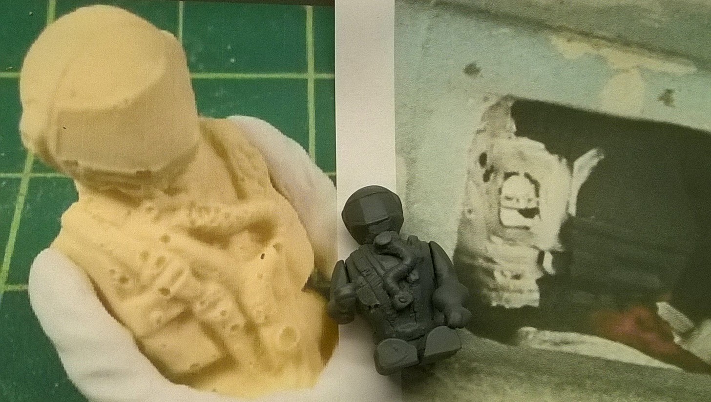

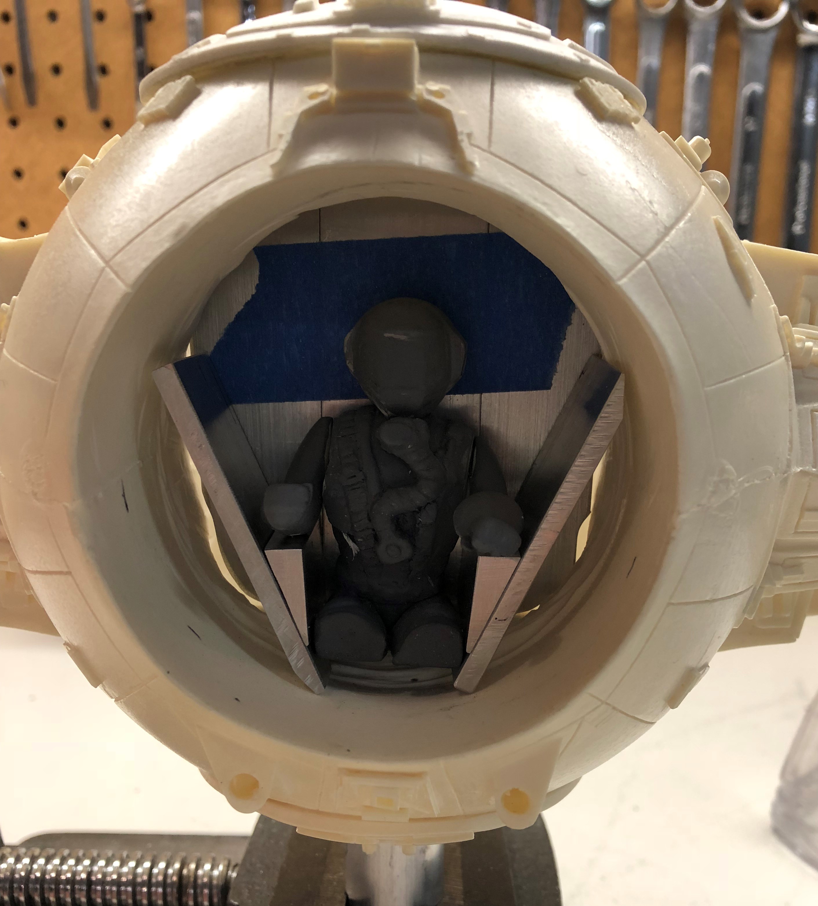

The work continues on the pilot figure...
One big difference between the original TIE fighter helmet and the prototype is a major neck seal, which I've added.
The pilot is looking a lot more like a spaceman at this point.
I've also added some more putty to the sides of the helmets to help increase the size of the "head phones".
One or two more coats of paint and I think that's going to about do it for the pilot and then it's back to the cockpit.
...and back to the Hobby shop to find those Tamiya paints. :)

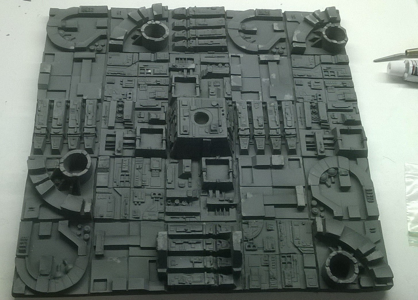

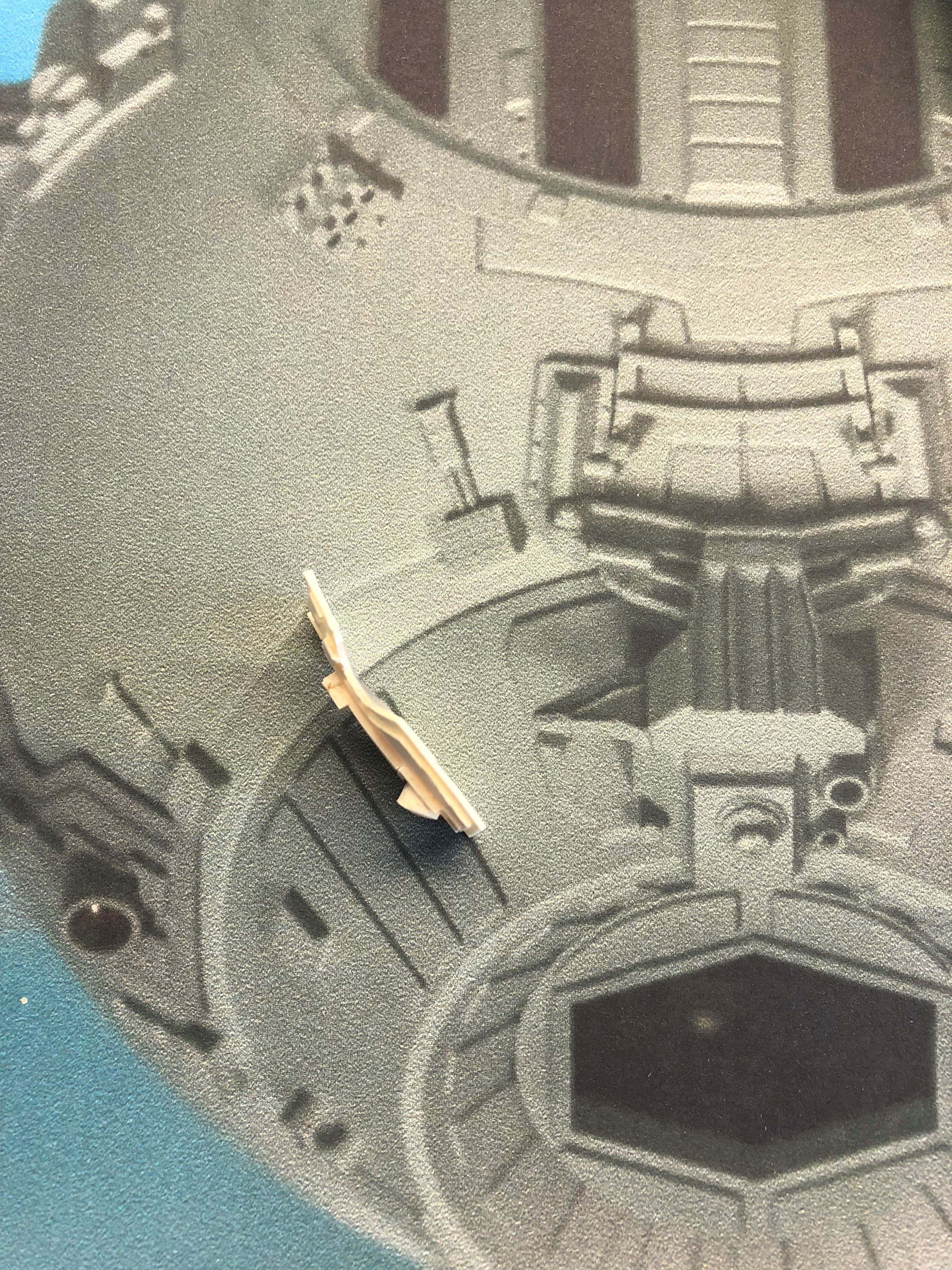

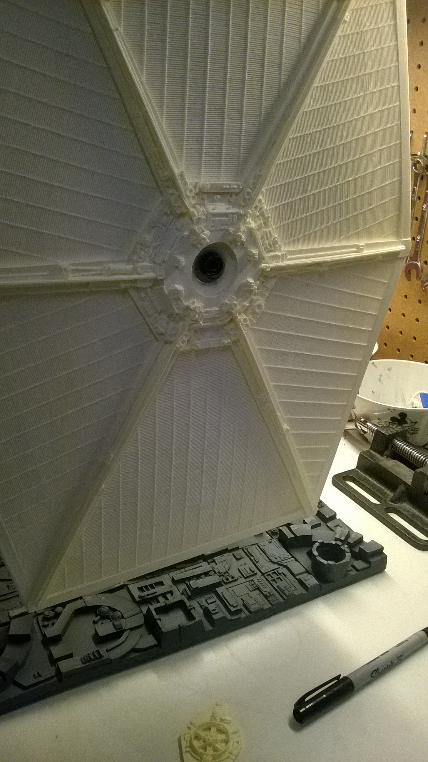

So it's back to the Death Star base..

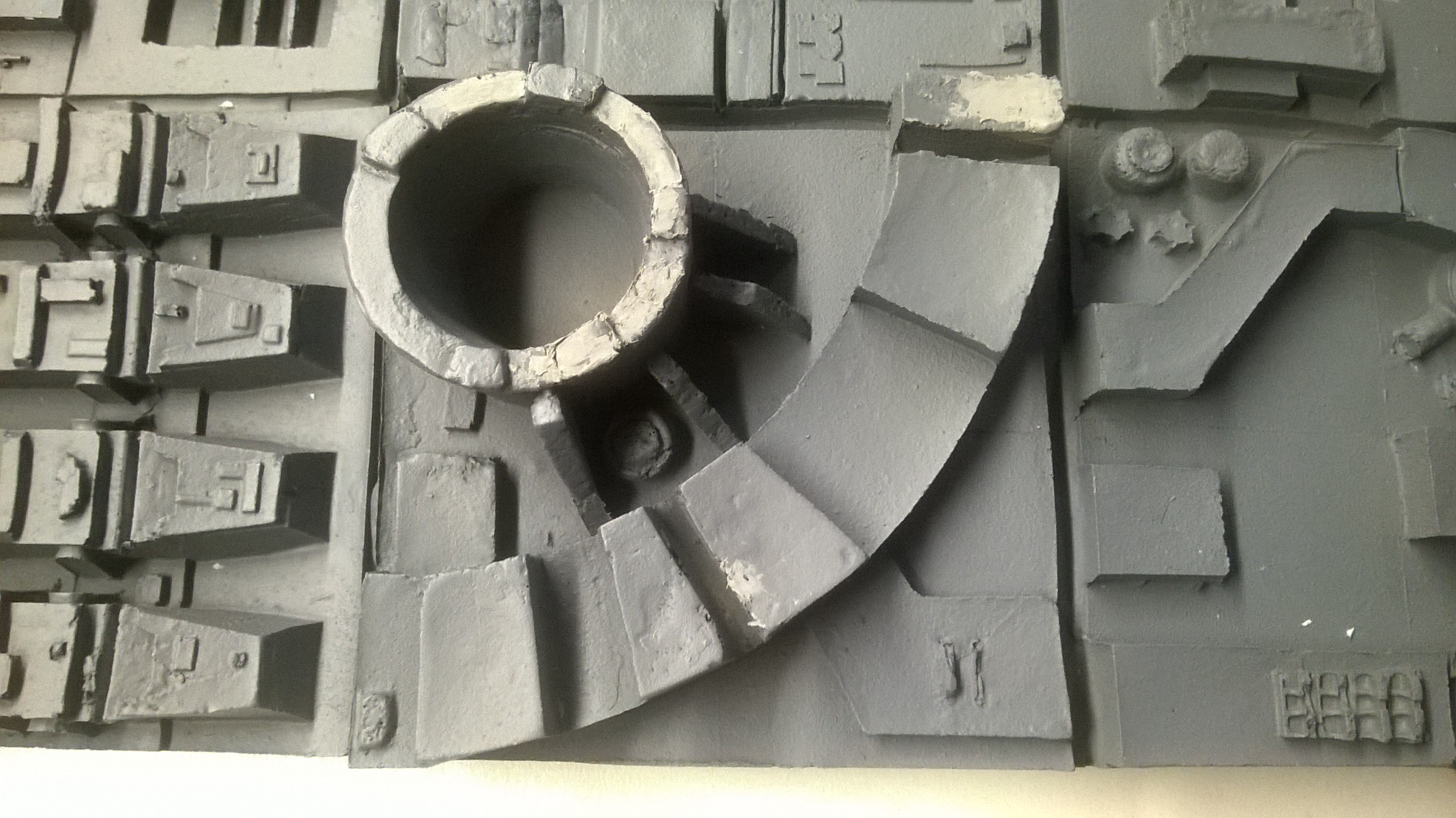

It's starting to feel like a major restoration project. I'm just glad it's not a recast. :p
Still working on the corners and trying to remove the bubble holes. The initial coat of primer is showing off all the pin holes and other problems.
The good news is that some squares or modules still have some sharp details that can be used as a reference while trying to "fix" similar modules placed in different spots on the base.
It does look like the master was originally made of foam with an outer coat of resin.

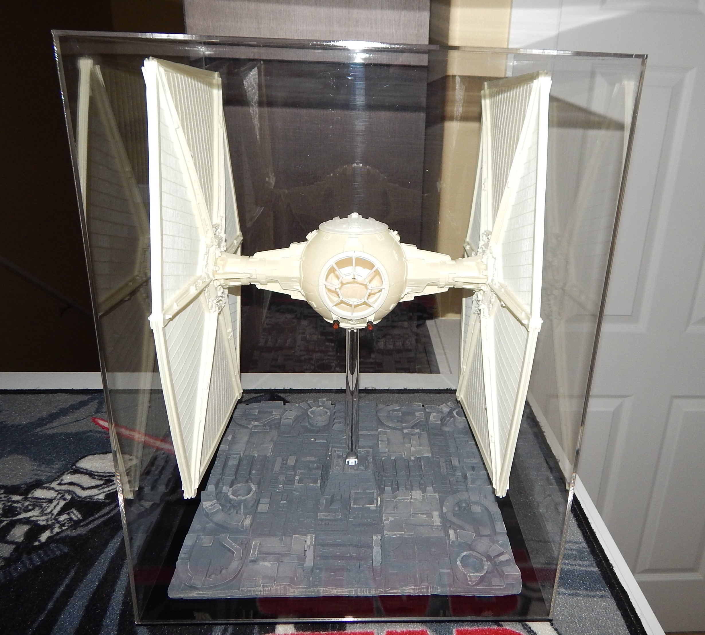

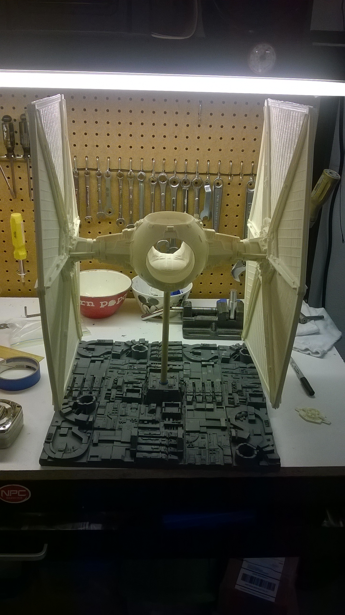

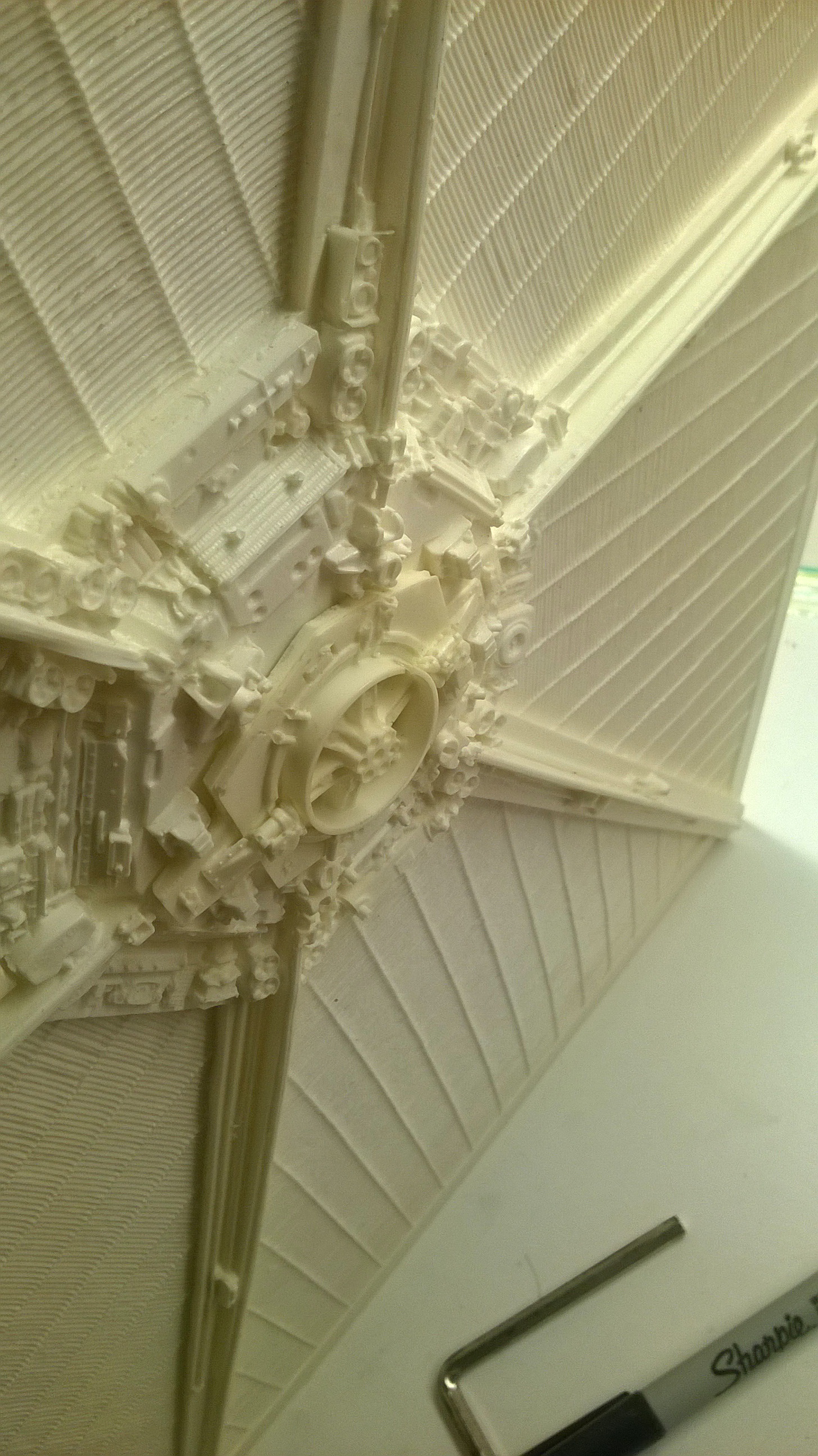

Again I found myself waiting for the putty to dry on the pilot figure so I decided to move forward with the wings. I also wanted to make sure that I got the dimensions right for the new display case and acrylic rod:
It was very exciting to finally get this model off the ground with both wings.:D

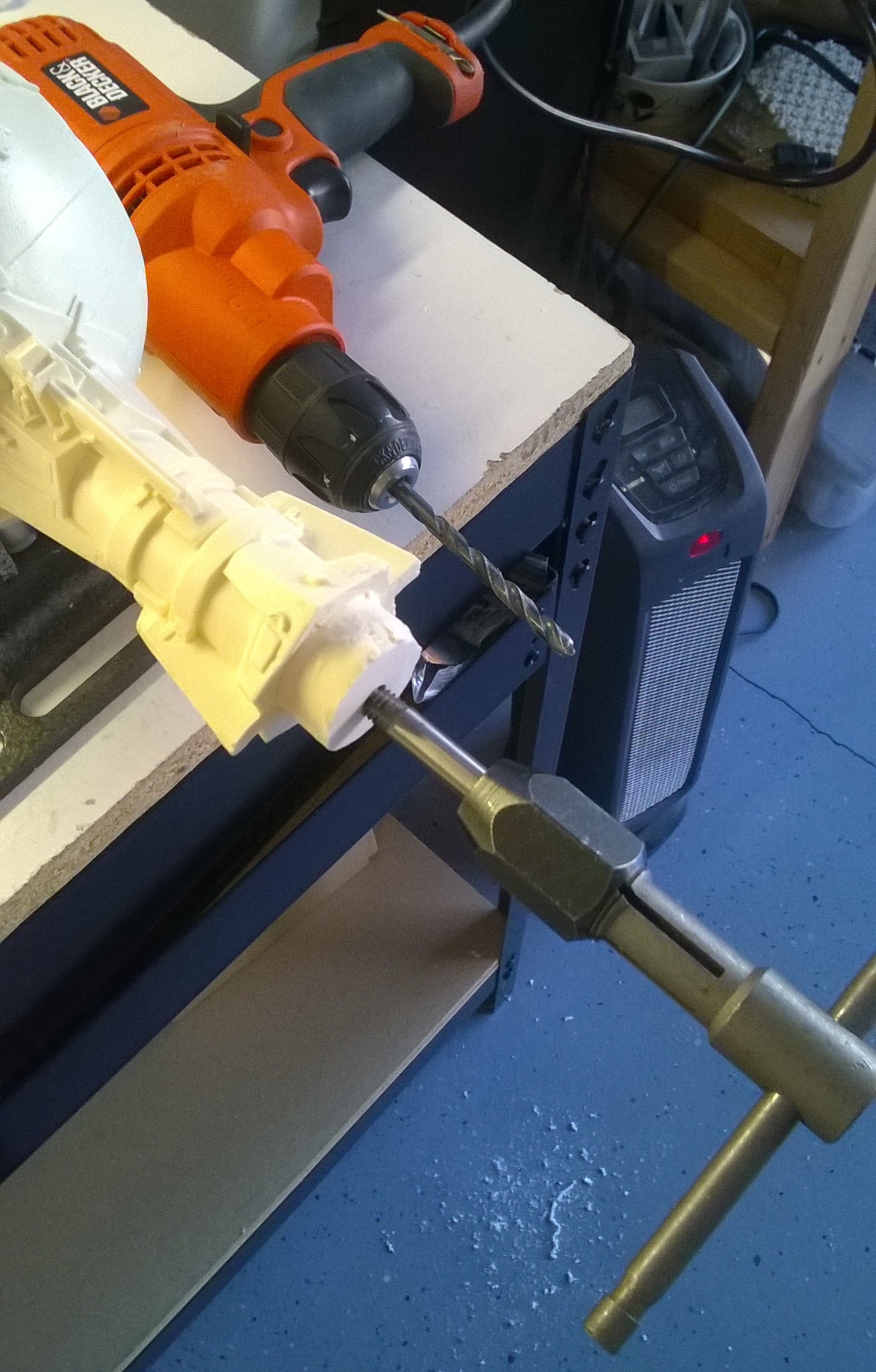

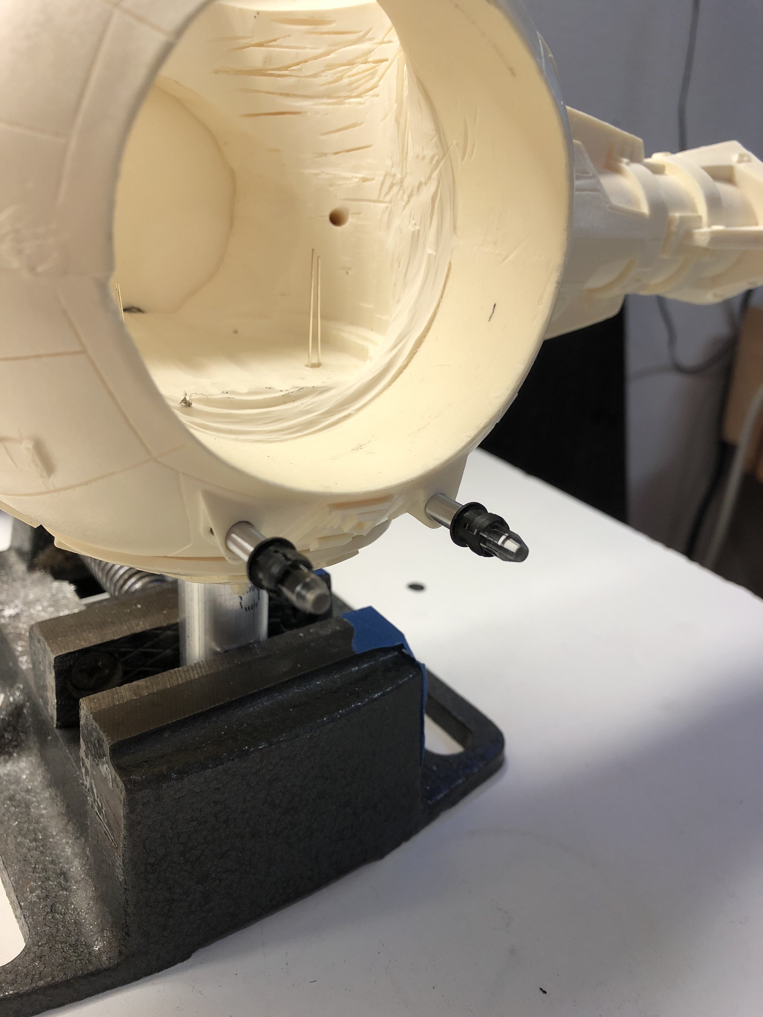

The resin is sturdy enough, so I drilled and threaded the "arms":
I used some left over furniture bolts and washers to complete the assembly:

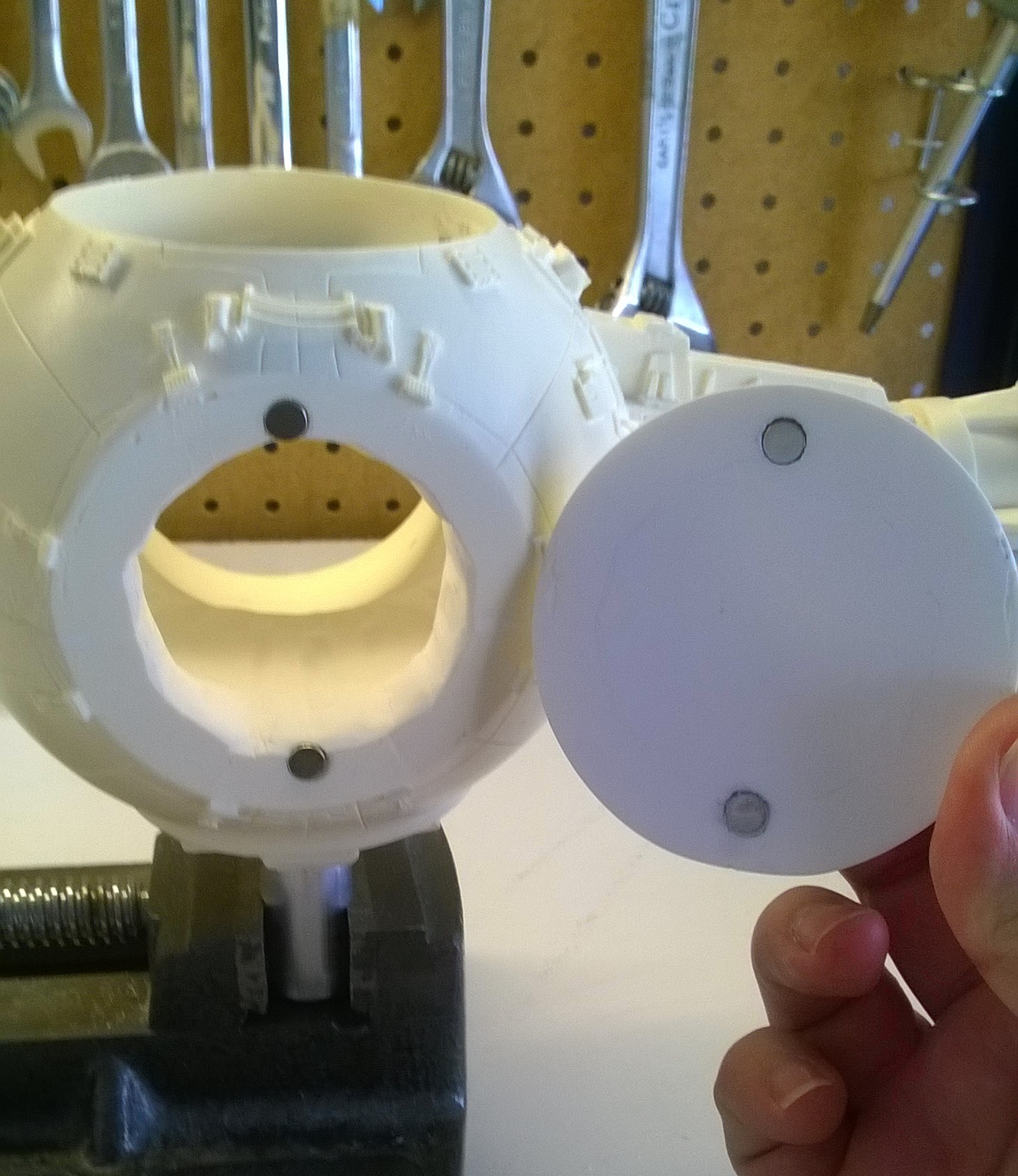

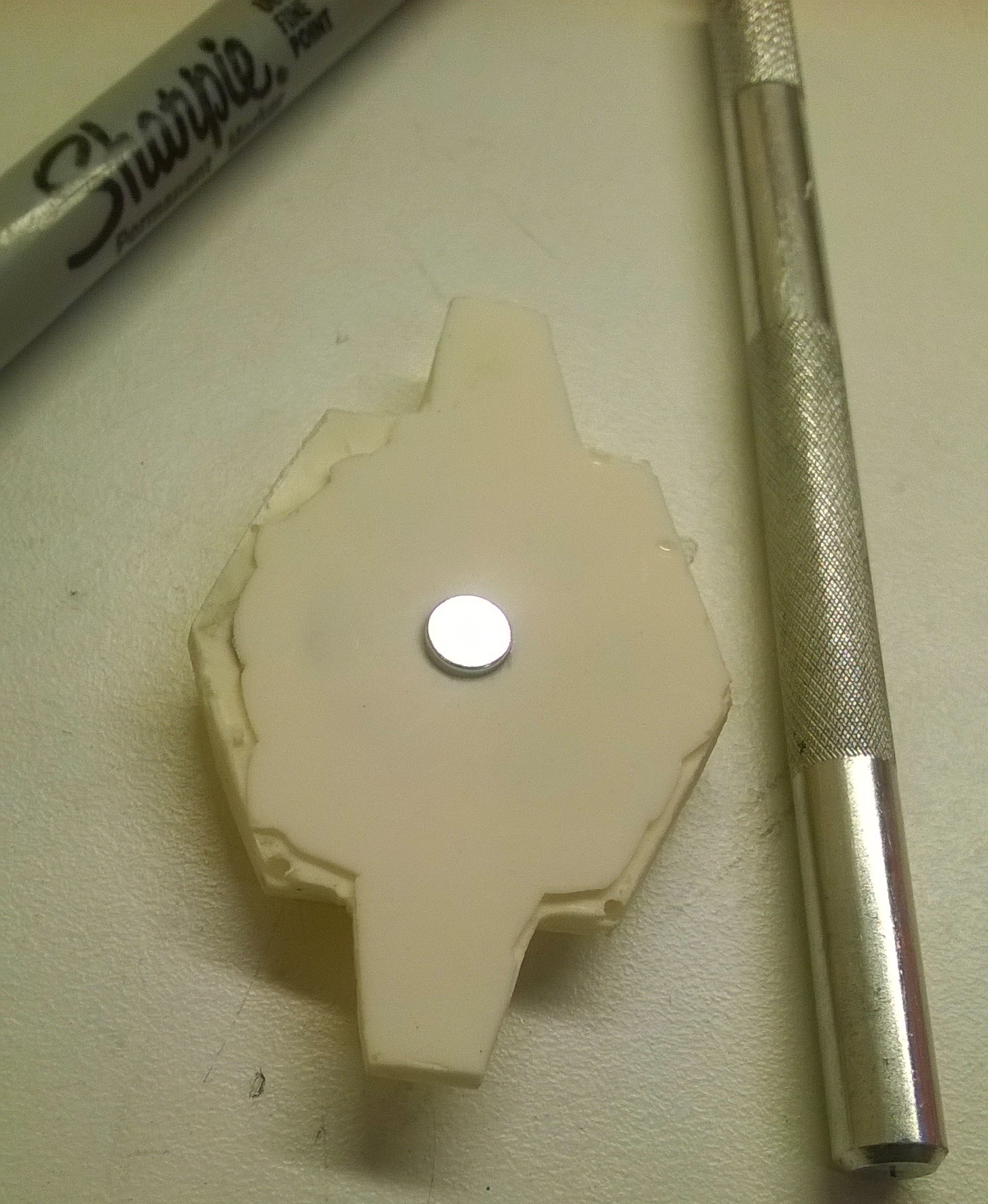

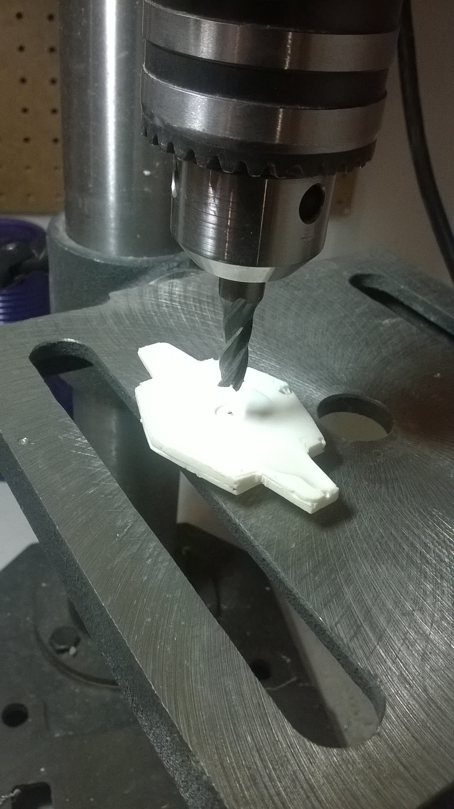

The 1/4" diameter magnets turned out to be the right size for the small, wing panels, so I used a 1/4" end mill
to drill a small hole near the center of the panel:
Sand one side of the magnet and with a single drop of super glue, viola!
The magnet mostly attaches to the bolt.

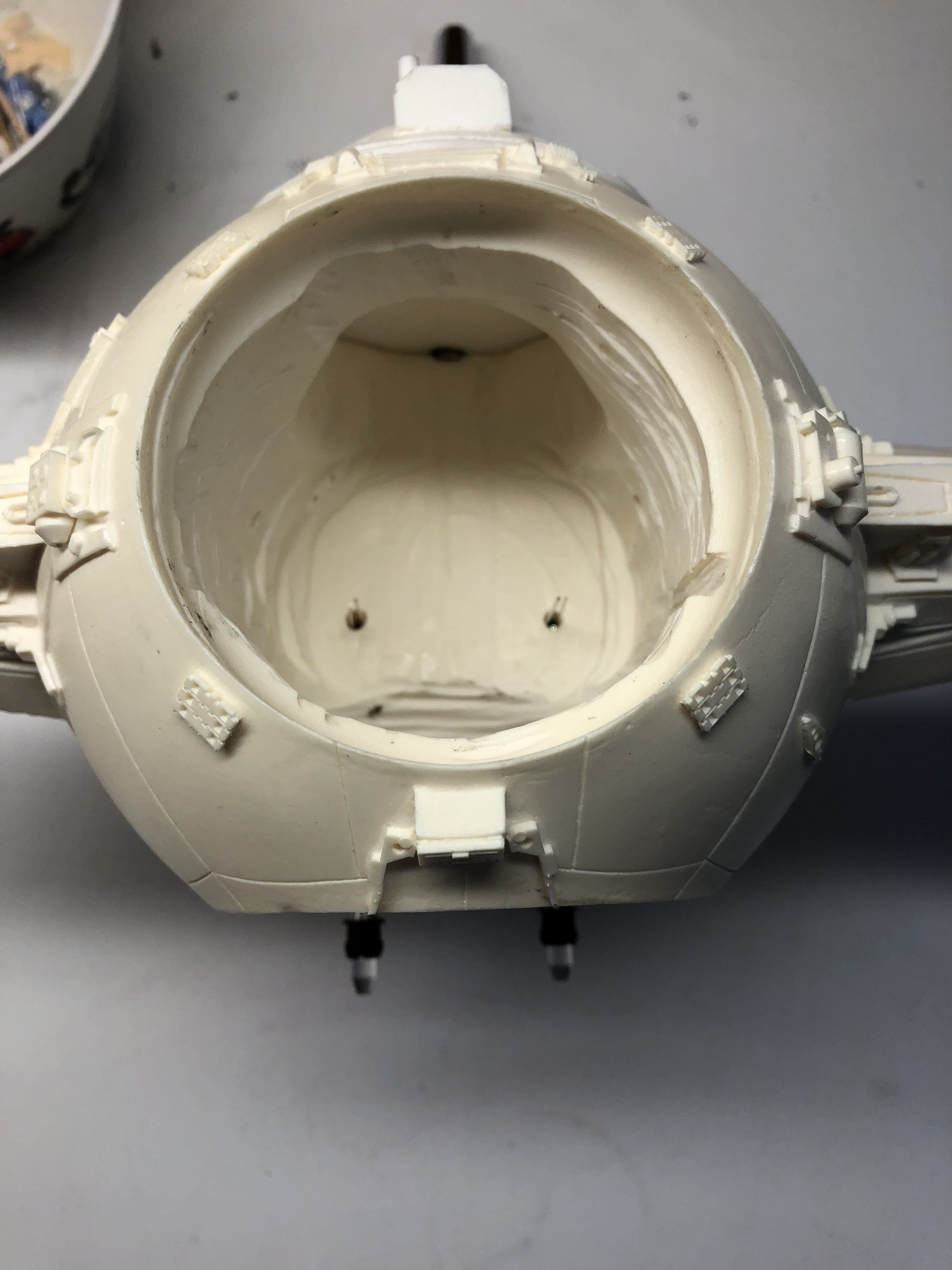

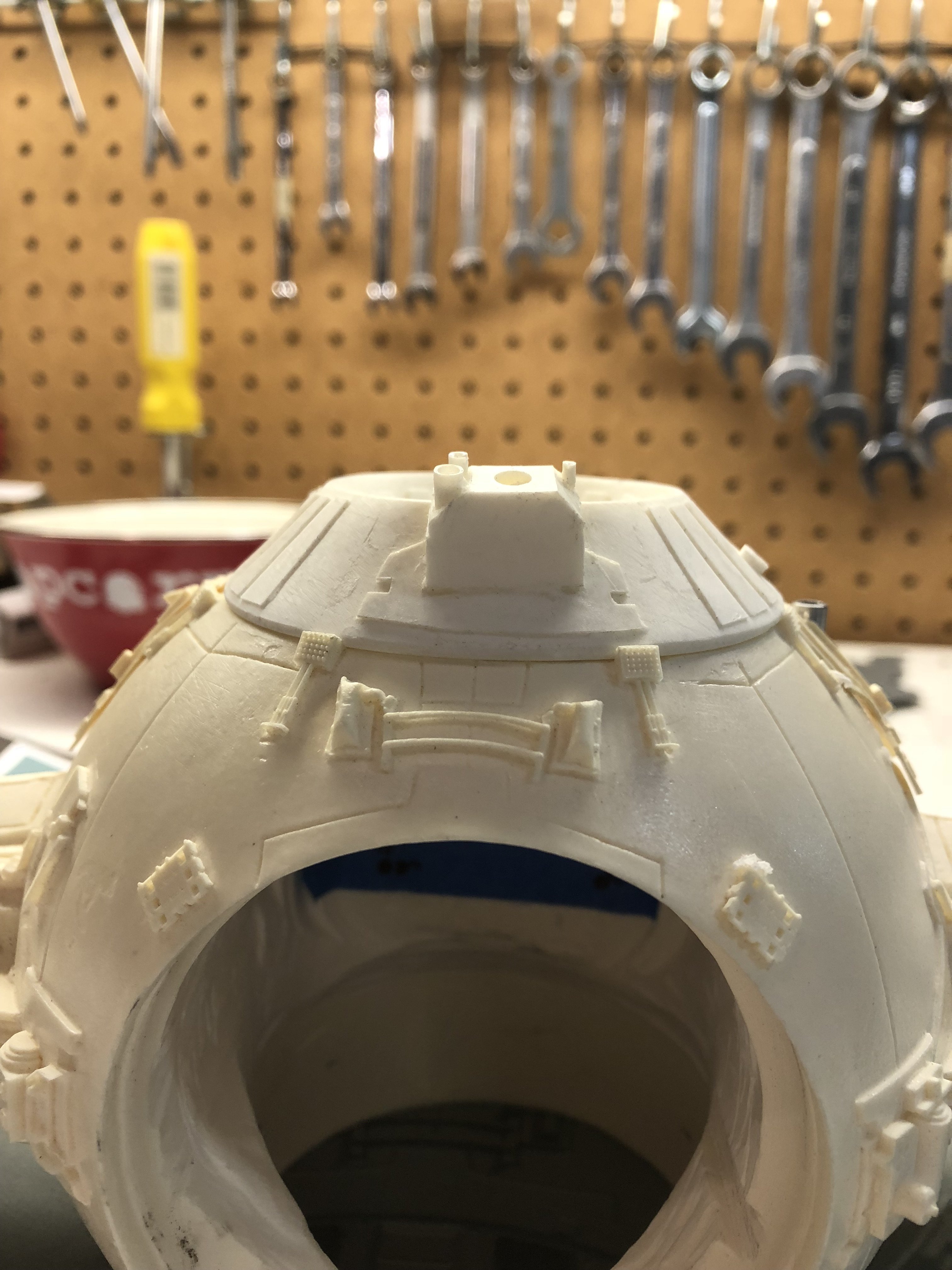

I'm actually not too concerned about sagging. The main fuselage is cast out of solid resin and even thought I've hollowed it out a bit, it's very sturdy.
So today I've moved on to the original, targeted parts for the earth magnets:
They turned out to be an easier install that I had originally thought. A small end mill and a x-acto knife did the trick. Viola!

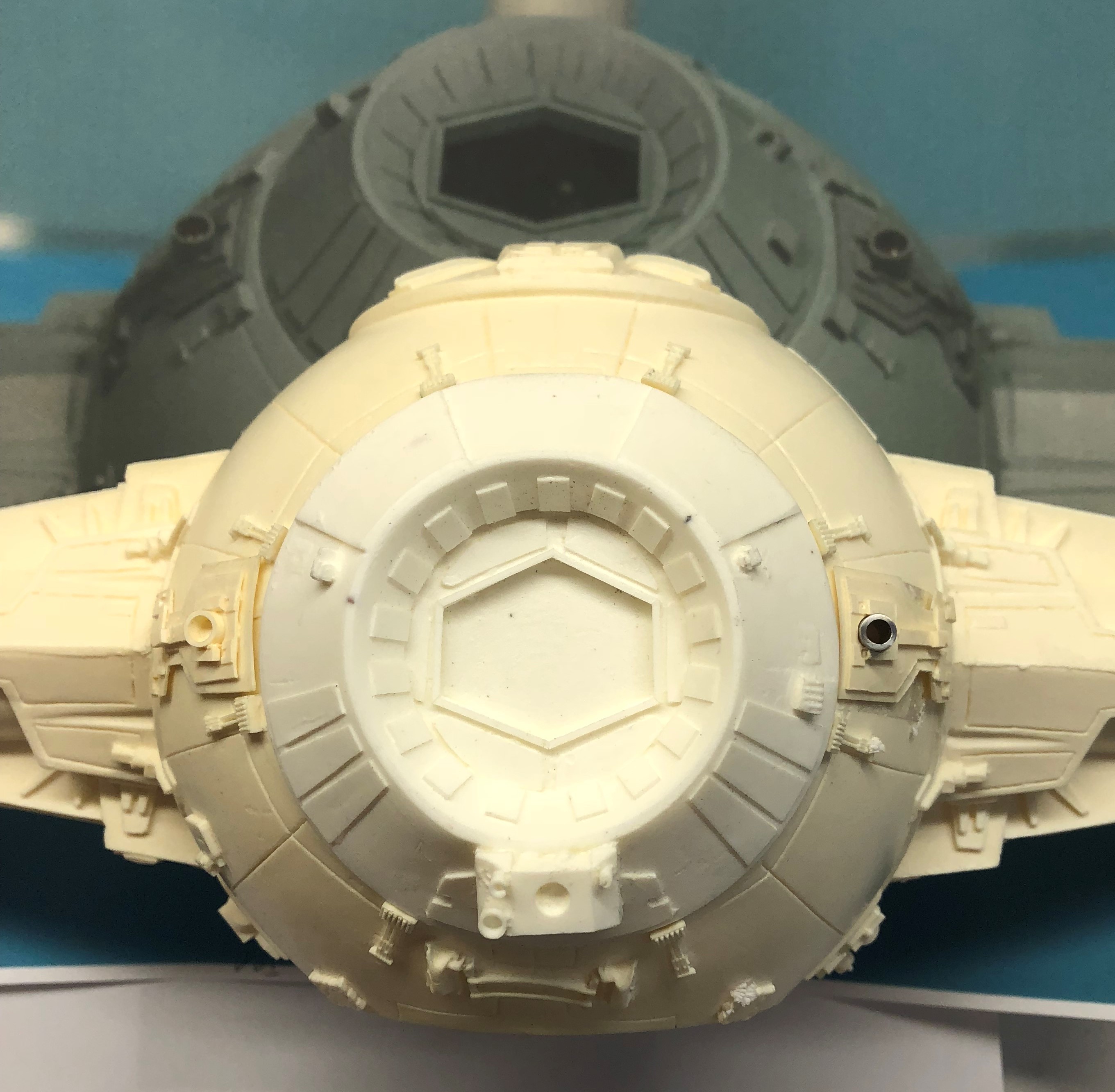

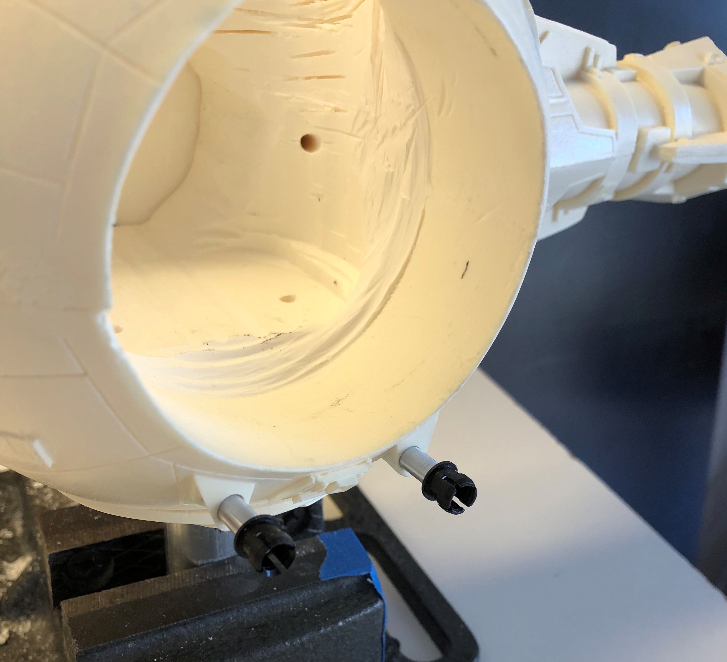

Looking at the cast parts for the ion engines, I realized that they're not sticking out at the correct angle.
So I carefully removed them with a very sharp X-Acto Knife.
I machined some engines out of round stock aluminum.
The size of the hole is 1/8" and the outer diameter is 3/16. It actually looks like the original part may have been a rivet spacer.
I like the idea of using aluminum since it's great at reflecting light. Eventually, I'll add some red LEDs.

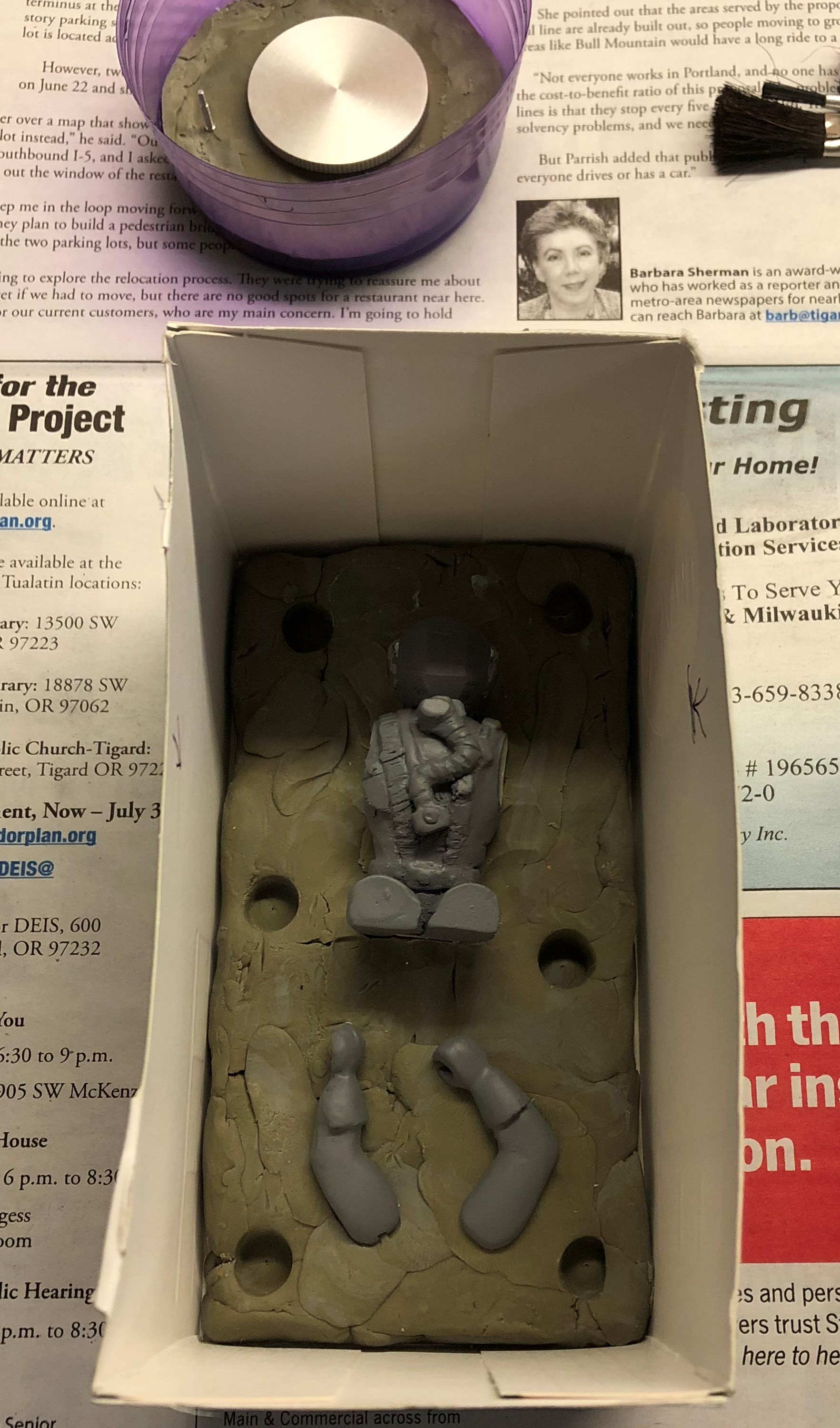

I decided to mold a small "pin" for the side panels since I need to make a mold of the pilot for my Y-Wing model:
If anyone should need these parts, just send me a pm. The mold should be completed some time next week. :)

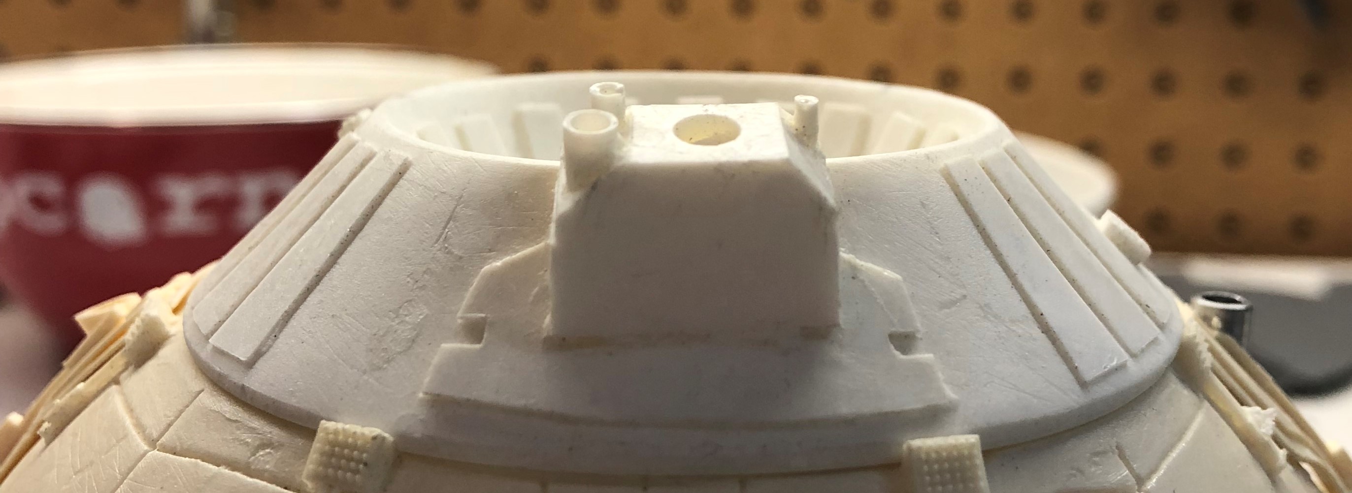

Blasters:
Looking at the ESB and ROTJ reference photos, I had noticed that the blasters appear to be brass tubes, which are probably found items.
I found some of these tubes in a local Hobby shop, but since I only need 2" or 3" of material, I decided to use some left over aluminum
and simply machine them.

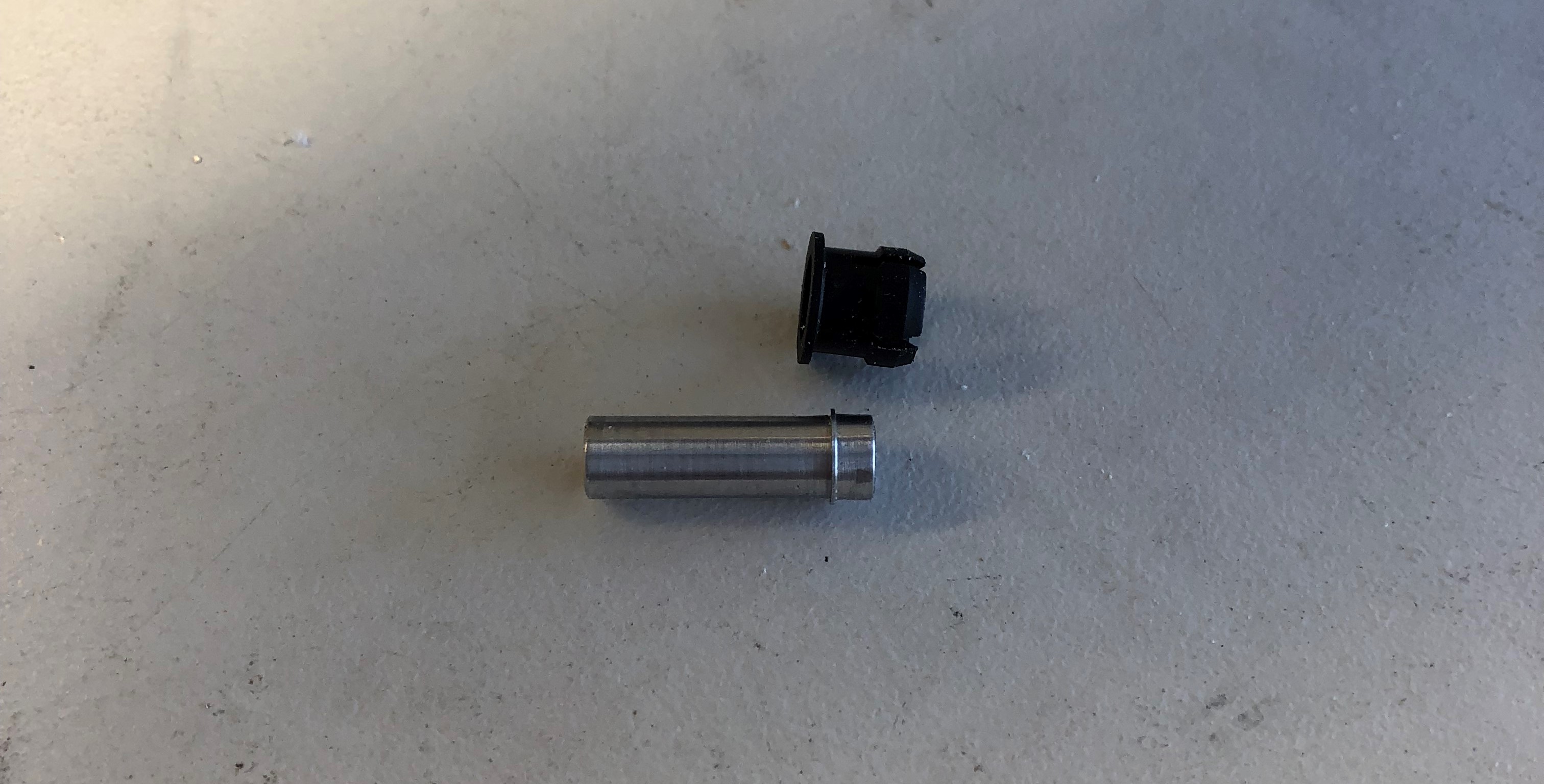

One of the nice things about machining these from scratch was the option of creating a "lip" or "step" to help keep the LED holder in place:
If you look at the ESB/ROTJ or Museum pics, you'll notice that the holders were pushed down against the model, slipping right over
the tubing.
Here's the finished product:

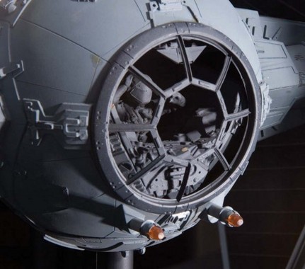

Here's the ESB/Musuem reference pictures:
So the next step is to produce the actual laser.

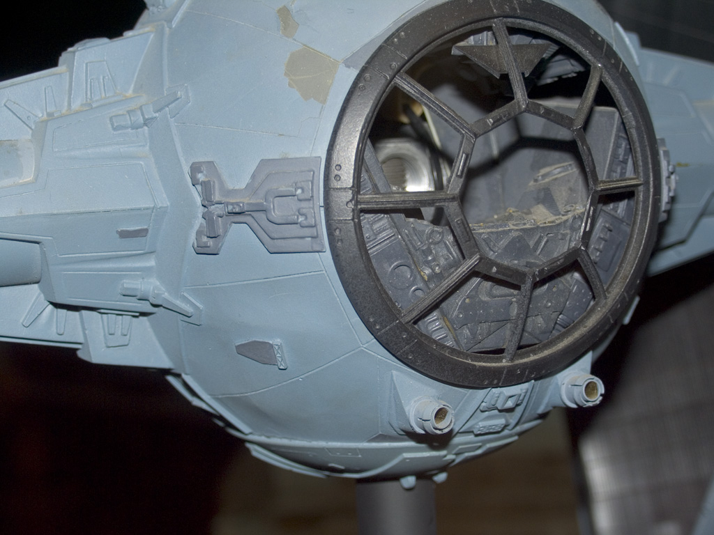

Here's a reference photo of the TIE used in ANH as Vader's right side "wing man":

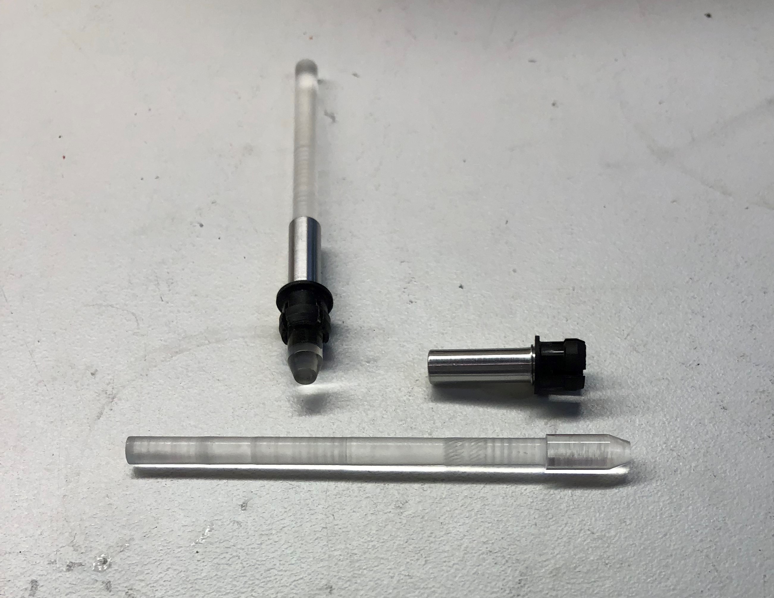

The actual "lasers" are probably just acrylic rods that have been machined and since we know some metal "piping" was used, they must fit inside of it.
So I used some 5/32" diameter, clear acrylic rod and machined it down to fit inside the tubing and then
used a 20 degree angle to machine the tips. The trick is to use plenty of water while machining acrylic. It gives the finished part a nice, smooth finish.

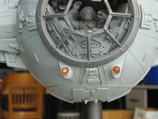

I dyed the clear acrylic "blasters" orange, which reminds me of the X-Wing Helmet lens, so it's possible the originals were dyed as well.

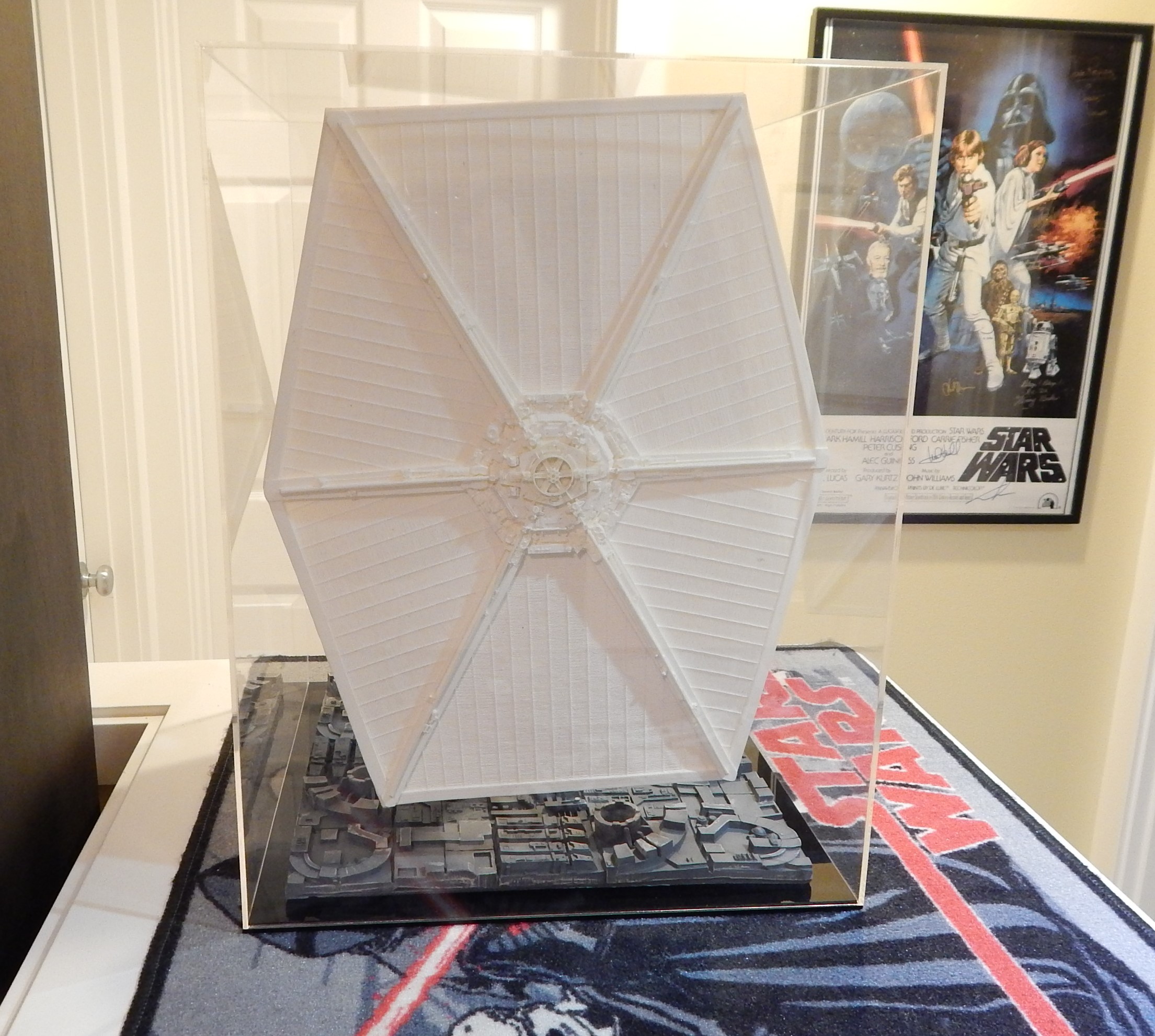

My run of Icons style display cases completed about a week ago:
This week I'm working on the LED wiring and side details for the wing "hubs".

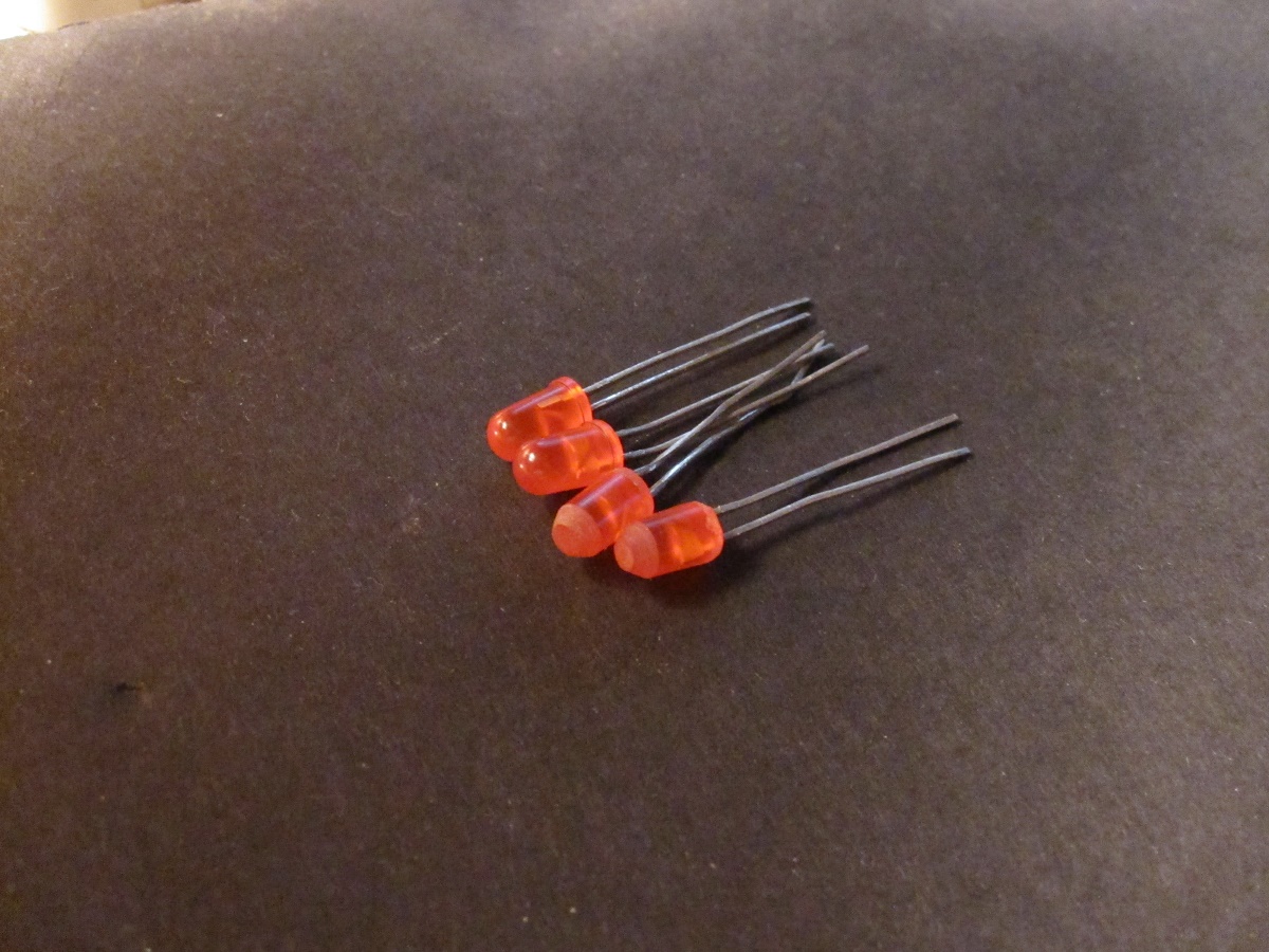

I was always under the impression the orange lights were vintage orange LEDs. I had some of these that I know are from the late 70's-early 80's that I am going to use on mine when I finally build it. Here are 2 normal and 2 that I turned down..
This is probably the best reference photo I could find of one of the original ANH TIE models:
I took a good look and checked the size of a standard LED, but it seemed a little big for the clip.
Also, if you watch ANH closely, you'll notice that the Advanced TIE gives off a white light instead of an orange or green one and with clear acrylic, even dyed orange, it's capable of giving off a white light with a clear LED behind it.
The standard TIEs in ANH don't appear to have working lights for the blasters, possibly because they didn't know where or when the graphics would be added, which turned out to be green instead of orange.
Fair enough on the lighting. I would have though all that would have been done post . As to the led size, it definitely fits, those clips were specifically designed for the large LEDs, The only thing is you have to file away the lip/ledge because the led is supposed to go in the clip backwards from what we want on the tie. Here are 2 other ref pics I have, The ANH one looks like LED to me, on the ESB you can tell it was probably acrylic, the ends are snapped off and you cant snap LEDs like that . Another thing to note, the ESB style look like the rod is inserted into a tube that's inserted into the clip where the ANH is bigger and has no tube around it. Either way im sure it will look great. If you want to go the LED route let me know.
I agree. Looking at the ANH references, it's really difficult to tell if LEDs were used or not.
The tubing for the blasters narrows so much that it's definitely possible that LEDs were used because it would be very easy to feed a couple of small wires
through that narrow area. To use the acrylic rods, they have to be turned down a bit to fit.
My $.02... and to be 100% truthful - this is mostly conjecture... They used LEDs in the sockets but they weren't lit. They likely had the intention of using them as light points for the fx... but like the fiber optics in the X-wings gun tips it didn't work out well in Film.. The lights were too bright, so they weren't used.
