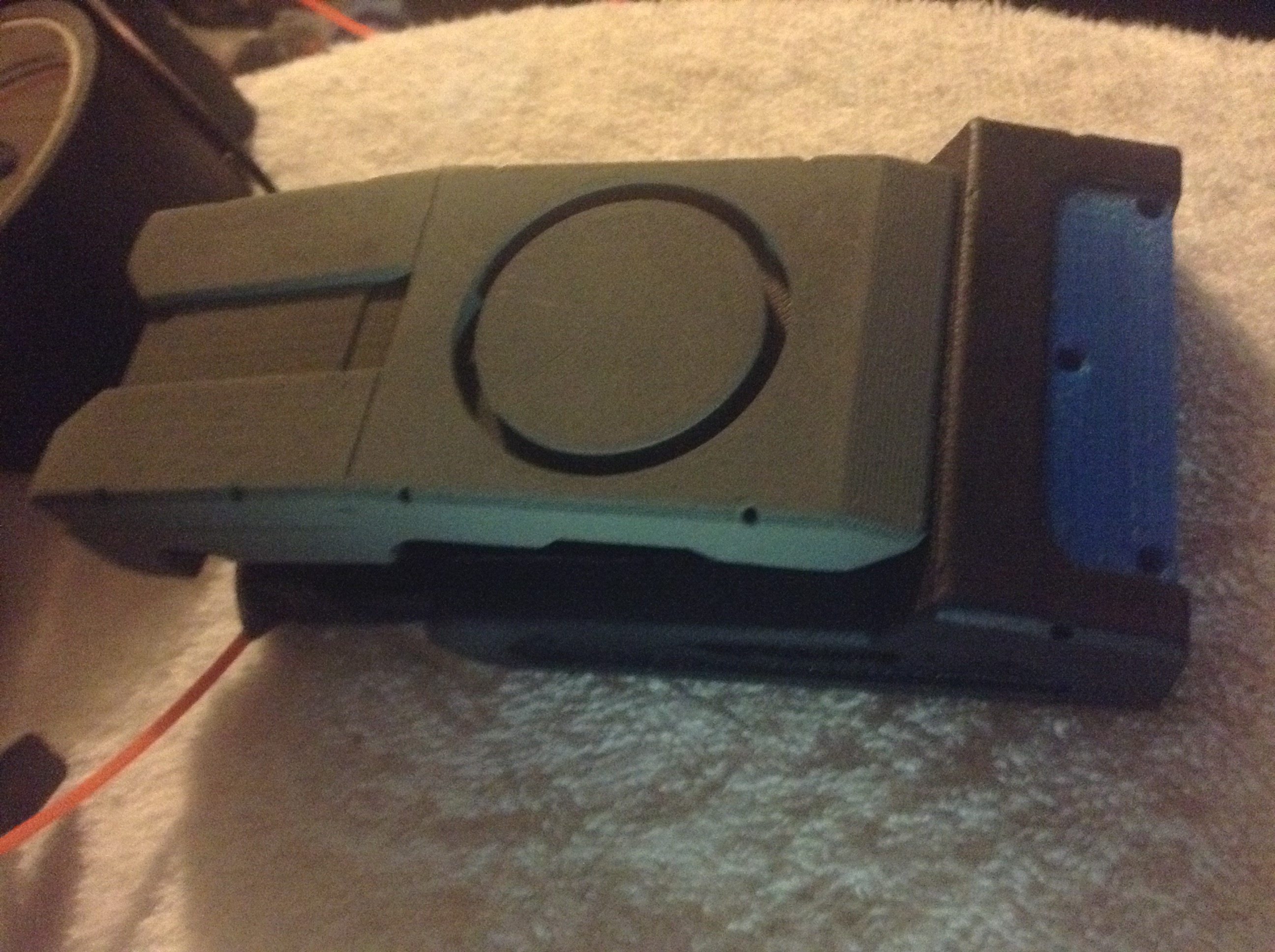

Anyway, this one is about the comms device, obviously. The pieces of the 3D prints from [the other] Keelan over in Australia came in, but they needed to be put together and cleaned up a bit. Anyone who has worked with 3D printed pieces before knows the pain in the ass the sanding process is, so I was glad after a few days to have gotten that task to a point where I felt pleased with moving on.

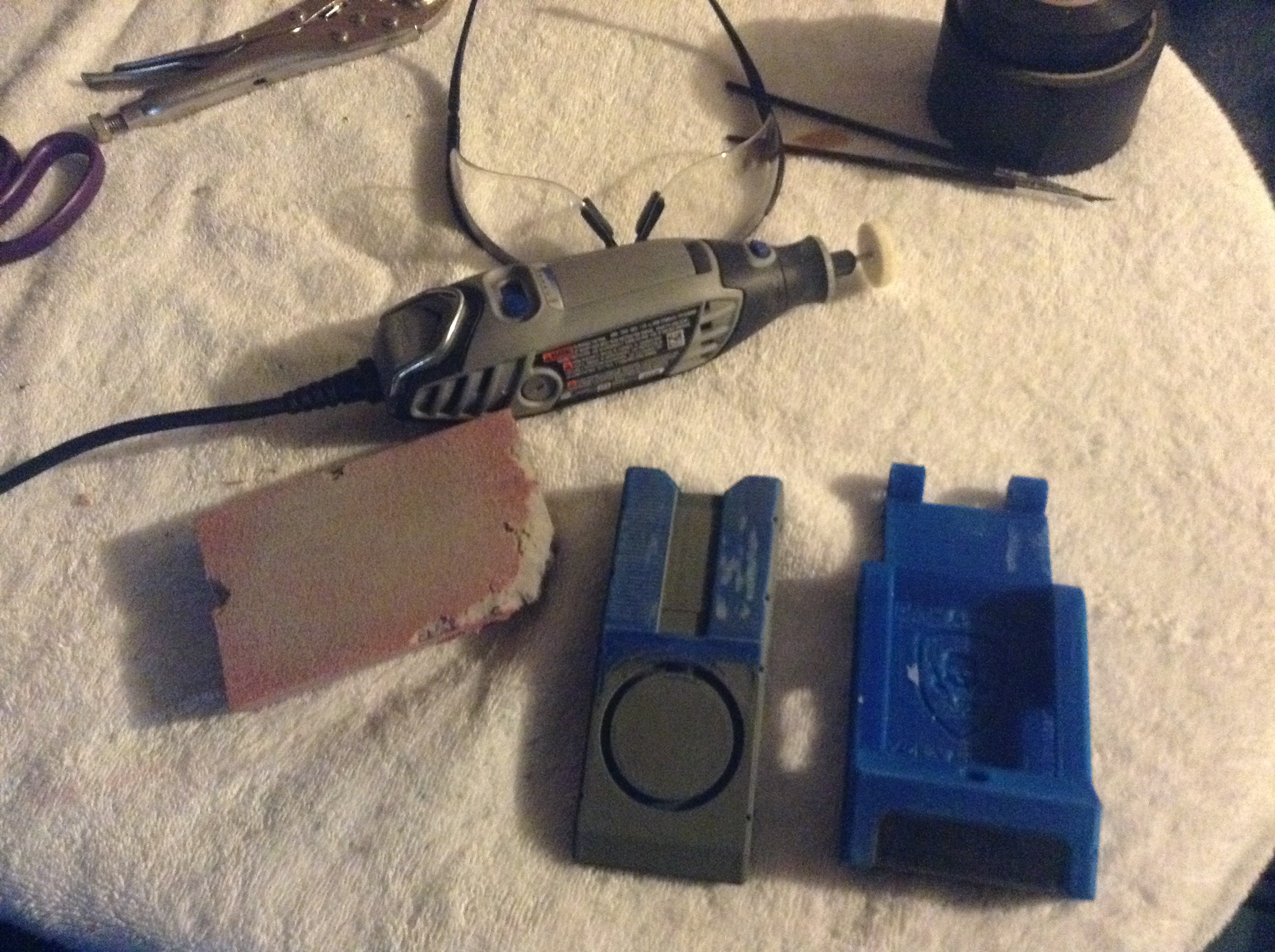

IMG_0537.JPG Here's an in-progress pic of the two halves of the body. You can see on the "cover" that I started to primer it, but wasn't too pleased with some of the sanding and decided to strip some off and go at it again. I started (at this point) to use the dremel with the cotton polishing wheel attached; this helped me to warm up the surface of the plastic a bit quicker so that the sanding had a better affect. There's some black gaffer tape on the bottom of the body section, and the purpose for that will be explained in a moment, but first...

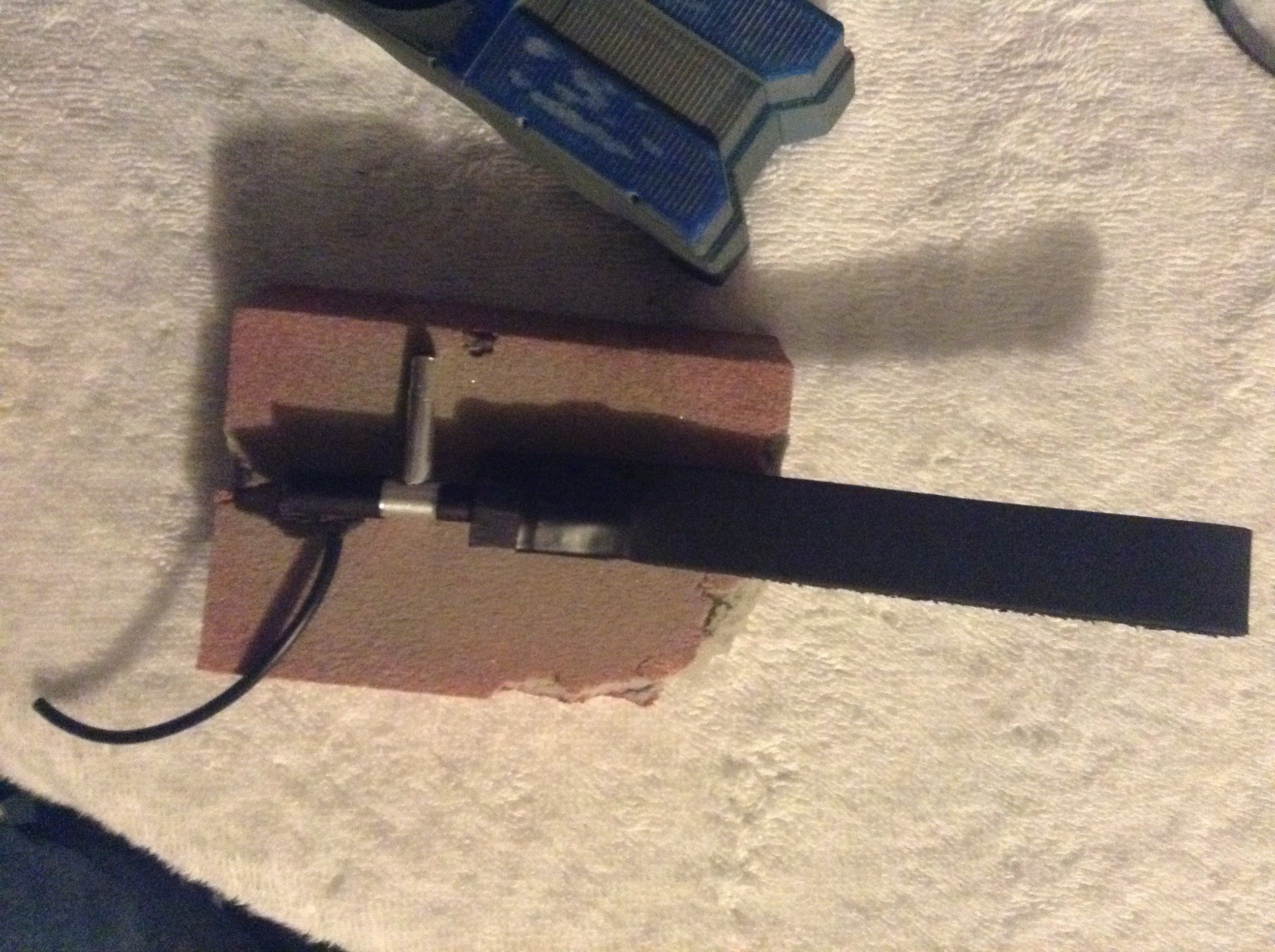

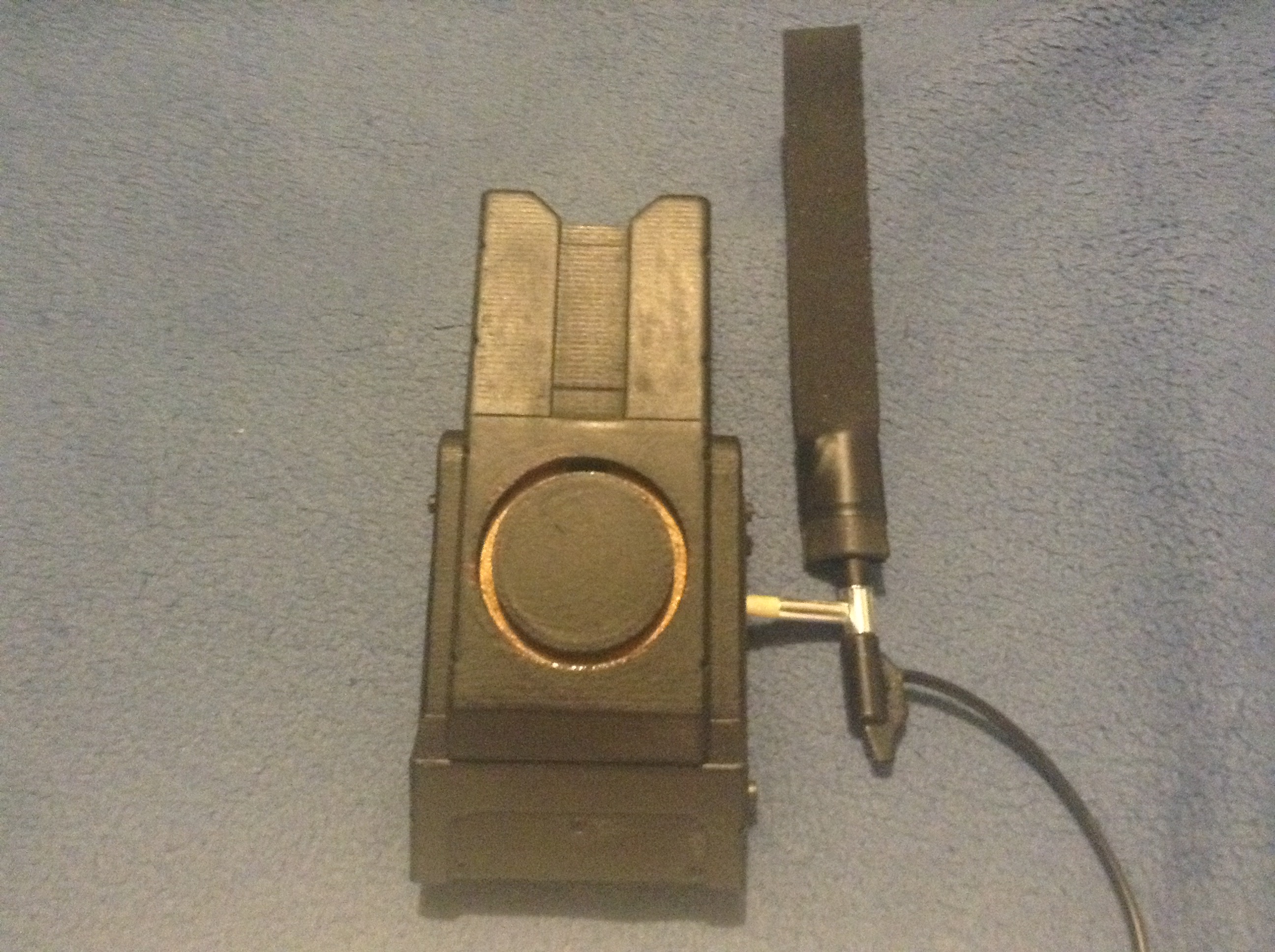

IMG_0538.JPG This is the look of the updated antenna. I added another dowel piece to be an "arm" between the antenna and the unit body. Attached to the "fin" at the bottom is a piece of scrap wire from an old headphone jack, which the other end will be attached to the unit body as well. Added to the center area I have a couple of bits of foil tape to give it a nice metal look.

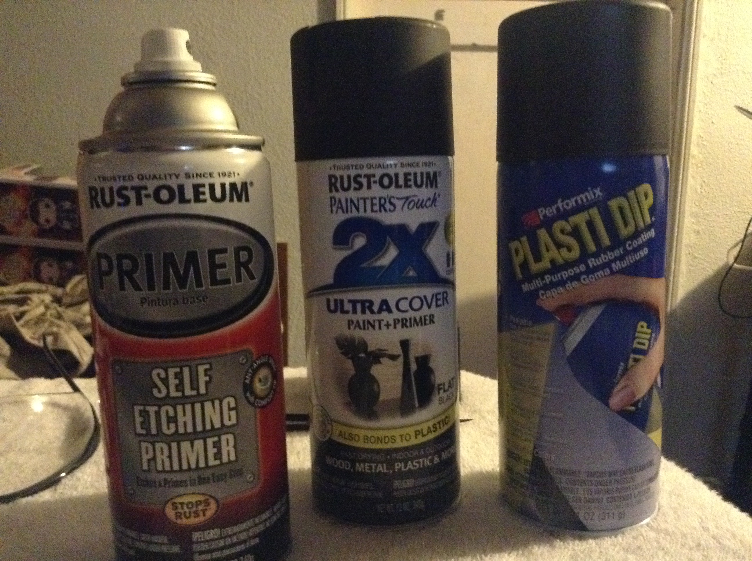

IMG_0539.JPG These are the paints used. The self etching primer was chosen because it would sort of fill in the little imperfections on the surface in the sanding process, but without worrying it would fill in any of the small details that I WANTED to be seen. The paint+primer is used for the obvious reasons, so nothing special there. The PlastiDip is the reason why I used the tape on the bottom of the unit body: I wanted to have a portion of it look like it was rubber, to help break up the surface textures a bit among a couple of other aesthetic reasons. A good number of coats of this were used before it stopped looking so much like PlastiDip covered plastic, but I eventually got it to look decent and was able to remove the tape.
IMG_0545.JPG This here is a mid-progress pic. You can see (the blue area) where the tape was removed after an acceptable affect was accomplished with the PlastiDip. We also have the fully primered cover placed on top, just to give a bit of a visual reference what things are shaping up to look like.
Now comes the exciting stuff:

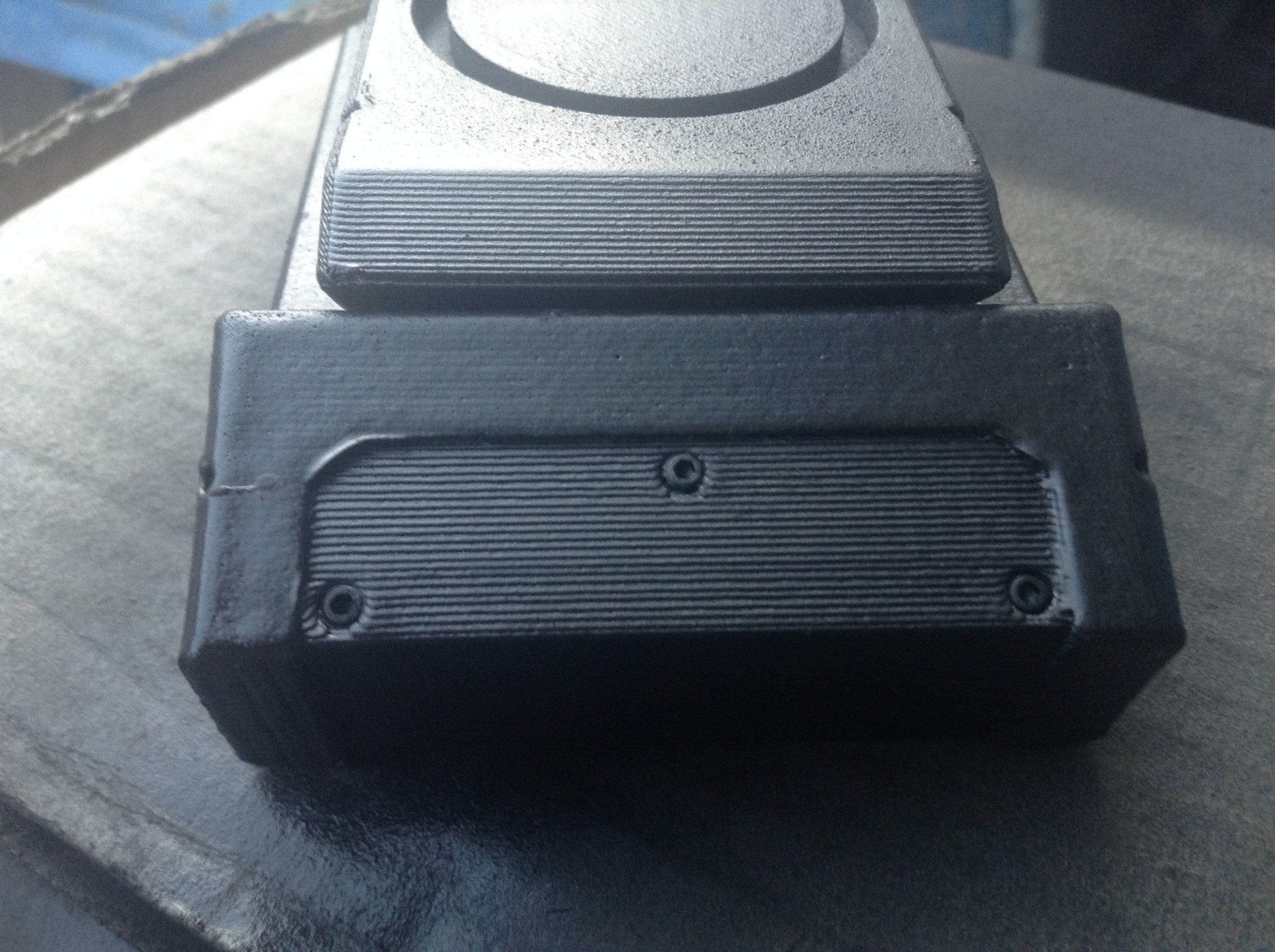

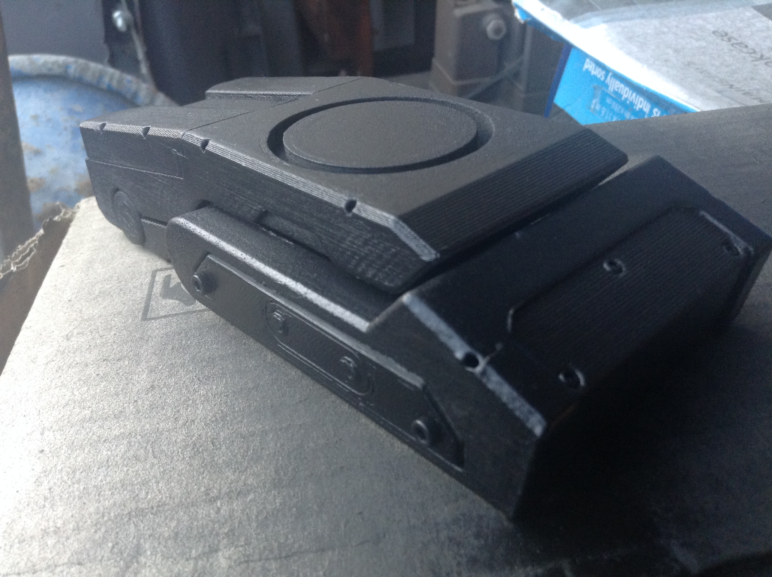

IMG_0551.JPGIMG_0553.JPGIMG_0556.JPG Things are finally given a few coats of paint and pieced together! The bolt/nut that holds the cover to the body is put in place, and the caps for the ends are glued in place as well. The side panels to the unit body are glued and screwed (totally did NOT mean for that to rhyme!), and the other little bits are put in place on the bottom of the unit. To help break up the look of the side of the unit without the antenna, I added a small piece of foil tape over the "buttons."
IMG_0555.JPGIMG_0554.JPGThis was the solution on the back of the unit to how it would secure on the costume, wherever it would be chosen to be mounted. I know, I know, I'm gonna get crap from some people for my choosing to not fully sand and smooth the back of the unit. Deal with it!
IMG_0560.JPG Here's the [nearly] finished unit! The inside of the ring was painted with a light coat of metallic silver paint, which was then gone over with a coat of acrylic clear orange (I'm hoping this bit of reflective surface will assist with the glow of the EL wire). Obviously, I need to make a few small adjustments before affixing the antenna, and I need to get the EL wire set up. So pretty much, I should have one functional unit for use when it comes to filming the pilot of the webseries. :)

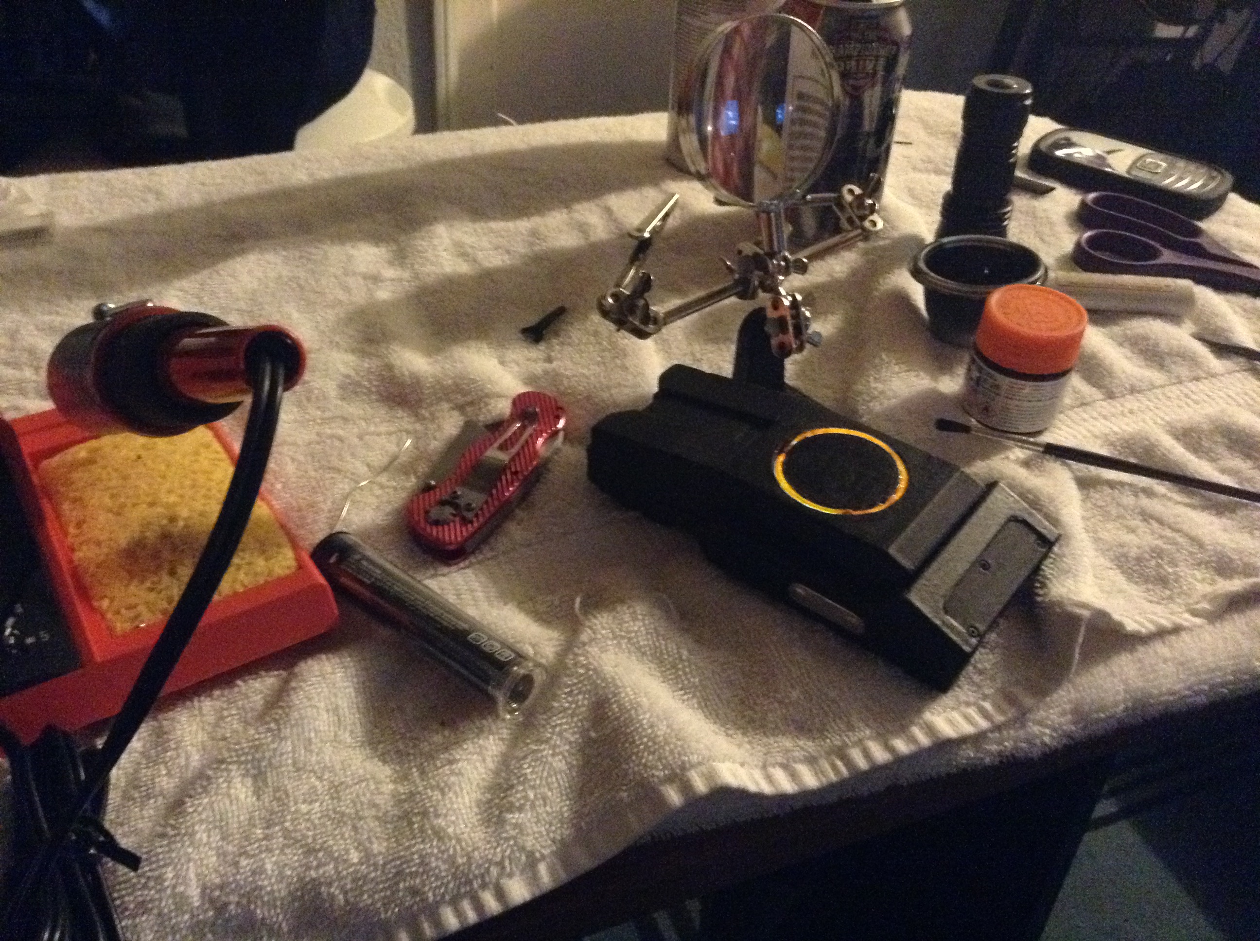

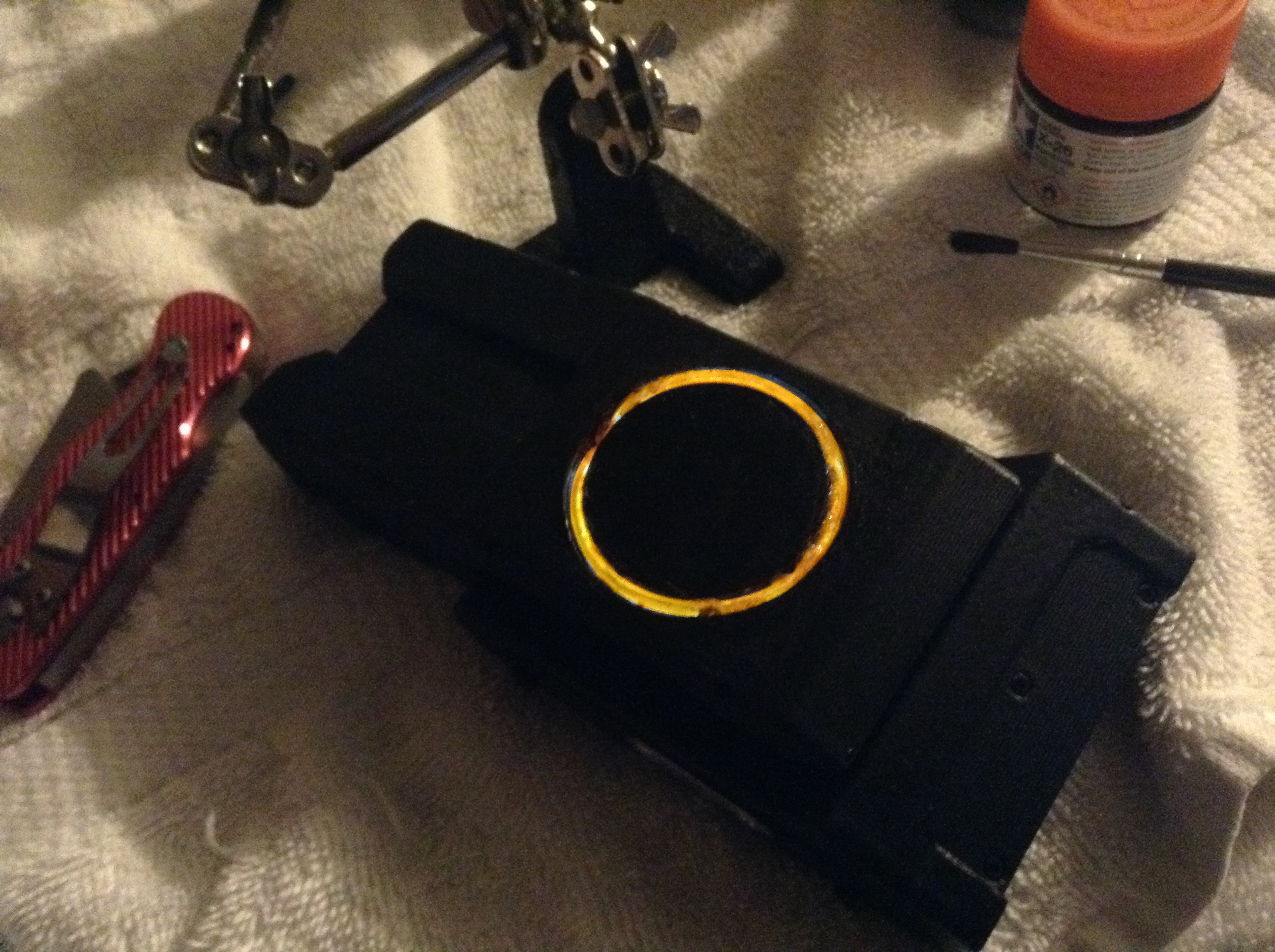

[Mini] Update #14: IT GLOWS NOW! :D
The soldering kit finally came in. Thanks to doing plenty of research ahead of time, I was able to get a decent grasp on the soldering technique, at least well enough that it actually worked!
Using the acrylic clear orange over the ring definitely got rid of the annoying aqua glow of the phospor through the cheap casing on the EL wire. I just have to do a better/cleaner job with securing and gluing the EL wire in place with the next unit pieced together. Hopefully, the glow of the ring reads well enough on camera when filming, but it for sure gets the job done in person. :)

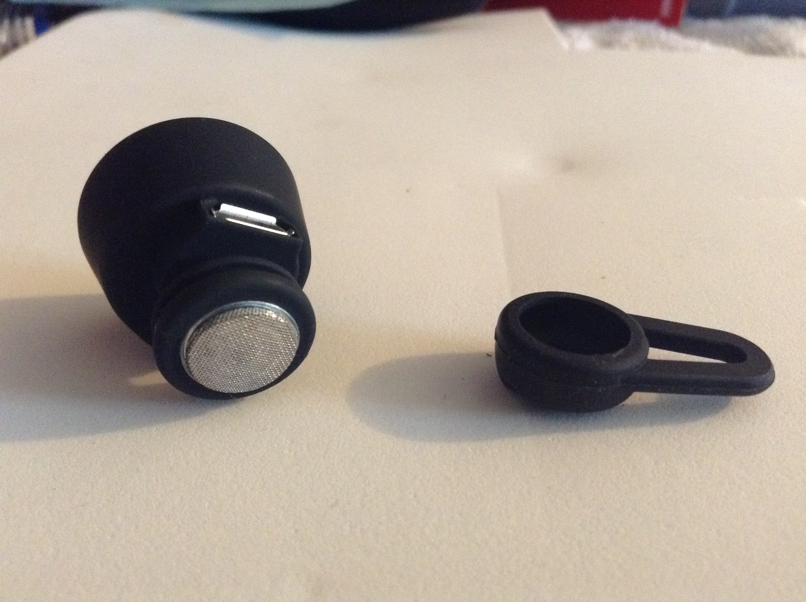

First step was to purchase an inexpensive bluetooth headset. The set looked nearly perfect in the photos when I ordered it, but the piece in reality was MUCH larger than it was believed to be...

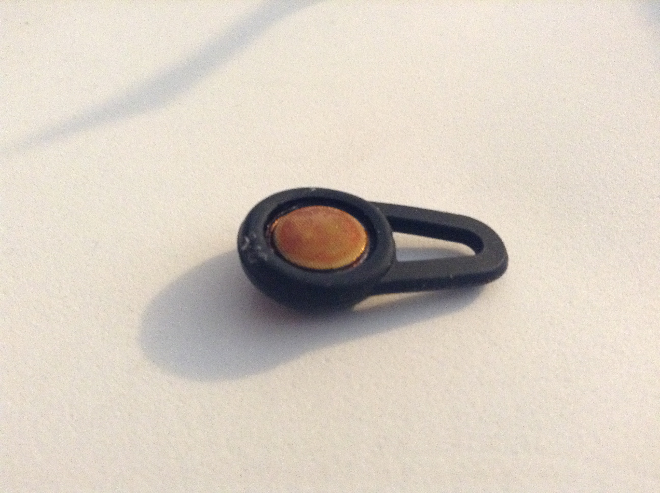

Looking over the piece to figure out what I could do with it, and loving the feel/size of the rubber piece that actually fit in the ear, I started to think of a plan...

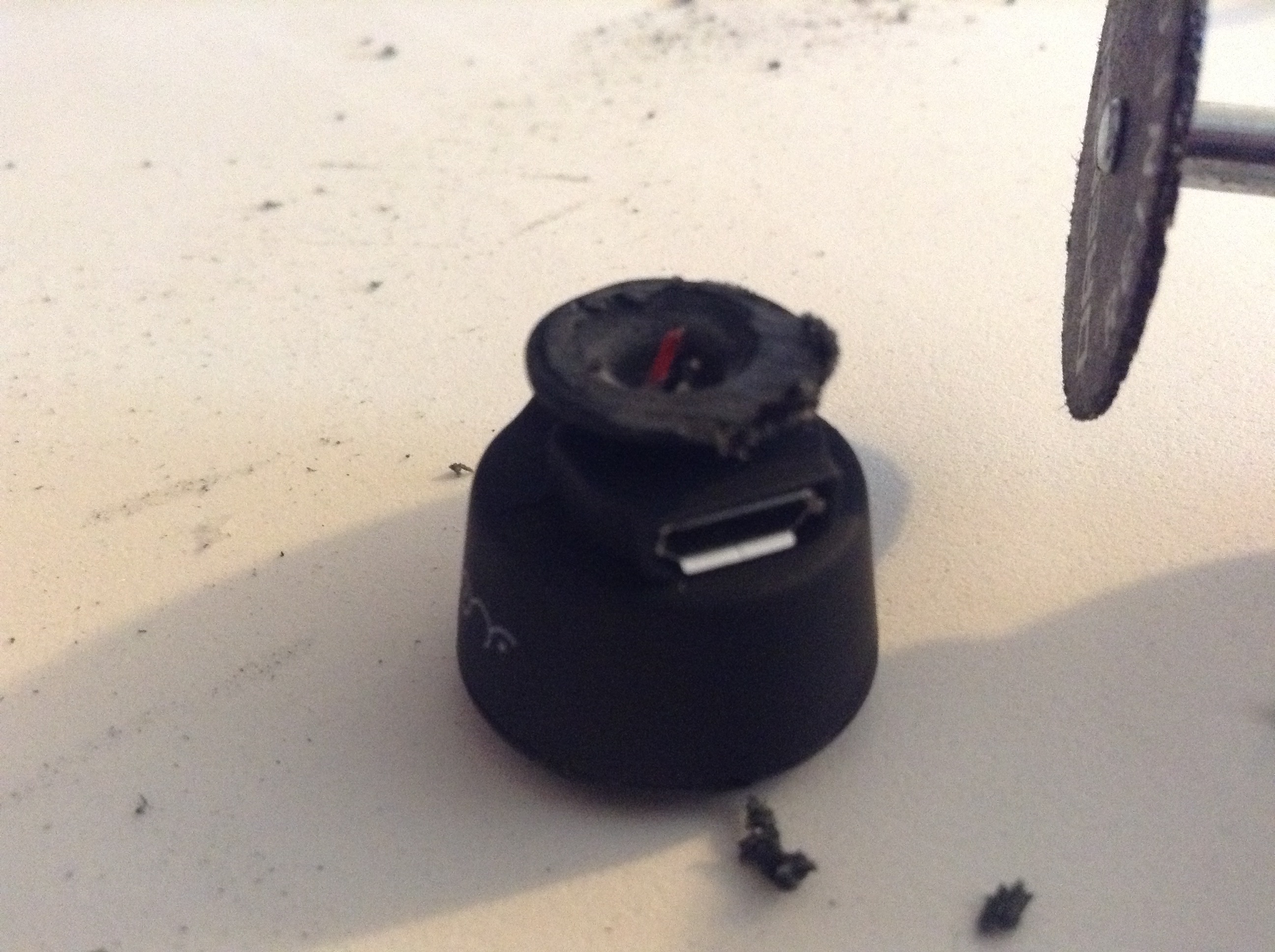

I decided to dissect it a little; I would use the rubber piece, but I liked the small speaker. Also, it would put something INSIDE the rubber piece so that it didn't just look like a hollow piece of rubber stuck in my ear...
Once the speaker and the plastic around it were severed from the rest of the headset, I simply put it back inside the rubber piece, though BACKWARDS (this way, the "screen" of the speaker would be facing outward). In keeping with the color scheme of the tech from the game, I applied a thin coat of clear orange acrylic paint (the same used with painting the EL wire of the comms device). This is the end result:
May not be much, and I'm sure as the game comes out there will be some sort of explanation to how the communications works that will void this little thing out of existence. But I think for the most part it works. It's subtle and "covert" enough to fit in, the colors work, and it's quite comfortable. Plus, this way my OCD doesn't kick in and I don't feel there's some detail I've overlooked. :p

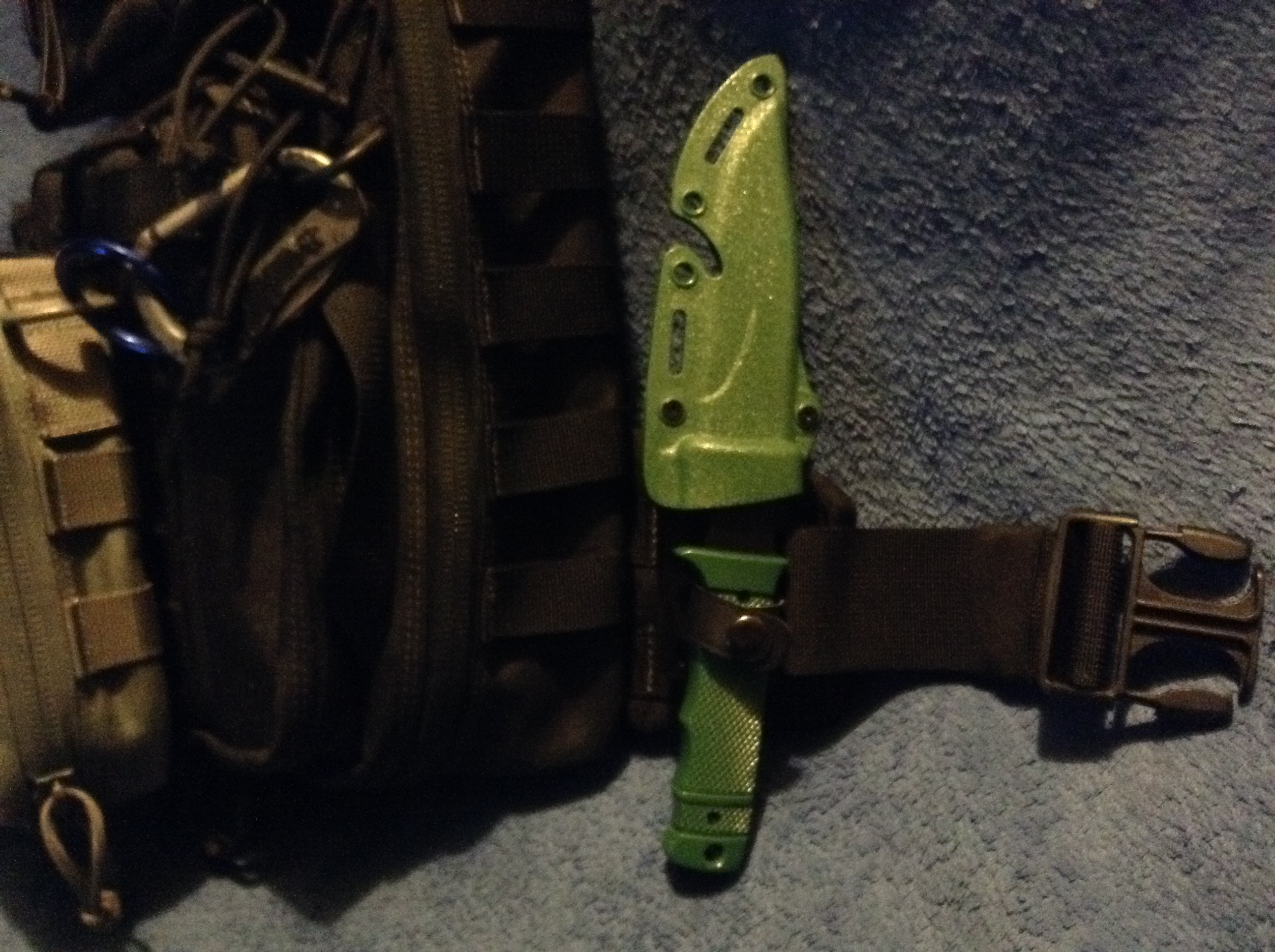

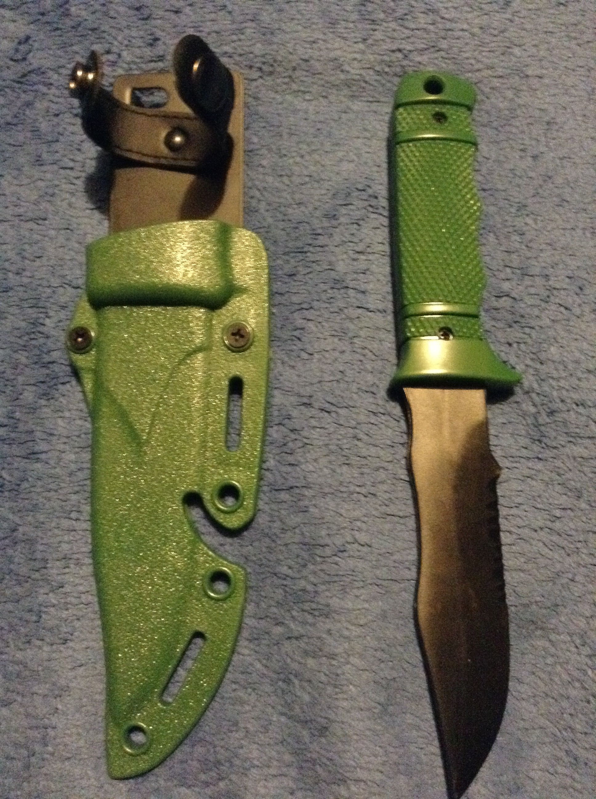

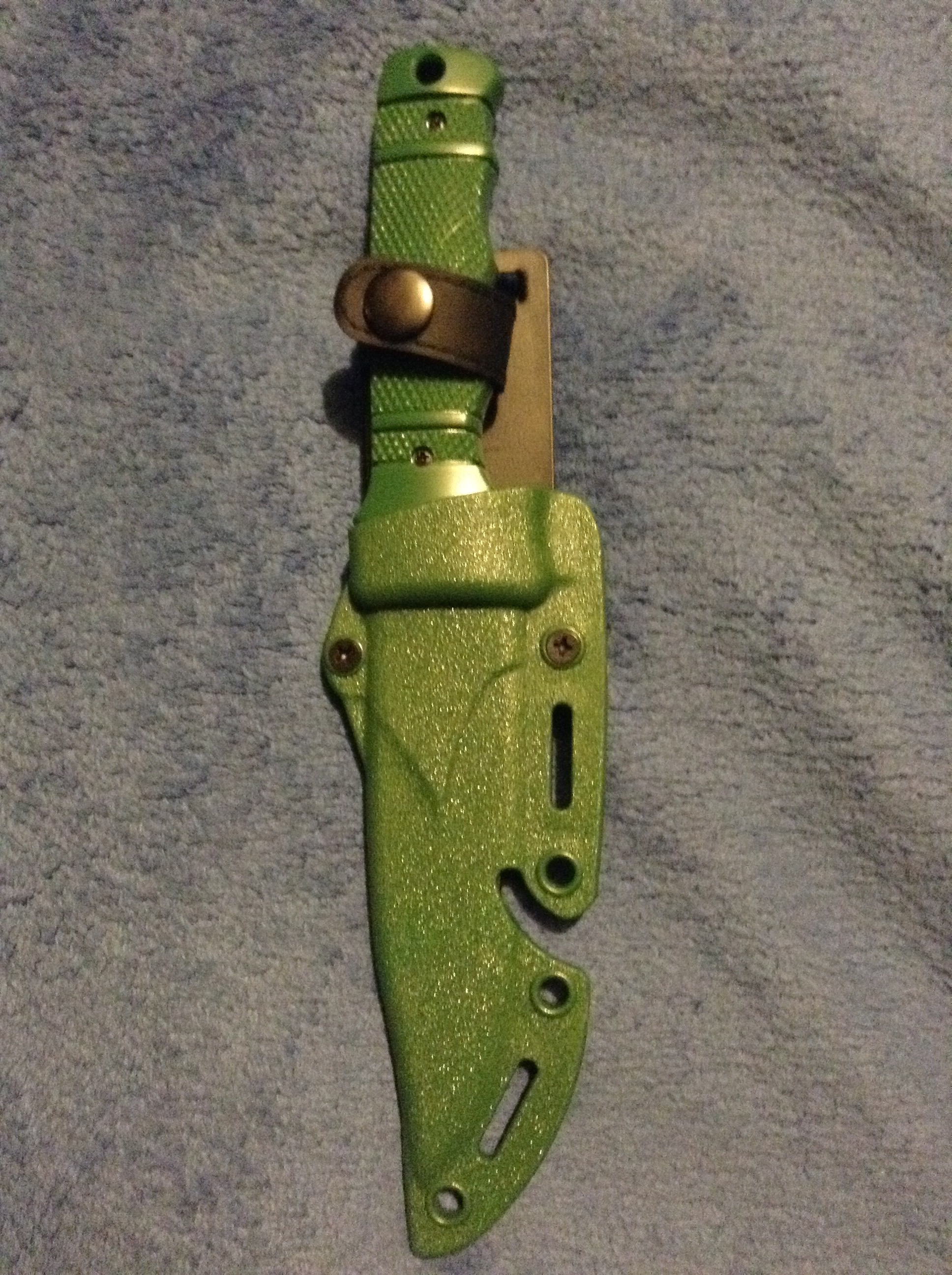

[mini] Update #17: K'NIFE! ;D

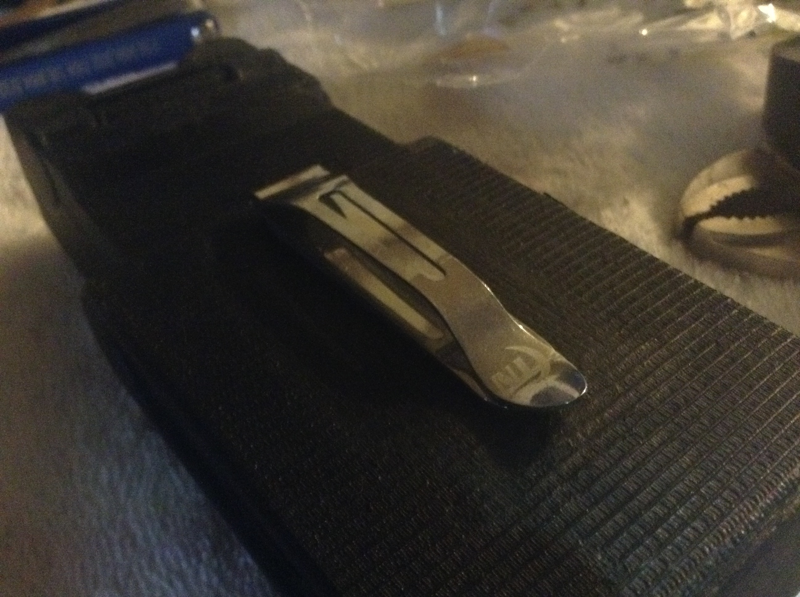

Not anything super important, but this little fella just came in and I felt like sharing the new addition with everyone.
Just a few select items to go, and I think the costume will be complete. If I can get it all together, I'll hopefully have some full shots to share from WonderCon.

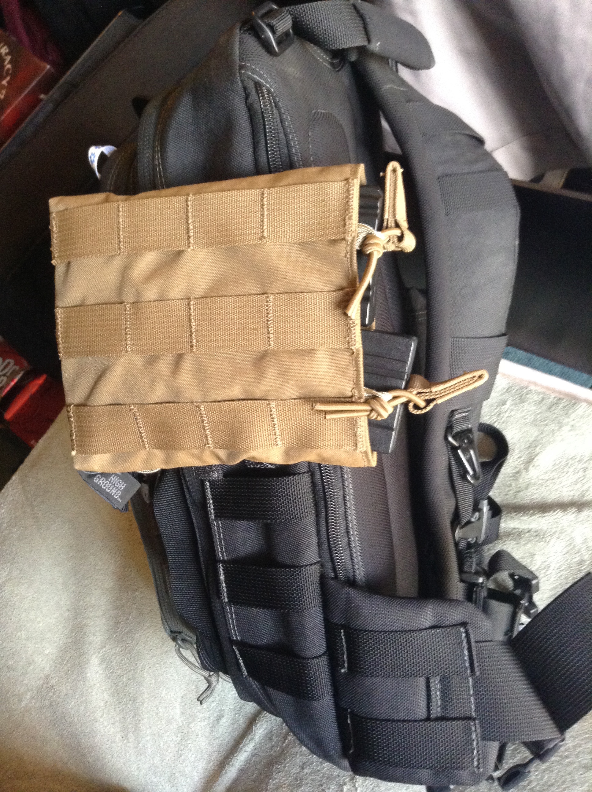

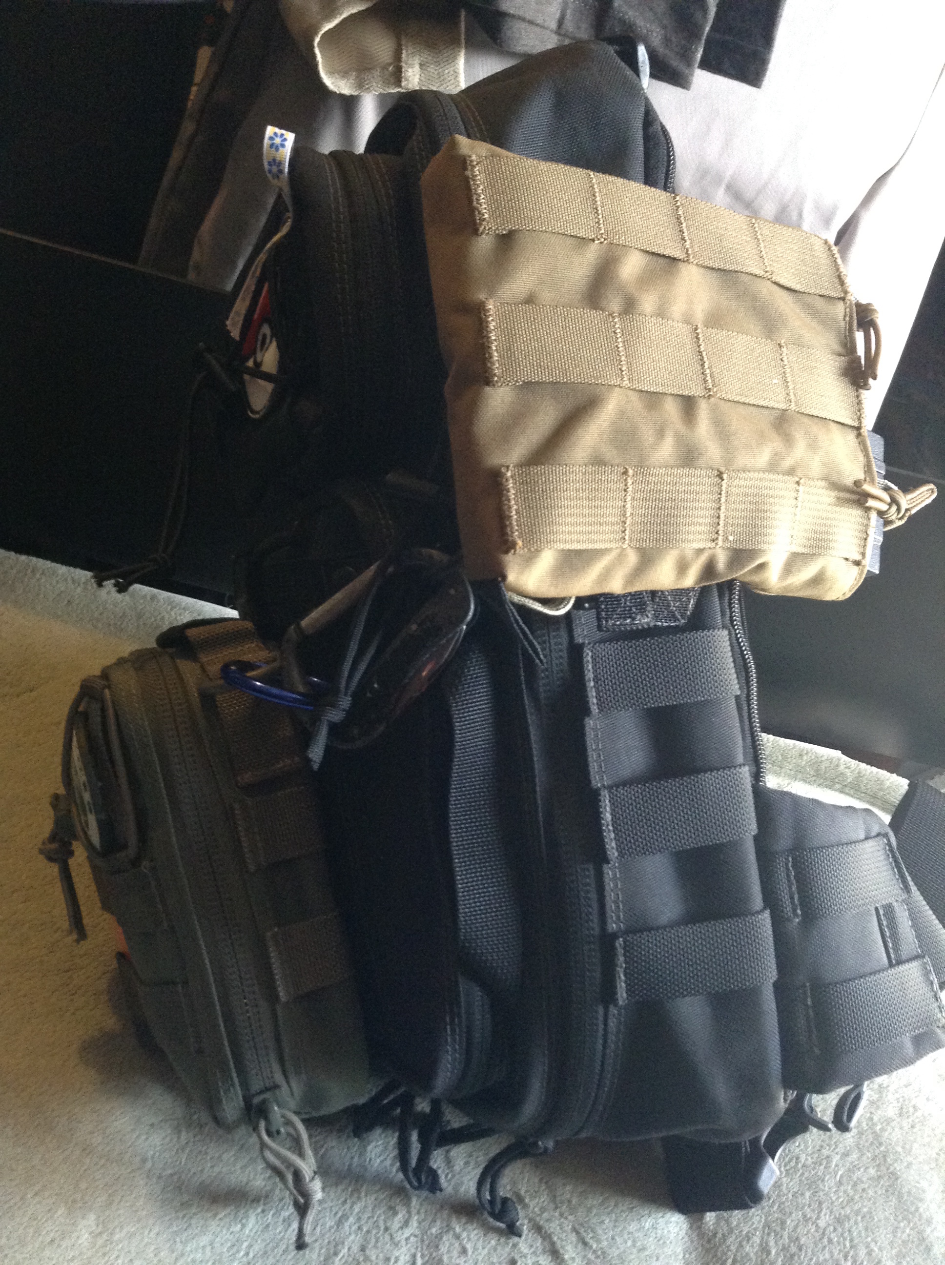

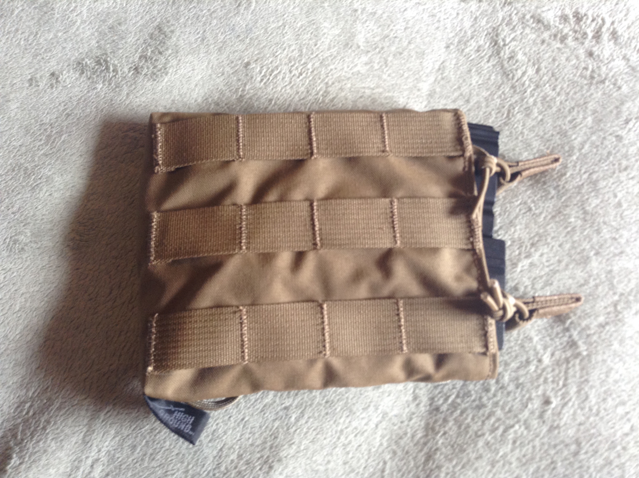

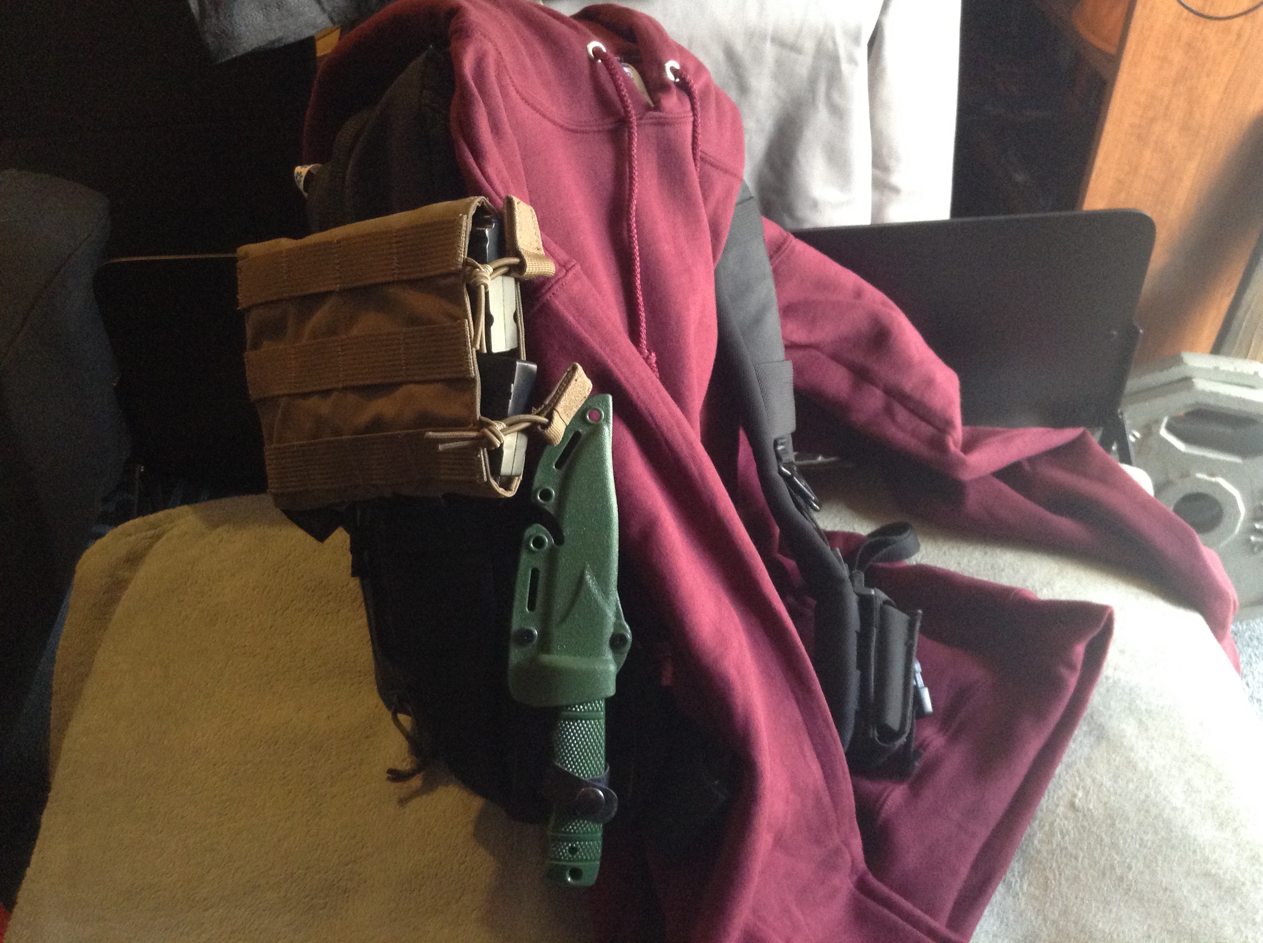

The first is that I got a double-mag pouch for M4 magazines; this one was a little tricky to find, as the place I wanted to mount it with the MOLLE weaving would require it to go on sideways. Thank you Google, for helping me track one down! ;D
Hangs a bit weird, given the size of it versus where on the gearsling it's mounted, but it does the trick.

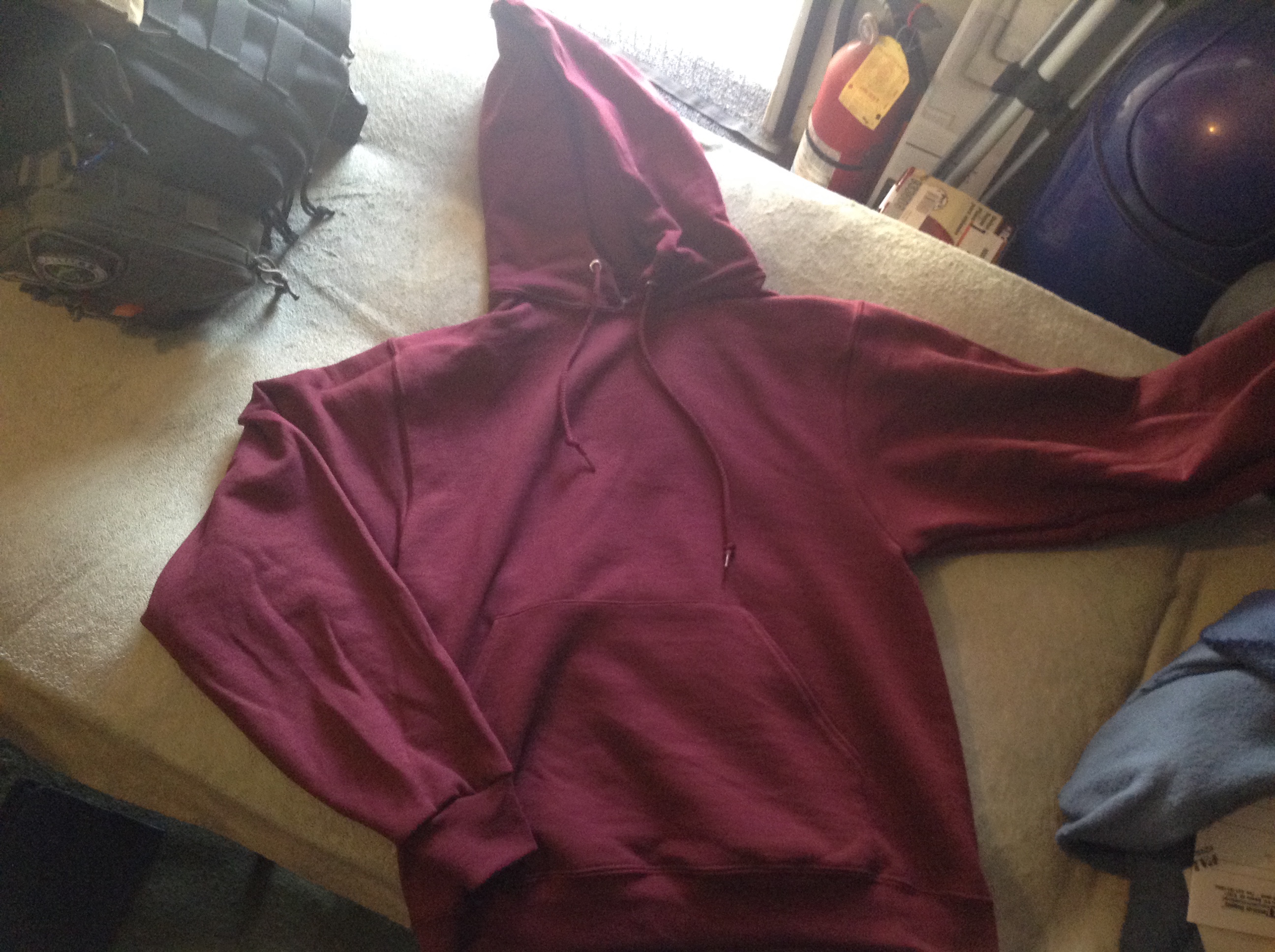

Also, I got in the hoodie. The original one in burgundy was no longer available, but I was able to get one in maroon. It's still a bit on the baggy side in terms of fitting, and I might darker the color some if I have the time/means.
Just for kicks, here's a shot of the hoodie placed with the gearsling (with the knife re-mounted).

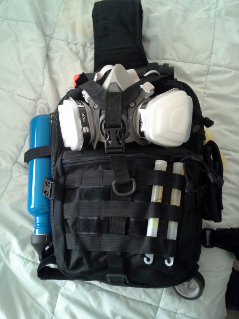

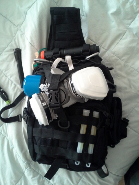

A few progress pics! This week I got my sling pack and a hat I had custom-made with the SHD logo! I ordered an airsoft gun and some other chotchkies for my pack, PLUS I emailed Antoine at Massive to inquire if they could export a model of the agent comms device that could be 3D printed by anyone wanting to cosplay. We'll see what happens!

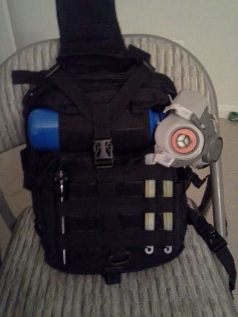

Here's the little sling pack. I put my water bottle horizontal, and it looks kind of cool that way. But I want to get one of two pouches for the pack to bulk it up a little more. I threw a mini-mag flashlight and some glowsticks in there for good measure, but I'll have a lot more chotchkies before I'm done.
Here's a pic of me from the front with my hat and pack. I mentioned before that I'm thinking about trying to holster the pistol somewhere not on the thigh, so I photoshopped a holster onto the sling pack strap to see how it would look. *Edit: I think it would look better to put a compass, a rubber knife in molle sheath, and one or two other little things on the chest here.*

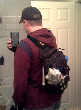

Here's some back views of the pack (photoshopped the comms device on there). Easier to see here the size of the pack. Found a bluetooth earpiece that I might use. I don't see agents wearing them, but their ears are usually covered by their caps. Mask with filters is on its way, too. :)

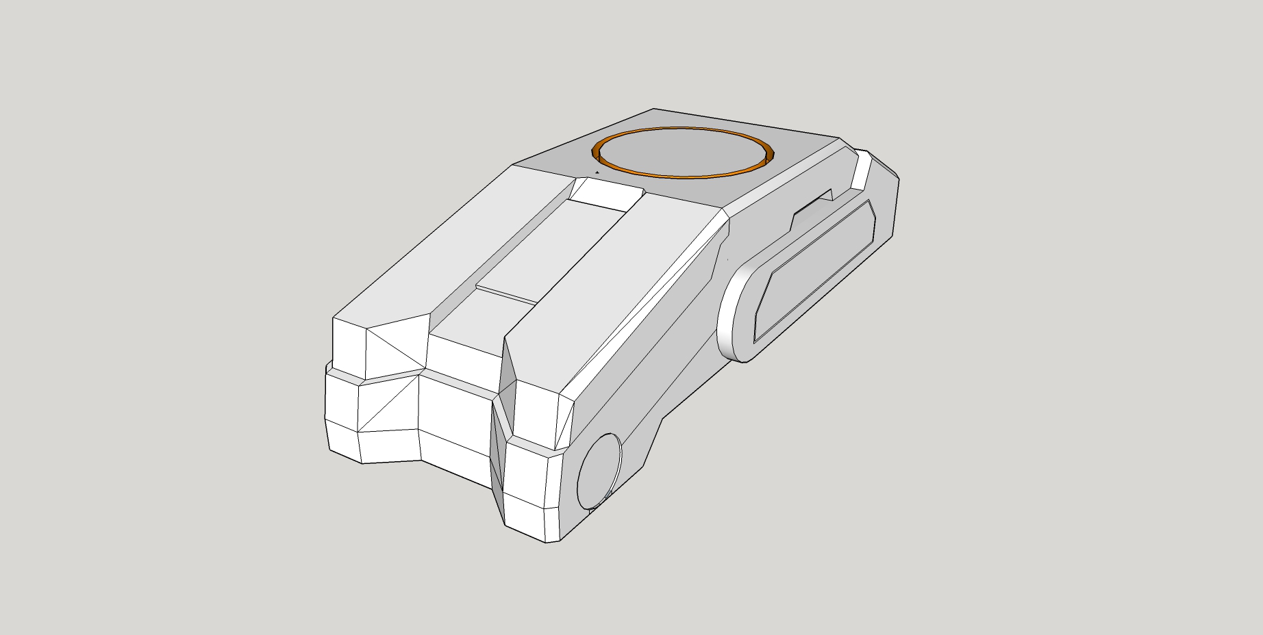

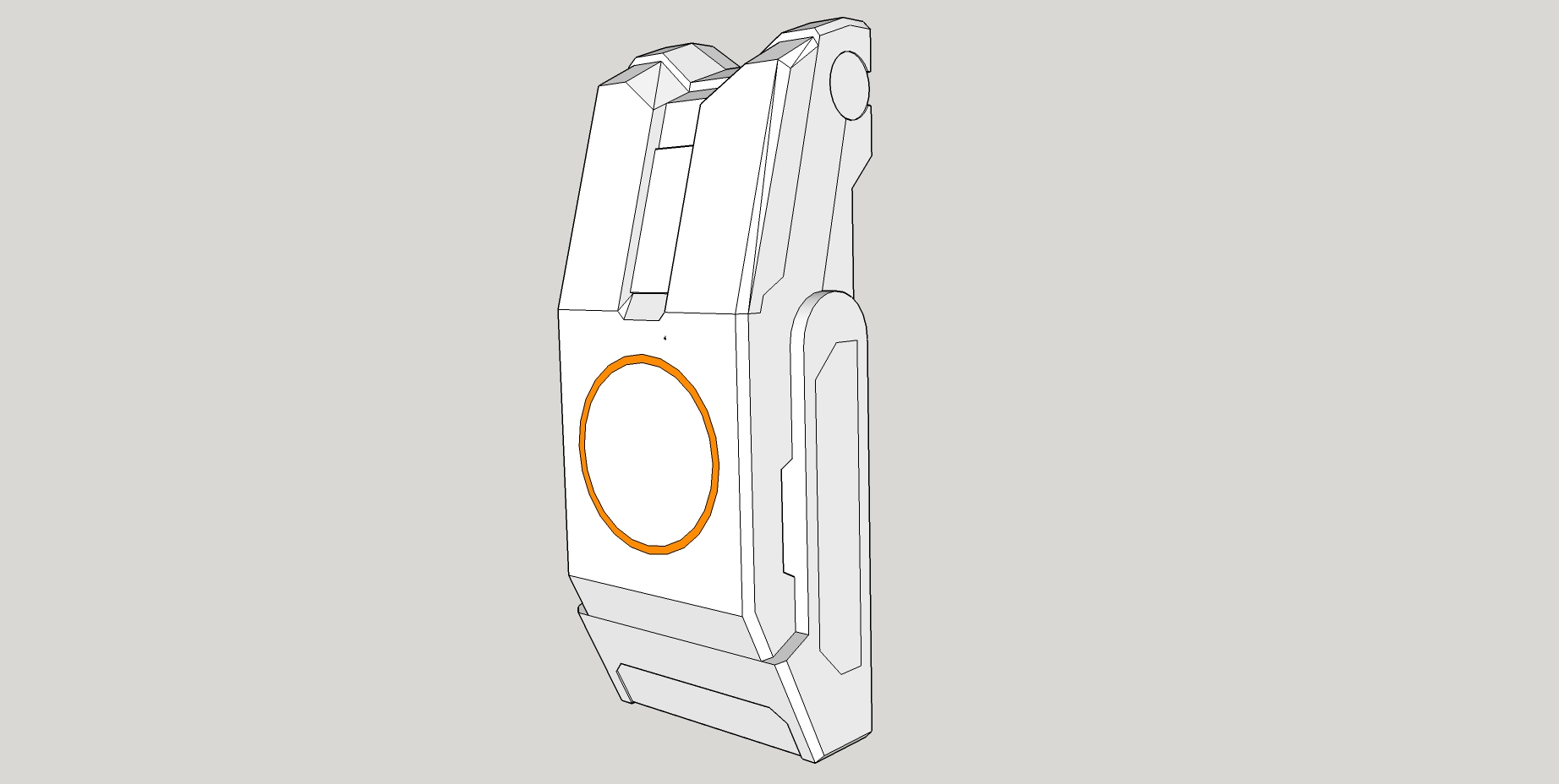

Working on a 3D model of the comms device in Sketchup. Not sure if I'm going to pepakura it or 3D print it somewhere, but its coming along nicely.

Got a mask, a gun, some caribiners and elastic velcro straps. A little detail I wanted to integrate: the roll of tape hanging off the back of the pack.

A note for others trying this build: my biggest frustration so far has actually been figuring out a good way to hang the mask on my bag. I had originally wanted to put my water bottle on my pack horizontally just because it looked cool, but the mask would NOT hang straight or securely off of the pack with it there. Check out the pics - once I put the water bottle on the side, the mask fits quite snugly under some straps built into the pack!

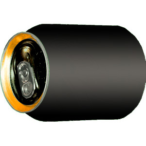

I am also going to try painting three of those half-sized soda cans black, with orange circles on the sides, so I can have some cheap "smart grenades" that will actually roll along the ground. With all this plus the orange tic tac baggies I mentioned earlier, I'll have a pretty nice build. :)

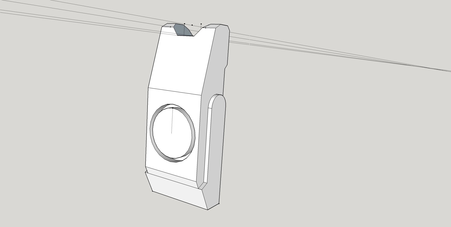

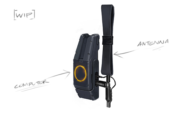

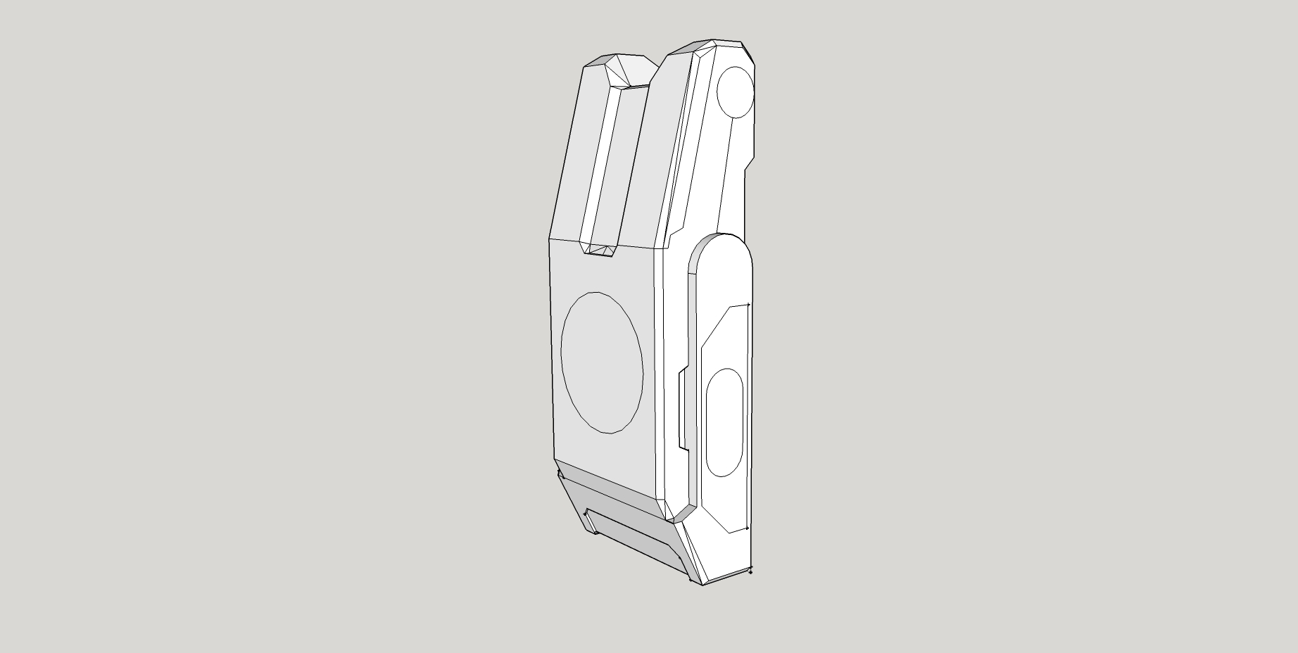

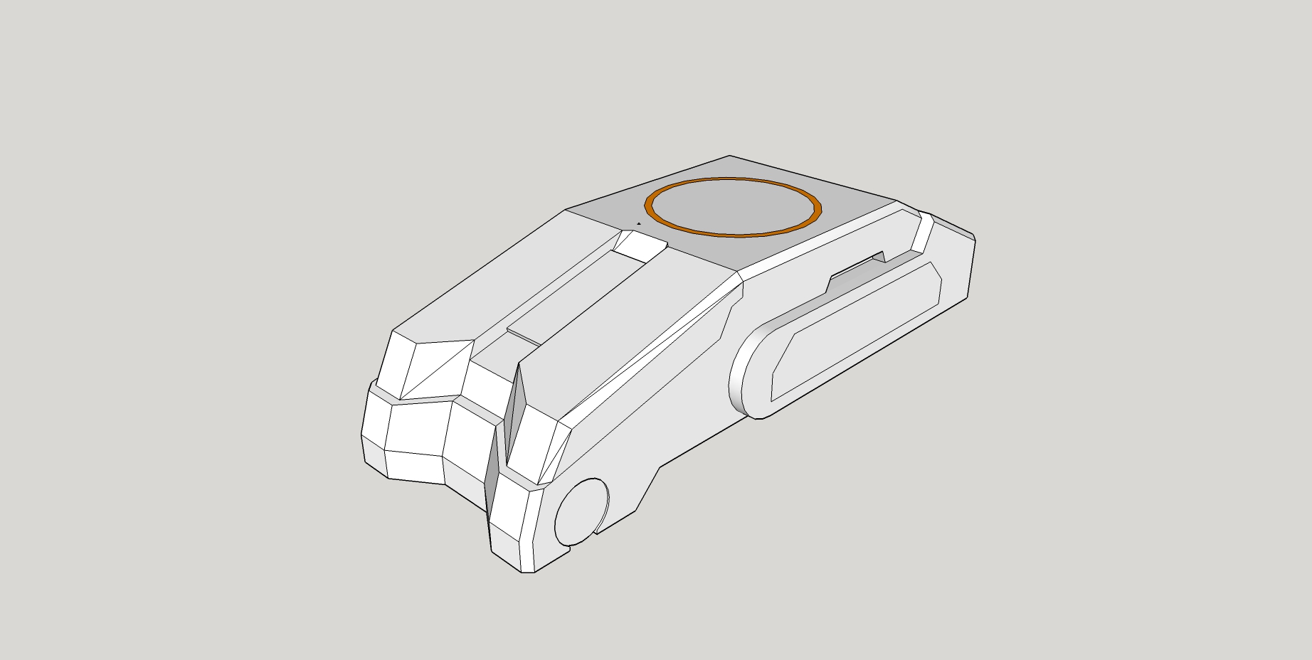

Almost done with designing the comms device, which I have taken to calling "the brick." This week I realized that the design I was building was a little too flat at 1 1/8", so I rebuilt it from scratch to be 1 1/2". It was just going to be too hard to stretch it upwards and reposition/redraw everything that was effected by that. I think the extra quarter of an inch makes a big difference. Just a few more chotchkies to add and I think its ready for 3D printing.
*EDIT* Added some pics here to show slight redesign. Realized I had tried to flatten/streamline the front end too much. I think it makes it look a little cooler than the actual design, but throws off the proportions too much; makes the front end look shorter than it is.
2013_Nov7_9_119194.jpg Here's the artist's rendition.
Brick5.jpgA good start, but too flat. Need to fatten him up.
Brickviewside.jpgNow an 1 1/2 inch thick. Proportions looking good, except the front end looks too short.
Brickviewfront.jpg3/4 view
Brick8dquart.jpgUnflattened and simplified the front end. Lengthens the look of it. I kind of want to pull the front end out 1/4 inch, but then the proportions on other sections are thrown off. DAMN YOU ARTIST RENDITION!
Brick8dquart2.jpg3/4 view
