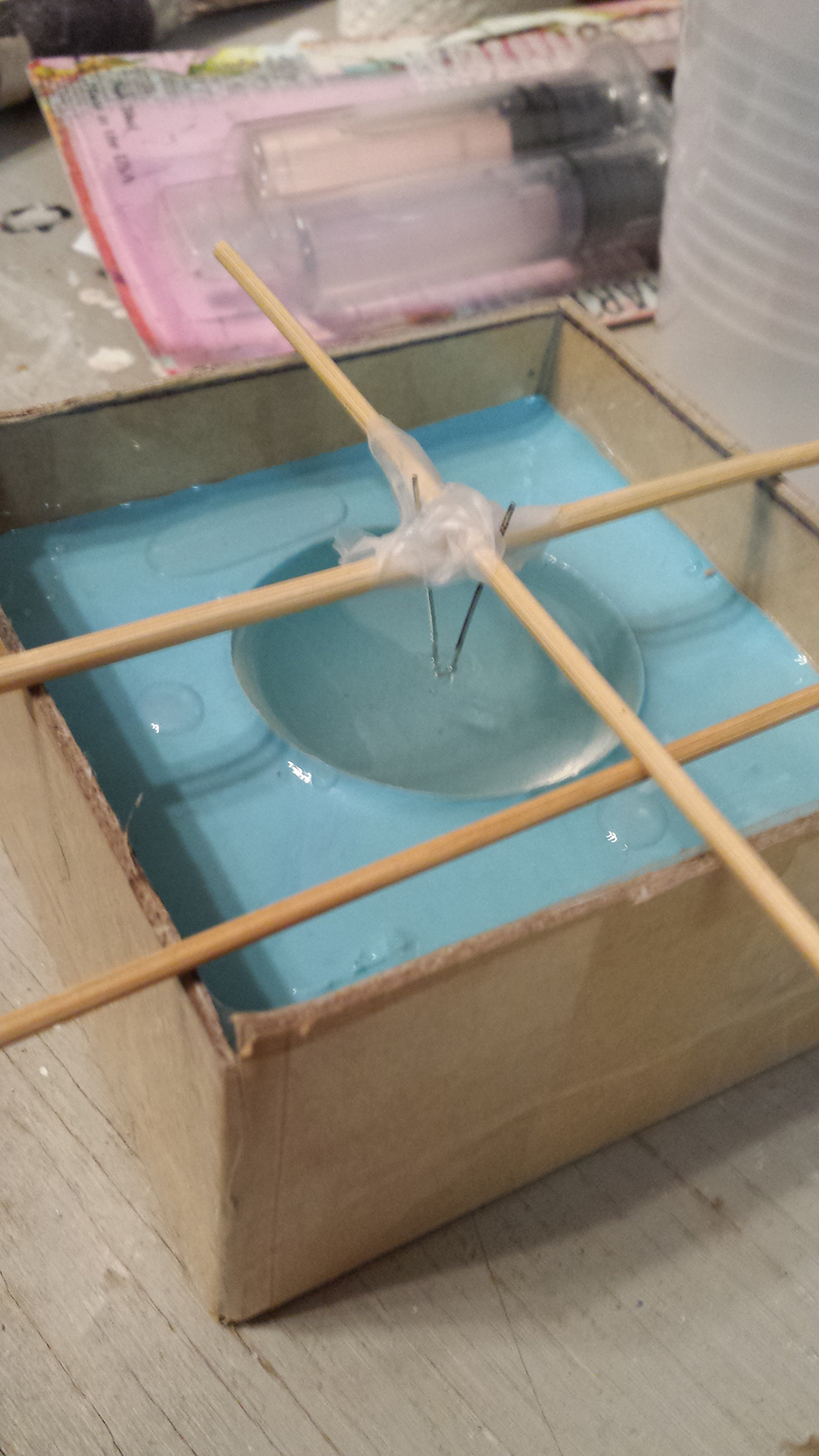

Then I worked on wiring the led that I wanted to cast in resin for the gem, and once I tested it I cast it in my mold.

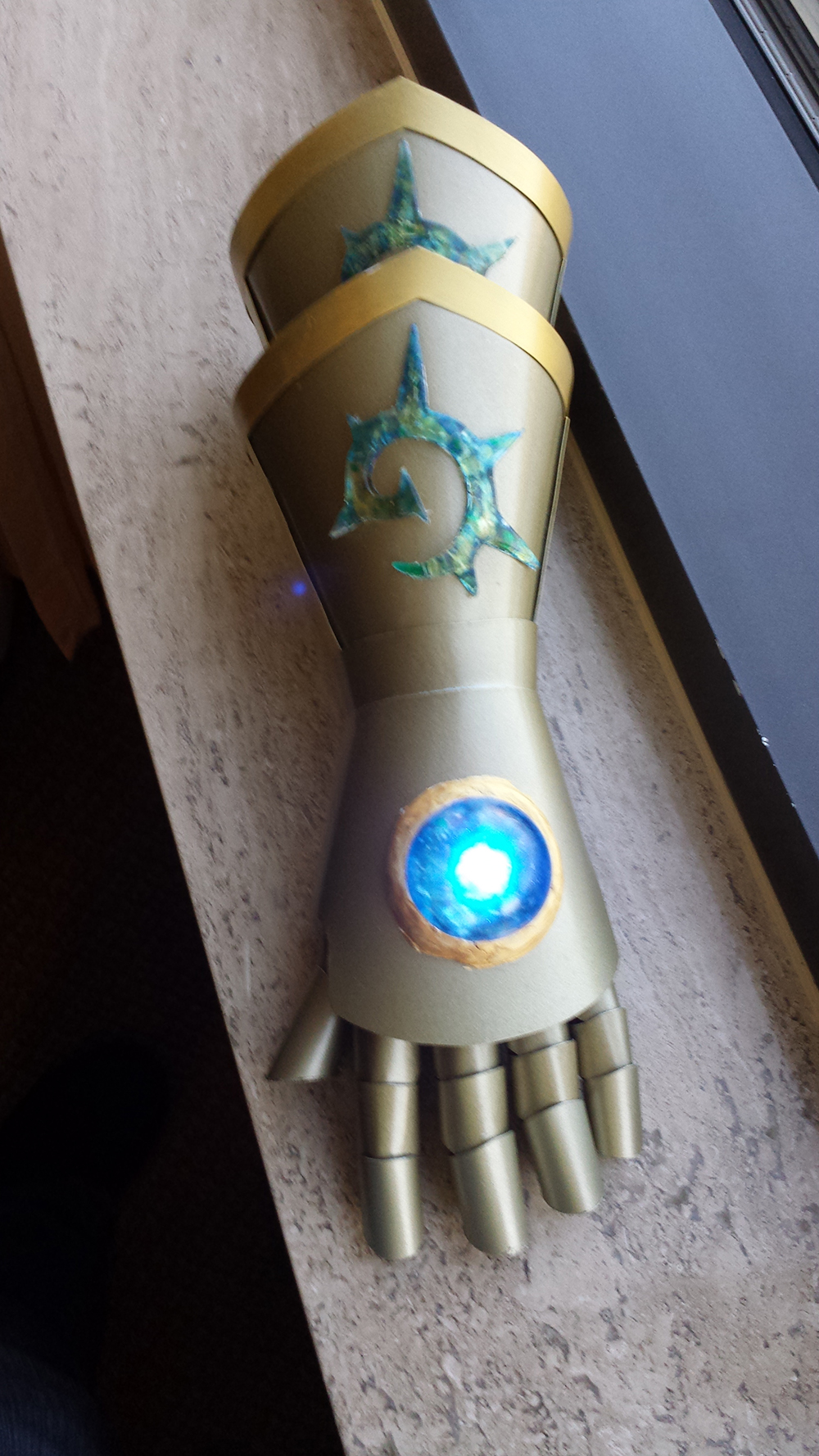

After that I had to build the rest of the armor out of thinner styrene.
All finished!

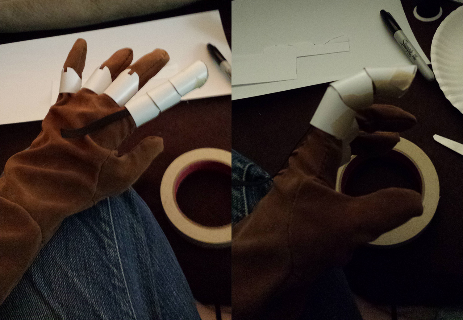

The next step was to make all the finger plates, I just taped them together to make sure they would work together.

Then I put the borders on the top pieces and glued everything together.
Painted the borders a lighter gold.
Then added weathering and finished!
Nice, thats a pretty successful first attempt I'd say, that resin cast gem with LED gives a good effect!

Aw thank you!! I'm glad it turned out ok, I was a little worried since it was a lot of new things in one go. I think I learned a lot!
