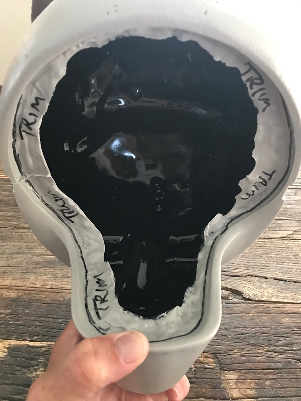

Right out of the box from Scotland

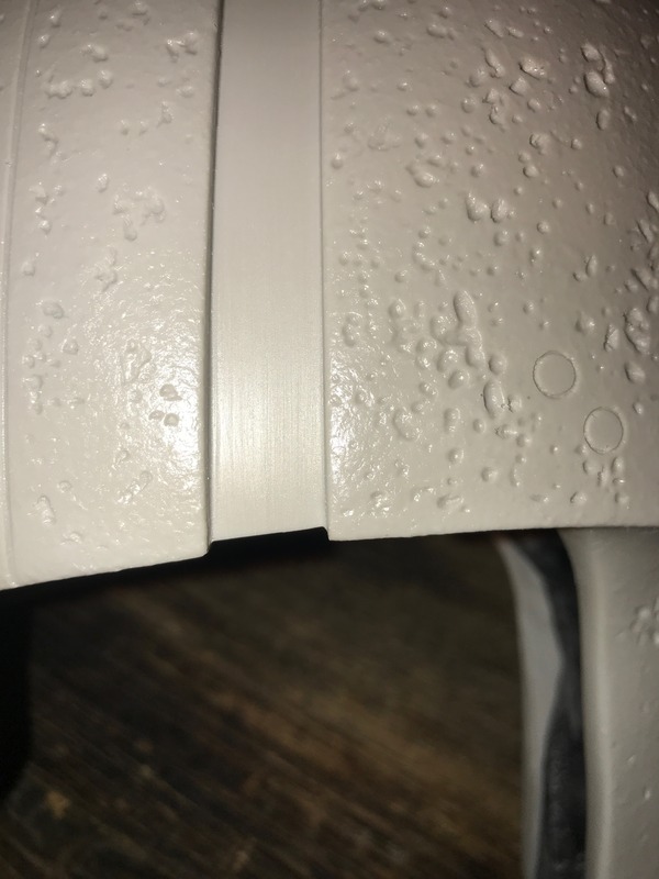

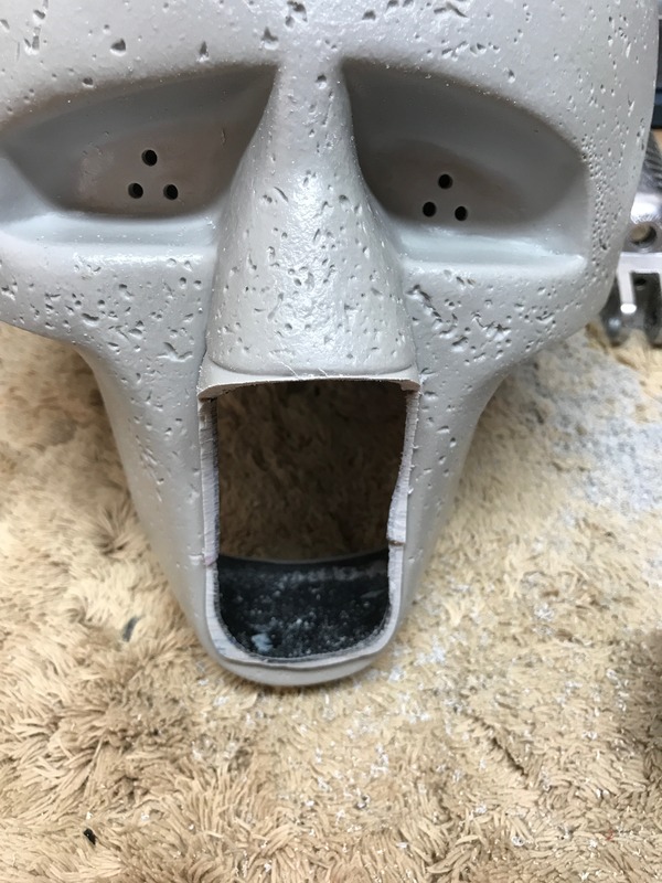

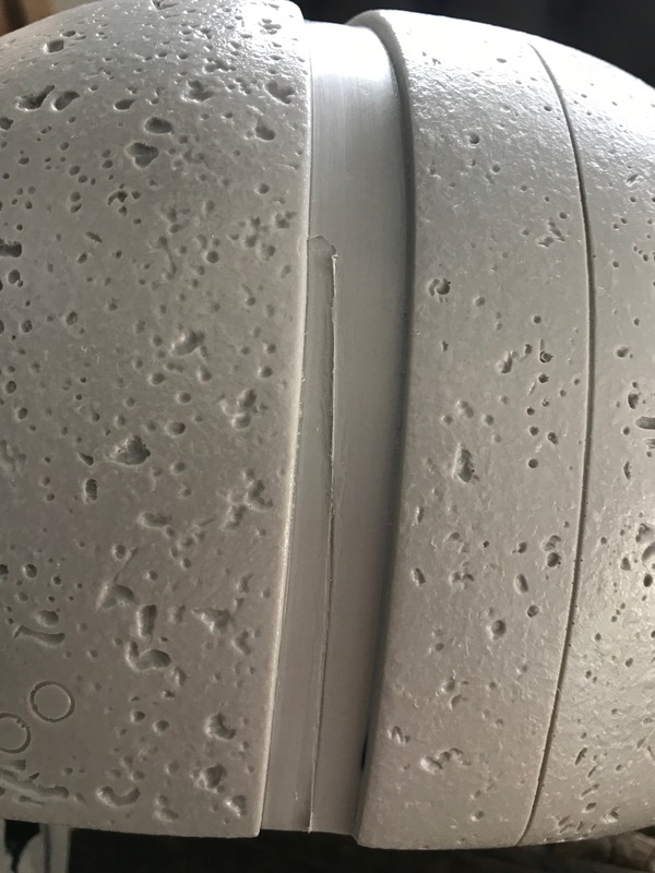

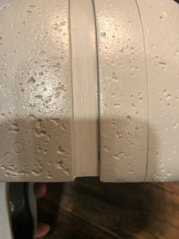

The only prep required - trim the mold joint & a little sanding at the Alice band
Finished this step

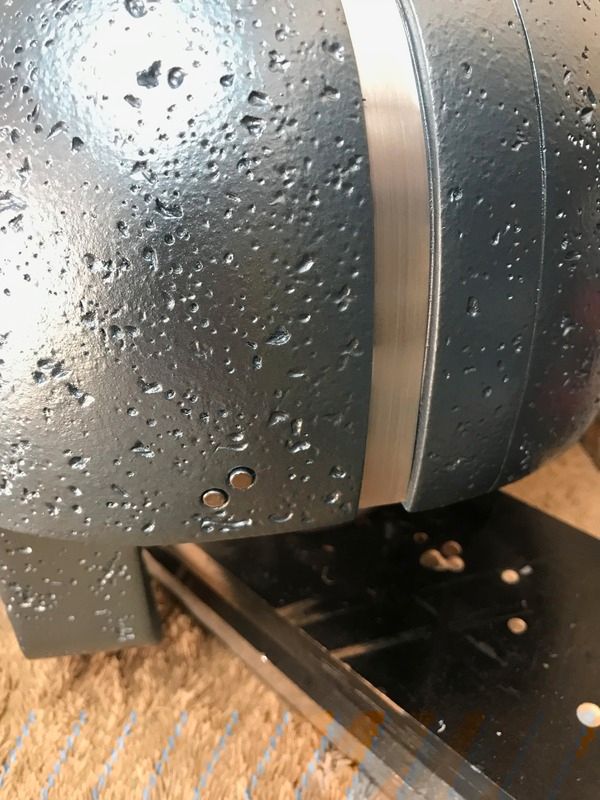

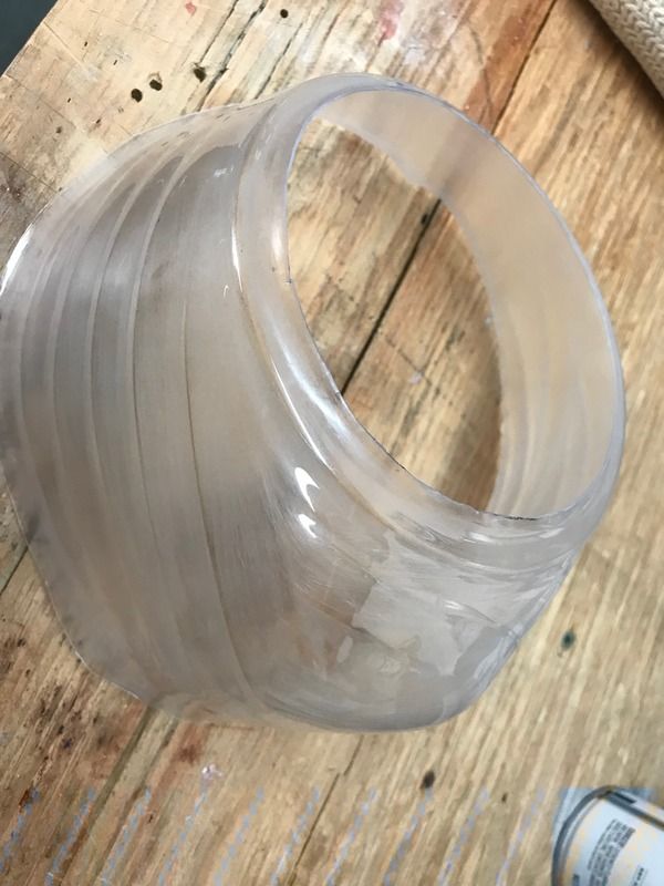

Made recess for the aluminum Alice band

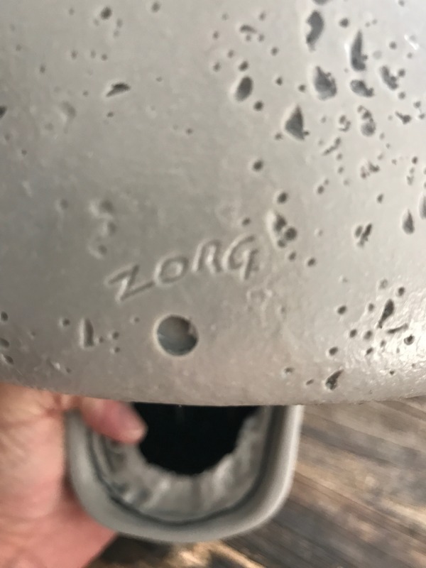

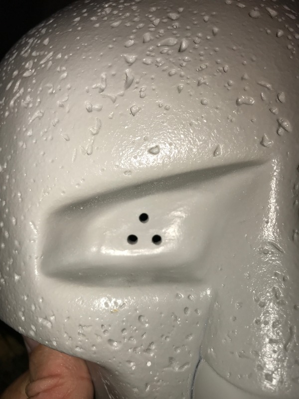

Drilled out the eye holes for the supplied LEDs
I love that Chris cast ZORG in the back of the head

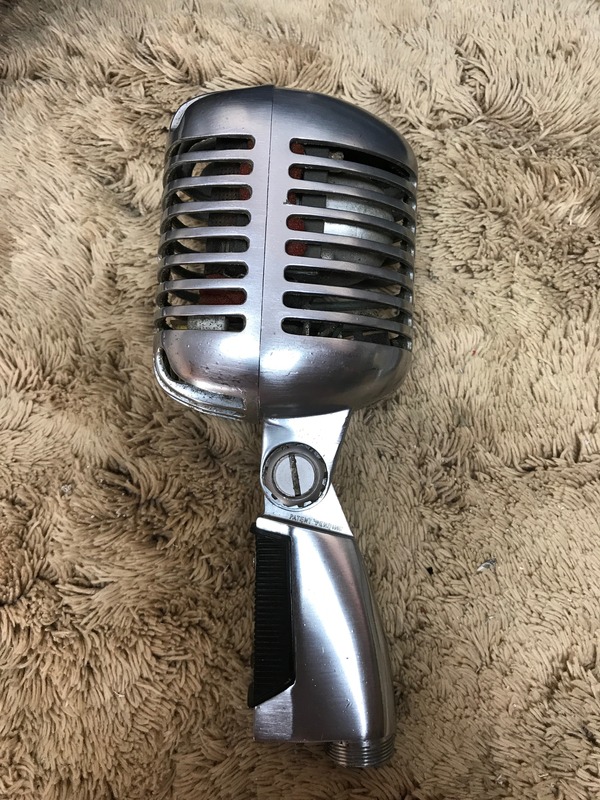

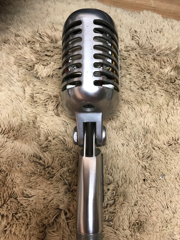

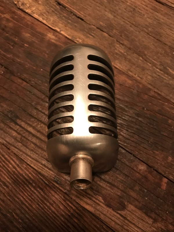

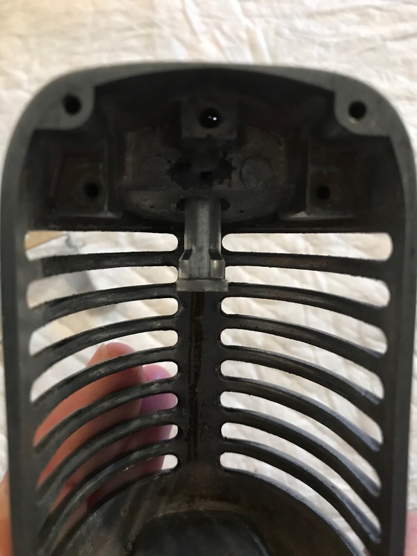

Vintage Shure 55SH microphone

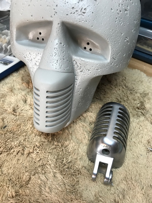

Cut off the cast Shure

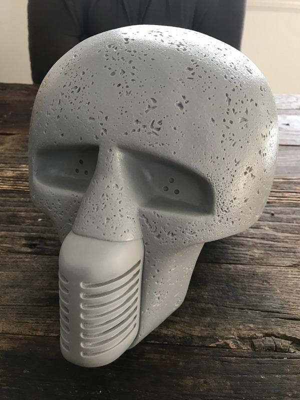

Fitted to the bridge of the nose

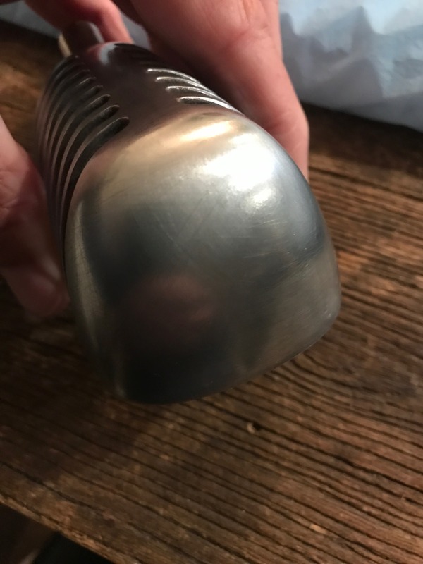

The Shure is electroplated with 2 layers of coating so trimming it was easy, but then you have to sand off the coating of the complete microphone if you want it to all have the same finish. If you don't then the copper and iridium finish are missing at the bracket area and it looks bad

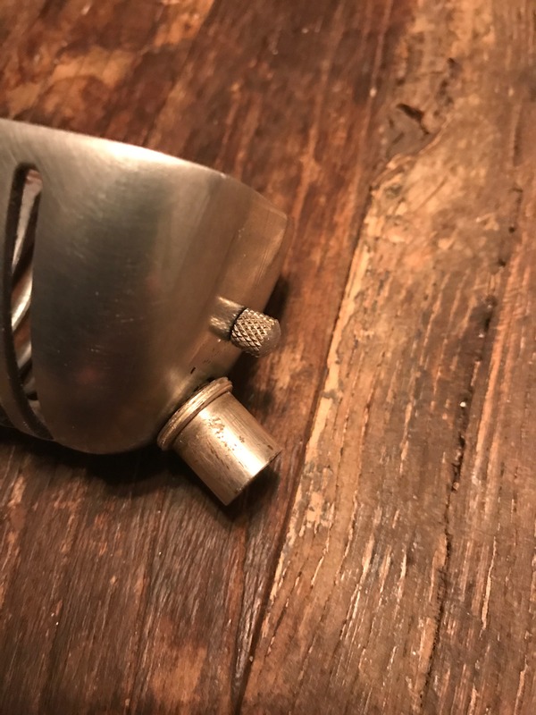

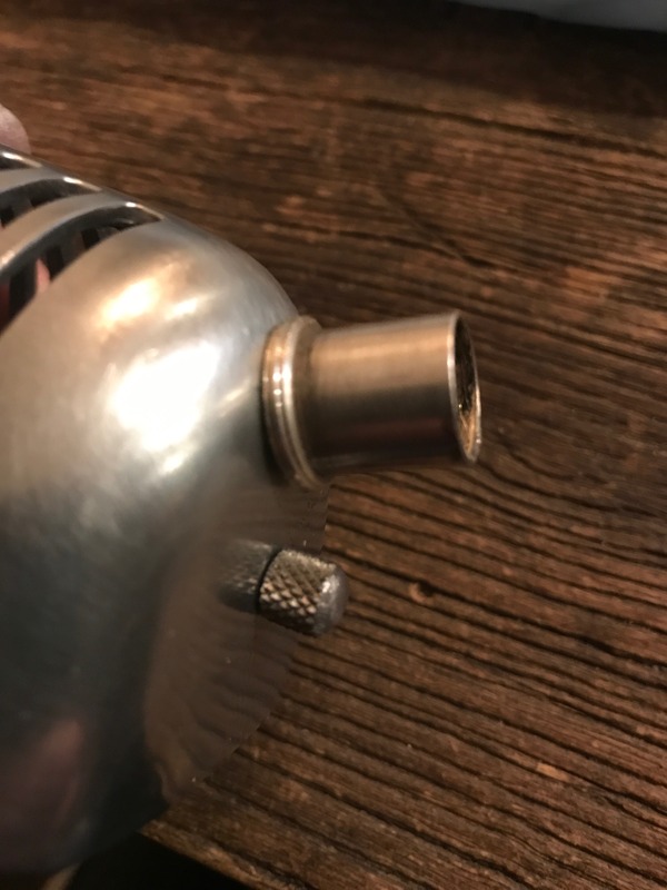

After shaping and the ridiculous sanding efforts to remove the plating. I picked up a vintage aluminum PL-259 connector for the hose and found a knurled thumb screw on eBay that I had to cut down and shape the rounded end

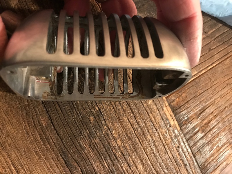

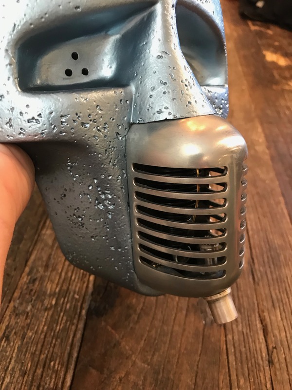

I milled the back lip so the Shure will sit nice and flush on the mouth

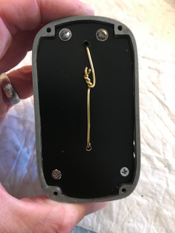

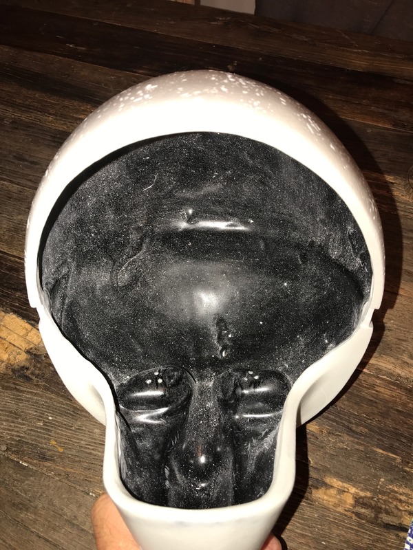

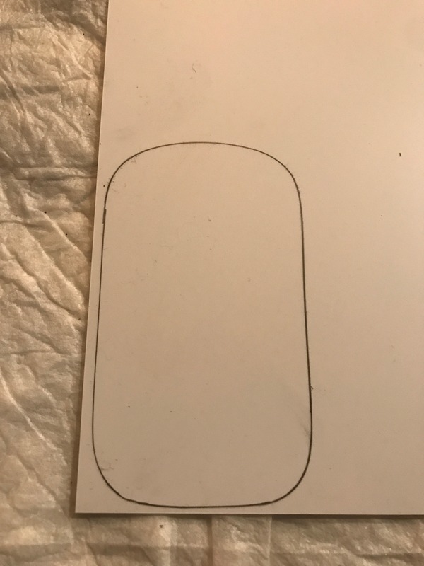

Made a styrene back for inside the Shure to hold the inner details
Not bad for a few hours of work!

Woah!! A real Sure mic! Can't decide if I should be happy or sad to see that. Nice piece!!
Nice, thanks for posting this. On the mic, did you repaint it after sanding it down? The bottom looks way too smooth after the band saw.
No, in fact I stripped all the finish off of the mic. It’s just good old aluminum. The casting on these old mics is very smooth and I just made the end I cut off the bracket to match the rest of the mic.

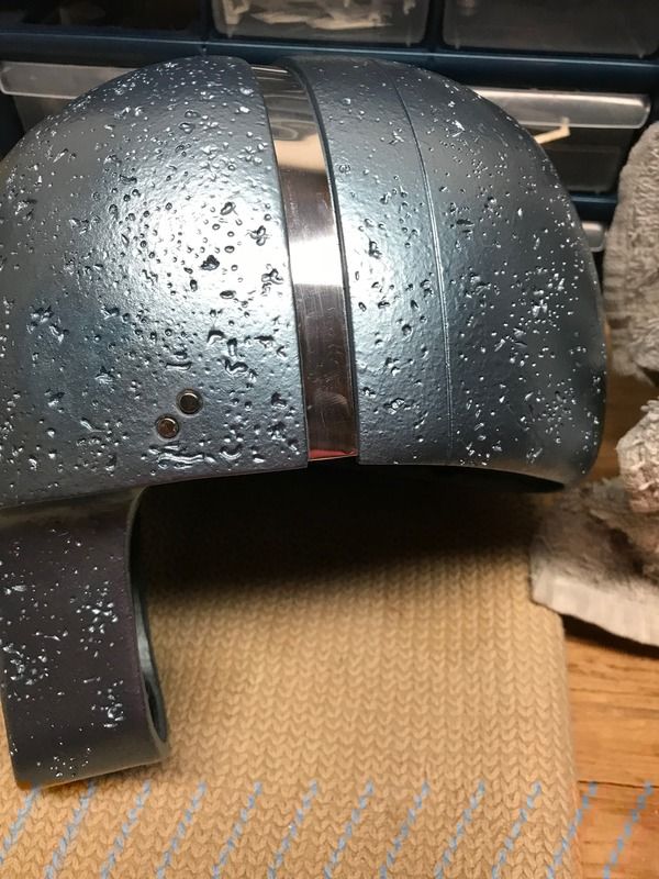

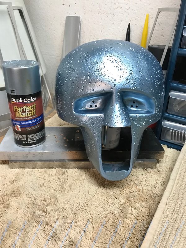

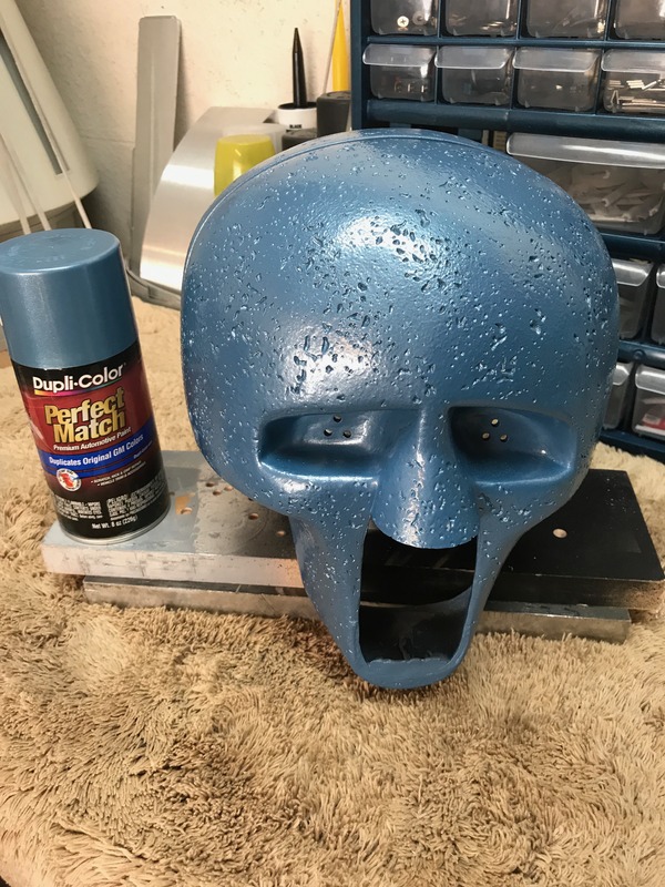

What color?
Avignonn Blue Metallic Duplicolor BHA0905
Tomorrow I’ll add the Alice band, magnets, side spikes, and then wash it with thinned down navy blue oil based paint to lightly get into the pitting and give some contrast and highlights.

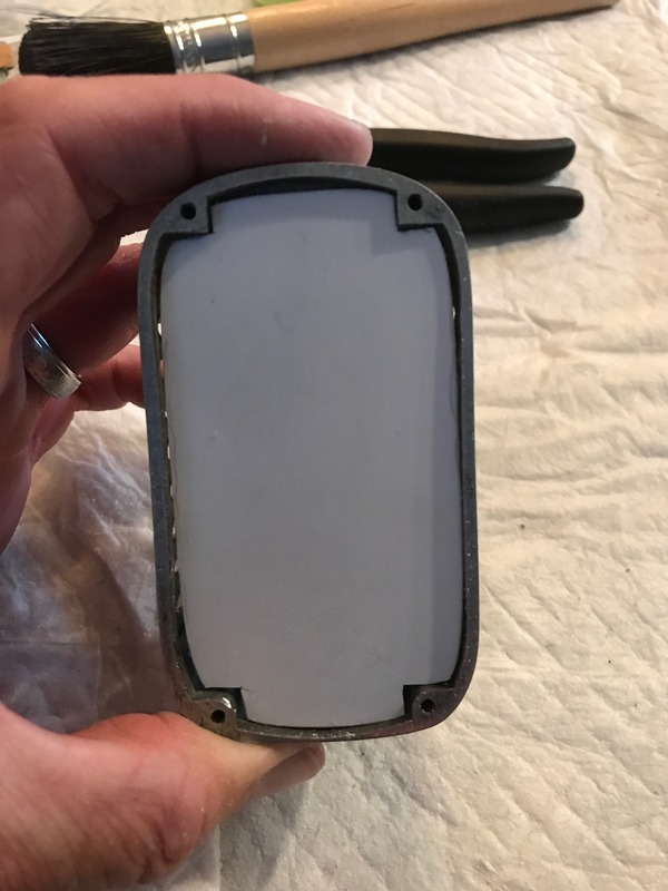

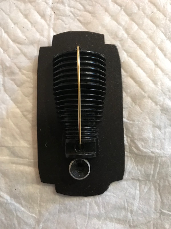

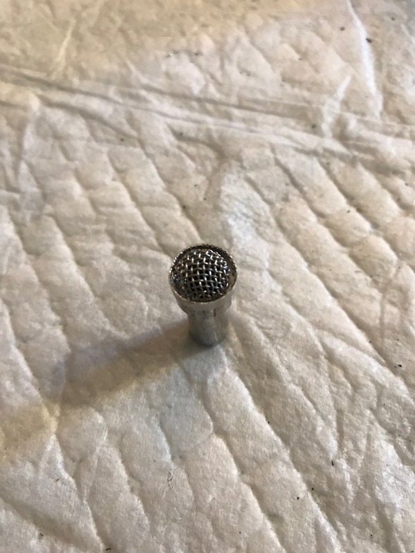

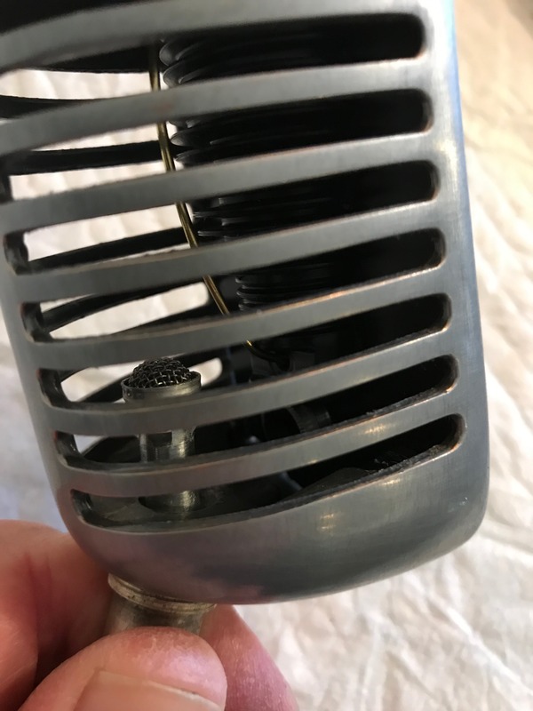

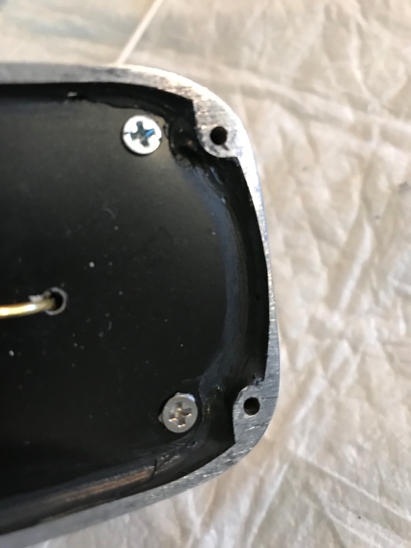

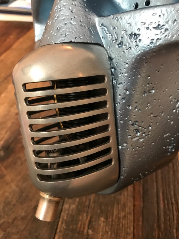

I have made a styrene panel for the mic internals, so I mounted it up at top with the Shure screws and the bottom had to spaced so it's level, then I caulked it with black so no light would show through from the eyes. I also added a part from a Kalimar 660 and used some stainless steel mesh to add some more detail - not screen accurate, but I like it!
Next some 5 minute epoxy at the chin and next to the bridge of the nose and done!
Caulked it in with black to hold it better and keep light from shining through
Next I'll do the dark wash and work on attaching the neck section!
