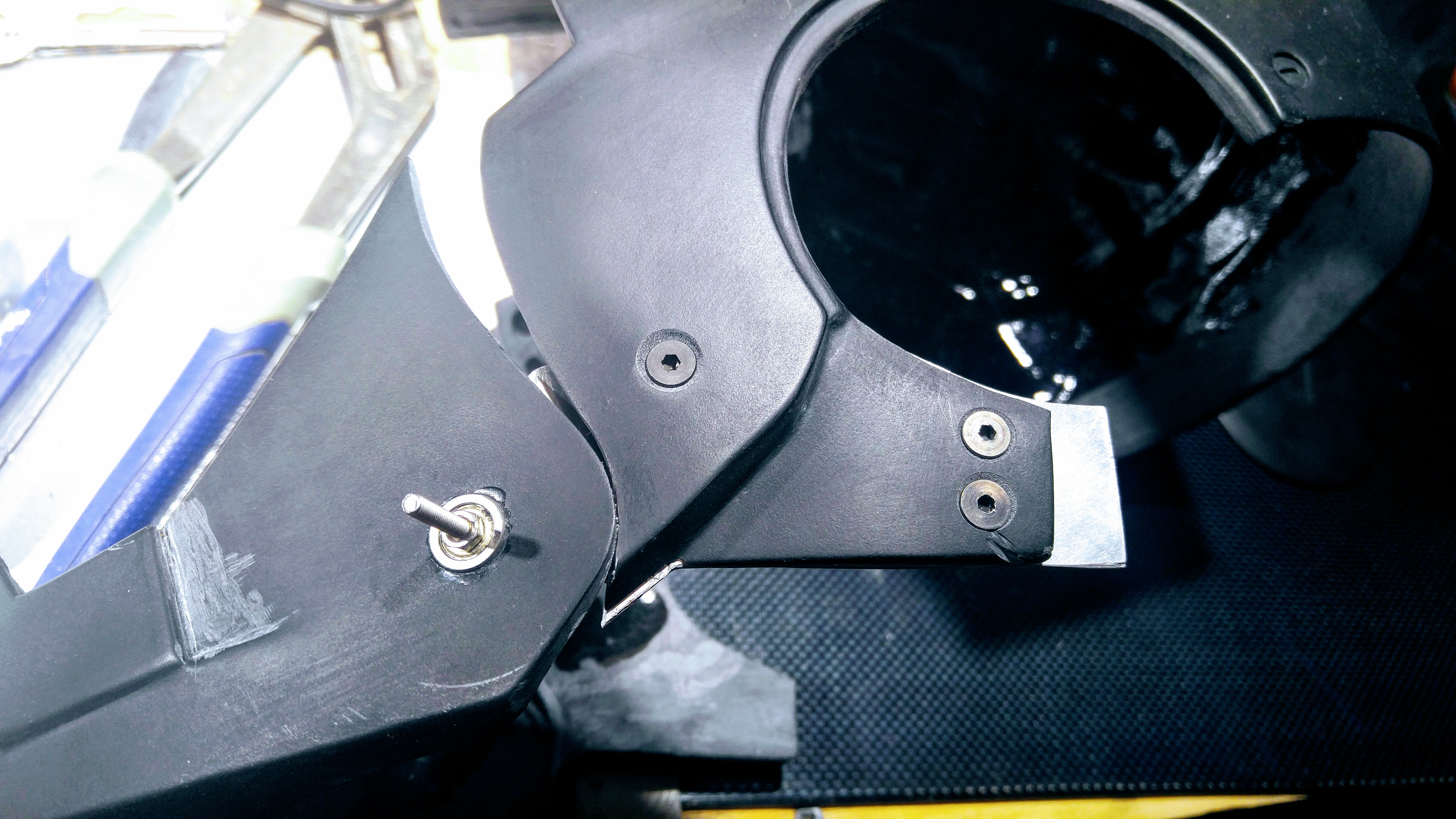

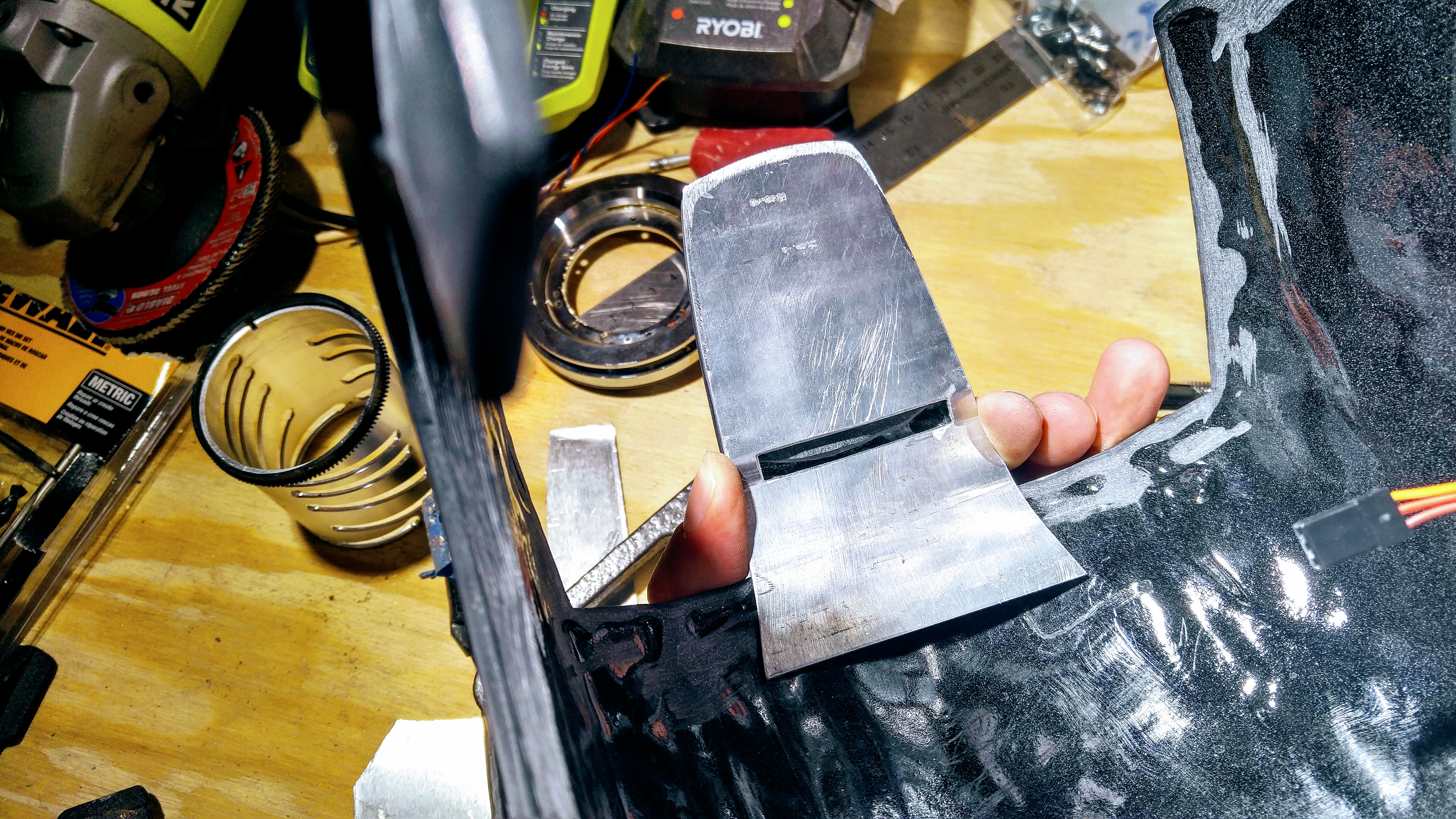

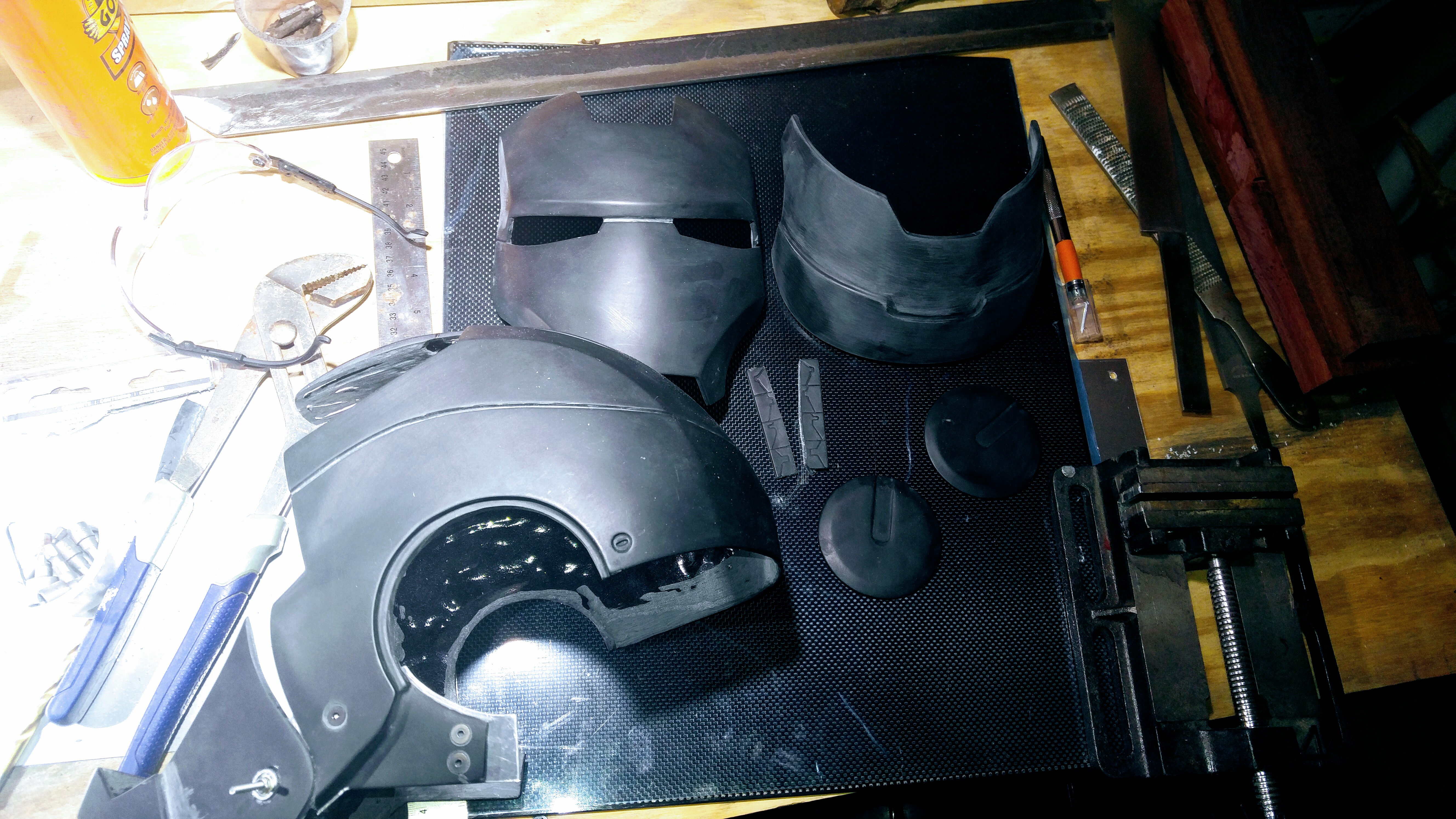

After about a million hrs of sanding and cutting this is where I am right now. The helmet is in about 9 pieces and joints started. The jaw joint is a ballbearing joint as a lot of joints will be. There is a plate on the other side where the screws are tapped too, making this thing super strong. More tomorrow but 4 now I'm getting some sleep.

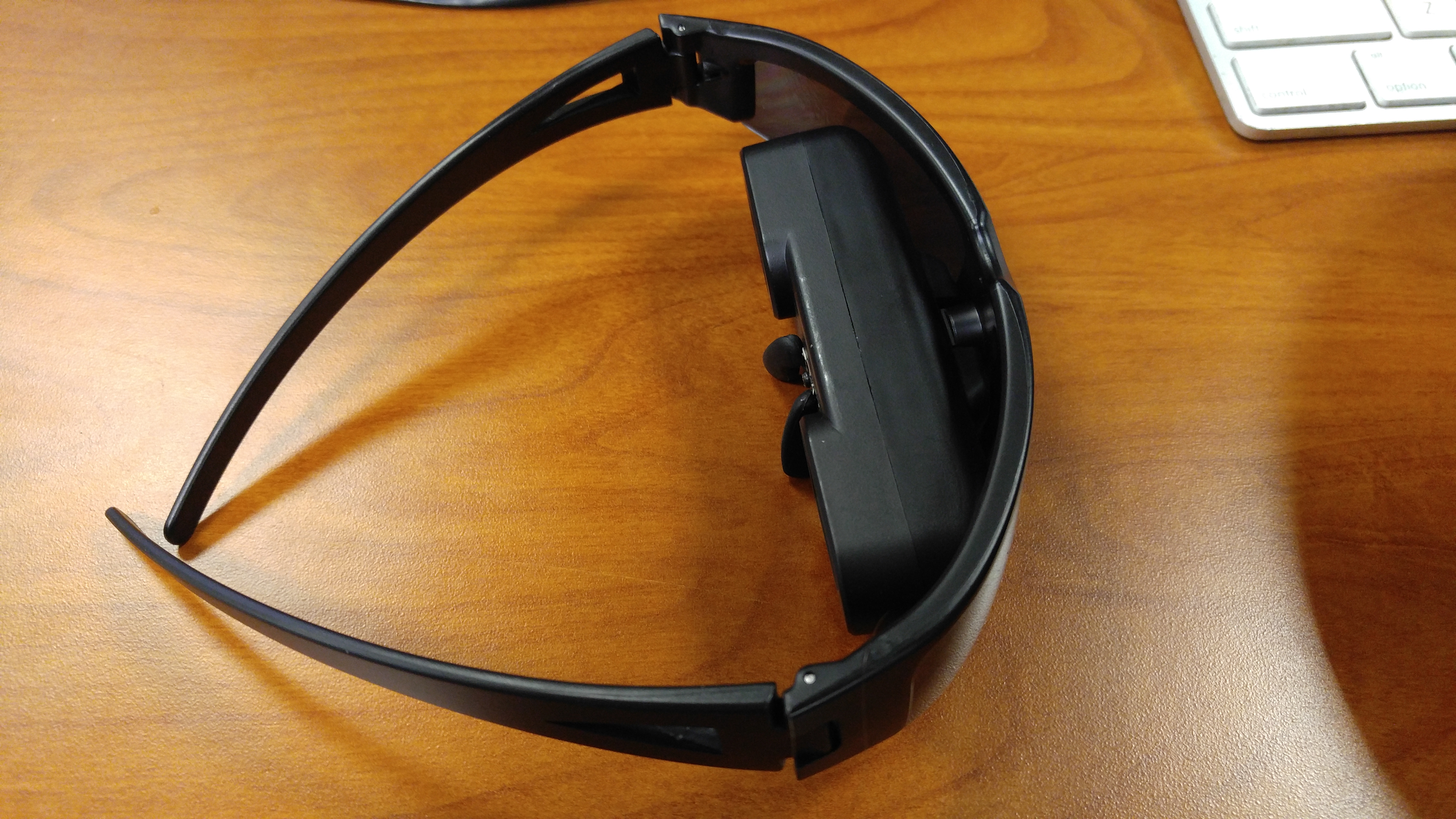

I'll have some cool updates this weekend but in the mean time my cheapy video glass came in. I'll use these with a camera mounted in or on the helmet to view everything. Then down the road I'll upgrade to a oled pair and 4k camera

There from zentronics and there were like 100$. The quality is not that great BUT it does serve the purpose I have for it and works great with analog cameras I plan on using.

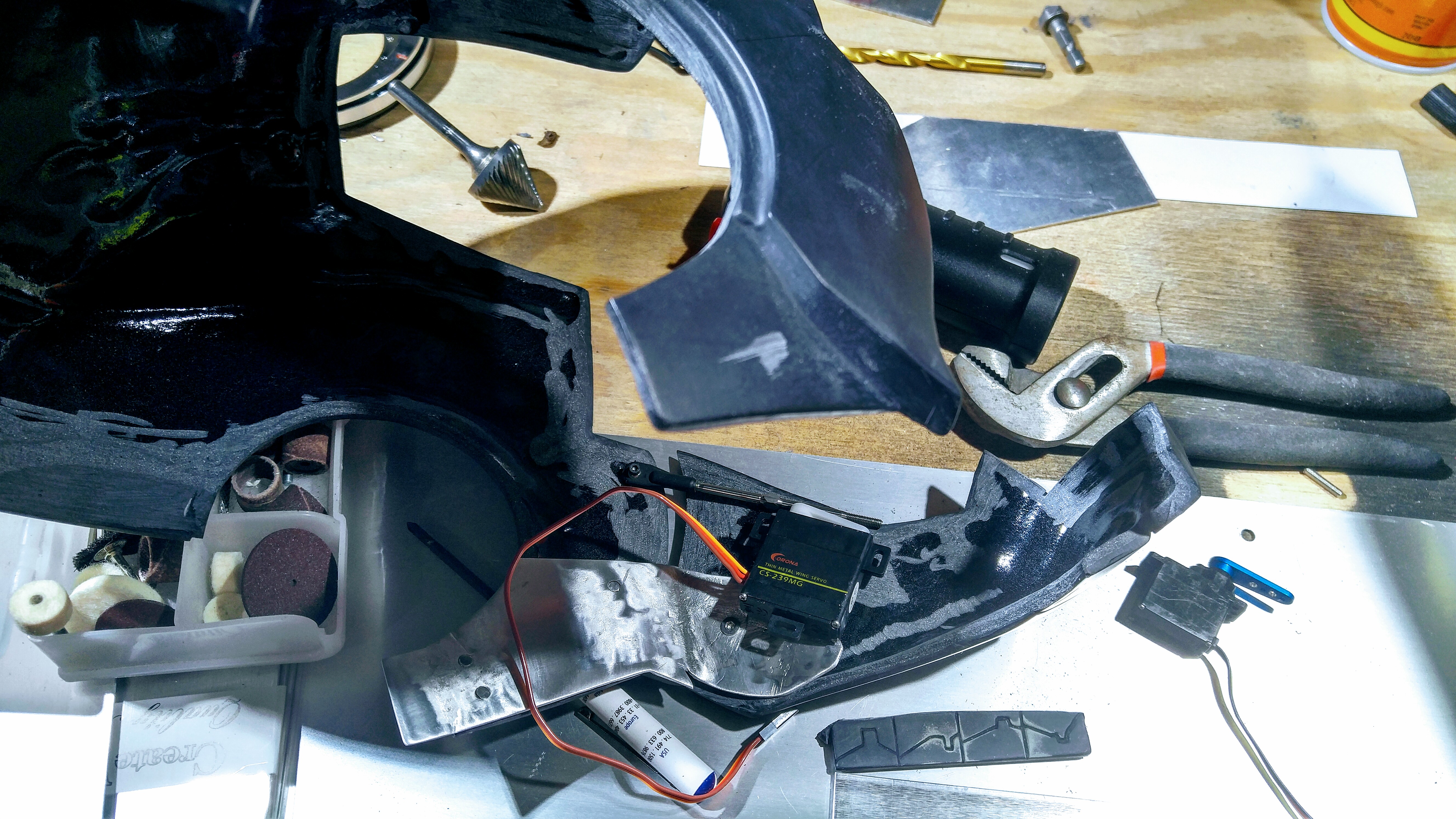

Been super busy and not getting as much time as I want on the suit, but I did split the jaw and started the servo placements. In thinking this weekend I'll get a lot done :)

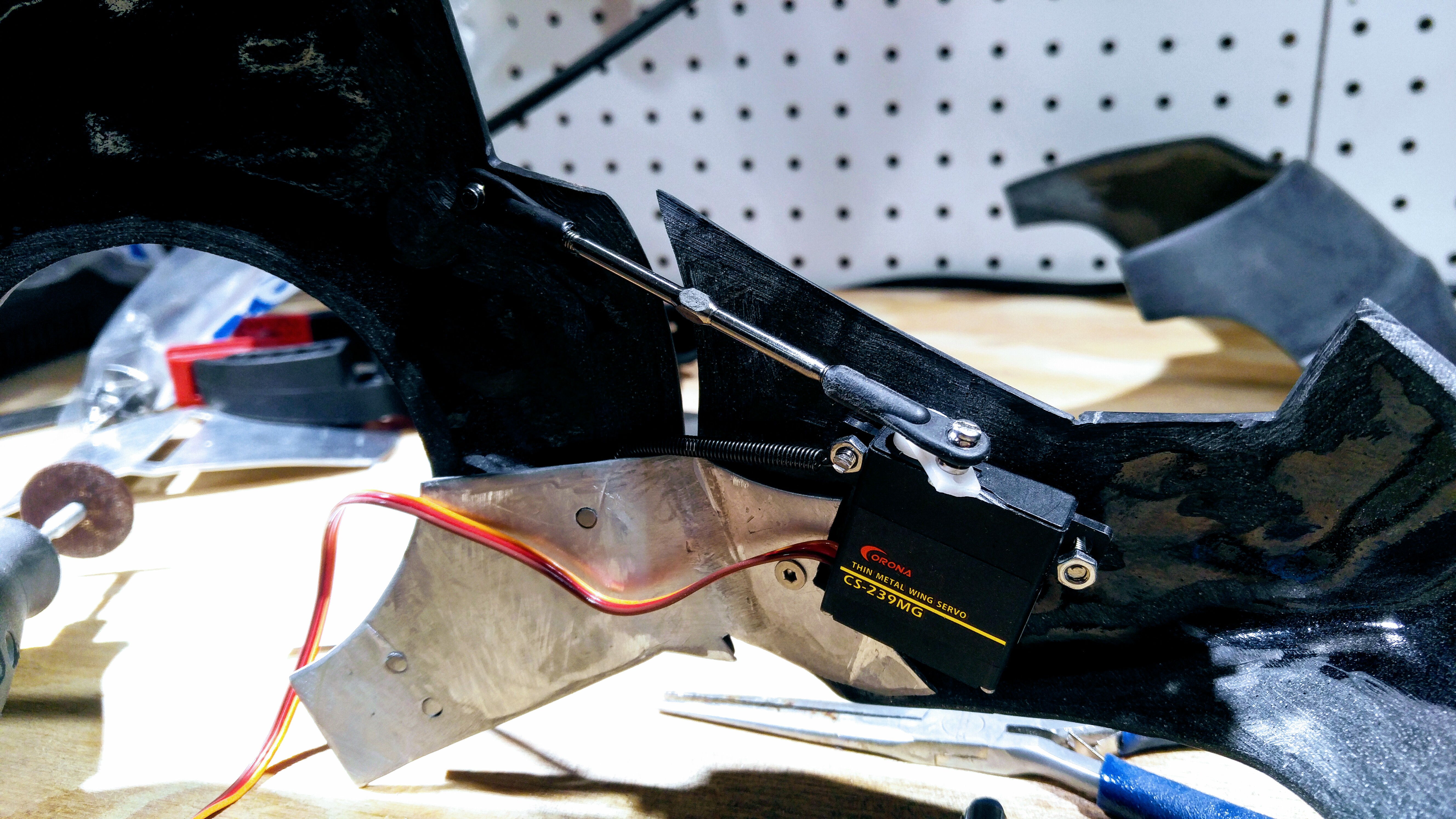

Started the top vent and servo support. There will be two micro 5v pc fans that will vent all the heat in the helmet up and out of this vent - Still need to finish opening it up and get the fan module done. so much to do :(

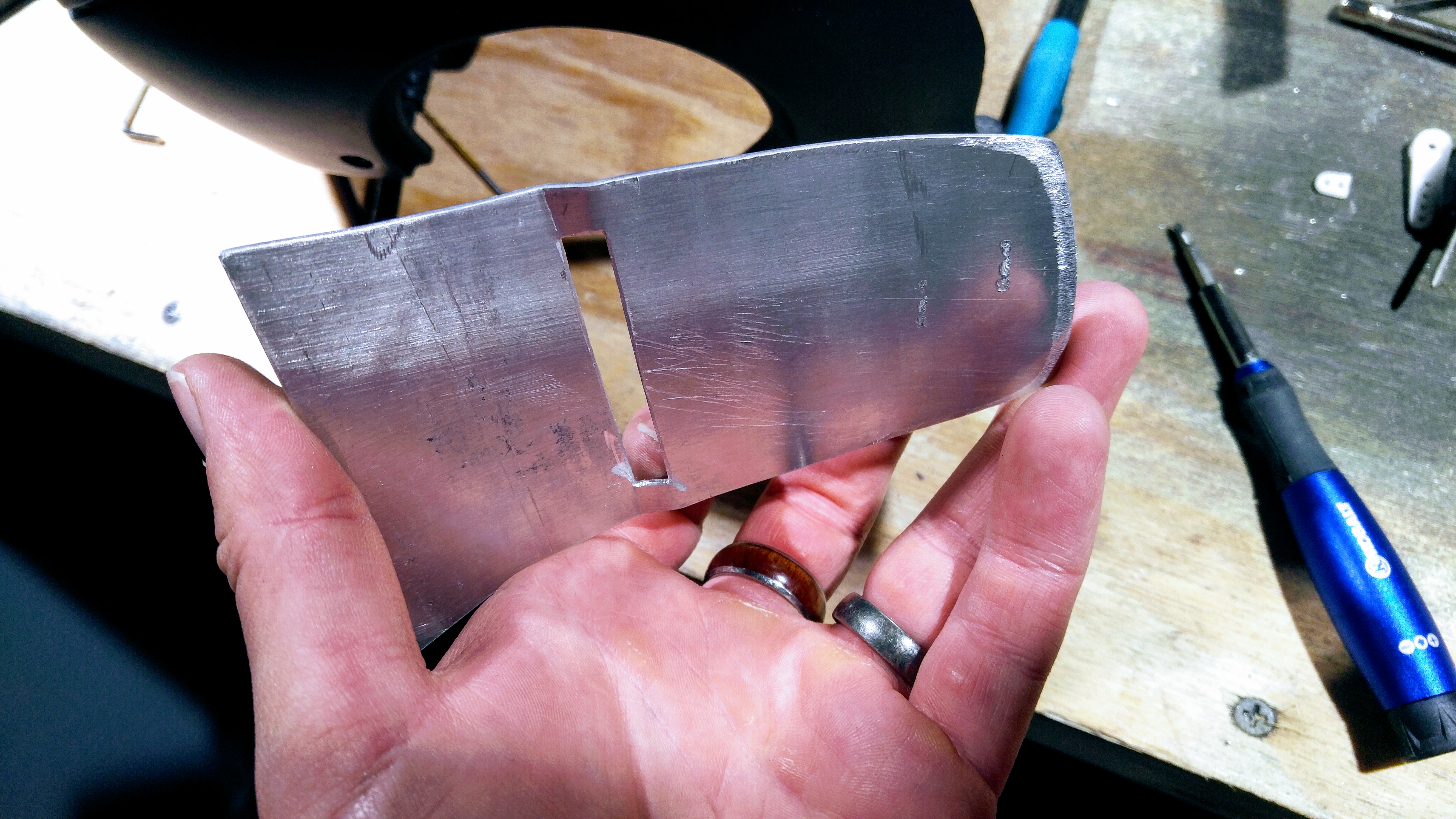

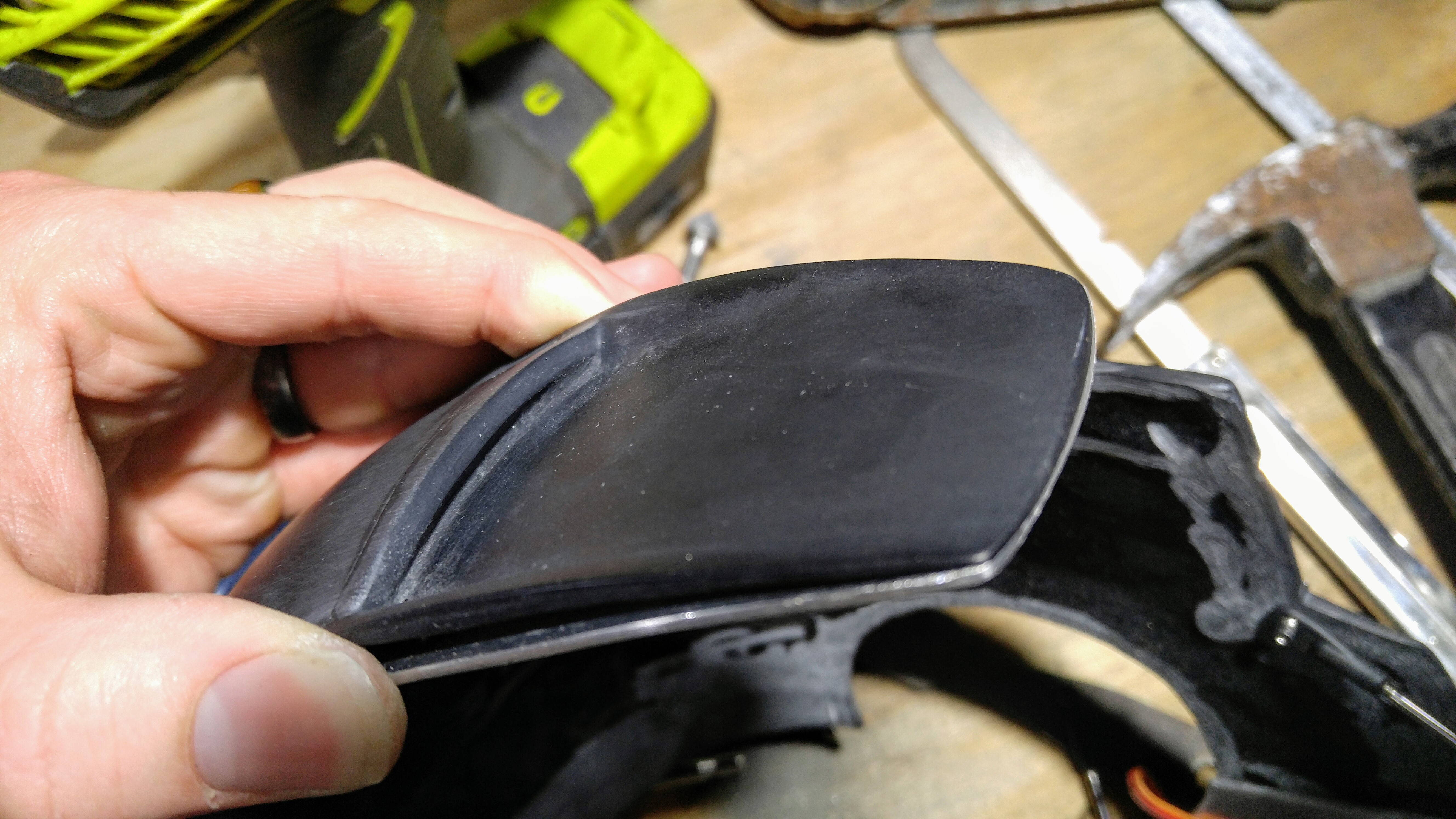

Also finished the first half of the jaw. Well the test fit anyway. Also note that really crappy servo - these will be replaced with nice hitec ones once everything is done, plus polishing the metal to get rid of scratches and make things shiny. Also there is a slight gap to count for the carbon fiber when that is laid on.
