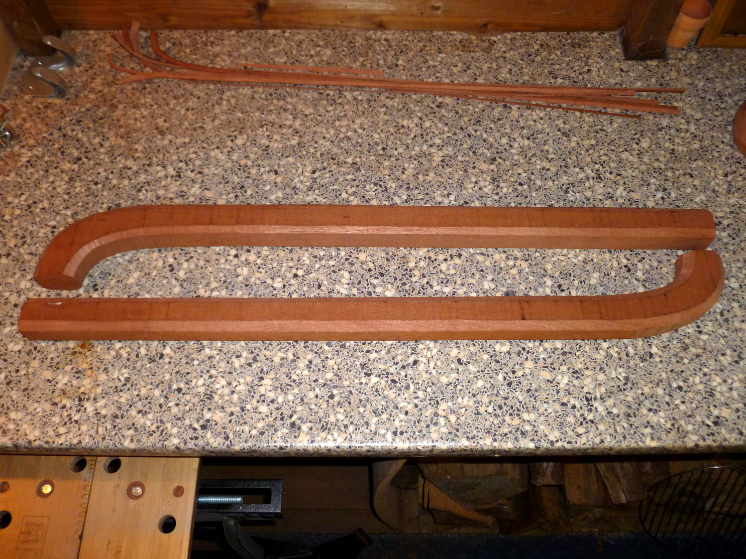

I'm making a Gaffi stick out of solid hardwood. I decided to do it this way because I want it to have as few seperate parts/joins as possible and have an authentic feel and weight to it. I did a bit of research and looked at stills from ANH, other peoples sticks and Fijiian war clubs and worked out roughly what size I wanted it and did some drawings. I then went and bought three bits of Sapele to make two sticks and two pineapples. I marked out the shapes on the wood and then had a joiner I know cut the sticks out and turn the blocks for the pineapples into my required size and shape.

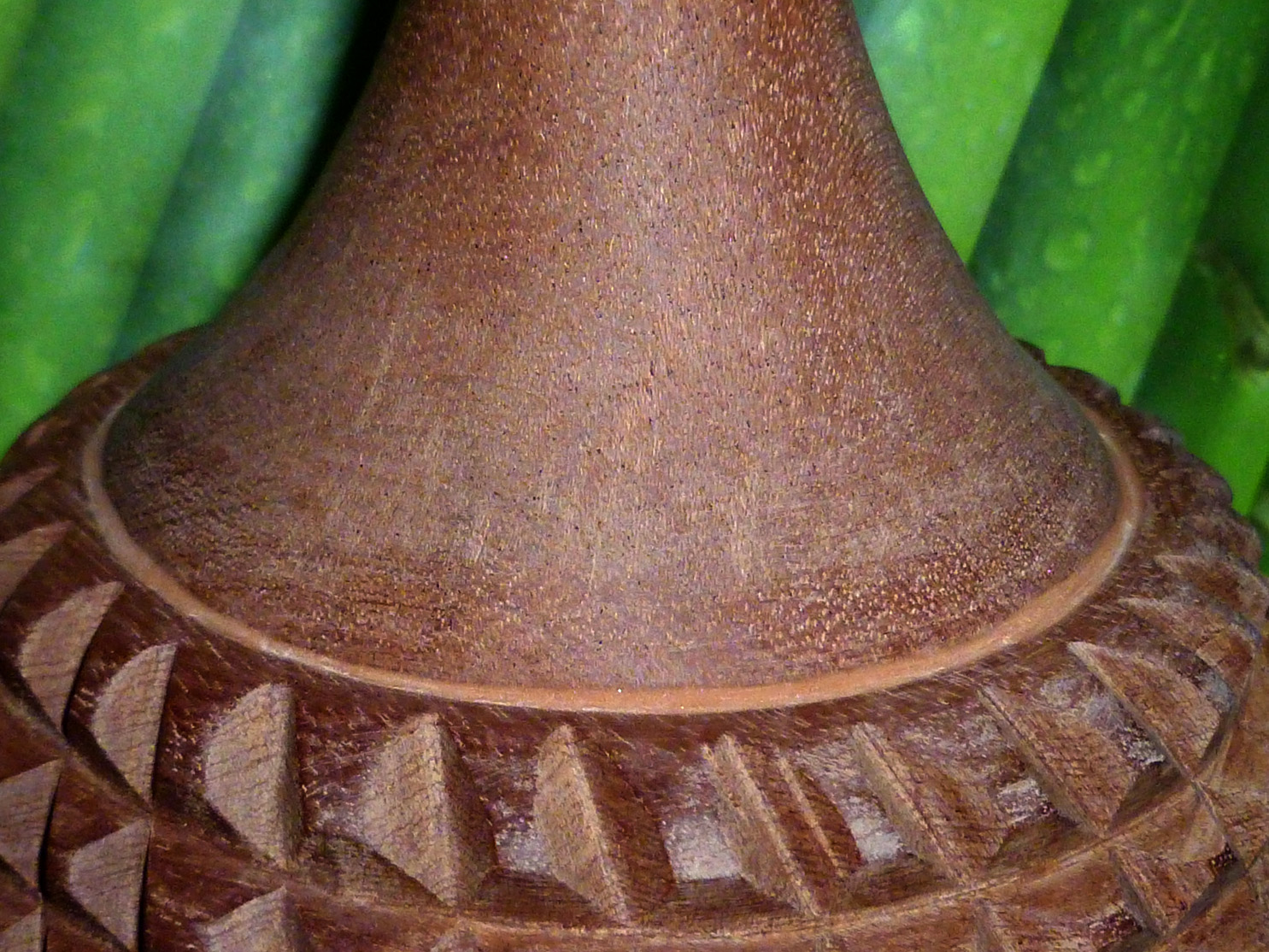

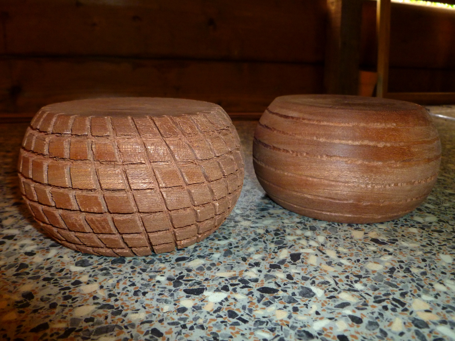

I then bevelled the sticks slightly with a jigsaw to start them off and marked out the lateral lines on the pineapple by stretching elastic bands round and following them with a pencil, I drew the bisecting lines by eye. Then I just used a dremel to make a shallow groove where the lines were and cut through the grooves with a handsaw.

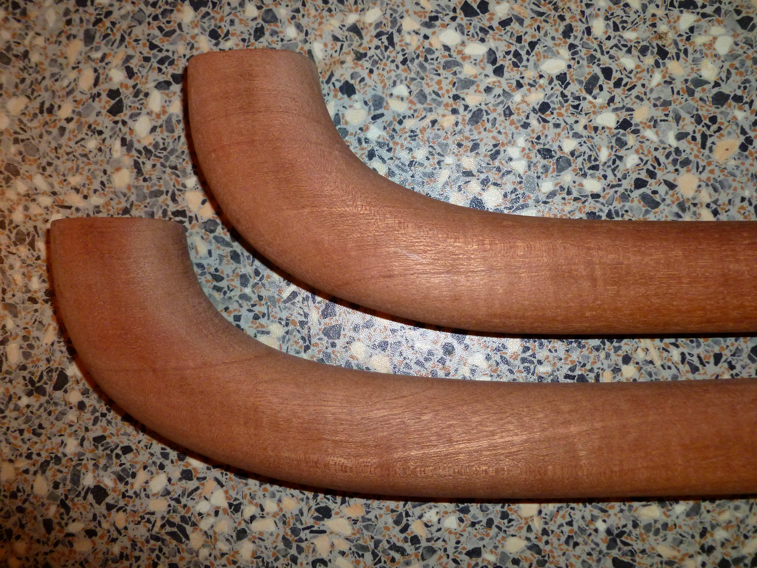

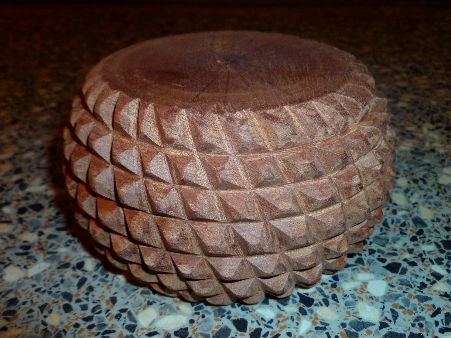

The next stage was to sand the sticks with a small vibration/electric sander. This was hard work but in doing it that way they look a bit more natural and not perfectly cylindrical which I wanted. They are not finished, need to do a bit more shaping and then make them smoother with finer grit. The pineapple I have filed with a square file. That's not finished either, it looks too uniform, I want to do some shaping and tweaking with smaller files.

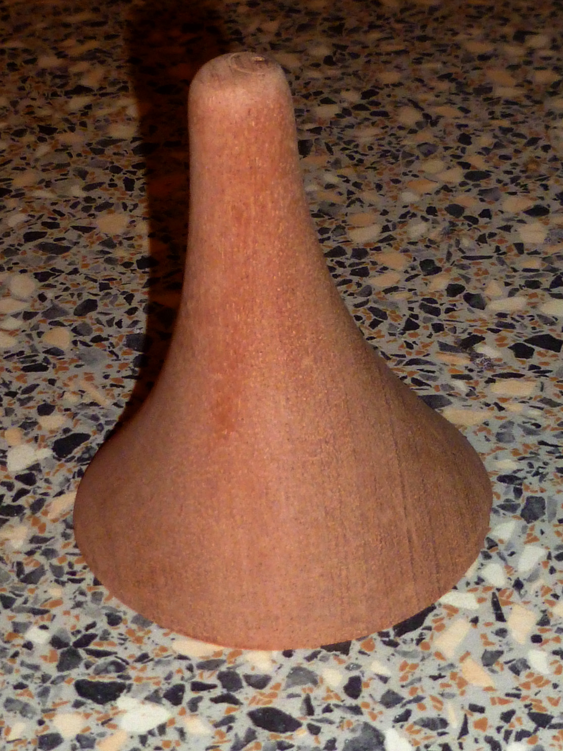

I had the spike parts turned slightly oversized into a general cone shape so that I could carve/shape them by eye. It allowed me to make the spike off-centre and give it a more interesting and appealing shape. I just drew a cirle to one side of the top and using the dremel sanded it and shaped it by eye. It ends up slightly lumpy but then I took the electric sander which has a foam plate and ran that over it to sand out the lumps. I was really pleased with these, I feel like it's all coming together now!
I am going to screw and glue the pineapple to the stick with a big countersunk screw and then glue the spike to the pineapple. My carpenter told me if I put a big blob of glue on the pineapple and then move the spike around on it it will expel the air and excess glue and give a nice strong hold. Once it's glued I'll stick a bit of filler in all the joins and any little holes and cracks and then sand it smooth so it all looks like one piece. I'm then going to dye it with a mahogany wood dye and wax it so it has a nice hard, shiny finish. I'm starting to think about the mace.. will post again with progress.

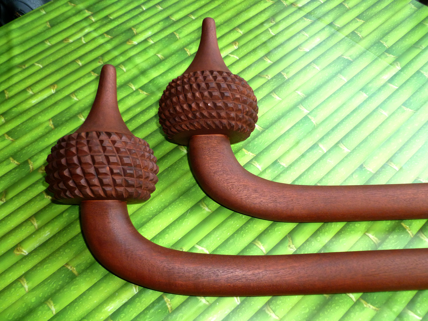

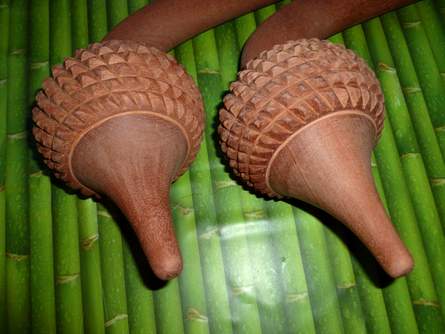

I finished all the shaping and sanding of the wooden parts and have joined them together. I basically drilled a hole right through the pineapple and countersunk one side, then a pilot hole into the stick and used a 100mm screw and a little glue. It's really solid. For the spike I put a big blob of glue on the pineapple and then pressed the spike on it whilst moving it around before positioning it in the middle. I filled in the joins/cracks with filler and sanded them smooth once dry. Even though you can see the seperate parts in front of you you never really know exactly what it's going to look and feel like until it's all joined together. I'm pleased with the shape, it feels good in hand too, it's got a nice weight.
P1050460(2) (small).jpgP1050462(2) (small).jpgP1050454(2) (small).jpgP1050455(2) (small).jpg
I've now put several layers of wood dye on them. I wanted to get a really dark red colour but it's a bit of an experiment because I've never done it before. I'm not sure if I'm going to go darker or leave them like this. You can still see the grain which I wanted and they look pretty good as is. I'm going to put a clear natural wax on them next which should seal them and give them a nice smooth, shiny, hard finish.
P1050468(2) (small).jpgP1050470(2) (small).jpgP1050472(2) (small).jpgP1050475(2) (small).jpg
