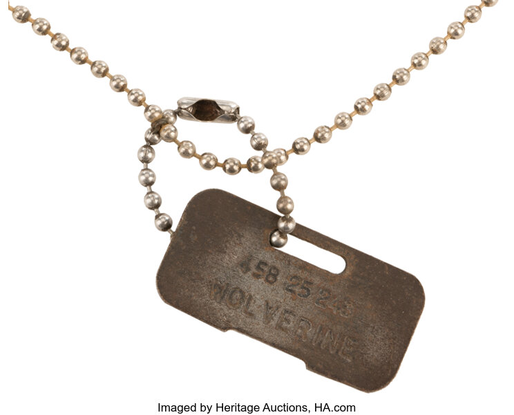

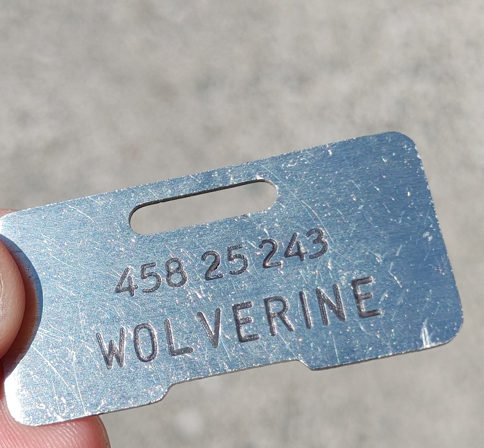

Recently bought the X Men 1 dog tags from Dark Matter Props and I wanna distress them to match this photo. I'm unsure of what kind of metal they're made of so I'm not sure how to rust them. Suggestions?

Bumping. I also bought the same dog tags (first X-men film) from the same source, and I'm thinking of weathering as well.
I'm assuming they either used some kind of metal that oxidizes easily, or it's painted. I'm guessing painted.
I've been looking for ways to do this myself. The problem I've ran into is that hey're stainless steel and as the name implies, finding ways to distress it has been a challenge. I've been working off an image of the X2 tag prop:
First I tried burning it (I've done it to steel before and it worked) and nada. So then I painted it with hammered textured paint, and it sorta did the trick, but begun to chip away with wear.
So then I scrubbed the paint away, and tried a different solution. Using a similar bleach/salt bath I used to distress my OWK lightsaber, I left the tag to sit in the bath for about 2 days. It did create a nice pitting effect, but I really want to find a way to permanently tarnish the metal.

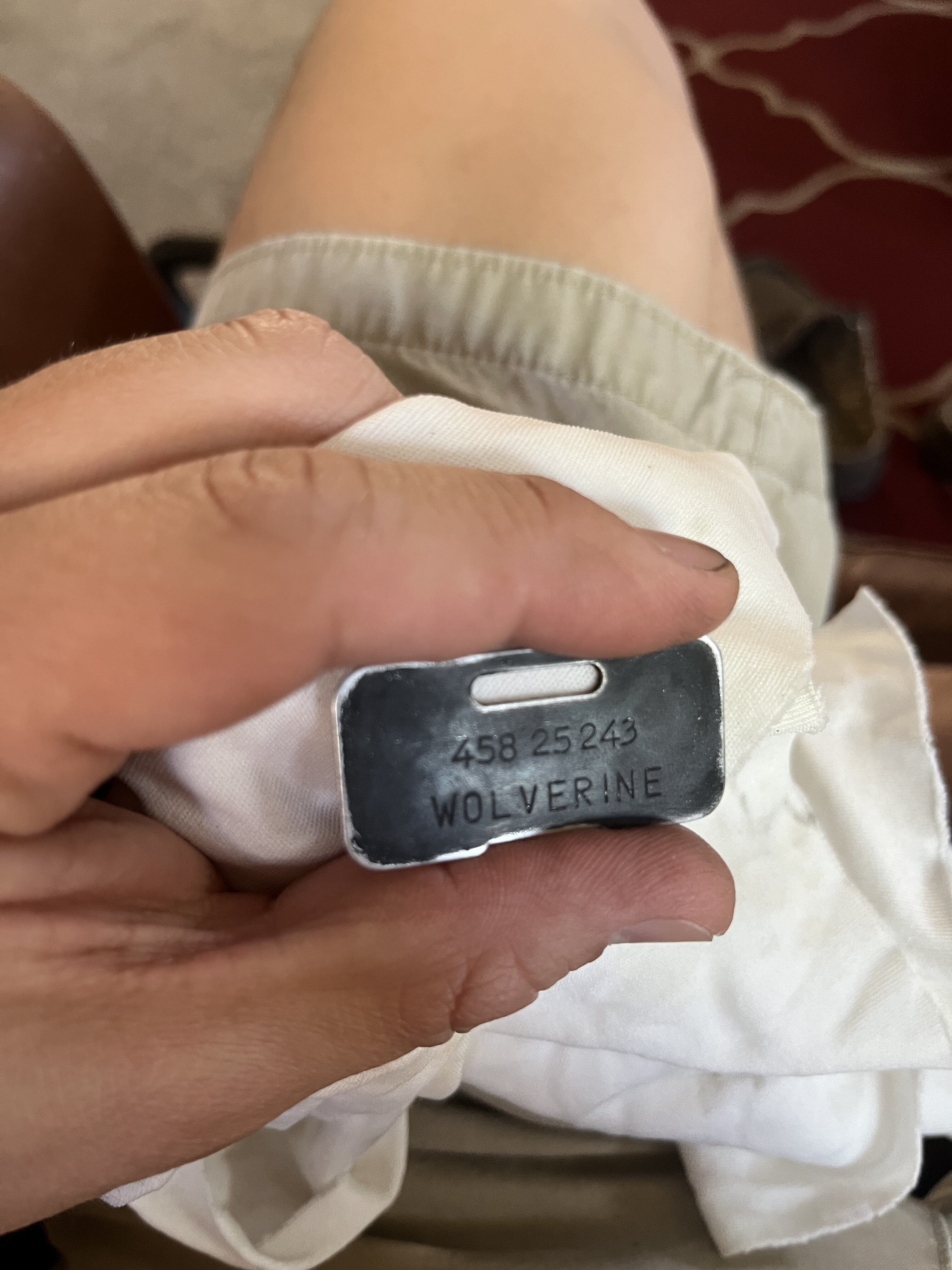

My apologies to post on an older post but I have a dark matter wolverine dog tag and used Birchwood Casey’s Aluminum black and this is how it came out.
CAUTION: when applying the aluminum black it will get home abs start to sizzle and release a gas smell. Do this in a well ventilated area with PPE!
I haven't aged mine yet, but I might use that technique. It looks great!
Thank ya. Hit me up for any info needed.
This is the before of it.
One more thing is you will need to use steel wool to scratch the surface.
This is how black it gets. Jus knock it down with very fine steel wool

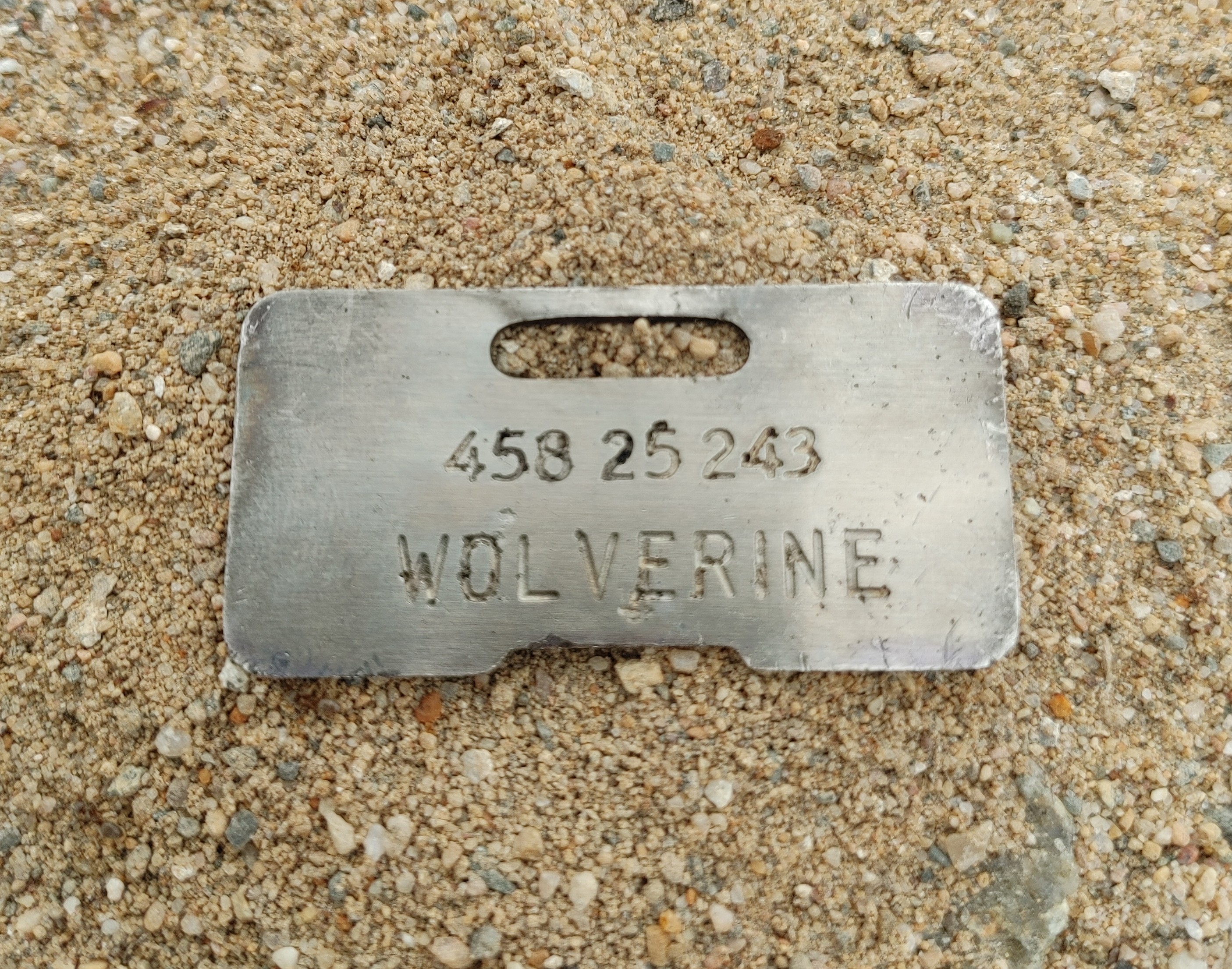

Decided to tackle this at last, after several years of procrastination.
First was the nicks, dents and scratches. I used the ol' box of screws method (and stomped it in some gravel for good measure). While I was probably borderline overzealous with this, I'm enamored with how it looks now!
Next I'm going to attempt the rust/patina effect. What is the best recommendation for a salt bath? I tried bleach and salt, but I'm new to this and apparently don't know what I'm doing, because there were no effects after several days.

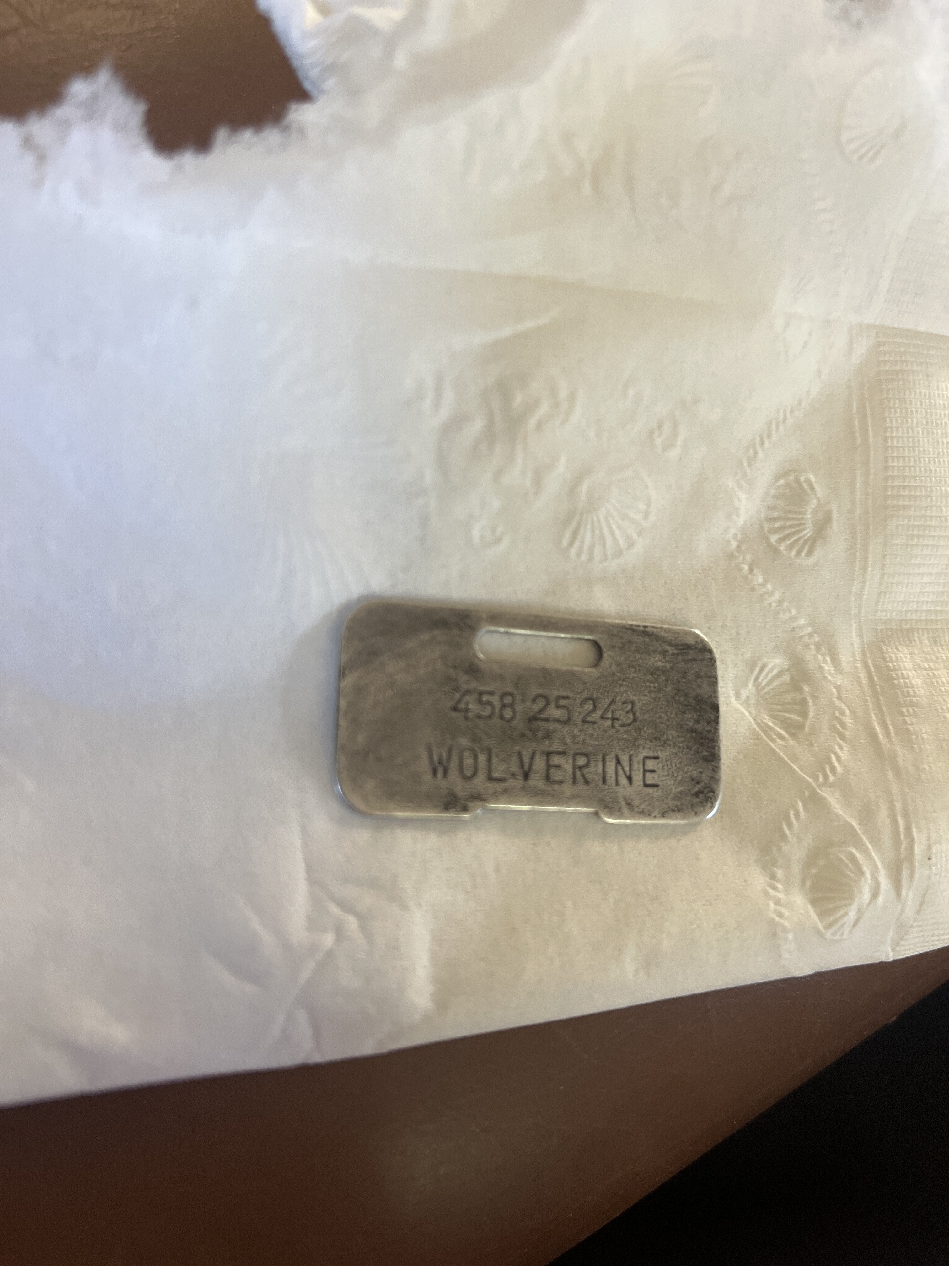

I think I've got it where I like now. A combination of heating and dunking in moist coffee grounds (this gave an immediate patina), some small amounts of burning/singeing in areas, and some bending/scraping with pliers on the edges and the hole where the chain goes. While it doesn't look like the screen accurate rusted ones, in person it looks very naturally aged, which is a win in my opinion. At this point, I feel like I could fool guests into thinking it was a real historical military dog tag.
