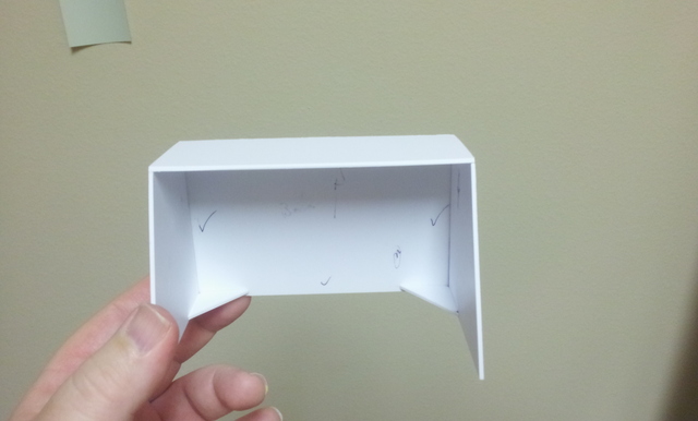

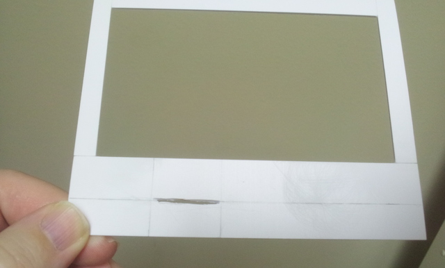

The first step was to cut a bunch of pieces of sheet styrene (why isn't "styrene" in the dictionary?) and start gluing them together.

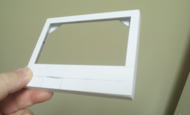

The base with some reinforcements in the corners because I did not have anything better to make sure they are square:
The top of the base with the slot for computer tapes roughly cut:
The base and top together:
Upper section:
Here is the front marked for drilling. I messed this up when I drilled the holes and they do not line up correctly. I used a drill press, but it is not perfectly aligned and for something like this you really need something with an x-y table which won't fit on mine. I know this is the bad one because of the marking are on the front. Also, that bottom row of indicators is too low. I will take a picture of the new one tomorrow.

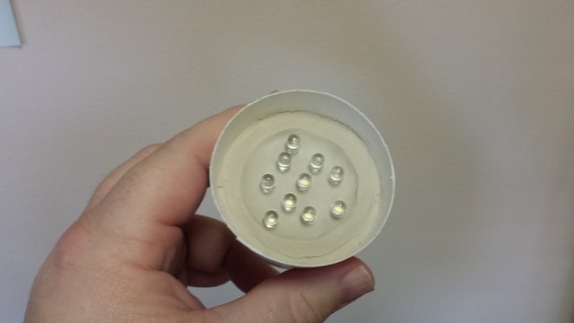

I got a paper cup, filled the bottom with clay, jammed a bunch of LED's in and made a mold.

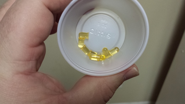

The first ones I cast were yellow. The funny thing was that after I poured the epoxy I though there were huge bubbles at the bottom, but it was just the lens affect. So cool!
No need to show the red or blue. I currently have the green ones curing. I have noticed that when I mix the resin the color looks great but when I pull the parts from the mold they are a lot lighter because they are so small. For now I am going to stay with them. Maybe after I test them with actual lighting I will have to recast them with more tint.

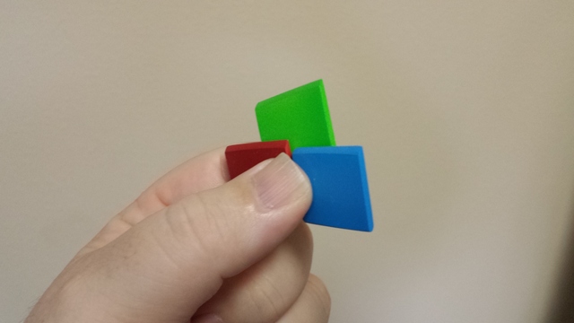

And of course I made some tapes for it. These are just some styrene cut to the right dimensions and then I used sand paper for the angled top and rounded bottom.
So that was all stuff from months ago. I pulled the green indicators out of the mold this morning. One had a big bubble in it but that is why I made a mold for eight at a time.
