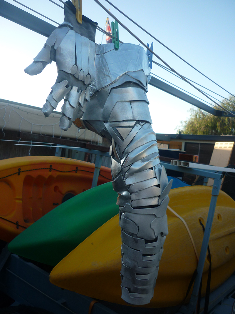

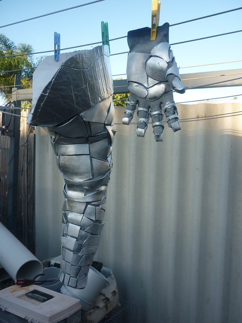

1 day to go before . . . *Captain America - The Winter Soldier* . . . and I'm posting progress pictures as I wait for the paint to dry.
I'm up to 2 coats of paint so far, one coat of Machinery Grey matte Spray paint; and one coat of Silver Spray Paint so for. When thats dry I will paint on the Iconic Red and Black outlined star on the sholder and add in detail to the hand with a marker pen this evening. Then in the morning I will spray the arm with a final clear gloss coat to seal everything up.
Ok Picture Time.
Painted 1.jpgPainted 2.jpgPainted 3.jpgPainted 4.jpgPainted 7.jpgPainted 5.jpgPainted 6.jpg
