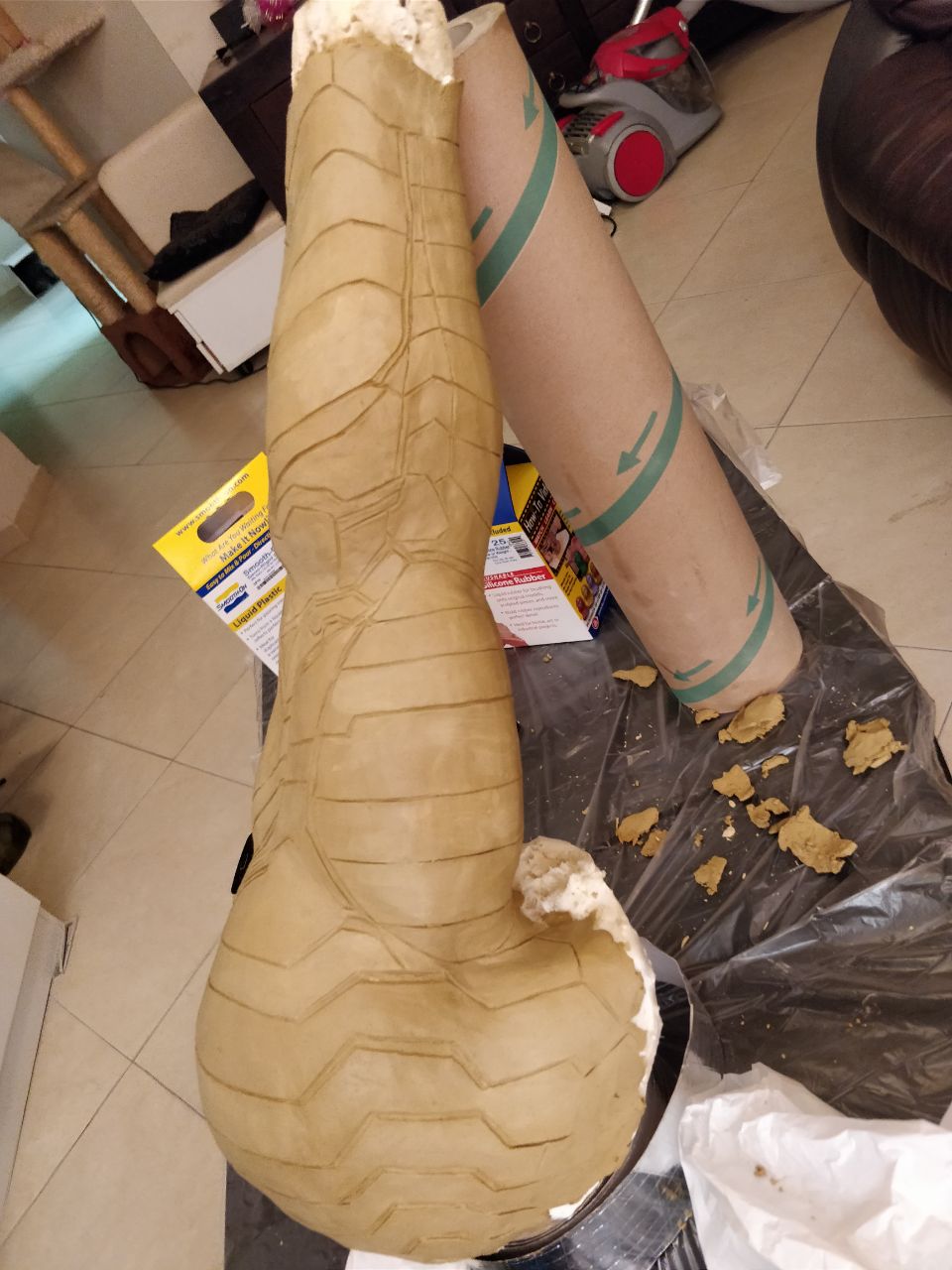

Sculpting this perplexing design of an arm - the pieces are so unintuitive, seriously - was tricky, but I got it made. It's almost weird to me, that it feels way less finished than the one built by Hydra.
And then 3 layers of Rebound 25 and a plaster shell. Working with silicone was a joy, and the day after I was left with a beautiful mould.
Then problems started. The polyurethane I purchased was Smooth-Cast 45D. I don't know what I did wrong, but the first and second tries of casting came out awful. Tiny bubbles everywhere (that formed during the curing process), and the final casting vas not rigid enouh to keep shape. In the end the only okay-ish things I had done with it were the different buckles of the jacket. Which is definitely something, but I was still really dissapointed.
I then bought a batch of a generic rigid polyester resin from a local hardware store, but it was very runny, the curing process was way too slow, and I ended up losing a lot of resin that just got poured out. I thought about buying a fiber-based filler that'd hopefully allow me to brush it peoperly, but with running out of budget for the project I simply ended up putting it aside and setting my mind to other things. And I thought maybe the film itself would motivate me again, but after watching it on opening night I was even more bummed out by that out-of-nowhere, depressing ending.
